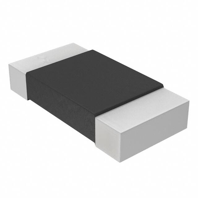

RCS e3 www.vishay.com Vishay Anti-Surge, High Power Thick Film Chip Resistors FEATURES • Excellent surge pulse capability • Superior ESD surge characteristics • High power rating • AEC-Q200 qualified • Material categorization: for definitions of compliance please see www.vishay.com/doc?99912 APPLICATIONS LINKS TO ADDITIONAL RESOURCES • Automotive 3D 3D • Industrial 3D Models • Telecommunications The anti-surge thick film chip resistor series combines a significantly higher power rating and pulse load performance as compared to standard chip resistors. • Medical TECHNICAL SPECIFICATIONS DESCRIPTION Imperial size Metric size code RCS0402 e3 RCS0603 e3 RCS0805 e3 RCS1206 e3 0402 0603 0805 1206 RR1005M RR1608M RR2012M RR3126M 1 Ω to 10 MΩ; jumper (0 Ω) Resistance range Resistance tolerance ± 5 %; ± 1 %; ± 0.5 % Temperature coefficient ± 200 ppm/K; ± 100 ppm/K Rated dissipation, P70 (1) 0.2 W 0.25 W Operating voltage, Umax. ACRMS/DC 50 V 75 V Permissible film temperature, ϑF max. (1) 0.4 W 0.5 W 150 V 200 V 200 V 300 V 155 °C Operating temperature range -55 °C to +155 °C Max. resistance change at P70 for resistance range, |ΔR/R| after: 1000 h ≤ 1.0 % 8000 h ≤ 2.0 % Permissible voltage against ambient (insulation): 1 min, Uins 75 V Failure rate: FITobserved 100 V ≤ 0.1 x 10-9/h Note (1) Please refer to APPLICATION INFORMATION below APPLICATION INFORMATION When the resistor dissipates power, a temperature rise above the ambient temperature occurs, dependent on the thermal resistance of the assembled resistor together with the printed circuit board. The rated dissipation applies only if the permitted film temperature is not exceeded. These resistors do not feature a limited lifetime when operated within the permissible limits. However, resistance value drift increasing over operating time may result in exceeding a limit acceptable to the specific application, thereby establishing a functional lifetime. Revision: 01-Jun-2021 Document Number: 20065 1 For technical questions, contact: thickfilmchip@vishay.com THIS DOCUMENT IS SUBJECT TO CHANGE WITHOUT NOTICE. THE PRODUCTS DESCRIBED HEREIN AND THIS DOCUMENT ARE SUBJECT TO SPECIFIC DISCLAIMERS, SET FORTH AT www.vishay.com/doc?91000 RCS e3 www.vishay.com Vishay TEMPERATURE COEFFICIENT AND RESISTANCE RANGE TYPE / SIZE RCS0402 e3 RCS0603 e3 RCS0805 e3 RCS1206 e3 TCR TOLERANCE RESISTANCE E-SERIES ± 200 ppm/K ±5% 1 Ω to 10 MΩ E24 ± 100 ppm/K ±1% 1 Ω to 10 MΩ E24; E96 ± 100 ppm/K ± 0.5 % 1 Ω to 10 MΩ E24; E96 Jumper, Imax. = 3 A ≤ 20 mΩ 0Ω - ± 200 ppm/K ±5% 1 Ω to 10 MΩ E24 ± 100 ppm/K ±1% 1 Ω to 10 MΩ E24; E96 ± 100 ppm/K ± 0.5 % 1 Ω to 10 MΩ E24; E96 Jumper, Imax. = 3.5 A ≤ 20 mΩ 0Ω - ± 200 ppm/K ±5% 1 Ω to 10 MΩ E24 ± 100 ppm/K ±1% 1 Ω to 10 MΩ E24; E96 ± 100 ppm/K ± 0.5 % 1 Ω to 10 MΩ E24; E96 Jumper, Imax. = 4 A ≤ 20 mΩ 0Ω - ± 200 ppm/K ±5% 1 Ω to 10 MΩ E24 ± 100 ppm/K ±1% 1 Ω to 10 MΩ E24; E96 ± 100 ppm/K ± 0.5 % 1 Ω to 10 MΩ E24; E96 Jumper, Imax. = 5 A ≤ 20 mΩ 0Ω - Note • The temperature coefficient of resistance (TCR) is not specified for 0 Ω jumpers PACKAGING TYPE / SIZE RCS0402 e3 RCS0603 e3 RCS0805 e3 RCS1206 e3 Revision: 01-Jun-2021 CODE QUANTITY ED = ET7 10 000 EE = EF4 50 000 EI = ET2 5000 ED = ET3 10 000 EL = ET4 20 000 EE = ET8 50 000 PACKAGING STYLE WIDTH PITCH 2 mm PACKAGING DIMENSIONS Ø 180 mm/7" Ø 330 mm/13" Ø 180 mm/7" 2 mm Ø 180 mm/7" Ø 285 mm/11.25" Ø 330 mm/13" EA = ET1 5000 EB = ET5 10 000 Ø 180 mm/7" EC = ET6 20 000 Ø 330 mm/13" EA = ET1 5000 Ø 180 mm/7" EB = ET5 10 000 EC = ET6 20 000 Ø 330 mm/13" EA = ET1 5000 Ø 180 mm/7" EB = ET5 10 000 EC = ET6 20 000 Paper tape according to IEC 60286-3, Type 1a 8 mm 4 mm 4 mm 4 mm Ø 285 mm/11.25" Ø 285 mm/11.25" Ø 285 mm/11.25" Ø 330 mm/13" Document Number: 20065 2 For technical questions, contact: thickfilmchip@vishay.com THIS DOCUMENT IS SUBJECT TO CHANGE WITHOUT NOTICE. THE PRODUCTS DESCRIBED HEREIN AND THIS DOCUMENT ARE SUBJECT TO SPECIFIC DISCLAIMERS, SET FORTH AT www.vishay.com/doc?91000 RCS e3 www.vishay.com Vishay PART NUMBER AND PRODUCT DESCRIPTION Part Number: RCS0805100RFKEC Part Number: RCS08050000Z0EC R C S 0 8 0 5 1 0 0 R F K E TYPE / SIZE RESISTANCE TOLERANCE TCR PACKAGING RCS0402 RCS0603 RCS0805 RCS1206 R = decimal K = thousand M = million 0000 = jumper D = ± 0.5 % F = ± 1.0 % J = ± 5.0 % Z = jumper K = ± 100 ppm/K N = ± 200 ppm/K 0 = jumper EA, EB, EC, ED, EE, EI, EL C Product Description: RCS0805 100 100R 1 % ET6 e3 Product Description: RCS0805 0R0 ET6 e3 RCS0805 100 100R 1% ET6 e3 TYPE / SIZE TCR RESISTANCE TOLERANCE PACKAGING LEAD (Pb)-FREE RCS0402 RCS0603 RCS0805 RCS1206 ± 100 ppm/K ± 200 ppm/K 10R = 10 Ω 100R = 100 Ω 10K = 10 kΩ 1M0 = 1 MΩ 0R0 = jumper ± 0.5 % ± 1.0 % ± 5.0 % ET1, ET2, ET3, ET4, ET5, ET6, ET7, ET8, EF4 e3 = pure tin termination finish Revision: 01-Jun-2021 Document Number: 20065 3 For technical questions, contact: thickfilmchip@vishay.com THIS DOCUMENT IS SUBJECT TO CHANGE WITHOUT NOTICE. THE PRODUCTS DESCRIBED HEREIN AND THIS DOCUMENT ARE SUBJECT TO SPECIFIC DISCLAIMERS, SET FORTH AT www.vishay.com/doc?91000 RCS e3 www.vishay.com DESCRIPTION Production is strictly controlled and follows an extensive set of instructions established for reproducibility. A cermet film layer and a glass-over are deposited on a high grade (AI2O3) ceramic substrate with its prepared inner contacts on both sides. A special laser is used to achieve the target value and the desired power dissipation performance by smoothly fine trimming the resistive layer without damaging the ceramics. The resistor elements are covered by a protective coating designed for electrical, mechanical and climatic protection. The terminations receive a final pure tin on nickel plating. The result of the determined production is verified by an extensive testing procedure on 100 % of the individual chip resistors. Only accepted products are laid directly into the tape in accordance with IEC 60286-3 Type 1a (1). ASSEMBLY The resistors are suitable for processing on automatic SMD assembly systems. They are suitable for automatic soldering using wave, reflow or vapor phase as shown in IEC 61760-1. The encapsulation is resistant to all cleaning solvents commonly used in the electronics industry, including alcohols, esters and aqueous solutions. The suitability of conformal coatings potting compounds and their processes, if applied, shall be qualified by appropriate means to ensure the long-term stability of the whole system. The resistors are RoHS-compliant, the pure tin plating provides compatibility with lead (Pb)-free and lead-containing soldering processes. Solderability is specified for 2 years after production or requalification. The permitted storage time is 20 years. The immunity of the plating against tin whisker growth has been proven under extensive testing. MATERIALS Vishay acknowledges the following systems for the regulation of hazardous substances: Vishay The products do not contain any of the banned substances as per IEC 62474, GADSL, or the SVHC list, see www.vishay.com/how/leadfree. Hence the products fully comply with the following directives: • 2000/53/EC End-of-Life Vehicle Directive (ELV) and Annex II (ELV II) • 2011/65/EU Restriction of the Use of Hazardous Substances Directive (RoHS) with amendment 2015/863/EU • 2012/19/EU Waste Electrical and Electronic Equipment Directive (WEEE) Vishay pursues the elimination of conflict minerals from its supply chain, see the Conflict Minerals Policy at www.vishay.com/doc?49037. APPROVALS The resistors are qualified according to AEC-Q200. Where applicable, the resistors are tested in accordance with EN 140401-802 which refers to EN 60115-1, EN 60115-8 and the variety of environmental test procedures of the IEC 60068 (1) series. RELATED PRODUCTS For more information about products with superior surge and pulse performance please refer to D/CRCW-IF e3, Pulse Proof Thick Film Chip Resistors datasheet (www.vishay.com/doc?20024). The CRCW-HP e3 product series is designed for those applications where both enhanced power rating and superior pulse loading performance is required. For ordering CRCW-HP e3 please refer to latest edition of datasheet (www.vishay.com/doc?20043). For thick film resistors with standard requirements for power rating, please refer to D/CRCW e3, Standard Thick Film Chip Resistors datasheet (www.vishay.com/doc?20035) • IEC 62474, Material Declaration for Products of and for the Electrotechnical Industry, with the list of declarable substances given therein (2) • The Global Automotive Declarable Substance List (GADSL) (3) • The REACH regulation (1907/2006/EC) and the related list of substances with very high concern (SVHC) (4) for its supply chain Notes (1) The quoted IEC standards are also released as EN standards with the same number and identical contents (2) The IEC 62474 list of declarable substances is maintained in a dedicated database, which is available at http://std.iec.ch/iec62474. (3) The Global Automotive Declarable Substance List (GADSL) is maintained by the American Chemistry Council and available at www.gadsl.org (4) The SVHC list is maintained by the European Chemical Agency (ECHA) and available at http://echa.europa.eu/candidate-list-table Revision: 01-Jun-2021 Document Number: 20065 4 For technical questions, contact: thickfilmchip@vishay.com THIS DOCUMENT IS SUBJECT TO CHANGE WITHOUT NOTICE. THE PRODUCTS DESCRIBED HEREIN AND THIS DOCUMENT ARE SUBJECT TO SPECIFIC DISCLAIMERS, SET FORTH AT www.vishay.com/doc?91000 RCS e3 www.vishay.com Vishay FUNCTIONAL PERFORMANCE Single Pulse High Power Overload 1.2 μs / 50 μs Pulse Axis Title 10 000 10000 1000 RCS1206 RCS0805 RCS0603 RCS0402 100 1st line 2nd line 2nd line Peak Voltage (V) 1000 100 10 10 100 000 1 1 10 100 1000 10 000 Resistance Value (Ω) Pulse load rating in accordance with EN 60115-1, 4.27; 1.2 μs / 50 μs; 5 pulses at 12 s intervals; for permissible resistance change 1 % Single Pulse High Power Overload 10 μs / 700 μs Pulse Axis Title 10 000 10000 1000 1st line 2nd line 2nd line Peak Voltage (V) 1000 RCS1206 RCS0805 RCS0603 RCS0402 100 100 10 10 100 000 1 1 10 100 1000 10 000 Resistance Value (Ω) Pulse load rating in accordance with EN 60115-1, 4.27; 10 μs / 700 μs; 10 pulses at 1 min intervals; for permissible resistance change 1 % Single Pulse Axis Title 10000 10 000 RCS1206 RCS0805 100 1000 1st line 2nd line 2nd line ^ Pmax. - Pulse Load (W) 1000 10 RCS0402 1 100 RCS0603 0.1 0.01 0.000001 10 0.00001 0.0001 0.001 0.01 0.1 1 10 100 ti - Pulse Duration (s) Maximum pulse load, single pulse; applicable if P → 0 and n < 1000 and Uˆ = Uˆ max.; for permissible resistance change equivalent to 8000 h operation Revision: 01-Jun-2021 Document Number: 20065 5 For technical questions, contact: thickfilmchip@vishay.com THIS DOCUMENT IS SUBJECT TO CHANGE WITHOUT NOTICE. THE PRODUCTS DESCRIBED HEREIN AND THIS DOCUMENT ARE SUBJECT TO SPECIFIC DISCLAIMERS, SET FORTH AT www.vishay.com/doc?91000 RCS e3 www.vishay.com Vishay Continuous Pulse Axis Title 10000 10 000 RCS1206 100 1000 RCS0805 1st line 2nd line 2nd line ^ Pmax. - Pulse Load (W) 1000 10 RCS0402 1 100 RCS0603 0.1 10 0.01 0.000001 0.00001 0.0001 0.001 0.01 0.1 1 10 100 ti - Pulse Duration (s) Maximum pulse load, continuous pulses; applicable if P ≤ P (ϑamb) and Uˆ = Uˆ max.; for permissible resistance change equivalent to 8000 h operation Pulse Voltage Axis Title 800 10000 600 RCS0805 1000 1st line 2nd line 2nd line ^ Umax. - Pulse Voltage (V) RCS1206 400 RCS0603 100 RCS0402 200 10 0 0.000001 0.00001 0.0001 0.001 0.01 0.1 1 10 ti - Pulse Duration (s) Maximum pulse voltage, single and continuous pulses; applicable if Pˆ = Pˆ max.; for permissible resistance change equivalent to 8000 h operation Derating Axis Title 10000 0.6 RCS1206 RCS0805 1000 0.4 0.3 1st line 2nd line 2nd line P - Power Dissipation (W) 0.5 RCS0603 100 0.2 RCS0402 0.1 10 0 -70 -50 Revision: 01-Jun-2021 -30 -10 0 10 30 50 70 ϑamb - Ambient Temperature (°C) 90 100110 130 150 Document Number: 20065 6 For technical questions, contact: thickfilmchip@vishay.com THIS DOCUMENT IS SUBJECT TO CHANGE WITHOUT NOTICE. THE PRODUCTS DESCRIBED HEREIN AND THIS DOCUMENT ARE SUBJECT TO SPECIFIC DISCLAIMERS, SET FORTH AT www.vishay.com/doc?91000 RCS e3 www.vishay.com Vishay TESTS AND REQUIREMENTS All executed tests are carried out in accordance with the following specifications: EN 60115-1, generic specification EN 60115-8 specification (successor of EN 140400), sectional The tests are carried out under standard atmospheric conditions in accordance with IEC 60068-1, 4.3, whereupon the following values are applied: Temperature: 15 °C to 35 °C Relative humidity: 25 % to 75 % EN 140401-802, detail specification Air pressure: 86 kPa to 106 kPa (860 mbar to 1060 mbar). IEC 60068-2-xx, test methods A climatic category LCT / UCT / 56 is applied, defined by the lower category temperature (LCT), the upper category temperature (UCT), and the duration of exposure in the damp heat, steady state test (56 days). The parameters stated in the Test Procedures and Requirements table are based on the required tests and permitted limits of EN 140401-802. The table presents only the most important tests, for the full test schedule refer to the documents listed above. However, some additional tests and a number of improvements against those minimum requirements have been included. The components are mounted for testing on boards in accordance with EN 60115-8, 2.4.2 unless otherwise specified. The testing also covers most of the requirements specified by EIA/IS-703 and JIS-C-5201-1. TEST PROCEDURES AND REQUIREMENTS EN 60115-1 CLAUSE IEC 60068-2 (1) TEST METHOD REQUIREMENTS PERMISSIBLE CHANGE (ΔR) STABILITY CLASS 1 STABILITY CLASS 2 OR BETTER OR BETTER PROCEDURE TEST Stability for product types: RCS e3 4.5 - Resistance 4.8 - Temperature coefficient 4.25.1 - Endurance at 70 °C 4.25.3 - Endurance at upper category temperature 4.24 78 (Cab) Damp heat, steady state 4.37 67 (Cy) Damp heat, steady state, accelerated 4.23 4.23.2 4.23.3 4.23.4 4.23.5 2 (Bb) 30 (Db) 1 (Ab) 13 (M) Climatic sequence: Dry heat Damp Cold Low air pressure 4.23.6 30 (Db) Damp heat, cyclic 4.23.7 - 1 (Aa) DC load Cold 4.19 14 (Na) Rapid change of temperature 4.13 - Short time overload 4.27 - Single pulse high voltage overload Revision: 01-Jun-2021 At (20 / -55 / 20) °C and (20 / 155 / 20) °C U = P 70 x R or U = Umax. whichever is the less severe; 1.5 h on; 0.5 h off 70 °C; 1000 h 70 °C; 8000 h 155 °C; 1000 h (40 ± 2) °C; 56 days; (93 ± 3) % RH (85 ± 2) °C; (85 ± 5) % RH U = 0.1 x P 85 x R ≤ 100 V; 1000 h 125 °C; 16 h 55 °C; 24 h; ≥ 90 % RH; 1 cycle -55 °C; 2 h 8.5 kPa; 2 h; (25 ± 10) °C 55 °C; 24 h; ≥ 90 % RH; 5 cycles U = P 70 x R ≤ Umax.; 1 min -55 °C; 2 h 30 min. at -55 °C and 30 min. at 125 °C 1000 cycles U = 2.5 x P 70 x R ≤ 2 x Umax.; whichever is the less severe; 5 s Severity no. 4: U = 10 x P 70 x R or U = 2 x Umax.; whichever is the less severe; 10 pulses 10 μs / 700 μs 1 Ω to 10 MΩ ± 0.5 %; ± 1 % ±5% ± 100 ppm/K ± 200 ppm/K ± (1 % R + 0.05 Ω) ± (2 % R + 0.1 Ω) ± (2 % R + 0.1 Ω) ± (4 % R + 0.1 Ω) ± (1 % R + 0.05 Ω) ± (2 % R + 0.1 Ω) ± (1 % R + 0.05 Ω) ± (1 % R + 0.05 Ω) ± (2 % R + 0.1 Ω) ± (1 % R + 0.05 Ω) ± (2 % R + 0.1 Ω) ± (0.25 % R + 0.05 Ω) ± (0.5 % R + 0.05 Ω) ± (1 % R + 0.05 Ω) no visible damage ± (2 % R + 0.05 Ω) ± (1 % R + 0.05 Ω) no visible damage Document Number: 20065 7 For technical questions, contact: thickfilmchip@vishay.com THIS DOCUMENT IS SUBJECT TO CHANGE WITHOUT NOTICE. THE PRODUCTS DESCRIBED HEREIN AND THIS DOCUMENT ARE SUBJECT TO SPECIFIC DISCLAIMERS, SET FORTH AT www.vishay.com/doc?91000 RCS e3 www.vishay.com Vishay TEST PROCEDURES AND REQUIREMENTS EN 60115-1 CLAUSE IEC 60068-2 (1) TEST METHOD PROCEDURE TEST REQUIREMENTS PERMISSIBLE CHANGE (ΔR) STABILITY CLASS 1 STABILITY CLASS 2 OR BETTER OR BETTER Stability for product types: U= 21 (Ue3) Resistance to soldering heat Component solvent resistance Shear (adhesion) 15 x P 70 U = 2 x Umax.; whichever is the less severe; 0.1 s on; 2.5 s off; 1000 cycles IEC 61340-3-1 (1); 3 positive + 3 negative discharges; ESD voltage according to the size Endurance by sweeping; 10 Hz to 2000 Hz; no resonance; amplitude ≤ 1.5 mm or ≤ 200 m/s2; 7.5 h Solder bath method, SnPb40; non-activated flux (235 ± 5) °C; (2 ± 0.2) s Solder bath method, Sn96.5Ag3Cu0.5; non-activated flux (245 ± 5) °C; (3 ± 0.3) s Soldering bath method; (260 ± 5) °C; (10 ± 1) s Isopropyl alcohol +50 °C; method 2 RCS0402 e3: 9 N RCS0603 e3 to RCS1206 e3: 17.7 N 4.33 21 (Ue1) Substrate bending Depth 2 mm; 3 times 4.7 - 4.35 - Voltage proof Flammability, needle flame test U = 1.4 x Uins; 60 s IEC 60695-11-5 (1); 10 s 4.39 - Periodic electric overload 4.38 - Electrostatic discharge (human body model) 4.22 6 (Fc) Vibration 4.17 58 (Td) Solderability 4.18 58 (Td) 4.29 45 (XA) 4.32 1 Ω to 10 MΩ RCS e3 x R or ± (1 % R + 0.05 Ω) no visible damage ± (1 % R + 0.05 Ω) ± (0.25 % R + 0.05 Ω) ± (0.5 % R + 0.05 Ω) no visible damage no visible damage Good tinning (≥ 95 % covered); no visible damage ± (0.25 % R + 0.05 Ω) ± (0.5 % R + 0.05 Ω) No visible damage No visible damage ± (0.25 % R + 0.05 Ω) no visible damage, no open circuit in bent position No flashover or breakdown No burning after 30 s Note (1) The quoted IEC standards are also released as EN standards with the same number and identical contents Revision: 01-Jun-2021 Document Number: 20065 8 For technical questions, contact: thickfilmchip@vishay.com THIS DOCUMENT IS SUBJECT TO CHANGE WITHOUT NOTICE. THE PRODUCTS DESCRIBED HEREIN AND THIS DOCUMENT ARE SUBJECT TO SPECIFIC DISCLAIMERS, SET FORTH AT www.vishay.com/doc?91000 RCS e3 www.vishay.com Vishay DIMENSIONS L T2 W H T1 DIMENSIONS AND MASS TYPE / SIZE L (mm) W (mm) H (mm) T1 (mm) T2 (mm) MASS (mg) RCS0402 e3 1.0 ± 0.05 0.5 ± 0.05 0.35 ± 0.05 0.25 ± 0.05 0.2 ± 0.10 0.65 RCS0603 e3 1.55 + 0.10 / - 0.05 0.85 ± 0.10 0.45 ± 0.05 0.3 ± 0.20 0.3 ± 0.20 2 RCS0805 e3 2.0 + 0.20 / - 0.10 1.25 ± 0.15 0.45 ± 0.05 0.3 + 0.20 / - 0.10 0.3 ± 0.20 5.5 RCS1206 e3 3.2 + 0.10 / - 0.20 1.6 ± 0.15 0.55 ± 0.10 0.45 ± 0.20 0.4 ± 0.20 10 SOLDER PAD DIMENSIONS X G Y Z RECOMMENDED SOLDER PAD DIMENSIONS WAVE SOLDERING REFLOW SOLDERING TYPE / SIZE G (mm) Y (mm) X (mm) Z (mm) G (mm) Y (mm) X (mm) Z (mm) RCS0402 e3 - - - - 0.45 0.6 0.6 1.65 RCS0603 e3 0.65 1.10 1.25 2.85 0.75 0.75 1.00 2.25 RCS0805 e3 0.90 1.30 1.60 3.50 1.00 0.95 1.45 2.90 RCS1206 e3 1.40 1.40 1.95 4.20 1.50 1.05 1.80 3.60 Notes • The given solder pad dimensions reflect the considerations for board design and assembly as outlined e.g in standards IEC 61188-5-x (1) or in publication IPC-7351 (1) The quoted IEC standards are also released as EN standards with the same number and identical contents Revision: 01-Jun-2021 Document Number: 20065 9 For technical questions, contact: thickfilmchip@vishay.com THIS DOCUMENT IS SUBJECT TO CHANGE WITHOUT NOTICE. THE PRODUCTS DESCRIBED HEREIN AND THIS DOCUMENT ARE SUBJECT TO SPECIFIC DISCLAIMERS, SET FORTH AT www.vishay.com/doc?91000 Legal Disclaimer Notice www.vishay.com Vishay Disclaimer ALL PRODUCT, PRODUCT SPECIFICATIONS AND DATA ARE SUBJECT TO CHANGE WITHOUT NOTICE TO IMPROVE RELIABILITY, FUNCTION OR DESIGN OR OTHERWISE. Vishay Intertechnology, Inc., its affiliates, agents, and employees, and all persons acting on its or their behalf (collectively, “Vishay”), disclaim any and all liability for any errors, inaccuracies or incompleteness contained in any datasheet or in any other disclosure relating to any product. Vishay makes no warranty, representation or guarantee regarding the suitability of the products for any particular purpose or the continuing production of any product. To the maximum extent permitted by applicable law, Vishay disclaims (i) any and all liability arising out of the application or use of any product, (ii) any and all liability, including without limitation special, consequential or incidental damages, and (iii) any and all implied warranties, including warranties of fitness for particular purpose, non-infringement and merchantability. Statements regarding the suitability of products for certain types of applications are based on Vishay's knowledge of typical requirements that are often placed on Vishay products in generic applications. Such statements are not binding statements about the suitability of products for a particular application. It is the customer's responsibility to validate that a particular product with the properties described in the product specification is suitable for use in a particular application. Parameters provided in datasheets and / or specifications may vary in different applications and performance may vary over time. All operating parameters, including typical parameters, must be validated for each customer application by the customer's technical experts. Product specifications do not expand or otherwise modify Vishay's terms and conditions of purchase, including but not limited to the warranty expressed therein. Hyperlinks included in this datasheet may direct users to third-party websites. These links are provided as a convenience and for informational purposes only. Inclusion of these hyperlinks does not constitute an endorsement or an approval by Vishay of any of the products, services or opinions of the corporation, organization or individual associated with the third-party website. Vishay disclaims any and all liability and bears no responsibility for the accuracy, legality or content of the third-party website or for that of subsequent links. Except as expressly indicated in writing, Vishay products are not designed for use in medical, life-saving, or life-sustaining applications or for any other application in which the failure of the Vishay product could result in personal injury or death. Customers using or selling Vishay products not expressly indicated for use in such applications do so at their own risk. Please contact authorized Vishay personnel to obtain written terms and conditions regarding products designed for such applications. No license, express or implied, by estoppel or otherwise, to any intellectual property rights is granted by this document or by any conduct of Vishay. Product names and markings noted herein may be trademarks of their respective owners. © 2021 VISHAY INTERTECHNOLOGY, INC. ALL RIGHTS RESERVED Revision: 09-Jul-2021 1 Document Number: 91000

物料型号: - RCS0402e3 - RCS0603e3 - RCS0805e3 - RCS1206e3
器件简介: RCS e3系列是抗浪涌厚膜芯片电阻器,具有高功率等级和脉冲负载性能,相较于标准芯片电阻器有显著提升。它们符合RoHS标准,无卤素,且通过了AEC-Q200认证。
引脚分配: 文档中未明确提供引脚分配信息,但通常这类电阻器为SMD表面贴装形式,具有两个端子用于连接。
参数特性: - 尺寸范围:0402至1206 - 阻值范围:1Ω至10MΩ,包括跳线(0Ω) - 阻值公差:±5%,±1%,±0.5% - 温度系数:±200 ppm/K,±100 ppm/K - 额定耗散功率:0.2W至0.5W - 最大工作电压:50V至200V - 最大环境温度:155°C - 工作温度范围:-55°C至+155°C
功能详解: 这些电阻器设计用于承受高浪涌脉冲能力,具有优越的ESD浪涌特性,适用于汽车、工业、电信和医疗等应用领域。
应用信息: 电阻器在散热时,会根据组装电阻器与印刷电路板的热阻产生高于环境温度的温度上升。在不超过允许的膜温条件下,额定耗散功率才适用。
封装信息: 提供了不同尺寸的封装信息,包括宽度、间距和封装尺寸。包装风格包括根据IEC60286-3标准的纸质胶带。
