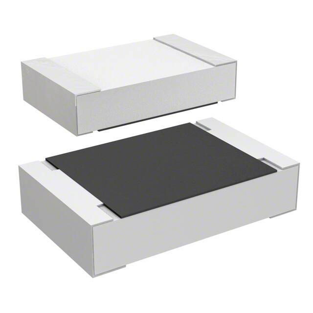

RCWL www.vishay.com Vishay Dale Thick Film Surface Mount Chip Resistors, Wraparound, Low Value (0.1  to 0.91 ) FEATURES • Low resistance values (0.1  to 0.91 ) • Suitable for current sensing and shunts Available • Metal glaze on high quality ceramic • Protective overglaze • Solder contacts on Ni barrier layer Available • AEC-Q200 qualified • Material categorization: for definitions of compliance please see www.vishay.com/doc?99912 Note * This datasheet provides information about parts that are RoHS-compliant and / or parts that are non RoHS-compliant. For example, parts with lead (Pb) terminations are not RoHS-compliant. Please see the information / tables in this datasheet for details STANDARD ELECTRICAL SPECIFICATIONS GLOBAL  MODEL CASE SIZE POWER RATING P70 °C W RCWL0402 0402 0.063 RCWL0603 0603 0.1 RCWL0805 0805 0.125 RCWL1206 1206 0.25 RCWL1210 1210 0.33 200 0.10 to 0.91 5 24 RCWL1218 1218 1.0 200 0.10 to 0.91 5 24 RCWL2010 2010 0.5 200 0.10 to 0.91 5 24 RCWL2512 2512 1.0 200 0.10 to 0.91 5 24 TEMPERATURE COEFFICIENT ± ppm/°C RESISTANCE RANGE  600 0.22 to 0.43 400 0.47 to 0.91 400 0.10 to 0.43 200 0.47 to 0.91 300 0.10 to 0.43 200 0.47 to 0.91 300 0.10 to 0.43 200 0.47 to 0.91 TOLERANCE ±% E-SERIES 5 24 5 24 5 24 5 24 Note • Power rating depends on the max. temperature at the solder point, the component placement density and the substrate material • Part marking: reference “Surface Mount Resistor Marking” (www.vishay.com/doc?20020) • The resistance is measured from the top side GLOBAL PART NUMBER INFORMATION Part Number: RCWL0402R470JQEA R C W L 0 4 0 2 R 4 7 0 J Q E A GLOBAL MODEL (8 digits) VALUE (4 digits) TOLERANCE (1 digits) TCR (1 digits) PACKAGING (2 digits) SPECIAL (up to 2 digits) RCWL0402 RCWL0603 RCWL0805 RCWL1206 RCWL1210 RCWL1218 RCWL2010 RCWL2512 R = decimal R470 = 0.47  J = ± 5.0 % N = ± 200 ppm/°C M = ± 300 ppm/°C Q = ± 400 ppm/°C T = ± 600 ppm/°C EA = lead (Pb)-free, tape/reel (dash number) from 1 to 99 as applicable Revision: 21-Aug-2018 TA = tin/lead, tape/reel Document Number: 20018 1 For technical questions, contact: ww2bresistors@vishay.com THIS DOCUMENT IS SUBJECT TO CHANGE WITHOUT NOTICE. THE PRODUCTS DESCRIBED HEREIN AND THIS DOCUMENT ARE SUBJECT TO SPECIFIC DISCLAIMERS, SET FORTH AT www.vishay.com/doc?91000 RCWL www.vishay.com Vishay Dale TECHNICAL SPECIFICATIONS PARAMETER UNIT RCWL0402 RCWL0603 RCWL0805 RCWL1206 RCWL1210 RCWL1218 RCWL2010 RCWL2512 Operating temp. range °C -55 to +155 Maximum operating voltage V (P x R)1/2 Insulation voltage Uins (1 min) V Insulation resistance  Weight/1000 pieces (typical) g > 75 > 100 > 200 > 300 > 300 > 300 > 300 > 300 16 29.5 25.5 40.5 > 109 0.65 2 5.5 10 DIMENSIONS b l a • Surface mount solder profile recommendations: www.vishay.com/doc?31052 DIMENSIONS in millimeters MODEL L W H T1 T2 RCWL0402 1.0 ± 0.05 0.5 ± 0.05 0.35 ± 0.05 0.25 ± 0.05 RCWL0603 1.55 + 0.10 - 0.05 0.85 ± 0.1 0.45 ± 0.05 0.3 ± 0.2 RCWL0805 2.0 + 0.20 - 0.10 1.25 ± 0.15 0.45 ± 0.05 0.3 RCWL1206 3.2 + 0.10 - 0.20 1.6 ± 0.15 0.55 ± 0.05 RCWL1210 3.2 ± 0.2 2.5 ± 0.2 RCWL1218 3.2 + 0.10 - 0.20 REFLOW SOLDERING WAVE SOLDERING a b l a b l 0.2 ± 0.1 0.4 0.6 0.5 0.5 0.6 0.5 0.3 ± 0.2 0.5 0.9 1.0 0.9 0.9 1.0 0.3 ± 0.2 0.7 1.3 1.2 0.9 1.3 1.3 0.45 ± 0.2 0.4 ± 0.2 0.9 1.7 2.0 1.1 1.7 2.3 0.55 ± 0.05 0.45 ± 0.2 0.4 ± 0.2 0.9 2.5 2.0 1.1 2.5 2.2 4.6 ± 0.15 0.55 ± 0.05 0.45 ± 0.2 0.4 ± 0.2 1.05 4.9 1.9 1.25 4.8 1.9 + 0.20 - 0.10 RCWL2010 5.0 ± 0.15 2.5 ± 0.15 0.6 ± 0.1 0.6 ± 0.2 0.6 ± 0.2 1.0 2.5 3.9 1.2 2.5 3.9 RCWL2512 6.3 ± 0.2 3.15 ± 0.15 0.6 ± 0.1 0.6 ± 0.2 0.6 ± 0.2 1.0 3.2 5.2 1.2 3.2 5.2 DERATING 90 80 0402 0603 0805 1206 1210 70 60 50 2010 Rated Power in % Temperature Rise in °C TEMPERATURE RISE 120 100 80 60 40 2512 40 30 1218 20 20 10 0 0 0.1 0.2 0.3 0.4 0.5 Power in W Revision: 21-Aug-2018 0 - 55 - 25 0 25 75 70 100 125 155 175 Ambient Temperature in °C Document Number: 20018 2 For technical questions, contact: ww2bresistors@vishay.com THIS DOCUMENT IS SUBJECT TO CHANGE WITHOUT NOTICE. THE PRODUCTS DESCRIBED HEREIN AND THIS DOCUMENT ARE SUBJECT TO SPECIFIC DISCLAIMERS, SET FORTH AT www.vishay.com/doc?91000 RCWL www.vishay.com Vishay Dale PERFORMANCE TEST CONDITIONS OF TEST TEST LIMITS ± (2.0 % + 0.005 ) R Thermal shock MIL-STD-202, method 107, -55 °C to +125 °C, 300 cycles at each extreme Short time overload 2x rated power; duration according the model ± (0.5 % + 0.005 ) R High temperature exposure MIL-STD-202, method 108, 1000 h at T = 125 °C, 0 % power ± (2.0 % + 0.005 ) R Temperature cycling JESD 22, method JA-104, 1000 cycles (-55 °C to +125 °C) ± (2.0 % + 0.005 ) R Biased humidity MIL-STD-202, method 103, 1000 h 85 °C/85 % RH, 10 % x (P x R)1/2 ± (2.0 % + 0.005 ) R Mechanical shock MIL-STD-202, method 213, condition C, 10 g’s, 6 ms (half sine), 3 directions ± (0.5 % + 0.005 ) R Vibration MIL-STD-202, method 204, 5 g’s, 20 min, 12 cycles, 3 directions, 10 Hz to 2000 Hz ± (0.5 % + 0.005 ) R Operational life MIL-STD-202, method 108, 1000 h at T = 125 °C at rated power ± (2.0 % + 0.005 ) R Resistance to solder heat MIL-STD-202, method 210, +260 °C solder, 10 s to 12 s dwell, 25 mm/s emergence ± (1.0 % + 0.005 ) R Moisture resistance MIL-STD-202, method 106, 0 % power, 7a and 7b not required ± (2.0 % + 0.005 ) R PACKAGING MODEL REEL TAPE WIDTH DIAMETER PITCH PIECES/REEL CODE RCWL0402 8 mm/punched paper 180 mm/7" 2 mm 10 000 EA RCWL0603 8 mm/punched paper 180 mm/7" 4 mm 5000 EA RCWL0805 8 mm/punched paper 180 mm/7" 4 mm 5000 EA RCWL1206 8 mm/punched paper 180 mm/7" 4 mm 5000 EA RCWL1210 12 mm/punched paper 180 mm/7" 4 mm 5000 EA RCWL1218 12 mm/embossed plastic 180 mm/7" 4 mm 4000 EA RCWL2010 12 mm/embossed plastic 180 mm/7" 4 mm 4000 EA RCWL2512 12 mm/embossed plastic 180 mm/7" 8 mm 2000 EA Note • Embossed carrier tape per EIA-481-1A Revision: 21-Aug-2018 Document Number: 20018 3 For technical questions, contact: ww2bresistors@vishay.com THIS DOCUMENT IS SUBJECT TO CHANGE WITHOUT NOTICE. THE PRODUCTS DESCRIBED HEREIN AND THIS DOCUMENT ARE SUBJECT TO SPECIFIC DISCLAIMERS, SET FORTH AT www.vishay.com/doc?91000 Legal Disclaimer Notice www.vishay.com Vishay Disclaimer ALL PRODUCT, PRODUCT SPECIFICATIONS AND DATA ARE SUBJECT TO CHANGE WITHOUT NOTICE TO IMPROVE RELIABILITY, FUNCTION OR DESIGN OR OTHERWISE. Vishay Intertechnology, Inc., its affiliates, agents, and employees, and all persons acting on its or their behalf (collectively, “Vishay”), disclaim any and all liability for any errors, inaccuracies or incompleteness contained in any datasheet or in any other disclosure relating to any product. Vishay makes no warranty, representation or guarantee regarding the suitability of the products for any particular purpose or the continuing production of any product. To the maximum extent permitted by applicable law, Vishay disclaims (i) any and all liability arising out of the application or use of any product, (ii) any and all liability, including without limitation special, consequential or incidental damages, and (iii) any and all implied warranties, including warranties of fitness for particular purpose, non-infringement and merchantability. Statements regarding the suitability of products for certain types of applications are based on Vishay's knowledge of typical requirements that are often placed on Vishay products in generic applications. Such statements are not binding statements about the suitability of products for a particular application. It is the customer's responsibility to validate that a particular product with the properties described in the product specification is suitable for use in a particular application. Parameters provided in datasheets and / or specifications may vary in different applications and performance may vary over time. All operating parameters, including typical parameters, must be validated for each customer application by the customer's technical experts. Product specifications do not expand or otherwise modify Vishay's terms and conditions of purchase, including but not limited to the warranty expressed therein. Hyperlinks included in this datasheet may direct users to third-party websites. These links are provided as a convenience and for informational purposes only. Inclusion of these hyperlinks does not constitute an endorsement or an approval by Vishay of any of the products, services or opinions of the corporation, organization or individual associated with the third-party website. Vishay disclaims any and all liability and bears no responsibility for the accuracy, legality or content of the third-party website or for that of subsequent links. Except as expressly indicated in writing, Vishay products are not designed for use in medical, life-saving, or life-sustaining applications or for any other application in which the failure of the Vishay product could result in personal injury or death. Customers using or selling Vishay products not expressly indicated for use in such applications do so at their own risk. Please contact authorized Vishay personnel to obtain written terms and conditions regarding products designed for such applications. No license, express or implied, by estoppel or otherwise, to any intellectual property rights is granted by this document or by any conduct of Vishay. Product names and markings noted herein may be trademarks of their respective owners. © 2021 VISHAY INTERTECHNOLOGY, INC. ALL RIGHTS RESERVED Revision: 09-Jul-2021 1 Document Number: 91000

物料型号:RCWL0402, RCWL0603, RCWL0805, RCWL1206, RCWL1210, RCWL1218, RCWL2010, RCWL2512
器件简介:这些电阻具有低阻值(0.1Ω至0.91Ω),适合电流检测和分流,采用高质量陶瓷上的金属釉料,具有保护性覆盖层,符合RoHS标准和AEC-Q200认证。
引脚分配:文档未明确提供引脚分配信息,但通常这类电阻为无引脚的表面贴装元件。
参数特性:电阻值范围、尺寸、功率额定值、工作温度范围、最大工作电压、绝缘电压、绝缘电阻、每千件重量等。
功能详解:文档提供了电阻的电气规格、尺寸信息、温度上升曲线、性能测试条件等。
应用信息:适用于电流检测和分流。
封装信息:提供了不同型号的尺寸、封装类型、卷带宽度、直径、节距、每卷数量等信息。
