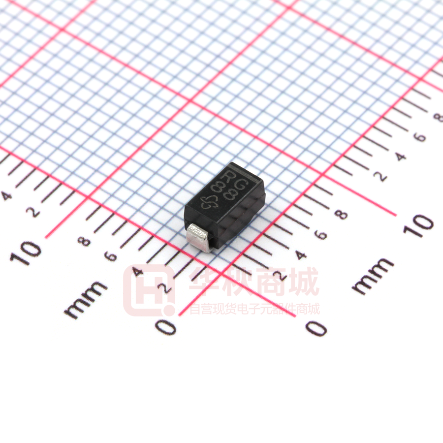

    开关二极管(小信号) VRRM=400V IF=1A Trr=150ns DO214BA
RGF1G-E3/67A 数据手册
RGF1A, RGF1B, RGF1D, RGF1G, RGF1J, RGF1K, RGF1M www.vishay.com Vishay General Semiconductor Surface-Mount Glass Passivated Junction Fast Switching Rectifier FEATURES • Superectifier structure for high reliability condition Superectifier® • Ideal for automated placement • Fast switching for high efficiency • Low leakage current • High forward surge capability • Meets MSL level 1, per J-STD-020, LF maximum peak of 250 °C GF1 (DO-214BA) • AEC-Q101 qualified available - Automotive ordering code: base P/NHE3 Cathode Anode • Material categorization: for definitions of compliance please see www.vishay.com/doc?99912 LINKS TO ADDITIONAL RESOURCES TYPICAL APPLICATIONS 3D 3D For use in fast switching rectification of power supply, inverters, converters, and freewheeling diodes for consumer, automotive, and telecommunication. 3D Models PRIMARY CHARACTERISTICS MECHANICAL DATA IF(AV) 1.0 A VRRM 50 V, 100 V, 200 V, 400 V, 600 V, 800 V, 1000 V IFSM 30 A VF 1.3 V trr 150 ns, 250 ns, 500 ns TJ max. 175 °C Package GF1 (DO-214BA) Circuit configuration Single Case: GF1 (DO-214BA), molded epoxy over glass body Molding compound meets UL 94 V-0 flammability rating Base P/N-E3 - RoHS-compliant, commercial grade Base P/NHE3_X - RoHS-compliant and AEC-Q101 qualified (“X” denotes revision code e.g. A, B, ...) Terminals: matte tin plated leads, solderable per J-STD-002 and JESD 22-B102 E3 and HE3 suffix meet JESD 201 class 2 whisker test Polarity: two bands indicate cathode end - 1st band denotes device type and 2nd band denotes repetitive peak reverse voltage rating MAXIMUM RATINGS (TA = 25 °C unless otherwise noted) PARAMETER SYMBOL Device marking code RGF1A RGF1B RGF1D RGF1G RGF1J RGF1K RGF1M UNIT RA RB RD RG RJ RK RM Maximum repetitive peak reverse voltage VRRM 50 100 200 400 600 800 1000 V Maximum RMS voltage VRMS 35 70 140 280 420 560 700 V Maximum DC blocking voltage VDC 50 100 200 400 600 800 1000 V Maximum average forward rectified current at TL = 120 °C IF(AV) 1.0 A Peak forward surge current 8.3 ms single half sine-wave superimposed on rated load IFSM 30 A Maximum full load reverse current, full cycle average TA = 55 °C IR(AV) 50 μA TJ, TSTG -65 to +175 °C Operating junction and storage temperature range Revision: 17-Aug-2021 Document Number: 88697 1 For technical questions within your region: DiodesAmericas@vishay.com, DiodesAsia@vishay.com, DiodesEurope@vishay.com THIS DOCUMENT IS SUBJECT TO CHANGE WITHOUT NOTICE. THE PRODUCTS DESCRIBED HEREIN AND THIS DOCUMENT ARE SUBJECT TO SPECIFIC DISCLAIMERS, SET FORTH AT www.vishay.com/doc?91000 RGF1A, RGF1B, RGF1D, RGF1G, RGF1J, RGF1K, RGF1M www.vishay.com Vishay General Semiconductor ELECTRICAL CHARACTERISTICS (TA = 25 °C unless otherwise noted) PARAMETER TEST CONDITIONS Maximum instantaneous forward voltage 1.0 A Maximum DC reverse current at rated DC blocking voltage SYMBOL RGF1A RGF1B RGF1D RGF1G VF RGF1J RGF1K RGF1M UNIT 1.3 TA = 25 °C V 5.0 IR μA TA = 125 °C 100 Typical reverse recovery time IF = 0.5 A, IR = 1.0 A, Irr = 0.25 A trr Typical junction capacitance 4.0 V, 1 MHz CJ 150 250 500 ns 8.5 pF THERMAL CHARACTERISTICS (TA = 25 °C unless otherwise noted) PARAMETER SYMBOL Typical thermal resistance RGF1A RGF1B RGF1D RGF1G RθJA (1) 80 RθJL (1) 28 RGF1J RGF1K RGF1M UNIT °C/W Note (1) Thermal resistance from junction to ambient and from junction to lead, PCB mounted on 0.2" x 0.2" (5.0 mm x 5.0 mm) copper pad areas ORDERING INFORMATION (Example) PREFERRED P/N UNIT WEIGHT (g) PREFERRED PACKAGE CODE BASE QUANTITY DELIVERY MODE RGF1J-E3/67A 0.104 67A 1500 7" diameter plastic tape and reel RGF1J-E3/5CA 0.104 5CA 6500 13" diameter plastic tape and reel RGF1JHE3_A/H (1)(2) 0.104 H 1500 7" diameter plastic tape and reel RGF1JHE3_A/I (1)(2) 0.104 I 6500 13" diameter plastic tape and reel RGF1KHE3_B/H (1)(3) 0.104 H 1500 7" diameter plastic tape and reel RGF1KHE3_B/I (1)(3) 0.104 I 6500 13" diameter plastic tape and reel Notes (1) AEC-Q101 qualified (2) _A is applied for A to J class (3) _B is applied for K and M class RATINGS AND CHARACTERISTICS CURVES (TA = 25 °C unless otherwise noted) 30 P.C.B. Mounted on 0.2" x 0.2" (5.0 mm x 5.0 mm) Copper Pad Areas 1.00 0.75 0.50 0.25 0 100 60 Hz Resistive or Inductive Load Peak Forward Surge Current (A) Average Forward Rectified Current (A) 1.25 TJ = TJ Max. 8.3 ms Single Half Sine-Wave 25 20 15 10 5 0 120 140 160 180 1 10 100 Lead Temperature (°C) Number of Cycles at 60 Hz Fig. 1 - Forward Current Derating Curve Fig. 2 - Maximum Non-Repetitive Peak Forward Surge Current Revision: 17-Aug-2021 Document Number: 88697 2 For technical questions within your region: DiodesAmericas@vishay.com, DiodesAsia@vishay.com, DiodesEurope@vishay.com THIS DOCUMENT IS SUBJECT TO CHANGE WITHOUT NOTICE. THE PRODUCTS DESCRIBED HEREIN AND THIS DOCUMENT ARE SUBJECT TO SPECIFIC DISCLAIMERS, SET FORTH AT www.vishay.com/doc?91000 RGF1A, RGF1B, RGF1D, RGF1G, RGF1J, RGF1K, RGF1M www.vishay.com Vishay General Semiconductor 100 Junction Capacitance (pF) Instantaneous Forward Current (A) 10 1 TJ = 25 °C Pulse Width = 300 µs 1 % Duty Cycle 0.1 0.01 0.4 10 1 0.6 0.8 1.0 1.2 1.4 1.6 10 1 100 Instantaneous Forward Voltage (V) Reverse Voltage (V) Fig. 3 - Typical Instantaneous Forward Characteristics Fig. 5 - Typical Junction Capacitance 100 Transient Thermal Impedance (°C/W) 10 Instantaneous Reverse Current (µA) TJ = 25 °C f = 1.0 MHz Vsig = 50 mVp-p TJ = 125 °C 1 TJ = 100 °C 0.1 TJ = 25 °C 20 40 60 80 1 Mounted on 0.2" x 0.2" (5.0 mm x 5.0 mm) Copper Pad Areas 0.1 0.01 0.01 0 10 100 0.1 1 10 100 Percent of Rated Peak Reverse Voltage (%) t - Pulse Duration (s) Fig. 4 - Typical Reverse Characteristics Fig. 6 - Typical Transient Thermal Impedance PACKAGE OUTLINE DIMENSIONS in inches (millimeters) GF1 (DO-214BA) Cathode Band Mounting Pad Layout 0.066 (1.68) 0.074 (1.88) MAX. 0.066 (1.68) MIN. 0.040 (1.02) 0.187 (4.75) 0.167 (4.24) 0.015 (0.38) 0.0065 (0.17) 0.060 (1.52) MIN. 0.118 (3.00) 0.108 (2.74) 0.100 (2.54) 0.098 (2.49) 0.060 (1.52) 0.030 (0.76) 0.006 (0.152) TYP. 0.208 (5.28) REF. 0.114 (2.90) 0.094 (2.39) 0.226 (5.74) 0.196 (4.98) Revision: 17-Aug-2021 Document Number: 88697 3 For technical questions within your region: DiodesAmericas@vishay.com, DiodesAsia@vishay.com, DiodesEurope@vishay.com THIS DOCUMENT IS SUBJECT TO CHANGE WITHOUT NOTICE. THE PRODUCTS DESCRIBED HEREIN AND THIS DOCUMENT ARE SUBJECT TO SPECIFIC DISCLAIMERS, SET FORTH AT www.vishay.com/doc?91000 Legal Disclaimer Notice www.vishay.com Vishay Disclaimer ALL PRODUCT, PRODUCT SPECIFICATIONS AND DATA ARE SUBJECT TO CHANGE WITHOUT NOTICE TO IMPROVE RELIABILITY, FUNCTION OR DESIGN OR OTHERWISE. Vishay Intertechnology, Inc., its affiliates, agents, and employees, and all persons acting on its or their behalf (collectively, “Vishay”), disclaim any and all liability for any errors, inaccuracies or incompleteness contained in any datasheet or in any other disclosure relating to any product. Vishay makes no warranty, representation or guarantee regarding the suitability of the products for any particular purpose or the continuing production of any product. To the maximum extent permitted by applicable law, Vishay disclaims (i) any and all liability arising out of the application or use of any product, (ii) any and all liability, including without limitation special, consequential or incidental damages, and (iii) any and all implied warranties, including warranties of fitness for particular purpose, non-infringement and merchantability. Statements regarding the suitability of products for certain types of applications are based on Vishay's knowledge of typical requirements that are often placed on Vishay products in generic applications. Such statements are not binding statements about the suitability of products for a particular application. It is the customer's responsibility to validate that a particular product with the properties described in the product specification is suitable for use in a particular application. Parameters provided in datasheets and / or specifications may vary in different applications and performance may vary over time. All operating parameters, including typical parameters, must be validated for each customer application by the customer's technical experts. Product specifications do not expand or otherwise modify Vishay's terms and conditions of purchase, including but not limited to the warranty expressed therein. Hyperlinks included in this datasheet may direct users to third-party websites. These links are provided as a convenience and for informational purposes only. Inclusion of these hyperlinks does not constitute an endorsement or an approval by Vishay of any of the products, services or opinions of the corporation, organization or individual associated with the third-party website. Vishay disclaims any and all liability and bears no responsibility for the accuracy, legality or content of the third-party website or for that of subsequent links. Except as expressly indicated in writing, Vishay products are not designed for use in medical, life-saving, or life-sustaining applications or for any other application in which the failure of the Vishay product could result in personal injury or death. Customers using or selling Vishay products not expressly indicated for use in such applications do so at their own risk. Please contact authorized Vishay personnel to obtain written terms and conditions regarding products designed for such applications. No license, express or implied, by estoppel or otherwise, to any intellectual property rights is granted by this document or by any conduct of Vishay. Product names and markings noted herein may be trademarks of their respective owners. © 2022 VISHAY INTERTECHNOLOGY, INC. ALL RIGHTS RESERVED Revision: 01-Jan-2022 1 Document Number: 91000
