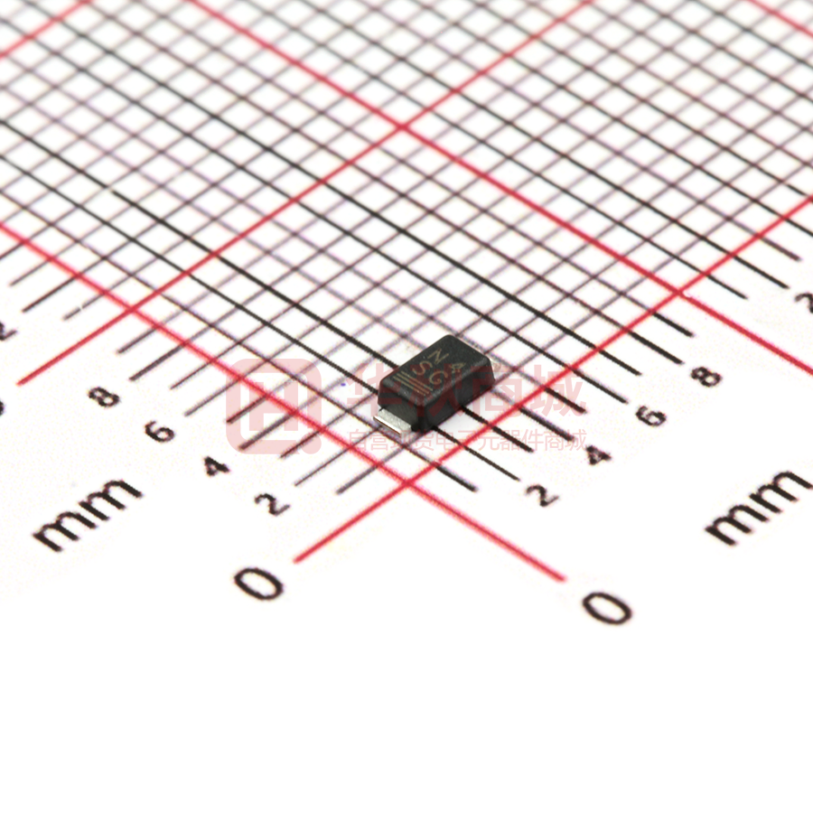

S07B, S07D, S07G, S07J, S07M www.vishay.com Vishay Semiconductors Standard Recovery Rectifier High Voltage Surface Mount FEATURES eSMP® Series • • • • • 2 1 • • • • 23020 23019 SMF (DO-219AB) • LINKS TO ADDITIONAL RESOURCES For surface mounted applications Low profile package Ideal for automated placement Glass passivated Meets MSL level 1, per J-STD-020, LF maximum peak of 260 °C Meets JESD 201 class 2 whisker test Wave and reflow solderable AEC-Q101 qualified Compatible to SOD-123W package case outline or SOD-123F and SOD-123FL Material categorization: for definitions of compliance please see www.vishay.com/doc?99912 MECHANICAL DATA 3D 3D Case: SMF (DO-219AB) Polarity: band denotes cathode end Weight: approx. 15 mg Packaging codes / options: GS18/10K per 13" reel (8 mm tape) GS08/3K per 7" reel (8 mm tape) Circuit configuration: single 3D Models PARTS TABLE PART ORDERING CODE MARKING REMARKS S07B S07D S07G S07J S07M S07B-GS18 or S07B-GS08 S07D-GS18 or S07D-GS08 S07G-GS18 or S07G-GS08 S07J-GS18 or S07J-GS08 S07M-GS18 or S07M-GS08 SB SD SG SJ SM Tape and reel Tape and reel Tape and reel Tape and reel Tape and reel ABSOLUTE MAXIMUM RATINGS (Tamb = 25 °C, unless otherwise specified) PARAMETER TEST CONDITION Maximum repetitive peak reverse voltage Maximum RMS voltage Maximum DC blocking voltage Maximum average forward rectified current Peak forward surge current 8.3 ms single half sine-wave TL = 110 °C (1) TA = 65 °C (1) TL = 25 °C PART SYMBOL VALUE UNIT S07B S07D S07G S07J S07M S07B S07D S07G S07J S07M S07B S07D S07G S07J S07M VRRM VRRM VRRM VRRM VRRM VRMS VRMS VRMS VRMS VRMS VDC VDC VDC VDC VDC IF(AV) IF(AV) IFSM 100 200 400 600 1000 70 140 280 420 700 100 200 400 600 1000 1.5 0.7 25 V V V V V V V V V V V V V V V A A A Note (1) Averaged over any 20 ms period Rev. 2.5, 27-Apr-2020 Document Number: 85733 1 For technical questions, contact: DiodesAmericas@vishay.com THIS DOCUMENT IS SUBJECT TO CHANGE WITHOUT NOTICE. THE PRODUCTS DESCRIBED HEREIN AND THIS DOCUMENT ARE SUBJECT TO SPECIFIC DISCLAIMERS, SET FORTH AT www.vishay.com/doc?91000 S07B, S07D, S07G, S07J, S07M www.vishay.com Vishay Semiconductors THERMAL CHARACTERISTICS (Tamb = 25 °C, unless otherwise specified) PARAMETER Thermal resistance junction to ambient air (1) Operating junction and storage temperature range TEST CONDITION SYMBOL RthJA Tj, Tstg VALUE 180 -65 to +175 UNIT K/W °C Note (1) Mounted on epoxy substrate with 3 mm x 3 mm Cu pads (≥ 40 μm thick) ELECTRICAL CHARACTERISTICS (Tamb = 25 °C, unless otherwise specified) PARAMETER Instantaneous forward voltage TEST CONDITION IF = 1 A (1) TA = 25 °C Maximum DC reverse current at rated DC blocking voltage TA = 125 °C Reverse recovery time Typical capacitance IF = 0.5 A, IR = 1 A, Irr = 0.25 A 4 V, 1 MHz PART SYMBOL MAX. UNIT S07B VF MIN. TYP. 1.1 V S07D VF 1.1 V S07G VF 1.1 V S07J VF 1.1 V S07M VF 1.1 V S07B IR 10 μA S07D IR 10 μA S07G IR 10 μA S07J IR 10 μA S07M IR 10 μA S07B IR 50 μA S07D IR 50 μA S07G IR 50 μA S07J IR 50 μA S07M IR 50 μA S07B trr 1800 ns S07D trr 1800 ns S07G trr 1800 ns S07J trr 1800 ns S07M trr 1800 S07B Cj 4 pF ns S07D Cj 4 pF S07G Cj 4 pF S07J Cj 4 pF S07M Cj 4 pF Note (1) Pulse test: 300 μs pulse width, 1 % duty cycle Rev. 2.5, 27-Apr-2020 Document Number: 85733 2 For technical questions, contact: DiodesAmericas@vishay.com THIS DOCUMENT IS SUBJECT TO CHANGE WITHOUT NOTICE. THE PRODUCTS DESCRIBED HEREIN AND THIS DOCUMENT ARE SUBJECT TO SPECIFIC DISCLAIMERS, SET FORTH AT www.vishay.com/doc?91000 S07B, S07D, S07G, S07J, S07M www.vishay.com Vishay Semiconductors TYPICAL CHARACTERISTICS (Tamb = 25 °C, unless otherwise specified) Average Forward Rectified Current - IFAV [A] 1.6 10 1.4 9 RthJA = 30K/W 8 1.2 7 C (pF) 1.0 0.8 0.6 RthJA = 150K/W 6 5 4 3 0.4 2 0.2 1 0.0 0 0 25 22773 50 75 100 125 150 Ambient Temperature -Tamb [°C] 0 175 17378 5 10 15 20 25 30 35 40 VR (V) Fig. 4 - Capacitance vs. Reverse Voltage Fig. 1 - Forward Current Derating Curve Instantaneous Forward Current (mA) 1000 TJ = 150 °C TJ = 25 °C TJ = 100 °C 100 600 700 800 900 1000 1100 Instantaneous Forward Voltage (mV) 17376 Fig. 2 - Typical Instantaneous Forward Characteristics Instantaneous Reverse Current (µA) 100 TJ = 150 °C 10 TJ = 125 °C TJ = 100 °C 1 TJ = 75 °C TJ = 50 °C 0.1 TJ = 25 °C 0.01 0 17377 100 200 300 400 500 600 700 800 900 Instantaneous Reverse Voltage (V) Fig. 3 - Typical Instantaneous Reverse Characteristics Rev. 2.5, 27-Apr-2020 Document Number: 85733 3 For technical questions, contact: DiodesAmericas@vishay.com THIS DOCUMENT IS SUBJECT TO CHANGE WITHOUT NOTICE. THE PRODUCTS DESCRIBED HEREIN AND THIS DOCUMENT ARE SUBJECT TO SPECIFIC DISCLAIMERS, SET FORTH AT www.vishay.com/doc?91000 S07B, S07D, S07G, S07J, S07M www.vishay.com Vishay Semiconductors PACKAGE DIMENSIONS in millimeters (inches): SMF (DO-219AB) 0.85 (0.033) 0 (0.000) 0.1 (0.004) 5 5 0.1(0.003) 1.7 (0.067) Detail Z enlarged 1.2 (0.047) 0.8 (0.031) 0.25 (0.010) 1.9 (0.075) 0.35 (0.014) 1.08 (0.043) 2.9 (0.114) 0.88 (0.035) 2.7 (0.106) 3.9 (0.154) 3.5 (0.138) Foot print recommendation: 1.3 (0.051) 1.4 (0.055) 1.3 (0.051) Created - Date: 15. February 2005 Rev. 3 - Date: 13. March 2007 Document no.: S8-V-3915.01-001 (4) 2.9 (0.114) 17247 ORIENTATION IN CARRIER TAPE - SMF Unreeling direction SMF cathode Top view Document no.: S8-V-3717.02-003 (4) Created - Date: 09. Feb. 2010 22670 Rev. 2.5, 27-Apr-2020 Document Number: 85733 4 For technical questions, contact: DiodesAmericas@vishay.com THIS DOCUMENT IS SUBJECT TO CHANGE WITHOUT NOTICE. THE PRODUCTS DESCRIBED HEREIN AND THIS DOCUMENT ARE SUBJECT TO SPECIFIC DISCLAIMERS, SET FORTH AT www.vishay.com/doc?91000 Legal Disclaimer Notice www.vishay.com Vishay Disclaimer ALL PRODUCT, PRODUCT SPECIFICATIONS AND DATA ARE SUBJECT TO CHANGE WITHOUT NOTICE TO IMPROVE RELIABILITY, FUNCTION OR DESIGN OR OTHERWISE. Vishay Intertechnology, Inc., its affiliates, agents, and employees, and all persons acting on its or their behalf (collectively, “Vishay”), disclaim any and all liability for any errors, inaccuracies or incompleteness contained in any datasheet or in any other disclosure relating to any product. Vishay makes no warranty, representation or guarantee regarding the suitability of the products for any particular purpose or the continuing production of any product. To the maximum extent permitted by applicable law, Vishay disclaims (i) any and all liability arising out of the application or use of any product, (ii) any and all liability, including without limitation special, consequential or incidental damages, and (iii) any and all implied warranties, including warranties of fitness for particular purpose, non-infringement and merchantability. Statements regarding the suitability of products for certain types of applications are based on Vishay’s knowledge of typical requirements that are often placed on Vishay products in generic applications. Such statements are not binding statements about the suitability of products for a particular application. It is the customer’s responsibility to validate that a particular product with the properties described in the product specification is suitable for use in a particular application. Parameters provided in datasheets and / or specifications may vary in different applications and performance may vary over time. All operating parameters, including typical parameters, must be validated for each customer application by the customer’s technical experts. Product specifications do not expand or otherwise modify Vishay’s terms and conditions of purchase, including but not limited to the warranty expressed therein. Except as expressly indicated in writing, Vishay products are not designed for use in medical, life-saving, or life-sustaining applications or for any other application in which the failure of the Vishay product could result in personal injury or death. Customers using or selling Vishay products not expressly indicated for use in such applications do so at their own risk. Please contact authorized Vishay personnel to obtain written terms and conditions regarding products designed for such applications. No license, express or implied, by estoppel or otherwise, to any intellectual property rights is granted by this document or by any conduct of Vishay. Product names and markings noted herein may be trademarks of their respective owners. © 2019 VISHAY INTERTECHNOLOGY, INC. ALL RIGHTS RESERVED Revision: 01-Jan-2019 1 Document Number: 91000
S07G-GS08
物料型号: - S07B, S07D, S07G, S07J, S07M
器件简介: - Vishay Semiconductors生产的eSMP®系列标准恢复整流器,适用于表面贴装应用,具有低剖面封装,适合自动化放置。
引脚分配: - 封装类型为SMF (DO-219AB),带有极性带表示阴极端。
参数特性: - 包括最大重复峰值反向电压(VRRM)、最大RMS电压(VRMS)、最大直流阻断电压(Vpc)、最大平均正向整流电流(IF(AV))、峰值正向浪涌电流(IFSM)等。
功能详解: - 提供了热特性、电气特性、典型特性的详细描述,包括热阻、工作结温范围、瞬时正向电压、最大直流反向电流、反向恢复时间、典型电容等。
应用信息: - 适用于需要标准恢复整流器的应用场景。
封装信息: - 提供了SMF (DO-219AB)封装的尺寸信息和在载带中的取向。
