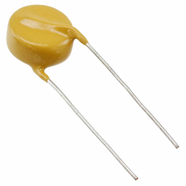

    TFUNK(威世)
    插件,P=5mm
    4700 pF ±20% 1000V(1kV) 陶瓷电容器 Z5U 径向,圆片式
S472M39Z5UN63L6R 数据手册
S Series www.vishay.com Vishay BCcomponents Ceramic Singlelayer DC Disc Capacitors for General Purpose Class 1, Class 2, and Class 3, 1 kVDC, 2 kVDC, 3 kVDC, 6 kVDC FEATURES • • • • High capacitance with small size High stability Crimp and straight lead styles Material categorization: for definitions of compliance please see www.vishay.com/doc?99912 APPLICATIONS • Temperature compensation • Coupling and decoupling • Bypassing QUICK REFERENCE DATA DESCRIPTION Ceramic Class Ceramic Dielectric Voltage (VDC) Min. Capacitance (pF) Max. Capacitance (pF) Mounting VALUE 1 SL0 1000, 2000, 3000, 6000 10 470 2 S3N 6000 47 150 X7R 1000, 2000, 3000 100 4700 Y5P 1000, 2000, 3000 100 10 000 Radial X5F 1000, 2000 100 4700 MARKING CAPACITANCE RANGE Marking indicates capacitance value and tolerance in accordance with “EIA 198” and voltage marks. 10 pF to 33 nF OPERATING TEMPERATURE RANGE SL0, S3N, X7R, X5F: -55 °C to +125 °C Y5P, Z5U, Y5V: -30 °C to +125 °C TEMPERATURE CHARACTERISTICS ± 5 %; ± 10 %; ± 20 %; + 80 % / - 20 % RATED VOLTAGE 1000 VDC, 2000 VDC, 3000 VDC, 6000 VDC TEST VOLTAGE SECTIONAL SPECIFICATIONS 10 GΩ min. Climatic category (according to EN 60058-1) Class 1 and 2: 55/125/21 Class 3: 30/85/21 DISSIPATION FACTOR EIA 198 IEC 60384-8 IEC 60384-9 3 Y5V 1000, 2000, 3000 1000 33 000 TOLERANCE ON CAPACITANCE Class 1: SL0, S3N Class 2: X7R, Y5P, X5F, Z5U Class 3: Y5V APPROVALS Z5U 1000, 2000, 3000, 6000 1000 22 000 200 % of rated voltage INSULATION RESISTANCE AT RATED VOLTAGE Class 1: 0.1 max. when C ≥ 30 pF (1 MHz, 1 V where C ≤ 1000 pF, and 1 kHz, 1 V where C > 1000 pF) For C < 30 pF: DF = 100/(400 + 20 °C) DF = dissipation factor in %; C = capacitance value in pF Class 2: 2.5 % max. (1 kHz, 1 V) Class 3: 5 % max. (1 kHz, 1 V) DESIGN The capacitors consist of a ceramic disc both sides of which are silver-plated. Connection leads are made of tinned copper wire, having diameters of 0.6 mm or 0.8 mm. The capacitors may be supplied with straight or kinked leads having a lead spacing of 5.0 mm, 7.5 mm and 10.0 mm. Coating is made of epoxy resin in accordance with UL 94 V-0. Revision: 26-Jul-2023 Document Number: 28515 1 For technical questions, contact: cdc@vishay.com THIS DOCUMENT IS SUBJECT TO CHANGE WITHOUT NOTICE. THE PRODUCTS DESCRIBED HEREIN AND THIS DOCUMENT ARE SUBJECT TO SPECIFIC DISCLAIMERS, SET FORTH AT www.vishay.com/doc?91000 S Series www.vishay.com Vishay BCcomponents LEAD CONFIGURATION (in millimeters) D D D DR SH D SH T SH L G L G G L V * K  G L F F F F J L K K Notes • Lead-spacing 2.5 mm is available for L lead configuration only • DR = 3.0 mm max., SH = 4.8 mm max. • V: 1 kV = 1.2 mm ± 0.5 mm; 2 kV = 2.6 mm ± 0.8 mm; 3 kV = 3.5 mm ± 1.0 mm; 6 kV = 6.2 mm ± 1.2 mm MARKING Size 25 Size 29 and above BC TTT XXXt VVVV TTT XXX VVVV Note • Refer to specified part for detail marking ORDERING CODE INFORMATION S 102 K 29 Y5P N 6 3 J 5 R 1 234 5 67 8 9 10 11 12 13 14 15 16 Capacitance Tolerance Size Code T.C. Code Rated Voltage Lead Diameter Packaging / Lead Length Lead Style Lead Spacing RoHSCompliant Product Capacitance Type (pF) S series Please N = 1000 VDC Please J=±5% The first two refer to P = 2000 VDC K = ± 10 % refer to digits are the M = ± 20 % relevant relevant R = 3000 VDC significant Z = + 80 % / datasheet datasheet U = 6000 VDC figures of - 20 % capacitance and the last digit is a multiplier as follows: 0=*1 1 = * 10 2 = * 100 3 = * 1000 Revision: 26-Jul-2023 6 = 0.60 mm 3 = bulk with Please 5 = 5.0 mm R = RoHSrefer to 6 = 6.4 mm compliant 30.0 mm ± ± 0.05 mm and relevant 7 = 7.5 mm 5.0 mm 8 = 0.80 mm ± 0.05 mm B = bulk with datasheet 0 = 10.0 mm halogen-free 3.5 mm ± 0.5 mm T = tape and reel U = ammo Document Number: 28515 2 For technical questions, contact: cdc@vishay.com THIS DOCUMENT IS SUBJECT TO CHANGE WITHOUT NOTICE. THE PRODUCTS DESCRIBED HEREIN AND THIS DOCUMENT ARE SUBJECT TO SPECIFIC DISCLAIMERS, SET FORTH AT www.vishay.com/doc?91000 S Series www.vishay.com Vishay BCcomponents ORDERING CODES DIELECTRIC SL0 (1000 VDC / 2000 VDC) CAP. (pF) 1000 VDC 2000 VDC ORDERING CODE DIAMETER (mm max.) THICKNESS (mm max.) ORDERING CODE DIAMETER (mm max.) THICKNESS (mm max.) 10 S100#25SL0N6###R 6.5 4 S100#25SL0P6###R 6.5 4.5 12 S120#25SL0N6###R 6.5 4 S120#25SL0P6###R 6.5 4.5 15 S150#25SL0N6###R 6.5 4 S150#25SL0P6###R 6.5 4.5 18 S180#25SL0N6###R 6.5 4 S180#25SL0P6###R 6.5 4.5 22 S220#25SL0N6###R 6.5 4 S220#25SL0P6###R 6.5 4.5 27 S270#25SL0N6###R 6.5 4 S270#25SL0P6###R 6.5 4.5 33 S330#25SL0N6###R 6.5 4 S330#29SL0P6###R 7.5 4.5 39 S390#25SL0N6###R 6.5 4 S390#29SL0P6###R 7.5 4.5 47 S470#25SL0N6###R 6.5 4 S470#29SL0P6###R 7.5 4.5 56 S560#29SL0N6###R 7.5 4 S560#29SL0P6###R 7.5 4.5 68 S680#29SL0N6###R 7.5 4 S680#33SL0P6###R 8.5 4.5 82 S820#29SL0N6###R 7.5 4 S820#33SL0P6###R 8.5 4.5 100 S101#29SL0N6###R 7.5 4 S101#39SL0P6###R 10 4.5 120 S121#33SL0N6###R 8.5 4 S121#39SL0P6###R 10 4.5 150 S151#33SL0N6###R 8.5 4 S151#43SL0P6###R 11 4.5 180 S181#39SL0N6###R 10 4 / / / 220 S221#39SL0N6###R 10 4 / / / DIELECTRIC SL0 (3000 VDC / 6000 VDC) 6000 VDC (1) 3000 VDC CAP. (pF) ORDERING CODE DIAMETER (mm max.) THICKNESS (mm max.) ORDERING CODE DIAMETER (mm max.) THICKNESS (mm max.) 10 S100#33SL0R6###R 8.5 5.5 S100#39SL0U83L0R 10 8 12 S120#33SL0R6###R 8.5 5.5 S120#39SL0U83L0R 10 8 15 S150#33SL0R6###R 8.5 5.5 S150#43SL0U83L0R 11 8 18 S180#33SL0R6###R 8.5 5.5 S180#43SL0U83L0R 11 8 22 S220#33SL0R6###R 8.5 5.5 S220#43SL0U83L0R 11 8 27 S270#33SL0R6###R 8.5 5.5 S270#47SL0U83L0R 12 8 33 S330#33SL0R6###R 8.5 5.5 S330#53SL0U83L0R 13.5 8 39 S390#33SL0R6###R 8.5 5.5 / / / 47 S470#33SL0R6###R 8.5 5.5 / / / 56 S560#39SL0R6###R 10 5.5 / / / 68 S680#39SL0R6###R 10 5.5 / / / Notes • Lead diameter is 0.6 mm • # 5th digit is capacitance tolerance code: ± 5 % = J; ± 10 % = K • # 13th digit is packaging code: bulk = 3; reel = T; ammo = U • # 14th digit is lead style code: L; J; K (J is valid for 1 kV only) • # 15th digit is lead spacing code: 5.0 mm = 5; 6.4 mm = 6; 7.5 mm = 7; 10.0 mm = 0 (1) For 6000 V part, only straight lead configuration (0.8 mm lead diameter) and bulk packaging are available Revision: 26-Jul-2023 Document Number: 28515 3 For technical questions, contact: cdc@vishay.com THIS DOCUMENT IS SUBJECT TO CHANGE WITHOUT NOTICE. THE PRODUCTS DESCRIBED HEREIN AND THIS DOCUMENT ARE SUBJECT TO SPECIFIC DISCLAIMERS, SET FORTH AT www.vishay.com/doc?91000 S Series www.vishay.com Vishay BCcomponents DIELECTRIC Z5U (1000 VDC / 2000 VDC) 1000 VDC 2000 VDC CAP. (pF) ORDERING CODE DIAMETER (mm max.) THICKNESS (mm max.) ORDERING CODE DIAMETER (mm max.) THICKNESS (mm max.) 1000 S102#25Z5UN6###R 6.5 4 S102#29Z5UP6###R 7.5 4.5 1500 S152#29Z5UN6###R 7.5 4 S152#29Z5UP6###R 7.5 4.5 2200 S222#29Z5UN6###R 7.5 4 S222#33Z5UP6###R 8.5 4.5 3300 S332#33Z5UN6###R 8.5 4 S332#43Z5UP6###R 11.0 4.5 4700 S472#39Z5UN6###R 10 4 S472#47Z5UP6###R 12.0 4.5 6800 S682#43Z5UN6###R 11 4 S682#53Z5UP63K7R 13.5 4.5 10 000 S103#47Z5UN6###R 12 4 S103#69Z5UP63K7R 17.5 4.5 15 000 S153#59Z5UN63J7R 15 4 / / / 22 000 S223#75Z5UN83J0R 19 4 / / / DIELECTRIC Z5U (3000 VDC / 6000 VDC) 3000 VDC 6000 VDC CAP. (pF) ORDERING CODE DIAMETER (mm max.) THICKNESS (mm max.) ORDERING CODE DIAMETER (mm max.) THICKNESS (mm max.) 220 / / / S221#39Z5UU83L0R 10 8 330 / / / S331#43Z5UU83L0R 11 8 470 S471#33Z5UR6###R 8.5 5.5 S471#47Z5UU83L0R 12 8 1000 S102#33Z5UR6###R 8.5 5.5 S102#59Z5UU83L0R 15 8 1500 S152#39Z5UR6###R 10.0 5.5 S152#69Z5UU83L0R 17.5 8 2200 S222#43Z5UR6###R 11.0 5.5 S222M75Z5UU83L0R 19 8 3300 S332#53Z5UR63K7R 13.5 5.5 / / / 4700 S472#69Z5UR63K7R 17.5 5.5 / / / Notes • Lead diameter is 0.6 mm • # 5th digit is capacitance tolerance code: ± 20 % = M; + 80 % / - 20 % = Z • # 13th digit is packaging code: bulk = 3; reel = T; ammo = U • # 14th digit is lead style code: L; J; K (J is valid for 1 kV only) • # 15th digit is lead spacing code: 5.0 mm = 5; 6.4 mm = 6; 7.5 mm = 7; 10.0 mm = 0 Revision: 26-Jul-2023 Document Number: 28515 4 For technical questions, contact: cdc@vishay.com THIS DOCUMENT IS SUBJECT TO CHANGE WITHOUT NOTICE. THE PRODUCTS DESCRIBED HEREIN AND THIS DOCUMENT ARE SUBJECT TO SPECIFIC DISCLAIMERS, SET FORTH AT www.vishay.com/doc?91000 S Series www.vishay.com Vishay BCcomponents DIELECTRIC Y5P (1000 VDC / 2000 VDC) CAP. (pF) 1000 VDC 2000 VDC ORDERING CODE DIAMETER (mm max.) THICKNESS (mm max.) ORDERING CODE DIAMETER (mm max.) THICKNESS (mm max.) 100 S101#25Y5PN6###R 6.5 4.0 S101#25Y5PP6###R 6.5 4.5 120 S121#25Y5PN6###R 6.5 4.0 S121#25Y5PP6###R 6.5 4.5 150 S151#25Y5PN6###R 6.5 4.0 S151#25Y5PP6###R 6.5 4.5 180 S181#25Y5PN6###R 6.5 4.0 S181#25Y5PP6###R 6.5 4.5 220 S221#25Y5PN6###R 6.5 4.0 S221#25Y5PP6###R 6.5 4.5 270 S271#25Y5PN6###R 6.5 4.0 S271#25Y5PP6###R 6.5 4.5 330 S331#25Y5PN6###R 6.5 4.0 S331#25Y5PP6###R 6.5 4.5 470 S471#25Y5PN6###R 6.5 4.0 S471#29Y5PP6###R 7.5 4.5 560 S561#29Y5PN6###R 7.5 4.0 S561#29Y5PP6###R 7.5 4.5 680 S681#29Y5PN6###R 7.5 4.0 S681#29Y5PP6###R 7.5 4.5 820 S821#29Y5PN7###R 7.5 4.0 S821#33Y5PP6###R 8.5 4.5 1000 S102#29Y5PN6###R 7.5 4.0 S102#33Y5PP6###R 8.5 4.5 1500 S152#33Y5PN6###R 8.5 4.0 S152#39Y5PP6###R 10.0 4.5 1800 S182#33Y5PN6###R 8.5 4.0 S182#43Y5PP6###R 11.0 4.5 2200 S222#39Y5PN6###R 10.0 4.0 S222#43Y5PP6###R 11.0 4.5 3300 S332#43Y5PN6###R 11.0 4.0 S332#53Y5PP6###R 13.5 4.5 4700 S472#53Y5PN6###R 13.5 4.0 S472#69Y5PP63K7R 17.5 4.5 6800 S682#59Y5PN63J7R 15.0 4.0 / / / 10 000 S103#75Y5PN83J0R 19.0 4.0 / / / DIELECTRIC Y5P (3000 VDC) CAP. (pF) 3000 VDC ORDERING CODE DIAMETER (mm max.) THICKNESS (mm max.) 100 S101#33Y5PR6###R 8.5 5.5 120 S121#33Y5PR6###R 8.5 5.5 150 S151#33Y5PR6###R 8.5 5.5 180 S181#33Y5PR6###R 8.5 5.5 220 S221#33Y5PR6###R 8.5 5.5 270 S271#33Y5PR6###R 8.5 5.5 330 S331#33Y5PR6###R 8.5 5.5 470 S471#33Y5PR6###R 8.5 5.5 560 S561#39Y5PR6###R 10.0 5.5 680 S681#39Y5PR6###R 10.0 5.5 820 S821#39Y5PR6###R 10.0 5.5 1000 S102#43Y5PR6###R 11.0 5.5 1500 S152#47Y5PR6###R 12.0 5.5 1800 S182#47Y5PR6###R 12.0 5.5 2200 S222#59Y5PR63K7R 15.0 5.5 3300 S332#75Y5PR83K0R 19.0 5.5 Notes • Lead diameter is 0.6 mm • # 5th digit is capacitance tolerance code: ± 5 % = J; ± 10 % = K • # 13th digit is packaging code: bulk = 3; reel = T; ammo = U • # 14th digit is lead style code: L; J; K (J is valid for 1 kV only) • # 15th digit is lead spacing code: 5.0 mm = 5; 6.4 mm = 6; 7.5 mm = 7; 10.0 mm = 0 Revision: 26-Jul-2023 Document Number: 28515 5 For technical questions, contact: cdc@vishay.com THIS DOCUMENT IS SUBJECT TO CHANGE WITHOUT NOTICE. THE PRODUCTS DESCRIBED HEREIN AND THIS DOCUMENT ARE SUBJECT TO SPECIFIC DISCLAIMERS, SET FORTH AT www.vishay.com/doc?91000 S Series www.vishay.com Vishay BCcomponents DIELECTRIC X7R (1000 VDC / 2000 VDC) 2000 VDC 1000 VDC CAP. (pF) ORDERING CODE DIAMETER (mm max.) THICKNESS (mm max.) ORDERING CODE DIAMETER (mm max.) THICKNESS (mm max.) 100 S101#25X7RN6###R 6.5 4.0 S101#25X7RP6###R 6.5 4.5 120 S121#25X7RN6###R 6.5 4.0 S121#25X7RP6###R 6.5 4.5 150 S151#25X7RN6###R 6.5 4.0 S151#25X7RP6###R 6.5 4.5 180 S181#25X7RN6###R 6.5 4.0 S181#25X7RP6###R 6.5 4.5 220 S221#25X7RN6###R 6.5 4.0 S221#25X7RP6###R 6.5 4.5 270 S271#25X7RN6###R 6.5 4.0 S271#25X7RP6###R 6.5 4.5 330 S331#25X7RN6###R 6.5 4.0 S331#25X7RP6###R 6.5 4.5 470 S471#29X7RN6###R 7.5 4.0 S471#29X7RP6###R 7.5 4.5 560 S561#29X7RN6###R 7.5 4.0 S561#33X7RP6###R 8.5 4.5 680 S681#29X7RN6###R 7.5 4.0 S681#33X7RP6###R 8.5 4.5 820 S821#29X7RN7###R 7.5 4.0 S821#39X7RP6###R 10.0 4.5 1000 S102#33X7RN6###R 8.5 4.0 S102#39X7RP6###R 10.0 4.5 1500 S152#39X7RN6###R 10.0 4.0 S152#43X7RP6###R 11.0 4.5 1800 S182#43X7RN6###R 11.0 4.0 S182#47X7RP6###R 12.0 4.5 2200 S222#43X7RN6###R 11.0 4.0 S222#53X7RP6###R 13.0 4.5 3300 S332#47X7RN6###R 12.0 4.0 S332#59X7RP63K7R 15.0 4.5 4700 S472#59X7RN63J7R 15.0 4.0 / / / DIELECTRIC X7R (3000 VDC) CAP. (pF) 3000 VDC ORDERING CODE DIAMETER (mm max.) THICKNESS (mm max.) 100 S101#33X7RR6###R 8.5 5.5 120 S121#33X7RR6###R 8.5 5.5 150 S151#33X7RR6###R 8.5 5.5 180 S181#33X7RR6###R 8.5 5.5 220 S221#33X7RR6###R 8.5 5.5 270 S271#33X7RR6###R 8.5 5.5 330 S331#33X7RR6###R 8.5 5.5 470 S471#33X7RR6###R 8.5 5.5 560 S561#39X7RR6###R 10.0 5.5 680 S681#39X7RR6###R 10.0 5.5 820 S821#43X7RR6###R 11.0 5.5 1000 S102#43X7RR6###R 11.0 5.5 1500 S152#53X7RR6###R 13.0 5.5 1800 S182#59X7RR63K7R 15.0 5.5 2200 S222#69X7RR63K7R 17.5 5.5 Notes • Lead diameter is 0.6 mm • # 5th digit is capacitance tolerance code: ± 5 % = J; ± 10 % = K • # 13th digit is packaging code: bulk = 3; reel = T; ammo = U • # 14th digit is lead style code: L; J; K (J is valid for 1 kV only) • # 15th digit is lead spacing code: 5.0 mm = 5; 6.4 mm = 6; 7.5 mm = 7; 10.0 mm = 0 Revision: 26-Jul-2023 Document Number: 28515 6 For technical questions, contact: cdc@vishay.com THIS DOCUMENT IS SUBJECT TO CHANGE WITHOUT NOTICE. THE PRODUCTS DESCRIBED HEREIN AND THIS DOCUMENT ARE SUBJECT TO SPECIFIC DISCLAIMERS, SET FORTH AT www.vishay.com/doc?91000 S Series www.vishay.com Vishay BCcomponents DIELECTRIC Y5V (1000 VDC / 2000 VDC) 1000 VDC 2000 VDC CAP. (pF) ORDERING CODE DIAMETER (mm max.) THICKNESS (mm max.) ORDERING CODE DIAMETER (mm max.) THICKNESS (mm max.) 1000 S102Z25Y5VN6###R 6.5 4.0 S102Z29Y5VP6###R 7.5 4.5 1500 S152Z25Y5VN6###R 6.5 4.0 S152Z29Y5VP6###R 7.5 4.5 2200 S222Z29Y5VN6###R 7.5 4.0 S222Z33Y5VP6###R 8.5 4.5 3300 S332Z29Y5VN6###R 7.5 4.0 S332Z39Y5VP6###R 10.0 4.5 4700 S472Z33Y5VN6###R 8.5 4.0 S472Z43Y5VP6###R 11.0 4.5 6800 S682Z39Y5VN6###R 10.0 4.0 S682Z47Y5VP6###R 12.0 4.5 10 000 S103Z43Y5VN6###R 11.0 4.0 S103Z59Y5VP6###R 15.0 4.5 15 000 S153Z53Y5VN63J7R 13.5 4.0 / / / 22 000 S223Z59Y5VN63J7R 15.0 4.0 / / / 33 000 S333Z75Y5VN83J0R 19.0 4.0 / / / DIELECTRIC Y5V (3000 VDC) 3000 VDC CAP. (pF) ORDERING CODE DIAMETER (mm max.) THICKNESS (mm max.) 1000 S102Z33Y5VR6###R 8.5 5.5 1500 S152Z33Y5VR6###R 8.5 5.5 2200 S222Z39Y5VR6###R 10.0 5.5 3300 S332Z43Y5VR6###R 11.0 5.5 4700 S472Z47Y5VR6###R 12.0 5.5 6800 S682Z59Y5VR6###R 15.0 5.5 Notes • Lead diameter is 0.6 mm • # 5th digit is capacitance tolerance code: ± 5 % = J; ± 10 % = K • # 13th digit is packaging code: bulk = 3; reel = T; ammo = U • # 14th digit is lead style code: L; J; K (J is valid for 1 kV only) • # 15th digit is lead spacing code: 5.0 mm = 5; 6.4 mm = 6; 7.5 mm = 7; 10.0 mm = 0 Revision: 26-Jul-2023 Document Number: 28515 7 For technical questions, contact: cdc@vishay.com THIS DOCUMENT IS SUBJECT TO CHANGE WITHOUT NOTICE. THE PRODUCTS DESCRIBED HEREIN AND THIS DOCUMENT ARE SUBJECT TO SPECIFIC DISCLAIMERS, SET FORTH AT www.vishay.com/doc?91000 S Series www.vishay.com Vishay BCcomponents DIELECTRIC X5F (1000 VDC / 2000 VDC) CAP. (pF) ORDERING CODE 100 120 150 180 220 270 330 390 470 560 680 820 1000 1500 1800 2200 3300 4700 S101#25X5FN6###R S121#25X5FN6###R S151#25X5FN6###R S181#25X5FN6###R S221#25X5FN6###R S271#25X5FN6###R S331#25X5FN6###R S391#25X5FN6###R S471#25X5FN6###R S561#29X5FN6###R S681#29X5FN6###R S821#29X5FN7###R S102#29X5FN6###R S152#39X5FN6###R S182#43X5FN6###R S222#43X5FN6###R S332#53X5FN63J7R S472#63X5FN63J7R 1000 VDC DIAMETER (mm max.) 6.5 6.5 6.5 6.5 6.5 6.5 6.5 6.5 6.5 7.5 7.5 7.5 7.5 10.0 11.0 11.0 12.0 15.0 THICKNESS (mm max.) 4.0 4.0 4.0 4.0 4.0 4.0 4.0 4.0 4.0 4.0 4.0 4.0 4.0 4.0 4.0 4.0 4.0 4.0 ORDERING CODE S101#25X5FP6###R S121#25X5FP6###R S151#25X5FP6###R S181#25X5FP6###R S221#25X5FP6###R S271#29X5FP6###R S331#29X5FP6###R S391#31X5FP6###R S471#31X5FP6###R S561#33X5FP6###R S681#39X5FP6###R S821#43X5FP6###R S102#43X5FP6###R S152#47X5FP6###R S182#53X5FP63K7R S222#59X5FP63K7R S332#65X5FP63K7R / 2000 VDC DIAMETER (mm max.) 6.5 6.5 6.5 6.5 6.5 7.5 7.5 8.0 8.0 8.5 10.0 11.0 11.0 12.0 13.5 15.0 16.5 / THICKNESS (mm max.) 4.5 4.5 4.5 4.5 4.5 4.5 4.5 4.5 4.5 4.5 4.5 4.5 4.5 4.5 4.5 4.5 4.5 / Notes • Lead diameter is 0.6 mm • # 5th digit is capacitance tolerance code: ± 5 % = J; ± 10 % = K • # 13th digit is packaging code: bulk = 3; reel = T; ammo = U • # 14th digit is lead style code: L; J; K (J is valid for 1 kV only) • # 15th digit is lead spacing code: 5.0 mm = 5; 6.4 mm = 6; 7.5 mm = 7; 10.0 mm = 0 DIELECTRIC S3N (6000 VDC) CAP. (pF) ORDERING CODE 47 68 100 150 S470M43S3NU83L0R S680M53S3NU83L0R S101M59S3NU83L0R S151M59S3NU83L0R 6000 VDC DIAMETER (mm max.) 11.0 13.5 15.0 15.0 THICKNESS (mm max.) 8.0 8.0 8.0 8.0 Notes • Lead diameter is 0.6 mm • # 5th digit is capacitance tolerance code: ± 5 % = J; ± 10 % = K • # 13th digit is packaging code: bulk = 3; reel = T; ammo = U • # 14th digit is lead style code: L; J; K (J is valid for 1 kV only) • # 15th digit is lead spacing code: 5.0 mm = 5; 6.4 mm = 6; 7.5 mm = 7; 10.0 mm = 0 TAPING AND PACKAGING LABELLING For example: Each reel is provided with a label showing the following details: manufacturer, D style, capacitance, tolerance, batch number, quantity of components, rated voltage, dielectric. On special request other designations can be shown. Revision: 26-Jul-2023 Document Number: 28515 8 For technical questions, contact: cdc@vishay.com THIS DOCUMENT IS SUBJECT TO CHANGE WITHOUT NOTICE. THE PRODUCTS DESCRIBED HEREIN AND THIS DOCUMENT ARE SUBJECT TO SPECIFIC DISCLAIMERS, SET FORTH AT www.vishay.com/doc?91000 S Series www.vishay.com Vishay BCcomponents PACKAGING QUANTITIES AND BOX DIMENSIONS PACKAGING SIZE CODE LEAD SPACING (mm) ≤ 6.4 ≤ 47 Tape on reel ≥ 7.5 all ≥ 59 ≤ 6.4 ≤ 47 Ammopack ≥ 7.5 > 6.4 all all all all all > 47 < 49 49 to 75 > 75 ≤ 49 > 49 Bulk (1) RATED VOLTAGE ≤ 2000 3000 all all < 2000 ≥ 2000 all all < 6000 < 6000 < 6000 6000 6000 SMALLEST PACKAGING QUANTITY (SPQ) 2000 1000 1000 500 2000 1500 1500 1000 1000 500 250 500 250 BOX DIMENSIONS L x W x H (mm) 370 x 370 x 60 335 x 240 x 50 335 x 290 x 50 245 x 120 x 65 Note (1) SPQ contains one or a multiple of poly-bags, 1000 units per bag CAPACITORS ON TAPE D P2 P ΔP Δh ΔP H1 W2 t1 H0 t detail A W1 W0 W A Direction of unreeling Ød PARAMETER Body diameter Lead diameter Pitch of component Pitch of sprocket hole Distance, hole center to lead Distance, hole to center of component Lead spacing Average deviation across tape Average deviation in direction of reeling Carrier tape width Hold-down tape width Position of sprocket hole Distance of hold-down tape Maximum component height Height to seating plane (for kinked leads) Height to seating plane (for straight leads) Length of cut leads Length of lead protrusion Diameter of sprocket hole Total tape thickness Maximum thickness of taping and wires Revision: 26-Jul-2023 P1 F P0 SYMBOL D d p P0 P1 P2 F Δh ΔP W W0 W1 W2 H1 H0 H0 L e D0 t t1 D0 e 11.0 max. 0.6 ± 0.05 12.7 ± 1.0 12.7 ± 0.3 5.1 ± 0.7 6.35 ± 1.3 2.5 + 0.60 / - 0.40 ± 1.0 max. ± 1.0 max. 18.0 + 1.0 / - 0.5 5.0 min. 9.0 + 0.75 / - 0.5 3.0 max. 32 max. 16.0 ± 0.5 20.0 ± 0.5 11.0 max. 1.0 max. 4.0 ± 0.2 0.9 max. 1.5 max. DIMENSIONS (mm) 11.0 max. 0.6 ± 0.05 12.7 ± 1.0 12.7 ± 0.3 3.85 ± 0.7 6.35 ± 1.3 5.0 + 0.60 / - 0.40 ± 1.0 max. ± 1.0 max. 18.0 + 1.0 / - 0.5 5.0 min. 9.0 + 0.75 / - 0.5 3.0 max. 32 max. 16.0 ± 0.5 20.0 ± 0.5 11.0 max. 1.0 max. 4.0 ± 0.2 0.9 max. 1.5 max. 14.0 max. 0.6 ± 0.05 15.0 ± 1.0 15.0 ± 0.3 3.75 ± 0.7 7.5 ± 1.5 7.5 + 0.6 / - 0.4 ± 1.0 max. ± 1.0 max. 18.0 + 1.0 / - 0.5 5.0 min. 9.0 + 0.75 / - 0.5 3.0 max. 40 max. 16.0 ± 0.5 20.0 ± 0.5 11.0 max. 1.0 max. 4.0 ± 0.2 0.9 max. 1.5 max. Document Number: 28515 9 For technical questions, contact: cdc@vishay.com THIS DOCUMENT IS SUBJECT TO CHANGE WITHOUT NOTICE. THE PRODUCTS DESCRIBED HEREIN AND THIS DOCUMENT ARE SUBJECT TO SPECIFIC DISCLAIMERS, SET FORTH AT www.vishay.com/doc?91000 S Series www.vishay.com Vishay BCcomponents P D P2 ΔP ΔP Δh T Δh H1 F Ød W2 L H0 W1 W0 W A e P0 P1 F D0 t1 t detail A DIMENSIONS OF TAPE SYMBOL PARAMETER DIMENSIONS (mm) D (1) Body diameter 19.0 max. d Lead diameter 0.6 ± 0.05 P Pitch of component 25.4 ± 1 P0 (2) Pitch of sprocket hole 12.7 ± 0.3 P1 (3) Distance, hole center to lead 7.7 or 6.4 ± 1.0 P2 (3) Distance, hole to center of component 12.7 ± 1.5 F Lead spacing 10.0 or 12.5 + 0.6 / - 0.4 Δh Average deviation across tape ± 1.0 max. ΔP Average deviation in direction of reeling ± 1.0 max. W Carrier tape width 18.0 + 1 / - 0.5 W0 Hold-down tape width 5.0 min. W1 Position of sprocket hole 9.0 + 0.75 / - 0.5 W2 Distance of hold-down tape 3.0 max. H1 Maximum component height 40.0 H0 Height to seating plane (for kinked leads) 16.0 ± 0.5 H0 Height to seating plane (for straight leads) 20.0 ± 0.5 L Length of cut leads 11.0 max. l Length of lead protrusion 1.0 max. D0 Diameter of sprocket hole 4.0 ± 0.2 t Total tape thickness 0.9 max. Notes (1) See Ordering Information table (2) Cumulative pitch error: ± 1 mm / 20 pitches (3) Obliquity maximum 3° Revision: 26-Jul-2023 Document Number: 28515 10 For technical questions, contact: cdc@vishay.com THIS DOCUMENT IS SUBJECT TO CHANGE WITHOUT NOTICE. THE PRODUCTS DESCRIBED HEREIN AND THIS DOCUMENT ARE SUBJECT TO SPECIFIC DISCLAIMERS, SET FORTH AT www.vishay.com/doc?91000 Legal Disclaimer Notice www.vishay.com Vishay Disclaimer ALL PRODUCT, PRODUCT SPECIFICATIONS AND DATA ARE SUBJECT TO CHANGE WITHOUT NOTICE TO IMPROVE RELIABILITY, FUNCTION OR DESIGN OR OTHERWISE. Vishay Intertechnology, Inc., its affiliates, agents, and employees, and all persons acting on its or their behalf (collectively, “Vishay”), disclaim any and all liability for any errors, inaccuracies or incompleteness contained in any datasheet or in any other disclosure relating to any product. Vishay makes no warranty, representation or guarantee regarding the suitability of the products for any particular purpose or the continuing production of any product. To the maximum extent permitted by applicable law, Vishay disclaims (i) any and all liability arising out of the application or use of any product, (ii) any and all liability, including without limitation special, consequential or incidental damages, and (iii) any and all implied warranties, including warranties of fitness for particular purpose, non-infringement and merchantability. Statements regarding the suitability of products for certain types of applications are based on Vishay's knowledge of typical requirements that are often placed on Vishay products in generic applications. Such statements are not binding statements about the suitability of products for a particular application. It is the customer's responsibility to validate that a particular product with the properties described in the product specification is suitable for use in a particular application. Parameters provided in datasheets and / or specifications may vary in different applications and performance may vary over time. All operating parameters, including typical parameters, must be validated for each customer application by the customer's technical experts. Product specifications do not expand or otherwise modify Vishay's terms and conditions of purchase, including but not limited to the warranty expressed therein. Hyperlinks included in this datasheet may direct users to third-party websites. These links are provided as a convenience and for informational purposes only. Inclusion of these hyperlinks does not constitute an endorsement or an approval by Vishay of any of the products, services or opinions of the corporation, organization or individual associated with the third-party website. Vishay disclaims any and all liability and bears no responsibility for the accuracy, legality or content of the third-party website or for that of subsequent links. Except as expressly indicated in writing, Vishay products are not designed for use in medical, life-saving, or life-sustaining applications or for any other application in which the failure of the Vishay product could result in personal injury or death. Customers using or selling Vishay products not expressly indicated for use in such applications do so at their own risk. Please contact authorized Vishay personnel to obtain written terms and conditions regarding products designed for such applications. No license, express or implied, by estoppel or otherwise, to any intellectual property rights is granted by this document or by any conduct of Vishay. Product names and markings noted herein may be trademarks of their respective owners. © 2023 VISHAY INTERTECHNOLOGY, INC. ALL RIGHTS RESERVED Revision: 01-Jan-2023 1 Document Number: 91000

物料型号:文档描述了Vishay BCcomponents的S系列陶瓷单层直流圆盘电容器,这些电容器适用于一般用途,并且有多种电压等级,包括1 kVDC、2 kVDC、3 kVDC和6 kVDC。
器件简介:这些电容器具有高电容但体积小、高稳定性、可焊接和直引线样式,并且材料分类符合www.vishay.com/doc?99912的定义。它们是符合RoHS标准的无卤素产品。
引脚分配:电容器可能配备直引线或弯曲引线,引线间距有5.0 mm、7.5 mm和10.0 mm的选项。电容器的连接引线由直径为0.6 mm或0.8 mm的镀锡铜线制成。
参数特性:电容器的电容范围从10 pF到33 nF,公差有± 5%、± 10%、± 20%和+ 80% / - 20%的选项。额定电压为1000 VDC、2000 VDC、3000 VDC和6000 VDC,测试电压为额定电压的200%。在额定电压下,绝缘电阻至少为10 GΩ。
功能详解:电容器的介电材料包括SLO、S3N、X7R、Y5P、X5F和Z5U,每种材料都有其特定的电压和电容范围。电容器的温度特性也被分为三个等级。
应用信息:这些电容器可用于温度补偿、耦合和去耦以及旁路应用。
封装信息:电容器由符合UL 94 V-0标准的环氧树脂涂层包裹。电容器的尺寸和引脚配置在文档中有详细的图表和说明。
