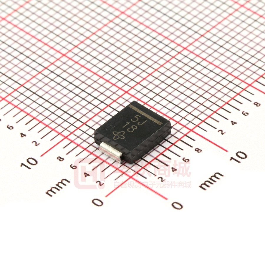

    直流反向耐压(Vr):600V 平均整流电流(Io):5A 正向压降(Vf):1.15V@5A 反向电流(Ir):10uA@600V
S5J-E3/57T 数据手册
S5A, S5B, S5D, S5G, S5J, S5K, S5M www.vishay.com Vishay General Semiconductor Surface-Mount Glass Passivated Rectifier FEATURES • Low profile package Available • Ideal for automated placement • Glass passivated pellet chip junction • Low forward voltage drop • Low leakage current • High forward surge capability • Meets MSL level 1, per LF maximum peak of 260 °C SMC (DO-214AB) Cathode Anode J-STD-020, • AEC-Q101 qualified available - Automotive ordering code: base P/NHE3 or P/NHM3 LINKS TO ADDITIONAL RESOURCES • Material categorization: for definitions of compliance please see www.vishay.com/doc?99912 3D 3D 3D Models TYPICAL APPLICATIONS For use in general purpose rectification of power supplies, inverters, converters and freewheeling diodes for consumer, automotive and telecommunication. PRIMARY CHARACTERISTICS IF(AV) 5.0 A VRRM 50 V, 100 V, 200 V, 400 V, 600 V, 800 V, 1000 V IFSM 100 A IR 10 μA VF 1.15 V TJ max. 150 °C Package SMC (DO-214AB) Circuit configuration Single MECHANICAL DATA Case: SMC (DO-214AB) Molding compound meets UL 94 V-0 flammability rating Base P/N-E3 - RoHS-compliant, commercial grade Base P/N-M3 - halogen-free, RoHS-compliant, commercial grade Base P/NHE3_X - RoHS-compliant and AEC-Q101 qualified (“_X” denotes revision code e.g. A, B,.....) Terminals: matte tin plated leads, solderable per J-STD-002 and JESD 22-B102 E3, M3, and HE3 suffix meets JESD 201 class 2 whisker test Polarity: color band denotes cathode end MAXIMUM RATINGS (TA = 25 °C unless otherwise noted) PARAMETER SYMBOL Device marking code S5A S5B S5D S5G S5J S5K S5M 5A 5B 5D 5G 5J 5K 5M UNIT Maximum repetitive peak reverse voltage VRRM 50 100 200 400 600 800 1000 V Maximum RMS voltage VRMS 35 70 140 280 420 560 700 V Maximum DC blocking voltage VDC 50 100 200 400 600 800 1000 Maximum average forward rectified current at TL = 75 °C IF(AV) 5.0 A Peak forward surge current 8.3 ms single half sine-wave superimposed on rated load IFSM 100 A TJ, TSTG -55 to +150 °C Operating junction and storage temperature range V Revision: 15-Apr-2020 Document Number: 88931 1 For technical questions within your region: DiodesAmericas@vishay.com, DiodesAsia@vishay.com, DiodesEurope@vishay.com THIS DOCUMENT IS SUBJECT TO CHANGE WITHOUT NOTICE. THE PRODUCTS DESCRIBED HEREIN AND THIS DOCUMENT ARE SUBJECT TO SPECIFIC DISCLAIMERS, SET FORTH AT www.vishay.com/doc?91000 S5A, S5B, S5D, S5G, S5J, S5K, S5M www.vishay.com Vishay General Semiconductor ELECTRICAL CHARACTERISTICS (TA = 25 °C unless otherwise noted) PARAMETER TEST CONDITIONS Maximum instantaneous forward voltage 5.0 A SYMBOL S5B S5D VF TA = 25 °C Maximum DC reverse current at rated DC blocking voltage S5A S5J S5K S5M 1.15 UNIT V 10 IR TA = 125 °C S5G μA 250 Typical reverse recovery time IF = 0.5 A, IR = 1.0 A, Irr = 0.25 A trr 2.5 μs Typical junction capacitance 4.0 V, 1 MHz CJ 40 pF THERMAL CHARACTERISTICS (TA = 25 °C unless otherwise noted) SYMBOL PARAMETER Typical thermal resistance (1) S5A S5B S5D S5G RθJL S5J S5K S5M 10 UNIT °C/W Note (1) Thermal resistance from junction to lead mounted on PCB with 0.3" x 0.3" (8.0 mm x 8.0 mm) copper pad area ORDERING INFORMATION (Example) UNIT WEIGHT (g) PREFERRED PACKAGE CODE BASE QUANTITY DELIVERY MODE S5J-E3/57T 0.211 57T 850 7" diameter plastic tape and reel S5J-E3/9AT 0.211 9AT 3500 13" diameter plastic tape and reel S5J-M3/57T 0.211 57T 850 7" diameter plastic tape and reel S5J-M3/9AT 0.211 9AT 3500 13" diameter plastic tape and reel S5JHE3_A/H (1) 0.211 H 850 7" diameter plastic tape and reel S5JHE3_A/I (1) 0.211 I 3500 13" diameter plastic tape and reel PREFERRED P/N Note AEC-Q101 qualified (1) Revision: 15-Apr-2020 Document Number: 88931 2 For technical questions within your region: DiodesAmericas@vishay.com, DiodesAsia@vishay.com, DiodesEurope@vishay.com THIS DOCUMENT IS SUBJECT TO CHANGE WITHOUT NOTICE. THE PRODUCTS DESCRIBED HEREIN AND THIS DOCUMENT ARE SUBJECT TO SPECIFIC DISCLAIMERS, SET FORTH AT www.vishay.com/doc?91000 S5A, S5B, S5D, S5G, S5J, S5K, S5M www.vishay.com Vishay General Semiconductor RATINGS AND CHARACTERISTICS CURVES (TA = 25 °C unless otherwise noted) Instantaneous Reverse Current (μA) Average Forward Current (A) 6 5 4 3 2 1 0 25 0 50 75 100 125 1000 TJ = 150 °C 100 1 TJ = 25 °C 0.1 0.01 TJ = -40 °C 0.001 0 150 Lead Temperature (°C) 20 40 60 80 100 Percent of Rated Peak Reverse Voltage (%) Fig. 4 - Typical Reverse Characteristics Fig. 1 - Forward Current Derating Curve 1000 100 TJ = 25 °C f = 1.0 MHz Vsig = 50 mVp-p TL = 75 °C 8.3 ms Single Half Sine-Wave Junction Capacitance (pF) Peak Forward Surge Current (A) TJ = 125 °C 10 100 10 10 10 1 100 0.1 1 10 Number of Cycles at 60 Hz Reverse Voltage (V) Fig. 2 - Maximum Non-Repetitive Peak Forward Surge Current Fig. 5 - Typical Junction Capacitance 100 Axis Title 10000 TJ = 150 °C 10 1000 TJ = 125 °C 1st line 2nd line 2nd line 2nd line Instantaneous Forward Current (A) 100 1 TJ = 25 °C 100 TJ = -40 °C 0.1 0.01 10 0.2 0.4 0.6 0.8 1.0 1.2 1.4 Instantaneous Forward Voltage (V) Fig. 3 - Typical Instantaneous Forward Characteristics Revision: 15-Apr-2020 Document Number: 88931 3 For technical questions within your region: DiodesAmericas@vishay.com, DiodesAsia@vishay.com, DiodesEurope@vishay.com THIS DOCUMENT IS SUBJECT TO CHANGE WITHOUT NOTICE. THE PRODUCTS DESCRIBED HEREIN AND THIS DOCUMENT ARE SUBJECT TO SPECIFIC DISCLAIMERS, SET FORTH AT www.vishay.com/doc?91000 S5A, S5B, S5D, S5G, S5J, S5K, S5M www.vishay.com Vishay General Semiconductor PACKAGE OUTLINE DIMENSIONS in inches (millimeters) SMC (DO-214AB) Cathode Band Mounting Pad Layout 0.185 (4.69) MAX. 0.245 (6.22) 0.220 (5.59) 0.126 (3.20) 0.114 (2.90) 0.126 (3.20) MIN. 0.280 (7.11) 0.260 (6.60) 0.060 (1.52) MIN. 0.012 (0.305) 0.006 (0.152) 0.320 (8.13) REF. 0.103 (2.62) 0.079 (2.01) 0.060 (1.52) 0.030 (0.76) 0.008 (0.2) 0 (0) 0.320 (8.13) 0.305 (7.75) Revision: 15-Apr-2020 Document Number: 88931 4 For technical questions within your region: DiodesAmericas@vishay.com, DiodesAsia@vishay.com, DiodesEurope@vishay.com THIS DOCUMENT IS SUBJECT TO CHANGE WITHOUT NOTICE. THE PRODUCTS DESCRIBED HEREIN AND THIS DOCUMENT ARE SUBJECT TO SPECIFIC DISCLAIMERS, SET FORTH AT www.vishay.com/doc?91000 Legal Disclaimer Notice www.vishay.com Vishay Disclaimer ALL PRODUCT, PRODUCT SPECIFICATIONS AND DATA ARE SUBJECT TO CHANGE WITHOUT NOTICE TO IMPROVE RELIABILITY, FUNCTION OR DESIGN OR OTHERWISE. Vishay Intertechnology, Inc., its affiliates, agents, and employees, and all persons acting on its or their behalf (collectively, “Vishay”), disclaim any and all liability for any errors, inaccuracies or incompleteness contained in any datasheet or in any other disclosure relating to any product. Vishay makes no warranty, representation or guarantee regarding the suitability of the products for any particular purpose or the continuing production of any product. To the maximum extent permitted by applicable law, Vishay disclaims (i) any and all liability arising out of the application or use of any product, (ii) any and all liability, including without limitation special, consequential or incidental damages, and (iii) any and all implied warranties, including warranties of fitness for particular purpose, non-infringement and merchantability. Statements regarding the suitability of products for certain types of applications are based on Vishay's knowledge of typical requirements that are often placed on Vishay products in generic applications. Such statements are not binding statements about the suitability of products for a particular application. It is the customer's responsibility to validate that a particular product with the properties described in the product specification is suitable for use in a particular application. Parameters provided in datasheets and / or specifications may vary in different applications and performance may vary over time. All operating parameters, including typical parameters, must be validated for each customer application by the customer's technical experts. Product specifications do not expand or otherwise modify Vishay's terms and conditions of purchase, including but not limited to the warranty expressed therein. Hyperlinks included in this datasheet may direct users to third-party websites. These links are provided as a convenience and for informational purposes only. Inclusion of these hyperlinks does not constitute an endorsement or an approval by Vishay of any of the products, services or opinions of the corporation, organization or individual associated with the third-party website. Vishay disclaims any and all liability and bears no responsibility for the accuracy, legality or content of the third-party website or for that of subsequent links. Except as expressly indicated in writing, Vishay products are not designed for use in medical, life-saving, or life-sustaining applications or for any other application in which the failure of the Vishay product could result in personal injury or death. Customers using or selling Vishay products not expressly indicated for use in such applications do so at their own risk. Please contact authorized Vishay personnel to obtain written terms and conditions regarding products designed for such applications. No license, express or implied, by estoppel or otherwise, to any intellectual property rights is granted by this document or by any conduct of Vishay. Product names and markings noted herein may be trademarks of their respective owners. © 2022 VISHAY INTERTECHNOLOGY, INC. ALL RIGHTS RESERVED Revision: 01-Jan-2022 1 Document Number: 91000
