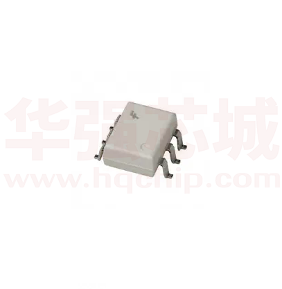

    单向光耦 Viso=5000Vrms VF(typ)=1.45V IF=60mA Vo=100V OC_7.3X6.5MM_SM
SFH601 数据手册
SFH601 www.vishay.com Vishay Semiconductors Optocoupler, Phototransistor Output, With Base Connection FEATURES • Isolation test voltage, 5000 VRMS • Low coupling capacitance • High common mode transient immunity • Storage temperature, -55 ° to +150 °C A 1 6 B C 2 5 C • Material categorization: for definitions of compliance please see www.vishay.com/doc?99912 NC 3 4 E APPLICATIONS • Telecom • Industrial controls • Battery powered equipment • Office machines • Programmable controllers 23030 AGENCY APPROVALS DESIGN SUPPORT TOOLS AVAILABLE 3D 3D • UL • cUL 3D Models Design Tools Related Documents • DIN EN 60747-5-5 (VDE 0884-5) available with option 1 • CQC DESCRIPTION       The SFH601 has a GaAs infrared emitting diode emitter, which is optically coupled to a silicon planar phototransistor detector, and is incorporated in a plastic DIP-6 package. It features a high current transfer ratio, low coupling capacitance, and high isolation voltage. The coupling device is designed for signal transmission between two electrically separated circuits. ORDERING INFORMATION S F H 6 0 1 - # PART NUMBER CTR BIN AGENCY CERTIFIED/PACKAGE UL, cUL, CQC DIP-6 0 # PACKAGE OPTION # # TAPE AND REEL CTR (%) 40 to 80 63 to 125 100 to 200 SFH601-1 SFH601-2 SFH601-3 - SFH601-3X007T SFH601-4X007T SMD-6, option 7 SMD-6, option 9 X 160 to 320 - - SFH601-3X009 - 40 to 80 63 to 125 100 to 200 160 to 320 DIP-6, 400 mil, option 6 - SFH601-2X016 SFH601-3X016 - SMD-6, option 7 - - SFH601-3X017T - VDE, UL, cUL, CQC Note • Additional options may be possible, please contact sales office   Rev. 1.7, 28-Feb-2019 Document Number: 83663 1 For technical questions, contact: optocoupleranswers@vishay.com THIS DOCUMENT IS SUBJECT TO CHANGE WITHOUT NOTICE. THE PRODUCTS DESCRIBED HEREIN AND THIS DOCUMENT ARE SUBJECT TO SPECIFIC DISCLAIMERS, SET FORTH AT www.vishay.com/doc?91000 SFH601 www.vishay.com Vishay Semiconductors ABSOLUTE MAXIMUM RATINGS (Tamb = 25 °C, unless otherwise specified) PARAMETER TEST CONDITION SYMBOL VALUE UNIT INPUT Reverse voltage VR 6 V Forward current IF 60 mA Pdiss 100 mW Collector emitter voltage VCEO 100 V Emitter base voltage VEBO 7 V Total power dissipation OUTPUT Collector current IC 50 mA Power dissipation Pdiss 150 mW Storage temperature range Tstg -55 to +150 °C Ambient temperature range Tamb -55 to +100 °C Tsld 260 °C COUPLER Soldering temperature t = 10 s Note • Stresses in excess of the absolute maximum ratings can cause permanent damage to the device. Functional operation of the device is not implied at these or any other conditions in excess of those given in the operational sections of this document. Exposure to absolute maximum ratings for extended periods of the time can adversely affect reliability Axis Title Axis Title 10000 10000 70 1000 100 IR diode 100 50 50 1000 1st line 2nd line 150 2nd line IF - Forward Current (mA) 60 Phototransistor 1st line 2nd line Pdiss - Power Dissipation (mW) 200 40 30 100 20 10 10 0 0 20 40 60 80 100 10 0 120 0 20 40 60 80 100 120 Tamb - Ambient Temperature (°C) Tamb - Ambient Temperature (°C) Fig. 1 - Power Dissipation vs. Ambient Temperature Fig. 2 - Maximum Forward Current vs. Ambient Temperature ELECTRICAL CHARACTERISTICS (Tamb = 25 °C, unless otherwise specified) PARAMETER TEST CONDITION SYMBOL MIN. TYP. MAX. UNIT INPUT Forward voltage IF = 60 mA VF - 1.45 1.65 V Breakdown voltage IR = 10 μA VBR 6 - - V Reverse current Capacitance VR = 6 V IR - 0.01 10 μA VF = 0 V, f = 1 kHz CI - - 100 pF VCE =10 V ICEO - 2 50 nA IF = 10 mA, IC = 2.5 mA VCEsat - 0.125 0.4 V VI-O = 0, f = 1 MHz CIO - 0.6 - pF OUTPUT Collector emitter leakage current COUPLER Collector emitter saturation voltage Coupling capacitance Note • Minimum and maximum values are testing requirements. Typical values are characteristics of the device and are the result of engineering evaluation. Typical values are for information only and are not part of the testing requirements Rev. 1.7, 28-Feb-2019 Document Number: 83663 2 For technical questions, contact: optocoupleranswers@vishay.com THIS DOCUMENT IS SUBJECT TO CHANGE WITHOUT NOTICE. THE PRODUCTS DESCRIBED HEREIN AND THIS DOCUMENT ARE SUBJECT TO SPECIFIC DISCLAIMERS, SET FORTH AT www.vishay.com/doc?91000 SFH601 www.vishay.com Vishay Semiconductors CURRENT TRANSFER RATIO PARAMETER TEST CONDITION IC/IF IF = 10 mA, VCE = 5 V PART SYMBOL MIN. TYP. MAX. UNIT SFH601-1 CTR 40 - 80 % SFH601-2 CTR 63 - 125 % SFH601-3 CTR 100 - 200 % SFH601-4 CTR 160 - 320 % SWITCHING CHARACTERISTICS PARAMETER TEST CONDITION SYMBOL MIN. TYP. MAX. UNIT Turn-on time VCC = 5 V, IC = 2 mA, RL = 100  ton - 3 - μs Turn-off time VCC = 5 V, IC = 2 mA, RL = 100  toff - 3 - μs VCC = 5 V Input Input pulse RL 5V 90 % VOUT Output pulse 10 % tr tf toff ton 23029 Fig. 3 - Test Circuit for Switching Characteristics 22986 Fig. 4 - Parameter and Limit Definition SAFETY AND INSULATION RATINGS PARAMETER TEST CONDITION Climatic classification According to IEC 68 part 1 Pollution degree According to DIN VDE 0109 Comparative tracking index Insulation group IIIa SYMBOL VALUE UNIT 55 / 115 / 21 2 CTI 175 Maximum rated withstanding isolation voltage According to UL1577, t = 1 min VISO 5000 Maximum transient isolation voltage According to DIN EN 60747-5-5 VIOTM 8000 Vpeak Maximum repetitive peak isolation voltage According to DIN EN 60747-5-5 VIORM 890 Vpeak Tamb = 25 °C, VIO = 500 V RIO 1012  Tamb = 100 °C, VIO = 500 V RIO 1011  PSO 700 mW Input safety current ISI 400 mA Input safety temperature TSI 175 °C 7 mm 7 mm 8 mm 8 mm  0.4 mm Isolation resistance Output safety power Creepage distance DIP-6, SMD-6 Clearance distance Creepage distance DIP-6, 400 mil Clearance distance Insulation thickness DTI VRMS Note • As per IEC 60747-5-5, § 7.4.3.8.2, this optocoupler is suitable for “safe electrical insulation” only within the safety ratings. Compliance with the safety ratings shall be ensured by means of protective circuits Rev. 1.7, 28-Feb-2019 Document Number: 83663 3 For technical questions, contact: optocoupleranswers@vishay.com THIS DOCUMENT IS SUBJECT TO CHANGE WITHOUT NOTICE. THE PRODUCTS DESCRIBED HEREIN AND THIS DOCUMENT ARE SUBJECT TO SPECIFIC DISCLAIMERS, SET FORTH AT www.vishay.com/doc?91000 SFH601 www.vishay.com Vishay Semiconductors TYPICAL CHARACTERISTICS (Tamb = 25 °C, unless otherwise specified) Axis Title Axis Title 10000 10 000 10000 IF = 0 mA Tamb = 25 °C Tamb = 100 °C 1 Tamb = 0 °C 100 Tamb = -55 °C 0.6 1.1 1000 10 VCE = 10 V VCE = 20 V 1 0.1 10 25 1.6 45 65 Tamb - Ambient Temperature (°C) Fig. 5 - Forward Current vs. Forward Voltage Fig. 8 - Leakage Current vs. Ambient Temperature Axis Title Axis Title 10000 10000 1.2 IF = 20 mA 1000 15 IF = 10 mA 10 100 IF = 5 mA 5 IF = 2 mA IF = 1 mA 10 0 0 1 2 3 4 1.0 1000 0.8 1st line 2nd line 20 2nd line NCTR - Normalized CTR (non-sat.) IF = 10 mA, VCE = 5 V 1st line 2nd line 2nd line IC - Collector Current (mA) 85 VF - Forward Voltage (V) 25 0.6 100 0.4 0.2 Normalized to IF = 10 mA, VCE = 5 V, Tamb = 25 °C 10 0 -55 5 -35 -15 5 25 45 65 85 VCE - Collector Emitter Voltage (V) Tamb - Ambient Temperature (°C) Fig. 6 - Collector Current vs. Collector Emitter Voltage (non-saturated) Fig. 9 - Normalized CTR vs. Ambient Temperature (non-saturated) Axis Title Axis Title 10000 1000 5 1st line 2nd line IF = 10 mA 100 IF = 5 mA IF = 1 mA IF = 10 mA, VCE = 0.4 V 0.8 1000 0.6 1st line 2nd line IF = 20 mA 10 10000 1.0 2nd line NCTR - Normalized CTR (sat.) 15 2nd line IC - Collector Current (mA) 100 VCE = 30 V 0.01 10 0.1 VCE = 40 V 100 1st line 2nd line 1000 2nd line ICEO - Leakage Current (nA) 10 1st line 2nd line 2nd line IF - Forward Current (mA) 1000 Tamb = 75 °C 0.4 100 0.2 IF = 2 mA Normalized to IF = 10 mA, VCE = 5 V, Tamb = 25 °C 10 0 0 0.1 0.2 0.3 0.4 0 10 -55 -35 -15 5 25 45 65 85 VCE - Collector Emitter Voltage (V) Tamb - Ambient Temperature (°C) Fig. 7 - Collector Current vs. Collector Emitter Voltage (saturated) Fig. 10 - Normalized CTR vs. Ambient Temperature (saturated) Rev. 1.7, 28-Feb-2019 Document Number: 83663 4 For technical questions, contact: optocoupleranswers@vishay.com THIS DOCUMENT IS SUBJECT TO CHANGE WITHOUT NOTICE. THE PRODUCTS DESCRIBED HEREIN AND THIS DOCUMENT ARE SUBJECT TO SPECIFIC DISCLAIMERS, SET FORTH AT www.vishay.com/doc?91000 SFH601 www.vishay.com Vishay Semiconductors Axis Title Axis Title 10000 1.2 10000 0 Tamb = 0 °C 1.0 0.6 1000 Tamb = 50 °C Tamb = 75 °C 100 0.4 Tamb = 100 °C 0.2 Normalized to CTR value: IF = 10 mA, VCE = 5 V, Tamb = 25 °C 0 0.1 1 1000 -4 RL = 150 Ω -6 100 RL = 200 Ω -8 VCE = 5 V 10 -10 0.01 10 0.1 1 10 10 1000 100 IF - Forward Current (mA) f - Frequency (kHz) Fig. 11 - Normalized CTR vs. Forward Current (non-saturated) Fig. 13 - Voltage Gain vs. Frequency Axis Title Axis Title 10000 1.0 1000 10000 100 1000 1000 Tamb = 50 °C Tamb = 75 °C 0.4 Tamb = 100 °C 0.2 Normalized to CTR value: IF = 10 mA, VCE = 5 V, Tamb = 25 °C 0 0.1 1 100 10 10 1st line 2nd line Tamb = 25 °C 0.6 2nd line tON, tOFF - Switching Time (μs) Tamb = 0 °C 0.8 1st line 2nd line 2nd line NCTR - Normalized CTR (sat.) 1st line 2nd line Tamb = 25 °C 0.8 2nd lin Voltage Gain (dB) -2 1st line 2nd line 2nd line NCTR - Normalized CTR (non-sat.) RL = 75 Ω tOFF 100 10 tON 10 1 0.1 1 10 IF - Forward Current (mA) RL - Load Resistance (kΩ) Fig. 12 - Normalized CTR vs. Forward Current (saturated) Fig. 14 - Switching Time vs. Load Resistance Rev. 1.7, 28-Feb-2019 Document Number: 83663 5 For technical questions, contact: optocoupleranswers@vishay.com THIS DOCUMENT IS SUBJECT TO CHANGE WITHOUT NOTICE. THE PRODUCTS DESCRIBED HEREIN AND THIS DOCUMENT ARE SUBJECT TO SPECIFIC DISCLAIMERS, SET FORTH AT www.vishay.com/doc?91000 SFH601 www.vishay.com Vishay Semiconductors PACKAGE DIMENSIONS in millimeters 6 Pin Package 6 5 4 6.5 ± 0.5 1 2 3 7.3 ± 0.5 7.62 ± 0.3 1.1 ± 0.1 3.5 ± 0.3 0.5 typ. 3.3 ± 0.5 2.8 ± 0.5 0.26 0.5 ± 0.1 2.54 ± 0.25 7.62 to 9.98 22530 Option 7 7.62 typ. 7.62 typ. 0.35 ± 0.25 Option 6 3.5 ± 0.3 0.1 min. 2.7 min. 10.16 typ. Option 9 7.62 typ. 3.5 ± 0.3 0.1 ± 0.1 0.6 1.25 0.6 min. 8 min. 3.5 ± 0.3 8.16 ± 0.8 10.16 ± 0.3 10.3 max. 0.76 R 0.25 2.54 0.76 2.54 R 0.25 1.78 8 min. 11.05 20802-52 1.52 1.78 8 min. 11.05 1.52 PACKAGE MARKING SFH601 Pin 1 I.D. V YWW 25 Fig. 15 - Example of SFH601 Notes • “YWW” is the date code marking (Y = year code, WW = week code) • VDE logo is only marked on VDE option parts • Tape and reel suffix (T) is not part of the package marking Rev. 1.7, 28-Feb-2019 Document Number: 83663 6 For technical questions, contact: optocoupleranswers@vishay.com THIS DOCUMENT IS SUBJECT TO CHANGE WITHOUT NOTICE. THE PRODUCTS DESCRIBED HEREIN AND THIS DOCUMENT ARE SUBJECT TO SPECIFIC DISCLAIMERS, SET FORTH AT www.vishay.com/doc?91000 SFH601 www.vishay.com Vishay Semiconductors PACKAGING INFORMATION (in millimeters) DEVICES PER TUBE TYPE UNITS/TUBE TUBES/BOX UNITS/BOX DIP-6 50 40 2000 DIP-6, option 6 50 40 2000 SMD-6, option 9 50 40 2000 0.6 ± 0.1 4.15 ANTISTATIC 4.20 ± 0.1 ANTISTATIC Marking surface + 0.15 - 0.05 7.0 ± 0.1 8.4 ± 0.1 5.00 ± 0.1 14.50 ± 0.2 5.15 ± 0.15 DIP-6 1.85 ± 0.1 5.35 ± 0.2 250.7 10.35 ± 0.2 518 ± 1 Spec for China only 23010 Fig. 16 - DIP-6 SMD-6 4 ± 0.1 7.5 ± 0.1 1.75 ± 0.1 12 ± 0.1 16 ± 0.3 2 ± 0.1 Ø 1.55 ± 0.05 0.3 ± 0.05 23031 Fig. 17 - SMD-6 Rev. 1.7, 28-Feb-2019 Document Number: 83663 7 For technical questions, contact: optocoupleranswers@vishay.com THIS DOCUMENT IS SUBJECT TO CHANGE WITHOUT NOTICE. THE PRODUCTS DESCRIBED HEREIN AND THIS DOCUMENT ARE SUBJECT TO SPECIFIC DISCLAIMERS, SET FORTH AT www.vishay.com/doc?91000 SFH601 www.vishay.com Vishay Semiconductors Reel + 0.2 -0 + 0.5 - 0.2 13 2.0 ±0 .5 100.0 ± 0.3 330.0 ± 2 21 ± 0.8 1.8 23012 16.4 +1 -0 Fig. 18 - Tape and Reel Shipping Medium SOLDER PROFILES IR Reflow Soldering (JEDEC® J-STD-020C compliant) Axis20 Title s One time soldering reflow is recommended within the condition of temperature and time profile shown below. Do not solder more than three times. Preheat - Temperature minimum (TS min.) 150 °C - Temperature maximum (TS max.) 200 °C - Time (min. to max.) (tS) 90 s ± 30 s Tp (260 °C) TL (217 °C) TS max. (200 °C) 1000 TS min. (150 °C) 100 Ramp-down 1000 1st line 2nd line CONDITIONS Ramp-up 2nd line Temperarure (°C) PROFILE ITEM 10000 10000 60 s tL (soldering) 100 Soldering zone - Temperature (TL) - Time (tL) Peak temperature (Tp) Ramp-up rate Ramp-down rate Rev. 1.7, 28-Feb-2019 217 °C 60 s 25 0 260 °C 3 °C/s max. 3 °C/s to 6 °C/s 23016 20 40 60 60 s to 120 s tS (preheat) Time (s) 80 35 s to 70 s 10 Time (s) Fig. 19 Document Number: 83663 8 For technical questions, contact: optocoupleranswers@vishay.com THIS DOCUMENT IS SUBJECT TO CHANGE WITHOUT NOTICE. THE PRODUCTS DESCRIBED HEREIN AND THIS DOCUMENT ARE SUBJECT TO SPECIFIC DISCLAIMERS, SET FORTH AT www.vishay.com/doc?91000 SFH601 www.vishay.com Vishay Semiconductors Wave Soldering (JEDEC JESD22-A111 compliant) Hand Soldering by Soldering Iron One time soldering is recommended within the condition of temperature. Allow single lead soldering in every single process. One time soldering is recommended. Temperature: 260 °C + 0 °C / - 5 °C Temperature: 380 °C + 0 °C / - 5 °C Time: 10 s Time: 3 s max. Preheat temperature: 25 °C to 140 °C Preheat time: 30 s to 80 s Axis Title 300 10000 260 °C + 0 °C / - 5 °C wave temperature First wave 200 Second wave 1000 +200 °C/s 150 1st line 2nd line 2nd line Temperature (°C) 250 -5 °C/s +2 °C/s 100 100 Preheat zone 50 10 0 0 0.5 1.0 1.5 2.0 2.5 3.0 3.5 4.0 Time (min) 23017 Fig. 20 Rev. 1.7, 28-Feb-2019 Document Number: 83663 9 For technical questions, contact: optocoupleranswers@vishay.com THIS DOCUMENT IS SUBJECT TO CHANGE WITHOUT NOTICE. THE PRODUCTS DESCRIBED HEREIN AND THIS DOCUMENT ARE SUBJECT TO SPECIFIC DISCLAIMERS, SET FORTH AT www.vishay.com/doc?91000 DIP-6A www.vishay.com Vishay Semiconductors DIP-6A PACKAGE DIMENSIONS in inches (millimeters) 3 2 1 4 5 6 Pin one ID 6.4 ± 0.1 ISO method A 8.6 ± 0.1 1 min. 7.62 typ. 1.2 ± 0.1 3.555 ± 0.255 18° 4° typ. 2.95 ± 0.5 0.8 min. 0.85 ± 0.05 0.5 ± 0.05 3° to 9° 0.25 typ. 7.62 to 8.81 i178004 2.54 typ. Note The information in this document provides generic information but for specific information on a product the appropriate product datasheet should be used. Rev. 1.2, 24-Aug-15 Document Number: 83263 1 For technical questions, contact: optocoupler.answers@vishay.com THIS DOCUMENT IS SUBJECT TO CHANGE WITHOUT NOTICE. THE PRODUCTS DESCRIBED HEREIN AND THIS DOCUMENT ARE SUBJECT TO SPECIFIC DISCLAIMERS, SET FORTH AT www.vishay.com/doc?91000 Legal Disclaimer Notice www.vishay.com Vishay Disclaimer ALL PRODUCT, PRODUCT SPECIFICATIONS AND DATA ARE SUBJECT TO CHANGE WITHOUT NOTICE TO IMPROVE RELIABILITY, FUNCTION OR DESIGN OR OTHERWISE. Vishay Intertechnology, Inc., its affiliates, agents, and employees, and all persons acting on its or their behalf (collectively, “Vishay”), disclaim any and all liability for any errors, inaccuracies or incompleteness contained in any datasheet or in any other disclosure relating to any product. Vishay makes no warranty, representation or guarantee regarding the suitability of the products for any particular purpose or the continuing production of any product. To the maximum extent permitted by applicable law, Vishay disclaims (i) any and all liability arising out of the application or use of any product, (ii) any and all liability, including without limitation special, consequential or incidental damages, and (iii) any and all implied warranties, including warranties of fitness for particular purpose, non-infringement and merchantability. Statements regarding the suitability of products for certain types of applications are based on Vishay’s knowledge of typical requirements that are often placed on Vishay products in generic applications. Such statements are not binding statements about the suitability of products for a particular application. It is the customer’s responsibility to validate that a particular product with the properties described in the product specification is suitable for use in a particular application. Parameters provided in datasheets and / or specifications may vary in different applications and performance may vary over time. All operating parameters, including typical parameters, must be validated for each customer application by the customer’s technical experts. Product specifications do not expand or otherwise modify Vishay’s terms and conditions of purchase, including but not limited to the warranty expressed therein. Except as expressly indicated in writing, Vishay products are not designed for use in medical, life-saving, or life-sustaining applications or for any other application in which the failure of the Vishay product could result in personal injury or death. Customers using or selling Vishay products not expressly indicated for use in such applications do so at their own risk. Please contact authorized Vishay personnel to obtain written terms and conditions regarding products designed for such applications. No license, express or implied, by estoppel or otherwise, to any intellectual property rights is granted by this document or by any conduct of Vishay. Product names and markings noted herein may be trademarks of their respective owners. © 2019 VISHAY INTERTECHNOLOGY, INC. ALL RIGHTS RESERVED Revision: 01-Jan-2019 1 Document Number: 91000
