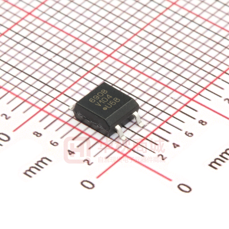

SFH690AB, SFH690A, SFH690B, SFH690C, SFH690D www.vishay.com Vishay Semiconductors Optocoupler Phototransistor Output, SOP-4, 100 mil Pitch, Mini-Flat Package FEATURES A 1 4 C C 2 3 E • SOP (small outline package) • Isolation test voltage, 3750 VRMS (1 s) • High collector emitter breakdown voltage, VCEO = 70 V • Low saturation voltage • Fast switching times i179066 V D E • Temperature stable • Low coupling capacitance DESCRIPTION • End-stackable, 0.100" (2.54 mm) spacing The SFH690ABT, SFH690AT, SFH690BT, SFH690CT, SFH690DT family has a GaAs infrared emitting diode emitter, which is optically coupled to a silicon planar phototransistor detector, and is incorporated in a 4 pin 100 mil lead pitch miniflat package. It features a high current transfer ratio, low coupling capacitance, and high isolation voltage. • Material categorization: for definitions of compliance please see www.vishay.com/doc?99912 APPLICATIONS • High density mounting or space sensitive PCBs • PLCs • Telecommunication The coupling devices are designed for signal transmission between two electrically separated circuits. The SFH690 series is available only on tape and reel. There are 2000 parts per reel. Marking for SFH690AT is 690A; SFH690BT is 690B; SFH690CT is 690C; SFH690DT is 690D; SFH690ABT will be marked as 690A or 690B. AGENCY APPROVALS • UL1577, file no. E52744 system code U • cUL tested to CSA 22.2 bulletin 5A • BSI EN 60950; EN 60065 • DIN EN 60747-5-5 (VDE 0885-5) available with option 1 • CQC GB4943.1-2011 and GB8898-2011 (suitable for installation altitude below 2000 m) ORDERING INFORMATION S F H 6 9 0 x PART NUMBER x - X CTR BIN 0 SOP-4, 100 mil pitch VDE, UL, cUL, BSI SOP-4, 100 mil pitch 1 PACKAGE OPTION AGENCY CERTIFIED/PACKAGE UL, cUL, BSI 0 SOP-4 T TAPE AND REEL 7.21 mm CTR (%) 50 to 300 50 to 150 100 to 300 100 to 200 200 to 400 SFH690ABT SFH690AT3 (1), SFH690AT (2) SFH690BT3 (1), SFH690BT (2) SFH690CT SFH690DT 50 to 300 50 to 150 100 to 300 100 to 200 200 to 400 - - SFH690B-X001T SFH690C-X001T SFH690D-X001T Notes (1) Product is rotated 180° in tape and reel cavity (2) Also available in tubes, do not put “T” to the end Document Number: 83686 1 For technical questions, contact: optocoupleranswers@vishay.com THIS DOCUMENT IS SUBJECT TO CHANGE WITHOUT NOTICE. THE PRODUCTS DESCRIBED HEREIN AND THIS DOCUMENT ARE SUBJECT TO SPECIFIC DISCLAIMERS, SET FORTH AT www.vishay.com/doc?91000 Rev. 2.6, 17-Nov-15 SFH690AB, SFH690A, SFH690B, SFH690C, SFH690D www.vishay.com Vishay Semiconductors ABSOLUTE MAXIMUM RATINGS (Tamb = 25 °C, unless otherwise specified) PARAMETER TEST CONDITION SYMBOL VALUE UNIT INPUT Reverse voltage VR 6 V DC forward current IF 50 mA tp ≤ 10 μs Surge forward current IFSM 2.5 A Pdiss 80 mW Collector emitter voltage VCEO 70 V Emitter collector voltage VECO 7 V IC 50 mA Power dissipation OUTPUT Collector current tp ≤ 1 ms IC 100 mA Pdiss 150 mW VIO = 500 V, Tamb = 25 °C RIO ≥ 1012 Ω VIO = 500 V, Tamb = 100 °C RIO ≥ 1011 Ω Tstg - 55 to + 150 °C Tamb - 55 to + 100 °C Tsld 260 °C Power dissipation COUPLER Isolation resistance Storage temperature range Ambient temperature range Soldering temperature (1) max. 10 s dip soldering distance to seating plane ≥ 1.5 mm Notes • Stresses in excess of the absolute maximum ratings can cause permanent damage to the device. Functional operation of the device is not implied at these or any other conditions in excess of those given in the operational sections of this document. Exposure to absolute maximum ratings for extended periods of the time can adversely affect reliability. (3) Refer to reflow profile for soldering conditions for surface mounted devices. Ptot - Power Dissipation (mW) 200 150 Phototransistor 100 50 Diode 0 0 25 50 75 100 125 150 Tamb - Ambient Temperature (°C) 18484 Fig. 1 - Permissible Power Dissipation vs. Ambient Temperature Document Number: 83686 2 For technical questions, contact: optocoupleranswers@vishay.com THIS DOCUMENT IS SUBJECT TO CHANGE WITHOUT NOTICE. THE PRODUCTS DESCRIBED HEREIN AND THIS DOCUMENT ARE SUBJECT TO SPECIFIC DISCLAIMERS, SET FORTH AT www.vishay.com/doc?91000 Rev. 2.6, 17-Nov-15 SFH690AB, SFH690A, SFH690B, SFH690C, SFH690D www.vishay.com Vishay Semiconductors ELECTRICAL CHARACTERISTICS (Tamb = 25 °C, unless otherwise specified) PARAMETER TEST CONDITION SYMBOL MIN. TYP. MAX. UNIT IF = 5 mA VF - 1.15 1.4 V VR = 6 V IR - 0.01 10 μA VR = 0 V, f = 1 MHz CO - 14 - pF RthJA - 750 - K/W VCE = 20 V ICEO - - 100 nA VCE = 5 V, f = 1 MHz CCE - 2.8 - pF RthJA - 500 - K/W IF = 10 mA, IC = 2 mA VCEsat - 0.1 0.3 V f = 1 MHz CC - 0.3 - pF INPUT Forward voltage Reverse current Capacitance Thermal resistance OUTPUT Collector emitter leakage current Collector emitter capacitance Thermal resistance COUPLER Collector emitter saturation voltage Coupling capacitance Note • Minimum and maximum values are testing requirements. Typical values are characteristics of the device and are the result of engineering evaluation. Typical values are for information only and are not part of the testing requirements. CURRENT TRANSFER RATIO (Tamb = 25 °C, unless otherwise specified) PARAMETER IC/IF TEST CONDITION IF = 5 mA, VCE = 5 V PART SYMBOL MIN. TYP. MAX. SFH690ABT CTR 50 - 300 UNIT % SFH690AT CTR 50 - 150 % SFH690BT CTR 100 - 300 % SFH690CT CTR 100 - 200 % SFH690DT CTR 200 - 400 % SWITCHING CHARACTERISTICS (Tamb = 25 °C, unless otherwise specified) PARAMETER Rise time TEST CONDITION SYMBOL MIN. TYP. MAX. UNIT IC = 2 mA, VCC = 5 V, RL = 100 Ω tr - 3 - μs Fall timet IC = 2 mA, VCC = 5 V, RL = 100 Ω tf - 4 - μs Turn-on time IC = 2 mA, VCC = 5 V, RL = 100 Ω ton - 5 - μs Turn-off time IC = 2 mA, VCC = 5 V, RL = 100 Ω toff - 3 - μs IF R L = 100 Ω V CC = 5 V 50 Ω isfh690at_01 Fig. 2 - Switching Operation (without saturation) Document Number: 83686 3 For technical questions, contact: optocoupleranswers@vishay.com THIS DOCUMENT IS SUBJECT TO CHANGE WITHOUT NOTICE. THE PRODUCTS DESCRIBED HEREIN AND THIS DOCUMENT ARE SUBJECT TO SPECIFIC DISCLAIMERS, SET FORTH AT www.vishay.com/doc?91000 Rev. 2.6, 17-Nov-15 SFH690AB, SFH690A, SFH690B, SFH690C, SFH690D www.vishay.com Vishay Semiconductors SAFETY AND INSULATION RATINGS PARAMETER CONDITION Climatic classification SYMBOL VALUE According to IEC 68 part 1 Partial discharge test voltage - lot test (sample test) 55 / 100 / 21 tTr = 60 s, ttest = 10 s, (see Fig. 2) VIOTM Isolation test voltage (RMS) Isolation resistance UNIT 6000 Vpeak VISO 3750 VRMS VIO = 500 V, Tamb = 25 °C RIO ≥ 1012 Ω VIO = 500 V, Tamb = 100 °C RIO ≥ 1011 Ω Forward current Isi 150 mA Power dissipation Pso 350 mW Safety temperature Tsi 175 °C Comparative tracking index CTI 175 Clearance distance 5.0 mm Creepage distance 5.0 mm Insulation distance (internal) 0.4 mm Note • According to DIN EN 60747-5-2 (VDE 0884) (see fig. 2). This optocoupler is suitable for safe electrical isolation only within the safety ratings. Compliance with the safety ratings shall be ensured by means of suitable protective circuits. VIOTM 300 t1, t2 t3 , t4 ttest tstres Phototransistor Pso (mW) 250 200 = 1 s to 10 s =1s = 10 s = 12 s Vpd 150 VIOWM VIORM 100 IR-diode Isi (mA) 50 0 0 0 94 9182-2 25 50 75 100 125 Tsi - Safety Temperature (°C) Fig. 3 - Derating Diagram 150 13930 t3 ttest t4 t1 tTr = 60 s t2 t stres t Fig. 4 - Test Pulse Diagram for Sample Test according to DIN EN 60747-5-2 (VDE 0884); IEC60747-5-5 Document Number: 83686 4 For technical questions, contact: optocoupleranswers@vishay.com THIS DOCUMENT IS SUBJECT TO CHANGE WITHOUT NOTICE. THE PRODUCTS DESCRIBED HEREIN AND THIS DOCUMENT ARE SUBJECT TO SPECIFIC DISCLAIMERS, SET FORTH AT www.vishay.com/doc?91000 Rev. 2.6, 17-Nov-15 SFH690AB, SFH690A, SFH690B, SFH690C, SFH690D www.vishay.com Vishay Semiconductors TYPICAL CHARACTERISTICS (Tamb = 25 °C, unless otherwise specified) 14 VF - Forward Voltage (V) 1.5 IC - Collector Current (mA) 1.6 Tamb = 0 °C 1.4 1.3 Tamb = - 55 °C 1.2 1.1 1.0 0.9 Tamb = 25 °C 0.8 Tamb = 75 °C 0.7 Tamb = 100 °C 0.6 IF = 10 mA 12 10 8 6 4 1 10 0 100 IF - Forward Current (mA) IF = 2 mA 0.1 0.2 0.3 0.4 VCE - Collector Emitter Voltage (sat) (V) Fig. 8 - Collector Current vs. Collector Emitter Voltage (saturated) Fig. 5 - Forward Voltage vs. Forward Current 1.4 NCTR - Normalized CTR (NS) 40 IC - Collector Current (mA) IF = 1 mA 2 0 0.1 35 IF = 20 mA 30 25 IF = 15 mA 20 IF = 10 mA 15 10 IF = 5 mA 5 0 1.2 1 2 3 4 5 6 7 IF = 5 mA 0.8 0.6 IF = 1 mA 0.4 0.2 8 Normalized to: IF = 5 mA, VCE = 5 V, Tamb = 25 °C - 60 - 40 - 20 VCE - Collector Emitter Voltage (NS) (V) Fig. 6 - Collector Current vs. Collector Emitter Voltage (non-saturated) IF = 10 mA 1.0 0 0 0 20 40 60 80 100 Tamb - Ambient Temperature (°C) Fig. 9 - Normalized Current Transfer Ratio vs. Ambient Temperature 1.2 10 000 NCTR - Normalized CTR (sat) IF = 0 mA ICE0 - Leakage Current (nA) IF = 5 mA 1000 VCE = 40 V 100 10 VCE = 24 V 1 0.1 VCE = 12 V 0.01 0.001 1.0 0.8 0 20 40 60 80 100 Tamb - Ambient Temperature (°C) Fig. 7 - Leakage Current vs. Ambient Temperature IF = 10 mA 0.6 IF = 1 mA 0.4 0.2 0 - 60 - 40 - 20 IF = 5 mA VCE = 0.4 V Normalized to: IF = 5 mA, VCE = 5 V, Tamb = 25 °C - 60 - 40 - 20 0 20 40 60 80 100 Tamb - Ambient Temperature (°C) Fig. 10 - Normalized Current Transfer Ratio (saturated) vs. Ambient Temperature Document Number: 83686 5 For technical questions, contact: optocoupleranswers@vishay.com THIS DOCUMENT IS SUBJECT TO CHANGE WITHOUT NOTICE. THE PRODUCTS DESCRIBED HEREIN AND THIS DOCUMENT ARE SUBJECT TO SPECIFIC DISCLAIMERS, SET FORTH AT www.vishay.com/doc?91000 Rev. 2.6, 17-Nov-15 SFH690AB, SFH690A, SFH690B, SFH690C, SFH690D www.vishay.com Vishay Semiconductors 1000 Tamb = 0 °C 1.2 VCC = 5 V Tamb = - 55 °C Tamb = 25 °C 1.0 FCTR (kHz) NCTR - Normalized CTR (NS) 1.4 0.8 0.6 Tamb = 75 °C 0.4 Tamb = 100 °C Normalized to: IF = 5 A, VCE = 5 V, Tamb = 25 °C 0.2 0 0.1 1 10 100 10 1 100 0.1 1 IF - Forward Current (mA) Fig. 11 - Normalized CTR (non-saturated) vs. Forward Current 100 Fig. 14 - FCTR vs. Collector Current 1000 1.2 VCE = 0.4 V Normalized to: IF = 5 mA, VCE = 5 V, Tamb = 25 °C 1.0 0.8 Tamb = 0 °C VCE = 5 V, IF = 5 mA Tamb = - 55 °C 0.6 0.4 Tamb = 25 °C 0.2 Tamb = 75 °C Tamb = 100 °C 0 0.1 1 10 ton, toff Switching Time (μs) NCTR - Normalized CTR (sat) 10 IC (mA) 100 toff 10 ton 1 0.1 100 IF - Forward Current (mA) 0.1 1 10 100 RL - Load Resistance (kΩ) Fig. 12 - Normalized CTR (saturated) vs. Forward Current Fig. 15 - Switching Time vs. Load Resistance 0 VCE = 5 V -20 Phase (deg) -40 -60 -80 -100 -120 -140 -160 1 10 100 1000 f (kHz) Fig. 13 - FCTR vs. Phase Angle Document Number: 83686 6 For technical questions, contact: optocoupleranswers@vishay.com THIS DOCUMENT IS SUBJECT TO CHANGE WITHOUT NOTICE. THE PRODUCTS DESCRIBED HEREIN AND THIS DOCUMENT ARE SUBJECT TO SPECIFIC DISCLAIMERS, SET FORTH AT www.vishay.com/doc?91000 Rev. 2.6, 17-Nov-15 SFH690AB, SFH690A, SFH690B, SFH690C, SFH690D www.vishay.com Vishay Semiconductors PACKAGE DIMENSIONS (in millimeters) 4 3 5.59 5.08 0.46 0.33 4.83 4.32 ISO method A 1 40° 10° 0.20 0.10 0.63 0.38 2 Pin one ID (on chamfer side of package) 4.67 4.17 0.61 0.86 7.21 6.71 6° R 0.25 0.36 2.03 1.91 2.54 0.46 0.36 0.91 Lead coplanarity 0.10 max. 5.08 7.37 2.67 2.41 1.14 i178037 PACKAGE MARKING (example of SFH690AT) 690A V YWW U68X1 Notes • Only option 1 is reflected in the package marking with the characters “X1” • Tape and reel suffix (T) is not part of the package marking Document Number: 83686 7 For technical questions, contact: optocoupleranswers@vishay.com THIS DOCUMENT IS SUBJECT TO CHANGE WITHOUT NOTICE. THE PRODUCTS DESCRIBED HEREIN AND THIS DOCUMENT ARE SUBJECT TO SPECIFIC DISCLAIMERS, SET FORTH AT www.vishay.com/doc?91000 Rev. 2.6, 17-Nov-15 Legal Disclaimer Notice www.vishay.com Vishay Disclaimer ALL PRODUCT, PRODUCT SPECIFICATIONS AND DATA ARE SUBJECT TO CHANGE WITHOUT NOTICE TO IMPROVE RELIABILITY, FUNCTION OR DESIGN OR OTHERWISE. Vishay Intertechnology, Inc., its affiliates, agents, and employees, and all persons acting on its or their behalf (collectively, “Vishay”), disclaim any and all liability for any errors, inaccuracies or incompleteness contained in any datasheet or in any other disclosure relating to any product. Vishay makes no warranty, representation or guarantee regarding the suitability of the products for any particular purpose or the continuing production of any product. To the maximum extent permitted by applicable law, Vishay disclaims (i) any and all liability arising out of the application or use of any product, (ii) any and all liability, including without limitation special, consequential or incidental damages, and (iii) any and all implied warranties, including warranties of fitness for particular purpose, non-infringement and merchantability. Statements regarding the suitability of products for certain types of applications are based on Vishay's knowledge of typical requirements that are often placed on Vishay products in generic applications. Such statements are not binding statements about the suitability of products for a particular application. It is the customer's responsibility to validate that a particular product with the properties described in the product specification is suitable for use in a particular application. Parameters provided in datasheets and / or specifications may vary in different applications and performance may vary over time. All operating parameters, including typical parameters, must be validated for each customer application by the customer's technical experts. Product specifications do not expand or otherwise modify Vishay's terms and conditions of purchase, including but not limited to the warranty expressed therein. Hyperlinks included in this datasheet may direct users to third-party websites. These links are provided as a convenience and for informational purposes only. Inclusion of these hyperlinks does not constitute an endorsement or an approval by Vishay of any of the products, services or opinions of the corporation, organization or individual associated with the third-party website. Vishay disclaims any and all liability and bears no responsibility for the accuracy, legality or content of the third-party website or for that of subsequent links. Except as expressly indicated in writing, Vishay products are not designed for use in medical, life-saving, or life-sustaining applications or for any other application in which the failure of the Vishay product could result in personal injury or death. Customers using or selling Vishay products not expressly indicated for use in such applications do so at their own risk. Please contact authorized Vishay personnel to obtain written terms and conditions regarding products designed for such applications. No license, express or implied, by estoppel or otherwise, to any intellectual property rights is granted by this document or by any conduct of Vishay. Product names and markings noted herein may be trademarks of their respective owners. © 2022 VISHAY INTERTECHNOLOGY, INC. ALL RIGHTS RESERVED Revision: 01-Jan-2022 1 Document Number: 91000
