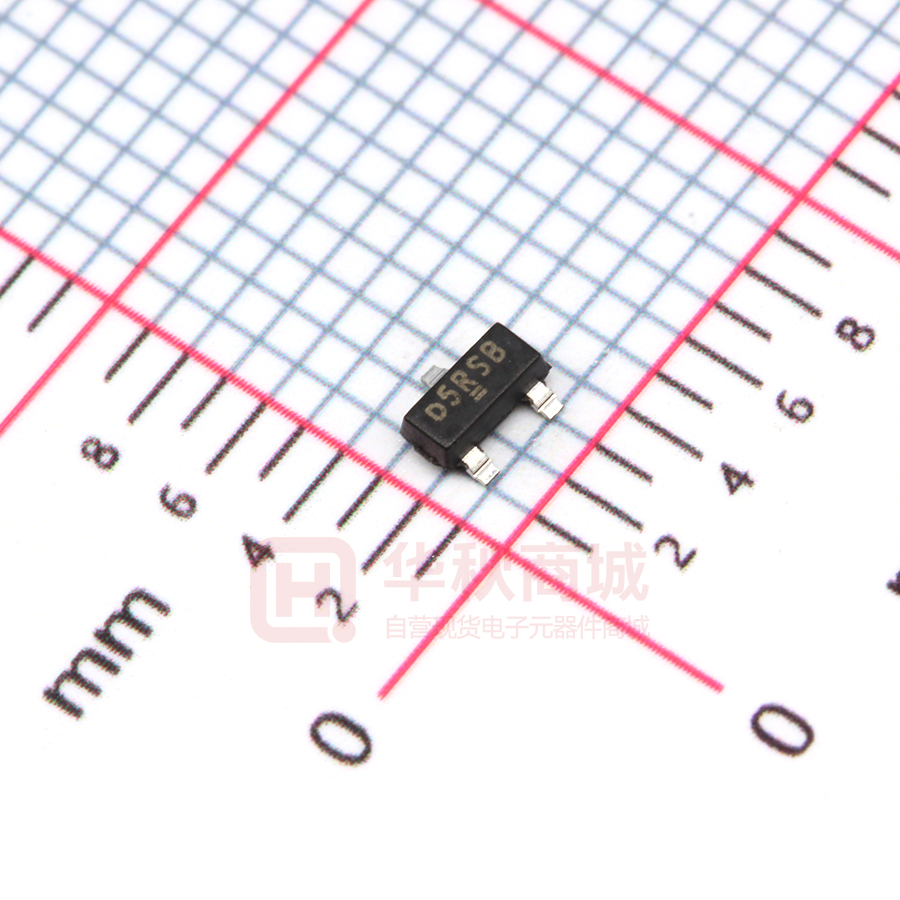

    MOS管 P-Channel VDS=150V VGS=±20V ID=530mA RDS(ON)=1.2Ω@10V SOT23-3
SI2325DS-T1-E3 数据手册
Si2325DS Vishay Siliconix P-Channel 150-V (D-S) MOSFET FEATURES PRODUCT SUMMARY VDS (V) - 150 RDS(on) (Ω) ID (A) 1.2 at VGS = - 10 V - 0.69 1.3 at VGS = - 6.0 V - 0.66 • Halogen-free According to IEC 61249-2-21 Available • TrenchFET® Power MOSFET • Ultra Low On-Resistance • Small Size Qg (Typ.) 7.7 APPLICATIONS • Active Clamp Circuits in DC/DC Power Supplies TO-236 (SOT-23) G 1 3 S D 2 Top View Si2325DS (D5)* * Marking Code Ordering Information: Si2325DS -T1-E3 (Lead (Pb)-free) Si2325DS -T1-GE3 (Lead (Pb)-free and Halogen-free) ABSOLUTE MAXIMUM RATINGS TA = 25 °C, unless otherwise noted Parameter Symbol 5s Steady State Drain-Source Voltage VDS - 150 Gate-Source Voltage VGS ± 20 TA = 25 °C Continuous Drain Current (TJ = 150 °C)a, b TA = 70 °C ID a, b IS Continuous Source Current (Diode Conduction) Single Pulse Avalanche Current Single Pulse Avalanche Energy Maximum Power Dissipationa, b L = 1.0 mH TA = 25 °C TA = 70 °C - 0.53 - 0.55 - 0.43 - 1.6 - 0.6 IAS 4.5 1.01 mJ 1.25 0.75 0.8 0.48 TJ, Tstg Operating Junction and Storage Temperature Range A - 1.0 EAS PD V - 0.69 IDM Pulsed Drain Current Unit - 55 to 150 W °C THERMAL RESISTANCE RATINGS Parameter Maximum Junction-to-Ambienta Maximum Junction-to-Foot (Drain) Symbol t≤5s Steady State Steady State RthJA RthJF Typical Maximum 75 100 120 166 40 50 Unit °C/W Notes: a. Surface Mounted on 1" x 1" FR4 board. b. Pulse width limited by maximum junction temperature. Document Number: 73238 S09-0133-Rev. B, 02-Feb-09 www.vishay.com 1 Si2325DS Vishay Siliconix SPECIFICATIONS TJ = 25 °C, unless otherwise noted Limits Parameter Symbol Test Conditions Min. V(BR)DSS VGS = 0 V, ID = - 250 µA - 150 VGS(th) VDS = VGS, ID = - 250 µA - 2.5 IGSS VDS = 0 V, VGS = ± 20 V ± 100 VDS = - 150 V, VGS = 0 V -1 VDS = - 150 V, VGS = 0 V, TJ = 55 °C - 10 Typ. Max. Unit Static Drain-Source Breakdown Voltage Gate-Threshold Voltage Gate-Body Leakage Zero Gate Voltage Drain Current IDSS On-State Drain Currenta ID(on) Drain-Source On-Resistancea Forward Transconductancea Diode Forward Voltage VDS ≤ - 15 V, VGS = 10 V - 4.5 - 1.6 nA µA A VGS = - 10 V, ID = - 0.5 A 1.0 1.2 VGS = - 6.0 V, ID = - 0.5 A 1.05 1.3 gfs VDS = - 15 V, ID = - 0.5 A 2.2 VSD IS = - 1.0 A, VGS = 0 V 0.7 - 1.2 7.7 12 RDS(on) V Ω S V Dynamicb Total Gate Charge Qg Gate-Source Charge Qgs Gate-Drain Charge Qgd Gate Resistance Rg Input Capacitance Ciss Output Capacitance Coss Reverse Transfer Capacitance Crss VDS = - 75 V, VGS = 10 V, ID ≅ - 0.5 A f = 1.0 MHz 2.5 Ω 9 340 VDS = - 25 V, VGS = 0 V, f = 1 MHz nC 1.5 510 pF 30 16 Switchingc Turn-On Time Turn-Off Time Body Diode Reverse Recovery Charge td(on) tr td(off) tf Qrr VDD = - 75 V, RL = 75 Ω ID ≅ - 1.0 A, VGEN = - 10 V Rg = 6 Ω IF = 0.5 A, dI/dt = 100 A/µs 7 11 11 17 16 25 11 17 90 135 ns nC Notes: a. Pulse test: PW ≤ 300 µs duty cycle ≤ 2 %. b. For DESIGN AID ONLY, not subject to production testing. c. Switching time is essentially independent of operating temperature. Stresses beyond those listed under “Absolute Maximum Ratings” may cause permanent damage to the device. These are stress ratings only, and functional operation of the device at these or any other conditions beyond those indicated in the operational sections of the specifications is not implied. Exposure to absolute maximum rating conditions for extended periods may affect device reliability. www.vishay.com 2 Document Number: 73238 S09-0133-Rev. B, 02-Feb-09 Si2325DS Vishay Siliconix TYPICAL CHARACTERISTICS 25 °C, unless otherwise noted 1.6 1.6 VGS = 10 thru 5 V 1.4 1.4 1.2 I D - Drain Current (A) I D - Drain Current (A) 1.2 1.0 0.8 0.6 0.4 1.0 0.8 0.6 TC = 125 °C 0.4 0.2 - 55 °C 3V 0.0 0 2 4 25 °C 0.2 4V 6 8 0.0 10 0 1 VDS - Drain-to-Source Voltage (V) 2 3 4 5 VGS - Gate-to-Source Voltage (V) Output Characteristics Transfer Characteristics 2.00 500 400 1.50 1.25 C - Capacitance (pF) R DS(on) - On-Resistance (Ω) 1.75 VGS = 6 V 1.00 VGS = 10 V 0.75 Ciss 300 200 0.50 100 0.25 Coss 0.00 0.0 0 0.2 0.4 0.6 0.8 1.0 1.2 1.4 1.6 Crss 0 30 ID - Drain Current (A) 60 120 150 VDS - Drain-to-Source Voltage (V) On-Resistance vs. Drain Current Capacitance 10 2.5 VDS = 75 V ID = 0.5 A VGS = 10 V ID = 0.5 A 8 6 4 2 (Normalized) 2.0 R DS(on) - On-Resistance VGS - Gate-to-Source Voltage (V) 90 1.5 1.0 0.5 0 0 1 2 3 4 5 6 Qg - Total Gate Charge (nC) Gate Charge Document Number: 73238 S09-0133-Rev. B, 02-Feb-09 7 8 0.0 - 50 - 25 0 25 50 75 100 125 150 TJ - Junction Temperature (°C) On-Resistance vs. Junction Temperature www.vishay.com 3 Si2325DS Vishay Siliconix TYPICAL CHARACTERISTICS 25 °C, unless otherwise noted 3.0 3 ID = 0.5 A RDS(on) - On-Resistance (Ω) 2.5 I S - Source Current (A) TJ = 150 °C 1 TJ = 25 °C 2.0 1.5 1.0 0.5 0.0 0.1 0 0.2 0.4 0.6 0.8 1.0 1.2 0 1.4 2 6 8 10 VGS - Gate-to-Source Voltage (V) VSD - Source-to-Drain Voltage (V) Source-Drain Diode Forward Voltage On-Resistance vs. Gate-to-Source Voltage 1.3 12 1.0 10 ID = 250 µA 0.7 8 Power (W) VGS(th) Variance (V) 4 0.4 0.1 6 4 TA = 25 °C - 0.2 - 0.5 - 50 2 0 - 25 0 25 50 75 100 125 150 0.01 0.1 1 10 TJ - Temperature (°C) Time (s) Threshold Voltage Single Pulse Power 100 600 10 IDM Limited Limited by R DS(on)* 10 µs 100 µs I D - Drain Current (A) 1 1 ms 0.1 10 ms ID(on) Limited 0.01 100 ms TA = 25 °C Single Pulse 10 s, 1 s 100 s, DC BVDSS Limited 0.001 0.1 1 10 100 1000 VDS - Drain-to-Source Voltage (V) * VGS > minimum V GS at which R DS(on) is specified Safe Operating Area www.vishay.com 4 Document Number: 73238 S09-0133-Rev. B, 02-Feb-09 Si2325DS Vishay Siliconix TYPICAL CHARACTERISTICS 25 °C, unless otherwise noted 2 1 Normalized Effective Transient Thermal Impedance Duty Cycle = 0.5 0.2 Notes: 0.1 PDM 0.1 t1 0.05 t2 1. Duty Cycle, D = t1 t2 2. Per Unit Base = R thJA = 120 °C/W 0.02 3. T JM - TA = PDMZthJA(t) 4. Surface Mounted Single Pulse 0.01 10-4 10-3 10-2 10-1 1 10 100 600 Square Wave Pulse Duration (s) Normalized Thermal Transient Impedance, Junction-to-Ambient Vishay Siliconix maintains worldwide manufacturing capability. Products may be manufactured at one of several qualified locations. Reliability data for Silicon Technology and Package Reliability represent a composite of all qualified locations. For related documents such as package/tape drawings, part marking, and reliability data, see www.vishay.com/ppg?73238. Document Number: 73238 S09-0133-Rev. B, 02-Feb-09 www.vishay.com 5 Package Information Vishay Siliconix SOT-23 (TO-236): 3-LEAD b 3 E1 1 E 2 e S e1 D 0.10 mm C 0.004" A2 A C q Gauge Plane Seating Plane Seating Plane C A1 Dim 0.25 mm L L1 MILLIMETERS Min INCHES Max Min Max 0.044 A 0.89 1.12 0.035 A1 0.01 0.10 0.0004 0.004 A2 0.88 1.02 0.0346 0.040 b 0.35 0.50 0.014 0.020 c 0.085 0.18 0.003 0.007 D 2.80 3.04 0.110 0.120 E 2.10 2.64 0.083 0.104 E1 1.20 1.40 0.047 e 0.95 BSC e1 L 1.90 BSC 0.40 L1 q 0.0748 Ref 0.60 0.016 0.64 Ref S 0.024 0.025 Ref 0.50 Ref 3° 0.055 0.0374 Ref 0.020 Ref 8° 3° 8° ECN: S-03946-Rev. K, 09-Jul-01 DWG: 5479 Document Number: 71196 09-Jul-01 www.vishay.com 1 Application Note 826 Vishay Siliconix 0.049 (1.245) 0.029 0.022 (0.559) (0.724) 0.037 (0.950) (2.692) 0.106 RECOMMENDED MINIMUM PADS FOR SOT-23 0.053 (1.341) 0.097 (2.459) Recommended Minimum Pads Dimensions in Inches/(mm) Return to Index Return to Index APPLICATION NOTE Document Number: 72609 Revision: 21-Jan-08 www.vishay.com 25 Legal Disclaimer Notice www.vishay.com Vishay Disclaimer ALL PRODUCT, PRODUCT SPECIFICATIONS AND DATA ARE SUBJECT TO CHANGE WITHOUT NOTICE TO IMPROVE RELIABILITY, FUNCTION OR DESIGN OR OTHERWISE. Vishay Intertechnology, Inc., its affiliates, agents, and employees, and all persons acting on its or their behalf (collectively, “Vishay”), disclaim any and all liability for any errors, inaccuracies or incompleteness contained in any datasheet or in any other disclosure relating to any product. Vishay makes no warranty, representation or guarantee regarding the suitability of the products for any particular purpose or the continuing production of any product. To the maximum extent permitted by applicable law, Vishay disclaims (i) any and all liability arising out of the application or use of any product, (ii) any and all liability, including without limitation special, consequential or incidental damages, and (iii) any and all implied warranties, including warranties of fitness for particular purpose, non-infringement and merchantability. Statements regarding the suitability of products for certain types of applications are based on Vishay's knowledge of typical requirements that are often placed on Vishay products in generic applications. Such statements are not binding statements about the suitability of products for a particular application. It is the customer's responsibility to validate that a particular product with the properties described in the product specification is suitable for use in a particular application. Parameters provided in datasheets and / or specifications may vary in different applications and performance may vary over time. All operating parameters, including typical parameters, must be validated for each customer application by the customer's technical experts. Product specifications do not expand or otherwise modify Vishay's terms and conditions of purchase, including but not limited to the warranty expressed therein. Hyperlinks included in this datasheet may direct users to third-party websites. These links are provided as a convenience and for informational purposes only. Inclusion of these hyperlinks does not constitute an endorsement or an approval by Vishay of any of the products, services or opinions of the corporation, organization or individual associated with the third-party website. Vishay disclaims any and all liability and bears no responsibility for the accuracy, legality or content of the third-party website or for that of subsequent links. Except as expressly indicated in writing, Vishay products are not designed for use in medical, life-saving, or life-sustaining applications or for any other application in which the failure of the Vishay product could result in personal injury or death. Customers using or selling Vishay products not expressly indicated for use in such applications do so at their own risk. Please contact authorized Vishay personnel to obtain written terms and conditions regarding products designed for such applications. No license, express or implied, by estoppel or otherwise, to any intellectual property rights is granted by this document or by any conduct of Vishay. Product names and markings noted herein may be trademarks of their respective owners. © 2022 VISHAY INTERTECHNOLOGY, INC. ALL RIGHTS RESERVED Revision: 01-Jan-2022 1 Document Number: 91000
