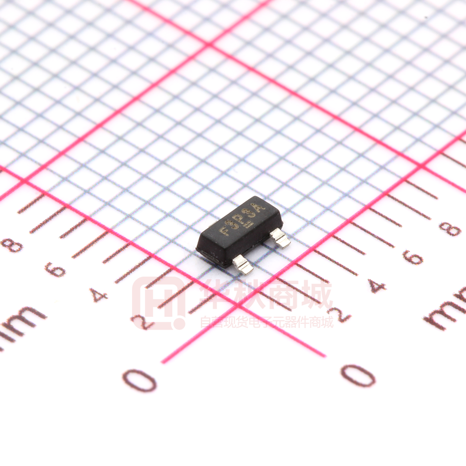

    MOSFET SOT23-3 P-Channel ID=4A
SI2343DS-T1-E3 数据手册
Si2343DS Vishay Siliconix P-Channel 30-V (D-S) MOSFET FEATURES PRODUCT SUMMARY VDS (V) - 30 RDS(on) (Ω) • Halogen-free According to IEC 61249-2-21 Available • TrenchFET® Power MOSFET ID (A) 0.053 at VGS = - 10 V - 4.0 0.086 at VGS = - 4.5 V - 3.1 APPLICATIONS • Load Switch • PA Switch TO-236 (SOT-23) G 1 S 2 3 D Top View Si2343DS (F3)* * Marking Code Ordering Information: Si2343DS-T1 Si2343DS-T1-E3 (Lead (Pb)-free) Si2343DS-T1-GE3 (Lead (Pb)-free and Halogen-free) ABSOLUTE MAXIMUM RATINGS TA = 25 °C, unless otherwise noted Parameter Symbol 5s Steady State Drain-Source Voltage VDS - 30 Gate-Source Voltage VGS ± 20 Continuous Drain Current (TJ = 150 °C)a, b TA = 25 °C TA = 70 °C Continuous Source Current (Diode Conduction)a, b IS TA = 25 °C TA = 70 °C PD - 3.1 - 3.2 - 2.5 - 15 - 1.0 - 0.6 1.25 0.75 0.8 0.48 TJ, Tstg Operating Junction and Storage Temperature Range V - 4.0 IDM Pulsed Drain Current Maximum Power Dissipationa, b ID Unit - 55 to 150 A W °C THERMAL RESISTANCE RATINGS Parameter Maximum Junction-to-Ambienta Maximum Junction-to-Foot (Drain) Symbol t≤5s Steady State Steady State RthJA RthJF Typical Maximum 75 100 120 166 40 50 Unit °C/W Notes: a. Surface Mounted on 1" x 1" FR4 board. b. Pulse width limited by maximum junction temperature. * Pb containing terminations are not RoHS compliant, exemptions may apply Document Number: 72079 S09-0133-Rev. B, 02-Feb-09 www.vishay.com 1 Si2343DS Vishay Siliconix SPECIFICATIONS TJ = 25 °C, unless otherwise noted Limits Parameter Symbol Test Conditions Min. V(BR)DSS VGS = 0 V, ID = - 250 µA - 30 VGS(th) VDS = VGS, ID = - 250 µA -1 IGSS VDS = 0 V, VGS = ± 20 V ± 100 VDS = - 24 V, VGS = 0 V -1 VDS = - 24 V, VGS = 0 V, TJ = 55 °C - 10 Typ. Max. Unit Static Drain-Source Breakdown Voltage Gate-Threshold Voltage Gate-Body Leakage Zero Gate Voltage Drain Current IDSS On-State Drain Currenta ID(on) Drain-Source On-Resistancea RDS(on) VDS ≤ - 5 V, VGS = - 10 V -3 - 15 V nA µA A VGS = - 10 V, ID = - 4.0 A 0.043 0.053 VGS = - 4.5 V, ID = - 3.1 A 0.068 0.086 Forward Transconductancea gfs VDS = - 5 V, ID = - 4.0 A 10 Diode Forward Voltage VSD IS = - 1.0 A, VGS = 0 V - 0.7 - 1.2 14 21 Ω S V Dynamicb Total Gate Charge Qg Gate-Source Charge Qgs Gate-Drain Charge Qgd Input Capacitance Ciss Output Capacitance Coss Reverse Transfer Capacitance Crss VDS = - 15 V, VGS = - 10 V ID ≅ - 4.0 A nC 1.9 3.7 540 VDS = - 15 V, VGS = 0 V, f = 1 MHz pF 131 105 Switchingc Turn-On Time Turn-Off Time td(on) tr td(off) tf VDD = - 15 V, RL = 15 Ω ID ≅ - 1.0 A, VGEN = - 10 V RG = 6 Ω 10 15 15 25 31 50 20 30 ns Notes: a. Pulse test: PW ≤ 300 µs, duty cycle ≤ 2 %. b. For DESIGN AID ONLY, not subject to production testing. c. Switching time is essentially independent of operating temperature. Stresses beyond those listed under “Absolute Maximum Ratings” may cause permanent damage to the device. These are stress ratings only, and functional operation of the device at these or any other conditions beyond those indicated in the operational sections of the specifications is not implied. Exposure to absolute maximum rating conditions for extended periods may affect device reliability. www.vishay.com 2 Document Number: 72079 S09-0133-Rev. B, 02-Feb-09 Si2343DS Vishay Siliconix TYPICAL CHARACTERISTICS 25 °C, unless otherwise noted 15 15 4V VGS = 10 thru 5 V 12 I D - Drain Current (A) I D - Drain Current (A) 12 9 6 6 TC = 125 °C 3V 3 9 3 25 °C 0 0 1 2 3 4 0 0.0 5 1.5 2.0 2.5 3.0 VGS - Gate-to-Source Voltage (V) Output Characteristics Transfer Characteristics 3.5 4.0 1000 0.10 800 0.08 C - Capacitance (pF) R DS(on) - On-Resistance (Ω) 1.0 VDS - Drain-to-Source Voltage (V) 0.12 VGS = 4.5 V 0.06 VGS = 10 V 0.04 Ciss 600 400 Coss 200 0.02 Crss 0.00 0 0 3 6 9 12 15 0 5 10 15 20 25 ID - Drain Current (A) VDS - Drain-to-Source Voltage (V) On-Resistance vs. Drain Current Capacitance 10 30 1.6 VDS =15 V ID = 4.0 A 1.4 6 4 2 (Normalized) 8 R DS(on) - On-Resistance V GS - Gate-to-Source Voltage (V) 0.5 - 55 °C VGS = 4.0 V ID = 4.0 A 1.2 1.0 0.8 0 0 3 6 9 Qg - Total Gate Charge (nC) Gate Charge Document Number: 72079 S09-0133-Rev. B, 02-Feb-09 12 15 0.6 - 50 - 25 0 25 50 75 100 125 150 TJ - Junction Temperature (°C) On-Resistance vs. Junction Temperature www.vishay.com 3 Si2343DS Vishay Siliconix TYPICAL CHARACTERISTICS 25 °C, unless otherwise noted 0.12 20 0.10 R DS(on) - On-Resistance (Ω) I S - Source Current (A) 10 TJ = 150 °C TJ = 25 °C ID = 4.0 A 0.08 ID = 1 A 0.06 0.04 0.02 0.00 1 0 0.2 0.4 0.6 0.8 1.0 1.2 0 1.4 4 6 8 VSD - Source-to-Drain Voltage (V) VGS - Gate-to-Source Voltage (V) Source-Drain Diode Forward Voltage On-Resistance vs. Gate-to-Source Voltage 0.6 10 12 ID = 250 µA 10 0.4 8 0.2 Power (W) V GS(th) Variance (V) 2 0.0 6 4 TA = 25 °C - 0.2 - 0.4 - 50 2 0 - 25 0 25 50 75 100 125 150 0.01 0.1 1 10 TJ - Temperature (°C) Time (s) Threshold Voltage Single Pulse Power 100 600 100 IDM Limited Limited by RDS(on)* I D - Drain Current (A) 10 P(t) = 0.0001 1 0.1 P(t) = 0.001 ID(on) Limited P(t) = 0.01 P(t) = 0.1 TA = 25 °C Single Pulse BVDSS Limited 0.01 0.1 P(t) = 1 P(t) = 10 DC 1 10 100 VDS - Drain-to-Source Voltage (V) * VGS > minimum VGS at which RDS(on) is specified Safe Operating Area www.vishay.com 4 Document Number: 72079 S09-0133-Rev. B, 02-Feb-09 Si2343DS Vishay Siliconix TYPICAL CHARACTERISTICS 25 °C, unless otherwise noted 2 1 Normalized Effective Transient Thermal Impedance Duty Cycle = 0.5 0.2 Notes: 0.1 PDM 0.1 t1 0.05 t2 1. Duty Cycle, D = t1 t2 2. Per Unit Base = R thJA = 120 °C/W 0.02 3. T JM - TA = PDMZthJA(t) 4. Surface Mounted Single Pulse 0.01 10-4 10-3 10-2 10-1 1 10 100 600 Square Wave Pulse Duration (s) Normalized Thermal Transient Impedance, Junction-to-Ambient Vishay Siliconix maintains worldwide manufacturing capability. Products may be manufactured at one of several qualified locations. Reliability data for Silicon Technology and Package Reliability represent a composite of all qualified locations. For related documents such as package/tape drawings, part marking, and reliability data, see www.vishay.com/ppg?72079. Document Number: 72079 S09-0133-Rev. B, 02-Feb-09 www.vishay.com 5 Package Information Vishay Siliconix SOT-23 (TO-236): 3-LEAD b 3 E1 1 E 2 e S e1 D 0.10 mm C 0.004" A2 A C q Gauge Plane Seating Plane Seating Plane C A1 Dim 0.25 mm L L1 MILLIMETERS Min INCHES Max Min Max 0.044 A 0.89 1.12 0.035 A1 0.01 0.10 0.0004 0.004 A2 0.88 1.02 0.0346 0.040 b 0.35 0.50 0.014 0.020 c 0.085 0.18 0.003 0.007 D 2.80 3.04 0.110 0.120 E 2.10 2.64 0.083 0.104 E1 1.20 1.40 0.047 e 0.95 BSC e1 L 1.90 BSC 0.40 L1 q 0.0748 Ref 0.60 0.016 0.64 Ref S 0.024 0.025 Ref 0.50 Ref 3° 0.055 0.0374 Ref 0.020 Ref 8° 3° 8° ECN: S-03946-Rev. K, 09-Jul-01 DWG: 5479 Document Number: 71196 09-Jul-01 www.vishay.com 1 AN807 Vishay Siliconix Mounting LITTLE FOOTR SOT-23 Power MOSFETs Wharton McDaniel Surface-mounted LITTLE FOOT power MOSFETs use integrated circuit and small-signal packages which have been been modified to provide the heat transfer capabilities required by power devices. Leadframe materials and design, molding compounds, and die attach materials have been changed, while the footprint of the packages remains the same. See Application Note 826, Recommended Minimum Pad Patterns With Outline Drawing Access for Vishay Siliconix MOSFETs, (http://www.vishay.com/doc?72286), for the basis of the pad design for a LITTLE FOOT SOT-23 power MOSFET footprint . In converting this footprint to the pad set for a power device, designers must make two connections: an electrical connection and a thermal connection, to draw heat away from the package. ambient air. This pattern uses all the available area underneath the body for this purpose. 0.114 2.9 0.081 2.05 0.150 3.8 0.059 1.5 0.0394 1.0 0.037 0.95 FIGURE 1. Footprint With Copper Spreading The electrical connections for the SOT-23 are very simple. Pin 1 is the gate, pin 2 is the source, and pin 3 is the drain. As in the other LITTLE FOOT packages, the drain pin serves the additional function of providing the thermal connection from the package to the PC board. The total cross section of a copper trace connected to the drain may be adequate to carry the current required for the application, but it may be inadequate thermally. Also, heat spreads in a circular fashion from the heat source. In this case the drain pin is the heat source when looking at heat spread on the PC board. Figure 1 shows the footprint with copper spreading for the SOT-23 package. This pattern shows the starting point for utilizing the board area available for the heat spreading copper. To create this pattern, a plane of copper overlies the drain pin and provides planar copper to draw heat from the drain lead and start the process of spreading the heat so it can be dissipated into the Document Number: 70739 26-Nov-03 Since surface-mounted packages are small, and reflow soldering is the most common way in which these are affixed to the PC board, “thermal” connections from the planar copper to the pads have not been used. Even if additional planar copper area is used, there should be no problems in the soldering process. The actual solder connections are defined by the solder mask openings. By combining the basic footprint with the copper plane on the drain pins, the solder mask generation occurs automatically. A final item to keep in mind is the width of the power traces. The absolute minimum power trace width must be determined by the amount of current it has to carry. For thermal reasons, this minimum width should be at least 0.020 inches. The use of wide traces connected to the drain plane provides a low-impedance path for heat to move away from the device. www.vishay.com 1 Application Note 826 Vishay Siliconix 0.049 (1.245) 0.029 0.022 (0.559) (0.724) 0.037 (0.950) (2.692) 0.106 RECOMMENDED MINIMUM PADS FOR SOT-23 0.053 (1.341) 0.097 (2.459) Recommended Minimum Pads Dimensions in Inches/(mm) Return to Index Return to Index APPLICATION NOTE Document Number: 72609 Revision: 21-Jan-08 www.vishay.com 25 Legal Disclaimer Notice www.vishay.com Vishay Disclaimer  ALL PRODUCT, PRODUCT SPECIFICATIONS AND DATA ARE SUBJECT TO CHANGE WITHOUT NOTICE TO IMPROVE RELIABILITY, FUNCTION OR DESIGN OR OTHERWISE. Vishay Intertechnology, Inc., its affiliates, agents, and employees, and all persons acting on its or their behalf (collectively, “Vishay”), disclaim any and all liability for any errors, inaccuracies or incompleteness contained in any datasheet or in any other disclosure relating to any product. Vishay makes no warranty, representation or guarantee regarding the suitability of the products for any particular purpose or the continuing production of any product. To the maximum extent permitted by applicable law, Vishay disclaims (i) any and all liability arising out of the application or use of any product, (ii) any and all liability, including without limitation special, consequential or incidental damages, and (iii) any and all implied warranties, including warranties of fitness for particular purpose, non-infringement and merchantability. Statements regarding the suitability of products for certain types of applications are based on Vishay’s knowledge of typical requirements that are often placed on Vishay products in generic applications. Such statements are not binding statements about the suitability of products for a particular application. It is the customer’s responsibility to validate that a particular product with the properties described in the product specification is suitable for use in a particular application. Parameters provided in datasheets and / or specifications may vary in different applications and performance may vary over time. All operating parameters, including typical parameters, must be validated for each customer application by the customer’s technical experts. Product specifications do not expand or otherwise modify Vishay’s terms and conditions of purchase, including but not limited to the warranty expressed therein. Except as expressly indicated in writing, Vishay products are not designed for use in medical, life-saving, or life-sustaining applications or for any other application in which the failure of the Vishay product could result in personal injury or death. Customers using or selling Vishay products not expressly indicated for use in such applications do so at their own risk. Please contact authorized Vishay personnel to obtain written terms and conditions regarding products designed for such applications. No license, express or implied, by estoppel or otherwise, to any intellectual property rights is granted by this document or by any conduct of Vishay. Product names and markings noted herein may be trademarks of their respective owners. © 2017 VISHAY INTERTECHNOLOGY, INC. ALL RIGHTS RESERVED Revision: 08-Feb-17 1 Document Number: 91000
