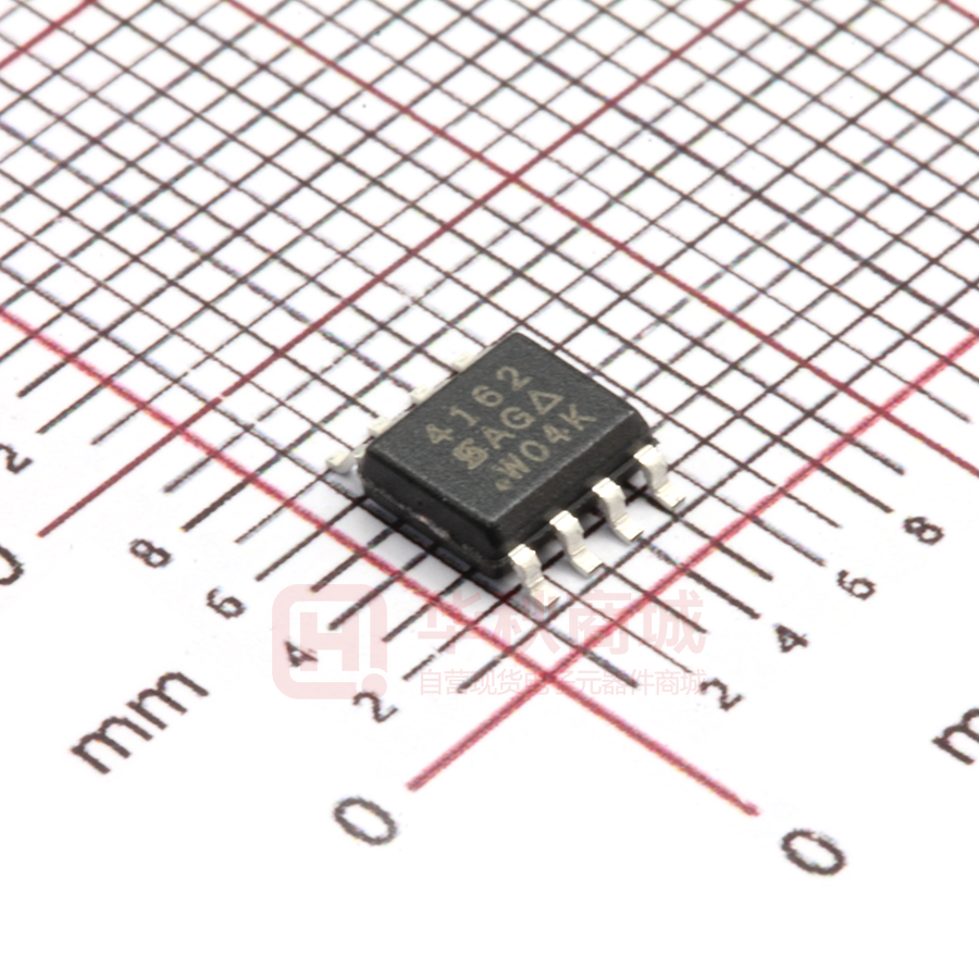

Si4162DY Vishay Siliconix N-Channel 30-V (D-S) MOSFET FEATURES PRODUCT SUMMARY VDS (V) 30 RDS(on) (Ω) ID (A) 0.0079 at VGS = 10 V 19.3a 0.010 at VGS = 4.5 V a • Halogen-free • TrenchFET® Power MOSFET • 100 % Rg Tested • 100 % UIS Tested Qg (Typ.) 8.8 nC 17.1 RoHS COMPLIANT APPLICATIONS • DC/DC - High Side - VRM - POL - Server SO-8 S 1 8 D S 2 7 D S 3 6 D G 4 5 D D G Top View S Ordering Information: Si4162DY-T1-GE3 (Lead (Pb)-free and Halogen-free) N-Channel MOSFET ABSOLUTE MAXIMUM RATINGS TA = 25 °C, unless otherwise noted Parameter Drain-Source Voltage Gate-Source Voltage Continuous Drain Current (TJ = 150 °C) Pulsed Drain Current Avalanche Current Avalanche Energy Symbol VDS VGS TC = 25 °C TC = 70 °C TA = 25 °C TA = 70 °C L = 0.1 mH TC = 25 °C Continuous Source-Drain Diode Current TA = 25 °C TC = 25 °C TC = 70 °C Maximum Power Dissipation TA = 25 °C TA = 70 °C Operating Junction and Storage Temperature Range Soldering Recommendations (Peak Temperature) Limit 30 ± 20 19.3a 15.4 13.6b, c 10.9b, c 70 31 48 4.2a 2.1b, c 5 3.2 2.5b, c 1.6b, c - 55 to 150 260 ID IDM IAS EAS IS PD TJ, Tstg Unit V A mJ A W °C THERMAL RESISTANCE RATINGS Parameter Maximum Junction-to-Ambientb, d Maximum Junction-to-Case (Drain) t ≤ 10 s Steady State Symbol RthJA RthJC Typical 38 20 Maximum 50 25 Unit °C/W Notes: a. Based on TC = 25 °C. b. Surface Mounted on 1" x 1" FR4 board. c. t = 10 s. d. Maximum under Steady State conditions is 85 °C/W. Document Number: 68967 S-82621-Rev. A, 03-Nov-08 www.vishay.com 1 Si4162DY Vishay Siliconix SPECIFICATIONS TJ = 25 °C, unless otherwise noted Parameter Symbol Test Conditions Min. VDS VGS = 0 V, ID = 250 µA 30 Typ. Max. Unit Static Drain-Source Breakdown Voltage VDS Temperature Coefficient ΔVDS/TJ VGS(th) Temperature Coefficient ΔVGS(th)/TJ Gate-Source Threshold Voltage ID = 250 µA VGS(th) VDS = VGS , ID = 250 µA Gate-Source Leakage IGSS VDS = 0 V, VGS = ± 20 V Zero Gate Voltage Drain Current IDSS On-State Drain Currenta ID(on) Drain-Source On-State Resistancea Forward Transconductancea RDS(on) gfs V 32 mV/°C - 5.5 1 3 V ± 100 nA VDS = 30 V, VGS = 0 V 1 VDS = 30 V, VGS = 0 V, TJ = 55 °C 5 VDS ≥ 5 V, VGS = 10 V 50 µA A VGS = 10 V, ID = 20 A 0.0065 0.0079 VGS = 4.5 V, ID = 14 A 0.0082 0.010 VDS = 15 V, ID = 20 A 70 Ω S b Dynamic Input Capacitance Ciss Output Capacitance Coss Reverse Transfer Capacitance Crss Total Gate Charge Qg Gate-Source Charge Qgs Gate-Drain Charge Qgd Gate Resistance Turn-On Delay Time Rise Time Turn-Off Delay Time Fall Time Turn-On Delay Time Rise Time Turn-Off Delay Time Fall Time Rg 1155 VDS = 15 V, VGS = 0 V, f = 1 MHz td(off) pF 95 VDS = 15 V, VGS = 10 V, ID = 20 A VDS = 15 V, VGS = 4.5 V, ID = 20 A 20 30 8.8 14 3.5 f = 1 MHz VDD = 15 V, RL = 15 Ω ID ≅ 1.0 A, VGEN = 4.5 V, Rg = 17 Ω 1.0 2.0 20 30 15 25 25 40 tf 10 15 td(on) 14 20 tr td(off) nC 2.2 td(on) tr 260 VDD = 15 V, RL = 15 Ω ID ≅ 1.0 A, VGEN = 10 V, Rg = 1 Ω tf 9 15 25 40 9 15 Ω ns Drain-Source Body Diode Characteristics Continuous Source-Drain Diode Current IS Pulse Diode Forward Current ISM Body Diode Voltage VSD Body Diode Reverse Recovery Time trr Body Diode Reverse Recovery Charge Qrr Reverse Recovery Fall Time ta Reverse Recovery Rise Time tb TC = 25 °C 30 70 IS = 4.0 A, VGS = 0 V IF = 4.0 A, dI/dt = 100 A/µs, TJ = 25 °C A 0.8 1.2 V 21 42 ns 15 30 nC 12.6 8.4 ns Notes: a. Pulse test; pulse width ≤ 300 µs, duty cycle ≤ 2 %. b. Guaranteed by design, not subject to production testing. Stresses beyond those listed under “Absolute Maximum Ratings” may cause permanent damage to the device. These are stress ratings only, and functional operation of the device at these or any other conditions beyond those indicated in the operational sections of the specifications is not implied. Exposure to absolute maximum rating conditions for extended periods may affect device reliability. www.vishay.com 2 Document Number: 68967 S-82621-Rev. A, 03-Nov-08 Si4162DY Vishay Siliconix TYPICAL CHARACTERISTICS 25 °C, unless otherwise noted 1.0 70 TC = - 55 °C VGS = 10 thru 4 V 60 I D - Drain Current (A) I D - Drain Current (A) 0.8 50 40 30 20 VGS = 3 V TC = 25 °C 0.6 0.4 0.2 10 TC = 125 °C 0.5 1.0 1.5 0.0 0.0 2.0 0.5 1.0 1.5 2.0 2.5 VDS - Drain-to-Source Voltage (V) VGS - Gate-to-Source Voltage (V) Output Characteristics Transfer Characteristics 0.012 1500 0.010 1200 C - Capacitance (pF) R DS(on) - On-Resistance (Ω) 0 0.0 VGS = 4.5 V 0.008 VGS = 10 V 0.006 3.0 Ciss 900 600 Coss 0.004 300 0.002 0 Crss 0 10 20 30 40 50 60 0 70 12 18 24 ID - Drain Current (A) VDS - Drain-to-Source Voltage (V) On-Resistance vs. Drain Current and Gate Voltage Capacitance 10 30 1.7 ID = 20 A ID = 20 A VDS = 15 V 8 1.5 VDS = 7.5 V 6 VDS = 22.5 V 4 2 VGS = 10 V (Normalized) R DS(on) - On-Resistance VGS - Gate-to-Source Voltage (V) 6 1.3 VGS = 4.5 V 1.1 0.9 0 0 5 10 15 Qg - Total Gate Charge (nC) Gate Charge Document Number: 68967 S-82621-Rev. A, 03-Nov-08 20 0.7 - 50 - 25 0 25 50 75 100 125 150 TJ - Junction Temperature (°C) On-Resistance vs. Junction Temperature www.vishay.com 3 Si4162DY Vishay Siliconix TYPICAL CHARACTERISTICS 25 °C, unless otherwise noted 100 0.030 0.025 R DS(on) - On-Resistance (Ω) I S - Source Current (A) 10 TJ = 25 °C TJ = 150 °C 1 0.1 TJ = - 50 °C 0.01 0.001 0.0 0.020 0.015 TJ = 125 °C 0.010 0.005 TJ = 25 °C 0.000 0.2 0.4 0.6 0.8 1.0 1.2 0 1 2 100 0.2 80 Power (W) VGS(th) Variance (V) 5 6 7 8 9 10 On-Resistance vs. Gate-to-Source Voltage 0.5 - 0.1 ID = 5 mA 60 40 ID = 250 µA - 0.7 - 1.0 - 50 4 VGS - Gate-to-Source Voltage (V) VSD - Source-to-Drain Voltage (V) Source-Drain Diode Forward Voltage - 0.4 3 20 - 25 0 25 50 75 100 125 0 0.001 150 0.01 TJ - Temperature (°C) Threshold Voltage 1 10 Single Pulse Power (Junction-to-Ambient) 100 Limited by RDS(on)* 10 µs 100 µs 10 I D - Drain Current (A) 0.1 Time (s) 1 ms 10 ms 1 100 ms 1s 10 s 100 s, DC 0.1 TA = 25 °C Single Pulse BVDSS Limited 0.01 0.1 1 10 100 VDS - Drain-to-Source Voltage (V) * VGS > minimum VGS at which RDS(on) is specified Safe Operating Area, Junction-to-Ambient www.vishay.com 4 Document Number: 68967 S-82621-Rev. A, 03-Nov-08 Si4162DY Vishay Siliconix TYPICAL CHARACTERISTICS 25 °C, unless otherwise noted 25 I D - Drain Current (A) 20 15 10 5 0 0 25 50 75 100 125 150 TC - Case Temperature (°C) Current Derating* 6.0 2.0 1.6 Power (W) Power (W) 4.5 3.0 1.2 0.8 1.5 0.4 0.0 0.0 0 25 50 75 100 125 150 0 25 50 75 100 125 TC - Case Temperature (°C) TA - Ambient Temperature (°C) Power, Junction-to-Case Power, Junction-to-Ambient 150 * The power dissipation PD is based on TJ(max) = 150 °C, using junction-to-case thermal resistance, and is more useful in settling the upper dissipation limit for cases where additional heatsinking is used. It is used to determine the current rating, when this rating falls below the package limit. Document Number: 68967 S-82621-Rev. A, 03-Nov-08 www.vishay.com 5 Si4162DY Vishay Siliconix TYPICAL CHARACTERISTICS 25 °C, unless otherwise noted 1 Normalized Effective Transient Thermal Impedance Duty Cycle = 0.5 0.2 0.1 Notes: 0.1 PDM 0.05 t1 t2 1. Duty Cycle, D = 0.02 t1 t2 2. Per Unit Base = RthJA = 85 °C/W 3. TJM - TA = PDMZthJA(t) Single Pulse 4. Surface Mounted 0.01 10 -4 10 -3 10 -2 10 -1 1 Square Wave Pulse Duration (s) 10 100 1000 Normalized Thermal Transient Impedance, Junction-to-Ambient 1 Normalized Effective Transient Thermal Impedance Duty Cycle = 0.5 0.2 0.1 0.1 0.05 0.02 0.01 10 -4 Single Pulse 10 -3 10 -2 10 -1 1 10 Square Wave Pulse Duration (s) Normalized Thermal Transient Impedance, Junction-to-Foot Vishay Siliconix maintains worldwide manufacturing capability. Products may be manufactured at one of several qualified locations. Reliability data for Silicon Technology and Package Reliability represent a composite of all qualified locations. For related documents such as package/tape drawings, part marking, and reliability data, see http://www.vishay.com/ppg?68967. www.vishay.com 6 Document Number: 68967 S-82621-Rev. A, 03-Nov-08 Package Information Vishay Siliconix SOIC (NARROW): 8-LEAD JEDEC Part Number: MS-012 8 6 7 5 E 1 3 2 H 4 S h x 45 D C 0.25 mm (Gage Plane) A e B All Leads q A1 L 0.004" MILLIMETERS INCHES DIM Min Max Min Max A 1.35 1.75 0.053 0.069 A1 0.10 0.20 0.004 0.008 B 0.35 0.51 0.014 0.020 C 0.19 0.25 0.0075 0.010 D 4.80 5.00 0.189 0.196 E 3.80 4.00 0.150 e 0.101 mm 1.27 BSC 0.157 0.050 BSC H 5.80 6.20 0.228 0.244 h 0.25 0.50 0.010 0.020 L 0.50 0.93 0.020 0.037 q 0° 8° 0° 8° S 0.44 0.64 0.018 0.026 ECN: C-06527-Rev. I, 11-Sep-06 DWG: 5498 Document Number: 71192 11-Sep-06 www.vishay.com 1 Application Note 826 Vishay Siliconix RECOMMENDED MINIMUM PADS FOR SO-8 0.172 (4.369) 0.028 0.022 0.050 (0.559) (1.270) 0.152 (3.861) 0.047 (1.194) 0.246 (6.248) (0.711) Recommended Minimum Pads Dimensions in Inches/(mm) Return to Index APPLICATION NOTE Return to Index www.vishay.com 22 Document Number: 72606 Revision: 21-Jan-08 Legal Disclaimer Notice www.vishay.com Vishay Disclaimer ALL PRODUCT, PRODUCT SPECIFICATIONS AND DATA ARE SUBJECT TO CHANGE WITHOUT NOTICE TO IMPROVE RELIABILITY, FUNCTION OR DESIGN OR OTHERWISE. Vishay Intertechnology, Inc., its affiliates, agents, and employees, and all persons acting on its or their behalf (collectively, “Vishay”), disclaim any and all liability for any errors, inaccuracies or incompleteness contained in any datasheet or in any other disclosure relating to any product. Vishay makes no warranty, representation or guarantee regarding the suitability of the products for any particular purpose or the continuing production of any product. To the maximum extent permitted by applicable law, Vishay disclaims (i) any and all liability arising out of the application or use of any product, (ii) any and all liability, including without limitation special, consequential or incidental damages, and (iii) any and all implied warranties, including warranties of fitness for particular purpose, non-infringement and merchantability. Statements regarding the suitability of products for certain types of applications are based on Vishay's knowledge of typical requirements that are often placed on Vishay products in generic applications. Such statements are not binding statements about the suitability of products for a particular application. It is the customer's responsibility to validate that a particular product with the properties described in the product specification is suitable for use in a particular application. Parameters provided in datasheets and / or specifications may vary in different applications and performance may vary over time. All operating parameters, including typical parameters, must be validated for each customer application by the customer's technical experts. Product specifications do not expand or otherwise modify Vishay's terms and conditions of purchase, including but not limited to the warranty expressed therein. Hyperlinks included in this datasheet may direct users to third-party websites. These links are provided as a convenience and for informational purposes only. Inclusion of these hyperlinks does not constitute an endorsement or an approval by Vishay of any of the products, services or opinions of the corporation, organization or individual associated with the third-party website. Vishay disclaims any and all liability and bears no responsibility for the accuracy, legality or content of the third-party website or for that of subsequent links. Except as expressly indicated in writing, Vishay products are not designed for use in medical, life-saving, or life-sustaining applications or for any other application in which the failure of the Vishay product could result in personal injury or death. Customers using or selling Vishay products not expressly indicated for use in such applications do so at their own risk. Please contact authorized Vishay personnel to obtain written terms and conditions regarding products designed for such applications. No license, express or implied, by estoppel or otherwise, to any intellectual property rights is granted by this document or by any conduct of Vishay. Product names and markings noted herein may be trademarks of their respective owners. © 2022 VISHAY INTERTECHNOLOGY, INC. ALL RIGHTS RESERVED Revision: 01-Jan-2022 1 Document Number: 91000
SI4162DY-T1-GE3
物料型号: - Si4162DY
器件简介: - 这是一款N-Channel 30-V (D-S) MOSFET,采用TrenchFET®技术,具有低导通电阻和快速开关特性。
引脚分配: - 该器件采用SO-8封装,引脚从顶部视图的左侧开始,依次为S、D、S、D、G、D,其中S代表源极,D代表漏极,G代表栅极。
参数特性: - 漏源电压(Vds):30V - 栅源电压(Vgs):±20V - 导通电阻(Rds(on)):在Vgs=10V时典型值为0.0079Ω,Vgs=4.5V时典型值为0.010Ω - 栅极电荷(Qg):典型值为8.8nC - 持续漏极电流(Id):在Tc=25°C时典型值为19.3A,Tc=70°C时典型值为15.4A - 脉冲漏极电流(Idm):70A - 雪崩电流(Ias):31A - 雪崩能量(EAS):48mJ
功能详解: - 该MOSFET适用于DC/DC转换器、高侧开关、电压调节模块(VRM)、电源优化(POL)和服务器等应用。 - 具有100% Rg测试和100% UIS测试,确保了产品的可靠性。
应用信息: - 适用于需要高效率和高密度的电源管理应用。
封装信息: - 封装类型:SO-8 - 封装尺寸:8引脚,引脚间距为0.25mm - 封装材料:符合RoHS标准的无卤素材料
