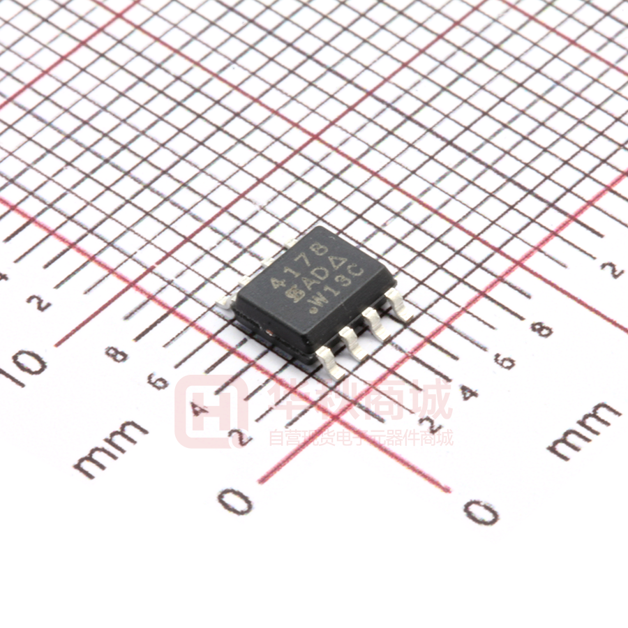

Si4178DY www.vishay.com Vishay Siliconix N-Channel 30 V (D-S) MOSFET FEATURES SO-8 Single D 8 D 7 D 6 D 5 • TrenchFET® power MOSFET • 100% Rg and UIS tested • Material categorization: for definitions of compliance please see www.vishay.com/doc?99912 Top View 1 S 2 S 3 S 4 G APPLICATIONS D • Notebook system power • Low current DC/DC PRODUCT SUMMARY VDS (V) RDS(on) max. () at VGS = 10 V 0.021 RDS(on) max. () at VGS = 4.5 V 0.033 Qg typ. (nC) 3.7 ID (A) a 12 Configuration G 30 S N-Channel MOSFET Single ORDERING INFORMATION Package SO-8 Lead (Pb)-free and halogen-free Si4178DY-T1-GE3 ABSOLUTE MAXIMUM RATINGS (TA = 25 °C, unless otherwise noted) PARAMETER SYMBOL LIMIT Drain-source voltage VDS 30 Gate-source voltage VGS ± 25 TC = 70 °C 9.7 a ID TA = 25 °C 8.3 b, c 6.7 b, c TA = 70 °C Pulsed drain current IDM TC = 25 °C Continuous source-drain diode current L = 0.1 mH Single pulse avalanche energy 4.2 2 b, c IAS 10 EAS 5 TC = 25 °C 3.2 PD TA = 25 °C W 2.4 b, c 1.5 b, c TA = 70 °C Operating junction and storage temperature range mJ 5 TC = 70 °C Maximum power dissipation A 40 IS TA = 25 °C Single pulse avalanche current V 12 a TC = 25 °C Continuous drain current (TJ = 150 °C) UNIT TJ, Tstg -55 to +150 °C THERMAL RESISTANCE RATINGS PARAMETER SYMBOL TYPICAL MAXIMUM Maximum junction-to-ambient b, d t  10 s RthJA 42 53 Maximum junction-to-foot (drain) Steady state RthJF 19 25 UNIT °C/W Notes a. Package limited b. Surface mounted on 1" x 1" FR4 board c. t = 10 s d. Maximum under steady state conditions is 85 °C/W S10-0212-Rev. A, 25-Jan-10 Document Number: 65718 1 For technical questions, contact: pmostechsupport@vishay.com THIS DOCUMENT IS SUBJECT TO CHANGE WITHOUT NOTICE. THE PRODUCTS DESCRIBED HEREIN AND THIS DOCUMENT ARE SUBJECT TO SPECIFIC DISCLAIMERS, SET FORTH AT www.vishay.com/doc?91000 Si4178DY www.vishay.com Vishay Siliconix SPECIFICATIONS (TJ = 25 °C, unless otherwise noted) PARAMETER SYMBOL TEST CONDITIONS MIN. TYP. MAX. UNIT VDS VGS = 0 V, ID = 250 μA 30 - - - V 25 - - -6 - Static Drain-source breakdown voltage VDS temperature coefficient VDS/TJ VGS(th) temperature coefficient VGS(th)/TJ Gate-source threshold voltage ID = 250 μA mV/°C VGS(th) VDS = VGS, ID = 250 μA 1.4 - 2.8 V Gate-source leakage IGSS VDS = 0 V, VGS = ± 25 V - - ± 100 nA Zero gate voltage drain current IDSS On-state drain current a ID(on) Drain-source on-state resistance a Forward transconductance a RDS(on) gfs VDS = 30 V, VGS = 0 V - - 1 VDS = 30 V, VGS = 0 V, TJ = 55 °C - - 10 VDS  5 V, VGS = 10 V 20 - - A  VGS = 10 V, ID = 8.4 A - 0.017 0.021 VGS = 4.5 V, ID = 2 A - 0.027 0.033 VDS = 15 V, ID = 8.4 A - 22 - - 405 - - 110 - - 56 - - 7.5 12 - 3.7 5.6 VDS = 15 V, VGS = 4.5 V, ID = 8.4 A - 1.6 - - 1.3 - f = 1 MHz 0.5 2.6 5.2 - 20 30 - 15 25 μA S Dynamic b Input capacitance Ciss Output capacitance Coss Reverse transfer capacitance Crss Total gate charge Qg Gate-source charge Qgs Gate-drain charge Qgd Gate resistance Rg Turn-on delay time Rise time Turn-off delay time Fall time Turn-on delay time Rise time Turn-off delay time Fall time VDS = 15 V, VGS = 0 V, f = 1 MHz VDS = 15 V, VGS = 10 V, ID = 8.4 A td(on) tr td(off) VDD = 15 V, RL = 2.2  ID  6.7 A, VGEN = 4.5 V, Rg = 1  - 11 20 tf - 10 15 td(on) - 7 15 tr td(off) VDD = 15 V, RL = 2.2  ID  6.7 A, VGEN = 10 V, Rg = 1  tf - 10 15 - 12 20 - 10 15 pF nC  ns Drain-Source Body Diode Characteristics Continuous source-drain diode current IS Pulse diode forward current ISM Body diode voltage VSD Body diode reverse recovery time trr Body diode reverse recovery charge Qrr Reverse recovery fall time ta Reverse recovery rise time tb TC = 25 °C IS = 6.7 A, VGS = 0 V IF = 6.7 A, di/dt = 100 A/μs, TJ = 25 °C - - 4.2 - - 40 - 0.85 1.2 V - 15 30 ns - 8 16 nC - 8.5 - - 6.5 - A ns Notes a. Pulse test; pulse width  300 μs, duty cycle  2% b. Guaranteed by design, not subject to production testing   Stresses beyond those listed under “Absolute Maximum Ratings” may cause permanent damage to the device. These are stress ratings only, and functional operation of the device at these or any other conditions beyond those indicated in the operational sections of the specifications is not implied. Exposure to absolute maximum rating conditions for extended periods may affect device reliability. S10-0212-Rev. A, 25-Jan-10 Document Number: 65718 2 For technical questions, contact: pmostechsupport@vishay.com THIS DOCUMENT IS SUBJECT TO CHANGE WITHOUT NOTICE. THE PRODUCTS DESCRIBED HEREIN AND THIS DOCUMENT ARE SUBJECT TO SPECIFIC DISCLAIMERS, SET FORTH AT www.vishay.com/doc?91000 Si4178DY www.vishay.com Vishay Siliconix TYPICAL CHARACTERISTICS (25 °C, unless otherwise noted) 40 10 8 I D - Drain Current (A) I D - Drain Current (A) V GS = 10 V thru 6 V 30 V GS = 5 V 20 6 T C = 25 °C 4 10 V GS = 4 V 2 T C = 125 °C V GS = 3 V 0 0.0 T C = - 55 °C 0 0.5 1.0 1.5 2.0 2.5 V DS - Drain-to-Source Voltage (V) 0 3.0 1 2 3 4 V GS - Gate-to-Source Voltage (V) Transfer Characteristics Output Characteristics 0.14 600 0.12 500 Ciss 0.10 C - Capacitance (pF) R DS(on) - On-Resistance (Ω) 5 0.08 V GS = 4.5 V 0.06 0.04 400 300 200 Coss V GS = 10 V 0.02 100 Crss 0 0.00 0 5 10 15 20 25 30 ID - Drain Current (A) 35 0 40 5 30 Capacitance On-Resistance vs. Drain Current 10 1.6 R DS(on) - On-Resistance (Normalized) ID = 8.4 A VGS - Gate-to-Source Voltage (V) 10 15 20 25 V DS - Drain-to-Source Voltage (V) V DS = 15 V 8 V DS = 7.5 V 6 V DS = 24 V 4 2 0 0 2 4 6 Qg - Total Gate Charge (nC) Gate Charge S10-0212-Rev. A, 25-Jan-10 8 V GS = 10 V; I D = 8.4 A 1.4 1.2 1.0 V GS = 4.5 V; I D = 8.4 A 0.8 0.6 - 50 - 25 0 25 50 75 100 T J - Junction Temperature (°C) 125 150 On-Resistance vs. Junction Temperature Document Number: 65718 3 For technical questions, contact: pmostechsupport@vishay.com THIS DOCUMENT IS SUBJECT TO CHANGE WITHOUT NOTICE. THE PRODUCTS DESCRIBED HEREIN AND THIS DOCUMENT ARE SUBJECT TO SPECIFIC DISCLAIMERS, SET FORTH AT www.vishay.com/doc?91000 Si4178DY www.vishay.com Vishay Siliconix TYPICAL CHARACTERISTICS (25 °C, unless otherwise noted) 0.050 100 T J = 150 °C R DS(on) - On-Resistance (Ω) I S - Source Current (A) 0.045 T J = 25 °C 10 0.040 ID = 2 A; T J = 125 °C 0.035 ID = 8.4 A; T J = 125 °C 0.030 ID = 8.4 A; T J = 25 °C 0.025 0.020 ID = 2 A; T J = 25 °C 0.015 1 0.0 0.010 0.2 0.4 0.6 0.8 1.0 1.2 V SD - Source-to-Drain Voltage (V) 0 1.4 2 4 6 8 10 V GS - Gate-to-Source Voltage (V) Source-Drain Diode Forward Voltage On-Resistance vs. Gate-to-Source Voltage 3.0 30 2.8 25 20 ID = 250 μA Power (W) VGS(th) (V) 2.6 2.4 2.2 15 10 2.0 5 1.8 1.6 - 50 - 25 0 25 50 75 100 T J - Temperature (°C) 125 0 0.001 150 0.01 Threshold Voltage 0.1 1 Time (s) 10 100 1000 Single Pulse Power 100 Limited by R DS(on)* I D - Drain Current (A) 10 100 μs 1 ms 1 10 ms 100 ms TA = 25 °C Single Pulse 1s 10 s 0.1 DC BVDSS Limited 0.01 0.1 1 10 100 V DS - Drain-to-Source Voltage (V) * V GS > minimum VGS at which RDS(on) is specified Safe Operating Area, Junction-to-Ambient S10-0212-Rev. A, 25-Jan-10 Document Number: 65718 4 For technical questions, contact: pmostechsupport@vishay.com THIS DOCUMENT IS SUBJECT TO CHANGE WITHOUT NOTICE. THE PRODUCTS DESCRIBED HEREIN AND THIS DOCUMENT ARE SUBJECT TO SPECIFIC DISCLAIMERS, SET FORTH AT www.vishay.com/doc?91000 Si4178DY www.vishay.com Vishay Siliconix 15 5 12 4 Package Limited 9 Power (W) I D - Drain Current (A) TYPICAL CHARACTERISTICS (25 °C, unless otherwise noted) 6 3 3 2 1 0 0 0 25 50 75 100 125 T C - Case Temperature (°C) Current Derating a 150 25 50 75 100 125 T C - Case Temperature (°C) 150 Power Derating Note a. The power dissipation PD is based on TJ max. = 150 °C, using junction-to-case thermal resistance, and is more useful in settling the upper dissipation limit for cases where additional heatsinking is used. It is used to determine the current rating, when this rating falls below the package limit S10-0212-Rev. A, 25-Jan-10 Document Number: 65718 5 For technical questions, contact: pmostechsupport@vishay.com THIS DOCUMENT IS SUBJECT TO CHANGE WITHOUT NOTICE. THE PRODUCTS DESCRIBED HEREIN AND THIS DOCUMENT ARE SUBJECT TO SPECIFIC DISCLAIMERS, SET FORTH AT www.vishay.com/doc?91000 Si4178DY www.vishay.com Vishay Siliconix TYPICAL CHARACTERISTICS (25 °C, unless otherwise noted) Normalized Effective Transient Thermal Impedance 1 Duty Cycle = 0.5 0.2 Notes: 0.1 0.1 PDM t1 t2 1. Duty Cycle, D = 0.05 t1 t2 2. Per Unit Base = R thJA = 85 °C/W 0.02 3. T JM - TA = PDMZthJA(t) Single Pulse 0.01 10 -4 4. Surface Mounted 10 -3 10 -2 10 -1 1 Square Wave Pulse Duration (s) 100 10 1000 Normalized Thermal Transient Impedance, Junction-to-Ambient 1 Normalized Effective Transient Thermal Impedance Duty Cycle = 0.5 0.2 0.1 0.1 0.05 0.02 Single Pulse 0.01 10 -4 10 -3 10 -2 10 -1 Square Wave Pulse Duration (s) 1 10 Normalized Thermal Transient Impedance, Junction-to-Foot                     Vishay Siliconix maintains worldwide manufacturing capability. Products may be manufactured at one of several qualified locations. Reliability data for silicon technology and package reliability represent a composite of all qualified locations. For related documents such as package / tape drawings, part marking, and reliability data, see www.vishay.com/ppg?65718. S10-0212-Rev. A, 25-Jan-10 Document Number: 65718 6 For technical questions, contact: pmostechsupport@vishay.com THIS DOCUMENT IS SUBJECT TO CHANGE WITHOUT NOTICE. THE PRODUCTS DESCRIBED HEREIN AND THIS DOCUMENT ARE SUBJECT TO SPECIFIC DISCLAIMERS, SET FORTH AT www.vishay.com/doc?91000 Package Information Vishay Siliconix SOIC (NARROW): 8-LEAD JEDEC Part Number: MS-012 8 6 7 5 E 1 3 2 H 4 S h x 45 D C 0.25 mm (Gage Plane) A e B All Leads q A1 L 0.004" MILLIMETERS INCHES DIM Min Max Min Max A 1.35 1.75 0.053 0.069 A1 0.10 0.20 0.004 0.008 B 0.35 0.51 0.014 0.020 C 0.19 0.25 0.0075 0.010 D 4.80 5.00 0.189 0.196 E 3.80 4.00 0.150 e 0.101 mm 1.27 BSC 0.157 0.050 BSC H 5.80 6.20 0.228 0.244 h 0.25 0.50 0.010 0.020 L 0.50 0.93 0.020 0.037 q 0° 8° 0° 8° S 0.44 0.64 0.018 0.026 ECN: C-06527-Rev. I, 11-Sep-06 DWG: 5498 Document Number: 71192 11-Sep-06 www.vishay.com 1 Application Note 826 Vishay Siliconix RECOMMENDED MINIMUM PADS FOR SO-8 0.172 (4.369) 0.028 0.022 0.050 (0.559) (1.270) 0.152 (3.861) 0.047 (1.194) 0.246 (6.248) (0.711) Recommended Minimum Pads Dimensions in Inches/(mm) Return to Index APPLICATION NOTE Return to Index www.vishay.com 22 Document Number: 72606 Revision: 21-Jan-08 Legal Disclaimer Notice www.vishay.com Vishay Disclaimer ALL PRODUCT, PRODUCT SPECIFICATIONS AND DATA ARE SUBJECT TO CHANGE WITHOUT NOTICE TO IMPROVE RELIABILITY, FUNCTION OR DESIGN OR OTHERWISE. Vishay Intertechnology, Inc., its affiliates, agents, and employees, and all persons acting on its or their behalf (collectively, “Vishay”), disclaim any and all liability for any errors, inaccuracies or incompleteness contained in any datasheet or in any other disclosure relating to any product. Vishay makes no warranty, representation or guarantee regarding the suitability of the products for any particular purpose or the continuing production of any product. To the maximum extent permitted by applicable law, Vishay disclaims (i) any and all liability arising out of the application or use of any product, (ii) any and all liability, including without limitation special, consequential or incidental damages, and (iii) any and all implied warranties, including warranties of fitness for particular purpose, non-infringement and merchantability. Statements regarding the suitability of products for certain types of applications are based on Vishay's knowledge of typical requirements that are often placed on Vishay products in generic applications. Such statements are not binding statements about the suitability of products for a particular application. It is the customer's responsibility to validate that a particular product with the properties described in the product specification is suitable for use in a particular application. Parameters provided in datasheets and / or specifications may vary in different applications and performance may vary over time. All operating parameters, including typical parameters, must be validated for each customer application by the customer's technical experts. Product specifications do not expand or otherwise modify Vishay's terms and conditions of purchase, including but not limited to the warranty expressed therein. Hyperlinks included in this datasheet may direct users to third-party websites. These links are provided as a convenience and for informational purposes only. Inclusion of these hyperlinks does not constitute an endorsement or an approval by Vishay of any of the products, services or opinions of the corporation, organization or individual associated with the third-party website. Vishay disclaims any and all liability and bears no responsibility for the accuracy, legality or content of the third-party website or for that of subsequent links. Except as expressly indicated in writing, Vishay products are not designed for use in medical, life-saving, or life-sustaining applications or for any other application in which the failure of the Vishay product could result in personal injury or death. Customers using or selling Vishay products not expressly indicated for use in such applications do so at their own risk. Please contact authorized Vishay personnel to obtain written terms and conditions regarding products designed for such applications. No license, express or implied, by estoppel or otherwise, to any intellectual property rights is granted by this document or by any conduct of Vishay. Product names and markings noted herein may be trademarks of their respective owners. © 2022 VISHAY INTERTECHNOLOGY, INC. ALL RIGHTS RESERVED Revision: 01-Jan-2022 1 Document Number: 91000

物料型号:Si4178DY 器件简介:N-Channel 30 V (D-S) MOSFET,使用TrenchFET®技术,100% Rg和UIS测试,符合RoHS标准,无卤素。
引脚分配:D(漏极)1-4,S(源极)5-8,G(栅极)6-7。
参数特性:VDS(漏源电压)30V,RDS(on)最大值(在VGS=10V和4.5V时分别为0.021Ω和0.033Ω),Qg(栅电荷)典型值3.7nC,ID(漏电流)最大12A。
功能详解:适用于笔记本电脑电源系统和低电流DC/DC转换器。
应用信息:用于笔记本电脑系统电源和低电流DC/DC转换器。
封装信息:SO-8封装,无铅和无卤素,型号为Si4178DY-T1-GE3。
