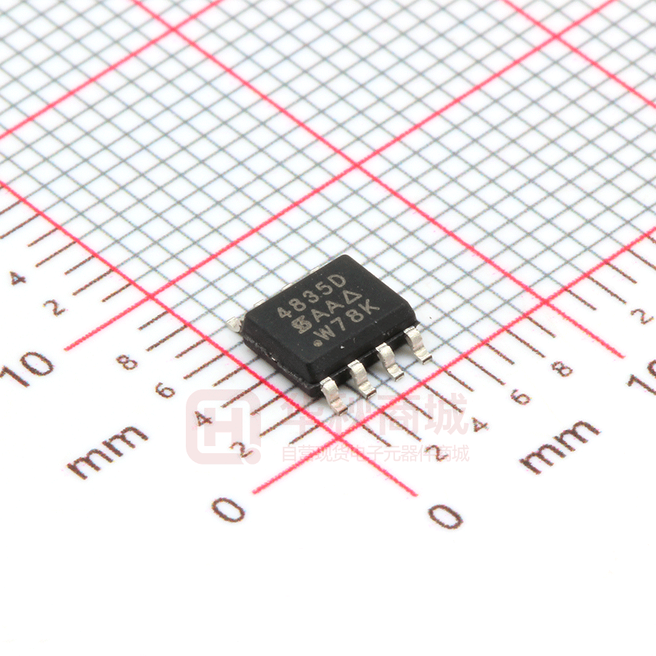

    类型:P沟道 漏源电压(Vdss):30V 连续漏极电流(Id):13A 功率(Pd):5.6W 导通电阻(RDS(on)@Vgs,Id):18mΩ@10V,10A 阈值电压(Vgs(th)@Id):...
SI4835DDY-T1-GE3 数据手册
New Product Si4835DDY Vishay Siliconix P-Channel 30-V (D-S) MOSFET FEATURES PRODUCT SUMMARY VDS (V) - 30 RDS(on) (Ω) ID (A)d 0.018 at VGS = - 10 V - 13 0.030 at VGS = - 4.5 V - 10 • Halogen-free According to IEC 61249-2-21 Available • TrenchFET® Power MOSFET • 100 % Rg Tested • 100 % UIS Tested Qg (Typ.) 22 nC APPLICATIONS • Load Switches - Notebook PCs - Desktop PCs SO-8 S S 1 8 D S 2 7 D S 3 6 D G 4 5 D G Top View D Ordering Information: Si4835DDY-T1-E3 (Lead (Pb)-free) Si4835DDY-T1-GE3 (Lead (Pb)-free and Halogen-free) P-Channel MOSFET ABSOLUTE MAXIMUM RATINGS TA = 25 °C, unless otherwise noted Parameter Drain-Source Voltage Gate-Source Voltage Continuous Drain Current (TJ = 150 °C) Symbol VDS VGS TC = 25 °C TC = 70 °C TA = 25 °C TA = 70 °C Limit - 30 ± 25 ID Continuous Source-Drain Diode Current TC = 25 °C TA = 25 °C IS Avalanche Current Single-Pulse Avalanche Energy L = 0.1 mH IAS EAS Maximum Power Dissipation TC = 25 °C TC = 70 °C TA = 25 °C TA = 70 °C PD 2.0a, b - 20 20 5.6 3.6 2.5a, b 1.6a, b - 55 to 150 TJ, Tstg Operating Junction and Storage Temperature Range V - 13 - 10.5 - 8.7a, b - 7.7a, b - 50 - 4.6 IDM Pulsed Drain Current Unit A mJ W °C THERMAL RESISTANCE RATINGS Parameter Maximum Junction-to-Ambienta, c Maximum Junction-to-Foot t ≤ 10 s Steady State Symbol RthJA RthJF Typical 39 18 Maximum 50 22 Unit °C/W Notes: a. Surface mounted on 1" x 1" FR4 board. b. t = 10 s. c. Maximum under Steady State conditions is 85 °C/W. d. Based on TC = 25 °C. Document Number: 69953 S09-0136-Rev. B, 02-Feb-09 www.vishay.com 1 New Product Si4835DDY Vishay Siliconix SPECIFICATIONS TJ = 25 °C, unless otherwise noted Parameter Symbol Test Conditions Min. VDS VGS = 0 V, ID = - 250 µA - 30 Typ. Max. Unit Static Drain-Source Breakdown Voltage VDS Temperature Coefficient ΔVDS/TJ VGS(th) Temperature Coefficient ΔVGS(th)/TJ ID = - 250 µA Gate-Source Threshold Voltage VGS(th) VDS = VGS, ID = - 250 µA Gate-Source Leakage IGSS VDS = 0 V, VGS = ± 25 V Zero Gate Voltage Drain Current IDSS On-State Drain Currenta ID(on) Drain-Source On-State Resistancea Forward Transconductancea RDS(on) gfs Dynamicb Input Capacitance Ciss Output Capacitance Coss Reverse Transfer Capacitance Crss Total Gate Charge Qg Gate-Source Charge Qgs Gate-Drain Charge Qgd Gate Resistance Rg Turn-On Delay Time Rise Time Turn-Off DelayTime Fall Time Turn-On Delay Time Rise Time Turn-Off DelayTime Fall Time mV/°C 5.5 - 1.0 - 3.0 V ± 100 nA VDS = - 30 V, VGS = 0 V -1 VDS = - 30 V, VGS = 0 V, TJ = 55 °C -5 VDS ≥ - 10 V, VGS = - 10 V VGS = - 10 V, ID = - 10 A - 30 0.018 VGS = - 4.5 V, ID = - 7 A 0.0245 0.030 VDS = - 10 V, ID = - 10 A 23 1960 VDS = - 15 V, VGS = 0 V, f = 1 MHz 380 pF 325 VDS = - 15 V, VGS = - 10 V, ID = - 10 A VDS = - 15 V, VGS = - 4.5 V, ID = - 10 A 43 65 22 33 6 VDD = - 15 V, RL = 3 Ω ID ≅ - 5 A, VGEN = - 10 V, Rg = 1 Ω 0.3 1.3 2.5 11 22 25 50 tf 9 18 td(on) 44 70 100 160 28 50 15 30 tr nC 11 f = 1 MHz 13 td(off) Ω S 32 td(off) µA A 0.014 td(on) tr V - 31 VDD = - 15 V, RL = 3 Ω ID ≅ - 5 A, VGEN = - 4.5 V, Rg = 1 Ω tf Ω ns Drain-Source Body Diode Characteristics Continuous Source-Drain Diode Current IS Pulse Diode Forward Current ISM Body Diode Voltage VSD Body Diode Reverse Recovery Time trr Body Diode Reverse Recovery Charge Qrr Reverse Recovery Fall Time ta Reverse Recovery Rise Time tb TC = 25 °C - 4.6 - 50 IS = - 2 A, VGS = 0 V IF = - 2 A, dI/dt = 100 A/µs, TJ = 25 °C A - 0.75 - 1.2 V 28 45 ns 20 40 nC 13 15 ns Notes: a. Pulse test; pulse width ≤ 300 µs, duty cycle ≤ 2 %. b. Guaranteed by design, not subject to production testing. Stresses beyond those listed under “Absolute Maximum Ratings” may cause permanent damage to the device. These are stress ratings only, and functional operation of the device at these or any other conditions beyond those indicated in the operational sections of the specifications is not implied. Exposure to absolute maximum rating conditions for extended periods may affect device reliability. www.vishay.com 2 Document Number: 69953 S09-0136-Rev. B, 02-Feb-09 New Product Si4835DDY Vishay Siliconix TYPICAL CHARACTERISTICS 25 °C, unless otherwise noted 60 5 VGS = 10 V thru 5 V 4 I D - Drain Current (A) I D - Drain Current (A) 50 40 30 VGS = 4 V 20 3 2 VGS = 125 °C 1 10 VGS = 25 °C VGS = 3 V VGS = - 55 °C 0 0 0 1 2 3 4 5 0 1 VDS - Drain-to-Source Voltage (V) 0.05 3000 0.04 2400 5 Ciss C - Capacitance (pF) R DS(on) - On-Resistance (Ω) 4 Transfer Characteristics VGS = 4.5 V 0.02 VGS = 10 V 1800 1200 0.01 600 Coss Crss 0.00 0 0 10 20 30 40 50 60 0 6 ID - Drain Current (A) 12 18 24 30 VDS - Drain-to-Source Voltage (V) On-Resistance vs. Drain Current Capacitance 10 1.6 VDS = 10 V ID = 10 A ID = 10 A 8 VGS = - 10 V VDS = 15 V 6 VDS = 20 V 4 2 (Normalized) 1.4 R DS(on) - On-Resistance VGS - Gate-to-Source Voltage (V) 3 VGS - Gate-to-Source Voltage (V) Output Characteristics 0.03 2 1.2 VGS = - 4.5 V 1.0 0.8 0 0 10 20 30 Qg - Total Gate Charge (nC) Gate Charge Document Number: 69953 S09-0136-Rev. B, 02-Feb-09 40 50 0.6 - 50 - 25 0 25 50 75 100 125 150 TJ - Junction Temperature (°C) On-Resistance vs. Junction Temperature www.vishay.com 3 New Product Si4835DDY Vishay Siliconix TYPICAL CHARACTERISTICS 25 °C, unless otherwise noted 100 0.10 ID = 10 A TJ = 150 °C R DS(on) - On-Resistance (Ω) I S - Source Current (A) 10 TJ = 25 °C 1 0.1 0.01 0.001 0.0 0.08 0.06 0.04 TJ = 125 °C 0.02 TJ = 25 °C 0.00 0.2 0.4 0.6 0.8 1.0 1.2 0 2 VSD - Source-to-Drain Voltage (V) 6 8 10 VGS - Gate-to-Source Voltage (V) Source-Drain Diode Forward Voltage On-Resistance vs. Gate-to-Source Voltage 50 0.8 ID = 5 mA 0.6 40 0.4 0.2 30 Power (W) VGS(th) Variance (V) 4 ID = 250 µA 20 0.0 10 - 0.2 - 0.4 - 50 - 25 0 25 50 75 100 125 0 0.001 150 0.01 0.1 1 10 100 1000 Time (s) TJ - Temperature (°C) Threshold Voltage Single Pulse Power, Junction-to-Ambient 100 I D - Drain Current (A) Limited by R DS(on)* 10 1 ms 10 ms 1 100 ms 1s 10 s 0.1 DC TA = 25 °C Single Pulse 0.01 0.01 0.1 1 10 100 VDS - Drain-to-Source Voltage (V) * VGS > minimum VGS at which R DS(on) is specified Safe Operating Area www.vishay.com 4 Document Number: 69953 S09-0136-Rev. B, 02-Feb-09 New Product Si4835DDY Vishay Siliconix TYPICAL CHARACTERISTICS 25 °C, unless otherwise noted 15 I D - Drain Current (A) 12 9 6 3 0 0 25 50 75 100 125 150 TC - Case Temperature (°C) 7.0 2.0 5.6 1.6 Power Dissipation (W) Power Dissipation (W) Current Derating* 4.2 2.8 1.4 1.2 0.8 0.4 0.0 0.0 0 25 50 75 100 TC - Case Temperature (°C) Power, Junction-to-Foot 125 150 0 25 50 75 100 125 150 TA - Ambient Temperature (°C) Power Derating, Junction-to-Ambient * The power dissipation PD is based on TJ(max) = 150 °C, using junction-to-case thermal resistance, and is more useful in settling the upper dissipation limit for cases where additional heatsinking is used. It is used to determine the current rating, when this rating falls below the package limit. Document Number: 69953 S09-0136-Rev. B, 02-Feb-09 www.vishay.com 5 New Product Si4835DDY Vishay Siliconix TYPICAL CHARACTERISTICS 25 °C, unless otherwise noted 1 Normalized Effective Transient Thermal Impedance Duty Cycle = 0.5 0.2 0.1 Notes: 0.1 PDM 0.05 t1 t2 1. Duty Cycle, D = 0.02 t1 t2 2. Per Unit Base = RthJA = 85 °C/W 3. TJM - TA = PDMZthJA(t) 4. Surface Mounted Single Pulse 0.01 10 -4 10 -3 10 -2 10 -1 1 Square Wave Pulse Duration (s) 100 10 1000 Normalized Thermal Transient Impedance, Junction-to-Ambient Normalized Effective Transient Thermal Impedance 1 Duty Cycle = 0.5 0.2 0.1 0.1 0.05 0.02 Single Pulse 0.01 10 -4 10 -3 10 -2 10 -1 Square Wave Pulse Duration (s) 1 10 Normalized Thermal Transient Impedance, Junction-to-Foot Vishay Siliconix maintains worldwide manufacturing capability. Products may be manufactured at one of several qualified locations. Reliability data for Silicon Technology and Package Reliability represent a composite of all qualified locations. For related documents such as package/tape drawings, part marking, and reliability data, see www.vishay.com/ppg?69953. www.vishay.com 6 Document Number: 69953 S09-0136-Rev. B, 02-Feb-09 Package Information Vishay Siliconix SOIC (NARROW): 8-LEAD JEDEC Part Number: MS-012 8 6 7 5 E 1 3 2 H 4 S h x 45 D C 0.25 mm (Gage Plane) A e B All Leads q A1 L 0.004" MILLIMETERS INCHES DIM Min Max Min Max A 1.35 1.75 0.053 0.069 A1 0.10 0.20 0.004 0.008 B 0.35 0.51 0.014 0.020 C 0.19 0.25 0.0075 0.010 D 4.80 5.00 0.189 0.196 E 3.80 4.00 0.150 e 0.101 mm 1.27 BSC 0.157 0.050 BSC H 5.80 6.20 0.228 0.244 h 0.25 0.50 0.010 0.020 L 0.50 0.93 0.020 0.037 q 0° 8° 0° 8° S 0.44 0.64 0.018 0.026 ECN: C-06527-Rev. I, 11-Sep-06 DWG: 5498 Document Number: 71192 11-Sep-06 www.vishay.com 1 Application Note 826 Vishay Siliconix RECOMMENDED MINIMUM PADS FOR SO-8 0.172 (4.369) 0.028 0.022 0.050 (0.559) (1.270) 0.152 (3.861) 0.047 (1.194) 0.246 (6.248) (0.711) Recommended Minimum Pads Dimensions in Inches/(mm) Return to Index APPLICATION NOTE Return to Index www.vishay.com 22 Document Number: 72606 Revision: 21-Jan-08 Legal Disclaimer Notice www.vishay.com Vishay Disclaimer  ALL PRODUCT, PRODUCT SPECIFICATIONS AND DATA ARE SUBJECT TO CHANGE WITHOUT NOTICE TO IMPROVE RELIABILITY, FUNCTION OR DESIGN OR OTHERWISE. Vishay Intertechnology, Inc., its affiliates, agents, and employees, and all persons acting on its or their behalf (collectively, “Vishay”), disclaim any and all liability for any errors, inaccuracies or incompleteness contained in any datasheet or in any other disclosure relating to any product. Vishay makes no warranty, representation or guarantee regarding the suitability of the products for any particular purpose or the continuing production of any product. To the maximum extent permitted by applicable law, Vishay disclaims (i) any and all liability arising out of the application or use of any product, (ii) any and all liability, including without limitation special, consequential or incidental damages, and (iii) any and all implied warranties, including warranties of fitness for particular purpose, non-infringement and merchantability. Statements regarding the suitability of products for certain types of applications are based on Vishay’s knowledge of typical requirements that are often placed on Vishay products in generic applications. Such statements are not binding statements about the suitability of products for a particular application. It is the customer’s responsibility to validate that a particular product with the properties described in the product specification is suitable for use in a particular application. Parameters provided in datasheets and / or specifications may vary in different applications and performance may vary over time. All operating parameters, including typical parameters, must be validated for each customer application by the customer’s technical experts. Product specifications do not expand or otherwise modify Vishay’s terms and conditions of purchase, including but not limited to the warranty expressed therein. Except as expressly indicated in writing, Vishay products are not designed for use in medical, life-saving, or life-sustaining applications or for any other application in which the failure of the Vishay product could result in personal injury or death. Customers using or selling Vishay products not expressly indicated for use in such applications do so at their own risk. Please contact authorized Vishay personnel to obtain written terms and conditions regarding products designed for such applications. No license, express or implied, by estoppel or otherwise, to any intellectual property rights is granted by this document or by any conduct of Vishay. Product names and markings noted herein may be trademarks of their respective owners. © 2017 VISHAY INTERTECHNOLOGY, INC. ALL RIGHTS RESERVED Revision: 08-Feb-17 1 Document Number: 91000
