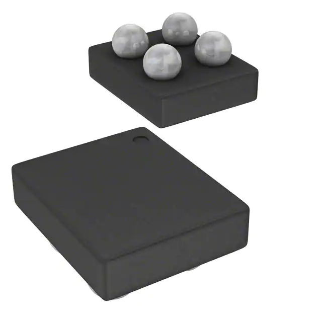

Si8805EDB www.vishay.com Vishay Siliconix P-Channel 8 V (D-S) MOSFET FEATURES PRODUCT SUMMARY RDS(on) (Ω) ID (A) a 0.068 at VGS = -4.5 V -3.1 0.088 at VGS = -2.5 V -2.7 0.155 at VGS = -1.5 V -2.1 0.290 at VGS = -1.2 V -0.5 VDS (V) -8 MICRO FOOT® 0.8 x 0.8 S 3 xxx xx • Ultra small 0.8 mm x 0.8 mm outline • Ultra thin 0.357 mm height 6.7 nC • Typical ESD protection 1500 V HBM • Material categorization: for definitions of compliance please see www.vishay.com/doc?99912 APPLICATIONS S 2 • Portable devices such as cell phones, smart phones, tablet PCs, and media players S - Load switch for low voltage gate drive 8 0. m m 1 • TrenchFET® power MOSFET Qg (TYP.) mm 0.8 Backside View 1 G - Load switch for 1.2 V power line G 4 D Bump Side View Marking Code: xx = AC xxx = Date/Lot traceability code Ordering Information: Si8805EDB-T2-E1 (lead (Pb)-free and halogen-free) D P-Channel MOSFET ABSOLUTE MAXIMUM RATINGS (TA = 25 °C, unless otherwise noted) PARAMETER SYMBOL LIMIT Drain-Source Voltage VDS -8 Gate-Source Voltage VGS ±5 TA = 70 °C TA = 25 °C -2.5 a ID -2.2 b -1.8 b TA = 70 °C Pulsed Drain Current Continuous Source-Drain Diode Current IDM TA = 25 °C TA = 25 °C TA = 70 °C TA = 25 °C -0.7 a IS -0.4 b 0.9 a 0.6 a PD W 0.5 b 0.3 b TA = 70 °C Operating Junction and Storage Temperature Range A -15 TA = 25 °C Maximum Power Dissipation V -3.1 a TA = 25 °C Continuous Drain Current (TJ = 150 °C) UNIT TJ, Tstg -55 to +150 Soldering Recommendations (Peak Temperature) c °C 260 THERMAL RESISTANCE RATINGS PARAMETER Maximum Junction-to-Ambient a, d Maximum Junction-to-Ambient b, e SYMBOL t≤5s RthJA TYPICAL MAXIMUM 105 135 200 260 UNIT °C/W Notes a. Surface mounted on 1" x 1" FR4 board with full copper, t = 5 s. b. Surface mounted on 1" x 1" FR4 board with minimum copper, t = 5 s. c. Refer to IPC/JEDEC® (J-STD-020), no manual or hand soldering. d. Maximum under steady state conditions is 185 °C/W. e. Maximum under steady state conditions is 330 °C/W. S15-0346-Rev. C, 23-Feb-15 Document Number: 67935 1 For technical questions, contact: pmostechsupport@vishay.com THIS DOCUMENT IS SUBJECT TO CHANGE WITHOUT NOTICE. THE PRODUCTS DESCRIBED HEREIN AND THIS DOCUMENT ARE SUBJECT TO SPECIFIC DISCLAIMERS, SET FORTH AT www.vishay.com/doc?91000 Si8805EDB www.vishay.com Vishay Siliconix SPECIFICATIONS (TJ = 25 °C, unless otherwise noted) PARAMETER SYMBOL TEST CONDITIONS MIN. TYP. MAX. UNIT VDS VGS = 0 V, ID = -250 μA -8 - - - V -4 - - 2.1 - -0.35 - -0.7 ± 1.5 Static Drain-Source Breakdown Voltage VDS Temperature Coefficient ΔVDS/TJ ID = -250 μA VGS(th) Temperature Coefficient ΔVGS(th)/TJ Gate-Source Threshold Voltage VGS(th) VDS = VGS , ID = -250 μA IGSS VDS = 0 V, VGS = ± 5 V - - VDS = -8 V, VGS = 0 V - - -1 VDS = -8 V, VGS = 0 V, TJ = 55 °C - - -10 Gate-Source Leakage Zero Gate Voltage Drain Current IDSS On-State Drain Current a ID(on) Drain-Source On-State Resistance a Forward Transconductance a RDS(on) gfs VDS ≤ -4 V, VGS = -4.5 V -5 - - VGS = -4.5 V, ID = -1.5 A - 0.056 0.068 VGS = -2.5 V, ID = -1.5 A - 0.070 0.088 VGS = -1.5 V, ID = -0.5 A - 0.115 0.155 VGS = -1.2 V, ID = -0.3 A - 0.190 0.290 VDS = -4 V, ID = -1.5 A - 8 - - 6.7 10 - 0.7 - - 1.8 - mV/°C V μA A Ω S Dynamic b Total Gate Charge Qg Gate-Source Charge Qgs Gate-Drain Charge Qgd Gate Resistance Turn-On Delay Time Rise Time Turn-Off Delay Time Fall Time Rg VDS = -4 V, VGS = -4.5 V, ID = -1.5 A f = 1 MHz td(on) tr td(off) VDD = -4 V, RL = 2.7 Ω ID ≅ -1.5 A, VGEN = -4.5 V, Rg = 1 Ω tf nC Ω - 10 - - 13 25 - 13 25 - 25 50 - 17 35 - - -0.7 - - -15 - -0.8 -1.2 V - 35 70 ns - 15 30 nC - 15 - - 20 - ns Drain-Source Body Diode Characteristics Continuous Source-Drain Diode Current IS Pulse Diode Forward Current ISM Body Diode Voltage VSD Body Diode Reverse Recovery Time trr Body Diode Reverse Recovery Charge Qrr Reverse Recovery Fall Time ta Reverse Recovery Rise Time tb TC = 25 °C IS = -1.5 A, VGS = 0 V IF = -1.5 A, dI/dt = 100 A/μs, TJ = 25 °C A ns Notes a. Pulse test; pulse width ≤ 300 μs, duty cycle ≤ 2 %. b. Guaranteed by design, not subject to production testing. Stresses beyond those listed under “Absolute Maximum Ratings” may cause permanent damage to the device. These are stress ratings only, and functional operation of the device at these or any other conditions beyond those indicated in the operational sections of the specifications is not implied. Exposure to absolute maximum rating conditions for extended periods may affect device reliability. S15-0346-Rev. C, 23-Feb-15 Document Number: 67935 2 For technical questions, contact: pmostechsupport@vishay.com THIS DOCUMENT IS SUBJECT TO CHANGE WITHOUT NOTICE. THE PRODUCTS DESCRIBED HEREIN AND THIS DOCUMENT ARE SUBJECT TO SPECIFIC DISCLAIMERS, SET FORTH AT www.vishay.com/doc?91000 Si8805EDB www.vishay.com Vishay Siliconix TYPICAL CHARACTERISTICS (25 °C, unless otherwise noted) 10-2 3.0 10-3 2.5 IGSS - Gate Current (A) IGSS - Gate Current (mA) 10-4 2.0 TJ = 25 °C 1.5 1.0 0.5 TJ = 150 °C 10-5 10-6 TJ = 25 °C -7 10 10-8 10-9 10-10 0 0 3 6 9 12 0 15 3 6 9 12 15 VGS - Gate-to-Source Voltage (V) VGS - Gate-Source Voltage (V) Gate Current vs. Gate-Source Voltage Gate Current vs. Gate-Source Voltage 15 15 VGS = 5 V thru 2.5 V 12 VGS = 2 V ID - Drain Current (A) ID - Drain Current (A) 12 9 6 VGS = 1.5 V 9 6 TC = 25 °C 3 3 TC = 125 °C VGS = 1 V 0 0.5 1 1.5 2 2.5 0 3 0.5 1 1.5 2 VDS - Drain-to-Source Voltage (V) VGS - Gate-to-Source Voltage (V) Output Characteristics Transfer Characteristics 2.5 1000 0.30 0.25 800 C - Capacitance (pF) RDS(on) - On-Resistance (Ω) TC = - 55 °C 0 0 VGS = 1.2 V 0.20 VGS = 1.5 V 0.15 VGS = 1.8 V VGS = 2.5 V 0.10 600 Ciss 400 Coss Crss 200 0.05 VGS = 4.5 V 0 0 0 3 6 9 12 15 0 2 4 6 ID - Drain Current (A) VDS - Drain-to-Source Voltage (V) On-Resistance vs. Drain Current Capacitance S15-0346-Rev. C, 23-Feb-15 8 Document Number: 67935 3 For technical questions, contact: pmostechsupport@vishay.com THIS DOCUMENT IS SUBJECT TO CHANGE WITHOUT NOTICE. THE PRODUCTS DESCRIBED HEREIN AND THIS DOCUMENT ARE SUBJECT TO SPECIFIC DISCLAIMERS, SET FORTH AT www.vishay.com/doc?91000 Si8805EDB www.vishay.com Vishay Siliconix TYPICAL CHARACTERISTICS (25 °C, unless otherwise noted) 5 14 VDS = 2 V 12 4 10 3 Power (W) VGS - Gate-to-Source Voltage (V) ID = 1.5 A VDS = 4 V VDS = 6.4 V 2 6 4 1 2 0 0 2 4 6 0 0.001 8 0.01 1 10 100 1000 Time (s) Gate Charge Single Pulse Power (Junction-to-Ambient) 100 VGS = 1.8 V, 1.5 V, ID = 0.5 A 1.3 1.2 IS - Source Current (A) VGS = 2.5 V, ID = 1.5 A VGS = 4.5 V, ID = 1.5 A 1.1 1.0 VGS = 1.2 V, ID = 0.5 A 0.9 10 TJ = 150 °C 1 TJ = 25 °C 0.8 0.7 - 50 0.1 - 25 0 25 50 75 100 125 0.0 150 0.2 TJ - Junction Temperature (°C) 0.4 0.6 0.8 1.0 1.2 VSD - Source-to-Drain Voltage (V) Source-Drain Diode Forward Voltage On-Resistance vs. Junction Temperature 0.25 0.7 0.20 0.6 ID = 1.5 A; TJ = 25 °C 0.15 VGS(th) (V) RDS(on) - On-Resistance (Ω) 0.1 Qg - Total Gate Charge (nC) 1.4 RDS(on) - On-Resistance (Normalized) 8 ID = 0.3 A; TJ = 125 °C ID = 1.5 A; TJ = 125 °C 0.10 0.5 0.4 ID = 250 μA ID = 0.3 A; TJ = 25 °C 0.3 0.05 0 0 1 2 3 4 5 0.2 - 50 - 25 0 25 50 75 100 VGS - Gate-to-Source Voltage (V) TJ - Temperature (°C) On-Resistance vs. Gate-to-Source Voltage Threshold Voltage S15-0346-Rev. C, 23-Feb-15 125 150 Document Number: 67935 4 For technical questions, contact: pmostechsupport@vishay.com THIS DOCUMENT IS SUBJECT TO CHANGE WITHOUT NOTICE. THE PRODUCTS DESCRIBED HEREIN AND THIS DOCUMENT ARE SUBJECT TO SPECIFIC DISCLAIMERS, SET FORTH AT www.vishay.com/doc?91000 Si8805EDB www.vishay.com Vishay Siliconix TYPICAL CHARACTERISTICS (25 °C, unless otherwise noted) 100 Limited by RDS(on)* 10 ID - Drain Current (A) 100 µs 1 ms 1 10 ms 0.1 TA = 25 °C 10 s, 1 s, 100 ms DC BVDSS Limited 0.01 0.1 1 10 VDS - Drain-to-Source Voltage (V) * VGS > minimum VGS at which RDS(on) is specified 100 Safe Operating Area, Junction-to-Ambient 3 0.8 Power (W) ID - Drain Current (A) 0.6 2 0.4 1 0.2 0 0 0 25 50 75 100 125 150 25 50 75 100 125 TA - Ambient Temperature (°C) TA - Ambient Temperature (°C) Current Derating* Power Derating 150 Note When mounted on 1" x 1" FR4 with full copper. * The power dissipation PD is based on TJ (max.) = 150 °C, using junction-to-case thermal resistance, and is more useful in settling the upper dissipation limit for cases where additional heatsinking is used. It is used to determine the current rating, when this rating falls below the package limit. S15-0346-Rev. C, 23-Feb-15 Document Number: 67935 5 For technical questions, contact: pmostechsupport@vishay.com THIS DOCUMENT IS SUBJECT TO CHANGE WITHOUT NOTICE. THE PRODUCTS DESCRIBED HEREIN AND THIS DOCUMENT ARE SUBJECT TO SPECIFIC DISCLAIMERS, SET FORTH AT www.vishay.com/doc?91000 Si8805EDB www.vishay.com Vishay Siliconix TYPICAL CHARACTERISTICS (25 °C, unless otherwise noted) 1 Normalized Effective Transient Thermal Impedance Duty Cycle = 0.5 0.2 0.1 Notes: 0.05 PDM 0.1 t1 t2 1. Duty Cycle, D = 0.02 t1 t2 2. Per Unit Base = R thJA = 185 °C/W 3. T JM - T A = PDMZthJA(t) Single Pulse 0.01 10 -4 4. Surface Mounted 10 -3 10 -2 10 -1 1 100 10 1000 Square Wave Pulse Duration (s) Normalized Thermal Transient Impedance, Junction-to-Ambient (On 1" x 1" FR4 Board with Maximum Copper) 1 Normalized Effective Transient Thermal Impedance Duty Cycle = 0.5 0.2 0.1 Notes: 0.05 PDM 0.1 t1 t2 1. Duty Cycle, D = 0.02 t1 t2 2. Per Unit Base = R thJA = 330 °C/W 3. T JM - TA = PDMZthJA(t) Single Pulse 0.01 10 -4 10 -3 4. Surface Mounted 10 -2 10 -1 1 10 100 1000 Square Wave Pulse Duration (s) Normalized Thermal Transient Impedance, Junction-to-Ambient (On 1" x 1" FR4 Board with Minimum Copper) Vishay Siliconix maintains worldwide manufacturing capability. Products may be manufactured at one of several qualified locations. Reliability data for Silicon Technology and Package Reliability represent a composite of all qualified locations. For related documents such as package/tape drawings, part marking, and reliability data, see www.vishay.com/ppg?67935. S15-0346-Rev. C, 23-Feb-15 Document Number: 67935 6 For technical questions, contact: pmostechsupport@vishay.com THIS DOCUMENT IS SUBJECT TO CHANGE WITHOUT NOTICE. THE PRODUCTS DESCRIBED HEREIN AND THIS DOCUMENT ARE SUBJECT TO SPECIFIC DISCLAIMERS, SET FORTH AT www.vishay.com/doc?91000 Package Information www.vishay.com Vishay Siliconix MICRO FOOT®: 4-Bump (0.8 mm x 0.8 mm, 0.4 mm Pitch) D S e S e XXX S D S S 4x Ø b G D S AK Mark on Backside of die A2 4-Ø 0.205 to 0.225 Note 5 Solder Mask ~Ø 0.215 A1 A e b k b1 e Bump Note 2 Note 4 Notes (1) Laser mark on the backside surface of die (2) Bumps are 95.5 % Sn,3.8 % Ag,0.7 % Cu (3) “i” is the location of pin 1 (4) “b1” is the diameter of the solderable substrate surface, defined by an opening in the solder resist layer solder mask defined. (5) Non-solder mask defined copper landing pad. DIM. MILLIMETERS a INCHES MIN. NOM. MAX. MIN. NOM. MAX. A 0.328 0.365 0.402 0.0129 0.0144 0.0158 A1 0.136 0.160 0.184 0.0053 0.0062 0.0072 A2 0.192 0.205 0.218 0.0076 0.0081 0.0086 b 0.200 0.220 0.240 0.0078 0.0086 0.0094 b1 0.175 0.0068 e 0.400 0.0157 S 0.160 0.180 0.200 0.0062 0.0070 0.0078 D 0.720 0.760 0.800 0.0283 0.0299 0.0314 K 0.040 0.070 0.100 0.0015 0.0027 0.0039 Note a. Use millimeters as the primary measurement. ECN: T15-0053-Rev. A, 16-Feb-15 DWG: 6033 Revision: 16-Feb-15 1 Document Number: 69442 THIS DOCUMENT IS SUBJECT TO CHANGE WITHOUT NOTICE. THE PRODUCTS DESCRIBED HEREIN AND THIS DOCUMENT ARE SUBJECT TO SPECIFIC DISCLAIMERS, SET FORTH AT www.vishay.com/doc?91000 Legal Disclaimer Notice www.vishay.com Vishay Disclaimer  ALL PRODUCT, PRODUCT SPECIFICATIONS AND DATA ARE SUBJECT TO CHANGE WITHOUT NOTICE TO IMPROVE RELIABILITY, FUNCTION OR DESIGN OR OTHERWISE. Vishay Intertechnology, Inc., its affiliates, agents, and employees, and all persons acting on its or their behalf (collectively, “Vishay”), disclaim any and all liability for any errors, inaccuracies or incompleteness contained in any datasheet or in any other disclosure relating to any product. Vishay makes no warranty, representation or guarantee regarding the suitability of the products for any particular purpose or the continuing production of any product. To the maximum extent permitted by applicable law, Vishay disclaims (i) any and all liability arising out of the application or use of any product, (ii) any and all liability, including without limitation special, consequential or incidental damages, and (iii) any and all implied warranties, including warranties of fitness for particular purpose, non-infringement and merchantability. Statements regarding the suitability of products for certain types of applications are based on Vishay’s knowledge of typical requirements that are often placed on Vishay products in generic applications. Such statements are not binding statements about the suitability of products for a particular application. It is the customer’s responsibility to validate that a particular product with the properties described in the product specification is suitable for use in a particular application. Parameters provided in datasheets and / or specifications may vary in different applications and performance may vary over time. All operating parameters, including typical parameters, must be validated for each customer application by the customer’s technical experts. Product specifications do not expand or otherwise modify Vishay’s terms and conditions of purchase, including but not limited to the warranty expressed therein. Except as expressly indicated in writing, Vishay products are not designed for use in medical, life-saving, or life-sustaining applications or for any other application in which the failure of the Vishay product could result in personal injury or death. Customers using or selling Vishay products not expressly indicated for use in such applications do so at their own risk. Please contact authorized Vishay personnel to obtain written terms and conditions regarding products designed for such applications. No license, express or implied, by estoppel or otherwise, to any intellectual property rights is granted by this document or by any conduct of Vishay. Product names and markings noted herein may be trademarks of their respective owners. © 2017 VISHAY INTERTECHNOLOGY, INC. ALL RIGHTS RESERVED Revision: 08-Feb-17 1 Document Number: 91000
