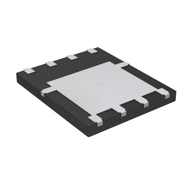

SiDR392DP www.vishay.com Vishay Siliconix N-Channel 30 V (D-S) MOSFET FEATURES PowerPAK® SO-8DC D D 6 5 D 7 • TrenchFET® Gen IV power MOSFET D 8 • Top side cooling feature provides additional venue for thermal transfer S • Optimized Qg, Qgd, and Qgd/Qgs ratio reduces switching related power loss 6.1 5m m 1 m 5m 4 G 5.1 Top View 1 2 3 S S S • 100 % Rg and UIS tested • Material categorization: for definitions of compliance please see www.vishay.com/doc?99912 Bottom View APPLICATIONS PRODUCT SUMMARY VDS (V) RDS(on) max. () at VGS = 10 V RDS(on) max. () at VGS = 4.5 V Qg typ. (nC) ID (A) Configuration • • • • • • 30 0.00062 0.00093 59.7 100 a, g Single D Synchronous rectification High power density DC/DC Synchronous buck converter OR-ing Load switching Battery management G N-Channel MOSFET S ORDERING INFORMATION Package Lead (Pb)-free and halogen-free PowerPAK SO-8DC SiDR392DP-T1-GE3 ABSOLUTE MAXIMUM RATINGS (TA = 25 °C, unless otherwise noted) PARAMETER Drain-source voltage Gate-source voltage Continuous drain current (TJ = 150 °C) SYMBOL VDS VGS TC = 25 °C TC = 70 °C TA = 25 °C TA = 70 °C Pulsed drain current (t = 100 μs) ID IDM Continuous source-drain diode current TC = 25 °C TA = 25 °C IS Single pulse avalanche current Single pulse avalanche energy L = 0.1 mH IAS EAS TC = 25 °C TC = 70 °C Maximum power dissipation TA = 25 °C TA = 70 °C Operating junction and storage temperature range Soldering recommendations (peak temperature) c PD TJ, Tstg LIMIT 30 +20 / -16 100 a 100 a 82 b, c 66 b, c 200 100 5.6 b, c 45 101 125 80 6.25 b, c 4 b, c -55 to +150 260 UNIT V A mJ W °C THERMAL RESISTANCE RATINGS PARAMETER SYMBOL TYPICAL MAXIMUM UNIT Maximum junction-to-ambient b t  10 s RthJA 15 20 0.8 1 Maximum junction-to-case (drain) Steady state RthJC °C/W 1.1 1.4 Maximum junction-to-case (source) Steady state RthJC Notes a. Package limited b. Surface mounted on 1" x 1" FR4 board c. t = 10 s d. See solder profile (www.vishay.com/doc?73257). The PowerPAK SO-8DC is a leadless package. The end of the lead terminal is exposed copper (not plated) as a result of the singulation process in manufacturing. A solder fillet at the exposed copper tip cannot be guaranteed and is not required to ensure adequate bottom side solder interconnection e. Rework conditions: manual soldering with a soldering iron is not recommended for leadless components f. Maximum under steady state conditions is 54 °C/W g. TC = 25 °C S18-0243-Rev. A, 26-Feb-18 Document Number: 76351 1 For technical questions, contact: pmostechsupport@vishay.com THIS DOCUMENT IS SUBJECT TO CHANGE WITHOUT NOTICE. THE PRODUCTS DESCRIBED HEREIN AND THIS DOCUMENT ARE SUBJECT TO SPECIFIC DISCLAIMERS, SET FORTH AT www.vishay.com/doc?91000 SiDR392DP www.vishay.com Vishay Siliconix SPECIFICATIONS (TJ = 25 °C, unless otherwise noted) PARAMETER SYMBOL TEST CONDITIONS MIN. TYP. MAX. UNIT V Static Drain-source breakdown voltage VDS VGS = 0 V, ID = 250 μA 30 - - VDS/TJ ID = 10 mA - 15 - VGS(th) temperature coefficient VGS(th)/TJ ID = 250 μA - -5.3 - Gate-source threshold voltage VDS temperature coefficient mV/°C VGS(th) VDS = VGS, ID = 250 μA 1 - 2.2 V Gate-source leakage IGSS VDS = 0 V, VGS = +20 / -16 V - - 100 nA Zero gate voltage drain current IDSS On-state drain current a ID(on) Drain-source on-state resistance a Forward transconductance a RDS(on) gfs VDS = 30 V, VGS = 0 V - - 1 VDS = 30 V, VGS = 0 V, TJ = 70 °C - - 15 VDS  10 V, VGS =10 V 20 - - A  VGS =10 V, ID = 20 A - 0.00047 0.00062 VGS = 4.5 V, ID = 15 A - 0.00071 0.00093 VDS = 15 V, ID = 30 A - 125 - - 9530 - - 4280 - - 626 - - 125 188 μA S Dynamic b Input capacitance Ciss Output capacitance Coss Reverse transfer capacitance Crss Total gate charge Qg Gate-source charge Qgs Gate-drain charge Qgd Gate resistance Rg Turn-on delay time Rise time Turn-off delay time Fall time Turn-on delay time Rise time Turn-off delay time Fall time VDS = 15 V, VGS = 0 V, f = 1 MHz VDS = 15 V, VGS = 10 V, ID = 20 A - 59.7 90 VDS = 15 V, VGS = 4.5 V, ID = 20 A - 25.2 - - 12.3 - f = 1 MHz 0.1 0.4 0.8 - 17 35 - 23 50 - 41 80 tf - 12 25 td(on) - 40 80 - 66 135 - 50 100 - 35 70 td(on) tr td(off) tr td(off) VDD = 15 V, RL = 1.5 , ID  10 A, VGEN = 10 V, Rg = 1  VDD = 15 V, RL = 1.5 , ID  10 A, VGEN = 4.5 V, Rg = 1  tf pF nC  ns Drain-Source Body Diode Characteristics Continuous source-drain diode current IS Pulse diode forward current ISM Body diode voltage VSD TC = 25 °C IS = 5 A, VGS = 0 V - - 100 - - 200 - 0.7 1.1 A V Body diode reverse recovery time trr - 80 160 ns Body diode reverse recovery charge Qrr - 144 290 nC Reverse recovery fall time ta - 43 - Reverse recovery rise time tb - 37 - IF = 10 A, di/dt = 100 A/μs, TJ = 25 °C ns Notes a. Pulse test; pulse width  300 μs, duty cycle  2 % b. Guaranteed by design, not subject to production testing  Stresses beyond those listed under “Absolute Maximum Ratings” may cause permanent damage to the device. These are stress ratings only, and functional operation of the device at these or any other conditions beyond those indicated in the operational sections of the specifications is not implied. Exposure to absolute maximum rating conditions for extended periods may affect device reliability. S18-0243-Rev. A, 26-Feb-18 Document Number: 76351 2 For technical questions, contact: pmostechsupport@vishay.com THIS DOCUMENT IS SUBJECT TO CHANGE WITHOUT NOTICE. THE PRODUCTS DESCRIBED HEREIN AND THIS DOCUMENT ARE SUBJECT TO SPECIFIC DISCLAIMERS, SET FORTH AT www.vishay.com/doc?91000 SiDR392DP www.vishay.com Vishay Siliconix TYPICAL CHARACTERISTICS (25 °C, unless otherwise noted) Axis Title Axis Title 100 10000 10000 120 VGS = 10 V thru 4 V 40 100 20 1000 80 TC = 25 °C 1st line 2nd line 1000 60 1st line 2nd line 2nd line ID - Drain Current (A) VGS = 3 V 2nd line ID - Drain Current (A) 100 80 60 40 100 TC = 125 °C 20 TC = -55 °C 0 0 10 0 0.5 1 1.5 10 2 0 1 2 VGS - Gate-to-Source Voltage (V) 2nd line Output Characteristics Transfer Characteristics Axis Title Axis Title 15 000 10000 10000 1000 0.0006 100 VGS = 10 V 1000 9000 6000 Coss 100 3000 0.0002 10 0 20 40 60 80 100 Crss 0 120 10 0 5 10 15 20 25 ID - Drain Current (A) 2nd line VDS - Drain-to-Source Voltage (V) 2nd line On-Resistance vs. Drain Current and Gate Voltage Capacitance Axis Title Axis Title 10 1000 6 4 1st line 2nd line VDS = 7.5 V VDS = 24 V 100 2 0 10 0 25 50 75 100 125 2nd line RDS(on) - On-Resistance (Normalized) VDS = 15 V 8 10000 1.6 10000 ID = 20 A 30 ID = 20 A 1.4 VGS = 10 V 1.2 VGS = 4.5 V 100 1.0 0.8 10 -50 -25 0 25 50 75 100 125 150 Qg - Total Gate Charge (nC) 2nd line TJ - Junction Temperature (°C) 2nd line Gate Charge On-Resistance vs. Junction Temperature S18-0243-Rev. A, 26-Feb-18 1000 1st line 2nd line 0.0004 Ciss 1st line 2nd line VGS = 4.5 V 2nd line C - Capacitance (pF) 12 000 0.0008 1st line 2nd line 2nd line RDS(on) - On-Resistance (Ω) 4 VDS - Drain-to-Source Voltage (V) 2nd line 0.0010 2nd line VGS - Gate-to-Source Voltage (V) 3 Document Number: 76351 3 For technical questions, contact: pmostechsupport@vishay.com THIS DOCUMENT IS SUBJECT TO CHANGE WITHOUT NOTICE. THE PRODUCTS DESCRIBED HEREIN AND THIS DOCUMENT ARE SUBJECT TO SPECIFIC DISCLAIMERS, SET FORTH AT www.vishay.com/doc?91000 SiDR392DP www.vishay.com Vishay Siliconix TYPICAL CHARACTERISTICS (25 °C, unless otherwise noted) Axis Title Axis Title 100 10000 TJ = 150 °C 1.6 VGS(th) (V) TJ = 25 °C 1 1000 1.4 1000 ID = 250μA 1st line 2nd line 10 1st line 2nd line 2nd line IS - Source Current (A) 10000 1.8 1.2 1.0 100 100 0.8 0.1 0.6 10 0 0.2 0.4 0.6 0.8 1.0 1.2 10 -50 -25 0 25 50 75 100 125 150 TJ - Temperature (°C) 2nd line VSD - Source-to-Drain Voltage (V) 2nd line Source-Drain Diode Forward Voltage Threshold Voltage Axis Title Axis Title 200 10000 0.0030 10000 0.0025 150 1000 0.0015 0.0010 1st line 2nd line 1000 2nd line Power (W) 0.0020 1st line 2nd line 2nd line RDS(on) - On-Resistance (Ω) ID = 20 A 100 100 TJ = 125 °C 100 50 0.0005 TJ = 25 °C 0 10 0 2 4 6 8 0 0.001 10 0.01 VGS - Gate-to-Source Voltage (V) 2nd line 0.1 1 10 100 10 1000 Time (s) 2nd line On-Resistance vs. Gate-to-Source Voltage Single Pulse Power, Junction-to-Ambient Axis Title Limited by RDS(on) (1) 1000 IDM Limited 10000 ID(ON) Limited 100 μs 1 ms 10 1000 1st line 2nd line 2nd line ID - Drain Current (A) 100 10 ms 100 ms 1 1s 10 s 0.1 TA = 25 °C Single pulse 0.01 0.01 (1) 100 DC BVdss Limited 10 0.1 1 10 100 VDS - Drain-to-Source Voltage (V) VGS > minimum VGS at which RDS(on) is specified Safe Operating Area, Junction-to-Ambient S18-0243-Rev. A, 26-Feb-18 Document Number: 76351 4 For technical questions, contact: pmostechsupport@vishay.com THIS DOCUMENT IS SUBJECT TO CHANGE WITHOUT NOTICE. THE PRODUCTS DESCRIBED HEREIN AND THIS DOCUMENT ARE SUBJECT TO SPECIFIC DISCLAIMERS, SET FORTH AT www.vishay.com/doc?91000 SiDR392DP www.vishay.com Vishay Siliconix TYPICAL CHARACTERISTICS (25 °C, unless otherwise noted) Axis Title 10000 300 1000 1st line 2nd line 2nd line ID - Drain Current (A) 400 200 Package limited 100 100 0 10 0 25 50 75 100 125 150 TC - Case Temperature (°C) 2nd line Current Derating a Axis Title 150 10000 120 1st line 2nd line 2nd line Power (W) 1000 90 60 100 30 0 10 0 25 50 75 100 125 150 TC - Case (Drain) Temperature (°C) 2nd line Power, Junction-to-Case Note a. The power dissipation PD is based on TJ max. = 150 °C, using junction-to-case thermal resistance, and is more useful in settling the upper dissipation limit for cases where additional heatsinking is used. It is used to determine the current rating, when this rating falls below the package limit S18-0243-Rev. A, 26-Feb-18 Document Number: 76351 5 For technical questions, contact: pmostechsupport@vishay.com THIS DOCUMENT IS SUBJECT TO CHANGE WITHOUT NOTICE. THE PRODUCTS DESCRIBED HEREIN AND THIS DOCUMENT ARE SUBJECT TO SPECIFIC DISCLAIMERS, SET FORTH AT www.vishay.com/doc?91000 SiDR392DP www.vishay.com Vishay Siliconix TYPICAL CHARACTERISTICS (25 °C, unless otherwise noted) Axis Title 1 10000 Notes: 0.2 0.1 1000 1st line 2nd line Normalized Effective Transient Thermal Impedance Duty cycle = 0.5 PDM 0.1 t1 0.05 t2 t 1. Duty cycle, D = t1 2 2. Per unit base = RthJA = 54 °C/W 0.02 100 3. TJM - TA = PDMZthJA (t) 4. Surface mounted Single pulse 0.01 0.0001 0.001 0.01 0.1 1 10 100 10 1000 Square Wave Pulse Duration (s) 2nd line Normalized Thermal Transient Impedance, Junction-to-Ambient Axis Title 10000 1 0.2 1000 0.1 0.1 1st line 2nd line Normalized Effective Transient Thermal Impedance Duty cycle = 0.5 0.05 0.02 100 Single pulse 0.01 0.0001 10 0.001 0.01 0.1 1 Square Wave Pulse Duration (s) 2nd line Normalized Thermal Transient Impedance, Junction-to-Case (Drain) Axis Title Axis Title 10000 Duty cycle = 0.5 1000 1st line 2nd line Normalized Effective Transient Thermal Impedance 1 0.2 0.1 100 0.05 0.02 Single pulse 0.1 0.0001 10 0.001 0.01 0.1 1 Square Wave Pulse Duration (s) 2nd2nd lineline Normalized Thermal Transient Impedance, Junction-to-Case (Source)  Vishay Siliconix maintains worldwide manufacturing capability. Products may be manufactured at one of several qualified locations. Reliability data for Silicon Technology and Package Reliability represent a composite of all qualified locations. For related documents such as package / tape drawings, part marking, and reliability data, see www.vishay.com/ppg?76351. S18-0243-Rev. A, 26-Feb-18 Document Number: 76351 6 For technical questions, contact: pmostechsupport@vishay.com THIS DOCUMENT IS SUBJECT TO CHANGE WITHOUT NOTICE. THE PRODUCTS DESCRIBED HEREIN AND THIS DOCUMENT ARE SUBJECT TO SPECIFIC DISCLAIMERS, SET FORTH AT www.vishay.com/doc?91000 Package Information www.vishay.com Vishay Siliconix PowerPAK® SO-8 Double Cooling Case Outline 8 M1 7 M4 6 K1 5 D1 5 6 K1 7 8 K T3 E2 E T1 E1 T2 H T5 D M4 e 1 2 3 L M3 4 4 3 2 1 b Back side view A1 c A T4 M2 DIM. MILLIMETERS INCHES MIN. NOM. MAX. MIN. NOM. A 0.51 0.56 0.61 0.020 0.022 0.024 A1 0.00 0.02 0.05 0.000 0.001 0.002 b 0.36 0.41 0.46 0.014 0.016 0.018 c 0.15 0.20 0.25 0.006 0.008 0.010 D 4.90 5.00 5.10 0.193 0.197 0.201 D1 3.71 3.76 3.81 0.146 0.148 0.150 e 1.27 BSC MAX. 0.050 BSC E 5.90 6.00 6.10 0.232 0.236 0.240 E1 3.60 3.65 3.70 0.142 0.144 0.146 E2 0.46 typ. 0.018 typ. H 0.49 0.54 0.59 0.019 0.021 0.023 K 1.22 1.27 1.32 0.048 0.050 0.052 K1 0.64 typ. 0.025 typ. L 0.49 0.54 0.59 0.019 0.021 0.023 M1 3.85 3.90 3.95 0.152 0.154 0.156 M2 2.74 2.79 2.84 0.108 0.110 0.112 M3 1.06 1.11 1.16 0.042 0.044 0.046 M4 0.56 typ. N 0.022 typ. 8 8 T1 4.51 4.56 4.61 0.178 0.180 0.182 T2 2.58 2.63 2.68 0.102 0.104 0.106 T3 1.88 1.93 1.98 0.074 0.076 0.078 T4 0.97 typ. 0.038 typ. T5 0.48 typ. 0.019 typ. ECN: T21-0014-Rev. B, 08-Feb-2021 DWG: 6048 Document Number: 75846 1 For technical questions, contact: pmostechsupport@vishay.com THIS DOCUMENT IS SUBJECT TO CHANGE WITHOUT NOTICE. THE PRODUCTS DESCRIBED HEREIN AND THIS DOCUMENT ARE SUBJECT TO SPECIFIC DISCLAIMERS, SET FORTH AT www.vishay.com/doc?91000 Revison: 08-Feb-2021 Application Note 826 Vishay Siliconix RECOMMENDED MINIMUM PADS FOR PowerPAK® SO-8 Single 0.260 (6.61) 0.150 (3.81) 0.050 0.174 (4.42) 0.154 (1.27) 0.026 (0.66) (3.91) 0.024 (0.61) 0.050 0.032 0.040 (1.27) (0.82) (1.02) Recommended Minimum Pads Dimensions in Inches/(mm) Return to Index Return to Index APPLICATION NOTE Document Number: 72599 Revision: 21-Jan-08 www.vishay.com 15 Legal Disclaimer Notice www.vishay.com Vishay Disclaimer ALL PRODUCT, PRODUCT SPECIFICATIONS AND DATA ARE SUBJECT TO CHANGE WITHOUT NOTICE TO IMPROVE RELIABILITY, FUNCTION OR DESIGN OR OTHERWISE. Vishay Intertechnology, Inc., its affiliates, agents, and employees, and all persons acting on its or their behalf (collectively, “Vishay”), disclaim any and all liability for any errors, inaccuracies or incompleteness contained in any datasheet or in any other disclosure relating to any product. Vishay makes no warranty, representation or guarantee regarding the suitability of the products for any particular purpose or the continuing production of any product. To the maximum extent permitted by applicable law, Vishay disclaims (i) any and all liability arising out of the application or use of any product, (ii) any and all liability, including without limitation special, consequential or incidental damages, and (iii) any and all implied warranties, including warranties of fitness for particular purpose, non-infringement and merchantability. Statements regarding the suitability of products for certain types of applications are based on Vishay's knowledge of typical requirements that are often placed on Vishay products in generic applications. Such statements are not binding statements about the suitability of products for a particular application. It is the customer's responsibility to validate that a particular product with the properties described in the product specification is suitable for use in a particular application. Parameters provided in datasheets and / or specifications may vary in different applications and performance may vary over time. All operating parameters, including typical parameters, must be validated for each customer application by the customer's technical experts. Product specifications do not expand or otherwise modify Vishay's terms and conditions of purchase, including but not limited to the warranty expressed therein. Hyperlinks included in this datasheet may direct users to third-party websites. These links are provided as a convenience and for informational purposes only. Inclusion of these hyperlinks does not constitute an endorsement or an approval by Vishay of any of the products, services or opinions of the corporation, organization or individual associated with the third-party website. Vishay disclaims any and all liability and bears no responsibility for the accuracy, legality or content of the third-party website or for that of subsequent links. Except as expressly indicated in writing, Vishay products are not designed for use in medical, life-saving, or life-sustaining applications or for any other application in which the failure of the Vishay product could result in personal injury or death. Customers using or selling Vishay products not expressly indicated for use in such applications do so at their own risk. Please contact authorized Vishay personnel to obtain written terms and conditions regarding products designed for such applications. No license, express or implied, by estoppel or otherwise, to any intellectual property rights is granted by this document or by any conduct of Vishay. Product names and markings noted herein may be trademarks of their respective owners. © 2021 VISHAY INTERTECHNOLOGY, INC. ALL RIGHTS RESERVED Revision: 09-Jul-2021 1 Document Number: 91000
