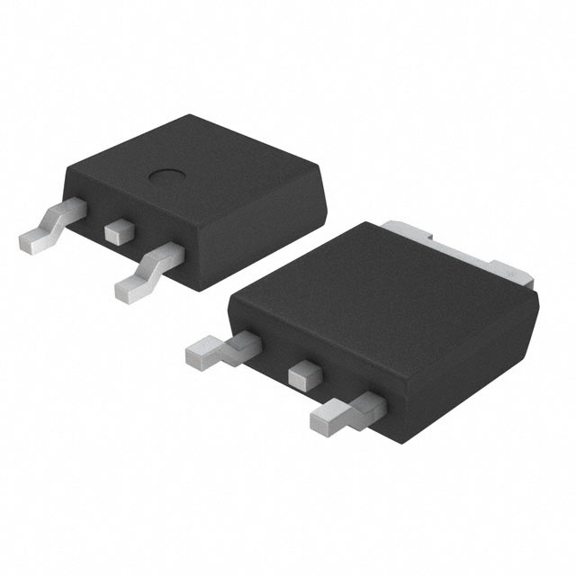

SiHD1K4N60E www.vishay.com Vishay Siliconix E Series Power MOSFET FEATURES D • 4th generation E series technology DPAK (TO-252) • Low figure-of-merit (FOM) Ron x Qg • Low effective capacitance (Co(er)) D • Reduced switching and conduction losses G • Avalanche energy rated (UIS) S G • Material categorization: for definitions of compliance please see www.vishay.com/doc?99912 S N-Channel MOSFET APPLICATIONS • • • • Server and telecom power supplies Switch mode power supplies (SMPS) Power factor correction power supplies (PFC) Lighting - High-intensity discharge (HID) - Fluorescent ballast lighting • Industrial - Welding - Induction heating - Motor drives - Battery chargers - Solar (PV inverters) PRODUCT SUMMARY VDS (V) at TJ max. RDS(on) typ. () at 25 °C 650 VGS = 10 V Qg max. (nC) 1.3 7.5 Qgs (nC) 1 Qgd (nC) 3 Configuration Single ORDERING INFORMATION Package DPAK (TO-252) Lead (Pb)-free and halogen-free SiHD1K4N60E-GE3 ABSOLUTE MAXIMUM RATINGS (TC = 25 °C, unless otherwise noted) PARAMETER SYMBOL LIMIT Drain-source voltage VDS 600 Gate-source voltage VGS ± 30 Continuous drain current (TJ = 150 °C) VGS at 10 V TC = 25 °C TC = 100 °C Pulsed drain current a ID IDM Linear derating factor UNIT V 4.2 2.6 A 5 0.5 W/°C Single pulse avalanche energy b EAS 14 mJ Maximum power dissipation PD 63 W TJ, Tstg -55 to +150 °C Operating junction and storage temperature range Drain-source voltage slope TJ = 125 °C Reverse diode dv/dt d Soldering recommendations (peak temperature) c For 10 s dv/dt 70 3 260 V/ns °C Notes a. Repetitive rating; pulse width limited by maximum junction temperature b. VDD = 140 V, starting TJ = 25 °C, L = 28.2 mH, Rg = 25 , IAS = 1 A c. 1.6 mm from case d. ISD  ID, di/dt = 100 A/μs, starting TJ = 25 °C S19-0021-Rev. B, 14-Jan-2019 Document Number: 92125 1 For technical questions, contact: hvm@vishay.com THIS DOCUMENT IS SUBJECT TO CHANGE WITHOUT NOTICE. THE PRODUCTS DESCRIBED HEREIN AND THIS DOCUMENT ARE SUBJECT TO SPECIFIC DISCLAIMERS, SET FORTH AT www.vishay.com/doc?91000 SiHD1K4N60E www.vishay.com Vishay Siliconix THERMAL RESISTANCE RATINGS PARAMETER SYMBOL TYP. MAX. Maximum junction-to-ambient RthJA - 62 Maximum junction-to-case (drain) RthJC - 2.0 UNIT °C/W SPECIFICATIONS (TJ = 25 °C, unless otherwise noted) PARAMETER SYMBOL TEST CONDITIONS MIN. TYP. MAX. UNIT Static Drain-source breakdown voltage VDS temperature coefficient Gate-source threshold voltage (N) VDS VGS = 0 V, ID = 250 μA 600 - - V VDS/TJ Reference to 25 °C, ID = 1 mA - 0.68 - V/°C VGS(th) VDS = VGS, ID = 250 μA 3.0 - 5.0 V VGS = ± 20 V - - ± 100 nA VGS = ± 30 V - - ±1 μA VDS = 600 V, VGS = 0 V - - 1 VDS = 480 V, VGS = 0 V, TJ = 125 °C - - 10 Gate-source leakage IGSS Zero gate voltage drain current IDSS μA - 1.3 1.45  gfs VDS = 20 V, ID = 2.0 A - 0.8 - S Input capacitance Ciss 172 - Coss - 19 - Reverse transfer capacitance Crss VGS = 0 V, VDS = 100 V, f = 1 MHz - Output capacitance - 4 - Effective output capacitance, energy related a Co(er) - 12 - Effective output capacitance, time  related b Co(tr) - 50 - - 5 7.5 - 1 - Drain-source on-state resistance Forward transconductance a RDS(on) VGS = 10 V ID = 0.5 A Dynamic pF VDS = 0 V to 480 V, VGS = 0 V Total gate charge Qg Gate-source charge Qgs VGS = 10 V ID = 2.0 A, VDS = 480 V Gate-drain charge Qgd - 3 - Turn-on delay time td(on) - 10 20 VDD = 480 V, ID = 2.0 A, VGS = 10 V, Rg = 9.1  - 23 46 - 10 20 - 22 44 f = 1 MHz, open drain 2.1 4.2 8.4 - - 4 - - 5 Rise time Turn-off delay time tr td(off) Fall time tf Gate input resistance Rg nC ns  Drain-Source Body Diode Characteristics Continuous source-drain diode current IS Pulsed diode forward current ISM Diode forward voltage VSD Reverse recovery time trr Reverse recovery charge Qrr Reverse recovery current IRRM MOSFET symbol showing the  integral reverse p - n junction diode D A G TJ = 25 °C, IS = 0.5 A, VGS = 0 V TJ = 25 °C, IF = IS = 0.5 A, di/dt = 100 A/μs, VR = 25 V S - - 1.2 V - 222 444 ns - 0.8 1.6 μC - 5.6 - A Notes a. Coss(er) is a fixed capacitance that gives the same energy as Coss while VDS is rising from 0 % to 80 % VDSS b. Coss(tr) is a fixed capacitance that gives the same charging time as Coss while VDS is rising from 0 % to 80 % VDSS S19-0021-Rev. B, 14-Jan-2019 Document Number: 92125 2 For technical questions, contact: hvm@vishay.com THIS DOCUMENT IS SUBJECT TO CHANGE WITHOUT NOTICE. THE PRODUCTS DESCRIBED HEREIN AND THIS DOCUMENT ARE SUBJECT TO SPECIFIC DISCLAIMERS, SET FORTH AT www.vishay.com/doc?91000 SiHD1K4N60E www.vishay.com Vishay Siliconix TYPICAL CHARACTERISTICS (25 °C, unless otherwise noted) Axis Title Axis Title 10000 1000 8V 3 2 7V 1 6V 100 5V 2.5 1.5 VGS = 10 V 0 5 10 15 100 1.0 0.5 10 0 1000 2.0 10 0 20 -60 -40 -20 0 20 40 60 80 100 120 140 160 VDS - Drain-to-Source Voltage (V) TJ - Junction Temperature (°C) Fig. 1 - Typical Output Characteristics Fig. 4 - Normalized On-Resistance vs. Temperature Axis Title 15 V 14 V 13 V 12 V 11 V 10 V 3 Axis Title 10 000 10000 10000 TJ = 150 °C 8V 1000 1st line 2nd line 7V 2 100 6V 1 VGS = 0 V, f = 1 MHz Ciss = Cgs + Cgd, Cds shorted Crss = Cgd Coss = Cds + Cgd 1000 2nd line C - Capacitance (pF) 4 2nd line ID - Drain-to-Source Current (A) 1st line 2nd line 4 9V ID = 2 A 1000 Ciss 1st line 2nd line 5 RDS(on) - Drain-to-Source On-Resistance (Normalized) TJ = 25 °C 15 V 14 V 13 V 12 V 11 V 10 V 10000 3.0 1st line 2nd line 2nd line ID - Drain-to-Source Current (A) 6 100 100 Coss 10 Crss 5V 10 0 5 10 15 10 1 20 0 100 200 300 400 500 600 VDS - Drain-to-Source Voltage (V) VDS - Drain-to-Source Voltage (V) Fig. 2 - Typical Output Characteristics Fig. 5 - Typical Capacitance vs. Drain-to-Source Voltage Axis Title Axis Title 10000 6 3.0 10 000 1000 4 TJ = 150 °C 3 100 2 1 2nd line Coss - Output Capacitance (pF) 5 1st line 2nd line 2nd line ID - Drain-to-Source Current (A) TJ = 25 °C 2.5 2.0 1000 Eoss 1.5 Coss 1.0 100 0.5 VDS = 31.7 V 10 0 0 5 10 15 20 0 10 0 100 200 300 400 500 VGS - Gate-to-Source Voltage (V) VDS - Drain-to-Source Voltage (V) Fig. 3 - Typical Transfer Characteristics Fig. 6 - Coss and Eoss vs. VDS S19-0021-Rev. B, 14-Jan-2019 Eoss - Output Capacitance Stored Energy (µJ) 2nd line 0 600 Document Number: 92125 3 For technical questions, contact: hvm@vishay.com THIS DOCUMENT IS SUBJECT TO CHANGE WITHOUT NOTICE. THE PRODUCTS DESCRIBED HEREIN AND THIS DOCUMENT ARE SUBJECT TO SPECIFIC DISCLAIMERS, SET FORTH AT www.vishay.com/doc?91000 SiHD1K4N60E www.vishay.com Vishay Siliconix Axis Title Axis Title 10000 10000 5 VDS = 480 V VDS = 300 V VDS = 120 V 6 100 3 1000 3 1st line 2nd line 1000 2nd line ID - Drain Current (A) 4 9 1st line 2nd line 2nd line VGS - Gate-to-Source Voltage (V) 12 2 100 1 0 1 2 3 4 5 10 0 10 0 6 25 50 75 100 125 150 Qg - Total Gate Charge (nC) TC - Case Temperature (°C) Fig. 7 - Typical Gate Charge vs. Gate-to-Source Voltage Fig. 10 - Maximum Drain Current vs. Case Temperature Axis Title 1000 TJ = 25 °C 1 100 VGS = 0 V 10 0.1 0.2 0.4 0.6 0.8 1.0 1.2 1.4 10000 750 725 700 1000 1st line 2nd line TJ = 150 °C 1st line 2nd line 2nd line ISD - Reverse Drain Current (A) 10000 2nd line VDS - Drain-to-Source Breakdown Voltage (V) Axis Title 10 675 650 100 625 ID = 250 µA 600 10 575 -60 -40 -20 0 20 40 60 80 100 120 140 160 VSD - Source-Drain Voltage (V) TJ - Junction Temperature (°C) Fig. 8 - Typical Source-Drain Diode Forward Voltage Fig. 11 - Temperature vs. Drain-to-Source Voltage Axis Title Operation in this area limited by RDS(on) 10000 IDM limited 1000 1 Limited by RDS(on) a 100 µs 1st line 2nd line 2nd line ID - Drain Current (A) 10 1 ms100 0.1 TC = 25 °C, TJ = 150 °C, single pulse 10 ms BVDSS limited 0.01 1 10 100 10 1000 VDS - Drain-to-Source Voltage (V) Fig. 9 - Maximum Safe Operating Area Note a. VGS > minimum VGS at which RDS(on) is specified S19-0021-Rev. B, 14-Jan-2019 Document Number: 92125 4 For technical questions, contact: hvm@vishay.com THIS DOCUMENT IS SUBJECT TO CHANGE WITHOUT NOTICE. THE PRODUCTS DESCRIBED HEREIN AND THIS DOCUMENT ARE SUBJECT TO SPECIFIC DISCLAIMERS, SET FORTH AT www.vishay.com/doc?91000 SiHD1K4N60E www.vishay.com Vishay Siliconix Axis Title 1 10000 0.2 1000 1st line 2nd line Normalized Effective Transient Thermal Impedance Duty cycle = 0.5 0.1 0.1 0.05 0.02 100 Single pulse 10 0.01 0.0001 0.001 0.01 0.1 1 10 Pulse Time (s) Fig. 12 - Normalized Transient Thermal Impedance, Junction-to-Case RD VDS VDS tp VGS D.U.T. VDD Rg + - VDD VDS 10 V Pulse width ≤ 1 μs Duty factor ≤ 0.1 % IAS Fig. 13 - Switching Time Test Circuit Fig. 16 - Unclamped Inductive Waveforms VDS Qg 10 V 90 % Qgs 10 % VGS Qgd VG td(on) td(off) tr tf Charge Fig. 14 - Switching Time Waveforms Fig. 17 - Basic Gate Charge Waveform Current regulator Same type as D.U.T. L VDS Vary tp to obtain required IAS 50 kΩ D.U.T. Rg + - VDD 12 V 0.2 μF 0.3 μF + IAS D.U.T. - VDS 10 V tp 0.01 Ω VGS 3 mA Fig. 15 - Unclamped Inductive Test Circuit IG ID Current sampling resistors Fig. 18 - Gate Charge Test Circuit S19-0021-Rev. B, 14-Jan-2019 Document Number: 92125 5 For technical questions, contact: hvm@vishay.com THIS DOCUMENT IS SUBJECT TO CHANGE WITHOUT NOTICE. THE PRODUCTS DESCRIBED HEREIN AND THIS DOCUMENT ARE SUBJECT TO SPECIFIC DISCLAIMERS, SET FORTH AT www.vishay.com/doc?91000 SiHD1K4N60E www.vishay.com Vishay Siliconix Peak Diode Recovery dv/dt Test Circuit + D.U.T. Circuit layout considerations • Low stray inductance • Ground plane • Low leakage inductance current transformer 3 + 2 - - 4 + 1 Rg • • • • 1 Driver gate drive Period P.W. + V - DD dv/dt controlled by Rg Driver same type as D.U.T. ISD controlled by duty factor “D” D.U.T. - device under test D= P.W. Period V GS = 10 V a 2 D.U.T. ISD waveform Reverse recovery current 3 D.U.T. VDS Body diode forward current di/dt waveform Diode recovery dv/dt Re-applied voltage V DD Body diode forward drop 4 Inductor current Ripple ≤ 5 % ISD Note a. VGS = 5 V for logic level devices Fig. 19 - For N-Channel Vishay Siliconix maintains worldwide manufacturing capability. Products may be manufactured at one of several qualified locations. Reliability data for Silicon Technology and Package Reliability represent a composite of all qualified locations. For related documents such as package/tape drawings, part marking, and reliability data, see www.vishay.com/ppg?92125. S19-0021-Rev. B, 14-Jan-2019 Document Number: 92125 6 For technical questions, contact: hvm@vishay.com THIS DOCUMENT IS SUBJECT TO CHANGE WITHOUT NOTICE. THE PRODUCTS DESCRIBED HEREIN AND THIS DOCUMENT ARE SUBJECT TO SPECIFIC DISCLAIMERS, SET FORTH AT www.vishay.com/doc?91000 Package Information Vishay Siliconix TO-252AA (HIGH VOLTAGE) E b3 E1 L3 D1 D H L4 b2 b A c2 e A1 L1 L c θ L2 MILLIMETERS INCHES DIM. MIN. MAX. MIN. MAX. E 6.40 6.73 0.252 0.265 L 1.40 1.77 0.055 L1 2.743 REF L2 0.070 0.108 REF 0.508 BSC 0.020 BSC L3 0.89 1.27 0.035 0.050 L4 0.64 1.01 0.025 0.040 D 6.00 6.22 0.236 0.245 H 9.40 10.40 0.370 0.409 b 0.64 0.88 0.025 0.035 b2 0.77 1.14 0.030 0.045 b3 5.21 5.46 0.205 e 2.286 BSC 0.215 0.090 BSC A 2.20 2.38 0.087 A1 0.00 0.13 0.000 0.094 0.005 c 0.45 0.60 0.018 0.024 c2 0.45 0.58 0.018 0.023 D1 5.30 - 0.209 - E1 4.40 - 0.173 - θ 0' 10' 0' 10' ECN: S-81965-Rev. A, 15-Sep-08 DWG: 5973 Notes 1. Package body sizes exclude mold flash, protrusion or gate burrs. Mold flash, protrusion or gate burrs shall not exceed 0.10 mm per side. 2. Package body sizes determined at the outermost extremes of the plastic body exclusive of mold flash, gate burrs and interlead flash, but including any mismatch between the top and bottom of the plastic body. 3. The package top may be smaller than the package bottom. 4. Dimension "b" does not include dambar protrusion. Allowable dambar protrusion shall be 0.10 mm total in excess of "b" dimension at maximum material condition. The dambar cannot be located on the lower radius of the foot. Document Number: 91344 Revision: 15-Sep-08 www.vishay.com 1 Application Note 826 Vishay Siliconix RECOMMENDED MINIMUM PADS FOR DPAK (TO-252) 0.224 0.243 0.087 (2.202) 0.090 (2.286) (10.668) 0.420 (6.180) (5.690) 0.180 0.055 (4.572) (1.397) Recommended Minimum Pads Dimensions in Inches/(mm) Return to Index Return to Index APPLICATION NOTE Document Number: 72594 Revision: 21-Jan-08 www.vishay.com 3 Legal Disclaimer Notice www.vishay.com Vishay Disclaimer ALL PRODUCT, PRODUCT SPECIFICATIONS AND DATA ARE SUBJECT TO CHANGE WITHOUT NOTICE TO IMPROVE RELIABILITY, FUNCTION OR DESIGN OR OTHERWISE. Vishay Intertechnology, Inc., its affiliates, agents, and employees, and all persons acting on its or their behalf (collectively, “Vishay”), disclaim any and all liability for any errors, inaccuracies or incompleteness contained in any datasheet or in any other disclosure relating to any product. Vishay makes no warranty, representation or guarantee regarding the suitability of the products for any particular purpose or the continuing production of any product. To the maximum extent permitted by applicable law, Vishay disclaims (i) any and all liability arising out of the application or use of any product, (ii) any and all liability, including without limitation special, consequential or incidental damages, and (iii) any and all implied warranties, including warranties of fitness for particular purpose, non-infringement and merchantability. Statements regarding the suitability of products for certain types of applications are based on Vishay's knowledge of typical requirements that are often placed on Vishay products in generic applications. Such statements are not binding statements about the suitability of products for a particular application. It is the customer's responsibility to validate that a particular product with the properties described in the product specification is suitable for use in a particular application. Parameters provided in datasheets and / or specifications may vary in different applications and performance may vary over time. All operating parameters, including typical parameters, must be validated for each customer application by the customer's technical experts. Product specifications do not expand or otherwise modify Vishay's terms and conditions of purchase, including but not limited to the warranty expressed therein. Hyperlinks included in this datasheet may direct users to third-party websites. These links are provided as a convenience and for informational purposes only. Inclusion of these hyperlinks does not constitute an endorsement or an approval by Vishay of any of the products, services or opinions of the corporation, organization or individual associated with the third-party website. Vishay disclaims any and all liability and bears no responsibility for the accuracy, legality or content of the third-party website or for that of subsequent links. Except as expressly indicated in writing, Vishay products are not designed for use in medical, life-saving, or life-sustaining applications or for any other application in which the failure of the Vishay product could result in personal injury or death. Customers using or selling Vishay products not expressly indicated for use in such applications do so at their own risk. Please contact authorized Vishay personnel to obtain written terms and conditions regarding products designed for such applications. No license, express or implied, by estoppel or otherwise, to any intellectual property rights is granted by this document or by any conduct of Vishay. Product names and markings noted herein may be trademarks of their respective owners. © 2021 VISHAY INTERTECHNOLOGY, INC. ALL RIGHTS RESERVED Revision: 09-Jul-2021 1 Document Number: 91000
