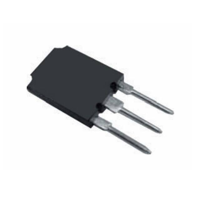

SiHFPS40N60K www.vishay.com Vishay Siliconix Power MOSFET FEATURES D • Low gate charge Qg results in simple drive requirement Super-247 • Improved gate, avalanche and dynamic dV/dt ruggedness G • Fully characterized capacitance avalanche voltage and current S D G S • Enhanced body diode dV/dt capability N-Channel MOSFET • Material categorization: for definitions of compliance please see www.vishay.com/doc?99912 PRODUCT SUMMARY VDS (V) APPLICATIONS 600 RDS(on) (Ω) and VGS = 10 V • Hard switching primary or PFC switch 0.110 330 • Switch mode power supply (SMPS) Qgs (nC) 84 • Uninterruptible power supply Qgd (nC) 150 • High speed power switching Qg (Max.) (nC) Configuration Single • Motor drive ORDERING INFORMATION Package Super-247 Lead (Pb)-free and halogen-free SiHFPS40N60K-GE3 ABSOLUTE MAXIMUM RATINGS (TC = 25 °C, unless otherwise noted) PARAMETER SYMBOL LIMIT Drain-source voltage VDS 600 Gate-source voltage VGS ± 30 VGS at 10 V Continuous drain current TC = 25 °C Pulsed drain current a V 40 ID TC = 100 °C UNIT A 24 IDM 160 4.5 W/°C Single pulse avalanche energy b EAS 600 mJ Repetitive avalanche current a IAR 40 A EAR 57 mJ PD 570 W dV/dt 7.5 V/ns TJ, Tstg - 55 to + 150 Linear derating factor Repetitive avalanche energy a TC = 25 °C Maximum power dissipation Peak diode recovery dV/dt c Operating junction and storage temperature range Soldering recommendations (peak temperature) °C 300 d for 10 s Notes a. Repetitive rating; pulse width limited by maximum junction temperature (see fig. 11) b. Starting TJ = 25 °C, L = 0.84 mH, Rg = 25 Ω, IAS = 38 A, dV/dt = 5.5 V/ns (see fig. 12a) c. ISD ≤ 38 A, dI/dt ≤ 150 A/μs, VDD ≤ VDS, TJ ≤ 150 °C d. 1.6 mm from case THERMAL RESISTANCE RATINGS PARAMETER Maximum junction-to-ambient Case-to-sink, flat, greased surface Maximum junction-to-case (drain) S21-0019-Rev. C, 18-Jan-2021 SYMBOL TYP. MAX. UNIT RthJA RthCS RthJC 0.24 - 40 0.22 °C/W Document Number: 91261 1 For technical questions, contact: hvm@vishay.com THIS DOCUMENT IS SUBJECT TO CHANGE WITHOUT NOTICE. THE PRODUCTS DESCRIBED HEREIN AND THIS DOCUMENT ARE SUBJECT TO SPECIFIC DISCLAIMERS, SET FORTH AT www.vishay.com/doc?91000 SiHFPS40N60K www.vishay.com Vishay Siliconix SPECIFICATIONS (TJ = 25 °C, unless otherwise noted) PARAMETER SYMBOL TEST CONDITIONS MIN. TYP. MAX. UNIT Static Drain-source breakdown voltage VDS temperature coefficient Gate-source threshold voltage VDS VGS = 0 V, ID = 250 μA 600 - - V ΔVDS/TJ Reference to 25 °C, ID = 1 mA - 0.63 - V/°C VGS(th) VDS = VGS, ID = 250 μA 3.0 - 5.0 V Gate-source leakage IGSS VGS = ± 30 V - - ± 100 nA Zero gate voltage drain current IDSS VDS = 600 V, VGS = 0 V - - 50 VDS = 480 V, VGS = 0 V, TJ = 125 °C - - 250 Drain-source on-state resistance Forward transconductance μA - 0.110 0.130 Ω gfs VDS = 50 V, ID = 24 A b 21 - - S VGS = 0 V, VDS = 25 V, f = 1.0 MHz, see fig. 5 - 7970 - - 750 - RDS(on) ID = 24 A b VGS = 10 V Dynamic Input capacitance Ciss Output capacitance Coss Reverse transfer capacitance Crss Output capacitance Effective output capacitance Coss Total gate charge Qg Gate-source charge Qgs Gate-drain charge Qgd Turn-on delay time td(on) Rise time Turn-off delay time Fall time VGS = 0 V Coss eff. - 75 - VDS = 1.0 V, f = 1.0 MHz - 9440 - VDS = 480 V, f = 1.0 MHz - 200 - VDS = 0 V to 480 V c - 260 - - - 330 ID = 38 A, VDS = 480 V, see fig. 6 and 13 b VGS = 10 V tr VDD = 300 V, ID = 38 A, RG = 4.3 Ω, see fig. 10 b td(off) tf - - 84 - - 150 - 47 - - 110 - - 97 - - 60 - - - 40 - - 160 pF nC ns Drain-source body diode characteristics Continuous source-drain diode current IS Pulsed diode forward current a ISM Body diode voltage VSD Body diode reverse recovery time Body diode reverse recovery charge Body diode recovery current Forward turn-on time trr Qrr IRRM ton MOSFET symbol showing the integral reverse p - n junction diode D A G S TJ = 25 °C, IS = 38 A, VGS = 0 V b TJ = 25 °C TJ = 125 °C TJ = 25 °C IF = 38 A, dI/dt = 100 A/μs TJ = 125 °C TJ = 25 °C - - 1.5 - 630 950 - 730 1090 - 14 20 - 17 25 - 39 58 V ns μC A Intrinsic turn-on time is negligible (turn-on is dominated by LS and LD) Notes a. Repetitive rating; pulse width limited by maximum junction temperature (see fig. 11) b. Pulse width ≤ 300 μs; duty cycle ≤ 2 % c. Coss eff. is a fixed capacitance that gives the same charging time as Coss while VDS is rising from 0 % to 80 % VDS S21-0019-Rev. C, 18-Jan-2021 Document Number: 91261 2 For technical questions, contact: hvm@vishay.com THIS DOCUMENT IS SUBJECT TO CHANGE WITHOUT NOTICE. THE PRODUCTS DESCRIBED HEREIN AND THIS DOCUMENT ARE SUBJECT TO SPECIFIC DISCLAIMERS, SET FORTH AT www.vishay.com/doc?91000 SiHFPS40N60K www.vishay.com Vishay Siliconix TYPICAL CHARACTERISTICS (25 °C, unless otherwise noted) 1000 3.5 VGS 15V 10V 8.0V 7.0V 6.0V 5.5V 5.0V BOTTOM 4.5V I D = 38A 10 3.0 1 0.1 4.5V 0.01 20μs PULSE WIDTH Tj = 25°C 0.001 0.1 1 10 2.5 (Normalized) 100 R DS(on) , Drain-to-Source On Resistance ID, Drain-to-Source Current (A) TOP 2.0 1.5 1.0 0.5 V GS = 10V 0.0 100 -60 -40 -20 Fig. 1 - Typical Output Characteristics 60 80 100 120 140 160 ( ° C) 100000 VGS 15V 10V 8.0V 7.0V 6.0V 5.5V 5.0V BOTTOM 4.5V VGS Ciss Crss Coss = 0V, f = 1 MHZ = Cgs + C gd, Cds SHORTED = Cgd = C ds + C gd 10000 C, Capacitance(pF) ID, Drain-to-Source Current (A) 40 Fig. 4 - Normalized On-Resistance vs. Temperature TOP 10 20 TJ , Junction Temperature VDS, Drain-to-Source Voltage (V) 100 0 4.5V 1 Ciss 1000 Coss 100 Crss 20μs PULSE WIDTH Tj = 150°C 0.1 0.1 1 10 100 10 1 VDS, Drain-to-Source Voltage (V) 10 100 1000 VDS, Drain-to-Source Voltage (V) Fig. 2 - Typical Output Characteristics Fig. 5 - Typical Capacitance vs. Drain-to-Source Voltage 12 1000 I D = 38A VDS = 480V VDS = 300V VDS = 120V 10 T J= 150 ° C VGS , Gate-to-Source Voltage (V) I D, Drain-to-Source Current (A) 100 10 TJ = 25 °C 1 0.1 7 5 2 V DS= 50V 20μs PULSE WIDTH 0 0.01 4 6 8 10 11 13 15 V GS, Gate-to-Source Voltage (V) Fig. 3 - Typical Transfer Characteristics S21-0019-Rev. C, 18-Jan-2021 0 50 100 150 200 250 QG, Total Gate Charge (nC) Fig. 6 - Typical Gate Charge vs. Gate-to-Source Voltage Document Number: 91261 3 For technical questions, contact: hvm@vishay.com THIS DOCUMENT IS SUBJECT TO CHANGE WITHOUT NOTICE. THE PRODUCTS DESCRIBED HEREIN AND THIS DOCUMENT ARE SUBJECT TO SPECIFIC DISCLAIMERS, SET FORTH AT www.vishay.com/doc?91000 SiHFPS40N60K www.vishay.com Vishay Siliconix 100 30 I D , Drain Current (A) 40 I SD , Reverse Drain Current (A) 1000 T J= 150 ° C 10 TJ = 25 °C 1 20 10 V GS = 0 V 0.1 0 0.2 0.6 0.9 1.3 1.6 25 50 V SD,Source-to-Drain Voltage (V) 75 Fig. 7 - Typical Source-Drain Diode Forward Voltage 125 RD OPERATION IN THIS AREA LIMITED BY R DS(on) VDS VGS 100 D.U.T. RG 100μsec 10 10 V 1 1 + - VDD Pulse width ≤ 1 µs Duty factor ≤ 0.1 % 1msec 0.1 150 ( ° C) Fig. 9 - Maximum Drain Current vs. Case Temperature 1000 ID, Drain-to-Source Current (A) 100 TC , Case Temperature 10msec Fig. 10a - Switching Time Test Circuit Tc = 25°C Tj = 150°C Single Pulse VDS 10 1000 90 % 100 10000 VDS , Drain-toSource Voltage (V) Fig. 8 - Maximum Safe Operating Area 10 % VGS td(on) tr td(off) tf Fig. 10b - Switching Time Waveforms S21-0019-Rev. C, 18-Jan-2021 Document Number: 91261 4 For technical questions, contact: hvm@vishay.com THIS DOCUMENT IS SUBJECT TO CHANGE WITHOUT NOTICE. THE PRODUCTS DESCRIBED HEREIN AND THIS DOCUMENT ARE SUBJECT TO SPECIFIC DISCLAIMERS, SET FORTH AT www.vishay.com/doc?91000 SiHFPS40N60K www.vishay.com Vishay Siliconix (Z thJC ) 1 D = 0.50 0.1 Thermal Response 0.20 0.10 0.05 P DM 0.02 0.01 0.01 SINGLE PULSE (THERMAL RESPONSE) t1 t2 Notes: 1. Duty factor D = 2. Peak T 0.001 0.00001 0.0001 0.001 t1/ t 2 J = P DM x Z thJC 0.01 +TC 0.1 1 t 1, Rectangular Pulse Duration (sec) Fig. 11 - Maximum Effective Transient Thermal Impedance, Junction-to-Case 1200 960 Driver L VDS D.U.T. RG + A - VDD IAS 20 V tp EAS , Single Pulse Avalanche Energy (mJ) 15 V 0.01 Ω TOP ID 17A 24A BOTTOM 38A 720 480 240 0 25 Fig. 12a - Unclamped Inductive Test Circuit 50 75 100 125 150 ( ° C) Starting Tj, Junction Temperature Fig. 12c - Maximum Avalanche Energy vs. Drain Current VDS IAS 5.0 VGS(th) Gate threshold Voltage (V) tp 4.5 4.0 ID = 250μA 3.5 3.0 2.5 Fig. 12b - Unclamped Inductive Waveforms 2.0 -75 -50 -25 0 25 50 75 100 125 150 T J , Temperature ( °C ) Fig. 12d - Threshold Voltage vs. Temperature S21-0019-Rev. C, 18-Jan-2021 Document Number: 91261 5 For technical questions, contact: hvm@vishay.com THIS DOCUMENT IS SUBJECT TO CHANGE WITHOUT NOTICE. THE PRODUCTS DESCRIBED HEREIN AND THIS DOCUMENT ARE SUBJECT TO SPECIFIC DISCLAIMERS, SET FORTH AT www.vishay.com/doc?91000 SiHFPS40N60K www.vishay.com Vishay Siliconix Current regulator Same type as D.U.T. QG VGS V 50 kΩ 12 V 0.2 µF 0.3 µF QGS QGD + D.U.T. - VDS VG VGS 3 mA Charge IG ID Current sampling resistors Fig. 13a - Basic Gate Charge Waveform S21-0019-Rev. C, 18-Jan-2021 Fig. 13b - Gate Charge Test Circuit Document Number: 91261 6 For technical questions, contact: hvm@vishay.com THIS DOCUMENT IS SUBJECT TO CHANGE WITHOUT NOTICE. THE PRODUCTS DESCRIBED HEREIN AND THIS DOCUMENT ARE SUBJECT TO SPECIFIC DISCLAIMERS, SET FORTH AT www.vishay.com/doc?91000 SiHFPS40N60K www.vishay.com Vishay Siliconix Peak Diode Recovery dV/dt Test Circuit + D.U.T. Circuit layout considerations • Low stray inductance • Ground plane • Low leakage inductance current transformer + - - Rg • • • • + dV/dt controlled by Rg Driver same type as D.U.T. ISD controlled by duty factor “D” D.U.T. - device under test + - VDD Driver gate drive P.W. Period D= P.W. Period VGS = 10 Va D.U.T. lSD waveform Reverse recovery current Body diode forward current dI/dt D.U.T. VDS waveform Diode recovery dV/dt Re-applied voltage Inductor current VDD Body diode forward drop Ripple ≤ 5 % ISD Note a. VGS = 5 V for logic level devices Fig. 14 - For N-Channel Vishay Siliconix maintains worldwide manufacturing capability. Products may be manufactured at one of several qualified locations. Reliability data for Silicon Technology and Package Reliability represent a composite of all qualified locations. For related documents such as package/tape drawings, part marking, and reliability data, see www.vishay.com/ppg?91261. S21-0019-Rev. C, 18-Jan-2021 Document Number: 91261 7 For technical questions, contact: hvm@vishay.com THIS DOCUMENT IS SUBJECT TO CHANGE WITHOUT NOTICE. THE PRODUCTS DESCRIBED HEREIN AND THIS DOCUMENT ARE SUBJECT TO SPECIFIC DISCLAIMERS, SET FORTH AT www.vishay.com/doc?91000 Package Information www.vishay.com Vishay Siliconix TO-274AA (High Voltage) VERSION 1: FACILITY CODE = Y B A E E4 A D2 E1 A1 R D1 D L1 L Detail “A” C b e A2 0.10 (0.25) M B A M 10° b4 b2 Lead Tip 5° Detail “A” Scale: 2:1 MILLIMETERS INCHES MILLIMETERS INCHES DIM. MIN. MAX. MIN. MAX. DIM. MIN. MAX. MIN. A 4.70 5.30 0.185 0.209 D1 15.50 16.10 0.610 0.634 A1 1.50 2.50 0.059 0.098 D2 0.70 1.30 0.028 0.051 A2 2.25 2.65 0.089 0.104 E 15.10 16.10 0.594 0.634 13.30 13.90 0.524 0.547 b 1.30 1.60 0.051 0.063 E1 b2 1.80 2.20 0.071 0.087 e 5.45 BSC MAX. 0.215 BSC b4 3.00 3.25 0.118 0.128 L 13.70 14.70 0.539 0.579 c (1) 0.38 0.89 0.015 0.035 L1 1.00 1.60 0.039 0.063 D 19.80 20.80 0.780 0.819 R 2.00 3.00 0.079 0.118 Notes • Dimensioning and tolerancing per ASME Y14.5M-1994 • Dimension D and E do not include mold flash. Mold flash shall not exceed 0.127 mm (0.005") per side. These dimensions are measured at the outer extremes of the plastic body • Outline conforms to JEDEC® outline to TO-274AA (1) Dimension measured at tip of lead Revision: 19-Oct-2020 Document Number: 91365 1 For technical questions, contact: hvm@vishay.com THIS DOCUMENT IS SUBJECT TO CHANGE WITHOUT NOTICE. THE PRODUCTS DESCRIBED HEREIN AND THIS DOCUMENT ARE SUBJECT TO SPECIFIC DISCLAIMERS, SET FORTH AT www.vishay.com/doc?91000 Package Information www.vishay.com Vishay Siliconix VERSION 2: FACILITY CODE = N A E A E3 B D D1 D2 E2 Q A2 L1 F F H H C G L G A1 e b 3x 0.25 M B A M b1 C b3 E4 E1 b’, b2, b4 C C’ Base metal b, b1, b3 Plating SECTION "F-F", "G-G" AND "H-H" SCALE: NONE MILLIMETERS MILLIMETERS DIM. MIN. MAX. DIM. MIN. MAX. A 4.83 5.21 D1 16.25 17.65 A1 2.29 2.54 D2 0.50 0.80 A2 1.91 2.16 E 15.75 16.13 b’ 1.07 1.28 E1 13.10 14.15 b 1.07 1.33 E2 3.68 5.10 b1 1.91 2.41 E3 1.00 1.90 b2 1.91 2.16 E4 12.38 13.43 b3 2.87 3.38 e b4 2.87 3.13 N c’ 0.55 0.65 L 19.81 c 0.55 0.68 L1 3.70 4.00 D 20.80 21.10 Q 5.49 6.00 5.44 BSC 3 20.32 ECN: E20-0538-Rev. C, 19-Oct-2020 DWG: 5975 Notes • Dimensioning and tolerancing per ASME Y14.5M-1994 • Outline conforms to JEDEC® outline to TO-274AD • Dimensions are measured in mm, angles are in degree • Metal surfaces are tin plated, except area of cut Revision: 19-Oct-2020 Document Number: 91365 2 For technical questions, contact: hvm@vishay.com THIS DOCUMENT IS SUBJECT TO CHANGE WITHOUT NOTICE. THE PRODUCTS DESCRIBED HEREIN AND THIS DOCUMENT ARE SUBJECT TO SPECIFIC DISCLAIMERS, SET FORTH AT www.vishay.com/doc?91000 Legal Disclaimer Notice www.vishay.com Vishay Disclaimer ALL PRODUCT, PRODUCT SPECIFICATIONS AND DATA ARE SUBJECT TO CHANGE WITHOUT NOTICE TO IMPROVE RELIABILITY, FUNCTION OR DESIGN OR OTHERWISE. Vishay Intertechnology, Inc., its affiliates, agents, and employees, and all persons acting on its or their behalf (collectively, “Vishay”), disclaim any and all liability for any errors, inaccuracies or incompleteness contained in any datasheet or in any other disclosure relating to any product. Vishay makes no warranty, representation or guarantee regarding the suitability of the products for any particular purpose or the continuing production of any product. To the maximum extent permitted by applicable law, Vishay disclaims (i) any and all liability arising out of the application or use of any product, (ii) any and all liability, including without limitation special, consequential or incidental damages, and (iii) any and all implied warranties, including warranties of fitness for particular purpose, non-infringement and merchantability. Statements regarding the suitability of products for certain types of applications are based on Vishay's knowledge of typical requirements that are often placed on Vishay products in generic applications. Such statements are not binding statements about the suitability of products for a particular application. It is the customer's responsibility to validate that a particular product with the properties described in the product specification is suitable for use in a particular application. Parameters provided in datasheets and / or specifications may vary in different applications and performance may vary over time. All operating parameters, including typical parameters, must be validated for each customer application by the customer's technical experts. Product specifications do not expand or otherwise modify Vishay's terms and conditions of purchase, including but not limited to the warranty expressed therein. Hyperlinks included in this datasheet may direct users to third-party websites. These links are provided as a convenience and for informational purposes only. Inclusion of these hyperlinks does not constitute an endorsement or an approval by Vishay of any of the products, services or opinions of the corporation, organization or individual associated with the third-party website. Vishay disclaims any and all liability and bears no responsibility for the accuracy, legality or content of the third-party website or for that of subsequent links. Except as expressly indicated in writing, Vishay products are not designed for use in medical, life-saving, or life-sustaining applications or for any other application in which the failure of the Vishay product could result in personal injury or death. Customers using or selling Vishay products not expressly indicated for use in such applications do so at their own risk. Please contact authorized Vishay personnel to obtain written terms and conditions regarding products designed for such applications. No license, express or implied, by estoppel or otherwise, to any intellectual property rights is granted by this document or by any conduct of Vishay. Product names and markings noted herein may be trademarks of their respective owners. © 2021 VISHAY INTERTECHNOLOGY, INC. ALL RIGHTS RESERVED Revision: 09-Jul-2021 1 Document Number: 91000
