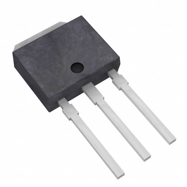

SiHU3N50D www.vishay.com Vishay Siliconix D Series Power MOSFET FEATURES PRODUCT SUMMARY VDS (V) at TJ max. • Optimal design - Low area specific on-resistance - Low input capacitance (Ciss) - Reduced capacitive switching losses - High body diode ruggedness Available - Avalanche energy rated (UIS) • Optimal efficiency and operation - Low cost - Simple gate drive circuitry - Low figure-of-merit (FOM): Ron x Qg - Fast switching • Material categorization: for definitions of compliance please see www.vishay.com/doc?99912 550 RDS(on) max. (Ω) at 25 °C VGS = 10 V 3.2 Qg max. (nC) 12 Qgs (nC) 2 Qgd (nC) 3 Configuration Single D IPAK (TO-251) D APPLICATIONS G G D S • Consumer electronics -Displays (LCD or plasma TV) • Server and telecom power supplies - SMPS • Industrial - Welding - Induction heating - Motor drives • Battery chargers S N-Channel MOSFET ORDERING INFORMATION Package IPAK (TO-251) Lead (Pb)-free SiHU3N50D-E3 Lead (Pb)-free and Halogen-free SiHU3N50D-GE3 ABSOLUTE MAXIMUM RATINGS (TC = 25 °C, unless otherwise noted) PARAMETER Drain-Source Voltage Gate-Source Voltage LIMIT VDS 500 VGS Gate-Source Voltage AC (f > 1 Hz) Continuous Drain Current (TJ = 150 °C) SYMBOL VGS at 10 V TC = 25 °C TC = 100 °C Pulsed Drain Current a ID IDM Linear Derating Factor ± 30 UNIT V 30 3.0 1.9 A 5.5 0.56 W/°C Single Pulse Avalanche Energy b EAS 10.4 mJ Maximum Power Dissipation PD 69 W TJ, Tstg -55 to +150 °C Operating Junction and Storage Temperature Range Drain-Source Voltage Slope Reverse Diode dV/dt TJ = 125 °C d Soldering Recommendations (Peak Temperature) c for 10 s dV/dt 24 0.22 300 V/ns °C Notes a. Repetitive rating; pulse width limited by maximum junction temperature. b. VDD = 50 V, starting TJ = 25 °C, L = 2.3 mH, Rg = 25 Ω, IAS = 3 A. c. 1.6 mm from case. d. ISD ≤ ID, starting TJ = 25 °C. S19-0604-Rev. D, 15-Jul-2019 Document Number: 91493 1 For technical questions, contact: hvm@vishay.com THIS DOCUMENT IS SUBJECT TO CHANGE WITHOUT NOTICE. THE PRODUCTS DESCRIBED HEREIN AND THIS DOCUMENT ARE SUBJECT TO SPECIFIC DISCLAIMERS, SET FORTH AT www.vishay.com/doc?91000 SiHU3N50D www.vishay.com Vishay Siliconix THERMAL RESISTANCE RATINGS PARAMETER SYMBOL TYP. MAX. Maximum Junction-to-Ambient RthJA - 62 Maximum Junction-to-Case (Drain) RthJC - 1.8 UNIT °C/W SPECIFICATIONS (TJ = 25 °C, unless otherwise noted) PARAMETER SYMBOL TEST CONDITIONS MIN. TYP. MAX. UNIT Static Drain-Source Breakdown Voltage VDS Temperature Coefficient Gate-Source Threshold Voltage (N) VDS VGS = 0 V, ID = 250 μA 500 - - V ΔVDS/TJ Reference to 25 °C, ID = 250 μA - 0.56 - V/°C VGS(th) VDS = VGS, ID = 250 μA 3 - 5 V Gate-Source Leakage IGSS VGS = ± 30 V - - ± 100 nA Zero Gate Voltage Drain Current IDSS VDS = 500 V, VGS = 0 V - - 1 VDS = 400 V, VGS = 0 V, TJ = 125 °C - - 10 - 2.6 3.2 Ω S Drain-Source On-State Resistance Forward Transconductance a RDS(on) VGS = 10 V ID = 1.5 A gfs VDS = 8 V, ID = 1.5 A - 1 - VGS = 0 V, VDS = 100 V, f = 1 MHz - 175 - - 21 - - 5 - - 21 - - 26 - μA Dynamic Input Capacitance Ciss Output Capacitance Coss Reverse Transfer Capacitance Crss Effective Output Capacitance, Energy Related b Co(er) Effective Output Capacitance, Time Related c Co(tr) pF VDS = 0 V to 400 V, VGS = 0 V Total Gate Charge Qg Gate-Source Charge Qgs Gate-Drain Charge Turn-On Delay Time Rise Time Turn-Off Delay Time - 6 12 - 2 - Qgd - 3 - td(on) - 12 24 tr - 9 18 - 11 22 - 13 26 - 3.3 - - - 3 - - 12 - - 1.2 - 293 - ns - 0.74 - μC - 5 - A td(off) Fall Time tf Gate Input Resistance Rg VGS = 10 V ID = 1.5 A, VDS = 400 V VDD = 400 V, ID = 1.5 A Rg = 9.1 Ω, VGS = 10 V f = 1 MHz, open drain nC ns Ω Drain-Source Body Diode Characteristics Continuous Source-Drain Diode Current IS Pulsed Diode Forward Current ISM Diode Forward Voltage VSD Reverse Recovery Time trr Reverse Recovery Charge Qrr Reverse Recovery Current IRRM MOSFET symbol showing the integral reverse p - n junction diode D A G TJ = 25 °C, IS = 1.5 A, VGS = 0 V TJ = 25 °C, IF = IS = 1.5 A, dI/dt = 100 A/μs, VR = 20 V S V Notes a. Repetitive rating; pulse width limited by maximum junction temperature. b. Coss(er) is a fixed capacitance that gives the same energy as Coss while VDS is rising from 0 % to 80 % VDSS. c. Coss(tr) is a fixed capacitance that gives the same charging time as Coss while VDS is rising from 0 % to 80 % VDSS. S19-0604-Rev. D, 15-Jul-2019 Document Number: 91493 2 For technical questions, contact: hvm@vishay.com THIS DOCUMENT IS SUBJECT TO CHANGE WITHOUT NOTICE. THE PRODUCTS DESCRIBED HEREIN AND THIS DOCUMENT ARE SUBJECT TO SPECIFIC DISCLAIMERS, SET FORTH AT www.vishay.com/doc?91000 SiHU3N50D www.vishay.com Vishay Siliconix TYPICAL CHARACTERISTICS (25 °C, unless otherwise noted) 3 TOP 15 V 14 V 13 V 12 V 11 V 10 V 9V 5 4 TJ = 25 °C ID = 1.5 A RDS(on), Drain-to-Source On Resistance (Normalized) ID, Drain-to-Source Current (A) 6 3 8V 2 7V 1 2.5 2 1.5 VGS = 10 V 1 0.5 6V 0 0 5 10 15 20 25 0 - 60 - 40 - 20 0 30 Fig. 4 - Normalized On-Resistance vs. Temperature Fig. 1 - Typical Output Characteristics TOP 15 V 14 V 13 V 12 V 11 V 10 V 9.0 V 8.0 V 7.0 V 6.0 V 5.0 V 3 2 1000 Ciss 100 Coss 10 Crss 1 0 1 0 10 5 20 15 25 30 0 VDS, Drain-to-Source Voltage (V) 100 200 300 400 500 VDS, Drain-to-Source Voltage (V) Fig. 5 - Typical Capacitance vs. Drain-to-Source Voltage Fig. 2 - Typical Output Characteristics 24 VGS, Gate-to-Source Voltage (V) 6 ID, Drain-to-Source Current (A) VGS = 0 V, f = 1 MHz Ciss = Cgs + Cgd, Cds Shorted Crss = Cgd Coss = Cds + Cgd TJ = 150 °C Capacitance (pF) ID, Drain-to-Source Current (A) 4 20 40 60 80 100 120 140 160 TJ, Junction Temperature (°C) VDS, Drain-to-Source Voltage (V) 5 4 3 2 TJ = 150 °C 1 TJ = 25 °C VDS = 400 V VDS = 250 V VDS = 100 V 20 16 12 8 4 0 0 0 5 10 15 20 VGS, Gate-to-Source Voltage (V) Fig. 3 - Typical Transfer Characteristics S19-0604-Rev. D, 15-Jul-2019 25 0 3 6 9 12 Qg, Total Gate Charge (nC) Fig. 6 - Typical Gate Charge vs. Gate-to-Source Voltage Document Number: 91493 3 For technical questions, contact: hvm@vishay.com THIS DOCUMENT IS SUBJECT TO CHANGE WITHOUT NOTICE. THE PRODUCTS DESCRIBED HEREIN AND THIS DOCUMENT ARE SUBJECT TO SPECIFIC DISCLAIMERS, SET FORTH AT www.vishay.com/doc?91000 SiHU3N50D www.vishay.com Vishay Siliconix 3.0 ISD, Reverse Drain Current (A) 100 ID, Drain Current (A) 2.5 10 TJ = 150 °C 1 TJ = 25 °C 0.1 2.0 1.5 1.0 0.5 VGS = 0 V 0.01 0 0.2 0.4 0.6 0.8 1.0 1.2 1.4 25 1.6 VSD, Source-Drain Voltage (V) 75 100 125 150 TJ, Case Temperature (°C) Fig. 7 - Typical Source-Drain Diode Forward Voltage Fig. 9 - Maximum Drain Current vs. Case Temperature 100 10 100 μs 1 1 ms Limited by RDS(on)* 10 ms 0.1 TC = 25 °C TJ = 150 °C Single Pulse VDS, Drain-to-Source Breakdown Voltage (V) 625 Operation in this area limited by RDS(on) ID, Drain Current (A) 50 600 575 550 525 500 BVDSS Limited 0.01 475 1 10 100 1000 VDS, Drain-to-Source Voltage (V) * VGS > minimum VGS at which RDS(on) is specified Normalized Effective Transient Thermal Impedance Fig. 8 - Maximum Safe Operating Area - 60 - 40 - 20 0 20 40 60 80 100 120 140 160 TJ, Junction Temperature (°C) Fig. 10 - Typical Drain-to-Source Voltage vs. Temperature 1 Duty Cycle = 0.5 0.2 0.1 0.1 0.05 0.02 Single Pulse 0.01 0.0001 0.001 0.01 0.1 1 Pulse Time (s) Fig. 11 - Normalized Thermal Transient Impedance, Junction-to-Case S19-0604-Rev. D, 15-Jul-2019 Document Number: 91493 4 For technical questions, contact: hvm@vishay.com THIS DOCUMENT IS SUBJECT TO CHANGE WITHOUT NOTICE. THE PRODUCTS DESCRIBED HEREIN AND THIS DOCUMENT ARE SUBJECT TO SPECIFIC DISCLAIMERS, SET FORTH AT www.vishay.com/doc?91000 SiHU3N50D www.vishay.com Vishay Siliconix RD VDS QG 10 V VGS D.U.T. RG QGS + - VDD QGD VG 10 V Pulse width ≤ 1 µs Duty factor ≤ 0.1 % Charge Fig. 12 - Switching Time Test Circuit Fig. 16 - Basic Gate Charge Waveform Current regulator Same type as D.U.T. VDS 90 % 50 kΩ 12 V 0.2 µF 0.3 µF + 10 % VGS D.U.T. td(on) td(off) tf tr - VDS VGS 3 mA Fig. 13 - Switching Time Waveforms IG ID Current sampling resistors Fig. 17 - Gate Charge Test Circuit L Vary tp to obtain required IAS VDS D.U.T RG + - IAS V DD 10 V 0.01 Ω tp Fig. 14 - Unclamped Inductive Test Circuit VDS tp VDD VDS IAS Fig. 15 - Unclamped Inductive Waveforms S19-0604-Rev. D, 15-Jul-2019 Document Number: 91493 5 For technical questions, contact: hvm@vishay.com THIS DOCUMENT IS SUBJECT TO CHANGE WITHOUT NOTICE. THE PRODUCTS DESCRIBED HEREIN AND THIS DOCUMENT ARE SUBJECT TO SPECIFIC DISCLAIMERS, SET FORTH AT www.vishay.com/doc?91000 SiHU3N50D www.vishay.com Vishay Siliconix Peak Diode Recovery dV/dt Test Circuit + D.U.T. Circuit layout considerations • Low stray inductance • Ground plane • Low leakage inductance current transformer + - - Rg • • • • + dV/dt controlled by Rg Driver same type as D.U.T. ISD controlled by duty factor “D” D.U.T. - device under test + - VDD Driver gate drive P.W. Period D= P.W. Period VGS = 10 Va D.U.T. lSD waveform Reverse recovery current Body diode forward current dI/dt D.U.T. VDS waveform Diode recovery dV/dt Re-applied voltage Inductor current VDD Body diode forward drop Ripple ≤ 5 % ISD Note a. VGS = 5 V for logic level devices Fig. 18 - For N-Channel Vishay Siliconix maintains worldwide manufacturing capability. Products may be manufactured at one of several qualified locations. Reliability data for Silicon Technology and Package Reliability represent a composite of all qualified locations. For related documents such as package/tape drawings, part marking, and reliability data, see www.vishay.com/ppg?91493. S19-0604-Rev. D, 15-Jul-2019 Document Number: 91493 6 For technical questions, contact: hvm@vishay.com THIS DOCUMENT IS SUBJECT TO CHANGE WITHOUT NOTICE. THE PRODUCTS DESCRIBED HEREIN AND THIS DOCUMENT ARE SUBJECT TO SPECIFIC DISCLAIMERS, SET FORTH AT www.vishay.com/doc?91000 Package Information www.vishay.com Vishay Siliconix Case Outline for TO-251AA (High Voltage) OPTION 1: 4 E1 3 E Thermal PAD 4 b4 θ2 4 A 0.010 0.25 M C A B L2 4 c2 A θ1 B D D1 A C 3 Seating plane 5 C L1 L3 (Datum A) C L B B A A1 3 x b2 View A - A 2xe c 3xb 0.010 0.25 M C A B Plating 5 b1, b3 Base metal Lead tip 5 c1 (c) (b, b2) Section B - B and C - C MILLIMETERS INCHES MILLIMETERS INCHES DIM. MIN. MAX. MIN. MAX. DIM. MIN. MAX. MIN. A 2.18 2.39 0.086 0.094 D1 5.21 - 0.205 MAX. - A1 0.89 1.14 0.035 0.045 E 6.35 6.73 0.250 0.265 4.32 - 0.170 - b 0.64 0.89 0.025 0.035 E1 b1 0.65 0.79 0.026 0.031 e b2 0.76 1.14 0.030 0.045 L 8.89 9.65 0.350 0.380 b3 0.76 1.04 0.030 0.041 L1 1.91 2.29 0.075 0.090 b4 4.95 5.46 0.195 0.215 L2 0.89 1.27 0.035 0.050 c 0.46 0.61 0.018 0.024 L3 1.14 1.52 0.045 0.060 c1 0.41 0.56 0.016 0.022 1 0' 15' 0' 15' c2 0.46 0.86 0.018 0.034 2 25' 35' 25' 35' D 5.97 6.22 0.235 0.245 2.29 BSC 2.29 BSC ECN: E21-0682-Rev. C, 27-Dec-2021 DWG: 5968 Notes • Dimensioning and tolerancing per ASME Y14.5M-1994 • Dimension are shown in inches and millimeters • Dimension D and E do not include mold flash. Mold flash shall not exceed 0.13 mm (0.005") per side. These dimensions are measured at the outermost extremes of the plastic body • Thermal pad contour optional with dimensions b4, L2, E1 and D1 • Lead dimension uncontrolled in L3 • Dimension b1, b3 and c1 apply to base metal only • Outline conforms to JEDEC® outline TO-251AA Revision: 27-Dec-2021 Document Number: 91362 1 For technical questions, contact: hvmos.techsupport@vishay.com THIS DOCUMENT IS SUBJECT TO CHANGE WITHOUT NOTICE. THE PRODUCTS DESCRIBED HEREIN AND THIS DOCUMENT ARE SUBJECT TO SPECIFIC DISCLAIMERS, SET FORTH AT www.vishay.com/doc?91000 Package Information www.vishay.com Vishay Siliconix OPTION 2: FACILITY CODE = N E A L2 b4 c2 E1 D2 θ1 CL L4 θ1 D D1 Ø 1.00 x 0.10 deep C B B L L3 L1 C b2 A1 b b1, b3 c c e c1 θ2 Third angle projection b, b2 Section “B-B” and “C-C” DIM. MIN. NOM. MAX. DIM. MIN. NOM. A 2.180 2.285 2.390 D2 5.380 - MAX. - A1 0.890 1.015 1.140 E 6.350 6.540 6.730 4.32 - - b 0.640 0.765 0.890 E1 b1 0.640 0.715 0.790 e b2 0.760 0.950 1.140 L 8.890 9.270 9.650 b3 0.760 0.900 1.040 L1 1.910 2.100 2.290 b4 4.950 5.205 5.460 L2 0.890 1.080 1.270 c 0.460 - 0.610 L3 1.140 1.330 1.520 c1 0.410 - 0.560 L4 1.300 1.400 1.500 c2 0.460 - 0.610 1 0° 7.5° 15° D 5.970 6.095 6.220 2 4° - - D1 4.300 - - 2.29 BSC ECN: E21-0682-Rev. C, 27-Dec-2021 DWG: 5968 Notes • Dimensioning and tolerancing per ASME Y14.5M-1994 • All dimension are in millimeters, angles are in degrees • Heat sink side flash is max. 0.8 mm Revision: 27-Dec-2021 Document Number: 91362 2 For technical questions, contact: hvmos.techsupport@vishay.com THIS DOCUMENT IS SUBJECT TO CHANGE WITHOUT NOTICE. THE PRODUCTS DESCRIBED HEREIN AND THIS DOCUMENT ARE SUBJECT TO SPECIFIC DISCLAIMERS, SET FORTH AT www.vishay.com/doc?91000 Application Note 826 Vishay Siliconix RECOMMENDED MINIMUM PADS FOR DPAK (TO-252) 0.224 0.243 0.087 (2.202) 0.090 (2.286) (10.668) 0.420 (6.180) (5.690) 0.180 0.055 (4.572) (1.397) Recommended Minimum Pads Dimensions in Inches/(mm) Return to Index Return to Index APPLICATION NOTE Document Number: 72594 Revision: 21-Jan-08 www.vishay.com 3 Legal Disclaimer Notice www.vishay.com Vishay Disclaimer ALL PRODUCT, PRODUCT SPECIFICATIONS AND DATA ARE SUBJECT TO CHANGE WITHOUT NOTICE TO IMPROVE RELIABILITY, FUNCTION OR DESIGN OR OTHERWISE. Vishay Intertechnology, Inc., its affiliates, agents, and employees, and all persons acting on its or their behalf (collectively, “Vishay”), disclaim any and all liability for any errors, inaccuracies or incompleteness contained in any datasheet or in any other disclosure relating to any product. Vishay makes no warranty, representation or guarantee regarding the suitability of the products for any particular purpose or the continuing production of any product. To the maximum extent permitted by applicable law, Vishay disclaims (i) any and all liability arising out of the application or use of any product, (ii) any and all liability, including without limitation special, consequential or incidental damages, and (iii) any and all implied warranties, including warranties of fitness for particular purpose, non-infringement and merchantability. Statements regarding the suitability of products for certain types of applications are based on Vishay's knowledge of typical requirements that are often placed on Vishay products in generic applications. Such statements are not binding statements about the suitability of products for a particular application. It is the customer's responsibility to validate that a particular product with the properties described in the product specification is suitable for use in a particular application. Parameters provided in datasheets and / or specifications may vary in different applications and performance may vary over time. All operating parameters, including typical parameters, must be validated for each customer application by the customer's technical experts. Product specifications do not expand or otherwise modify Vishay's terms and conditions of purchase, including but not limited to the warranty expressed therein. Hyperlinks included in this datasheet may direct users to third-party websites. These links are provided as a convenience and for informational purposes only. Inclusion of these hyperlinks does not constitute an endorsement or an approval by Vishay of any of the products, services or opinions of the corporation, organization or individual associated with the third-party website. Vishay disclaims any and all liability and bears no responsibility for the accuracy, legality or content of the third-party website or for that of subsequent links. Except as expressly indicated in writing, Vishay products are not designed for use in medical, life-saving, or life-sustaining applications or for any other application in which the failure of the Vishay product could result in personal injury or death. Customers using or selling Vishay products not expressly indicated for use in such applications do so at their own risk. Please contact authorized Vishay personnel to obtain written terms and conditions regarding products designed for such applications. No license, express or implied, by estoppel or otherwise, to any intellectual property rights is granted by this document or by any conduct of Vishay. Product names and markings noted herein may be trademarks of their respective owners. © 2022 VISHAY INTERTECHNOLOGY, INC. ALL RIGHTS RESERVED Revision: 01-Jan-2022 1 Document Number: 91000
SIHU3N50D-E3
1. 物料型号:SiHU3N50D 2. 器件简介:D系列功率MOSFET,具有低区域比导通电阻、低输入电容、降低电容开关损耗、高体二极管鲁棒性、雪崩能量等级等特点。 3. 引脚分配:配置为单N沟道MOSFET,引脚为G(栅极)、D(漏极)、S(源极)。 4. 参数特性: - 漏源电压(VDS)最大值为550V - 导通电阻(RDS(on))在25°C、VGS=10V时最大为3.2Ω - 栅极电荷(Qg)最大为12nC - 工作结温范围(TJ)为-55至+150°C - 封装类型为IPAK (TO-251) 5. 功能详解:包括静态和动态特性,如阈值电压、栅极漏电流、导通电阻、输入电容、输出电容、反向传输电容、总栅极电荷等。 6. 应用信息:适用于消费电子、服务器和电信电源、工业应用如焊接、感应加热、电机驱动和电池充电器。 7. 封装信息:提供了TO-251AA的案例轮廓和尺寸信息。
