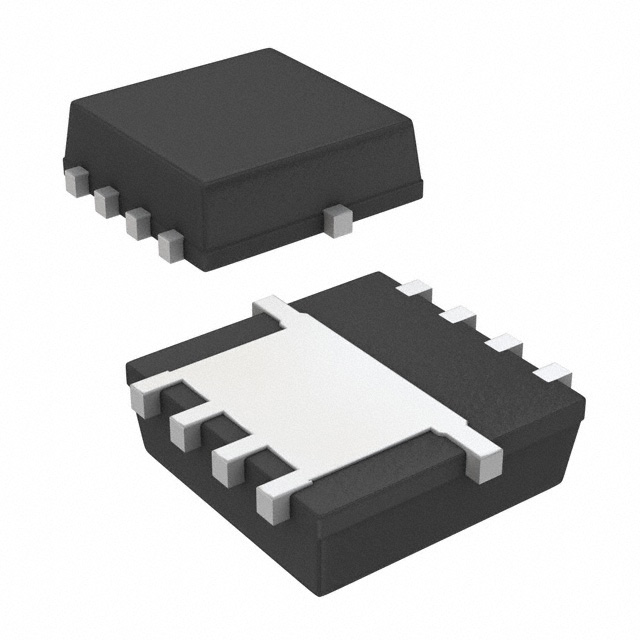

    特性:TrenchFET Gen IV p沟道功率MOSFET。在紧凑的符合RoHS标准且散热增强的无卤封装中提供极低的RDS(ON)。实现更高的功率密度。100%进行Rg和UIS测试。应用:移动设备...
SISA01DN-T1-GE3 数据手册
SiSA01DN www.vishay.com Vishay Siliconix P-Channel 30 V (D-S) MOSFET FEATURES PowerPAK® 1212-8 Single • TrenchFET® Gen IV p-channel power MOSFET D D 8 D 7 D 6 5 • Provides exceptionally low RDS(ON) in a compact package that is thermally enhanced • Enables higher power density • 100 % Rg and UIS tested 3. 3 m m 1 3.3 mm Top View • Material categorization: for definitions of compliance please see www.vishay.com/doc?99912 1 2 S 3 S 4 S G Bottom View APPLICATIONS PRODUCT SUMMARY VDS (V) RDS(on) max. () at VGS = 10 V RDS(on) max. () at VGS = 4.5 V Qg typ. (nC) ID (A) Configuration S • Battery management in mobile devices • Adapter and charger switch -30 0.0049 0.0082 27 60 a, g Single G • Battery switch • Load switch D P-Channel MOSFET ORDERING INFORMATION Package Lead (Pb)-free and halogen-free PowerPAK 1212-8 SiSA01DN-T1-GE3 ABSOLUTE MAXIMUM RATINGS (TA = 25 °C, unless otherwise noted) PARAMETER Drain-source voltage Gate-source voltage Continuous drain current (TJ = 150 °C) SYMBOL VDS VGS TC = 25 °C TC = 70 °C TA = 25 °C TA = 70 °C Pulsed drain current (t = 100 μs) ID IDM Continuous source-drain diode current TC = 25 °C TA = 25 °C IS Single pulse avalanche current Single pulse avalanche energy L = 0.1 mH IAS EAS TC = 25 °C TC = 70 °C Maximum power dissipation TA = 25 °C TA = 70 °C Operating junction and storage temperature range Soldering recommendations (peak temperature) c IP TJ, Tstg LIMIT -30 +16 / -20 -60 a -60 a -22.4 b, c 18.4 b, c -150 -47.2 -3.3 b, c -25 31.2 52 33 3.7 b, c 2.4 b, c -55 to +150 260 UNIT V A mJ W °C THERMAL RESISTANCE RATINGS PARAMETER SYMBOL TYPICAL MAXIMUM UNIT Maximum junction-to-ambient b t  10 s RthJA 24 33 °C/W 1.9 2.4 Maximum junction-to-case (drain) Steady state RthJF Notes a. Package limited b. Surface mounted on 1" x 1" FR4 board c. t = 10 s d. See solder profile (www.vishay.com/doc?73257). The PowerPAK 1212-8 is a leadless package. The end of the lead terminal is exposed copper (not plated) as a result of the singulation process in manufacturing. A solder fillet at the exposed copper tip cannot be guaranteed and is not required to ensure adequate bottom side solder interconnection e. Rework conditions: manual soldering with a soldering iron is not recommended for leadless components f. Maximum under steady state conditions is 81 °C/W g. TC = 25 °C S17-1370-Rev. A, 04-Sep-17 Document Number: 76198 1 For technical questions, contact: pmostechsupport@vishay.com THIS DOCUMENT IS SUBJECT TO CHANGE WITHOUT NOTICE. THE PRODUCTS DESCRIBED HEREIN AND THIS DOCUMENT ARE SUBJECT TO SPECIFIC DISCLAIMERS, SET FORTH AT www.vishay.com/doc?91000 SiSA01DN www.vishay.com Vishay Siliconix SPECIFICATIONS (TJ = 25 °C, unless otherwise noted) PARAMETER SYMBOL TEST CONDITIONS MIN. TYP. MAX. UNIT V Static Drain-source breakdown voltage VDS VGS = 0 V, ID = -250 μA -30 - - VDS/TJ ID = -10 mA - -17 - VGS(th) temperature coefficient VGS(th)/TJ ID = -250 μA - 5.5 - Gate-source threshold voltage VDS temperature coefficient mV/°C VGS(th) VDS = VGS, ID = 250 μA -1 - -2.2 V Gate-source leakage IGSS VDS = 0 V, VGS = +16 / -20 V - - 100 nA Zero gate voltage drain current IDSS On-state drain current a ID(on) Drain-source on-state resistance a Forward transconductance a RDS(on) gfs VDS = -30 V, VGS = 0 V - - -1 VDS = -30 V, VGS = 0 V, TJ = 70 °C - - -15 VDS  -10 V, VGS = -10 V -40 - - A  VGS = -10 V, ID = -15 A - 0.0041 0.0049 VGS = -4.5 V, ID = -10 A - 0.0063 0.0082 VDS = -15 V, ID = -15 A - 81 - - 3490 - VDS = -15 V, VGS = 0 V, f = 1 MHz - 1420 - - 70 - - 56 84 μA S Dynamic b Input capacitance Ciss Output capacitance Coss Reverse transfer capacitance Crss Total gate charge Qg Gate-source charge Qgs Gate-drain charge Qgd Gate resistance Rg Turn-on delay time Rise time Turn-off delay time Fall time Turn-on delay time Rise time Turn-off delay time Fall time VDS = -15 V, VGS = -10 V, ID = -10 A - 27 41 VDS = -15 V, VGS = -4.5 V, ID =-10 A - 9.4 - - 8.2 - f = 1 MHz 1.5 3.5 6 - 15 30 - 6 12 - 39 78 tf - 10 20 td(on) - 34 68 - 86 172 - 31 62 - 22 44 td(on) tr td(off) tr td(off) VDD = -15 V, RL = 1.5 , ID  -10 A, VGEN = -10 V, Rg = 1  VDD = -15 V, RL = 1.5 , ID  -10 A, VGEN = -4.5 V, Rg = 1  tf pF nC  ns Drain-Source Body Diode Characteristics Continuous source-drain diode current IS Pulse diode forward current ISM Body diode voltage VSD TC = 25 °C IS = -5 A, VGS = 0 V - - -47.2 - - -150 - -0.73 -1.1 A V Body diode reverse recovery time trr - 44 88 ns Body diode reverse recovery charge Qrr - 41 82 nC Reverse recovery fall time ta - 19 - Reverse recovery rise time tb - 25 - IF = -10 A, di/dt = 100 A/μs, TJ = 25 °C ns Notes a. Pulse test; pulse width  300 μs, duty cycle  2 % b. Guaranteed by design, not subject to production testing  Stresses beyond those listed under “Absolute Maximum Ratings” may cause permanent damage to the device. These are stress ratings only, and functional operation of the device at these or any other conditions beyond those indicated in the operational sections of the specifications is not implied. Exposure to absolute maximum rating conditions for extended periods may affect device reliability. S17-1370-Rev. A, 04-Sep-17 Document Number: 76198 2 For technical questions, contact: pmostechsupport@vishay.com THIS DOCUMENT IS SUBJECT TO CHANGE WITHOUT NOTICE. THE PRODUCTS DESCRIBED HEREIN AND THIS DOCUMENT ARE SUBJECT TO SPECIFIC DISCLAIMERS, SET FORTH AT www.vishay.com/doc?91000 SiSA01DN www.vishay.com Vishay Siliconix TYPICAL CHARACTERISTICS (25 °C, unless otherwise noted) Axis Title Axis Title 150 150 10000 10000 VGS = 10 V thru 5 V 120 60 100 30 1000 90 TC = 25 °C 60 100 30 VGS = 3 V TC = 125 °C VGS = 2 V 0 1 2 3 4 0 10 5 10 0 1 2 4 VGS - Gate-to-Source Voltage (V) 2nd line Output Characteristics Transfer Characteristics Axis Title Axis Title 10000 Ciss 3600 VGS = 4.5 V 0.006 100 0 10 60 100 Crss 0 40 Coss 1800 900 VGS = 10 V 20 1000 2700 1st line 2nd line 1000 0.009 2nd line C - Capacitance (pF) 0.012 0.003 80 100 10 0 6 12 18 24 ID - Drain Current (A) 2nd line VDS - Drain-to-Source Voltage (V) 2nd line On-Resistance vs. Drain Current and Gate Voltage Capacitance 1.6 ID = 10 A 8 1000 1st line 2nd line 6 4 100 VDS = 10 V, 15 V, 20 V 2 0 10 24 36 48 60 2nd line RDS(on) - On-Resistance (Normalized) 10000 12 30 Axis Title Axis Title 10 0 5 4500 10000 1st line 2nd line 2nd line RDS(on) - On-Resistance (Ω) 3 VDS - Drain-to-Source Voltage (V) 2nd line 0.015 0 TC = -55 °C 10000 ID = 15 A 1.4 VGS = 10 V 1000 1.2 VGS = 4.5 V 1.0 100 0.8 0.6 10 -50 -25 0 25 50 75 100 125 150 Qg - Total Gate Charge (nC) 2nd line TJ - Junction Temperature (°C) 2nd line Gate Charge On-Resistance vs. Junction Temperature S17-1370-Rev. A, 04-Sep-17 1st line 2nd line 0 2nd line VGS - Gate-to-Source Voltage (V) 1st line 2nd line 1000 90 2nd line ID - Drain Current (A) VGS = 4 V 1st line 2nd line 2nd line ID - Drain Current (A) 120 Document Number: 76198 3 For technical questions, contact: pmostechsupport@vishay.com THIS DOCUMENT IS SUBJECT TO CHANGE WITHOUT NOTICE. THE PRODUCTS DESCRIBED HEREIN AND THIS DOCUMENT ARE SUBJECT TO SPECIFIC DISCLAIMERS, SET FORTH AT www.vishay.com/doc?91000 SiSA01DN www.vishay.com Vishay Siliconix TYPICAL CHARACTERISTICS (25 °C, unless otherwise noted) Axis Title Axis Title 1.0 10000 ID = 250 μA 0.7 2nd line VGS(th) - Variance (V) TJ = 150 °C 1000 1 TJ = 25 °C 1st line 2nd line 2nd line IS - Source Current (A) 10 10000 0.1 100 1000 0.4 1st line 2nd line 100 ID = 5 mA 0.1 100 0.01 -0.2 0.001 -0.5 10 0 0.2 0.4 0.6 0.8 1.0 10 -50 1.2 -25 0 25 50 75 100 125 150 VSD - Source-to-Drain Voltage (V) 2nd line TJ - Temperature (°C) 2nd line Source-Drain Diode Forward Voltage Threshold Voltage Axis Title Axis Title 0.020 150 10000 10000 0.016 120 TJ = 125 °C 0.004 90 60 100 100 30 TJ = 25 °C 0 0 0.001 10 0 2 4 6 1st line 2nd line 0.008 1000 2nd line Power (W) 1000 0.012 1st line 2nd line 2nd line RDS(on) - On-Resistance (Ω) ID = 15 A 8 10 10 0.01 0.1 1 10 VGS - Gate-to-Source Voltage (V) 2nd line Time (s) 2nd line On-Resistance vs. Gate-to-Source Voltage Single Pulse Power, Junction-to-Ambient Axis Title 1000 10000 IDM limited ID limited 100 μs1000 10 1st line 2nd line 2nd line ID - Drain Current (A) 100 1 ms Limited by RDS(on) (1) 1 10 ms 0.1 TA = 25 °C Single pulse 0.01 0.01 (1) BVDSS limited 100 ms100 1s 10 s DC 10 0.1 1 10 100 VDS - Drain-to-Source Voltage (V) VGS > minimum VGS at which RDS(on) is specified Safe Operating Area, Junction-to-Ambient S17-1370-Rev. A, 04-Sep-17 Document Number: 76198 4 For technical questions, contact: pmostechsupport@vishay.com THIS DOCUMENT IS SUBJECT TO CHANGE WITHOUT NOTICE. THE PRODUCTS DESCRIBED HEREIN AND THIS DOCUMENT ARE SUBJECT TO SPECIFIC DISCLAIMERS, SET FORTH AT www.vishay.com/doc?91000 SiSA01DN www.vishay.com Vishay Siliconix TYPICAL CHARACTERISTICS (25 °C, unless otherwise noted) Axis Title 100 10000 1000 60 1st line 2nd line 2nd line ID - Drain Current (A) 80 Package limited 40 100 20 0 10 0 30 60 90 120 150 TC - Case Temperature (°C) 2nd line Current Derating a Axis Title Axis Title 65 10000 2.0 52 10000 1.6 1.2 1st line 2nd line 26 2nd line Power (W) 1000 1st line 2nd line 2nd line Power (W) 1000 39 0.8 100 13 100 0.4 0 10 0 25 50 75 100 125 150 0 10 0 25 50 75 100 125 TC - Case Temperature (°C) 2nd line TA - Ambient Temperature (°C) 2nd line Power, Junction-to-Case Power, Junction-to-Ambient 150 Note a. The power dissipation PD is based on TJ max. = 150 °C, using junction-to-case thermal resistance, and is more useful in settling the upper dissipation limit for cases where additional heatsinking is used. It is used to determine the current rating, when this rating falls below the package limit S17-1370-Rev. A, 04-Sep-17 Document Number: 76198 5 For technical questions, contact: pmostechsupport@vishay.com THIS DOCUMENT IS SUBJECT TO CHANGE WITHOUT NOTICE. THE PRODUCTS DESCRIBED HEREIN AND THIS DOCUMENT ARE SUBJECT TO SPECIFIC DISCLAIMERS, SET FORTH AT www.vishay.com/doc?91000 SiSA01DN www.vishay.com Vishay Siliconix TYPICAL CHARACTERISTICS (25 °C, unless otherwise noted) Axis Title 10000 Duty Cycle = 0.5 Notes: 0.2 PDM 0.1 0.1 1000 1st line 2nd line Normalized Effective Transient Thermal Impedance 1 t1 0.05 t2 t 1. Duty cycle, D = t1 2 2. Per unit base = RthJA = 81 °C/W 0.02 3. TJM - TA = PDMZthJA Single pulse 100 (t) 4. Surface mounted 0.01 0.0001 0.001 0.01 0.1 1 10 100 10 1000 Square Wave Pulse Duration (s) 2nd line Normalized Thermal Transient Impedance, Junction-to-Ambient Axis Title 10000 Duty Cycle = 0.5 0.2 1000 0.1 1st line 2nd line Normalized Effective Transient Thermal Impedance 1 0.05 0.1 0.02 100 Single pulse 0.01 0.0001 10 0.001 0.01 0.1 1 Square Wave Pulse Duration (s) 2nd line Normalized Thermal Transient Impedance, Junction-to-Case                     Vishay Siliconix maintains worldwide manufacturing capability. Products may be manufactured at one of several qualified locations. Reliability data for Silicon Technology and Package Reliability represent a composite of all qualified locations. For related documents such as package / tape drawings, part marking, and reliability data, see www.vishay.com/ppg?76198. S17-1370-Rev. A, 04-Sep-17 Document Number: 76198 6 For technical questions, contact: pmostechsupport@vishay.com THIS DOCUMENT IS SUBJECT TO CHANGE WITHOUT NOTICE. THE PRODUCTS DESCRIBED HEREIN AND THIS DOCUMENT ARE SUBJECT TO SPECIFIC DISCLAIMERS, SET FORTH AT www.vishay.com/doc?91000 Package Information www.vishay.com Vishay Siliconix D4 PowerPAK® 1212-8, (Single / Dual) W H E2 E4 L K M θ e 1 Z D5 D D2 2 2 D1 8 1 5 4 θ 4 b 3 L1 E3 A1 Backside view of single pad H 2 E1 E Detail Z L K E2 E4 D2 D3(2x) D4 c A H 1 D1 2 K1 Notes 1. Inch will govern 2 Dimensions exclusive of mold gate burrs 3. Dimensions exclusive of mold flash and cutting burrs D2 3 4 b θ D5 θ E3 Backside view of dual pad DIM. MILLIMETERS INCHES MIN. NOM. MAX. MIN. NOM. MAX. A 0.97 1.04 1.12 0.038 0.041 0.044 A1 0.00 - 0.05 0.000 - 0.002 b 0.23 0.30 0.41 0.009 0.012 0.016 c 0.23 0.28 0.33 0.009 0.011 0.013 D 3.20 3.30 3.40 0.126 0.130 0.134 D1 2.95 3.05 3.15 0.116 0.120 0.124 D2 1.98 2.11 2.24 0.078 0.083 0.088 D3 0.48 - 0.89 0.019 - 0.035 D4 0.47 typ. D5 2.3 typ. 0.0185 typ 0.090 typ E 3.20 3.30 3.40 0.126 0.130 0.134 E1 2.95 3.05 3.15 0.116 0.120 0.124 E2 1.47 1.60 1.73 0.058 0.063 0.068 E3 1.75 1.85 1.98 0.069 0.073 0.078 E4 0.034 typ. 0.013 typ. e 0.65 BSC 0.026 BSC K 0.86 typ. K1 0.35 - 0.034 typ. - 0.014 - - H 0.30 0.41 0.51 0.012 0.016 0.020 L 0.30 0.43 0.56 0.012 0.017 0.022 L1 0.06 0.13 0.20 0.002 0.005 0.008  0° - 12° 0° - 12° W 0.15 0.25 0.36 0.006 0.010 0.014 M 0.125 typ. 0.005 typ. ECN: S16-2667-Rev. M, 09-Jan-17 DWG: 5882 Revison: 09-Jan-17 Document Number: 71656 1 For technical questions, contact: pmostechsupport@vishay.com THIS DOCUMENT IS SUBJECT TO CHANGE WITHOUT NOTICE. THE PRODUCTS DESCRIBED HEREIN AND THIS DOCUMENT ARE SUBJECT TO SPECIFIC DISCLAIMERS, SET FORTH AT www.vishay.com/doc?91000 Application Note 826 Vishay Siliconix RECOMMENDED MINIMUM PADS FOR PowerPAK® 1212-8 Single 0.152 (3.860) 0.039 0.068 (0.990) (1.725) 0.010 (0.255) (2.390) 0.094 0.088 (2.235) 0.016 (0.405) 0.026 (0.660) 0.025 0.030 (0.635) (0.760) Recommended Minimum Pads Dimensions in Inches/(mm) Return to Index Return to Index APPLICATION NOTE Document Number: 72597 Revision: 21-Jan-08 www.vishay.com 7 Legal Disclaimer Notice www.vishay.com Vishay Disclaimer ALL PRODUCT, PRODUCT SPECIFICATIONS AND DATA ARE SUBJECT TO CHANGE WITHOUT NOTICE TO IMPROVE RELIABILITY, FUNCTION OR DESIGN OR OTHERWISE. Vishay Intertechnology, Inc., its affiliates, agents, and employees, and all persons acting on its or their behalf (collectively, “Vishay”), disclaim any and all liability for any errors, inaccuracies or incompleteness contained in any datasheet or in any other disclosure relating to any product. Vishay makes no warranty, representation or guarantee regarding the suitability of the products for any particular purpose or the continuing production of any product. To the maximum extent permitted by applicable law, Vishay disclaims (i) any and all liability arising out of the application or use of any product, (ii) any and all liability, including without limitation special, consequential or incidental damages, and (iii) any and all implied warranties, including warranties of fitness for particular purpose, non-infringement and merchantability. Statements regarding the suitability of products for certain types of applications are based on Vishay's knowledge of typical requirements that are often placed on Vishay products in generic applications. Such statements are not binding statements about the suitability of products for a particular application. It is the customer's responsibility to validate that a particular product with the properties described in the product specification is suitable for use in a particular application. Parameters provided in datasheets and / or specifications may vary in different applications and performance may vary over time. All operating parameters, including typical parameters, must be validated for each customer application by the customer's technical experts. Product specifications do not expand or otherwise modify Vishay's terms and conditions of purchase, including but not limited to the warranty expressed therein. Hyperlinks included in this datasheet may direct users to third-party websites. These links are provided as a convenience and for informational purposes only. Inclusion of these hyperlinks does not constitute an endorsement or an approval by Vishay of any of the products, services or opinions of the corporation, organization or individual associated with the third-party website. Vishay disclaims any and all liability and bears no responsibility for the accuracy, legality or content of the third-party website or for that of subsequent links. Except as expressly indicated in writing, Vishay products are not designed for use in medical, life-saving, or life-sustaining applications or for any other application in which the failure of the Vishay product could result in personal injury or death. Customers using or selling Vishay products not expressly indicated for use in such applications do so at their own risk. Please contact authorized Vishay personnel to obtain written terms and conditions regarding products designed for such applications. No license, express or implied, by estoppel or otherwise, to any intellectual property rights is granted by this document or by any conduct of Vishay. Product names and markings noted herein may be trademarks of their respective owners. © 2021 VISHAY INTERTECHNOLOGY, INC. ALL RIGHTS RESERVED Revision: 09-Jul-2021 1 Document Number: 91000
