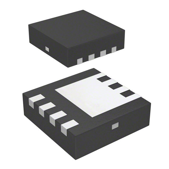

    特性:TrenchFET Gen IV功率MOSFET。 100% Rg和UIS测试。应用:开关模式电源。 个人电脑和服务器
SISHA04DN-T1-GE3 数据手册
SiSHA04DN www.vishay.com Vishay Siliconix N-Channel 30 V (D-S) MOSFET FEATURES PowerPAK® 1212-8SH • TrenchFET ® Gen IV power MOSFET D D 8 D 7 D 6 5 • 100 % Rg and UIS tested • Material categorization: for definitions of compliance please see www.vishay.com/doc?99912 0.9 mm 3.3 mm 1 1 2 S 3 S 4 S G mm 3.3 Top View APPLICATIONS Bottom View • Personal computers and servers PRODUCT SUMMARY VDS (V) RDS(on) max. (Ω) at VGS = 10 V RDS(on) max. (Ω) at VGS = 4.5 V Qg typ. (nC) ID (A) Configuration D • Switch mode power supplies • Telecom bricks G • VRM’s and POL 30 0.00215 0.00310 22.5 40 g Single S N-Channel MOSFET ORDERING INFORMATION Package Lead (Pb)-free and halogen-free PowerPAK 1212-8SH SiSHA04DN-T1-GE3 ABSOLUTE MAXIMUM RATINGS (TA = 25 °C, unless otherwise noted) PARAMETER Drain-source voltage Gate-source voltage SYMBOL VDS VGS TC = 25 °C TC = 70 °C TA = 25 °C TA = 70 °C Continuous drain current (TJ = 150 °C) LIMIT 30 +20, -16 40 g 40 g 30.9 a, b 28.3 a, b 80 40 g 3.3 a, b 20 20 52 43 3.7 a, b 3.1 a, b -55 to +150 260 ID Pulsed drain current (t = 300 μs) IDM Continuous source-drain diode current TC = 25 °C TA = 25 °C IS Single pulse avalanche current Single pulse avalanche energy L = 0.1 mH IAS EAS TC = 25 °C TC = 70 °C Maximum power dissipation TA = 25 °C TA = 70 °C Operating junction and storage temperature range Soldering recommendations (peak temperature) c, d PD TJ, Tstg UNIT V A mJ W °C THERMAL RESISTANCE RATINGS PARAMETER SYMBOL TYPICAL MAXIMUM Maximum junction-to-ambient a, e t ≤ 10 s RthJA 24 33 Maximum junction-to-case (drain) Steady state RthJC 1.9 2.4 UNIT °C/W Notes a. Surface mounted on 1" x 1" FR4 board b. t = 10 s c. See solder profile (www.vishay.com/doc?73257). The PowerPAK 1212-8 is a leadless package. The end of the lead terminal is exposed copper (not plated) as a result of the singulation process in manufacturing. A solder fillet at the exposed copper tip cannot be guaranteed and is not required to ensure adequate bottom side solder interconnection d. Rework conditions: manual soldering with a soldering iron is not recommended for leadless components e. Maximum under steady state conditions is 81 °C/W f. Based on TC = 25 °C g. Package limited S21-0899-Rev. B, 30-Aug-2021 Document Number: 76879 1 For technical questions, contact: pmostechsupport@vishay.com THIS DOCUMENT IS SUBJECT TO CHANGE WITHOUT NOTICE. THE PRODUCTS DESCRIBED HEREIN AND THIS DOCUMENT ARE SUBJECT TO SPECIFIC DISCLAIMERS, SET FORTH AT www.vishay.com/doc?91000 SiSHA04DN www.vishay.com Vishay Siliconix SPECIFICATIONS (TJ = 25 °C, unless otherwise noted) PARAMETER SYMBOL TEST CONDITIONS MIN. TYP. MAX. UNIT VDS VGS = 0 V, ID = 250 μA 30 - - - V 14 - - -5.5 - Static Drain-source breakdown voltage VDS temperature coefficient ΔVDS/TJ ID = 250 μA mV/°C VGS(th) temperature coefficient ΔVGS(th)/TJ Gate-source threshold voltage VGS(th) VDS = VGS , ID = 250 μA 1.1 - 2.2 V IGSS VDS = 0 V, VGS = +20 V, -16 V - - ±100 nA VDS = 30 V, VGS = 0 V - - 1 VDS = 30 V, VGS = 0 V, TJ = 55 °C - - 10 VDS ≥ 5 V, VGS = 10 V 40 - - VGS = 10 V, ID = 15 A - 0.00180 0.00215 VGS = 4.5 V, ID = 10 A - 0.00250 0.00310 VDS = 15 V, ID = 15 A - 105 Gate-source leakage Zero gate voltage drain current IDSS On-state drain current a ID(on) Drain-source on-state resistance a Forward transconductance a RDS(on) gfs μA A Ω S Dynamic b Input capacitance Ciss - 3595 Output capacitance Coss - 1040 - Reverse transfer capacitance Crss - 79 0.044 VDS = 15 V, VGS = 0 V, f = 1 MHz Crss/Ciss ratio Total gate charge Qg Gate-source charge Qgs Gate-drain charge Qgd Output charge Qoss Gate resistance Rg Turn-on delay time Rise time Turn-off delay time Fall time Turn-on delay time Rise time Turn-off delay time Fall time VDS = 15 V, VGS = 10 V, ID = 10 A VDS = 15 V, VGS = 4.5 V, ID = 10 A td(off) - 0.022 - 51 77 - 22.5 34 - 8.6 - - 4 - VDS = 15 V, VGS = 0 V - 30.5 - f = 1 MHz 0.3 1.25 2.5 - 24 48 - 17 34 td(on) tr - VDD = 15 V, RL = 1.5 Ω ID ≅ 10 A, VGEN = 4.5 V, Rg = 1 Ω pF nC Ω - 25 50 tf - 10 20 td(on) - 12 24 - 10 20 - 30 60 - 8 16 - - 40 - - 80 - 0.73 1.1 V - 36 70 ns - 24 48 nC - 16 - - 20 - tr td(off) VDD = 15 V, RL = 1.5 Ω ID ≅ 10 A, VGEN = 10 V, Rg = 1 Ω tf ns Drain-Source Body Diode Characteristics Continuous source-drain diode current IS Pulse diode forward current ISM Body diode voltage VSD Body diode reverse recovery time trr Body diode reverse recovery charge Qrr Reverse recovery fall time ta Reverse recovery rise time tb TC = 25 °C IS = 5 A, VGS = 0 V IF = 10 A, di/dt = 100 A/μs, TJ = 25 °C A ns Notes a. Pulse test; pulse width ≤ 300 μs, duty cycle ≤ 2 % b. Guaranteed by design, not subject to production testing Stresses beyond those listed under “Absolute Maximum Ratings” may cause permanent damage to the device. These are stress ratings only, and functional operation of the device at these or any other conditions beyond those indicated in the operational sections of the specifications is not implied. Exposure to absolute maximum rating conditions for extended periods may affect device reliability. S21-0899-Rev. B, 30-Aug-2021 Document Number: 76879 2 For technical questions, contact: pmostechsupport@vishay.com THIS DOCUMENT IS SUBJECT TO CHANGE WITHOUT NOTICE. THE PRODUCTS DESCRIBED HEREIN AND THIS DOCUMENT ARE SUBJECT TO SPECIFIC DISCLAIMERS, SET FORTH AT www.vishay.com/doc?91000 SiSHA04DN www.vishay.com Vishay Siliconix TYPICAL CHARACTERISTICS (25 °C, unless otherwise noted) Axis Title Axis Title 10000 80 10000 10 VGS = 10 V thru 4 V VGS = 3 V 32 100 16 1000 6 1st line 2nd line 1000 48 2nd line ID - Drain Current (A) 8 1st line 2nd line 2nd line ID - Drain Current (A) 64 4 100 TC = 25 °C 2 TC = -55 °C TC = 125 °C VGS = 2 V 10 0 0 0.5 1.0 1.5 2.0 10 0 2.5 0 1 2 3 4 VDS - Drain-to-Source Voltage (V) VGS - Gate-to-Source Voltage (V) Output Characteristics Transfer Characteristics Axis Title 5 Axis Title 10000 0.0040 10000 4000 Ciss 1st line 2nd line VGS = 4.5 V 0.0022 100 VGS = 10 V 0.0016 1000 2400 1st line 2nd line 1000 0.0028 2nd line C - Capacitance (pF) 3200 2nd line RDS(on) - On-Resistance (Ω) 0.0034 Coss 1600 100 800 Crss 10 0.0010 10 20 30 40 10 0 50 0 5 10 20 25 ID - Drain Current (A) VDS - Drain-to-Source Voltage (V) On-Resistance vs. Drain Current and Gate Voltage Capacitance Axis Title 1000 1st line 2nd line VDS = 10 V VDS = 20 V 4 100 2 10 0 0 11 22 33 44 55 2nd line RDS(on) - On-Resistance (Normalized) 8 VDS = 15 V 10000 1.7 ID = 10 A 6 30 Axis Title 10000 10 2nd line VGS - Gate-to-Source Voltage (V) 15 ID = 15 A 1.5 VGS = 10 V VGS = 4.5 V 1.1 100 0.9 10 0.7 -50 -25 0 25 50 75 100 125 150 Qg - Total Gate Charge (nC) TJ - Junction Temperature (°C) Gate Charge On-Resistance vs. Junction Temperature S21-0899-Rev. B, 30-Aug-2021 1000 1.3 1st line 2nd line 0 Document Number: 76879 3 For technical questions, contact: pmostechsupport@vishay.com THIS DOCUMENT IS SUBJECT TO CHANGE WITHOUT NOTICE. THE PRODUCTS DESCRIBED HEREIN AND THIS DOCUMENT ARE SUBJECT TO SPECIFIC DISCLAIMERS, SET FORTH AT www.vishay.com/doc?91000 SiSHA04DN www.vishay.com Vishay Siliconix TYPICAL CHARACTERISTICS (25 °C, unless otherwise noted) Axis Title Axis Title 10000 100 10000 0.015 ID = 15 A 1000 TJ = 25 °C 0.1 100 0.01 0.012 1000 0.009 1st line 2nd line 2nd line RDS(on) - On-Resistance (Ω) TJ = 150 °C 1 1st line 2nd line 2nd line IS - Source Current (A) 10 0.006 100 TJ = 125 °C 0.003 TJ = 25 °C 10 0.001 0 0.2 0.4 0.6 0.8 1.0 10 0 1.2 0 2 4 8 10 VSD - Source-to-Drain Voltage (V) VGS - Gate-to-Source Voltage (V) Source-Drain Diode Forward Voltage On-Resistance vs. Gate-to-Source Voltage Axis Title Axis Title 10000 0.4 10000 100 0.2 80 ID = 5 mA 100 -0.4 60 1st line 2nd line -0.2 1000 2nd line P - Power (W) 1000 0 1st line 2nd line 2nd line VGS(th) - Variance (V) 6 40 100 ID = 250 μA 20 -0.6 10 -0.8 -50 -25 0 25 50 75 10 0 0.001 100 125 150 0.01 0.1 1 10 TJ - Junction Temperature (°C) t - Time (s) Threshold Voltage Single Pulse Power, Junction-to-Ambient Axis Title 100 10000 IDM limited ID limited 1 ms 1000 10 ms Limited by RDS(on) a 1st line 2nd line 2nd line ID - Drain Current (A) 100 μs 10 1 100 ms 1s 10 s 0.1 100 DC TC = 25 °C, single pulse 0.01 0.01 BVDSS limited 10 0.1 1 10 100 VDS - Drain-to-Source Voltage (V) Safe Operating Area, Junction-to-Ambient Note a. VGS > minimum VGS at which RDS(on) is specified S21-0899-Rev. B, 30-Aug-2021 Document Number: 76879 4 For technical questions, contact: pmostechsupport@vishay.com THIS DOCUMENT IS SUBJECT TO CHANGE WITHOUT NOTICE. THE PRODUCTS DESCRIBED HEREIN AND THIS DOCUMENT ARE SUBJECT TO SPECIFIC DISCLAIMERS, SET FORTH AT www.vishay.com/doc?91000 SiSHA04DN www.vishay.com Vishay Siliconix TYPICAL CHARACTERISTICS (25 °C, unless otherwise noted) Axis Title 10000 130 1000 78 1st line 2nd line 2nd line ID - Drain Current (A) 104 52 Package limited 100 26 10 0 0 25 50 75 100 125 150 TC - Case Temperature (°C) Current Derating a Axis Title Axis Title 10000 65 1.6 1st line 2nd line 26 100 1000 1.2 1st line 2nd line 1000 39 2nd line P - Power (W) 52 2nd line P - Power (W) 10000 2.0 0.8 100 0.4 13 10 0 0 25 50 75 100 125 150 10 0 0 25 50 75 100 125 TC - Case Temperature (°C) TA - Ambient Temperature (°C) Power, Junction-to-Case Power, Junction-to-Ambient 150 Note a. The power dissipation PD is based on TJ max. = 150 °C, using junction-to-case thermal resistance, and is more useful in settling the upper dissipation limit for cases where additional heatsinking is used. It is used to determine the current rating, when this rating falls below the package limit. S21-0899-Rev. B, 30-Aug-2021 Document Number: 76879 5 For technical questions, contact: pmostechsupport@vishay.com THIS DOCUMENT IS SUBJECT TO CHANGE WITHOUT NOTICE. THE PRODUCTS DESCRIBED HEREIN AND THIS DOCUMENT ARE SUBJECT TO SPECIFIC DISCLAIMERS, SET FORTH AT www.vishay.com/doc?91000 SiSHA04DN www.vishay.com Vishay Siliconix TYPICAL CHARACTERISTICS (25 °C, unless otherwise noted) Axis Title 10000 Duty cycle = 0.5 Notes 1000 0.2 1st line 2nd line Normalized Effective Transient Thermal Impedance 1 PDM 0.1 0.1 t1 t2 t1 1. Duty cycle, D = t 2 2. Per unit base = RthJA = 81 °C/W 0.05 0.02 3. TJM - TA = PDMZthJA Single pulse 0.01 0.0001 0.001 0.01 100 (t) 4. Surface mounted 0.1 1 10 100 10 1000 Square Wave Pulse Duration (s) Normalized Thermal Transient Impedance, Junction-to-Ambient Axis Title 1 10000 0.2 1000 0.1 0.1 1st line 2nd line Normalized Effective Transient Thermal Impedance Duty cycle = 0.5 0.05 0.02 Single pulse 100 0.01 0.0001 10 0.001 0.01 0.1 1 Square Wave Pulse Duration (s) Normalized Thermal Transient Impedance, Junction-to-Case Vishay Siliconix maintains worldwide manufacturing capability. Products may be manufactured at one of several qualified locations. Reliability data for Silicon Technology and Package Reliability represent a composite of all qualified locations. For related documents such as package / tape drawings, part marking, and reliability data, see www.vishay.com/ppg?76879. S21-0899-Rev. B, 30-Aug-2021 Document Number: 76879 6 For technical questions, contact: pmostechsupport@vishay.com THIS DOCUMENT IS SUBJECT TO CHANGE WITHOUT NOTICE. THE PRODUCTS DESCRIBED HEREIN AND THIS DOCUMENT ARE SUBJECT TO SPECIFIC DISCLAIMERS, SET FORTH AT www.vishay.com/doc?91000 Package Information www.vishay.com Vishay Siliconix Case Outline for PowerPAK® 1212-SWLH and PowerPAK® 1212-8SH A 0.10 C Z D 8 7 6 5 1 2 3 4 D1 5 6 b 4 3 7 8 2 1 K E E1 K1 2x L B 0.10 C 2x e 0.10 M C A B 0.05 M C Pin 1 dot 0.10 C A C 0.08 C A1 A3 DIM. MILLIMETERS INCHES MIN. NOM. MAX. MIN. NOM. MAX. A 0.82 0.90 0.98 0.032 0.035 0.038 A1 0.00 - 0.05 0.000 - 0.002 A3 0.20 ref. 0.008 ref. b 0.25 0.30 0.35 0.010 0.012 0.014 D 3.20 3.30 3.40 0.126 0.130 0.134 D1 2.15 2.25 2.35 0.085 0.089 0.093 E 3.20 3.30 3.40 0.126 0.130 0.134 E1 1.60 1.70 1.80 0.063 0.067 0.071 e 0.65 bsc. K 0.76 ref. 0.030 ref. K1 0.41 ref. 0.016 ref. L 0.33 Z 0.43 0.525 ref. 0.026 bsc. 0.53 0.013 0.017 0.021 0.021 ref. ECN: S20-0930-Rev. C, 07-Dec-2020 DWG: 6062 Revision: 07-Dec-2020 Document Number: 76384 1 For technical questions, contact: pmostechsupport@vishay.com THIS DOCUMENT IS SUBJECT TO CHANGE WITHOUT NOTICE. THE PRODUCTS DESCRIBED HEREIN AND THIS DOCUMENT ARE SUBJECT TO SPECIFIC DISCLAIMERS, SET FORTH AT www.vishay.com/doc?91000 Legal Disclaimer Notice www.vishay.com Vishay Disclaimer ALL PRODUCT, PRODUCT SPECIFICATIONS AND DATA ARE SUBJECT TO CHANGE WITHOUT NOTICE TO IMPROVE RELIABILITY, FUNCTION OR DESIGN OR OTHERWISE. Vishay Intertechnology, Inc., its affiliates, agents, and employees, and all persons acting on its or their behalf (collectively, “Vishay”), disclaim any and all liability for any errors, inaccuracies or incompleteness contained in any datasheet or in any other disclosure relating to any product. Vishay makes no warranty, representation or guarantee regarding the suitability of the products for any particular purpose or the continuing production of any product. To the maximum extent permitted by applicable law, Vishay disclaims (i) any and all liability arising out of the application or use of any product, (ii) any and all liability, including without limitation special, consequential or incidental damages, and (iii) any and all implied warranties, including warranties of fitness for particular purpose, non-infringement and merchantability. Statements regarding the suitability of products for certain types of applications are based on Vishay's knowledge of typical requirements that are often placed on Vishay products in generic applications. Such statements are not binding statements about the suitability of products for a particular application. It is the customer's responsibility to validate that a particular product with the properties described in the product specification is suitable for use in a particular application. Parameters provided in datasheets and / or specifications may vary in different applications and performance may vary over time. All operating parameters, including typical parameters, must be validated for each customer application by the customer's technical experts. Product specifications do not expand or otherwise modify Vishay's terms and conditions of purchase, including but not limited to the warranty expressed therein. Hyperlinks included in this datasheet may direct users to third-party websites. These links are provided as a convenience and for informational purposes only. Inclusion of these hyperlinks does not constitute an endorsement or an approval by Vishay of any of the products, services or opinions of the corporation, organization or individual associated with the third-party website. Vishay disclaims any and all liability and bears no responsibility for the accuracy, legality or content of the third-party website or for that of subsequent links. Except as expressly indicated in writing, Vishay products are not designed for use in medical, life-saving, or life-sustaining applications or for any other application in which the failure of the Vishay product could result in personal injury or death. Customers using or selling Vishay products not expressly indicated for use in such applications do so at their own risk. Please contact authorized Vishay personnel to obtain written terms and conditions regarding products designed for such applications. No license, express or implied, by estoppel or otherwise, to any intellectual property rights is granted by this document or by any conduct of Vishay. Product names and markings noted herein may be trademarks of their respective owners. © 2021 VISHAY INTERTECHNOLOGY, INC. ALL RIGHTS RESERVED Revision: 09-Jul-2021 1 Document Number: 91000
