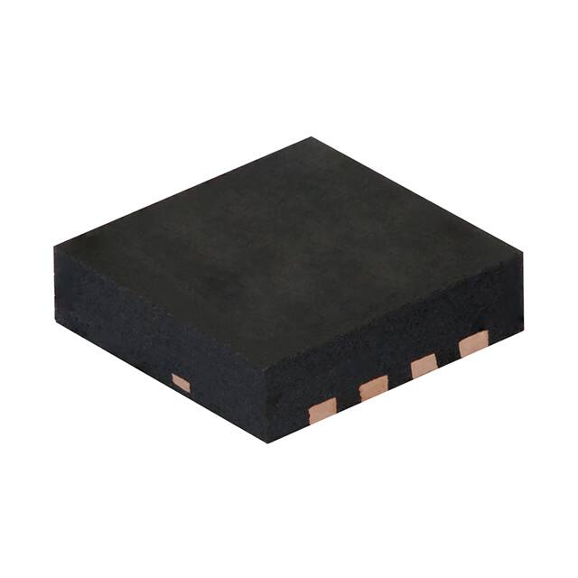

SiSS52DN www.vishay.com Vishay Siliconix N-Channel 30 V (D-S) MOSFET FEATURES PowerPAK® 1212-8S D D D 7 8 D 6 5 3. 3 m m 1 3.3 mm Top View • TrenchFET® Gen V power MOSFET • Very low RDS x Qg figure-of-merit (FOM) • Enables higher power density with very low RDS(on) and thermally enhanced compact package 4 G Bottom View 3 S 2 S • 100 % Rg and UIS tested • Material categorization: for definitions of compliance please see www.vishay.com/doc?99912 1 S APPLICATIONS PRODUCT SUMMARY VDS (V) RDS(on) max. (Ω) at VGS = 10 V RDS(on) max. (Ω) at VGS = 4.5 V Qg typ. (nC) ID (A) Configuration • • • • • 30 0.0012 0.0019 19.9 162 Single D DC/DC converter POL Synchronous rectification Battery management Power and load switch G S N-Channel MOSFET ORDERING INFORMATION Package Lead (Pb)-free and halogen-free PowerPAK 1212-8S SiSS52DN-T1-GE3 ABSOLUTE MAXIMUM RATINGS (TA = 25 °C, unless otherwise noted) PARAMETER Drain-source voltage Gate-source voltage Continuous drain current (TJ = 150 °C) SYMBOL VDS VGS TC = 25 °C TC = 70 °C TA = 25 °C TA = 70 °C Pulsed drain current (t = 100 μs) ID IDM Continuous source-drain diode current TC = 25 °C TA = 25 °C IS Single pulse avalanche current Single pulse avalanche energy L = 0.1 mH IAS EAS TC = 25 °C TC = 70 °C Maximum power dissipation TA = 25 °C TA = 70 °C Operating junction and storage temperature range Soldering recommendations (peak temperature) c PD TJ, Tstg LIMIT 30 +16 / -12 162 129 47.1 b, c 37.7 b, c 250 51.8 4.3 b, c 30 45 57 36 4.8 b, c 3 b, c -55 to +150 260 UNIT V A mJ W °C THERMAL RESISTANCE RATINGS PARAMETER SYMBOL TYPICAL MAXIMUM UNIT Maximum junction-to-ambient b t ≤ 10 s RthJA 21 26 °C/W Maximum junction-to-case (drain) Steady state RthJC 1.7 2.2 Notes a. Package limited b. Surface mounted on 1" x 1" FR4 board c. t = 10 s d. See solder profile (www.vishay.com/doc?73257). The PowerPAK 1212-8S is a leadless package. The end of the lead terminal is exposed copper (not plated) as a result of the singulation process in manufacturing. A solder fillet at the exposed copper tip cannot be guaranteed and is not required to ensure adequate bottom side solder interconnection e. Rework conditions: manual soldering with a soldering iron is not recommended for leadless components f. Maximum under steady state conditions is 70 °C/W g. TC = 25 °C S21-0001-Rev. B, 11-Jan-2021 Document Number: 79977 1 For technical questions, contact: pmostechsupport@vishay.com THIS DOCUMENT IS SUBJECT TO CHANGE WITHOUT NOTICE. THE PRODUCTS DESCRIBED HEREIN AND THIS DOCUMENT ARE SUBJECT TO SPECIFIC DISCLAIMERS, SET FORTH AT www.vishay.com/doc?91000 SiSS52DN www.vishay.com Vishay Siliconix SPECIFICATIONS (TJ = 25 °C, unless otherwise noted) PARAMETER SYMBOL TEST CONDITIONS MIN. TYP. MAX. UNIT V Static Drain-source breakdown voltage VDS VGS = 0 V, ID = 1 mA 30 - - ΔVDS/TJ ID = 10 mA - 21 - VGS(th) temperature coefficient ΔVGS(th)/TJ ID = 250 μA - -4.2 - Gate-source threshold voltage VGS(th) VDS = VGS, ID = 250 μA 1 - 2.2 V IGSS VDS = 0 V, VGS = +16 / -12 V - - 100 nA VDS = 24 V, VGS = 0 V - - 1 VDS = 24 V, VGS = 0 V, TJ = 70 °C - - 15 VDS ≥ 10 V, VGS = 10 V 40 - - VDS temperature coefficient Gate-source leakage Zero gate voltage drain current IDSS On-state drain current a ID(on) Drain-source on-state resistance a Forward transconductance a Dynamic RDS(on) gfs VGS = 10 V, ID = 20 A - 0.00095 0.0012 VGS = 4.5 V, ID = 20 A - 0.0015 0.0019 VDS = 15 V, ID = 20 A - 95 - - 2950 - - 1035 - - 88 - mV/°C μA A Ω S b Input capacitance Ciss Output capacitance Coss Reverse transfer capacitance Crss Total gate charge Qg Gate-source charge Qgs VDS = 15 V, VGS = 0 V, f = 1 MHz VDS = 15 V, VGS = 10 V, ID = 20 A VDS = 15 V, VGS = 4.5 V, ID =20 A - 43.2 65 - 19.9 30 - 9.6 - Gate-drain charge Qgd - 3.9 - Output charge Qoss VDS = 15 V, VGS = 0 V - 29 - Rg f = 1 MHz 0.2 0.42 0.8 - 12 24 - 6 12 - 26 52 Gate resistance Turn-on delay time Rise time Turn-off delay time Fall time Turn-on delay time Rise time Turn-off delay time Fall time td(on) tr td(off) VDD = 15 V, RL = 0.75 Ω, ID ≅ 20 A, VGEN = 10 V, Rg = 1 Ω pF nC Ω tf - 6 12 td(on) - 23 46 - 150 300 - 31 62 - 13 26 - - 51.8 - - 250 - 0.73 1.1 V - 34 68 ns - 25 50 nC - 18 - - 16 - tr td(off) VDD = 15 V, RL = 0.75 Ω, ID ≅ 20 A, VGEN = 4.5 V, Rg = 1 Ω tf ns Drain-Source Body Diode Characteristics Continuous source-drain diode current IS Pulse diode forward current ISM Body diode voltage VSD Body diode reverse recovery time trr Body diode reverse recovery charge Qrr Reverse recovery fall time ta Reverse recovery rise time tb TC = 25 °C IS = 5 A, VGS = 0 V IF = 10 A, di/dt = 100 A/μs, TJ = 25 °C A ns Notes a. Pulse test; pulse width ≤ 300 μs, duty cycle ≤ 2 % b. Guaranteed by design, not subject to production testing Stresses beyond those listed under “Absolute Maximum Ratings” may cause permanent damage to the device. These are stress ratings only, and functional operation of the device at these or any other conditions beyond those indicated in the operational sections of the specifications is not implied. Exposure to absolute maximum rating conditions for extended periods may affect device reliability. S21-0001-Rev. B, 11-Jan-2021 Document Number: 79977 2 For technical questions, contact: pmostechsupport@vishay.com THIS DOCUMENT IS SUBJECT TO CHANGE WITHOUT NOTICE. THE PRODUCTS DESCRIBED HEREIN AND THIS DOCUMENT ARE SUBJECT TO SPECIFIC DISCLAIMERS, SET FORTH AT www.vishay.com/doc?91000 SiSS52DN www.vishay.com Vishay Siliconix TYPICAL CHARACTERISTICS (25 °C, unless otherwise noted) Axis Title Axis Title 10000 100 10000 150 VGS = 10 V thru 4 V 120 40 100 1000 90 1st line 2nd line 1000 60 2nd line ID - Drain Current (A) VGS = 3 V 1st line 2nd line 2nd line ID - Drain Current (A) 80 60 TC = 25 °C 100 30 20 TC = 125 °C TC = -55 °C VGS = 2 V 10 0 0 1 2 3 4 10 0 0 5 1 2 3 4 VDS - Drain-to-Source Voltage (V) VGS - Gate-to-Source Voltage (V) Output Characteristics Transfer Characteristics Axis Title 5 Axis Title 10000 0.0018 10000 10 000 0.0016 0.0014 0.0012 100 VGS = 10 V Coss 1000 1000 1st line 2nd line 1000 2nd line C - Capacitance (pF) VGS = 4.5 V 1st line 2nd line 2nd line RDS(on) - On-Resistance (Ω) Ciss Crss 100 100 0.0010 0 16 32 48 64 10 10 10 0.0008 0 80 6 12 24 ID - Drain Current (A) VDS - Drain-to-Source Voltage (V) On-Resistance vs. Drain Current and Gate Voltage Capacitance Axis Title 1st line 2nd line VDS =10 V, 15 V, 20 V 100 2 10 0 0 9 18 27 36 45 1.4 VGS = 10 V, 20 A 1000 1.2 1st line 2nd line 1000 2nd line RDS(on) - On-Resistance (Normalized) ID = 20 A 6 10000 1.6 8 4 30 Axis Title 10000 10 2nd line VGS - Gate-to-Source Voltage (V) 18 1 VGS = 4.5 V, 20 A 0.8 10 0.6 -50 -25 0 25 50 75 100 125 150 Qg - Total Gate Charge (nC) TJ - Junction Temperature (°C) Gate Charge On-Resistance vs. Junction Temperature S21-0001-Rev. B, 11-Jan-2021 100 Document Number: 79977 3 For technical questions, contact: pmostechsupport@vishay.com THIS DOCUMENT IS SUBJECT TO CHANGE WITHOUT NOTICE. THE PRODUCTS DESCRIBED HEREIN AND THIS DOCUMENT ARE SUBJECT TO SPECIFIC DISCLAIMERS, SET FORTH AT www.vishay.com/doc?91000 SiSS52DN www.vishay.com Vishay Siliconix TYPICAL CHARACTERISTICS (25 °C, unless otherwise noted) Axis Title Axis Title 10000 0.4 10000 100 2nd line VGS(th) - Variance (V) TJ = 150 °C 1 TJ = 25 °C 100 0.1 1000 0 ID = 5 mA -0.2 100 ID = 250 μA -0.4 0.01 10 0 0.2 0.4 0.6 0.8 10 -0.6 1.2 1 1st line 2nd line 1000 1st line 2nd line 2nd line IS - Source Current (A) 0.2 10 -50 -25 0 25 50 75 100 125 150 VSD - Source-to-Drain Voltage (V) TJ - Junction Temperature (°C) Source-Drain Diode Forward Voltage Threshold Voltage Axis Title Axis Title 10000 0.005 10000 500 400 TJ = 125 °C 100 300 1st line 2nd line 0.002 1000 2nd line P - Power (W) 1000 0.003 1st line 2nd line 2nd line RDS(on) - On-Resistance (Ω) ID = 20 A 0.004 200 100 0.001 100 TJ = 25 °C 10 0 0 2 4 6 8 0 0.0001 10 10 0.001 0.01 0.1 1 10 VGS - Gate-to-Source Voltage (V) t - Time (s) On-Resistance vs. Gate-to-Source Voltage Single Pulse Power, Junction-to-Ambient Axis Title 10000 1000 IDM limited ID limited 100 μs1000 10 Limited by RDS(on) 1st line 2nd line 2nd line ID - Drain Current (A) 100 1 ms a 10 ms 1 100 ms100 1s 0.1 10s TA = 25 °C, single pulse 0.01 0.01 BVDSS limited DC 10 0.1 1 10 100 VDS - Drain-to-Source Voltage (V) Safe Operating Area, Junction-to-Ambient Note a. VGS > minimum VGS at which RDS(on) is specified S21-0001-Rev. B, 11-Jan-2021 Document Number: 79977 4 For technical questions, contact: pmostechsupport@vishay.com THIS DOCUMENT IS SUBJECT TO CHANGE WITHOUT NOTICE. THE PRODUCTS DESCRIBED HEREIN AND THIS DOCUMENT ARE SUBJECT TO SPECIFIC DISCLAIMERS, SET FORTH AT www.vishay.com/doc?91000 SiSS52DN www.vishay.com Vishay Siliconix TYPICAL CHARACTERISTICS (25 °C, unless otherwise noted) Axis Title 10000 200 1000 120 1st line 2nd line 2nd line ID - Drain Current (A) 160 80 100 40 10 0 0 25 50 75 100 125 150 TC - Case Temperature (°C) Current Derating a Axis Title Axis Title 10000 70 2.0 1st line 2nd line 28 100 14 1000 1.5 1st line 2nd line 1000 42 2nd line P - Power (W) 56 2nd line P - Power (W) 10000 2.5 1.0 100 0.5 10 0 0 25 50 75 100 125 150 10 0 0 25 50 75 100 125 TC - Case Temperature (°C) TA - Ambient Temperature (°C) Power, Junction-to-Case Power, Junction-to-Ambient 150 Note a. The power dissipation PD is based on TJ max. = 150 °C, using junction-to-case thermal resistance, and is more useful in settling the upper dissipation limit for cases where additional heatsinking is used. It is used to determine the current rating, when this rating falls below the package limit S21-0001-Rev. B, 11-Jan-2021 Document Number: 79977 5 For technical questions, contact: pmostechsupport@vishay.com THIS DOCUMENT IS SUBJECT TO CHANGE WITHOUT NOTICE. THE PRODUCTS DESCRIBED HEREIN AND THIS DOCUMENT ARE SUBJECT TO SPECIFIC DISCLAIMERS, SET FORTH AT www.vishay.com/doc?91000 SiSS52DN www.vishay.com Vishay Siliconix TYPICAL CHARACTERISTICS (25 °C, unless otherwise noted) Axis Title 10000 Duty cycle = 0.5 Notes 0.2 1000 PDM 1st line 2nd line Normalized Effective Transient Thermal Impedance 1 0.1 0.1 t1 t2 0.05 t1 t2 2. Per unit base = RthJA = 70 °C/W 1. Duty cycle, D = 0.02 3. TJM - TA = PDMZthJA Single pulse 100 (t) 4. Surface mounted 0.01 0.0001 0.001 0.01 0.1 1 10 100 10 1000 Square Wave Pulse Duration (s) Normalized Thermal Transient Impedance, Junction-to-Ambient Axis Title 1 10000 Normalized Effective Transient Thermal Impedance Duty cycle = 0.5 1st line 2nd line 1000 0.2 0.1 100 0.05 0.02 Single pulse 0.1 0.0001 10 0.001 0.01 0.1 1 Square Wave Pulse Duration (s) Normalized Thermal Transient Impedance, Junction-to-Case Vishay Siliconix maintains worldwide manufacturing capability. Products may be manufactured at one of several qualified locations. Reliability data for Silicon Technology and Package Reliability represent a composite of all qualified locations. For related documents such as package / tape drawings, part marking, and reliability data, see www.vishay.com/ppg?79977. S21-0001-Rev. B, 11-Jan-2021 Document Number: 79977 6 For technical questions, contact: pmostechsupport@vishay.com THIS DOCUMENT IS SUBJECT TO CHANGE WITHOUT NOTICE. THE PRODUCTS DESCRIBED HEREIN AND THIS DOCUMENT ARE SUBJECT TO SPECIFIC DISCLAIMERS, SET FORTH AT www.vishay.com/doc?91000 Package Information www.vishay.com Vishay Siliconix Case Outline for PowerPAK® 1212-8S A 0.10 C 2x D 8 7 Z 6 5 D1 5 6 b 4 3 7 8 2 1 K1 E1 E K B L 0.10 C 1 2x 2 3 4 Pin 1 dot e 0.10 M C A B 0.05 M C 0.10 C C A A3 0.08 C A1 A MIN. 0.67 MILLIMETERS NOM. 0.75 MAX. 0.83 MIN. 0.026 INCHES NOM. 0.030 MAX. 0.033 A1 0.00 - 0.05 0.000 - 0.002 DIM. A3 0.20 ref. 0.008 ref b 0.25 0.30 0.35 0.010 0.012 D 3.20 3.30 3.40 0.126 0.130 0.134 D1 2.15 2.25 2.35 0.085 0.089 0.093 E 3.20 3.30 3.40 0.126 0.130 0.134 E1 1.60 1.70 1.80 0.063 0.067 0.071 e 0.65 bsc. 0.026 bsc. K 0.76 ref. 0.030 ref. K1 L 0.41 ref. 0.33 Z 0.43 0.525 ref. 0.014 0.016 ref. 0.53 0.013 0.017 0.021 0.021 ref. ECN: C20-0862-Rev. B, 20-Jul-2020 DWG: 6008 Revision: 20-Jul-2020 Document Number: 63919 1 For technical questions, contact: pmostechsupport@vishay.com THIS DOCUMENT IS SUBJECT TO CHANGE WITHOUT NOTICE. THE PRODUCTS DESCRIBED HEREIN AND THIS DOCUMENT ARE SUBJECT TO SPECIFIC DISCLAIMERS, SET FORTH AT www.vishay.com/doc?91000 Application Note 826 Vishay Siliconix RECOMMENDED MINIMUM PADS FOR PowerPAK® 1212-8 Single 0.152 (3.860) 0.039 0.068 (0.990) (1.725) 0.010 (0.255) (2.390) 0.094 0.088 (2.235) 0.016 (0.405) 0.026 (0.660) 0.025 0.030 (0.635) (0.760) Recommended Minimum Pads Dimensions in Inches/(mm) Return to Index Return to Index APPLICATION NOTE Document Number: 72597 Revision: 21-Jan-08 www.vishay.com 7 Legal Disclaimer Notice www.vishay.com Vishay Disclaimer ALL PRODUCT, PRODUCT SPECIFICATIONS AND DATA ARE SUBJECT TO CHANGE WITHOUT NOTICE TO IMPROVE RELIABILITY, FUNCTION OR DESIGN OR OTHERWISE. Vishay Intertechnology, Inc., its affiliates, agents, and employees, and all persons acting on its or their behalf (collectively, “Vishay”), disclaim any and all liability for any errors, inaccuracies or incompleteness contained in any datasheet or in any other disclosure relating to any product. Vishay makes no warranty, representation or guarantee regarding the suitability of the products for any particular purpose or the continuing production of any product. To the maximum extent permitted by applicable law, Vishay disclaims (i) any and all liability arising out of the application or use of any product, (ii) any and all liability, including without limitation special, consequential or incidental damages, and (iii) any and all implied warranties, including warranties of fitness for particular purpose, non-infringement and merchantability. Statements regarding the suitability of products for certain types of applications are based on Vishay's knowledge of typical requirements that are often placed on Vishay products in generic applications. Such statements are not binding statements about the suitability of products for a particular application. It is the customer's responsibility to validate that a particular product with the properties described in the product specification is suitable for use in a particular application. Parameters provided in datasheets and / or specifications may vary in different applications and performance may vary over time. All operating parameters, including typical parameters, must be validated for each customer application by the customer's technical experts. Product specifications do not expand or otherwise modify Vishay's terms and conditions of purchase, including but not limited to the warranty expressed therein. Hyperlinks included in this datasheet may direct users to third-party websites. These links are provided as a convenience and for informational purposes only. Inclusion of these hyperlinks does not constitute an endorsement or an approval by Vishay of any of the products, services or opinions of the corporation, organization or individual associated with the third-party website. Vishay disclaims any and all liability and bears no responsibility for the accuracy, legality or content of the third-party website or for that of subsequent links. Except as expressly indicated in writing, Vishay products are not designed for use in medical, life-saving, or life-sustaining applications or for any other application in which the failure of the Vishay product could result in personal injury or death. Customers using or selling Vishay products not expressly indicated for use in such applications do so at their own risk. Please contact authorized Vishay personnel to obtain written terms and conditions regarding products designed for such applications. No license, express or implied, by estoppel or otherwise, to any intellectual property rights is granted by this document or by any conduct of Vishay. Product names and markings noted herein may be trademarks of their respective owners. © 2021 VISHAY INTERTECHNOLOGY, INC. ALL RIGHTS RESERVED Revision: 09-Jul-2021 1 Document Number: 91000
