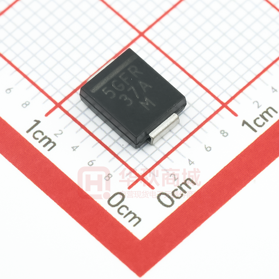

SMC5K10A thru SMC5K85A www.vishay.com Vishay General Semiconductor Surface Mount TRANSZORB® Transient Voltage Suppressors FEATURES • Unidirectional • Peak pulse power: - 5000 W (10/1000 μs) - 40 kW (8/20 μs) • Excellent clamping capability • Very fast response time • Low incremental surge resistance SMC (DO-214AB) Cathode • Meets MSL level 1, per J-STD-020, LF maximum peak of 260 °C Anode LINKS TO ADDITIONAL RESOURCES 3D 3D • AEC-Q101 qualified - Automotive ordering code: base P/NHM3 for SMC5K10A to SMC5K20A • UL recognition for safety 497B with file number E136766 • Material categorization: for definitions of compliance please see www.vishay.com/doc?99912 3D Models MECHANICAL DATA PRIMARY CHARACTERISTICS VBR 11.1 V to 104 V VWM 10 V to 85 V PPPM 5000 W TJ max. 150 °C Polarity Unidirectional Package SMC (DO-214AB) TYPICAL APPLICATIONS Use in sensitive electronics protection against voltage transients induced by inductive load switching and lighting on ICs, MOSFET, signal lines of sensor units for consumer, computer, industrial, automotive, and telecommunication. Case: SMC (DO-214AB) Molding compound meets UL 94 V-0 flammability rating Base P/N-M3 - halogen-free, RoHS-compliant Base P/NHM3_X - halogen-free, RoHS-compliant, and AEC-Q101 qualified (“_X” denotes revision code e.g. A, B, ... and only available for SMC5K10A to 20A types) Terminals: matte tin plated leads, solderable per J-STD-002 and JESD 22-B102 M3 suffix meets JESD 201 class 2 whisker test, HM3 suffix meets JESD 201 class 2 whisker test Note • SMC5K22A to SMC5K85A for industrial grade only Polarity: color band denotes cathode end MAXIMUM RATINGS (TA = 25 °C unless otherwise noted) PARAMETER SYMBOL VALUE UNIT Peak pulse power dissipation with a 10/1000 μs waveform (fig. 1) PPPM (1) 5000 W Peak pulse current with a 10/1000 μs waveform (fig 3.) IPPM (1) See next table A TJ, TSTG -55 to +150 °C Operating junction and storage temperature range Note (1) Non-repetitive current pulse, per fig. 3 and derated above T = 25 °C, per fig. 2 A Revision: 13-Sep-2022 Document Number: 87742 1 For technical questions within your region: DiodesAmericas@vishay.com, DiodesAsia@vishay.com, DiodesEurope@vishay.com THIS DOCUMENT IS SUBJECT TO CHANGE WITHOUT NOTICE. THE PRODUCTS DESCRIBED HEREIN AND THIS DOCUMENT ARE SUBJECT TO SPECIFIC DISCLAIMERS, SET FORTH AT www.vishay.com/doc?91000 SMC5K10A thru SMC5K85A www.vishay.com Vishay General Semiconductor ELECTRICAL CHARACTERISTICS (TA = 25 °C unless otherwise noted) DEVICE TYPE DEVICE MARKING CODE SMC5K10A 5GDX BREAKDOWN VOLTAGE VBR AT IT (1) (V) MIN. MAX. 11.1 12.3 TEST CURRENT IT (mA) STAND-OFF VOLTAGE VWM (V) MAXIMUM REVERSE LEAKAGE AT VWMID (μA) 1.0 10 10.0 MAXIMUM CLAMPING VOLTAGE VC AT IPPM 10/1000 μs MAXIMUM CLAMPING VOLTAGE VC AT IPPM 8/20 μs (V) (A) (V) (A) 17.0 294 24.1 1660 SMC5K12A 5GEE 13.3 14.7 1.0 12 5.0 19.9 251 25.3 1581 SMC5K13A 5GEG 14.4 15.9 1.0 13 2.0 21.5 233 27.2 1471 SMC5K14A 5GEK 15.6 17.2 1.0 14 2.0 23.2 216 30.0 1333 SMC5K15A 5GEM 16.7 18.5 1.0 15 2.0 24.4 205 32.5 1231 SMC5K16A 5GEP 17.8 19.7 1.0 16 2.0 26.0 192 34.4 1163 SMC5K17A 5GER 18.9 20.9 1.0 17 2.0 27.6 181 37.0 1081 SMC5K18A 5GET 20.0 22.1 1.0 18 2.0 29.2 171 39.3 1018 SMC5K20A 5GEV 22.2 24.5 1.0 20 2.0 32.4 154 42.8 935 SMC5K22A 5GEX 24.4 26.9 1.0 22 1.0 35.5 141 48.2 830 SMC5K24A 5GEZ 26.7 29.5 1.0 24 1.0 38.9 129 51.6 775 SMC5K26A 5GFE 28.9 31.9 1.0 26 1.0 42.1 119 55.8 717 SMC5K28A 5GFG 31.1 34.4 1.0 28 1.0 45.4 110 60.2 664 SMC5K30A 5GFK 33.3 36.8 1.0 30 1.0 48.4 103 64.0 625 SMC5K33A 5GFM 36.7 40.6 1.0 33 1.0 53.3 93.8 69.8 573 SMC5K36A 5GFP 40.0 44.2 1.0 36 1.0 58.1 86.1 76.0 526 SMC5K40A 5GFR 44.4 49.1 1.0 40 1.0 64.5 77.5 84.0 476 SMC5K43A 5GFT 47.8 52.8 1.0 43 1.0 69.4 72.0 90.3 443 SMC5K45A 5GFV 50.0 55.3 1.0 45 1.0 72.7 68.8 94.6 423 SMC5K48A 5GFX 53.3 58.9 1.0 48 1.0 77.4 64.6 100 400 SMC5K51A 5GFZ 56.7 62.7 1.0 51 1.0 82.4 60.7 107 374 SMC5K54A 5GGE 60.0 66.3 1.0 54 1.0 87.1 57.4 113 354 SMC5K58A 5GGG 64.4 71.2 1.0 58 1.0 93.6 53.4 121 331 SMC5K60A 5GGK 66.7 73.7 1.0 60 1.0 96.8 51.7 125 320 SMC5K64A 5GGM 71.1 78.6 1.0 64 1.0 103 48.5 134 299 SMC5K70A 5GGP 77.8 86.0 1.0 70 1.0 113 44.2 146 274 SMC5K75A 5GGR 83.3 92.1 1.0 75 1.0 121 41.3 157 255 SMC5K78A 5GGT 86.7 95.8 1.0 78 1.0 126 39.7 163 245 SMC5K85A 5GGV 94.4 104 1.0 85 1.0 137 36.5 177 226 Notes (1) Pulse test: t ≤ 50 ms p (2) Surge current waveform per fig. 3 and derated per fig.2 (3) All terms and symbols are consistent with ANSI/IEEE C62.35 THERMAL CHARACTERISTICS (TA = 25 °C unless otherwise noted) PARAMETER Thermal resistance SYMBOL TYP. UNIT RthJA (1) 90 °C/W RthJM (2) 4.0 °C/W Notes (1) Thermal resistance junction-to-ambient to follow JEDEC® 51-2A, device mounted on FR4 PCB, 2 oz. standard footprint (2) Thermal resistance junction-to-mount to follow JEDEC® 51-14 using Transient Dual Interface Test Method (TDIM) IMMUNITY TO STATIC ELECTRICAL DISCHARGE TO THE FOLLOWING STANDARDS (TA = 25 °C unless otherwise noted) STANDARD IEC 61000-4-2 TEST TYPE Human body model (contact mode) Human body model (air discharge mode) TEST CONDITIONS SYMBOL C = 150 pF, R = 330 Ω ESD VALUE 30 kV 30 kV Revision: 13-Sep-2022 Document Number: 87742 2 For technical questions within your region: DiodesAmericas@vishay.com, DiodesAsia@vishay.com, DiodesEurope@vishay.com THIS DOCUMENT IS SUBJECT TO CHANGE WITHOUT NOTICE. THE PRODUCTS DESCRIBED HEREIN AND THIS DOCUMENT ARE SUBJECT TO SPECIFIC DISCLAIMERS, SET FORTH AT www.vishay.com/doc?91000 SMC5K10A thru SMC5K85A www.vishay.com Vishay General Semiconductor ORDERING INFORMATION (Example) PREFERRED P/N UNIT WEIGHT (g) PREFERRED PACKAGE CODE BASE QUANTITY DELIVERY MODE SMC5K10A-M3/H (1) 0.257 H 850 7" diameter plastic tape and reel SMC5K10A-M3/I (1) 0.257 I 3500 13" diameter plastic tape and reel SMC5K10AHM3_A/H (2) 0.257 H 850 7" diameter plastic tape and reel SMC5K10AHM3_A/I (2) 0.257 I 3500 13" diameter plastic tape and reel Notes (1) Available for SMC5K10A to SMC5K85A (2) AEC-Q101 qualified, available for SMC5K10A to SMC5K20A only RATINGS AND CHARACTERISTICS CURVES (TA = 25 °C unless otherwise noted) Axis Title Axis Title 10000 150 10000 1000 10 100 1 2nd line IPPM - Peak Pulse Current, % IRSM 100 1st line 2nd line 2nd line PPPM - Peak Pulse Power (kW) tr = 10 µs TJ = 25 °C Pulse width (td) is defined as the point where the peak current decays to 50 % of IPPM 1000 100 Peak value IPPM 1st line 2nd line 1000 Half value IPPM - IPPM/2 50 100 10/1000 µs waveform td 10 10 000 0.1 100 1000 10 0 0.5 1.0 2.0 2.5 3.0 td - Pulse Width (µs) tp - Time (ms) Fig. 1 - Peak Pulse Power Derating Curve Fig. 3 - Pulse Waveform Axis Title 3.5 4.0 Axis Title 100 10000 10000 150 75 1000 50 100 25 2nd line IPPM - Peak Pulse Current, % IRSM tr = 8 µs 1st line 2nd line Peak Pulse Power (PPP) or Current (IPP) Derating in Percentage (%) 1.5 TJ = 25 °C Pulse width (td) is defined as the point where the peak current decays to 50 % of IPPM 1000 100 Peak value IPPM 1st line 2nd line 10 0 Half value IPPM - IPPM/2 100 50 8/20 µs waveform td 10 0 0 25 50 75 100 125 150 10 0 0 20 40 60 TJ - Initial Temperature (°C) tp - Time (µs) Fig. 2 - Peak Pulse Power or Current vs. Initial Junction Temperature Fig. 4 - Pulse Waveform 80 Revision: 13-Sep-2022 Document Number: 87742 3 For technical questions within your region: DiodesAmericas@vishay.com, DiodesAsia@vishay.com, DiodesEurope@vishay.com THIS DOCUMENT IS SUBJECT TO CHANGE WITHOUT NOTICE. THE PRODUCTS DESCRIBED HEREIN AND THIS DOCUMENT ARE SUBJECT TO SPECIFIC DISCLAIMERS, SET FORTH AT www.vishay.com/doc?91000 SMC5K10A thru SMC5K85A www.vishay.com Vishay General Semiconductor Axis Title Axis Title 100 1000 Measured at stand-off voltage, VWM TJ = 25 °C f = 1.0 MHz Vsig = 50 mVp-p 100 10 20 30 40 50 60 70 80 10 90 10000 100 R JA 1000 1st line 2nd line 1000 2nd line Transient Thermal Impedance (°C/W) Measured at zero bias 10000 1st line 2nd line 2nd line CJ - Junction Capacitance (pF) 1000 10000 100000 10 100 1 R 0.1 0.001 0.01 0.1 1 JM 10 100 10 1000 VWM - Reverse Stand-Off Voltage (V) tp - Pulse Duration (s) Fig. 5 - Typical Junction Capacitance Fig. 6 - Typical Transient thermal Impedance Notes • Fig.1 - Power calculations is based on IPPM times defined maximum clamping voltage by pulse width • Fig.1 - 10 000 μs PPPM is actual test for VWM ≤ 60 V types, over 60 V types 10 000 μs PPPM is curve extensional value PACKAGE OUTLINE DIMENSIONS in inches (millimeters) SMC (DO-214AB) Cathode Band Mounting Pad Layout 0.185 (4.69) MAX. 0.246 (6.22) 0.220 (5.59) 0.126 (3.20) 0.114 (2.90) 0.126 (3.20) MIN. 0.280 (7.11) 0.260 (6.60) 0.060 (1.52) MIN. 0.012 (0.305) 0.006 (0.152) 0.320 (8.13) REF. 0.103 (2.62) 0.079 (2.06) 0.060 (1.52) 0.030 (0.76) 0.008 (0.2) 0 (0) 0.320 (8.13) 0.305 (7.75) Revision: 13-Sep-2022 Document Number: 87742 4 For technical questions within your region: DiodesAmericas@vishay.com, DiodesAsia@vishay.com, DiodesEurope@vishay.com THIS DOCUMENT IS SUBJECT TO CHANGE WITHOUT NOTICE. THE PRODUCTS DESCRIBED HEREIN AND THIS DOCUMENT ARE SUBJECT TO SPECIFIC DISCLAIMERS, SET FORTH AT www.vishay.com/doc?91000 Legal Disclaimer Notice www.vishay.com Vishay Disclaimer ALL PRODUCT, PRODUCT SPECIFICATIONS AND DATA ARE SUBJECT TO CHANGE WITHOUT NOTICE TO IMPROVE RELIABILITY, FUNCTION OR DESIGN OR OTHERWISE. Vishay Intertechnology, Inc., its affiliates, agents, and employees, and all persons acting on its or their behalf (collectively, “Vishay”), disclaim any and all liability for any errors, inaccuracies or incompleteness contained in any datasheet or in any other disclosure relating to any product. Vishay makes no warranty, representation or guarantee regarding the suitability of the products for any particular purpose or the continuing production of any product. To the maximum extent permitted by applicable law, Vishay disclaims (i) any and all liability arising out of the application or use of any product, (ii) any and all liability, including without limitation special, consequential or incidental damages, and (iii) any and all implied warranties, including warranties of fitness for particular purpose, non-infringement and merchantability. Statements regarding the suitability of products for certain types of applications are based on Vishay's knowledge of typical requirements that are often placed on Vishay products in generic applications. Such statements are not binding statements about the suitability of products for a particular application. It is the customer's responsibility to validate that a particular product with the properties described in the product specification is suitable for use in a particular application. Parameters provided in datasheets and / or specifications may vary in different applications and performance may vary over time. All operating parameters, including typical parameters, must be validated for each customer application by the customer's technical experts. Product specifications do not expand or otherwise modify Vishay's terms and conditions of purchase, including but not limited to the warranty expressed therein. Hyperlinks included in this datasheet may direct users to third-party websites. These links are provided as a convenience and for informational purposes only. Inclusion of these hyperlinks does not constitute an endorsement or an approval by Vishay of any of the products, services or opinions of the corporation, organization or individual associated with the third-party website. Vishay disclaims any and all liability and bears no responsibility for the accuracy, legality or content of the third-party website or for that of subsequent links. Except as expressly indicated in writing, Vishay products are not designed for use in medical, life-saving, or life-sustaining applications or for any other application in which the failure of the Vishay product could result in personal injury or death. Customers using or selling Vishay products not expressly indicated for use in such applications do so at their own risk. Please contact authorized Vishay personnel to obtain written terms and conditions regarding products designed for such applications. No license, express or implied, by estoppel or otherwise, to any intellectual property rights is granted by this document or by any conduct of Vishay. Product names and markings noted herein may be trademarks of their respective owners. © 2023 VISHAY INTERTECHNOLOGY, INC. ALL RIGHTS RESERVED Revision: 01-Jan-2023 1 Document Number: 91000

物料型号:Vishay SMC5K10A至SMC5K85A
器件简介: - 这些是单向瞬态电压抑制二极管,具有非常快的响应时间和低增量浪涌电阻。 - 它们符合RoHS标准,无卤素,并且通过了AEC-Q101认证。
引脚分配: - 引脚分配为阴极和阳极,具体极性由色带表示。
参数特性: - 工作结温范围:-55°C至+150°C - 峰值脉冲功率耗散:5000W(10/1000μs波形) - 封装类型:SMC (DO-214AB)
功能详解: - 用于保护敏感电子设备免受由感性负载切换和IC、MOSFET、传感器信号线上的照明引起的电压瞬态。
应用信息: - 应用于消费电子、计算机、工业、汽车和电信领域的电压瞬态保护。
封装信息: - 封装符合UL 94 V-0可燃性等级,基座型号为M3和HM3,后者为无卤素、符合RoHS标准且通过AEC-Q101认证。
电气特性: - 提供了详细的电气特性表,包括击穿电压、保持电压、最大反向漏电流、最大钳位电压等。
热特性: - 提供了热阻抗参数,包括结到环境和结到安装的热阻抗。
静电放电免疫: - 符合IEC61000-4-2标准,人体模型(接触模式和空气放电模式)的ESD等级为30kV。
订购信息: - 提供了订购示例,包括优选型号、单位重量、包装代码、基础数量和交货方式。
特性曲线: - 提供了峰值脉冲功率耗散曲线、脉冲波形图、峰值脉冲功率或电流随初始结温变化的图表、典型结电容图和典型瞬态热阻抗图。
包装轮廓尺寸: - 提供了SMC (DO-214AB)封装的详细尺寸图。
