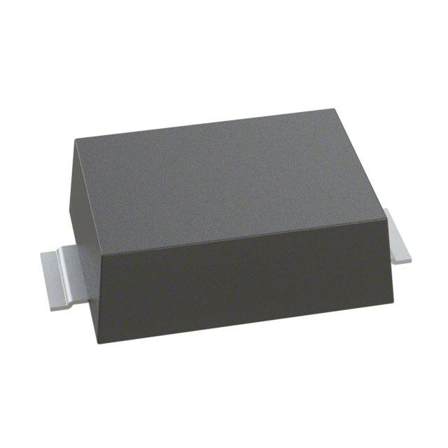

    贴片电容(MLCC) CAP_14.8X8.6MM_SM 4.7nF ±20% 760V Y5U
SMDY1472MY5UDR 数据手册
SMDY1 Series www.vishay.com Vishay BCcomponents EMI Suppression Safety Capacitor, Ceramic Disc, Class X1, 760 VAC, Class Y1, 500 VAC FEATURES • Complying with IEC 60384-14 • Humidity class IIB annex I achieved • Singlelayer AC disc safety capacitors • Mounting: surface-mount • Material categorization: for definitions of compliance please see www.vishay.com/doc?99912 LINKS TO ADDITIONAL RESOURCES APPLICATIONS 3D 3D Related Documents Infographics 3D Models • X1, Y1 according to IEC 60384-14 Models • Line-to-line filtering (Class X) • Line-to-ground filtering (Class Y) QUICK REFERENCE DATA • Primary and secondary coupling (SMPS) DESCRIPTION VALUE Ceramic class 2 Ceramic dielectric Voltage (VAC) • EMI / RFI suppression and filtering Y5U 500 DESIGN 760 Min. capacitance (pF) 470 Max. capacitance (pF) 4700 Mounting • Industrial and consumer Surface mount (reflow soldering) The capacitor consists of a ceramic disc which is copper plated on both sides. Encapsulation is made of flame retardant epoxy resin in accordance with UL 94 V-0. CAPACITANCE RANGE OPERATING TEMPERATURE RANGE 470 pF to 4700 pF -55 °C to +125 °C RATED VOLTAGE UR TEMPERATURE CHARACTERISTICS IEC 60384-14: Y5U (X1): 760 VAC, 50 Hz (Y1): 500 VAC, 50 Hz SECTIONAL SPECIFICATIONS Annex H: 1500 VDC Climatic category (according to EN 60058-1) Class 2: 55/125/21 TEST VOLTAGE MOLDING Component test (100 %): 4000 VAC, 50 Hz, 2 s According to UL 94 V-0 Epoxy resin, isolating, flame retardant Halogen-free Reinforced insulation Moisture sensitivity level: MSL 2a APPROVALS IEC 60384-14 UL 60384-14 DIN EN 60384-14 CSA E60384-1:14, CSA E60384-14:14 CQC11-471112-2015 Random sampling test (destructive test): 4000 VAC, 50 Hz, 60 s Voltage proof of molding (destructive test): 4000 VAC, 50 Hz, 60 s INSULATION RESISTANCE ≥ 10 000 MΩ CAPACITANCE TOLERANCE ± 20 % (code M) DISSIPATION FACTOR Class 2: max. 2.5 % (1 kHz) Revision: 16-Aug-2021 Document Number: 28566 1 For technical questions, contact: cdc@vishay.com THIS DOCUMENT IS SUBJECT TO CHANGE WITHOUT NOTICE. THE PRODUCTS DESCRIBED HEREIN AND THIS DOCUMENT ARE SUBJECT TO SPECIFIC DISCLAIMERS, SET FORTH AT www.vishay.com/doc?91000 SMDY1 Series www.vishay.com Vishay BCcomponents DIMENSIONS in millimeters 4 W B W 4 B 2.2 11 2.2 Recommended footprint size code C K A L L 5° 6 0.2 6 T 2.2 W A (min. 10) 2.2 15.5 Recommended footprint size code D SIZE CODE W (± 0.5) L (± 0.5) A (± 0.5) B (± 0.5) K (± 0.1) Tmax. C 8.60 14.80 10.50 3.50 11.80 4.00 D 14.60 19.20 15.00 5.00 16.20 4.00 Note • For soldering recommendation please see www.vishay.com/doc?28572 TECHNICAL DATA CAPACITANCE (pF) TOLERANCE (%) SIZE CODE PART NUMBER MISSING DIGITS SEE ORDERING CODE BELOW Y5U (2E3) 470 C SMDY1471MY5UC# 680 C SMDY1681MY5UC# 1000 C SMDY1102MY5UC# C SMDY1152MY5UC# D SMDY1222MY5UD# 3300 D SMDY1332MY5UD# 3900 D SMDY1392MY5UD# 4700 D SMDY1472MY5UD# 1500 ± 20 2200 ORDERING CODE Example SMDY1 472 M Y5U D B Series Capacitance value Tolerance code Temperature coefficient Size code Packaging code B = bulk R = tape and reel PACKAGING SIZE CODE PACKAGING QUANTITIES BULK REEL C 1000 1000 D 500 500 Revision: 16-Aug-2021 Document Number: 28566 2 For technical questions, contact: cdc@vishay.com THIS DOCUMENT IS SUBJECT TO CHANGE WITHOUT NOTICE. THE PRODUCTS DESCRIBED HEREIN AND THIS DOCUMENT ARE SUBJECT TO SPECIFIC DISCLAIMERS, SET FORTH AT www.vishay.com/doc?91000 SMDY1 Series www.vishay.com Vishay BCcomponents CARRIER TAPE DIMENSIONS FOR SIZE CODE C in millimeters P2 D0 T B0 D1 A A 5° REF. “H” K0 P1 B-B Section W 5° REF. F E P0 B0 (on a place in the bottom of the corner radii) A0 (on a place in the bottom of the corner radii) “I” A0 A-A Section Detail “H” Detail “I” A0 B0 K0 P0 P1 P2 T W 10 P0 E F D0 D1 9.25 ± 0.10 15.45 ± 0.10 4.15 ± 0.10 4.00 ± 0.10 12.00 ± 0.10 2.00 ± 0.10 0.35 ± 0.05 24.00 ± 0.30 40.00 ± 0.20 1.75 ± 0.10 11.50 ± 0.10 1.55 ± 0.05 1.5 min. T B0 5° REF. W So B-B Section D0 E P2 F P0 B CARRIER TAPE DIMENSIONS FOR SIZE CODE D in millimeters “H” A K0 “N” B A P1 0.20 ± 0.05 D1 5° REF. R0.75 B0 (on a place in the bottom of the corner radii) A0 (on a place in the bottom of the corner radii) “I” A0 Detail “I” Detail “N” A-A Section Detail “H” A0 B0 K0 P0 P1 P2 T W 10 P0 So E F D0 D1 15.25 ± 0.10 19.85 ± 0.10 4.15 ± 0.10 4.00 ± 0.10 20.00 ± 0.10 2.00 ± 0.10 0.35 ± 0.05 32.00 ± 0.30 40.00 ± 0.20 28.40 ± 0.10 1.75 ± 0.10 14.20 ± 0.10 1.50 + 0.10 2.0 min. Revision: 16-Aug-2021 Document Number: 28566 3 For technical questions, contact: cdc@vishay.com THIS DOCUMENT IS SUBJECT TO CHANGE WITHOUT NOTICE. THE PRODUCTS DESCRIBED HEREIN AND THIS DOCUMENT ARE SUBJECT TO SPECIFIC DISCLAIMERS, SET FORTH AT www.vishay.com/doc?91000 SMDY1 Series www.vishay.com Vishay BCcomponents APPROVALS IEC 60384-14 - Safety tests This approval together with CB test certificate substitutes all national approvals. CB Certificate (www.vishay.com/doc?22268) Y1-capacitor: CB test certificate: DE1-63889/A2 470 pF to 4.7 nF 500 VAC X1-capacitor: CB test certificate: DE1-63889/A2 470 pF to 4.7 nF 760 VAC VDE (www.vishay.com/doc?22269) Y1-capacitor: VDE marks approval: 40052244 470 pF to 4.7 nF 500 VAC X1-capacitor: VDE marks approval: 40052244 470 pF to 4.7 nF 760 VAC DIN EN 60384-14 (VDE 0565-1-1):2014-04; EN 60384-14:2013-08 DIN EN 60384-14/A1 (VDE 0565-1-1/A1):2017-04; EN 60384-14:2013/A1:2016 Underwriters Laboratories Inc. / Canadian Standards Association (www.vishay.com/doc?22271) Y1-capacitor: CSA test certificate: E183844 470 pF to 4.7 nF 500 VAC X1-capacitor: CSA test certificate: E183844 470 pF to 4.7 nF 760 VAC UL 60384-14, CSA E60384-1:14, CSA E60384-14:14 Fixed capacitors for electromagnetic interference suppression and connection to the supply mains. CQC (www.vishay.com/doc?22270) Y1-capacitor: CQC test certificate: CQC20001274917 470 pF to 4.7 nF 500 VAC X1-capacitor: CQC test certificate: CQC20001274917 470 pF to 4.7 nF 760 VAC MARKING YYΔΔ XXXt X1: 760 V~ Y1: 500 V~ YY: year, ΔΔ: week, XXX: capacitance value, t: tolerance code (1) Note (1) Identify “XXX” and “t” by the ordering code PERFORMANCE TEST Visual and mechanical inspection Capacitance (C) Dissipation factor (DF) Insulation resistance (IR) Dielectric strength Solderability of termination Impulse voltage Revision: 16-Aug-2021 TEST CONDITION Optical inspection, dimensions measured with caliper 25 °C ± 3 °C; RH ≤ 75 %; 1.0 VRMS ± 0.2 VRMS at 1 kHz Measured with 60 s ± 5 s after charging at 500 VDC 4000 VAC at 50 Hz / 60 Hz for 1 min 50 mA max. Immerse in solder bath for 2 s with 255 °C ± 5 °C after fluxing 3 pulses of 8 kV TEST LIMITS No visual damage, marking legible Capacitance within specified tolerance DF ≤ 2.5 % Min. 10 000 MΩ No failure 95 % of the terminations are to be soldered No failure Document Number: 28566 4 For technical questions, contact: cdc@vishay.com THIS DOCUMENT IS SUBJECT TO CHANGE WITHOUT NOTICE. THE PRODUCTS DESCRIBED HEREIN AND THIS DOCUMENT ARE SUBJECT TO SPECIFIC DISCLAIMERS, SET FORTH AT www.vishay.com/doc?91000 SMDY1 Series www.vishay.com Vishay BCcomponents PERFORMANCE TEST Life test TEST CONDITION 125 °C; 1.5 kVAC at 50 Hz; 1000 h 125 °C; 2250 VDC; 1000 h 500 h +48 h / -0 h; 40 °C ± 2 °C; 90 % to 95 % RH; 760 VAC at 50 Hz 500 h +48 h / -0 h; 40 °C ± 2 °C; 90 % to 95 % RH; 1500 VDC Humidity test 500 h +48 h / -0 h; 40 °C ± 2 °C / 90 % to 95 % RH; 0 V loading 500 h +48 h / -0 h; 85 °C ± 3 °C / 85 % RH; 760 VAC at 50 Hz 500 h +48 h / -0 h; 85 °C ± 3 °C / 85 % RH; 1500 VDC TEST LIMITS No visual damage ΔC/C < ± 15 % DF ≤ 5 % IR ≥ 3000 MΩ Dielectric strength: no failure No visual damage ΔC/C < ± 15 % DF ≤ 5 % IR ≥ 3000 MΩ Dielectric strength: no failure No visual damage ΔC/C < ± 15 % DF ≤ 5 % IR ≥ 3000 MΩ Dielectric strength: no failure No visual damage ΔC/C < ± 15 % DF ≤ 5 % IR ≥ 3000 MΩ Dielectric strength: no failure Shear test: 10 N for 10 s ± 1 s for soldered on PCB R0.5 Specimen Width Thickness Substrate Pushing tool Bending test: 1 mm bending constant for 5 s ± 1 s Robustness of termination Substrate before test No damage to capacitor body and pin 1.6 mm ± 0.20 mm Specimen (of SMD) Substrate during test 45 mm ± 2 mm 45 mm ± 2 mm Support Solder 20 mm Bending tool Radius 340 D Resistance to soldering heat (solder bath) 20 mm/s dipping speed; dwell 10 s at 2 mm dipping; 260 °C ± 5 °C Temperature cycling -55 °C ~ +125 °C; 5 cycles Revision: 16-Aug-2021 No visual damage ΔC/C < ± 10 % DF ≤ 5 % IR ≥ 3000 MΩ Dielectric strength: no failure No visual damage ΔC/C < ± 30 % DF ≤ 5 % IR ≥ 3000 MΩ Dielectric strength: no failure Document Number: 28566 5 For technical questions, contact: cdc@vishay.com THIS DOCUMENT IS SUBJECT TO CHANGE WITHOUT NOTICE. THE PRODUCTS DESCRIBED HEREIN AND THIS DOCUMENT ARE SUBJECT TO SPECIFIC DISCLAIMERS, SET FORTH AT www.vishay.com/doc?91000 SMDY1 Series www.vishay.com Vishay BCcomponents PERFORMANCE TEST TEST CONDITION Electrical characterization TEST LIMITS Capacitance within specified tolerance DF ≤ 2.5 % 25 °C and -40 °C, +125 °C Min. 10 000 MΩ No visual damage Mechanical shock Half-sine; 100 g/s; 6 ms; 3 shocks each of 6 orientation ΔC/C < ± 10 % DF ≤ 5 % IR ≥ 10 000 MΩ No visual damage ΔC/C < ± 10 % 5 g/s; 1.5 mm amplitude; 20 min; 12 cycles each of orientation; 10 Hz ~ 2000 Hz Vibration DF ≤ 5 % IR ≥ 10 000 MΩ AC CURRENT VS. VOLTAGE (Typical) IMPEDANCE VS. FREQUENCY (Typical) Axis Title Axis Title 10000 4000 ▬▬▬ 2nd line AC Current (μA) RMS ▬▬▬ 3000 ▬▬▬ ▬▬▬ 2500 ▬▬▬ 10000 100 1000 2000 1500 100 1000 10 ▬▬▬ 1 ▬▬▬ ▬▬▬ ▬▬▬ 1000 ▬▬▬ 0.1 ▬▬▬ 500 ▬▬▬ ▬▬▬ 0 0 1000 2000 3000 AC Voltage (V) RMS 10 4000 1st line 2nd line 3500 470 pF 680 pF 1000 pF 1500 pF 2200 pF 3300 pF 4700 pF 2nd line Impedance (Ω) ▬▬▬ 1000 1st line 2nd line ▬▬▬ 470 pF 680 pF 1000 pF 1500 pF 2200 pF 3300 pF 3900 pF 4700 pF 100 0.01 1 10 100 10 1000 Frequency (MHz) Note • Unless stated otherwise all electrical values apply at an ambient temperature of 25 °C ± 3 °C, at normal atmospheric conditions RELATED DOCUMENTS CB Test Certificate www.vishay.com/doc?22268 VDE Marks Approval www.vishay.com/doc?22269 UL Test Certificate www.vishay.com/doc?22271 CQC Test Certificate www.vishay.com/doc?22270 Soldering Recommendation www.vishay.com/doc?28572 Revision: 16-Aug-2021 Document Number: 28566 6 For technical questions, contact: cdc@vishay.com THIS DOCUMENT IS SUBJECT TO CHANGE WITHOUT NOTICE. THE PRODUCTS DESCRIBED HEREIN AND THIS DOCUMENT ARE SUBJECT TO SPECIFIC DISCLAIMERS, SET FORTH AT www.vishay.com/doc?91000 Legal Disclaimer Notice www.vishay.com Vishay Disclaimer ALL PRODUCT, PRODUCT SPECIFICATIONS AND DATA ARE SUBJECT TO CHANGE WITHOUT NOTICE TO IMPROVE RELIABILITY, FUNCTION OR DESIGN OR OTHERWISE. Vishay Intertechnology, Inc., its affiliates, agents, and employees, and all persons acting on its or their behalf (collectively, “Vishay”), disclaim any and all liability for any errors, inaccuracies or incompleteness contained in any datasheet or in any other disclosure relating to any product. Vishay makes no warranty, representation or guarantee regarding the suitability of the products for any particular purpose or the continuing production of any product. To the maximum extent permitted by applicable law, Vishay disclaims (i) any and all liability arising out of the application or use of any product, (ii) any and all liability, including without limitation special, consequential or incidental damages, and (iii) any and all implied warranties, including warranties of fitness for particular purpose, non-infringement and merchantability. Statements regarding the suitability of products for certain types of applications are based on Vishay's knowledge of typical requirements that are often placed on Vishay products in generic applications. Such statements are not binding statements about the suitability of products for a particular application. It is the customer's responsibility to validate that a particular product with the properties described in the product specification is suitable for use in a particular application. Parameters provided in datasheets and / or specifications may vary in different applications and performance may vary over time. All operating parameters, including typical parameters, must be validated for each customer application by the customer's technical experts. Product specifications do not expand or otherwise modify Vishay's terms and conditions of purchase, including but not limited to the warranty expressed therein. Hyperlinks included in this datasheet may direct users to third-party websites. These links are provided as a convenience and for informational purposes only. Inclusion of these hyperlinks does not constitute an endorsement or an approval by Vishay of any of the products, services or opinions of the corporation, organization or individual associated with the third-party website. Vishay disclaims any and all liability and bears no responsibility for the accuracy, legality or content of the third-party website or for that of subsequent links. Except as expressly indicated in writing, Vishay products are not designed for use in medical, life-saving, or life-sustaining applications or for any other application in which the failure of the Vishay product could result in personal injury or death. Customers using or selling Vishay products not expressly indicated for use in such applications do so at their own risk. Please contact authorized Vishay personnel to obtain written terms and conditions regarding products designed for such applications. No license, express or implied, by estoppel or otherwise, to any intellectual property rights is granted by this document or by any conduct of Vishay. Product names and markings noted herein may be trademarks of their respective owners. © 2021 VISHAY INTERTECHNOLOGY, INC. ALL RIGHTS RESERVED Revision: 09-Jul-2021 1 Document Number: 91000
