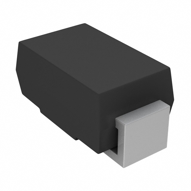

SML4738 to SML4764A www.vishay.com Vishay Semiconductors Surface Mount Zener Diodes FEATURES • Plastic package has underwriters laboratory flammability classification 94 V-0 • For surface mounted applications • Low Zener impedance • Low regulation factor • High temperature soldering guaranteed: 260 °C/10 s at terminals SMA (DO-214AC) • Standard voltage tolerance is ± 10 %, suffix A ± 5 % • AEC-Q101 qualified available LINKS TO ADDITIONAL RESOURCES • Material categorization: for definitions of compliance please see www.vishay.com/doc?99912 3D 3D 3D Models MECHANICAL DATA Base P/N-E3 - RoHS-compliant, commercial grade PRIMARY CHARACTERISTICS PARAMETER VALUE UNIT VZ range nom. 8.2 to 100 V Test current IZT 2.5 to 31 mA VZ specification Pulse current Circuit configuration Base P/NHE3_X - RoHS-compliant and AEC-Q101 qualified (“_X” denotes revision code e.g. A, B, ...) Single ORDERING INFORMATION DEVICE NAME ORDERING CODE TAPED UNITS PER REEL MINIMUM ORDER QUANTITY 7500 (12 mm tape on 13" plastic reel) 7500 1800 (12 mm tape on 7" plastic reel) 1800 SML4738-E3/5A SML4738 to SML4764A SML4738HE3_A/I SML4738-E3/61 SML4738 to SML4764A SML4738HE3_A/H PACKAGE PACKAGE NAME WEIGHT SMA (DO-214AC) 64 mg MOLDING COMPOUND MOISTURE SENSITIVITY FLAMMABILITY RATING LEVEL UL 94 V-0 MSL level 1 (according J-STD-020) SOLDERING CONDITIONS Peak temperature max. 260 °C ABSOLUTE MAXIMUM RATINGS (Tamb = 25 °C, unless otherwise specified) PARAMETER Power dissipation Junction temperature Storage temperature range TEST CONDITION SYMBOL VALUE UNIT TL = 75 °C Ptot 1000 mW Tj 150 °C Tstg -65 to +150 °C Rev. 2.2, 07-Jul-2021 Document Number: 85782 1 For technical questions within your region: DiodesAmericas@vishay.com, DiodesAsia@vishay.com, DiodesEurope@vishay.com THIS DOCUMENT IS SUBJECT TO CHANGE WITHOUT NOTICE. THE PRODUCTS DESCRIBED HEREIN AND THIS DOCUMENT ARE SUBJECT TO SPECIFIC DISCLAIMERS, SET FORTH AT www.vishay.com/doc?91000 SML4738 to SML4764A www.vishay.com Vishay Semiconductors ELECTRICAL CHARACTERISTICS (Tamb = 25 °C, unless otherwise specified) ZENER VOLTAGE RANGE PART NUMBER MARKING CODE VZ at IZT1 TEST CURRENT IZT1 V IZT2 mA REVERSE CURRENT IR at VR μA NOM. 0.5 10 ZZ at IZT1 6 SURGE CURRENT (1) ZZK at IZT2 IRM MAX. MAX. MAX. 4.5 700 550 Ω V MAX. 31 DYNAMIC RESISTANCE mApk SML4738 8P2 8.2 SML4739 9P1 9.1 28 0.5 10 7 5 700 500 SML4740 10 10 25 0.25 10 7.6 7 700 454 SML4741 11 11 23 0.25 5 8.4 8 700 414 SML4742 12 12 21 0.25 5 9.1 9 700 380 SML4743 13 13 19 0.25 5 9.9 10 700 344 SML4744 15 15 17 0.25 5 11.4 14 700 305 SML4745 16 16 15.5 0.25 5 12.2 16 700 285 SML4746 18 18 14 0.25 5 13.7 20 750 250 SML4747 20 20 12.5 0.25 5 15.2 22 750 225 SML4748 22 22 11.5 0.25 5 16.7 23 750 205 SML4749 24 24 10.5 0.25 5 18.2 25 750 190 SML4750 27 27 9.5 0.25 5 20.6 35 750 170 SML4751 30 30 8.5 0.25 5 22.8 40 1000 150 SML4752 33 33 7.5 0.25 5 25.1 45 1000 135 SML4753 36 36 7 0.25 5 27.4 50 1000 125 SML4754 39 39 6.5 0.25 5 29.7 60 1000 115 SML4755 43 43 6 0.25 5 32.7 70 1500 110 SML4756 47 47 5.5 0.25 5 35.8 80 1500 95 SML4757 51 51 5 0.25 5 38.8 95 1500 90 SML4758 56 56 4.5 0.25 5 42.6 110 2000 80 SML4759 62 62 4 0.25 5 47.1 125 2000 70 SML4760 68 68 3.7 0.25 5 51.7 150 2000 65 SML4761 75 75 3.3 0.25 5 56 175 2000 60 SML4762 82 82 3 0.25 5 62.2 200 3000 55 SML4763 91 91 2.8 0.25 5 69.2 250 3000 50 SML4764 100 100 2.5 0.25 5 76 350 3000 45 Note (1) Surge current is a non-repetitive, 8.3 ms pulse width square wave or equivalent sine-wave superimposed on I ® ZT per JEDEC method Rev. 2.2, 07-Jul-2021 Document Number: 85782 2 For technical questions within your region: DiodesAmericas@vishay.com, DiodesAsia@vishay.com, DiodesEurope@vishay.com THIS DOCUMENT IS SUBJECT TO CHANGE WITHOUT NOTICE. THE PRODUCTS DESCRIBED HEREIN AND THIS DOCUMENT ARE SUBJECT TO SPECIFIC DISCLAIMERS, SET FORTH AT www.vishay.com/doc?91000 SML4738 to SML4764A www.vishay.com Vishay Semiconductors ELECTRICAL CHARACTERISTICS (Tamb = 25 °C, unless otherwise specified) ZENER VOLTAGE RANGE PART NUMBER MARKING CODE VZ at IZT1 TEST CURRENT IZT1 V IZT2 mA REVERSE CURRENT IR at VR μA NOM. 8P2A 8.2 31 SML4739A 9P1A 9.1 SML4740A 10A 10 SML4741A 11A SML4742A 12A SML4743A SML4744A ZZ at IZT1 SURGE CURRENT (1) ZZK at IZT2 IRM MAX. MAX. MAX. 6 4.5 700 550 Ω V MAX. SML4738A DYNAMIC RESISTANCE mApk 0.5 10 28 0.5 10 7 5 700 500 25 0.25 10 7.6 7 700 454 11 23 0.25 5 8.4 8 700 414 12 21 0.25 5 9.1 9 700 380 13A 13 19 0.25 5 9.9 10 700 344 15A 15 17 0.25 5 11.4 14 700 305 SML4745A 16A 16 15.5 0.25 5 12.2 16 700 285 SML4746A 18A 18 14 0.25 5 13.7 20 750 250 SML4747A 20A 20 12.5 0.25 5 15.2 22 750 225 SML4748A 22A 22 11.5 0.25 5 16.7 23 750 205 SML4749A 24A 24 10.5 0.25 5 18.2 25 750 190 SML4750A 27A 27 9.5 0.25 5 20.6 35 750 170 SML4751A 30A 30 8.5 0.25 5 22.8 40 1000 150 SML4752A 33A 33 7.5 0.25 5 25.1 45 1000 135 SML4753A 36A 36 7 0.25 5 27.4 50 1000 125 SML4754A 39A 39 6.5 0.25 5 29.7 60 1000 115 SML4755A 43A 43 6 0.25 5 32.7 70 1500 110 SML4756A 47A 47 5.5 0.25 5 35.8 80 1500 95 SML4757A 51A 51 5 0.25 5 38.8 95 1500 90 SML4758A 56A 56 4.5 0.25 5 42.6 110 2000 80 SML4759A 62A 62 4 0.25 5 47.1 125 2000 70 SML4760A 68A 68 3.7 0.25 5 51.7 150 2000 65 SML4761A 75A 75 3.3 0.25 5 56 175 2000 60 SML4762A 82A 82 3 0.25 5 62.2 200 3000 55 SML4763A 91A 91 2.8 0.25 5 69.2 250 3000 50 SML4764A 100A 100 2.5 0.25 5 76 350 3000 45 Note (1) Surge current is a non-repetitive, 8.3 ms pulse width square wave or equivalent sine-wave superimposed on I ® ZT per JEDEC method Rev. 2.2, 07-Jul-2021 Document Number: 85782 3 For technical questions within your region: DiodesAmericas@vishay.com, DiodesAsia@vishay.com, DiodesEurope@vishay.com THIS DOCUMENT IS SUBJECT TO CHANGE WITHOUT NOTICE. THE PRODUCTS DESCRIBED HEREIN AND THIS DOCUMENT ARE SUBJECT TO SPECIFIC DISCLAIMERS, SET FORTH AT www.vishay.com/doc?91000 SML4738 to SML4764A www.vishay.com Vishay Semiconductors Instantaneous Forward Current (A) 1.0 60 Hz resistive or inductive load 0.75 0.5 0.25 PCB mounted on 0.31 x 0.31 x 0.08" (8 x 8 x 2 mm) copper areas pads 0 25 17923 100 75 125 50 150 Terminals Temperature ( °C) Z Z, Dynamic Zener Impedance (Ω) 1000 TJ = 25 °C VZ = 91 V VZ = 56 V VZ = 30 V 10 1 0.5 17925 10 100 IZT , Zener Test Current (mA) Θ VZ , Temperature Coefficient (mV/ °C) 0.1 Pulse width = 300 µs 1 % duty cycle TJ = 25 °C 0.01 0.4 1.4 1.2 1.0 0.6 0.8 Instantaneous Forward Voltage (V) 1.6 Fig. 4 - Typical Instantaneous Forward Characteristics for SML4763 500 Fig. 2 - Typical Zener Impedance 17927 1 17924 Fig. 1 - Maximum Continuous Power Dissipation 100 10 175 Instantaneous Reverse Current ( µA) PM(AV) , Average Power Dissipation (W) BASIC CHARACTERISTICS (Tamb = 25 °C, unless otherwise specified) 10 1 TJ = 100 °C 0.1 TJ = 25 °C 0.01 0 17926 20 80 40 60 Percent of Rated Zener Voltage (%) 100 Fig. 5 - Typical Reverse Characteristics 110 90 70 Tested at rated IZT 50 30 10 0 0 10 20 30 40 50 60 70 80 90 100 VZ , Zener Voltage (V) Fig. 3 - Typical Temperature Coefficients Rev. 2.2, 07-Jul-2021 Document Number: 85782 4 For technical questions within your region: DiodesAmericas@vishay.com, DiodesAsia@vishay.com, DiodesEurope@vishay.com THIS DOCUMENT IS SUBJECT TO CHANGE WITHOUT NOTICE. THE PRODUCTS DESCRIBED HEREIN AND THIS DOCUMENT ARE SUBJECT TO SPECIFIC DISCLAIMERS, SET FORTH AT www.vishay.com/doc?91000 SML4738 to SML4764A www.vishay.com Vishay Semiconductors PACKAGE DIMENSIONS in inches (millimeters): SMA (DO-214AC) SMA (DO-214AC) Cathode Band Mounting Pad Layout 0.110 (2.79) 0.100 (2.54) 0.065 (1.65) 0.049 (1.25) 0.177 (4.50) 0.157 (3.99) 0.012 (0.305) 0.006 (0.152) 0.060 (1.52) MIN. 0.208 (5.28) REF. 0.090 (2.29) 0.078 (1.98) 0.060 (1.52) 0.030 (0.76) 0.074 (1.88) MAX. 0.066 (1.68) MIN. 0.008 (0.203) 0 (0) 0.208 (5.28) 0.194 (4.93) Rev. 2.2, 07-Jul-2021 Document Number: 85782 5 For technical questions within your region: DiodesAmericas@vishay.com, DiodesAsia@vishay.com, DiodesEurope@vishay.com THIS DOCUMENT IS SUBJECT TO CHANGE WITHOUT NOTICE. THE PRODUCTS DESCRIBED HEREIN AND THIS DOCUMENT ARE SUBJECT TO SPECIFIC DISCLAIMERS, SET FORTH AT www.vishay.com/doc?91000 Legal Disclaimer Notice www.vishay.com Vishay Disclaimer ALL PRODUCT, PRODUCT SPECIFICATIONS AND DATA ARE SUBJECT TO CHANGE WITHOUT NOTICE TO IMPROVE RELIABILITY, FUNCTION OR DESIGN OR OTHERWISE. Vishay Intertechnology, Inc., its affiliates, agents, and employees, and all persons acting on its or their behalf (collectively, “Vishay”), disclaim any and all liability for any errors, inaccuracies or incompleteness contained in any datasheet or in any other disclosure relating to any product. Vishay makes no warranty, representation or guarantee regarding the suitability of the products for any particular purpose or the continuing production of any product. To the maximum extent permitted by applicable law, Vishay disclaims (i) any and all liability arising out of the application or use of any product, (ii) any and all liability, including without limitation special, consequential or incidental damages, and (iii) any and all implied warranties, including warranties of fitness for particular purpose, non-infringement and merchantability. Statements regarding the suitability of products for certain types of applications are based on Vishay's knowledge of typical requirements that are often placed on Vishay products in generic applications. Such statements are not binding statements about the suitability of products for a particular application. It is the customer's responsibility to validate that a particular product with the properties described in the product specification is suitable for use in a particular application. Parameters provided in datasheets and / or specifications may vary in different applications and performance may vary over time. All operating parameters, including typical parameters, must be validated for each customer application by the customer's technical experts. Product specifications do not expand or otherwise modify Vishay's terms and conditions of purchase, including but not limited to the warranty expressed therein. Hyperlinks included in this datasheet may direct users to third-party websites. These links are provided as a convenience and for informational purposes only. Inclusion of these hyperlinks does not constitute an endorsement or an approval by Vishay of any of the products, services or opinions of the corporation, organization or individual associated with the third-party website. Vishay disclaims any and all liability and bears no responsibility for the accuracy, legality or content of the third-party website or for that of subsequent links. Except as expressly indicated in writing, Vishay products are not designed for use in medical, life-saving, or life-sustaining applications or for any other application in which the failure of the Vishay product could result in personal injury or death. Customers using or selling Vishay products not expressly indicated for use in such applications do so at their own risk. Please contact authorized Vishay personnel to obtain written terms and conditions regarding products designed for such applications. No license, express or implied, by estoppel or otherwise, to any intellectual property rights is granted by this document or by any conduct of Vishay. Product names and markings noted herein may be trademarks of their respective owners. © 2021 VISHAY INTERTECHNOLOGY, INC. ALL RIGHTS RESERVED Revision: 09-Jul-2021 1 Document Number: 91000
SML4762HE3_A/I
物料型号:SML4738至SML4764A
器件简介: - 这些是Vishay生产的表面安装Zener二极管。 - 符合RoHS标准。 - 使用SMA (DO-214AC)封装。 - 具有UL94V-0的阻燃等级。 - 适用于表面安装应用。
引脚分配:文档中没有明确指出具体的引脚分配,但SMA (DO-214AC)封装通常有一个阳极带和一个阴极点。
参数特性: - 额定Zener电压范围从8.2V至100V。 - 测试电流从2.5mA至31mA。 - 脉冲电流规格。 - 单向电路配置。 - 低Zener阻抗和低调节因子。 - 高温焊接保证:260°C/10秒在端子上。 - 标准电压容差为±10%,后缀A为±5%。 - 提供AEC-Q101认证型号。
功能详解: - 这些Zener二极管具有低阻抗和低调节因子,适用于需要精确电压参考的应用。 - 高温焊接保证使其适用于需要高温回流焊接工艺的生产环境。 - 电压容差选项使得这些二极管可以用于对电压精度要求不同的应用。
应用信息: - 适用于需要表面安装和精确电压稳定的应用。
封装信息: - 封装类型为SMA (DO-214AC),重量为64毫克。 - 封装的阻燃等级为UL94V-0。 - 湿度敏感等级为J-STD-020标准的1级。 - 焊接条件:峰值温度最高260°C。
订购信息: - 提供了不同型号的订购代码和每卷的封装单位数量,以及最小订购数量。
绝对最大额定值: - 总功耗在75°C时为1000mW。 - 结温150°C。 - 存储温度范围为-65°C至+150°C。
电气特性: - 提供了在25°C环境温度下,不同Zener电压范围的测试电流、反向电流、动态阻抗和浪涌电流等详细电气特性数据。
