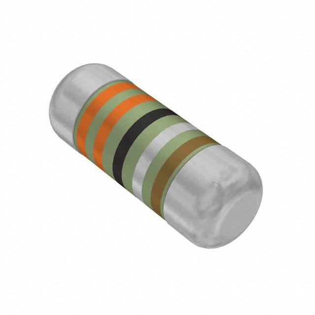

SMM0207 www.vishay.com Vishay Draloric Thin Film MELF Resistors FEATURES • MELF resistor with high power rating • AEC-Q200 qualified • Advanced metal film technology • Best in class pulse load capability • Intrinsic sulfur resistance • Material categorization: for definitions of compliance please see www.vishay.com/doc?99912 SMM0207 thin film MELF resistors are the perfect choice for most fields of modern professional electronics where reliability and stability is of major concern at higher power rating and higher operating voltage. The typical applications in the fields of automotive, industrial and medical equipment reflect the outstanding level of proven reliability. APPLICATIONS • Automotive • Telecommunication • Industrial • Medical equipment TECHNICAL SPECIFICATIONS DESCRIPTION SMM0207 DIN size 0207 Metric size code RC6123M Resistance range 0.16 Ω to 10 MΩ Resistance tolerance ± 5 %; ± 1 %; ± 0.5 %; ± 0.25 %; ± 0.1 % Temperature coefficient ± 100 ppm/K; ± 50 ppm/K; ± 25 ppm/; ± 15 ppm/K Rated dissipation P70 (1) 1.0 W Operating voltage, Umax. ACRMS/DC 350 V Permissible film temperature, ϑF max. (1) 155 °C Operating temperature range (1) -55 °C to 155 °C Permissible voltage against ambient (insulation): 1 min; Uins Failure rate: FITobserved Zero-Ohm-Resistor: OMM0207 500 V ≤ 0.1 x 10-9/h Rmax. = 10 mΩ; Imax. = 5 A Note (1) Please refer to APPLICATION INFORMATION below APPLICATION INFORMATION When the resistor dissipates power, a temperature rise above the ambient temperature occurs, dependent on the thermal resistance of the assembled resistor together with the printed circuit board. The rated dissipation applies only if the permitted film temperature is not exceeded. These resistors do not feature a limited lifetime when operated within the permissible limits. However, resistance value drift increasing over operating time may result in exceeding a limit acceptable to the specific application, thereby establishing a functional lifetime Revision: 12-Jun-17 Document Number: 20005 1 For technical questions, contact: melf@vishay.com THIS DOCUMENT IS SUBJECT TO CHANGE WITHOUT NOTICE. THE PRODUCTS DESCRIBED HEREIN AND THIS DOCUMENT ARE SUBJECT TO SPECIFIC DISCLAIMERS, SET FORTH AT www.vishay.com/doc?91000 SMM0207 www.vishay.com Vishay Draloric MAXIMUM RESISTANCE CHANGE AT RATED DISSIPATION OPERATION MODE Rated dissipation, P70 PRECISION STANDARD POWER 0.125 W 0.4 W 1.0 W -10 °C to 85 °C -55 °C to 125 °C -55 °C to 155 °C 85 °C 125 °C 155 °C 100 Ω to 511 kΩ 1 Ω to 1 MΩ 1 Ω to 1 MΩ 1000 h ≤ 0.05 % ≤ 0.15 % ≤ 0.25 % 8000 h ≤ 0.1 % ≤ 0.3 % ≤ 0.5 % 225 000 h ≤ 0.25 % ≤ 1.0 % - SMM0207 Operating temperature range Permissible film temperature, ϑF max. SMM0207 Max. resistance change at P70 for resistance range, |ΔR/R| after: Note • The presented operation modes do not refer to different types of resistors, but actually show examples of different loads, that lead to different film temperatures and different achievable load-life stability (drift) of the resistance value. A suitable low thermal resistance of the circuit board assembly must be safeguarded in order to maintain the film temperature of the resistors within the specified limits. Please consider the application note “Thermal Management in Surface-Mounted Resistor Applications” (www.vishay.com/doc?28844) for information on the general nature of thermal resistance TEMPERATURE COEFFICIENT AND RESISTANCE RANGE TYPE / SIZE TCR TOLERANCE RESISTANCE E-SERIES ± 100 ppm/K ±5% 0.16 Ω to 0.91 Ω E24 ±1% 1 Ω to 10 MΩ E24; E96 ± 0.5 % 1 Ω to 2.21 MΩ E24; E192 43 Ω to 1 MΩ E24; E192 100 Ω to 511 kΩ E24; E192 0Ω - ± 50 ppm/K ± 0.5 % ± 25 ppm/K ± 0.25 % SMM0207 ± 0.1 % ± 0.5 % ± 15 ppm/K (1) ± 0.25 % ± 0.1 % Jumper; Imax. = 5 A ≤ 10 mΩ Notes (1) TCR ± 10 ppm/K and ± 5 ppm/K in resistance range 100 Ω to 100 kΩ on request PACKAGING TYPE / SIZE SMM0207 OMM0207 Revision: 12-Jun-17 CODE QUANTITY BP 1500 BS 7500 PACKAGING STYLE WIDTH PITCH Antistatic blister tape acc. IEC 60286-3, Type 2a 12 mm 4 mm PACKAGING DIMENSIONS Ø 180 mm/7" Ø 330 mm/13" Document Number: 20005 2 For technical questions, contact: melf@vishay.com THIS DOCUMENT IS SUBJECT TO CHANGE WITHOUT NOTICE. THE PRODUCTS DESCRIBED HEREIN AND THIS DOCUMENT ARE SUBJECT TO SPECIFIC DISCLAIMERS, SET FORTH AT www.vishay.com/doc?91000 SMM0207 www.vishay.com Vishay Draloric PART NUMBER AND PRODUCT DESCRIPTION Part Number: SMM02070C5620FBS00 Part Number: OMM02070000000BS00 S M M 0 2 0 7 0 C 5 6 2 0 F B S 0 0 O M M 0 2 0 7 0 0 0 0 0 0 0 B S 0 0 TYPE / SIZE VERSION TCR RESISTANCE TOLERANCE PACKAGING SMM0207 OMM0207 0 = neutral E = ± 15 ppm/K D = ± 25 ppm/K C = ± 50 ppm/K B = ± 100 ppm/K 0 = jumper 3 digit value 1 digit multiplier 0000 = Jumper MULTIPLIER 7 = *10-3 8 = *10-2 9 = *10-1 0 = *100 1 = *101 2 = *102 3 = *103 4 = *104 5 = *105 B = ± 0.1 % C = ± 0.25 % D = ± 0.5 % F=±1% J=±5% 0 = jumper BP BS Product Description: SMM0207 50 562R 1 % BS Product Description: OMM0207 0R0 BS SMM0207 50 562R 1% BS OMM0207 - 0R0 - BS TYPE / SIZE TCR RESISTANCE TOLERANCE PACKAGING ± 15 ppm/K ± 25 ppm/K ± 50 ppm/K ± 100 ppm/K 100R = 100 Ω 2M21 = 2.21 MΩ 0R0 = jumper ± 0.1 % ± 0.25 % ± 0.5 % ±1% ±5% BP BS SMM0207 OMM0207 Note • Products can be ordered using either the PART NUMBER or the PRODUCT DESCRIPTION Revision: 12-Jun-17 Document Number: 20005 3 For technical questions, contact: melf@vishay.com THIS DOCUMENT IS SUBJECT TO CHANGE WITHOUT NOTICE. THE PRODUCTS DESCRIBED HEREIN AND THIS DOCUMENT ARE SUBJECT TO SPECIFIC DISCLAIMERS, SET FORTH AT www.vishay.com/doc?91000 SMM0207 www.vishay.com Vishay Draloric DESCRIPTION MATERIALS Production is strictly controlled and follows an extensive set of instructions established for reproducibility. A homogeneous film of metal alloy is deposited on a high grade ceramic body (Al2O3) and conditioned to achieve the desired temperature coefficient. Nickel plated steel termination caps are firmly pressed on the metallized rods. A special laser is used to achieve the target value by smoothly cutting a helical groove in the resistive layer without damaging the ceramics. The resistor elements are covered by a protective coating designed for electrical, mechanical and climatic protection. The terminations receive a final pure tin on nickel plating. Four or six color code bands designate the resistance value and tolerance in accordance with IEC 60062 (1). Vishay acknowledges the following systems for the regulation of hazardous substances: • IEC 62474, Material Declaration for Products of and for the Electrotechnical Industry, with the list of declarable substances given therein (2) • The Global Automotive Declarable Substance List (GADSL) (3) • The REACH regulation (1907/2006/EC) and the related list of substances with very high concern (SVHC) (4) for its supply chain The products do not contain any of the banned substances as per IEC 62474, GADSL, or the SVHC list, see www.vishay.com/how/leadfree. Hence the products fully comply with the following directives: • 2000/53/EC End-of-Life Vehicle Directive (ELV) and Annex II (ELV II) • 2011/65/EU Restriction of the Use of Hazardous Substances Directive (RoHS) with amendment 2015/863/EU • 2012/19/EU Waste Electrical and Electronic Equipment Directive (WEEE) Vishay pursues the elimination of conflict minerals from its supply chain, see the Conflict Minerals Policy at www.vishay.com/doc?49037. The result of the determined production is verified by an extensive testing procedure performed on 100 % of the individual resistors. This includes full screening for the elimination of products with a potential risk of early field failures (feasible for R ≥ 10 Ω) according to EN 140401-803, 2.1.2.2. Only accepted products are laid directly into the blister tape in accordance with IEC 60286-3, Type 2a (1). ASSEMBLY The resistors are suitable for processing on automatic SMD assembly systems. They are suitable for automatic soldering using wave, reflow or vapor phase as shown in IEC 61760-1 (1). The encapsulation is resistant to all cleaning solvents commonly used in the electronics industry, including alcohols, esters and aqueous solutions. The suitability of conformal coatings, potting compounds and their processes, if applied, shall be qualified by appropriate means to ensure the long-term stability of the whole system. The resistors are completely lead (Pb)-free, the pure tin plating provides compatibility with lead (Pb)-free and lead containing soldering processes. Solderability is specified for 2 years after production or requalification, however, excellent solderability is proven after extended storage in excess of 10 years. The permitted storage time is 20 years. The immunity of the plating against tin whisker growth has been proven under extensive testing. APPROVALS The resistors are qualified according to AEC-Q200. RELATED PRODUCTS MELF resistors of other sizes are available: • Thin Fim Micro-MELF Resistors SMM0102 (www.vishay.com/doc?20003) • Thin Fim MELF Resistors SMM0204 (www.vishay.com/doc?20004) Resistors are available with established reliability in accordance with EN 140401-803 Version E. Please refer to datasheet “MELF Resistors with Established Reliability” (www.vishay.com/doc?28707). MS1 .... ESCC high-reliability thin film MINI-MELF resistors are the premium choice for design and manufacture of equipment, where matured technology and proven reliability are of utmost importance. They are regularly used in communication and research satellites and fit equally well into aircraft and military electronic systems. Approval of the MS1 .... ESCC products is granted by the European Space Components Coordination and registered in the ESCC Qualified Parts List, REP005. (www.vishay.com/doc?28790). Notes (1) The quoted IEC standards are also released as EN standards with the same number and identical contents (2) The IEC 62474 list of declarable substances is maintained in a dedicated database, which is available at http://std.iec.ch/iec62474. (3) The Global Automotive Declarable Substance List (GADSL) is maintained by the American Chemistry Council and available at www.gadsl.org (4) The SVHC list is maintained by the European Chemical Agency (ECHA) and available at http://echa.europa.eu/candidate-list-table Revision: 12-Jun-17 Document Number: 20005 4 For technical questions, contact: melf@vishay.com THIS DOCUMENT IS SUBJECT TO CHANGE WITHOUT NOTICE. THE PRODUCTS DESCRIBED HEREIN AND THIS DOCUMENT ARE SUBJECT TO SPECIFIC DISCLAIMERS, SET FORTH AT www.vishay.com/doc?91000 SMM0207 www.vishay.com Vishay Draloric Power Dissipation P FUNCTIONAL PERFORMANCE 1.2 W 1.0 0.8 0.6 0.4 0.2 0 -50 0 50 70 85 100 130 °C 160 Ambient Temparature ϑ amb Power Dissipation P Derating - Precision Operation 1.2 W 1.0 0.8 0.6 0.4 0.2 0 -50 0 50 70 100 125 °C 160 Ambient Temparature ϑ amb Power Dissipation P Derating - Standard Operation 1.2 W 1.0 0.8 0.6 0.4 0.2 0 -50 0 50 70 100 130 °C 155 Ambient Temparature ϑ amb Derating - Power Operation Revision: 12-Jun-17 Document Number: 20005 5 For technical questions, contact: melf@vishay.com THIS DOCUMENT IS SUBJECT TO CHANGE WITHOUT NOTICE. THE PRODUCTS DESCRIBED HEREIN AND THIS DOCUMENT ARE SUBJECT TO SPECIFIC DISCLAIMERS, SET FORTH AT www.vishay.com/doc?91000 SMM0207 www.vishay.com Vishay Draloric Current Noise in µV/V Non-Linearity A3 in dB FUNCTIONAL PERFORMANCE 120 110 100 90 10 5 1 0.5 0.1 80 0.05 70 60 10 100 1K 10K 3K 1K 100 10 10R 100 1K 10K 100K Current Noise 1M 10M Resistance Value in Ω 3K 1K 100 100R 1K 10K 100K Resistance Value in Ω Single Pulse High Voltage Overload Capability 1.2/50 acc. EN 60115-1, 4.27 Revision: 12-Jun-17 0.01 Test Voltage in V Test Voltage in V Non-Linearity 100K 1M 10M Resistance Value in Ω 10 10R 100R 1K 100K 10K Resistance Value in Ω Single Pulse High Voltage Overload Capability 10/700 acc. EN 60115-1, 4.27 Document Number: 20005 6 For technical questions, contact: melf@vishay.com THIS DOCUMENT IS SUBJECT TO CHANGE WITHOUT NOTICE. THE PRODUCTS DESCRIBED HEREIN AND THIS DOCUMENT ARE SUBJECT TO SPECIFIC DISCLAIMERS, SET FORTH AT www.vishay.com/doc?91000 SMM0207 Pulse Load Pmax. www.vishay.com Vishay Draloric SMM0207 100 W 10 1 0.1 1 µs 10 µs 100 µs 1 ms 10 ms 100 ms 1s 10 s Pulse Duration ti Maximum pulse load, single pulse; applicable if P 0 and n ≤ 1000 and U ≤ Umax.; for permissible resistance change ± (0.5 % R + 0.01 Ω) Continuous Pulse Load Pmax. Single Pulse for R < 10 Ω SMM0207 100 W 10 1 0.1 1 µs 10 µs 100 µs 1 ms 10 ms 100 ms 1s 10 s Pulse Duration ti Maximum pulse load, continuous pulse; applicable if P ≤ P (ϑamb) and U ≤ Umax.; for permissible resistance change ± (0.5 % R + 0.01 Ω) Pulse Load P Continuous Pulse for R < 10 Ω 1000 SMM0207 W 100 10 1 0.1 1 µs 10 µs 100 µs 1 ms 10 ms 100 ms 1s 10 s Pulse Duration ti Maximum pulse load, single pulse; applicable if P 0 and n ≤ 1000 and U ≤ Umax.; for permissible resistance change ± (0.5 % R + 0.01 Ω) Single Pulse for R ≥ 10 Ω Revision: 12-Jun-17 Document Number: 20005 7 For technical questions, contact: melf@vishay.com THIS DOCUMENT IS SUBJECT TO CHANGE WITHOUT NOTICE. THE PRODUCTS DESCRIBED HEREIN AND THIS DOCUMENT ARE SUBJECT TO SPECIFIC DISCLAIMERS, SET FORTH AT www.vishay.com/doc?91000 SMM0207 Pulse Load P www.vishay.com Vishay Draloric 1000 SMM0207 W 100 10 1 0.1 1 µs 10 µs 100 µs 1 ms 10 ms 100 ms 1s 10 s Pulse Duration ti Maximum pulse load, continuous pulse; applicable if P ≤ P (ϑamb) and U ≤ Umax.; for permissible resistance change ± (0.5 % R + 0.01 Ω) Pulse Voltage Umax. Continuous Pulse for R ≥ 10 Ω SMM0207 V 1000 100 1 µs 10 µs 100 µs 1 ms 10 ms 100 ms 1s 10 s Pulse Duration ti Maximum pulse voltage, single and continuous pulses; applicable if P ≤ Pmax.; for permissible resistance change ± (0.5 % R + 0.01 Ω) Pulse Voltage Revision: 12-Jun-17 Document Number: 20005 8 For technical questions, contact: melf@vishay.com THIS DOCUMENT IS SUBJECT TO CHANGE WITHOUT NOTICE. THE PRODUCTS DESCRIBED HEREIN AND THIS DOCUMENT ARE SUBJECT TO SPECIFIC DISCLAIMERS, SET FORTH AT www.vishay.com/doc?91000 SMM0207 www.vishay.com Vishay Draloric TESTS AND REQUIREMENTS All tests are carried out in accordance with the following specifications: The testing also covers most of the requirements specified by EIA/ECA-703 and JIS-C-5201-1. EN 60115-1, generic specification The tests are carried out under standard atmospheric conditions in accordance with IEC 60068-1, 4.3, whereupon the following values are applied: EN 60115-8 specification (successor of EN 140400), sectional EN 140401-803, detail specification Temperature: 15 °C to 35 °C IEC 60068-2-xx, test methods Relative humidity: 25 % to 75 % The parameters stated in the Test Procedures and Requirements table are based on the required tests and permitted limits of EN 140401-803. The table presents only the most important tests, for the full test schedule refer to the documents listed above. However, some additional tests and a number of improvements against those minimum requirements have been included. Air pressure: 86 kPa to 106 kPa (860 mbar to 1060 mbar). A climatic category LCT / UCT / 56 is applied, defined by the lower category temperature (LCT), the upper category temperature (UCT), and the duration of exposure in the damp heat, steady state test (56 days). The components are mounted for testing on printed circuit boards in accordance with EN 60115-8, 2.4.2, unless otherwise specified. TEST PROCEDURES AND REQUIREMENTS IEC EN 60068-2 (1) 60115-1 TEST CLAUSE METHOD TEST Stability for product types: SMM0207 4.8 - Temperature coefficient (1) Endurance at 70 °C: precision operation mode REQUIREMENTS PERMISSIBLE CHANGE (ΔR) PROCEDURE At (20 / -55 / 20) °C and (20 / 125 / 20) °C STABILITY CLASS 0.25 OR BETTER STABILITY CLASS 0.5 OR BETTER STABILITY CLASS 1 OR BETTER STABILITY CLASS 2 OR BETTER 1 MΩ ± 100 ppm/K, ± 50 ppm/K, ± 25 ppm/K; ±15 ppm/K U = P 70 x R ≤ Umax.; 1.5 h on; 0.5 h off; 70 °C; 1000 h 70 °C; 8000 h 4.25.1 - Endurance at 70 °C: standard operation mode Endurance at 70 °C: power operation mode 4.25.3 4.24 - 78 (Cab) Revision: 12-Jun-17 Endurance at upper category temperature Damp heat, steady state ± (0.05 % R + 0.005 Ω) ± (0.1 % R + 0.005 Ω) - U = P 70 x R ≤ Umax.; 1.5 h on; 0.5 h off; 70 °C; 1000 h ± (0.15 % R + 0.01 Ω) ± (0.5 % R) 70 °C; 8000 h ± (0.3 % R + 0.01 Ω) ± (1 % R) 70 °C; 1000 h ± (0.25 % R + 0.01 Ω) ± (0.5 % R) 70 °C; 8000 h ± (0.5 % R + 0.01 Ω) ± (1 % R) 125 °C; 1000 h ± (0.15 % R + 0.01 Ω) ± (0.5 % R) 155 °C; 1000 h ± (0.3 % R + 0.01 Ω) ± (1 % R) (40 ± 2) °C; 56 days; (93 ± 3) % RH ± (0.25 % R + 0.01 Ω) ± (1 % R) U = P 70 x R ≤ Umax.; 1.5 h on; 0.5 h off; Document Number: 20005 9 For technical questions, contact: melf@vishay.com THIS DOCUMENT IS SUBJECT TO CHANGE WITHOUT NOTICE. THE PRODUCTS DESCRIBED HEREIN AND THIS DOCUMENT ARE SUBJECT TO SPECIFIC DISCLAIMERS, SET FORTH AT www.vishay.com/doc?91000 SMM0207 www.vishay.com Vishay Draloric TEST PROCEDURES AND REQUIREMENTS IEC EN 60068-2 (1) 60115-1 TEST CLAUSE METHOD TEST REQUIREMENTS PERMISSIBLE CHANGE (ΔR) PROCEDURE Stability for product types: SMM0207 4.37 67 (Cy) Damp heat, steady state, accelerated (85 ± 2) °C (85 ± 5) % RH U = 0.3 x P 70 x R ≤ 100 V and U = 0.3 x Umax.; (the smaller value is valid) 1000 h - 1 (Ab) Cold -55 °C; 2000 h STABILITY CLASS 0.25 OR BETTER STABILITY CLASS 0.5 OR BETTER STABILITY CLASS 1 OR BETTER STABILITY CLASS 2 OR BETTER 1 MΩ ± (0.5 % R + 0.01 Ω) ± (2 % R) ± (0.1 % R + 0.01 Ω) 30 min at LCT and 30 min at UCT; 4.19 4.13 4.27 4.39 14 (Na) - - - Revision: 12-Jun-17 Rapid change of temperature Short time overload: standard operation mode Short time overload: power operation mode Single pulse high voltage overload: standard operation mode Single pulse high voltage overload: power operation mode Periodic electric overload: standard operation mode Periodic electric overload: power operation mode LCT = -55 °C; UCT = 125 °C; 1000 cycles ± (0.25 % R + 0.01 Ω) LCT = -55 °C; UCT = 155 °C; 1000 cycles ± (0.5 % R + 0.01 Ω) ± (0.03 % R + 0.01 Ω) ± (0.15 % R) ± (0.05 % R + 0.01 Ω) ± (0.15 % R) U = 2.5 x P 70 x R ≤ 2 x Umax.; 5 s ± (0.25 % R + 0.01 Ω) Severity no. 4: U = 10 x P 70 x R ≤ 2 x Umax.; 10 pulses 10 μs/700 μs ± (0.5 % R + 0.01 Ω) ± (0.15 % R + 0.01 Ω) U= 15 x P 70 x R ≤ 2 x Umax.; 0.1 s on; 2.5 s off; 1000 cycles ± (0.3 % R + 0.01 Ω) Document Number: 20005 10 For technical questions, contact: melf@vishay.com THIS DOCUMENT IS SUBJECT TO CHANGE WITHOUT NOTICE. THE PRODUCTS DESCRIBED HEREIN AND THIS DOCUMENT ARE SUBJECT TO SPECIFIC DISCLAIMERS, SET FORTH AT www.vishay.com/doc?91000 SMM0207 www.vishay.com Vishay Draloric TEST PROCEDURES AND REQUIREMENTS IEC EN 60068-2 (1) 60115-1 TEST CLAUSE METHOD TEST Stability for product types: SMM0207 4.22 4.40 4.17 4.18 REQUIREMENTS PERMISSIBLE CHANGE (ΔR) PROCEDURE STABILITY CLASS 0.25 OR BETTER STABILITY CLASS 0.5 OR BETTER STABILITY CLASS 1 OR BETTER STABILITY CLASS 2 OR BETTER 1 MΩ 6 (Fc) Vibration Endurance by sweeping; 10 Hz to 2000 Hz; no resonance; amplitude ≤ 1.5 mm or ≤ 200 m/s2; 7.5 h - Electro Static Discharge (Human Body Model) IEC 61340-3-1 (1); 3 pos. + 3 neg. discharges; 4 kV ± (0.5 % R + 0.05 Ω) Solder bath method; SnPb40; non-activated flux (215 ± 3) °C; (3 ± 0.3) s Good tinning (≥ 95 % covered); no visible damage Solder bath method; SnAg3Cu0.5 or SnAg3.5; non-activated flux; (235 ± 3) °C; (2 ± 0.2) s Good tinning (≥ 95 % covered); no visible damage 58 (Td) 58 (Td) Solderability Resistance to soldering heat ± (0.05 % R + 0.01 Ω) Solder bath method; (260 ± 5) °C; (10 ± 1) s ± (0.1 % R + 0.01 Ω) ± (0.05 % R + 0.01 Ω) Reflow method 2 (IR/forced gas convection); (260 ± 5) °C; (10 ± 1) s ± (0.05 % R + 0.01 Ω) ± (0.02 % R + 0.01 Ω) 4.29 45 (XA) Component solvent resistance Isopropyl alcohol; 50 °C; method 2 No visible damage 4.30 45 (XA) Solvent resistance of marking Isopropyl alcohol; 50 °C; method 1, toothbrush Marking visible, no visible damage 4.32 21 (Ue3) Shear (adhesion) 45 N No visible damage 4.33 21 (Ue1) Substrate bending Depth 2 mm, 3 times No visible damage, no open circuit in bent position ± (0.05 % R + 0.01 Ω) 4.7 - Voltage proof URMS = Uins; 60 s No flashover or breakdown Flammability IEC 60695-11-5 (1); needle flame test; 10 s No burning after 30 s 4.35 - Note (1) The quoted IEC standards are also released as EN standards with the same number and identical contents Revision: 12-Jun-17 Document Number: 20005 11 For technical questions, contact: melf@vishay.com THIS DOCUMENT IS SUBJECT TO CHANGE WITHOUT NOTICE. THE PRODUCTS DESCRIBED HEREIN AND THIS DOCUMENT ARE SUBJECT TO SPECIFIC DISCLAIMERS, SET FORTH AT www.vishay.com/doc?91000 SMM0207 www.vishay.com Vishay Draloric DIMENSIONS L K L1 D D1 DIMENSIONS AND MASS TYPE / SIZE SMM0207 OMM0207 L (mm) D (mm) L1 min. (mm) D1 (mm) K (mm) MASS (mg) 5.8 + 0 / - 0.3 2.2 ± 0.2 2.6 D + 0 / - 0.2 1.25 ± 0.2 77 Notes • Color code marking is applied according to IEC 60062 (1) in four (E24 series) or six bands (E96 series). Each color band appears as a single solid line, voids are permissible if at least 2/3 of the band is visible from each radial angle of view. The last color band represents the TCR for resistors with TCR ≤ 50 ppm/K and nominal tolerance ≤ 1 % • Zero ohm jumper are marked with one centered black band PATTERN STYLES FOR MELF RESISTORS X G Y Z RECOMMENDED SOLDER PAD DIMENSIONS WAVE SOLDERING TYPE / SIZE SMM0207 OMM0207 REFLOW SOLDERING G (mm) Y (mm) X (mm) Z (mm) G (mm) Y (mm) X (mm) Z (mm) 2.4 2.3 2.6 7.0 2.6 2.0 2.4 6.6 Notes • The given solder pad dimensions reflect the considerations for board design and assembly as outlined e.g. in standards IEC 61188-5-x (1), or in publication IPC-7351 (1) The quoted IEC standards are also released as EN standards with the same number and identical contents Revision: 12-Jun-17 Document Number: 20005 12 For technical questions, contact: melf@vishay.com THIS DOCUMENT IS SUBJECT TO CHANGE WITHOUT NOTICE. THE PRODUCTS DESCRIBED HEREIN AND THIS DOCUMENT ARE SUBJECT TO SPECIFIC DISCLAIMERS, SET FORTH AT www.vishay.com/doc?91000 Legal Disclaimer Notice www.vishay.com Vishay Disclaimer ALL PRODUCT, PRODUCT SPECIFICATIONS AND DATA ARE SUBJECT TO CHANGE WITHOUT NOTICE TO IMPROVE RELIABILITY, FUNCTION OR DESIGN OR OTHERWISE. Vishay Intertechnology, Inc., its affiliates, agents, and employees, and all persons acting on its or their behalf (collectively, “Vishay”), disclaim any and all liability for any errors, inaccuracies or incompleteness contained in any datasheet or in any other disclosure relating to any product. Vishay makes no warranty, representation or guarantee regarding the suitability of the products for any particular purpose or the continuing production of any product. To the maximum extent permitted by applicable law, Vishay disclaims (i) any and all liability arising out of the application or use of any product, (ii) any and all liability, including without limitation special, consequential or incidental damages, and (iii) any and all implied warranties, including warranties of fitness for particular purpose, non-infringement and merchantability. Statements regarding the suitability of products for certain types of applications are based on Vishay's knowledge of typical requirements that are often placed on Vishay products in generic applications. Such statements are not binding statements about the suitability of products for a particular application. It is the customer's responsibility to validate that a particular product with the properties described in the product specification is suitable for use in a particular application. Parameters provided in datasheets and / or specifications may vary in different applications and performance may vary over time. All operating parameters, including typical parameters, must be validated for each customer application by the customer's technical experts. Product specifications do not expand or otherwise modify Vishay's terms and conditions of purchase, including but not limited to the warranty expressed therein. Hyperlinks included in this datasheet may direct users to third-party websites. These links are provided as a convenience and for informational purposes only. Inclusion of these hyperlinks does not constitute an endorsement or an approval by Vishay of any of the products, services or opinions of the corporation, organization or individual associated with the third-party website. Vishay disclaims any and all liability and bears no responsibility for the accuracy, legality or content of the third-party website or for that of subsequent links. Except as expressly indicated in writing, Vishay products are not designed for use in medical, life-saving, or life-sustaining applications or for any other application in which the failure of the Vishay product could result in personal injury or death. Customers using or selling Vishay products not expressly indicated for use in such applications do so at their own risk. Please contact authorized Vishay personnel to obtain written terms and conditions regarding products designed for such applications. No license, express or implied, by estoppel or otherwise, to any intellectual property rights is granted by this document or by any conduct of Vishay. Product names and markings noted herein may be trademarks of their respective owners. © 2021 VISHAY INTERTECHNOLOGY, INC. ALL RIGHTS RESERVED Revision: 09-Jul-2021 1 Document Number: 91000

参数特性: - 尺寸代码:0207 / 公制尺寸代码:RC6123M - 电阻范围:0.16Ω至10MΩ - 电阻公差:±5%, 1%, 0.5%, 0.25%, 0.1% - 温度系数:±100 ppm/K, ±50 ppm/K, ±25 ppm/K, ±15 ppm/K - 额定耗散功率P70:1.0W - 最大工作电压:350V AC/DC - 最大膜温度:155°C - 工作温度范围:-55°C至155°C - 绝缘电压:500V(1分钟) - 故障率:≤0.1x10^-6/小时
