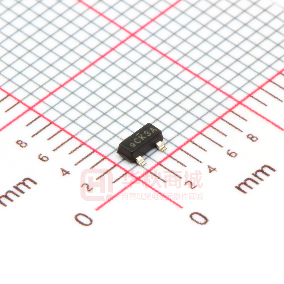

    MOS管 P-Channel VDS=60V VGS=±20V ID=2.8A RDS(ON)=170mΩ@10V SOT23-3
SQ2361AEES-T1_GE3 数据手册
SQ2361AEES www.vishay.com Vishay Siliconix Automotive P-Channel 60 V (D-S) 175 °C MOSFET FEATURES PRODUCT SUMMARY VDS (V) • TrenchFET® power MOSFET -60 RDS(on) () at VGS = -10 V 0.170 RDS(on) () at VGS = -4.5 V 0.230 ID (A) • Typical ESD protection: 800 V • AEC-Q101 qualified • 100 % Rg and UIS tested -2.9 Configuration • Material categorization: for definitions of compliance please see www.vishay.com/doc?99912 Single S SOT-23 (TO-236) D 3 G 2 S P-Channel MOSFET 1 G Top View D           Marking Code: 9Cxxx ORDERING INFORMATION Package SOT-23 Lead (Pb)-free and Halogen-free SQ2361AEES-T1-GE3 ABSOLUTE MAXIMUM RATINGS (TC = 25 °C, unless otherwise noted) PARAMETER SYMBOL LIMIT Drain-Source Voltage VDS -60 Gate-Source Voltage VGS ± 20 Continuous Drain Current TC = 25 °C TC = 125 °C Continuous Source Current (Diode Conduction) Pulsed Drain Current a Single Pulse Avalanche Current Single Pulse Avalanche Energy Maximum Power Dissipation a L = 0.1 mH TC = 25 °C TC = 125 °C Operating Junction and Storage Temperature Range ID V -2.8 -1.6 IS -2.5 IDM -11 IAS -13 EAS 8.4 PD UNIT 2 0.67 A mJ W TJ, Tstg -55 to +175 °C SYMBOL LIMIT UNIT RthJA 175 RthJF 75 THERMAL RESISTANCE RATINGS PARAMETER Junction-to-Ambient Junction-to-Foot (Drain) PCB Mount b °C/W Notes a. Pulse test; pulse width  300 μs, duty cycle  2 %. b. When mounted on 1" square PCB (FR4 material). S15-1208-Rev. A, 21-May-15 Document Number: 62997 1 For technical questions, contact: automostechsupport@vishay.com THIS DOCUMENT IS SUBJECT TO CHANGE WITHOUT NOTICE. THE PRODUCTS DESCRIBED HEREIN AND THIS DOCUMENT ARE SUBJECT TO SPECIFIC DISCLAIMERS, SET FORTH AT www.vishay.com/doc?91000 SQ2361AEES www.vishay.com Vishay Siliconix SPECIFICATIONS (TC = 25 °C, unless otherwise noted) PARAMETER SYMBOL TEST CONDITIONS MIN. TYP. MAX. VDS VGS = 0 V, ID = -250 μA -60 - - VGS(th) VDS = VGS, ID = -250 μA -1.5 - -2.5 VDS = 0 V, VGS = ± 20 V - - ± 30 VDS = 0 V, VGS = ± 8 V - - ±2 UNIT Static Drain-Source Breakdown Voltage Gate-Source Threshold Voltage Gate-Source Leakage IGSS Zero Gate Voltage Drain Current IDSS On-State Drain Current a Drain-Source On-State Resistance a Forward Transconductance b ID(on) RDS(on) gfs VGS = 0 V VDS = -60 V - - -1 VGS = 0 V VDS = -60 V, TJ = 125 °C - - -50 VGS = 0 V VDS = -60 V, TJ = 175 °C - - -150 VGS = -10 V VDS  -5 V -10 - - VGS = -10 V ID = -2.4 A - 0.130 0.170 VGS = -10 V ID = -2.4 A, TJ = 125 °C - - 0.300 VGS = -10 V ID = -2.4 A, TJ = 175 °C - - 0.315 VGS = -4.5 V ID = -1.8 A - 0.180 0.230 - 5 - - 415 620 VDS = -10 V, ID = -2 A V mA μA A  S Dynamic b Input Capacitance Ciss Output Capacitance Coss - 55 80 Reverse Transfer Capacitance Crss - 32 45 Total Gate Charge c Qg - 10 15 - 1.5 - - 5 - 3.2 4.3 5.4 - 9 12 - 9 12 - 24 30 - 4 6 Gate-Source Charge c Gate-Drain Charge c Gate Resistance Turn-On Delay Time c Rise Time c Turn-Off Delay Qgs Fall Time c VGS = -10 V VDS = -30 V, f = 1 MHz VDS = -30 V, ID = -6 A Qgd Rg f = 1 MHz td(on) tr Time c VGS = 0 V td(off) VDD = -30 V, RL = 20  ID  -1.5 A, VGEN = -10 V, Rg = 1  tf Source-Drain Diode Ratings and Characteristics pF nC  ns b Pulsed Current a ISM Forward Voltage VSD IF = -1.5 A, VGS = 0 V - - -13 A - -0.8 -1.2 V Notes a. Pulse test; pulse width  300 μs, duty cycle  2 %. b. Guaranteed by design, not subject to production testing. c. Independent of operating temperature.    Stresses beyond those listed under “Absolute Maximum Ratings” may cause permanent damage to the device. These are stress ratings only, and functional operation of the device at these or any other conditions beyond those indicated in the operational sections of the specifications is not implied. Exposure to absolute maximum rating conditions for extended periods may affect device reliability. S15-1208-Rev. A, 21-May-15 Document Number: 62997 2 For technical questions, contact: automostechsupport@vishay.com THIS DOCUMENT IS SUBJECT TO CHANGE WITHOUT NOTICE. THE PRODUCTS DESCRIBED HEREIN AND THIS DOCUMENT ARE SUBJECT TO SPECIFIC DISCLAIMERS, SET FORTH AT www.vishay.com/doc?91000 SQ2361AEES www.vishay.com Vishay Siliconix TYPICAL CHARACTERISTICS (TA = 25 °C, unless otherwise noted) 10 10 VGS = 10 V thru 5 8 ID - Drain Current (A) ID - Drain Current (A) 8 6 VGS = 4 V 4 6 4 TC = 25 °C 2 2 TC = 125 °C VGS = 3 V TC = -55 °C VGS = 2 V 0 0 1 2 3 4 0 5 0 2 VDS - Drain-to-Source Voltage (V) 4 6 8 VGS - Gate-to-Source Voltage (V) Transfer Characteristics 10 0.5 8 0.4 TC = 25 °C RDS(on) - On-Resistance (Ω) gfs - Transconductance (S) Output Characteristics 10 TC = -55 °C 6 TC = 125 °C 4 0.3 VGS = 4.5 V 0.2 VGS = 10 V 0.1 2 0 0 0 1 2 3 4 ID - Drain Current (A) 5 6 0 2 4 6 8 10 ID - Drain Current (A) Transconductance On-Resistance vs. Drain Current 100 IGSS - Gate Current (μA) 102 104 TJ = 150 °C 106 TJ = 25 °C 108 1010 0 5 10 15 20 VGS - Gate-to-Source Voltage (V) 25 Gate Current vs. Gate-Source Voltage S15-1208-Rev. A, 21-May-15 Document Number: 62997 3 For technical questions, contact: automostechsupport@vishay.com THIS DOCUMENT IS SUBJECT TO CHANGE WITHOUT NOTICE. THE PRODUCTS DESCRIBED HEREIN AND THIS DOCUMENT ARE SUBJECT TO SPECIFIC DISCLAIMERS, SET FORTH AT www.vishay.com/doc?91000 SQ2361AEES www.vishay.com Vishay Siliconix TYPICAL CHARACTERISTICS (TA = 25 °C, unless otherwise noted) 1.0 800 RDS(on) - On-Resistance (Ω) ID = 1.7 A C - Capacitance (pF) 600 Ciss 400 200 0.6 0.4 TJ = 150 °C 0.2 Coss TJ = 25 °C Crss 0 0 0 10 20 30 40 50 60 0 2 4 6 8 VDS - Drain-to-Source Voltage (V) VGS - Gate-to-Source Voltage (V) Capacitance On-Resistance vs. Gate-Source Voltage 10 1.0 2.0 ID = 1.7 A ID = 1.9 A 1.7 RDS(on) - On-Resistance (Ω) RDS(on) - On-Resistance (Normalized) 0.8 VGS = 10 V 1.4 VGS = 4.5 V 1.1 0.8 0.6 0.4 TJ = 150 °C 0.8 0.2 0.5 0 TJ = 25 °C - 50 - 25 0 25 50 75 100 125 150 175 0 2 TJ - Junction Temperature (°C) 6 8 10 On-Resistance vs. Gate-Source Voltage On-Resistance vs. Junction Temperature 10 2.0 ID = 6 A VDS = 30 V VGS - Gate-to-Source Voltage (V) ID = 1.9 A RDS(on) - On-Resistance (Normalized) 4 VGS - Gate-to-Source Voltage (V) 1.7 VGS = 10 V 1.4 VGS = 4.5 V 1.1 0.8 8 6 4 2 0 0.5 - 50 - 25 0 25 50 75 100 125 TJ - Junction Temperature (°C) 150 On-Resistance vs. Junction Temperature S15-1208-Rev. A, 21-May-15 175 0 3 6 9 12 15 Qg - Total Gate Charge (nC) Gate Charge Document Number: 62997 4 For technical questions, contact: automostechsupport@vishay.com THIS DOCUMENT IS SUBJECT TO CHANGE WITHOUT NOTICE. THE PRODUCTS DESCRIBED HEREIN AND THIS DOCUMENT ARE SUBJECT TO SPECIFIC DISCLAIMERS, SET FORTH AT www.vishay.com/doc?91000 SQ2361AEES www.vishay.com Vishay Siliconix TYPICAL CHARACTERISTICS (TA = 25 °C, unless otherwise noted) 10 IS - Source Current (A) 1 VDS - Drain-to-Source Voltage (V) - 55 TJ = 150 °C 0.1 TJ = 25 °C 0.01 0.001 0.0 0.2 0.4 0.6 0.8 1.0 ID = 1 mA - 59 - 63 - 67 - 71 - 75 - 50 - 25 1.2 0 25 50 75 100 125 150 175 TJ - Junction Temperature (°C) VSD - Source-to-Drain Voltage (V) Source-Drain Diode Forward Voltage Drain Source Breakdown vs. Junction Temperature 100 1.0 IDM Limited 10 ID = 250 μA 0.4 ID = 5 mA 0.1 ID - Drain Current (A) VGS(th) - Variance (V) 0.7 Limited by RDS(on)* 100 μs 1 ms 1 10 ms 100 ms 0.1 - 0.2 BVDSS Limited TC = 25 °C Single Pulse - 0.5 - 50 - 25 0 25 50 75 100 TJ - Temperature (°C) Threshold Voltage S15-1208-Rev. A, 21-May-15 125 150 175 0.01 0.01 1s 10 s DC 0.1 1 10 100 VDS - Drain-to-Source Voltage (V) * VGS > minimum VGS at which RDS(on) is specified Safe Operating Area Document Number: 62997 5 For technical questions, contact: automostechsupport@vishay.com THIS DOCUMENT IS SUBJECT TO CHANGE WITHOUT NOTICE. THE PRODUCTS DESCRIBED HEREIN AND THIS DOCUMENT ARE SUBJECT TO SPECIFIC DISCLAIMERS, SET FORTH AT www.vishay.com/doc?91000 SQ2361AEES www.vishay.com Vishay Siliconix THERMAL RATINGS (TA = 25 °C, unless otherwise noted) 2 Normalized Effective Transient Thermal Impedance 1 Duty Cycle = 0.5 0.2 Notes: 0.1 PDM 0.1 0.05 t1 t2 1. Duty Cycle, D = 0.02 t1 t2 2. Per Unit Base = RthJA = 175 °C/W 3. TJM - TA = PDMZthJA(t) Single Pulse 0.01 10-4 4. Surface Mounted 10-3 10-2 10-1 1 Square Wave Pulse Duration (s) 10 100 600 Normalized Thermal Transient Impedance, Junction-to-Ambient Normalized Effective Transient Thermal Impedance 2 1 Duty Cycle = 0.5 0.2 0.1 0.1 0.05 0.02 Single Pulse 0.01 10-4 10-3 10-2 10-1 1 10 Square Wave Pulse Duration (s) Normalized Thermal Transient Impedance, Junction-to-Foot Note • The characteristics shown in the two graphs - Normalized Transient Thermal Impedance Junction-to-Ambient (25 °C) - Normalized Transient Thermal Impedance Junction-to-Foot (25 °C) are given for general guidelines only to enable the user to get a “ball park” indication of part capabilities. The data are extracted from single pulse transient thermal impedance characteristics which are developed from empirical measurements. The latter is valid for the part mounted on printed circuit board - FR4, size 1" x 1" x 0.062", double sided with 2 oz. copper, 100 % on both sides. The part capabilities can widely vary depending on actual application parameters and operating conditions.          Vishay Siliconix maintains worldwide manufacturing capability. Products may be manufactured at one of several qualified locations. Reliability data for Silicon Technology and Package Reliability represent a composite of all qualified locations. For related documents such as package/tape drawings, part marking, and reliability data, see www.vishay.com/ppg?62997. S15-1208-Rev. A, 21-May-15 Document Number: 62997 6 For technical questions, contact: automostechsupport@vishay.com THIS DOCUMENT IS SUBJECT TO CHANGE WITHOUT NOTICE. THE PRODUCTS DESCRIBED HEREIN AND THIS DOCUMENT ARE SUBJECT TO SPECIFIC DISCLAIMERS, SET FORTH AT www.vishay.com/doc?91000 Package Information Vishay Siliconix SOT-23 (TO-236): 3-LEAD b 3 E1 1 E 2 e S e1 D 0.10 mm C 0.004" A2 A C q Gauge Plane Seating Plane Seating Plane C A1 Dim 0.25 mm L L1 MILLIMETERS Min INCHES Max Min Max 0.044 A 0.89 1.12 0.035 A1 0.01 0.10 0.0004 0.004 A2 0.88 1.02 0.0346 0.040 b 0.35 0.50 0.014 0.020 c 0.085 0.18 0.003 0.007 D 2.80 3.04 0.110 0.120 E 2.10 2.64 0.083 0.104 E1 1.20 1.40 0.047 e 0.95 BSC e1 L 1.90 BSC 0.40 L1 q 0.0748 Ref 0.60 0.016 0.64 Ref S 0.024 0.025 Ref 0.50 Ref 3° 0.055 0.0374 Ref 0.020 Ref 8° 3° 8° ECN: S-03946-Rev. K, 09-Jul-01 DWG: 5479 Document Number: 71196 09-Jul-01 www.vishay.com 1 AN807 Vishay Siliconix Mounting LITTLE FOOTR SOT-23 Power MOSFETs Wharton McDaniel Surface-mounted LITTLE FOOT power MOSFETs use integrated circuit and small-signal packages which have been been modified to provide the heat transfer capabilities required by power devices. Leadframe materials and design, molding compounds, and die attach materials have been changed, while the footprint of the packages remains the same. See Application Note 826, Recommended Minimum Pad Patterns With Outline Drawing Access for Vishay Siliconix MOSFETs, (http://www.vishay.com/doc?72286), for the basis of the pad design for a LITTLE FOOT SOT-23 power MOSFET footprint . In converting this footprint to the pad set for a power device, designers must make two connections: an electrical connection and a thermal connection, to draw heat away from the package. ambient air. This pattern uses all the available area underneath the body for this purpose. 0.114 2.9 0.081 2.05 0.150 3.8 0.059 1.5 0.0394 1.0 0.037 0.95 FIGURE 1. Footprint With Copper Spreading The electrical connections for the SOT-23 are very simple. Pin 1 is the gate, pin 2 is the source, and pin 3 is the drain. As in the other LITTLE FOOT packages, the drain pin serves the additional function of providing the thermal connection from the package to the PC board. The total cross section of a copper trace connected to the drain may be adequate to carry the current required for the application, but it may be inadequate thermally. Also, heat spreads in a circular fashion from the heat source. In this case the drain pin is the heat source when looking at heat spread on the PC board. Figure 1 shows the footprint with copper spreading for the SOT-23 package. This pattern shows the starting point for utilizing the board area available for the heat spreading copper. To create this pattern, a plane of copper overlies the drain pin and provides planar copper to draw heat from the drain lead and start the process of spreading the heat so it can be dissipated into the Document Number: 70739 26-Nov-03 Since surface-mounted packages are small, and reflow soldering is the most common way in which these are affixed to the PC board, “thermal” connections from the planar copper to the pads have not been used. Even if additional planar copper area is used, there should be no problems in the soldering process. The actual solder connections are defined by the solder mask openings. By combining the basic footprint with the copper plane on the drain pins, the solder mask generation occurs automatically. A final item to keep in mind is the width of the power traces. The absolute minimum power trace width must be determined by the amount of current it has to carry. For thermal reasons, this minimum width should be at least 0.020 inches. The use of wide traces connected to the drain plane provides a low-impedance path for heat to move away from the device. www.vishay.com 1 Application Note 826 Vishay Siliconix 0.049 (1.245) 0.029 0.022 (0.559) (0.724) 0.037 (0.950) (2.692) 0.106 RECOMMENDED MINIMUM PADS FOR SOT-23 0.053 (1.341) 0.097 (2.459) Recommended Minimum Pads Dimensions in Inches/(mm) Return to Index Return to Index APPLICATION NOTE Document Number: 72609 Revision: 21-Jan-08 www.vishay.com 25 Legal Disclaimer Notice www.vishay.com Vishay Disclaimer  ALL PRODUCT, PRODUCT SPECIFICATIONS AND DATA ARE SUBJECT TO CHANGE WITHOUT NOTICE TO IMPROVE RELIABILITY, FUNCTION OR DESIGN OR OTHERWISE. Vishay Intertechnology, Inc., its affiliates, agents, and employees, and all persons acting on its or their behalf (collectively, “Vishay”), disclaim any and all liability for any errors, inaccuracies or incompleteness contained in any datasheet or in any other disclosure relating to any product. Vishay makes no warranty, representation or guarantee regarding the suitability of the products for any particular purpose or the continuing production of any product. To the maximum extent permitted by applicable law, Vishay disclaims (i) any and all liability arising out of the application or use of any product, (ii) any and all liability, including without limitation special, consequential or incidental damages, and (iii) any and all implied warranties, including warranties of fitness for particular purpose, non-infringement and merchantability. Statements regarding the suitability of products for certain types of applications are based on Vishay’s knowledge of typical requirements that are often placed on Vishay products in generic applications. Such statements are not binding statements about the suitability of products for a particular application. It is the customer’s responsibility to validate that a particular product with the properties described in the product specification is suitable for use in a particular application. Parameters provided in datasheets and / or specifications may vary in different applications and performance may vary over time. All operating parameters, including typical parameters, must be validated for each customer application by the customer’s technical experts. Product specifications do not expand or otherwise modify Vishay’s terms and conditions of purchase, including but not limited to the warranty expressed therein. Except as expressly indicated in writing, Vishay products are not designed for use in medical, life-saving, or life-sustaining applications or for any other application in which the failure of the Vishay product could result in personal injury or death. Customers using or selling Vishay products not expressly indicated for use in such applications do so at their own risk. Please contact authorized Vishay personnel to obtain written terms and conditions regarding products designed for such applications. No license, express or implied, by estoppel or otherwise, to any intellectual property rights is granted by this document or by any conduct of Vishay. Product names and markings noted herein may be trademarks of their respective owners. © 2017 VISHAY INTERTECHNOLOGY, INC. ALL RIGHTS RESERVED Revision: 08-Feb-17 1 Document Number: 91000
