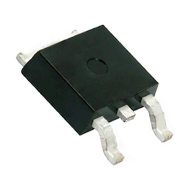

SQD40052EL www.vishay.com Vishay Siliconix Automotive N-Channel 40 V (D-S) 175 °C MOSFET FEATURES • TrenchFET® power MOSFET • Package with low thermal resistance • 100 % Rg and UIS tested • AEC-Q101 qualified • Material categorization: for definitions of compliance please see www.vishay.com/doc?99912 D PRODUCT SUMMARY VDS (V) RDS(on) (Ω) at VGS = 10 V 0.0060 RDS(on) (Ω) at VGS = 4.5 V 0.0078 ID (A) Configuration Package G 40 N-Channel MOSFET 30 S Single TO-252 ABSOLUTE MAXIMUM RATINGS (TC = 25 °C, unless otherwise noted) PARAMETER SYMBOL LIMIT Drain-source voltage VDS 40 Gate-source voltage VGS ± 20 Continuous drain current a TC = 25 °C TC = 125 °C Continuous source current (diode conduction) a Pulsed drain current b Single pulse avalanche current Single pulse avalanche energy Maximum power dissipation L = 0.1 mH TC = 25 °C TC = 125 °C Operating junction and storage temperature range ID V 30 30 IS 30 IDM 120 IAS 24 EAS 28.8 PD UNIT 62 20 A mJ W TJ, Tstg -55 to +175 °C SYMBOL LIMIT UNIT RthJA 50 RthJC 2.4 THERMAL RESISTANCE RATINGS PARAMETER Junction-to-ambient Junction-to-case (drain) PCB mount c °C/W Notes a. Package limited b. Pulse test; pulse width ≤ 300 μs, duty cycle ≤ 2 % c. When mounted on 1" square PCB (FR4 material) S21-0146-Rev. A, 22-Feb-2021 Document Number: 77607 1 For technical questions, contact: automostechsupport@vishay.com THIS DOCUMENT IS SUBJECT TO CHANGE WITHOUT NOTICE. THE PRODUCTS DESCRIBED HEREIN AND THIS DOCUMENT ARE SUBJECT TO SPECIFIC DISCLAIMERS, SET FORTH AT www.vishay.com/doc?91000 SQD40052EL www.vishay.com Vishay Siliconix SPECIFICATIONS (TC = 25 °C, unless otherwise noted) PARAMETER SYMBOL TEST CONDITIONS MIN. TYP. MAX. UNIT Static Drain-source breakdown voltage Gate-source threshold voltage Gate-source leakage VDS VGS = 0 V, ID = 250 μA 40 - - VGS(th) VDS = VGS, ID = 250 μA 1.2 1.7 2.2 VDS = 0 V, VGS = ± 20 V IGSS - - ± 100 VGS = 0 V VDS = 40 V - - 1 - - 50 V nA μA Zero gate voltage drain current IDSS VGS = 0 V VDS = 40 V, TJ = 125 °C VGS = 0 V VDS = 40 V, TJ = 175 °C - - 250 μA On-state drain current a ID(on) VGS = 10 V VDS ≥ 5 V 20 - - A VGS = 10 V ID = 15 A - 0.0046 0.0060 VGS = 4.5 V ID = 10 A - 0.0060 0.0078 VGS = 10 V ID = 15 A, TJ = 125 °C - - 0.0091 VGS = 10 V ID = 15 A, TJ = 175 °C Drain-source on-state resistance a Forward transconductance b Dynamic RDS(on) gfs VDS = 15 V, ID = 15 A - - 0.0107 - 62 - - 1844 2600 - 527 750 - 56 80 Ω S b Input capacitance Ciss Output capacitance Coss Reverse transfer capacitance Crss Total gate charge c Qg Gate-source charge c Qgs Gate-drain charge c Qgd Gate resistance Rg Turn-on delay time c Rise time c Turn-off delay time c Fall time c VGS = 0 V VGS = 10 V VDS = 25 V, f = 1 MHz VDS = 20 V, ID = 15 A f = 1 MHz td(on) tr td(off) VDD = 20 V, RL = 1.33 Ω ID ≅ 15 A, VGEN = 10 V, Rg = 1 Ω tf - 34.5 52 - 6.1 - - 6.6 - 1.45 2.91 4.37 - 12 25 - 7 15 - 28 50 - 10 20 pF nC Ω ns Source-Drain Diode Ratings and Characteristics b Pulsed current a ISM Forward voltage VSD IF = 15 A, VGS = 0 V - - 120 - 0.83 1.5 V - 26 52 ns - 13 26 nC - 11 - Body diode reverse recovery time trr Body diode reverse recovery charge Qrr Reverse recovery fall time ta Reverse recovery rise time tb - 15 - IRM(REC) - -0.86 - Body diode peak reverse recovery current IF = 10 A, di/dt = 100 A/μs A ns A Notes a. Pulse test; pulse width ≤ 300 μs, duty cycle ≤ 2 % b. Guaranteed by design, not subject to production testing c. Independent of operating temperature Stresses beyond those listed under “Absolute Maximum Ratings” may cause permanent damage to the device. These are stress ratings only, and functional operation of the device at these or any other conditions beyond those indicated in the operational sections of the specifications is not implied. Exposure to absolute maximum rating conditions for extended periods may affect device reliability. S21-0146-Rev. A, 22-Feb-2021 Document Number: 77607 2 For technical questions, contact: automostechsupport@vishay.com THIS DOCUMENT IS SUBJECT TO CHANGE WITHOUT NOTICE. THE PRODUCTS DESCRIBED HEREIN AND THIS DOCUMENT ARE SUBJECT TO SPECIFIC DISCLAIMERS, SET FORTH AT www.vishay.com/doc?91000 SQD40052EL www.vishay.com Vishay Siliconix TYPICAL CHARACTERISTICS (TA = 25 °C, unless otherwise noted) Axis Title Axis Title 10000 350 10000 150 VGS = 10 V thru 6 V 280 1st line 2nd line 140 VGS = 4 V 100 70 1000 90 1st line 2nd line 2nd line ID - Drain Current (A) 1000 210 2nd line ID - Drain Current (A) 120 VGS = 5 V TC = 125 °C 60 TC = 25 °C 100 30 VGS = 3 V TC = -55 °C 10 0 0 2 4 6 8 10 0 10 0 2 4 6 8 VDS - Drain-to-Source Voltage (V) VGS - Gate-to-Source Voltage (V) Output Characteristics Transfer Characteristics 10 Axis Title 10000 0.015 150 120 TC = 125 °C 90 TC = 25 °C 60 30 0.012 1000 0.009 VGS = 4.5 V 0.006 100 VGS = 10 V 0.003 10 0 0 0 15 30 45 60 0 75 16 32 Axis Title 1st line 2nd line 100 100 Crss 10 10 16 24 32 40 10000 ID = 15 A, VDS = 20 V 8 1000 6 1st line 2nd line 1000 Coss 2nd line VGS - Gate-to-Source Voltage (V) 10 Ciss 8 4 100 2 10 0 0 10 20 30 40 VDS - Drain-to-Source Voltage (V) Qg - Total Gate Charge (nC) Capacitance Gate Charge S21-0146-Rev. A, 22-Feb-2021 80 Axis Title 10000 10 000 0 64 On-Resistance vs. Drain Current Transconductance 1000 48 ID - Drain Current (A) ID - Drain Current (A) 2nd line C - Capacitance (pF) 1st line 2nd line 2nd line RDS(on) - On-Resistance (Ω) 2nd line gfs - Transconductance (S) TC = -55 °C 50 Document Number: 77607 3 For technical questions, contact: automostechsupport@vishay.com THIS DOCUMENT IS SUBJECT TO CHANGE WITHOUT NOTICE. THE PRODUCTS DESCRIBED HEREIN AND THIS DOCUMENT ARE SUBJECT TO SPECIFIC DISCLAIMERS, SET FORTH AT www.vishay.com/doc?91000 SQD40052EL www.vishay.com Vishay Siliconix TYPICAL CHARACTERISTICS (TA = 25 °C, unless otherwise noted) Axis Title Axis Title 10000 10000 0.4 VGS = 10 V ID = 15 A 0.1 VGS = 4.5 V 1.1 100 0.8 1000 -0.2 ID = 5 mA -0.5 100 ID = 250 μA -0.8 10 0.5 -50 -25 0 25 50 75 10 -1.1 100 125 150 175 -50 -25 0 25 75 100 125 150 175 TJ - Junction Temperature (°C) On-Resistance vs. Junction Temperature Threshold Voltage Axis Title Axis Title 10000 1000 1st line 2nd line 0.012 TJ = 150 °C 100 0.006 TJ = 25 °C 10 0 2 4 6 8 ID = 1 mA 56 1000 54 1st line 2nd line 0.024 0.018 10000 58 2nd line VDS - Drain-to-Source Voltage (V) 0.030 2nd line RDS(on) - On-Resistance (Ω) 50 TJ - Junction Temperature (°C) 0 1st line 2nd line 1000 1.4 2nd line VGS(th) - Variance (V) 1.7 1st line 2nd line 2nd line RDS(on) - On-Resistance (Normalized) 2.0 52 100 50 10 48 -50 10 -25 0 25 50 75 100 125 150 175 VGS - Gate-to-Source Voltage (V) TJ - Junction Temperature (°C) On-Resistance vs. Gate-to-Source Voltage Drain Source Breakdown vs. Junction Temperature Axis Title Axis Title 100 10000 1000 10000 IDM limited 1 100 0.1 TJ = 25 °C 10 0.3 0.6 0.9 1000 10 1.2 1.5 1 ms ID limited 1 Limited by RDS(on) 10 ms 100 ms, 1 s, 10 s, DC a 100 BVDSS limited 0.1 0.01 0 100 μs 1st line 2nd line 1000 2nd line ID - Drain Current (A) 100 1st line 2nd line 2nd line IS - Source Current (A) TJ = 150 °C 10 0.01 0.01 TC = 25 °C, single pulse 10 0.1 1 10 VSD - Source-to-Drain Voltage (V) VDS - Drain-to-Source Voltage (V) Source Drain Diode Forward Voltage Safe Operating Area 100 Note a. VGS > minimum VGS at which RDS(on) is specified S21-0146-Rev. A, 22-Feb-2021 Document Number: 77607 4 For technical questions, contact: automostechsupport@vishay.com THIS DOCUMENT IS SUBJECT TO CHANGE WITHOUT NOTICE. THE PRODUCTS DESCRIBED HEREIN AND THIS DOCUMENT ARE SUBJECT TO SPECIFIC DISCLAIMERS, SET FORTH AT www.vishay.com/doc?91000 SQD40052EL www.vishay.com Vishay Siliconix THERMAL RATINGS (TA = 25 °C, unless otherwise noted) Axis Title Duty cycle = 0.5 0.2 1000 0.1 0.1 1st line 2nd line Normalized Effective Transient Thermal Impedance 10000 1 0.05 0.02 100 0.01 single pulse 0.001 0.0001 0.001 0.01 0.1 1 10 100 10 1000 Square Wave Pulse Duration (s) 2nd line Normalized Thermal Transient Impedance, Junction-to-Ambient Axis Title 1 Duty cycle = 0.5 1000 0.2 1st line 2nd line Normalized Effective Transient Thermal Impedance 10000 0.1 0.1 0.05 100 0.02 Single pulse 0.01 0.0001 10 0.001 0.01 0.1 1 10 Square Wave Pulse Duration (s) 2nd line Normalized Thermal Transient Impedance, Junction-to-Case Note • The characteristics shown in the two graphs - Normalized Transient Thermal Impedance Junction-to-Ambient (25 °C) - Normalized Transient Thermal Impedance Junction-to-Case (25 °C) are given for general guidelines only to enable the user to get a “ball park” indication of part capabilities. The data are extracted from single pulse transient thermal impedance characteristics which are developed from empirical measurements. The latter is valid for the part mounted on printed circuit board - FR4, size 1" x 1" x 0.062", double sided with 2 oz. copper, 100 % on both sides. The part capabilities can widely vary depending on actual application parameters and operating conditions Vishay Siliconix maintains worldwide manufacturing capability. Products may be manufactured at one of several qualified locations. Reliability data for Silicon Technology and Package Reliability represent a composite of all qualified locations. For related documents such as package / tape drawings, part marking, and reliability data, see www.vishay.com/ppg?77607. S21-0146-Rev. A, 22-Feb-2021 Document Number: 77607 5 For technical questions, contact: automostechsupport@vishay.com THIS DOCUMENT IS SUBJECT TO CHANGE WITHOUT NOTICE. THE PRODUCTS DESCRIBED HEREIN AND THIS DOCUMENT ARE SUBJECT TO SPECIFIC DISCLAIMERS, SET FORTH AT www.vishay.com/doc?91000 Legal Disclaimer Notice www.vishay.com Vishay Disclaimer ALL PRODUCT, PRODUCT SPECIFICATIONS AND DATA ARE SUBJECT TO CHANGE WITHOUT NOTICE TO IMPROVE RELIABILITY, FUNCTION OR DESIGN OR OTHERWISE. Vishay Intertechnology, Inc., its affiliates, agents, and employees, and all persons acting on its or their behalf (collectively, “Vishay”), disclaim any and all liability for any errors, inaccuracies or incompleteness contained in any datasheet or in any other disclosure relating to any product. Vishay makes no warranty, representation or guarantee regarding the suitability of the products for any particular purpose or the continuing production of any product. To the maximum extent permitted by applicable law, Vishay disclaims (i) any and all liability arising out of the application or use of any product, (ii) any and all liability, including without limitation special, consequential or incidental damages, and (iii) any and all implied warranties, including warranties of fitness for particular purpose, non-infringement and merchantability. Statements regarding the suitability of products for certain types of applications are based on Vishay's knowledge of typical requirements that are often placed on Vishay products in generic applications. Such statements are not binding statements about the suitability of products for a particular application. It is the customer's responsibility to validate that a particular product with the properties described in the product specification is suitable for use in a particular application. Parameters provided in datasheets and / or specifications may vary in different applications and performance may vary over time. All operating parameters, including typical parameters, must be validated for each customer application by the customer's technical experts. Product specifications do not expand or otherwise modify Vishay's terms and conditions of purchase, including but not limited to the warranty expressed therein. Hyperlinks included in this datasheet may direct users to third-party websites. These links are provided as a convenience and for informational purposes only. Inclusion of these hyperlinks does not constitute an endorsement or an approval by Vishay of any of the products, services or opinions of the corporation, organization or individual associated with the third-party website. Vishay disclaims any and all liability and bears no responsibility for the accuracy, legality or content of the third-party website or for that of subsequent links. Except as expressly indicated in writing, Vishay products are not designed for use in medical, life-saving, or life-sustaining applications or for any other application in which the failure of the Vishay product could result in personal injury or death. Customers using or selling Vishay products not expressly indicated for use in such applications do so at their own risk. Please contact authorized Vishay personnel to obtain written terms and conditions regarding products designed for such applications. No license, express or implied, by estoppel or otherwise, to any intellectual property rights is granted by this document or by any conduct of Vishay. Product names and markings noted herein may be trademarks of their respective owners. © 2021 VISHAY INTERTECHNOLOGY, INC. ALL RIGHTS RESERVED Revision: 09-Jul-2021 1 Document Number: 91000
