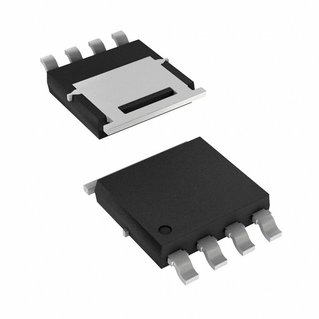

    特性:TrenchFET功率MOSFET。 AEC-Q101合格。 100% Rg和UIS测试
SQJ414EP-T1_GE3 数据手册
SQJ414EP www.vishay.com Vishay Siliconix Automotive N-Channel 30 V (D-S) 175 °C MOSFET FEATURES PowerPAK® SO-8L Single • TrenchFET® power MOSFET • AEC-Q101 qualified • 100 % Rg and UIS tested D 6. 15 m m m 1 3 .1 m 4 G 5 Top View 3 S 2 S 1 S • Material categorization: for definitions of compliance please see www.vishay.com/doc?99912 D Bottom View PRODUCT SUMMARY VDS (V) 30 RDS(on) () at VGS = 10 V 0.0120 RDS(on) () at VGS = 4.5 V 0.0170 ID (A) 30 Configuration Package G N-Channel MOSFET Single S PowerPAK SO-8L ABSOLUTE MAXIMUM RATINGS (TC = 25 °C, unless otherwise noted) PARAMETER SYMBOL LIMIT Drain-source voltage VDS 30 Gate-source voltage VGS ± 20 Continuous drain current TC = 25 °C a TC = 125 °C Continuous source current (diode conduction) a Pulsed drain current b Single pulse avalanche current Single pulse avalanche energy Maximum power dissipation b L = 0.1 mH TC = 25 °C TC = 125 °C Operating junction and storage temperature range ID 25 30 IDM 90 IAS 22 EAS 24.2 TJ, Tstg Soldering recommendations (peak temperature) d, e V 30 IS PD UNIT 45 15 -55 to +175 260 A mJ W °C THERMAL RESISTANCE RATINGS PARAMETER Junction-to-ambient Junction-to-case (drain) PCB mount c SYMBOL LIMIT RthJA 70 RthJC 3.3 UNIT °C/W Notes a. Package limited b. Pulse test; pulse width  300 μs, duty cycle  2 % c. When mounted on 1" square PCB (FR4 material) d. See solder profile (www.vishay.com/doc?73257). The PowerPAK SO-8L is a leadless package. The end of the lead terminal is exposed copper (not plated) as a result of the singulation process in manufacturing. A solder fillet at the exposed copper tip cannot be guaranteed and is not required to ensure adequate bottom side solder interconnection e. Rework conditions: manual soldering with a soldering iron is not recommended for leadless components S17-0520-Rev. A, 10-Apr-17 Document Number: 75498 1 For technical questions, contact: automostechsupport@vishay.com THIS DOCUMENT IS SUBJECT TO CHANGE WITHOUT NOTICE. THE PRODUCTS DESCRIBED HEREIN AND THIS DOCUMENT ARE SUBJECT TO SPECIFIC DISCLAIMERS, SET FORTH AT www.vishay.com/doc?91000 SQJ414EP www.vishay.com Vishay Siliconix SPECIFICATIONS (TC = 25 °C, unless otherwise noted) PARAMETER SYMBOL TEST CONDITIONS MIN. TYP. MAX. UNIT Static Drain-source breakdown voltage Gate-source threshold voltage Gate-source leakage Zero gate voltage drain current On-state drain current a Drain-source on-state resistance a Forward transconductance b Dynamic VDS VGS = 0, ID = 250 μA 30 - - VGS(th) VDS = VGS, ID = 250 μA 1.5 2.0 2.5 VDS = 0 V, VGS = ± 20 V IGSS IDSS ID(on) RDS(on) gfs - - ± 100 VGS = 0 V VDS = 30 V - - 1 VGS = 0 V VDS = 30 V, TJ = 125 °C - - 50 VGS = 0 V VDS = 30 V, TJ = 175 °C - - 250 VGS = 10 V VDS  5 V 15 - - VGS = 10 V ID = 4.5 A - 0.0098 0.0120 VGS = 4.5 V ID = 3 A - 0.0139 0.0170 VGS = 10 V ID = 4.5 A, TJ = 125 °C - - 0.0188 VGS = 10 V ID = 4.5 A, TJ = 175 °C - - 0.0227 - 31 - VDS = 15 V, ID = 4 A V nA μA A  S b Input capacitance Ciss Output capacitance Coss Reverse transfer capacitance Crss Total gate charge c Qg Gate-source charge c Qgs Gate-drain charge c Qgd Gate resistance Rg Turn-on delay time c Rise time c Turn-off delay time c Fall time c - 850 1110 - 167 220 - 60 80 - 15 25 - 3 - - 3 - f = 1 MHz 0.7 1.5 2.3 - 11 20 VDD = 15 V, RL = 3.8  ID  4 A, VGEN = 10 V, Rg = 1  - 5 10 - 21 40 - 5 10 VGS = 0 V VGS = 10 V VDS = 15 V, f = 1 MHz VDS = 15 V, ID = 5 A td(on) tr td(off) tf pF nC  ns Source-Drain Diode Ratings and Characteristics b Pulsed current a ISM Forward voltage VSD Body diode reverse recovery time trr IF = 4 A, VGS = 0 - - 90 - 0.79 1.2 V - 22 50 ns - 18 40 nC - 14 - Body diode reverse recovery charge Qrr Reverse recovery fall time ta Reverse recovery rise time tb - 8 - IRM(REC) - -1.5 - Body diode peak reverse recovery current IF = 3 A, di/dt = 100 A/μs A ns A Notes a. Pulse test; pulse width  300 μs, duty cycle  2 % b. Guaranteed by design, not subject to production testing c. Independent of operating temperature Stresses beyond those listed under “Absolute Maximum Ratings” may cause permanent damage to the device. These are stress ratings only, and functional operation of the device at these or any other conditions beyond those indicated in the operational sections of the specifications is not implied. Exposure to absolute maximum rating conditions for extended periods may affect device reliability. S17-0520-Rev. A, 10-Apr-17 Document Number: 75498 2 For technical questions, contact: automostechsupport@vishay.com THIS DOCUMENT IS SUBJECT TO CHANGE WITHOUT NOTICE. THE PRODUCTS DESCRIBED HEREIN AND THIS DOCUMENT ARE SUBJECT TO SPECIFIC DISCLAIMERS, SET FORTH AT www.vishay.com/doc?91000 SQJ414EP www.vishay.com Vishay Siliconix TYPICAL CHARACTERISTICS (TA = 25 °C, unless otherwise noted) Axis Title Axis Title 100 75 10000 10000 VGS = 10 V thru 5 V 40 100 20 1000 45 1st line 2nd line 1000 60 2nd line ID - Drain Current (A) 60 VGS = 4 V 1st line 2nd line 2nd line ID - Drain Current (A) 80 30 TC = 125 °C 100 TC = 25 °C 15 VGS = 3 V TC = -55 °C 0 0 10 0 2 4 6 8 10 10 0 2 4 6 8 VDS - Drain-to-Source Voltage (V) 2nd line VGS - Gate-to-Source Voltage (V) 2nd line Output Characteristics Transfer Characteristics 10 Axis Title Axis Title 80 0.05 10000 10000 TC = 125 °C 32 100 16 0 3 6 9 12 1000 0.03 VGS = 4.5 V 0.02 100 0.01 VGS = 10 V 0 10 0 0.04 10 0 15 12 On-Resistance vs. Drain Current Axis Title 480 Crss 100 Coss 0 10 12 18 24 30 10000 ID = 5 A VDS = 15 V 8 1000 6 1st line 2nd line 1000 720 2nd line VGS - Gate-to-Source Voltage (V) Ciss 240 4 100 2 0 10 0 4 8 12 16 VDS - Drain-to-Source Voltage (V) 2nd line Qg - Total Gate Charge (nC) 2nd line Capacitance Gate Charge S17-0520-Rev. A, 10-Apr-17 60 10 10000 1st line 2nd line 2nd line C - Capacitance (pF) 48 Transconductance Axis Title 6 36 ID - Drain Current (A) 2nd line 1200 0 24 ID - Drain Current (A) 2nd line 960 1st line 2nd line 1000 48 2nd line RDS(on) - On-Resistance (Ω) TC = 25 °C 64 1st line 2nd line 2nd line gfs - Transconductance (S) TC = -55 °C 20 Document Number: 75498 3 For technical questions, contact: automostechsupport@vishay.com THIS DOCUMENT IS SUBJECT TO CHANGE WITHOUT NOTICE. THE PRODUCTS DESCRIBED HEREIN AND THIS DOCUMENT ARE SUBJECT TO SPECIFIC DISCLAIMERS, SET FORTH AT www.vishay.com/doc?91000 SQJ414EP www.vishay.com Vishay Siliconix TYPICAL CHARACTERISTICS (TA = 25 °C, unless otherwise noted) Axis Title Axis Title 100 10000 1.4 VGS = 4.5 V 1.1 100 0.8 0.5 25 50 1000 1 0.1 0.01 10 0 75 100 125 150 175 0.2 0.4 0.6 0.8 1.0 1.2 TJ - Junction Temperature (°C) 2nd line VSD - Source-to-Drain Voltage (V) 2nd line On-Resistance vs. Junction Temperature Source Drain Diode Forward Voltage Axis Title Axis Title 0.10 0.4 10000 10000 0.1 1000 0.06 0.04 100 TJ = 150 °C 0.02 1000 -0.2 1st line 2nd line 2nd line VGS(th) Variance (V) 0.08 1st line 2nd line 2nd line RDS(on) - On-Resistance (Ω) 100 TJ = 25 °C 0.001 10 0 TJ = 150 °C 1st line 2nd line 2nd line IS - Source Current (A) 10 1000 -50 -25 10000 VGS = 10 V ID = 4.5 A 1.7 1st line 2nd line 2nd line RDS(on) - On-Resistance (Normalized) 2.0 ID = 5 mA -0.5 100 -0.8 ID = 250 μA TJ = 25 °C 0.00 -1.1 10 0 2 4 6 8 10 -50 -25 10 0 25 50 75 100 125 150 175 VGS - Gate-to-Source Voltage (V) 2nd line TJ - Temperature (°C) 2nd line On-Resistance vs. Gate-to-Source Voltage Threshold Voltage Axis Title 10000 ID = 1 mA 38 1000 36 1st line 2nd line 2nd line VDS - Drain-to-Source Voltage (V) 40 34 100 32 30 10 -50 -25 0 25 50 75 100 125 150 175 TJ - Junction Temperature (°C) 2nd line Drain Source Breakdown vs. Junction Temperature S17-0520-Rev. A, 10-Apr-17 Document Number: 75498 4 For technical questions, contact: automostechsupport@vishay.com THIS DOCUMENT IS SUBJECT TO CHANGE WITHOUT NOTICE. THE PRODUCTS DESCRIBED HEREIN AND THIS DOCUMENT ARE SUBJECT TO SPECIFIC DISCLAIMERS, SET FORTH AT www.vishay.com/doc?91000 SQJ414EP www.vishay.com Vishay Siliconix THERMAL RATINGS (TA = 25 °C, unless otherwise noted) Axis Title 1000 10000 IDM limited 100 μs 10 1000 1st line 2nd line 2nd line ID - Drain Current (A) 100 1 ms ID limited 10 ms 100 ms, 1 s, 10 s, DC 1 100 Limited by RDS(on) (1) 0.1 TC = 25 °C Single pulse 0.01 0.01 (1) BVDSS limited 10 0.1 1 10 100 VDS - Drain-to-Source Voltage (V) VGS > minimum VGS at which RDS(on) is specified Normalized Effective Transient Thermal Impedance Safe Operating Area 1 Duty cycle = 0.5 0.2 0.1 Notes: 0.1 PDM 0.05 t1 t2 1. Duty cycle, D = t1 t2 2. Per unit base = R thJA = 70 °C/W 0.02 3. TJM - TA = PDMZthJA(t) Single pulse 4. Surface nounted 0.01 0.0001 0.001 0.01 0.1 1 10 100 1000 Square Wave Pulse Duration (s) Normalized Thermal Transient Impedance, Junction-to-Ambient S17-0520-Rev. A, 10-Apr-17 Document Number: 75498 5 For technical questions, contact: automostechsupport@vishay.com THIS DOCUMENT IS SUBJECT TO CHANGE WITHOUT NOTICE. THE PRODUCTS DESCRIBED HEREIN AND THIS DOCUMENT ARE SUBJECT TO SPECIFIC DISCLAIMERS, SET FORTH AT www.vishay.com/doc?91000 SQJ414EP www.vishay.com Vishay Siliconix THERMAL RATINGS (TA = 25 °C, unless otherwise noted) Axis Title 1 Duty cycle = 0.5 1000 0.2 0.1 1st line Normalized Effective Transient Thermal Impedance 10000 0.1 100 0.05 0.02 Single pulse 0.01 0.0001 10 0.001 0.01 0.1 1 Square Wave Pulse Duration (s) 2nd line Normalized Thermal Transient Impedance, Junction-to-Case Note • The characteristics shown in the two graphs - Normalized Transient Thermal Impedance Junction-to-Ambient (25 °C) - Normalized Transient Thermal Impedance Junction-to-Case (25 °C) are given for general guidelines only to enable the user to get a “ball park” indication of part capabilities. The data are extracted from single pulse transient thermal impedance characteristics which are developed from empirical measurements. The latter is valid for the part mounted on printed circuit board - FR4, size 1" x 1" x 0.062", double sided with 2 oz. copper, 100 % on both sides. The part capabilities can widely vary depending on actual application parameters and operating conditions. Vishay Siliconix maintains worldwide manufacturing capability. Products may be manufactured at one of several qualified locations. Reliability data for Silicon Technology and Package Reliability represent a composite of all qualified locations. For related documents such as package / tape drawings, part marking, and reliability data, see www.vishay.com/ppg?75498. S17-0520-Rev. A, 10-Apr-17 Document Number: 75498 6 For technical questions, contact: automostechsupport@vishay.com THIS DOCUMENT IS SUBJECT TO CHANGE WITHOUT NOTICE. THE PRODUCTS DESCRIBED HEREIN AND THIS DOCUMENT ARE SUBJECT TO SPECIFIC DISCLAIMERS, SET FORTH AT www.vishay.com/doc?91000 Package Information www.vishay.com Vishay Siliconix PowerPAK® SO-8L Case Outline 2 Revision: 05-Aug-2019 Document Number: 66934 1 For technical questions, contact: pmostechsupport@vishay.com THIS DOCUMENT IS SUBJECT TO CHANGE WITHOUT NOTICE. THE PRODUCTS DESCRIBED HEREIN AND THIS DOCUMENT ARE SUBJECT TO SPECIFIC DISCLAIMERS, SET FORTH AT www.vishay.com/doc?91000 Package Information www.vishay.com DIM. Vishay Siliconix MILLIMETERS INCHES MIN. NOM. MAX. MIN. NOM. MAX. A 1.00 1.07 1.14 0.039 0.042 0.045 A1 0.00 - 0.127 0.00 - 0.005 b 0.33 0.41 0.48 0.013 0.016 0.019 b1 0.44 0.51 0.58 0.017 0.020 0.023 b2 4.80 4.90 5.00 0.189 0.193 0.197 b3 0.094 0.004 b4 0.47 0.019 c 0.20 0.25 0.30 0.008 0.010 0.012 D 5.00 5.13 5.25 0.197 0.202 0.207 D1 4.80 4.90 5.00 0.189 0.193 0.197 D2 3.86 3.96 4.06 0.152 0.156 0.160 D3 1.63 1.73 1.83 0.064 0.068 0.072 e 1.27 BSC 0.050 BSC E 6.05 6.15 6.25 0.238 0.242 0.246 E1 4.27 4.37 4.47 0.168 0.172 0.176 E2 2.75 2.85 2.95 0.108 0.112 0.116 F - - 0.15 - - 0.006 L 0.62 0.72 0.82 0.024 0.028 0.032 L1 0.92 1.07 1.22 0.036 0.042 0.048 K 0.51 0.020 W 0.23 0.009 W1 0.41 0.016 W2 2.82 0.111 W3 q 2.96 0° - 0.117 10° 0° - 10° ECN: S19-0643-Rev. B, 05-Aug-2019 DWG: 6044 Note • Millimeters will gover Revision: 05-Aug-2019 Document Number: 66934 2 For technical questions, contact: pmostechsupport@vishay.com THIS DOCUMENT IS SUBJECT TO CHANGE WITHOUT NOTICE. THE PRODUCTS DESCRIBED HEREIN AND THIS DOCUMENT ARE SUBJECT TO SPECIFIC DISCLAIMERS, SET FORTH AT www.vishay.com/doc?91000 PAD Pattern www.vishay.com Vishay Siliconix RECOMMENDED MINIMUM PAD FOR PowerPAK® SO-8L SINGLE 5.000 (0.197) 0.510 (0.020) 2.310 (0.091) 4.061 (0.160) 0.595 (0.023) 6.250 (0.246) 8.250 (0.325) 3.630 (0.143) 0.610 (0.024) 0.410 (0.016) 2.715 (0.107) 0.860 (0.034) 1.291 (0.051) 0.710 (0.028) 0.820 (0.032) 1.905 (0.075) 1.270 (0.050) 7.250 (0.285) Recommended Minimum Pads Dimensions in mm (inches) Revision: 07-Feb-12 1 Document Number: 63818 THIS DOCUMENT IS SUBJECT TO CHANGE WITHOUT NOTICE. THE PRODUCTS DESCRIBED HEREIN AND THIS DOCUMENT ARE SUBJECT TO SPECIFIC DISCLAIMERS, SET FORTH AT www.vishay.com/doc?91000 Legal Disclaimer Notice www.vishay.com Vishay Disclaimer ALL PRODUCT, PRODUCT SPECIFICATIONS AND DATA ARE SUBJECT TO CHANGE WITHOUT NOTICE TO IMPROVE RELIABILITY, FUNCTION OR DESIGN OR OTHERWISE. Vishay Intertechnology, Inc., its affiliates, agents, and employees, and all persons acting on its or their behalf (collectively, “Vishay”), disclaim any and all liability for any errors, inaccuracies or incompleteness contained in any datasheet or in any other disclosure relating to any product. Vishay makes no warranty, representation or guarantee regarding the suitability of the products for any particular purpose or the continuing production of any product. To the maximum extent permitted by applicable law, Vishay disclaims (i) any and all liability arising out of the application or use of any product, (ii) any and all liability, including without limitation special, consequential or incidental damages, and (iii) any and all implied warranties, including warranties of fitness for particular purpose, non-infringement and merchantability. Statements regarding the suitability of products for certain types of applications are based on Vishay’s knowledge of typical requirements that are often placed on Vishay products in generic applications. Such statements are not binding statements about the suitability of products for a particular application. It is the customer’s responsibility to validate that a particular product with the properties described in the product specification is suitable for use in a particular application. Parameters provided in datasheets and / or specifications may vary in different applications and performance may vary over time. All operating parameters, including typical parameters, must be validated for each customer application by the customer’s technical experts. Product specifications do not expand or otherwise modify Vishay’s terms and conditions of purchase, including but not limited to the warranty expressed therein. Except as expressly indicated in writing, Vishay products are not designed for use in medical, life-saving, or life-sustaining applications or for any other application in which the failure of the Vishay product could result in personal injury or death. Customers using or selling Vishay products not expressly indicated for use in such applications do so at their own risk. Please contact authorized Vishay personnel to obtain written terms and conditions regarding products designed for such applications. No license, express or implied, by estoppel or otherwise, to any intellectual property rights is granted by this document or by any conduct of Vishay. Product names and markings noted herein may be trademarks of their respective owners. © 2021 VISHAY INTERTECHNOLOGY, INC. ALL RIGHTS RESERVED Revision: 01-Jan-2021 1 Document Number: 91000
