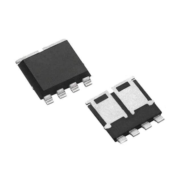

SQJQ960EL www.vishay.com Vishay Siliconix Automotive Dual N-Channel 60 V (D-S) 175 °C MOSFET FEATURES PowerPAK® 8 x 8L Dual • TrenchFET® power MOSFET • AEC-Q101 qualified D1 • 100 % Rg and UIS tested • Fully lead (Pb)-free device D2 8 m m m 1 m 8.1 Top View 4 G2 3 S2 2 S1 1 G1 • Material categorization:  for definitions of compliance please see www.vishay.com/doc?99912 D1 Bottom View D2 PRODUCT SUMMARY VDS (V) 60 RDS(on) () at VGS = 10 V 0.009 RDS(on) () at VGS = 4.5 V 0.013 ID (A) per leg 63 Configuration Dual Package G1 G2 S1 PowerPAK 8 x 8L S2 N-Channel MOSFET N-Channel MOSFET ABSOLUTE MAXIMUM RATINGS (TC = 25 °C, unless otherwise noted) PARAMETER SYMBOL LIMIT Drain-source voltage VDS 60 Gate-source voltage VGS ± 20 Continuous drain current TC = 25 °C a TC = 125 °C Continuous source current (diode conduction) a Pulsed drain current b Single pulse avalanche current Single pulse avalanche energy Maximum power dissipation b L = 0.1 mH TC = 25 °C TC = 125 °C Operating junction and storage temperature range ID 63 IS 50 200 IAS 26 EAS 34 TJ, Tstg Soldering recommendations (peak temperature) d, e V 36 IDM PD UNIT 71 24 -55 to +175 260 A mJ W °C THERMAL RESISTANCE RATINGS PARAMETER Junction-to-ambient Junction-to-case (drain) SYMBOL PCB mount c LIMIT RthJA 75 RthJC 2.1 UNIT °C/W Notes a. Package limited b. Pulse test; pulse width  300 μs, duty cycle  2 % c. When mounted on 1" square PCB (FR4 material) d. See solder profile (www.vishay.com/doc?73257). The PowerPAK 8 x 8L is a leadless package. The end of the lead terminal is exposed copper (not plated) as a result of the singulation process in manufacturing. A solder fillet at the exposed copper tip cannot be guaranteed and is not required to ensure adequate bottom side solder interconnection e. Rework conditions: manual soldering with a soldering iron is not recommended for leadless components S17-0463-Rev. A, 27-Mar-17 Document Number: 76020 1 For technical questions, contact: automostechsupport@vishay.com THIS DOCUMENT IS SUBJECT TO CHANGE WITHOUT NOTICE. THE PRODUCTS DESCRIBED HEREIN AND THIS DOCUMENT ARE SUBJECT TO SPECIFIC DISCLAIMERS, SET FORTH AT www.vishay.com/doc?91000 SQJQ960EL www.vishay.com Vishay Siliconix SPECIFICATIONS (TC = 25 °C, unless otherwise noted) PARAMETER SYMBOL TEST CONDITIONS MIN. TYP. MAX. UNIT Static Drain-source breakdown voltage Gate-source threshold voltage Gate-source leakage Zero gate voltage drain current On-state drain current a Drain-source on-state resistance a Forward transconductance b VDS VGS = 0, ID = 250 μA 60 - - VGS(th) VDS = VGS, ID = 250 μA 1.5 2 2.5 VDS = 0 V, VGS = ± 20 V IGSS IDSS ID(on) RDS(on) gfs - - ± 100 VGS = 0 V VDS = 20 V - - 1 VGS = 0 V VDS = 60 V, TJ = 125 °C - - 50 VGS = 0 V VDS = 60 V, TJ = 175 °C - - 150 VGS = 10 V VDS  5 V 40 - - VGS = 10 V ID = 10 A - 0.0070 0.0090 VGS = 4.5 V ID = 7 A - 0.0092 0.0130 VGS = 10 V ID = 10 A, TJ = 125 °C - - 0.0145 VGS = 10 V ID = 10 A, TJ = 175 °C VDS = 15 V, ID = 10 A - - 0.0180 - 55 1950 V nA μA A  S Dynamic b Input capacitance Ciss Output capacitance Coss Reverse transfer capacitance Crss Total gate charge c Qg Gate-source charge c Qgs Gate-drain charge c Qgd Gate resistance Turn-on delay time c Rise time c Turn-off delay time c Fall time c Rg VGS = 0 V VDS = 25 V, f = 1 MHz VGS = 10 V VDS = 30 V, ID = 10 A f = 1 MHz td(on) tr td(off) VDD = 30 V, RL = 4  ID  10 A, VGEN = 10 V, Rg = 1  tf Source-Drain Diode Ratings and Characteristics - 1560 - 771 964 - 87 108 - 19 24 - 4 - - 2 - 0.98 1.6 2.6 - 10 14 pF nC  - 3 5 - 22 28 - 3 5 - - 200 A - 1 1.2 V ns b Pulsed current a ISM Forward voltage VSD IF = 20 A, VGS = 0 Notes a. Pulse test; pulse width  300 μs, duty cycle  2 % b. Guaranteed by design, not subject to production testing c. Independent of operating temperature   Stresses beyond those listed under “Absolute Maximum Ratings” may cause permanent damage to the device. These are stress ratings only, and functional operation of the device at these or any other conditions beyond those indicated in the operational sections of the specifications is not implied. Exposure to absolute maximum rating conditions for extended periods may affect device reliability. S17-0463-Rev. A, 27-Mar-17 Document Number: 76020 2 For technical questions, contact: automostechsupport@vishay.com THIS DOCUMENT IS SUBJECT TO CHANGE WITHOUT NOTICE. THE PRODUCTS DESCRIBED HEREIN AND THIS DOCUMENT ARE SUBJECT TO SPECIFIC DISCLAIMERS, SET FORTH AT www.vishay.com/doc?91000 SQJQ960EL www.vishay.com Vishay Siliconix TYPICAL CHARACTERISTICS (TA = 25 °C, unless otherwise noted) Axis Title Axis Title 150 10000 10000 1.2 VGS = 10 V thru 5 V 1.0 60 100 30 1000 0.8 1st line 2nd line VGS = 4 V 2nd line ID - Drain Current (A) 1000 90 1st line 2nd line 0.6 TC = 25 °C 0.4 100 0.2 TC = -55 °C TC = 125 °C 0 10 0 6 12 18 24 0.0 10 0 30 1 2 VGS - Gate-to-Source Voltage (V) 2nd line Output Characteristics Transfer Characteristics 0.025 1000 60 1st line 2nd line 2nd line ID - Drain Current (A) 80 40 100 TC = 25 °C 20 2nd line RDS(on) - On-Resistance (Ω) 10000 TC = 125 °C 0.020 1000 0.015 VGS = 4.5 V 0.010 100 0.005 VGS = 10 V 0.000 10 2 10000 TC = -55 °C 0 1 3 4 10 0 5 20 40 80 100 ID - Drain Current (A) 2nd line Transfer Characteristics On-Resistance vs. Drain Current Axis Title 10 TC = 25 °C 1000 1st line 2nd line 75 TC = 125 °C 100 25 0 10 12 18 24 30 10000 ID = 10 A VDS = 30 V 8 1000 6 1st line 2nd line TC = -55 °C 100 2nd line VGS - Gate-to-Source Voltage (V) 10000 50 4 100 2 0 10 0 5 10 15 20 ID - Drain Current (A) 2nd line Qg - Total Gate Charge (nC) 2nd line Transconductance Gate Charge S17-0463-Rev. A, 27-Mar-17 120 Axis Title 125 2nd line gfs - Transconductance (S) 60 VGS - Gate-to-Source Voltage (V) 2nd line 6 5 Axis Title Axis Title 0 4 VDS - Drain-to-Source Voltage (V) 2nd line 100 0 3 1st line 2nd line 2nd line ID - Drain Current (A) 120 25 Document Number: 76020 3 For technical questions, contact: automostechsupport@vishay.com THIS DOCUMENT IS SUBJECT TO CHANGE WITHOUT NOTICE. THE PRODUCTS DESCRIBED HEREIN AND THIS DOCUMENT ARE SUBJECT TO SPECIFIC DISCLAIMERS, SET FORTH AT www.vishay.com/doc?91000 SQJQ960EL www.vishay.com Vishay Siliconix TYPICAL CHARACTERISTICS (TA = 25 °C, unless otherwise noted) Axis Title Axis Title 2000 Ciss 10000 10 1st line 2nd line Coss 800 100 400 1000 TJ = 25 °C TJ = 150 °C 1 1st line 2nd line 1000 1200 2nd line IS - Source Current (A) 1600 2nd line C - Capacitance (pF) 100 10000 0.1 100 0.01 Crss 0 0.001 10 0 12 24 36 48 10 0 60 0.2 0.4 1.0 1.2 VSD - Source-to-Drain Voltage (V) 2nd line Capacitance Source Drain Diode Forward Voltage Axis Title Axis Title 0.5 10000 ID = 20 A 10000 VGS = 10 V 1.7 VGS = 4.5 V 1.1 100 0.8 ID = 5 mA 1000 -0.3 1st line 2nd line 1000 1.4 2nd line VGS(th) Variance (V) 0.1 1st line 2nd line 2nd line RDS(on) - On-Resistance (Normalized) 0.8 VDS - Drain-to-Source Voltage (V) 2nd line 2.0 -0.7 100 ID = 250 μA -1.1 0.5 -1.5 10 -50 -25 0 25 50 75 100 125 150 175 10 -50 -25 0 25 50 75 100 125 150 175 TJ - Junction Temperature (°C) 2nd line TJ - Temperature (°C) 2nd line On-Resistance vs. Junction Temperature Threshold Voltage Axis Title Axis Title 75 0.04 1000 1st line 2nd line 0.03 0.02 TJ = 150 °C 100 0.01 TJ = 25 °C 0.00 10 0 2 4 6 8 10 2nd line VDS - Drain-to-Source Voltage (V) 10000 10000 ID = 1 mA 73 1000 71 1st line 2nd line 0.05 2nd line RDS(on) - On-Resistance (Ω) 0.6 69 100 67 65 10 -50 -25 0 25 50 75 100 125 150 175 VGS - Gate-to-Source Voltage (V) 2nd line TJ - Junction Temperature (°C) 2nd line On-Resistance vs. Gate-to-Source Voltage Drain Source Breakdown vs. Junction Temperature S17-0463-Rev. A, 27-Mar-17 Document Number: 76020 4 For technical questions, contact: automostechsupport@vishay.com THIS DOCUMENT IS SUBJECT TO CHANGE WITHOUT NOTICE. THE PRODUCTS DESCRIBED HEREIN AND THIS DOCUMENT ARE SUBJECT TO SPECIFIC DISCLAIMERS, SET FORTH AT www.vishay.com/doc?91000 SQJQ960EL www.vishay.com Vishay Siliconix THERMAL RATINGS (TA = 25 °C, unless otherwise noted) 1000 IDM limited ID - Drain Current (A) 100 1 ms 10 ms 100 ms 10 Limited by R DS(on) * 1 0.1 BVDSS limited TC = 25 °C Single pulse 0.01 0.01 1 s, 10 s, DC 0.1 1 10 100 VDS - Drain-to-Source Voltage (V) * VGS > minimum VGS at which RDS(on) is specified Safe Operating Area Normalized Effective Transient Thermal Impedance 1 Duty cycle = 0.5 0.2 0.1 0.1 0.05 0.02 Single pulse 0.01 0.0001 0.001 0.01 0.1 1 Square Wave Pulse Duration (s) 10 100 1000 Normalized Thermal Transient Impedance, Junction-to-Ambient S17-0463-Rev. A, 27-Mar-17 Document Number: 76020 5 For technical questions, contact: automostechsupport@vishay.com THIS DOCUMENT IS SUBJECT TO CHANGE WITHOUT NOTICE. THE PRODUCTS DESCRIBED HEREIN AND THIS DOCUMENT ARE SUBJECT TO SPECIFIC DISCLAIMERS, SET FORTH AT www.vishay.com/doc?91000 SQJQ960EL www.vishay.com Vishay Siliconix THERMAL RATINGS (TA = 25 °C, unless otherwise noted) Normalized Effective Transient Thermal Impedance 1 Duty cycle = 0.5 0.2 0.1 0.1 0.05 Single pulse 0.02 0.01 0.0001 0.001 0.01 0.1 1 10 Square Wave Pulse Duration (s) Normalized Thermal Transient Impedance, Junction-to-Case Note • The characteristics shown in the two graphs - Normalized Transient Thermal Impedance Junction to Ambient (25 °C) - Normalized Transient Thermal Impedance Junction to Case (25 °C) are given for general guidelines only to enable the user to get a “ball park” indication of part capabilities. The data are extracted from single pulse transient thermal impedance characteristics which are developed from empirical measurements. The latter is valid for the part mounted on printed circuit board - FR4, size 1" x 1" x 0.062", double sided with 2 oz. copper, 100 % on both sides. The part capabilities can widely vary depending on actual application parameters and operating conditions.                                    Vishay Siliconix maintains worldwide manufacturing capability. Products may be manufactured at one of several qualified locations. Reliability data for Silicon Technology and Package Reliability represent a composite of all qualified locations. For related documents such as package/tape drawings, part marking, and reliability data, see www.vishay.com/ppg?76020. S17-0463-Rev. A, 27-Mar-17 Document Number: 76020 6 For technical questions, contact: automostechsupport@vishay.com THIS DOCUMENT IS SUBJECT TO CHANGE WITHOUT NOTICE. THE PRODUCTS DESCRIBED HEREIN AND THIS DOCUMENT ARE SUBJECT TO SPECIFIC DISCLAIMERS, SET FORTH AT www.vishay.com/doc?91000 Package Information www.vishay.com Vishay Siliconix PowerPAK® 8 x 8L Case Outline D2 E5 L1 D3 K D3 D7 D5 D5 D7 D5 E1 E W3 W2 W1 D5 E2 E3 b2 K F Bottom view (single) 0.25 Gauge line Top view (single) E5 L θ e W4 D1 D E4 E1 E b1 D5 D4 A2 A1 b D6 E2 E3 W4 D6 W W3 W2 W1 D5 E4 b2 D4 b b1 D1 D e Bottom view (dual) DIM. A C A3 Top view (dual) MILLIMETERS INCHES MIN. NOM. MAX. MIN. NOM. A 1.70 1.80 1.90 0.067 0.071 MAX. 0.075 A1 0.00 0.08 0.13 0.000 0.003 0.005 A2 0.25 0.30 0.35 0.010 0.012 0.014 A3 0.55 0.62 0.70 0.022 0.024 0.028 b 0.92 1.00 1.08 0.036 0.039 0.043 b1 1.02 1.10 1.18 0.040 0.043 0.046 b2 7.80 7.90 8.00 0.307 0.311 0.315 c 0.20 0.25 0.30 0.008 0.010 0.012 D 8.00 8.10 8.25 0.315 0.319 0.325 D1 7.80 7.90 8.00 0.307 0.311 0.315 D2 6.70 6.80 6.90 0.264 0.268 0.272 D3 2.85 2.95 3.05 0.112 0.116 0.120 D4 6.11 6.21 6.31 0.241 0.244 0.248 D5 0.37 0.47 0.57 0.015 0.019 0.022 D6 2.49 2.59 2.69 0.098 0.102 0.106 D7 1.76 1.86 1.96 0.069 0.073 0.077 Revision: 16-Oct-17 Document Number: 67734 1 For technical questions, contact: pmostechsupport@vishay.com THIS DOCUMENT IS SUBJECT TO CHANGE WITHOUT NOTICE. THE PRODUCTS DESCRIBED HEREIN AND THIS DOCUMENT ARE SUBJECT TO SPECIFIC DISCLAIMERS, SET FORTH AT www.vishay.com/doc?91000 Package Information www.vishay.com DIM. Vishay Siliconix MILLIMETERS INCHES MIN. NOM. MAX. MIN. NOM. MAX. e 1.95 2.00 2.05 0.077 0.079 0.081 E 7.90 8.00 8.10 0.311 0.315 0.319 E1 6.12 6.22 6.32 0.241 0.245 0.249 E2 3.94 4.04 4.14 0.140 0.159 0.163 E3 4.69 4.79 4.89 0.185 0.189 0.193 E4 3.23 3.33 3.43 0.127 0.131 0.135 E5 0.65 0.75 0.85 0.026 0.030 0.033 F 0.00 0.10 0.15 0.000 0.004 0.006 L 0.62 0.72 0.82 0.024 0.028 0.032 L1 0.92 1.07 1.22 0.036 0.042 0.048 K 0.80 0.90 1.00 0.031 0.035 0.039 W 0.30 0.40 0.50 0.012 0.016 0.020 W1 0.30 0.40 0.50 0.012 0.016 0.020 W2 4.39 4.49 4.59 0.173 0.177 0.181 W3 4.54 4.64 4.74 0.179 0.183 0.187 W4 0.32 0.37 0.42 0.013 0.015 0.017  6° 10° 14° 6° 10° 14° C17-1388-Rev. B, 16-Oct-17 DWG: 6026 Revision: 16-Oct-17 Document Number: 67734 2 For technical questions, contact: pmostechsupport@vishay.com THIS DOCUMENT IS SUBJECT TO CHANGE WITHOUT NOTICE. THE PRODUCTS DESCRIBED HEREIN AND THIS DOCUMENT ARE SUBJECT TO SPECIFIC DISCLAIMERS, SET FORTH AT www.vishay.com/doc?91000 PAD Pattern www.vishay.com Vishay Siliconix Recommended Minimum PADs for PowerPAK® 8 x 8L Dual 8.00 (0.31) 0.50 (0.02) 4.05 (0.16) 3.55 (0.14) 6.90 (0.27) 3.05 (0.12) 3.99 (0.16) 3.05 (0.12) (0, 0) 0.44 (0.02) 4.59 (0.18) Y 0.80 (0.03) X 0.54 (0.02) 0.85 (0.03) 6.11 (0.24) 1.29 (0.05) 1.94 (0.08) 8.25 (0.32) 3.23 (0.13) 0.82 (0.03) 2.47 (0.10) 3.62 (0.14) 4.05 (0.16) 2.03 (0.08) 1.15 (0.05) 0.88 (0.03) Dimensions in millimeters (inches) Note • Linear dimensions are in black, the same information is provided in ordinate dimensions which are in blue. Revision: 08-Apr-15 1 Document Number: 67489 THIS DOCUMENT IS SUBJECT TO CHANGE WITHOUT NOTICE. THE PRODUCTS DESCRIBED HEREIN AND THIS DOCUMENT ARE SUBJECT TO SPECIFIC DISCLAIMERS, SET FORTH AT www.vishay.com/doc?91000 Legal Disclaimer Notice www.vishay.com Vishay Disclaimer ALL PRODUCT, PRODUCT SPECIFICATIONS AND DATA ARE SUBJECT TO CHANGE WITHOUT NOTICE TO IMPROVE RELIABILITY, FUNCTION OR DESIGN OR OTHERWISE. Vishay Intertechnology, Inc., its affiliates, agents, and employees, and all persons acting on its or their behalf (collectively, “Vishay”), disclaim any and all liability for any errors, inaccuracies or incompleteness contained in any datasheet or in any other disclosure relating to any product. Vishay makes no warranty, representation or guarantee regarding the suitability of the products for any particular purpose or the continuing production of any product. To the maximum extent permitted by applicable law, Vishay disclaims (i) any and all liability arising out of the application or use of any product, (ii) any and all liability, including without limitation special, consequential or incidental damages, and (iii) any and all implied warranties, including warranties of fitness for particular purpose, non-infringement and merchantability. Statements regarding the suitability of products for certain types of applications are based on Vishay's knowledge of typical requirements that are often placed on Vishay products in generic applications. Such statements are not binding statements about the suitability of products for a particular application. It is the customer's responsibility to validate that a particular product with the properties described in the product specification is suitable for use in a particular application. Parameters provided in datasheets and / or specifications may vary in different applications and performance may vary over time. All operating parameters, including typical parameters, must be validated for each customer application by the customer's technical experts. Product specifications do not expand or otherwise modify Vishay's terms and conditions of purchase, including but not limited to the warranty expressed therein. Hyperlinks included in this datasheet may direct users to third-party websites. These links are provided as a convenience and for informational purposes only. Inclusion of these hyperlinks does not constitute an endorsement or an approval by Vishay of any of the products, services or opinions of the corporation, organization or individual associated with the third-party website. Vishay disclaims any and all liability and bears no responsibility for the accuracy, legality or content of the third-party website or for that of subsequent links. Except as expressly indicated in writing, Vishay products are not designed for use in medical, life-saving, or life-sustaining applications or for any other application in which the failure of the Vishay product could result in personal injury or death. Customers using or selling Vishay products not expressly indicated for use in such applications do so at their own risk. Please contact authorized Vishay personnel to obtain written terms and conditions regarding products designed for such applications. No license, express or implied, by estoppel or otherwise, to any intellectual property rights is granted by this document or by any conduct of Vishay. Product names and markings noted herein may be trademarks of their respective owners. © 2021 VISHAY INTERTECHNOLOGY, INC. ALL RIGHTS RESERVED Revision: 09-Jul-2021 1 Document Number: 91000
