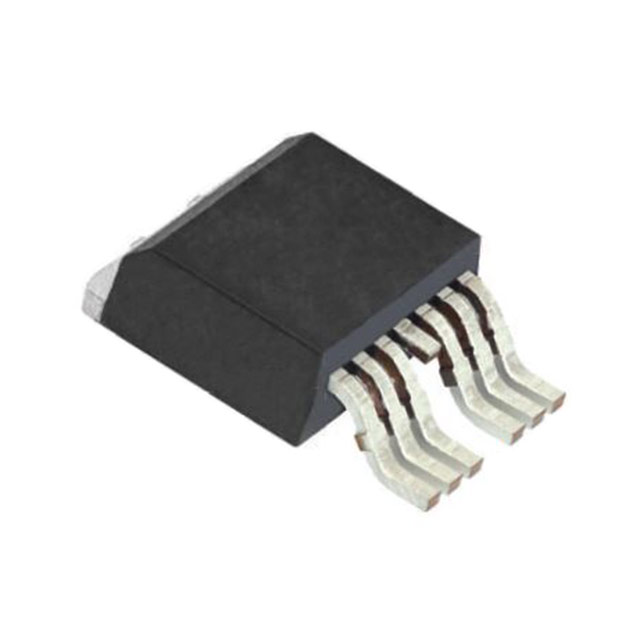

    MOSFET N-CH 40V 150A TO263-7
SQM40022EM_GE3 数据手册
SQM40022EM www.vishay.com Vishay Siliconix Automotive N-Channel 40 V (D-S) 175 °C MOSFET FEATURES TO-263 7-Lead • TrenchFET® power MOSFET • Package with low thermal resistance • 100 % Rg and UIS tested • AEC-Q101 qualified Drain conntected to tab Top View S G D S S S • Material categorization:  for definitions of compliance please see www.vishay.com/doc?99912 S D PRODUCT SUMMARY VDS (V) RDS(on) () at VGS = 10 V 40 0.00163 ID (A) Configuration Package G 150 Single N-Channel MOSFET TO-263-7L S ABSOLUTE MAXIMUM RATINGS (TC = 25 °C, unless otherwise noted) PARAMETER SYMBOL LIMIT Drain-source voltage VDS 40 Gate-source voltage VGS ± 20 Continuous drain current TC = 25 °C a TC = 125 °C Continuous source current (diode conduction) a Pulsed drain current b Single pulse avalanche current Single pulse avalanche energy Maximum power dissipation b L = 0.1 mH TC = 25 °C TC = 125 °C Operating junction and storage temperature range ID V 150 125 IS 136 IDM 300 IAS 60 EAS 180 PD UNIT 150 50 A mJ W TJ, Tstg -55 to +175 °C SYMBOL LIMIT UNIT RthJA 40 RthJC 1 THERMAL RESISTANCE RATINGS PARAMETER Junction-to-ambient Junction-to-case (drain) PCB mount c °C/W Notes a. Package limited b. Pulse test; pulse width  300 μs, duty cycle  2 % c. When mounted on 1" square PCB (FR4 material) S18-0116-Rev. A, 29-Jan-18 Document Number: 77695 1 For technical questions, contact: automostechsupport@vishay.com THIS DOCUMENT IS SUBJECT TO CHANGE WITHOUT NOTICE. THE PRODUCTS DESCRIBED HEREIN AND THIS DOCUMENT ARE SUBJECT TO SPECIFIC DISCLAIMERS, SET FORTH AT www.vishay.com/doc?91000 SQM40022EM www.vishay.com Vishay Siliconix SPECIFICATIONS (TC = 25 °C, unless otherwise noted) PARAMETER SYMBOL TEST CONDITIONS MIN. TYP. MAX. UNIT Static Drain-source breakdown voltage Gate-source threshold voltage Gate-source leakage VDS VGS = 0 V, ID = 250 μA 40 - - VGS(th) VDS = VGS, ID = 250 μA 2.5 3.0 3.5 VDS = 0 V, VGS = ± 20 V IGSS - - ± 100 VGS = 0 V VDS = 40 V - - 1 - - 50 V nA μA Zero gate voltage drain current IDSS VGS = 0 V VDS = 40 V, TJ = 125 °C VGS = 0 V VDS = 40 V, TJ = 175 °C - - 300 μA On-state drain current a ID(on) VGS = 10 V VDS  5 V 100 - - A VGS = 10 V ID = 35 A - VGS = 10 V ID = 35 A, TJ = 125 °C - - 0.00268 VGS = 10 V ID = 35 A, TJ = 175 °C - - 0.00326 - 143 - - 6783 9200 - 1771 2400 - 109 150 Drain-source on-state resistance a Forward transconductance b RDS(on) gfs VDS = 15 V, ID = 35 A 0.00133 0.00163  S Dynamic b Input capacitance Ciss Output capacitance Coss Reverse transfer capacitance Crss Total gate charge c Qg Gate-source charge c Qgs Gate-drain charge c Qgd Gate resistance Turn-on delay time c Rise time c Turn-off delay time c Fall time c Rg VGS = 0 V VGS = 10 V VDS = 25 V, f = 1 MHz VDS = 20 V, ID = 100 A f = 1 MHz td(on) tr td(off) VDD = 20 V, RL = 0.2  ID  100 A, VGEN = 10 V, Rg = 1  tf - 106 160 - 33 - - 21 - 1.25 2.75 4.35 - 19 30 - 194 300 - 45 70 - 26 40 pF nC  ns Source-Drain Diode Ratings and Characteristics b Pulsed current a ISM Forward voltage VSD Body diode reverse recovery time trr Body diode reverse recovery charge Qrr IF = 60 A, VGS = 0 V IF = 30 A, di/dt = 100 A/μs - - 300 - 0.83 1.5 V - 88 180 ns - 186 380 nC Reverse recovery fall time ta - 57 - Reverse recovery rise time tb - 31 - IRM(REC) - -4.6 - Body diode peak reverse recovery current A ns A Notes a. Pulse test; pulse width  300 μs, duty cycle  2 % b. Guaranteed by design, not subject to production testing c. Independent of operating temperature     Stresses beyond those listed under “Absolute Maximum Ratings” may cause permanent damage to the device. These are stress ratings only, and functional operation of the device at these or any other conditions beyond those indicated in the operational sections of the specifications is not implied. Exposure to absolute maximum rating conditions for extended periods may affect device reliability.  S18-0116-Rev. A, 29-Jan-18 Document Number: 77695 2 For technical questions, contact: automostechsupport@vishay.com THIS DOCUMENT IS SUBJECT TO CHANGE WITHOUT NOTICE. THE PRODUCTS DESCRIBED HEREIN AND THIS DOCUMENT ARE SUBJECT TO SPECIFIC DISCLAIMERS, SET FORTH AT www.vishay.com/doc?91000 SQM40022EM www.vishay.com Vishay Siliconix TYPICAL CHARACTERISTICS (TA = 25 °C, unless otherwise noted) Axis Title 10000 125 200 VGS = 6 V thru 10 V 100 VGS = 5 V 120 80 1000 75 1st line 2nd line 2nd line ID - Drain Current (A) 2nd line ID - Drain Current (A) 160 TC = 25 °C 50 100 25 40 TC = 125 °C VGS = 4 V TC = -55 °C 0 0 0 2 4 6 8 10 0 10 2 4 6 8 VDS - Drain-to-Source Voltage (V) 2nd line VGS - Gate-to-Source Voltage (V) 2nd line Output Characteristics Transfer Characteristics 10 Axis Title 200 10000 0.005 TC = 25 °C 1000 120 TC = 125 °C 80 100 40 0 RDS(on) - On-Resistance (Ω) 160 1st line 2nd line 2nd line gfs - Transconductance (S) TC = -55 °C 10 0 10 20 30 40 0.004 0.003 0.002 VGS = 10 V 0.001 0.000 50 0 20 On-Resistance vs. Drain Current Axis Title 100 Coss 2400 Crss 0 10 16 24 32 40 10000 ID = 100 A VDS = 20 V 8 1000 6 1st line 2nd line 1st line 2nd line 4800 2nd line VGS - Gate-to-Source Voltage (V) 1000 Ciss 7200 4 100 2 0 10 0 30 60 90 120 VDS - Drain-to-Source Voltage (V) 2nd line Qg - Total Gate Charge (nC) 2nd line Capacitance Gate Charge S18-0116-Rev. A, 29-Jan-18 100 10 10000 9600 2nd line C - Capacitance (pF) 80 Transconductance Axis Title 8 60 ID - Drain Current (A) 2nd line 12 000 0 40 ID - Drain Current (A) 2nd line 150 Document Number: 77695 3 For technical questions, contact: automostechsupport@vishay.com THIS DOCUMENT IS SUBJECT TO CHANGE WITHOUT NOTICE. THE PRODUCTS DESCRIBED HEREIN AND THIS DOCUMENT ARE SUBJECT TO SPECIFIC DISCLAIMERS, SET FORTH AT www.vishay.com/doc?91000 SQM40022EM www.vishay.com Vishay Siliconix TYPICAL CHARACTERISTICS (TA = 25 °C, unless otherwise noted) Axis Title Axis Title 100 10000 ID = 35 A 10000 VGS = 10 V TJ = 150 °C 1000 1.6 1.2 100 0.8 10 1000 1st line 2nd line 2nd line IS - Source Current (A) 2.0 1st line 2nd line 2nd line RDS(on) - On-Resistance (Normalized) 2.4 1 100 0.1 TJ = 25 °C 0.4 0.01 10 -50 -25 0 25 50 75 100 125 150 175 10 0 0.2 0.5 0.7 1.0 1.2 TJ - Junction Temperature (°C) 2nd line VSD - Source-to-Drain Voltage (V) 2nd line On-Resistance vs. Junction Temperature Source Drain Diode Forward Voltage Axis Title 10000 0.8 0.008 2nd line VGS(th) Variance (V) 0.3 1000 0.006 1st line 2nd line RDS(on) - On-Resistance (Ω) 0.010 0.004 100 TJ = 125°C 0.002 -0.2 ID = 5 mA -0.7 -1.2 TJ = 25 °C ID = 250 μA 0.000 10 0 2 4 6 8 -1.7 10 -50 -25 0 25 50 75 100 125 150 175 VGS - Gate-to-Source Voltage (V) 2nd line TJ - Temperature (°C) 2nd line On-Resistance vs. Gate-to-Source Voltage Threshold Voltage Axis Title 2nd line VDS - Drain-to-Source Voltage (V) 54 ID = 1 mA 52 50 48 46 44 -50 -25 0 25 50 75 100 125 150 175 TJ - Junction Temperature (°C) 2nd line Drain Source Breakdown vs. Junction Temperature S18-0116-Rev. A, 29-Jan-18 Document Number: 77695 4 For technical questions, contact: automostechsupport@vishay.com THIS DOCUMENT IS SUBJECT TO CHANGE WITHOUT NOTICE. THE PRODUCTS DESCRIBED HEREIN AND THIS DOCUMENT ARE SUBJECT TO SPECIFIC DISCLAIMERS, SET FORTH AT www.vishay.com/doc?91000 SQM40022EM www.vishay.com Vishay Siliconix THERMAL RATINGS (TA = 25 °C, unless otherwise noted) Axis Title 1000 10000 IDM limited 100 μs ID limited 1000 1 ms 10 ms 100 ms, 1 s, 10 s, DC 10 Limited by RDS(on) (1) 1 1st line 2nd line 2nd line ID - Drain Current (A) 100 100 0.1 TC = 25 °C single pulse 0.01 0.01 (1) BVDSS limited 0.1 1 10 100 10 1000 VDS - Drain-to-Source Voltage (V) VGS > minimum VGS at which RDS(on) is specified Safe Operating Area Normalized Effective Transient Thermal Impedance 1 0.1 0.01 0.001 0.0001 10-4 10-3 10-2 10-1 1 10 100 1000 Square Wave Pulse Duration (s) Normalized Thermal Transient Impedance, Junction-to-Ambient S18-0116-Rev. A, 29-Jan-18 Document Number: 77695 5 For technical questions, contact: automostechsupport@vishay.com THIS DOCUMENT IS SUBJECT TO CHANGE WITHOUT NOTICE. THE PRODUCTS DESCRIBED HEREIN AND THIS DOCUMENT ARE SUBJECT TO SPECIFIC DISCLAIMERS, SET FORTH AT www.vishay.com/doc?91000 SQM40022EM www.vishay.com Vishay Siliconix THERMAL RATINGS (TA = 25 °C, unless otherwise noted) Normalized Effective Transient Thermal Impedance 2 1 Duty cycle = 0.5 0.2 0.1 0.1 0.05 0.02 Single pulse 0.01 10-4 10-3 10-2 10-1 Square Wave Pulse Duration (s) 1 10 Normalized Thermal Transient Impedance, Junction-to-Case Note • The characteristics shown in the two graphs - Normalized Transient Thermal Impedance Junction-to-Ambient (25 °C) - Normalized Transient Thermal Impedance Junction-to-Case (25 °C) are given for general guidelines only to enable the user to get a “ball park” indication of part capabilities. The data are extracted from single pulse transient thermal impedance characteristics which are developed from empirical measurements. The latter is valid for the part mounted on printed circuit board - FR4, size 1" x 1" x 0.062", double sided with 2 oz. copper, 100 % on both sides. The part capabilities can widely vary depending on actual application parameters and operating conditions                                    Vishay Siliconix maintains worldwide manufacturing capability. Products may be manufactured at one of several qualified locations. Reliability data for Silicon Technology and Package Reliability represent a composite of all qualified locations. For related documents such as package / tape drawings, part marking, and reliability data, see www.vishay.com/ppg?77695. S18-0116-Rev. A, 29-Jan-18 Document Number: 77695 6 For technical questions, contact: automostechsupport@vishay.com THIS DOCUMENT IS SUBJECT TO CHANGE WITHOUT NOTICE. THE PRODUCTS DESCRIBED HEREIN AND THIS DOCUMENT ARE SUBJECT TO SPECIFIC DISCLAIMERS, SET FORTH AT www.vishay.com/doc?91000 Package Information www.vishay.com Vishay Siliconix D2PAK (TO-263-7L) Case Outline Notes 1. Plane B includes maximum features of heat sink tab and plastic. 2. No more than 25 % of L1 can fall above seating plane by max. 8 mils. 3. Pin to pin coplanarity max. 4 mils. 4. Lead thickness 25 mils. 5. For SUM part numbers lead thickness is 24 mils to 29 mils. 6. For reference only. 7. Use inches as the primary measurement. 8. This feature is only for SUM. INCHES MILLIMETERS DIM. MIN. MAX. MIN. MAX. A 0.160 0.190 4.064 4.826 b 0.020 0.039 0.508 0.990 b1 0.020 0.035 0.508 0.889 b2 0.045 0.055 1.143 1.397 c* SUB 0.012 0.018 0.305 0.457 c* SUM 0.022 0.028 0.559 0.711 c1 0.018 0.025 0.457 0.635 c2 0.045 0.055 1.143 1.397 D 0.340 0.380 8.636 9.652 D1 0.220 0.240 5.588 6.096 D2 0.038 0.042 0.965 1.067 D3 0.045 0.055 1.143 1.397 E 0.380 0.410 9.652 10.414 E1 0.245 - 6.223 - E2 0.072 0.078 1.829 1.981 0.050 BSC e 1.27 BSC K 0.045 0.055 1.143 1.397 L 0.575 0.625 14.605 15.875 L1 0.090 0.110 2.286 2.794 L2 0.040 0.055 1.016 1.397 L3 0.050 0.070 1.270 1.778 0.010 BSC L4 M - 0.002 0.254 BSC - 0.050 ECN: T13-0709-Rev. B, 30-Sep-13 DWG: 6006 Revision: 30-Sep-13 1 Document Number: 63782 THIS DOCUMENT IS SUBJECT TO CHANGE WITHOUT NOTICE. THE PRODUCTS DESCRIBED HEREIN AND THIS DOCUMENT ARE SUBJECT TO SPECIFIC DISCLAIMERS, SET FORTH AT www.vishay.com/doc?91000 PAD Pattern www.vishay.com Vishay Siliconix Recommended Land Pattern D2PAK (TO-263-7L) 0.145 (3.683) 0.635 (16.129) 0.355 (9.017) 0.420 (10.668) 0.135 (3.429) 0.061 (1.540) 0.039 (1.000) 0.050 (1.270) 0.339 (8.620) Revision: 23-Jul-2020 Document Number: 77341 1 For technical questions, contact: pmostechsupport@vishay.comgz THIS DOCUMENT IS SUBJECT TO CHANGE WITHOUT NOTICE. THE PRODUCTS DESCRIBED HEREIN AND THIS DOCUMENT ARE SUBJECT TO SPECIFIC DISCLAIMERS, SET FORTH AT www.vishay.com/doc?91000 Legal Disclaimer Notice www.vishay.com Vishay Disclaimer ALL PRODUCT, PRODUCT SPECIFICATIONS AND DATA ARE SUBJECT TO CHANGE WITHOUT NOTICE TO IMPROVE RELIABILITY, FUNCTION OR DESIGN OR OTHERWISE. Vishay Intertechnology, Inc., its affiliates, agents, and employees, and all persons acting on its or their behalf (collectively, “Vishay”), disclaim any and all liability for any errors, inaccuracies or incompleteness contained in any datasheet or in any other disclosure relating to any product. Vishay makes no warranty, representation or guarantee regarding the suitability of the products for any particular purpose or the continuing production of any product. To the maximum extent permitted by applicable law, Vishay disclaims (i) any and all liability arising out of the application or use of any product, (ii) any and all liability, including without limitation special, consequential or incidental damages, and (iii) any and all implied warranties, including warranties of fitness for particular purpose, non-infringement and merchantability. Statements regarding the suitability of products for certain types of applications are based on Vishay's knowledge of typical requirements that are often placed on Vishay products in generic applications. Such statements are not binding statements about the suitability of products for a particular application. It is the customer's responsibility to validate that a particular product with the properties described in the product specification is suitable for use in a particular application. Parameters provided in datasheets and / or specifications may vary in different applications and performance may vary over time. All operating parameters, including typical parameters, must be validated for each customer application by the customer's technical experts. Product specifications do not expand or otherwise modify Vishay's terms and conditions of purchase, including but not limited to the warranty expressed therein. Hyperlinks included in this datasheet may direct users to third-party websites. These links are provided as a convenience and for informational purposes only. Inclusion of these hyperlinks does not constitute an endorsement or an approval by Vishay of any of the products, services or opinions of the corporation, organization or individual associated with the third-party website. Vishay disclaims any and all liability and bears no responsibility for the accuracy, legality or content of the third-party website or for that of subsequent links. Except as expressly indicated in writing, Vishay products are not designed for use in medical, life-saving, or life-sustaining applications or for any other application in which the failure of the Vishay product could result in personal injury or death. Customers using or selling Vishay products not expressly indicated for use in such applications do so at their own risk. Please contact authorized Vishay personnel to obtain written terms and conditions regarding products designed for such applications. No license, express or implied, by estoppel or otherwise, to any intellectual property rights is granted by this document or by any conduct of Vishay. Product names and markings noted herein may be trademarks of their respective owners. © 2021 VISHAY INTERTECHNOLOGY, INC. ALL RIGHTS RESERVED Revision: 09-Jul-2021 1 Document Number: 91000
