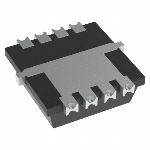

    特性:TrenchFET功率MOSFET。AEC-Q101合格。100% Rg和UIS测试
SQS482ENW-T1_GE3 数据手册
SQS482ENW www.vishay.com Vishay Siliconix Automotive N-Channel 30 V (D-S) 175 °C MOSFET FEATURES PowerPAK® 1212-8W Single D 5 3. 3 m D 6 D 7 • TrenchFET® power MOSFET D 8 • AEC-Q101 qualified d • 100 % Rg and UIS tested m 1 3.3 mm Top View 4 G Bottom View 3 S 2 S 1 S • Material categorization: for definitions of compliance please see www.vishay.com/doc?99912 D Marking code: Q034 PRODUCT SUMMARY VDS (V) RDS(on) () at VGS = 10 V 0.0085 RDS(on) () at VGS = 4.5 V 0.0100 ID (A) Configuration Package G 30 16 S Single N-Channel MOSFET PowerPAK 1212-8W ABSOLUTE MAXIMUM RATINGS (TC = 25 °C, unless otherwise noted) PARAMETER SYMBOL LIMIT Drain-source voltage VDS 30 Gate-source voltage VGS ± 20 Continuous drain current a TC = 25 °C TC = 125 °C Continuous source current (diode conduction) a Pulsed drain current b Single pulse avalanche current Single pulse avalanche energy Maximum power dissipation b L = 0.1 mH TC = 25 °C TC = 125 °C Operating junction and storage temperature range ID 16 16 IDM 64 IAS 31 EAS 48 TJ, Tstg Soldering recommendations (peak temperature) e, f V 16 IS PD UNIT 62 20 -55 to +175 260 A mJ W °C THERMAL RESISTANCE RATINGS PARAMETER Junction-to-ambient Junction-to-case (drain) PCB mount c SYMBOL LIMIT RthJA 81 RthJC 2.4 UNIT °C/W Notes a. Package limited b. Pulse test; pulse width  300 μs, duty cycle  2 % c. When mounted on 1" square PCB (FR4 material) d. Parametric verification ongoing e. See solder profile (www.vishay.com/doc?73257). The PowerPAK 1212-8W is a leadless package. The end of the lead terminal is exposed copper (not plated) as a result of the singulation process in manufacturing. A solder fillet at the exposed copper tip cannot be guaranteed and is not required to ensure adequate bottom side solder interconnection f. Rework conditions: manual soldering with a soldering iron is not recommended for leadless components S17-1217-Rev. A, 07-Aug-17 Document Number: 75543 1 For technical questions, contact: automostechsupport@vishay.com THIS DOCUMENT IS SUBJECT TO CHANGE WITHOUT NOTICE. THE PRODUCTS DESCRIBED HEREIN AND THIS DOCUMENT ARE SUBJECT TO SPECIFIC DISCLAIMERS, SET FORTH AT www.vishay.com/doc?91000 SQS482ENW www.vishay.com Vishay Siliconix SPECIFICATIONS (TC = 25 °C, unless otherwise noted) PARAMETER SYMBOL TEST CONDITIONS MIN. TYP. MAX. UNIT Static Drain-source breakdown voltage Gate-source threshold voltage Gate-source leakage Zero gate voltage drain current On-state drain current a Drain-source on-state resistance a Forward transconductance b VDS VGS = 0, ID = 250 μA 30 - - VGS(th) VDS = VGS, ID = 250 μA 1.5 2.0 2.5 VDS = 0 V, VGS = ± 20 V IGSS IDSS ID(on) RDS(on) gfs - - ± 100 VGS = 0 V VDS = 30 V - - 1 VGS = 0 V VDS = 30 V, TJ = 125 °C - - 50 VGS = 0 V VDS = 30 V, TJ = 175 °C - - 150 VGS = 10 V VDS  5 V 20 - - VGS = 10 V ID = 16.4 A - 0.0070 0.0085 VGS = 10 V ID = 16.4 A, TJ = 125 °C - - 0.0135 VGS = 10 V ID = 16.4 A, TJ = 175 °C - - 0.0160 VGS = 4.5 V ID = 16.4 A - 0.0080 0.0100 - 70 - VDS = 15 V, ID = 16.4 A V nA μA A  S Dynamic b Input capacitance Ciss Output capacitance Coss Reverse transfer capacitance Crss Total gate charge c Qg Gate-source charge c Qgs Gate-drain charge c Qgd Gate resistance Turn-on delay time c Rise time c Turn-off delay time c Fall Time c Rg VGS = 0 V VDS = 25 V, f = 1 MHz VGS = 10 V VDS = 15 V, ID = 10 A f = 1 MHz td(on) tr td(off) VDD = 15 V, RL = 3  ID  5 A, VGEN = 10 V, Rg = 1  tf Source-Drain Diode Ratings and Characteristics - 1492 1865 - 280 350 - 108 135 - 26 39 - 4.7 - - 4.3 - 5 10 20 - 7 11 - 21 32 - 49 74 - 18 27 pF nC  ns b Pulsed current a ISM Forward voltage VSD IF = 15 A, VGS = 0 - - 64 A - 0.82 1.2 V Notes a. Pulse test; pulse width  300 μs, duty cycle  2 % b. Guaranteed by design, not subject to production testing c. Independent of operating temperature     Stresses beyond those listed under “Absolute Maximum Ratings” may cause permanent damage to the device. These are stress ratings only, and functional operation of the device at these or any other conditions beyond those indicated in the operational sections of the specifications is not implied. Exposure to absolute maximum rating conditions for extended periods may affect device reliability.  S17-1217-Rev. A, 07-Aug-17 Document Number: 75543 2 For technical questions, contact: automostechsupport@vishay.com THIS DOCUMENT IS SUBJECT TO CHANGE WITHOUT NOTICE. THE PRODUCTS DESCRIBED HEREIN AND THIS DOCUMENT ARE SUBJECT TO SPECIFIC DISCLAIMERS, SET FORTH AT www.vishay.com/doc?91000 SQS482ENW www.vishay.com Vishay Siliconix TYPICAL CHARACTERISTICS (TA = 25 °C, unless otherwise noted) 60 60 VGS = 10 V thru 4 V 48 ID - Drain Current (A) ID - Drain Current (A) 48 36 24 TC = 25 °C 24 12 VGS = 3 V 12 36 TC = 125 °C TC = - 55 °C 0 0 0 2 4 6 8 VDS - Drain-to-Source Voltage (V) 10 0 1 2 3 4 VGS - Gate-to-Source Voltage (V) 5 Transfer Characteristics Output Characteristics 10 100 8 80 gfs - Transconductance (S) ID - Drain Current (A) TC = - 55 °C 6 4 TC = 25 °C 2 TC = 25 °C 60 TC = 125 °C 40 20 TC = 125 °C TC = - 55 °C 0 0 0 1 2 3 4 VGS - Gate-to-Source Voltage (V) 5 0 4 16 20 6 12 18 24 VDS - Drain-to-Source Voltage (V) 30 Transconductance Transfer Characteristics 0.020 2000 Ciss 1600 0.015 C - Capacitance (pF) RDS(on) - On-Resistance (Ω) 8 12 ID - Drain Current (A) 0.010 VGS = 4.5 V VGS = 10 V 0.005 1200 800 Coss 400 0 Crss 0 0 12 24 36 ID - Drain Current (A) 48 On-Resistance vs. Drain Current S17-1217-Rev. A, 07-Aug-17 60 0 Capacitance Document Number: 75543 3 For technical questions, contact: automostechsupport@vishay.com THIS DOCUMENT IS SUBJECT TO CHANGE WITHOUT NOTICE. THE PRODUCTS DESCRIBED HEREIN AND THIS DOCUMENT ARE SUBJECT TO SPECIFIC DISCLAIMERS, SET FORTH AT www.vishay.com/doc?91000 SQS482ENW www.vishay.com Vishay Siliconix TYPICAL CHARACTERISTICS (TA = 25 °C, unless otherwise noted) 2.0 ID = 10 A VDS = 15 V 8 ID = 16.4 A RDS(on) - On-Resistance (Normalized) VGS - Gate-to-Source Voltage (V) 10 6 4 2 1.7 1.4 VGS = 4.5 V 1.1 0.8 0.5 -50 0 0 5 10 15 20 Qg - Total Gate Charge (nC) 25 30 -25 0 25 50 75 100 125 TJ - Junction Temperature (°C) 150 175 On-Resistance vs. Junction Temperature Gate Charge 0.10 100 0.08 RDS(on) - On-Resistance (Ω) 10 IS - Source Current (A) VGS = 10 V TJ = 150 °C 1 TJ = 25 °C 0.1 0.06 0.04 TJ = 150 °C 0.02 0.01 TJ = 25 °C 0.001 0.0 0.00 0.2 0.4 0.6 0.8 1.0 1.2 0 2 4 6 8 VGS - Gate-to-Source Voltage (V) VSD - Source-to-Drain Voltage (V) 10 On-Resistance vs. Gate-to-Source Voltage Source Drain Diode Forward Voltage 0.5 40 VDS - Drain-to-Source Voltage (V) VGS(th) Variance (V) 0.2 -0.1 ID = 5 mA -0.4 -0.7 -1.0 -50 ID = 250 μA -25 0 25 50 75 100 TJ - Temperature (°C) Threshold Voltage S17-1217-Rev. A, 07-Aug-17 125 150 175 ID = 1 mA 38 36 34 32 30 - 50 - 25 0 25 50 75 100 125 TJ - Junction Temperature (°C) 150 175 Drain Source Breakdown vs. Junction Temperature Document Number: 75543 4 For technical questions, contact: automostechsupport@vishay.com THIS DOCUMENT IS SUBJECT TO CHANGE WITHOUT NOTICE. THE PRODUCTS DESCRIBED HEREIN AND THIS DOCUMENT ARE SUBJECT TO SPECIFIC DISCLAIMERS, SET FORTH AT www.vishay.com/doc?91000 SQS482ENW www.vishay.com Vishay Siliconix THERMAL RATINGS (TA = 25 °C, unless otherwise noted) 100 100 μs IDM Limited ID - Drain Current (A) 10 1 ms ID Limited 10 ms 100 ms,1 s,10 s,DC 1 Limited by RDS(on)* 0.1 TC = 25 °C Single Pulse BVDSS Limited 0.01 0.01 0.1 1 10 100 VDS - Drain-to-Source Voltage (V) * VGS > minimum VGS at which RDS(on) is specified Safe Operating Area 1 Normalized Effective Transient Thermal Impedance Duty Cycle = 0.5 0.2 0.1 Notes: 0.1 PDM 0.05 t1 t2 1. Duty Cycle, D = t1 t2 2. Per Unit Base = RthJA = 81 °C/W 0.02 3. TJM - TA = PDMZthJA(t) Single Pulse 4. Surface Mounted 0.01 10 -4 10 -3 10 -2 10 -1 1 Square Wave Pulse Duration (s) 10 100 1000 Normalized Thermal Transient Impedance, Junction-to-Ambient S17-1217-Rev. A, 07-Aug-17 Document Number: 75543 5 For technical questions, contact: automostechsupport@vishay.com THIS DOCUMENT IS SUBJECT TO CHANGE WITHOUT NOTICE. THE PRODUCTS DESCRIBED HEREIN AND THIS DOCUMENT ARE SUBJECT TO SPECIFIC DISCLAIMERS, SET FORTH AT www.vishay.com/doc?91000 SQS482ENW www.vishay.com Vishay Siliconix THERMAL RATINGS (TA = 25 °C, unless otherwise noted) 2 Normalized Effective Transient Thermal Impedance 1 Duty Cycle = 0.5 0.2 0.1 0.1 Single Pulse 0.05 0.02 0.01 10-4 10-3 10-2 Square Wave Pulse Duration (s) 10-1 1 Normalized Thermal Transient Impedance, Junction-to-Case Note • The characteristics shown in the two graphs - Normalized Transient Thermal Impedance Junction-to-Ambient (25 °C) - Normalized Transient Thermal Impedance Junction-to-Case (25 °C) are given for general guidelines only to enable the user to get a “ball park” indication of part capabilities. The data are extracted from single pulse transient thermal impedance characteristics which are developed from empirical measurements. The latter is valid for the part mounted on printed circuit board - FR4, size 1" x 1" x 0.062", double sided with 2 oz. copper, 100 % on both sides. The part capabilities can widely vary depending on actual application parameters and operating conditions                                    Vishay Siliconix maintains worldwide manufacturing capability. Products may be manufactured at one of several qualified locations. Reliability data for Silicon Technology and Package Reliability represent a composite of all qualified locations. For related documents such as package / tape drawings, part marking, and reliability data, see www.vishay.com/ppg?75543. S17-1217-Rev. A, 07-Aug-17 Document Number: 75543 6 For technical questions, contact: automostechsupport@vishay.com THIS DOCUMENT IS SUBJECT TO CHANGE WITHOUT NOTICE. THE PRODUCTS DESCRIBED HEREIN AND THIS DOCUMENT ARE SUBJECT TO SPECIFIC DISCLAIMERS, SET FORTH AT www.vishay.com/doc?91000 Package Information www.vishay.com Vishay Siliconix PowerPAK® 1212-8W Case Outline E2 E4 H L K 1 Z 2 4 5 3 4 b 6 θ 3 D5 2 D2 2 7 D1 D 8 e 1 M θ D4 A2 W L1 θ E3 Backside view of single pad θ c A A1 2 E1 E DIM. Detail Z Notes 1 Inch will govern 2 Dimensions exclusive of mold gate burrs 3 Dimensions exclusive of mold flash and cutting burrs MILLIMETERS INCHES MIN. NOM. MAX. MIN. NOM. MAX. A 0.97 1.04 1.12 0.038 0.041 0.044 A1 0 - 0.05 0 - 0.002 A2 0 - 0.13 0 - 0.005 b 0.23 0.30 0.41 0.009 0.012 0.016 c 0.23 0.28 0.33 0.009 0.011 0.013 D 3.20 3.30 3.40 0.126 0.130 0.134 D1 2.95 3.05 3.15 0.116 0.120 0.124 D2 1.98 2.11 2.24 0.078 0.083 0.088 D4 0.47 typ. D5 2.3 typ. 0.0185 typ. 0.090 typ. E 3.20 3.30 3.40 0.126 0.130 0.134 E1 2.95 3.05 3.15 0.116 0.120 0.124 E2 1.47 1.60 1.73 0.058 0.063 0.068 E3 1.75 1.85 1.98 0.069 0.073 0.078 E4 0.34 typ. 0.013 typ. e 0.65 BSC. 0.026 BSC K 0.86 typ. 0.034 typ. H 0.30 0.41 0.51 0.012 0.016 0.020 L 0.30 0.43 0.56 0.012 0.017 0.022 L1 0.06 0.13 0.20 0.002 0.005 0.008  0° - 12° 0° - 12° W 0.15 0.25 0.36 0.006 0.010 0.014 M 0.125 typ. 0.005 typ. ECN: C15-1530-Rev. B, 16-Nov-15 DWG: 6032 Revision: 16-Nov-15 Document Number: 64614 1 For technical questions, contact: pmostechsupport@vishay.com THIS DOCUMENT IS SUBJECT TO CHANGE WITHOUT NOTICE. THE PRODUCTS DESCRIBED HEREIN AND THIS DOCUMENT ARE SUBJECT TO SPECIFIC DISCLAIMERS, SET FORTH AT www.vishay.com/doc?91000 Application Note 826 Vishay Siliconix RECOMMENDED MINIMUM PADS FOR PowerPAK® 1212-8 Single 0.152 (3.860) 0.039 0.068 (0.990) (1.725) 0.010 (0.255) (2.390) 0.094 0.088 (2.235) 0.016 (0.405) 0.026 (0.660) 0.025 0.030 (0.635) (0.760) Recommended Minimum Pads Dimensions in Inches/(mm) Return to Index Return to Index APPLICATION NOTE Document Number: 72597 Revision: 21-Jan-08 www.vishay.com 7 Legal Disclaimer Notice www.vishay.com Vishay Disclaimer ALL PRODUCT, PRODUCT SPECIFICATIONS AND DATA ARE SUBJECT TO CHANGE WITHOUT NOTICE TO IMPROVE RELIABILITY, FUNCTION OR DESIGN OR OTHERWISE. Vishay Intertechnology, Inc., its affiliates, agents, and employees, and all persons acting on its or their behalf (collectively, “Vishay”), disclaim any and all liability for any errors, inaccuracies or incompleteness contained in any datasheet or in any other disclosure relating to any product. Vishay makes no warranty, representation or guarantee regarding the suitability of the products for any particular purpose or the continuing production of any product. To the maximum extent permitted by applicable law, Vishay disclaims (i) any and all liability arising out of the application or use of any product, (ii) any and all liability, including without limitation special, consequential or incidental damages, and (iii) any and all implied warranties, including warranties of fitness for particular purpose, non-infringement and merchantability. Statements regarding the suitability of products for certain types of applications are based on Vishay's knowledge of typical requirements that are often placed on Vishay products in generic applications. Such statements are not binding statements about the suitability of products for a particular application. It is the customer's responsibility to validate that a particular product with the properties described in the product specification is suitable for use in a particular application. Parameters provided in datasheets and / or specifications may vary in different applications and performance may vary over time. All operating parameters, including typical parameters, must be validated for each customer application by the customer's technical experts. Product specifications do not expand or otherwise modify Vishay's terms and conditions of purchase, including but not limited to the warranty expressed therein. Hyperlinks included in this datasheet may direct users to third-party websites. These links are provided as a convenience and for informational purposes only. Inclusion of these hyperlinks does not constitute an endorsement or an approval by Vishay of any of the products, services or opinions of the corporation, organization or individual associated with the third-party website. Vishay disclaims any and all liability and bears no responsibility for the accuracy, legality or content of the third-party website or for that of subsequent links. Except as expressly indicated in writing, Vishay products are not designed for use in medical, life-saving, or life-sustaining applications or for any other application in which the failure of the Vishay product could result in personal injury or death. Customers using or selling Vishay products not expressly indicated for use in such applications do so at their own risk. Please contact authorized Vishay personnel to obtain written terms and conditions regarding products designed for such applications. No license, express or implied, by estoppel or otherwise, to any intellectual property rights is granted by this document or by any conduct of Vishay. Product names and markings noted herein may be trademarks of their respective owners. © 2021 VISHAY INTERTECHNOLOGY, INC. ALL RIGHTS RESERVED Revision: 09-Jul-2021 1 Document Number: 91000
