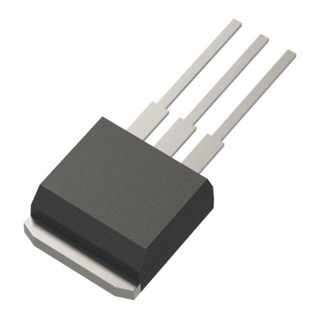

    MOSFET N-CH 100V 120A TO262-3
SQV120N10-3M8_GE3 数据手册
SQV120N10-3m8 www.vishay.com Vishay Siliconix Automotive N-Channel 100 V (D-S) 175 °C MOSFET FEATURES PRODUCT SUMMARY VDS (V) • TrenchFET® Power MOSFET 100 RDS(on) () at VGS = 10 V • Package with Low Thermal Resistance 0.0038 ID (A) • AEC-Q101 Qualifiedd 120 Configuration TO-262 1 • 100 % Rg and UIS Tested Single • Material categorization: For definitions of compliance please see www.vishay.com/doc?99912 D 2 3 G Top View S G D S N-Channel MOSFET ORDERING INFORMATION Package TO-262 Lead (Pb)-free and Halogen-free SQV120N10-3m8-GE3 ABSOLUTE MAXIMUM RATINGS (TC = 25 °C, unless otherwise noted) PARAMETER SYMBOL LIMIT Drain-Source Voltage VDS 100 Gate-Source Voltage VGS ± 20 Continuous Drain Current TC = 25 °Ca TC = 125 °C Continuous Source Current (Diode Conduction)a Pulsed Drain Currentb Single Pulse Avalanche Current Single Pulse Avalanche Energy Maximum Power Dissipationb L = 0.1 mH TC = 25 °C TC = 125 °C Operating Junction and Storage Temperature Range ID V 120 102 IS 120 IDM 480 IAS 73 EAS 266 PD UNIT 250 83 A mJ W TJ, Tstg - 55 to + 175 °C SYMBOL LIMIT UNIT RthJA 40 RthJC 0.6 THERMAL RESISTANCE RATINGS PARAMETER Junction-to-Ambient Junction-to-Case (Drain) PCB Mountc °C/W Notes a. Package limited. b. Pulse test; pulse width  300 μs, duty cycle  2 %. c. When mounted on 1" square PCB (FR-4 material). d. Parametric verification ongoing. S13-1433-Rev. A, 01-Jul-13 Document Number: 63402 1 For technical questions, contact: automostechsupport@vishay.com THIS DOCUMENT IS SUBJECT TO CHANGE WITHOUT NOTICE. THE PRODUCTS DESCRIBED HEREIN AND THIS DOCUMENT ARE SUBJECT TO SPECIFIC DISCLAIMERS, SET FORTH AT www.vishay.com/doc?91000 SQV120N10-3m8 www.vishay.com Vishay Siliconix SPECIFICATIONS (TC = 25 °C, unless otherwise noted) PARAMETER SYMBOL TEST CONDITIONS MIN. TYP. MAX. VDS VGS = 0, ID = 250 μA 100 - - VGS(th) VDS = VGS, ID = 250 μA 2.5 3.0 3.5 VDS = 0 V, VGS = ± 20 V UNIT Static Drain-Source Breakdown Voltage Gate-Source Threshold Voltage Gate-Source Leakage Zero Gate Voltage Drain Current On-State Drain Currenta Drain-Source On-State Resistancea Forward Transconductanceb IGSS IDSS ID(on) RDS(on) gfs - - ± 100 VGS = 0 V VDS = 100 V - - 1 VGS = 0 V VDS = 100 V, TJ = 125 °C - - 50 VGS = 0 V VDS = 100 V, TJ = 175 °C - - 500 VGS = 10 V VDS5 V 120 - - VGS = 10 V ID = 20 A - 0.0030 0.0038 VGS = 10 V ID = 20 A, TJ = 125 °C - - 0.0064 VGS = 10 V ID = 20 A, TJ = 175 °C - - 0.0080 - 82 - VDS = 15 V, ID = 20 A V nA μA A  S Dynamicb - 5780 7230 - 3070 3840 Crss - 305 385 Qg - 125 190 Input Capacitance Ciss Output Capacitance Coss Reverse Transfer Capacitance Total Gate Chargec Gate-Source Chargec Gate-Drain Chargec Gate Resistance Turn-On Delay Timec Rise Timec Turn-Off Delay Timec Fall Timec Qgs VGS = 0 V VGS = 10 V VDS = 25 V, f = 1 MHz VDS = 50 V, ID = 70 A Qgd Rg f = 1 MHz td(on) tr td(off) VDD = 50 V, RL = 0.7  ID  70 A, VGEN = 10 V, Rg = 1  tf - 28 - - 46 - 1.6 3.3 5 - 16 25 pF nC  - 110 165 - 40 60 - 12 20 - - 480 A - 0.9 1.5 V ns Source-Drain Diode Ratings and Characteristicsb Pulsed Currenta ISM Forward Voltage VSD IF = 100 A, VGS = 0 Notes a. Pulse test; pulse width  300 μs, duty cycle  2 %. b. Guaranteed by design, not subject to production testing. c. Independent of operating temperature. Stresses beyond those listed under “Absolute Maximum Ratings” may cause permanent damage to the device. These are stress ratings only, and functional operation of the device at these or any other conditions beyond those indicated in the operational sections of the specifications is not implied. Exposure to absolute maximum rating conditions for extended periods may affect device reliability. S13-1433-Rev. A, 01-Jul-13 Document Number: 63402 2 For technical questions, contact: automostechsupport@vishay.com THIS DOCUMENT IS SUBJECT TO CHANGE WITHOUT NOTICE. THE PRODUCTS DESCRIBED HEREIN AND THIS DOCUMENT ARE SUBJECT TO SPECIFIC DISCLAIMERS, SET FORTH AT www.vishay.com/doc?91000 SQV120N10-3m8 www.vishay.com Vishay Siliconix TYPICAL CHARACTERISTICS (TA = 25 °C, unless otherwise noted) 150 VGS = 10 V thru 7 V 200 120 ID - Drain Current (A) VGS = 6 V ID - Drain Current (A) 150 100 50 90 TC = 25°C 60 TC = 125°C 30 TC = - 55°C VGS = 5 V 0 0 0 2 4 6 8 10 0 2 4 6 8 10 VGS - Gate-to-Source Voltage (V) VDS - Drain-to-Source Voltage (V) Output Characteristics Transfer Characteristics 200 0.010 TC = - 55 °C TC = 25 °C RDS(on) - On-Resistance (Ω) gfs - Transconductance (S) 160 120 TC = 125 °C 80 40 0.008 0.006 0.004 VGS = 10 V 0.002 0 0.000 0 14 28 42 56 70 0 20 ID - Drain Current (A) 40 60 80 100 120 ID - Drain Current (A) Transconductance On-Resistance vs. Drain Current 10000 10 ID = 70 A VDS = 50 V VGS - Gate-to-Source Voltage (V) C - Capacitance (pF) 8000 Ciss 6000 4000 Coss 8 6 4 2 2000 Crss 0 0 0 20 40 60 80 VDS - Drain-to-Source Voltage (V) Capacitance S13-1433-Rev. A, 01-Jul-13 100 0 30 60 90 120 150 Qg - Total Gate Charge (nC) Gate Charge Document Number: 63402 3 For technical questions, contact: automostechsupport@vishay.com THIS DOCUMENT IS SUBJECT TO CHANGE WITHOUT NOTICE. THE PRODUCTS DESCRIBED HEREIN AND THIS DOCUMENT ARE SUBJECT TO SPECIFIC DISCLAIMERS, SET FORTH AT www.vishay.com/doc?91000 SQV120N10-3m8 www.vishay.com Vishay Siliconix TYPICAL CHARACTERISTICS (TA = 25 °C, unless otherwise noted) 100 ID = 20 A 1.8 10 IS - Source Current (A) RDS(on) - On-Resistance (Normalized) 2.1 VGS = 10 V 1.5 1.2 1 0.1 TJ = 25 °C 0.9 0.01 0.001 0.6 - 50 - 25 0 25 50 75 100 125 150 0.0 175 0.2 0.4 0.6 0.8 1.0 1.2 TJ - Junction Temperature (°C) VSD - Source-to-Drain Voltage (V) On-Resistance vs. Junction Temperature Source Drain Diode Forward Voltage 0.020 0.6 0.016 0.1 VGS(th) Variance (V) RDS(on) - On-Resistance (Ω) TJ = 150 °C 0.012 0.008 TJ = 150 °C - 0.4 ID = 5 mA - 0.9 - 1.4 0.004 ID = 250 μA TJ = 25 °C - 1.9 0.000 0 2 4 6 8 - 50 - 25 10 0 VGS - Gate-to-Source Voltage (V) 25 50 75 100 125 150 175 TJ - Temperature (°C) On-Resistance vs. Gate-to-Source Voltage Threshold Voltage VDS - Drain-to-Source Voltage (V) 125 120 ID = 10 mA 115 110 105 100 - 50 - 25 0 25 50 75 100 125 150 175 TJ - Junction Temperature (°C) Drain Source Breakdown vs. Junction Temperature S13-1433-Rev. A, 01-Jul-13 Document Number: 63402 4 For technical questions, contact: automostechsupport@vishay.com THIS DOCUMENT IS SUBJECT TO CHANGE WITHOUT NOTICE. THE PRODUCTS DESCRIBED HEREIN AND THIS DOCUMENT ARE SUBJECT TO SPECIFIC DISCLAIMERS, SET FORTH AT www.vishay.com/doc?91000 SQV120N10-3m8 www.vishay.com Vishay Siliconix THERMAL RATINGS (TA = 25 °C, unless otherwise noted) 1000 ID - Drain Current (A) 100 IDM Limited 100 μs 1 ms 10 1 0.1 0.01 0.01 ID Limited 10 ms 100 ms, 1 s, 10 s, DC Limited by RDS(on)* BVDSS Limited TC = 25 °C Single Pulse 0.1 1 10 100 VDS - Drain-to-Source Voltage (V) * VGS > minimum VGS at which RDS(on) is specified Safe Operating Area Normalized Effective Transient Thermal Impedance 1 0.1 0.01 0.001 0.0001 10-4 10-3 10-2 10-1 1 10 100 1000 Square Wave Pulse Duration (s) Normalized Thermal Transient Impedance, Junction-to-Ambient S13-1433-Rev. A, 01-Jul-13 Document Number: 63402 5 For technical questions, contact: automostechsupport@vishay.com THIS DOCUMENT IS SUBJECT TO CHANGE WITHOUT NOTICE. THE PRODUCTS DESCRIBED HEREIN AND THIS DOCUMENT ARE SUBJECT TO SPECIFIC DISCLAIMERS, SET FORTH AT www.vishay.com/doc?91000 SQV120N10-3m8 www.vishay.com Vishay Siliconix THERMAL RATINGS (TA = 25 °C, unless otherwise noted) 2 Normalized Effective Transient Thermal Impedance 1 Duty Cycle = 0.5 0.2 0.1 0.1 0.05 0.02 Single Pulse 0.01 10- 5 10- 4 10- 3 10- 2 Square Wave Pulse Duration (s) 10- 1 1 3 Normalized Thermal Transient Impedance, Junction-to-Case Note • The characteristics shown in the two graphs - Normalized Transient Thermal Impedance Junction to Ambient (25 °C) - Normalized Transient Thermal Impedance Junction to Case (25 °C) are given for general guidelines only to enable the user to get a “ball park” indication of part capabilities. The data are extracted from single pulse transient thermal impedance characteristics which are developed from empirical measurements. The latter is valid for the part mounted on printed circuit board - FR4, size 1" x 1" x 0.062", double sided with 2 oz. copper, 100 % on both sides. The part capabilities can widely vary depending on actual application parameters and operating conditions. Vishay Siliconix maintains worldwide manufacturing capability. Products may be manufactured at one of several qualified locations. Reliability data for Silicon Technology and Package Reliability represent a composite of all qualified locations. For related documents such as package/tape drawings, part marking, and reliability data, see www.vishay.com/ppg?63402. S13-1433-Rev. A, 01-Jul-13 Document Number: 63402 6 For technical questions, contact: automostechsupport@vishay.com THIS DOCUMENT IS SUBJECT TO CHANGE WITHOUT NOTICE. THE PRODUCTS DESCRIBED HEREIN AND THIS DOCUMENT ARE SUBJECT TO SPECIFIC DISCLAIMERS, SET FORTH AT www.vishay.com/doc?91000 Package Information Vishay Siliconix TO−262: 3−LEAD A E E1 D D1 L2 F 2 E2 3 L1 1 L b(1) J1 e b e(1) c MILLIMETERS* Dim A b b(1) c D D1 e e(1) E E1 E2 F J1 L L1 L2 INCHES Min Max Min Max 4.32 4.70 0.170 0.185 0.64 1.00 0.025 0.039 1.14 1.40 0.045 0.055 0.36 0.50 0.014 0.020 8.64 9.65 0.340 0.380 5.59 6.10 0.220 0.240 2.41 2.67 0.095 0.105 4.95 5.33 0.195 0.210 10.03 10.41 0.395 0.410 7.87 8.64 0.310 0.340 9.02 9.53 0.355 0.375 1.14 1.40 0.045 0.055 2.41 2.79 0.095 0.110 13.08 14.22 0.515 0.560 - 3.81 - 0.150 1.02 1.40 0.040 0.055 ECN: T-02234—Rev. C, 14-Oct-02 DWG: 5855 *Use millimeters as the primary measurement Document Number: 71769 15-Oct-02 www.vishay.com 1 Legal Disclaimer Notice www.vishay.com Vishay Disclaimer ALL PRODUCT, PRODUCT SPECIFICATIONS AND DATA ARE SUBJECT TO CHANGE WITHOUT NOTICE TO IMPROVE RELIABILITY, FUNCTION OR DESIGN OR OTHERWISE. Vishay Intertechnology, Inc., its affiliates, agents, and employees, and all persons acting on its or their behalf (collectively, “Vishay”), disclaim any and all liability for any errors, inaccuracies or incompleteness contained in any datasheet or in any other disclosure relating to any product. Vishay makes no warranty, representation or guarantee regarding the suitability of the products for any particular purpose or the continuing production of any product. To the maximum extent permitted by applicable law, Vishay disclaims (i) any and all liability arising out of the application or use of any product, (ii) any and all liability, including without limitation special, consequential or incidental damages, and (iii) any and all implied warranties, including warranties of fitness for particular purpose, non-infringement and merchantability. Statements regarding the suitability of products for certain types of applications are based on Vishay's knowledge of typical requirements that are often placed on Vishay products in generic applications. Such statements are not binding statements about the suitability of products for a particular application. It is the customer's responsibility to validate that a particular product with the properties described in the product specification is suitable for use in a particular application. Parameters provided in datasheets and / or specifications may vary in different applications and performance may vary over time. All operating parameters, including typical parameters, must be validated for each customer application by the customer's technical experts. Product specifications do not expand or otherwise modify Vishay's terms and conditions of purchase, including but not limited to the warranty expressed therein. Hyperlinks included in this datasheet may direct users to third-party websites. These links are provided as a convenience and for informational purposes only. Inclusion of these hyperlinks does not constitute an endorsement or an approval by Vishay of any of the products, services or opinions of the corporation, organization or individual associated with the third-party website. Vishay disclaims any and all liability and bears no responsibility for the accuracy, legality or content of the third-party website or for that of subsequent links. Except as expressly indicated in writing, Vishay products are not designed for use in medical, life-saving, or life-sustaining applications or for any other application in which the failure of the Vishay product could result in personal injury or death. Customers using or selling Vishay products not expressly indicated for use in such applications do so at their own risk. Please contact authorized Vishay personnel to obtain written terms and conditions regarding products designed for such applications. No license, express or implied, by estoppel or otherwise, to any intellectual property rights is granted by this document or by any conduct of Vishay. Product names and markings noted herein may be trademarks of their respective owners. © 2021 VISHAY INTERTECHNOLOGY, INC. ALL RIGHTS RESERVED Revision: 09-Jul-2021 1 Document Number: 91000
