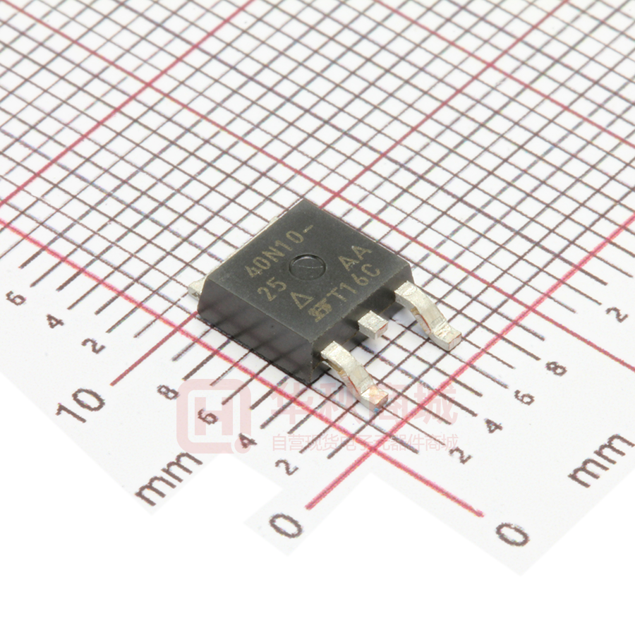

    表面贴装型 N 通道 100 V 40A(Tc) 3W(Ta),136W(Tc) TO-252AA
SUD40N10-25-E3 数据手册
SUD40N10-25 Vishay Siliconix N-Channel 100-V (D-S) 175 °C MOSFET FEATURES PRODUCT SUMMARY VDS (V) 100 RDS(on) (Ω) ID (A) 0.025 at VGS = 10 V 40 0.028 at VGS = 4.5 V 38 • TrenchFET® Power MOSFET • 175 °C Maximum Junction Temperature • 100 % Rg Tested Available RoHS* COMPLIANT TO-252 D G Drain Connected to Tab G D S Top View S Ordering Information: SUD40N10-25 SUD40N10-25-E3 (Lead (Pb)-free) N-Channel MOSFET ABSOLUTE MAXIMUM RATINGS TA = 25 °C, unless otherwise noted Parameter Symbol Limit Drain-Source Voltage VDS 100 Gate-Source Voltage VGS ± 20 Continuous Drain Current (TJ = 175 °C)b TC = 25 °C TC = 125 °C 23 70 Continuous Source Current (Diode Conduction) IS 40 Avalanche Current IAS 40 EAS 80 Single Pulse Avalanche Energy (Duty Cycle ≤ 1 %) Maximum Power Dissipation L = 0.1 mH TC = 25 °C TA = 25 °C A mJ 136b PD W 3a TJ, Tstg Operating Junction and Storage Temperature Range V 40 ID IDM Pulsed Drain Current Unit - 55 to 175 °C THERMAL RESISTANCE RATINGS Parameter Junction-to-Ambienta Symbol t ≤ 10 s Steady State Junction-to-Case RthJA RthJC Typical Maximum 15 18 40 50 0.85 1.1 Unit °C/W Notes: a. Surface Mounted on 1" x 1" FR4 board. b. See SOA curve for voltage derating. * Pb containing terminations are not RoHS compliant, exemptions may apply. Document Number: 71140 S-81732-Rev. E, 04-Aug-08 www.vishay.com 1 SUD40N10-25 Vishay Siliconix SPECIFICATIONS TJ = 25 °C, unless otherwise noted Parameter Symbol Test Conditions Min. Typ.a Max. Unit Static Drain-Source Breakdown Voltage Gate Threshold Voltage Gate-Body Leakage VDS VGS = 0 V, ID = 250 µA 100 VGS(th) VDS = VGS, ID = 250 µA 1.0 IGSS VDS = 0 V, VGS = ± 20 V ± 100 VDS = 100 V, VGS = 0 V 1 VDS = 100 V, VGS = 0 V, TJ = 125 °C 50 Zero Gate Voltage Drain Current IDSS On-State Drain Currentb ID(on) 3.0 VDS = 100 V, VGS = 0 V, TJ = 175 °C VDS = 5 V, VGS = 10 V Forward Transconductanceb RDS(on) µA A 0.02 0.025 VGS = 10 V, ID = 40 A, TJ = 125 °C 0.05 VGS = 10 V, ID = 40 A, TJ = 175 °C 0.063 VGS = 4.5 V, ID = 20 A 0.022 VDS = 15 V, ID = 40 A 70 gfs nA 250 70 VGS = 10 V, ID = 40 A Drain-Source On-State Resistanceb V Ω 0.028 S Dynamica Input Capacitance Ciss Output Capacitance Coss Reverse Transfer Capacitance Crss Total Gate Chargec Qg Gate-Source Chargec Qgs c Gate-Drain Charge 120 40 VDS = 50 V, VGS = 10 V, ID = 40 A 1 td(on) Rise Timec tr c td(off) Fall Timec 60 nC 11 9 Rg Turn-On Delay Timec pF 290 Qgd Gate Resistance Turn-Off Delay Time 2400 VGS = 0 V, VDS = 25 V, F = 1 MHz 3.5 8 VDD = 50 V, RL = 1.25 Ω ID ≅ 40 A, VGEN = 10 V, Rg = 2.5 Ω tf Ω 13 40 60 15 25 80 120 ns Source-Drain Diode Ratings and Characteristics TC = 25 °C ISM Pulsed Current Diode Forward Voltage b Source-Drain Reverse Recovery Time 70 A VSD IF = 40 A, VGS = 0 V 1.0 1.5 V trr IF = 40 A, dI/dt = 100 A/µs 75 120 ns Notes: a. Guaranteed by design, not subject to production testing. b. Pulse test; pulse width ≤ 300 µs, duty cycle ≤ 2 %. c. Independent of operating temperature. Stresses beyond those listed under “Absolute Maximum Ratings” may cause permanent damage to the device. These are stress ratings only, and functional operation of the device at these or any other conditions beyond those indicated in the operational sections of the specifications is not implied. Exposure to absolute maximum rating conditions for extended periods may affect device reliability. www.vishay.com 2 Document Number: 71140 S-81732-Rev. E, 04-Aug-08 SUD40N10-25 Vishay Siliconix TYPICAL CHARACTERISTICS 25 °C, unless otherwise noted 100 160 VGS = 10 thru 6 V 5V 80 I D - Drain Current (A) I D - Drain Current (A) 120 80 4V 60 TC = 125 °C 40 - 55 °C 25 °C 40 20 3V 0 0 0 2 4 6 8 0 10 1 2 3 4 5 VGS - Gate-to-Source Voltage (V) VDS - Drain-to-Source Voltage (V) Output Characteristics Transfer Characteristics 100 0.05 TC = - 55 °C 25 °C 60 R DS(on) - On-Resistance (Ω) gfs - Transconductance (S) 80 125 °C 40 20 0 0.04 0.03 VGS = 4.5 V 0.02 VGS = 10 V 0.01 0.00 0 10 20 30 40 50 60 0 20 40 ID - Drain Current (A) 80 100 I D - Drain Current (A) Transconductance On-Resistance vs. Drain Current 20 VGS - Gate-to-Source Voltage (V) 4000 3000 C - Capacitance (pF) 60 Ciss 2000 1000 Crss Coss VDS = 50 V ID = 40 A 16 12 8 4 0 0 0 20 40 60 80 VDS - Drain-to-Source Voltage (V) Capacitance Document Number: 71140 S-81732-Rev. E, 04-Aug-08 100 0 20 40 60 80 Q g - Total Gate Charge (nC) Gate Charge www.vishay.com 3 SUD40N10-25 Vishay Siliconix TYPICAL CHARACTERISTICS 25 °C, unless otherwise noted 100 3.0 VGS = 10 V ID = 40 A IS - Source Current (A) 2.0 (Normalized) R DS(on) - On-Resistance 2.5 1.5 1.0 TJ = 175 °C 10 TJ = 25 °C 0.5 0.0 - 50 - 25 0 25 50 75 100 125 150 1 175 0.3 0 0.6 0.9 1.2 TJ - Junction Temperature ( °C) VSD - Source-to-Drain Voltage (V) On-Resistance vs. Junction Temperature Source-Drain Diode Forward Voltage THERMAL RATINGS 100 50 10 µs Limited by R DS(on)* 100 µs I D - Drain Current (A) ID - Drain Current (A) 40 30 20 10 1 ms 10 ms 100 ms 1 s, DC 1 TC = 25 °C Single Pulse 10 0 0 25 50 75 100 125 150 175 0.1 0.1 TC - Case Temperature (°C) Maximum Avalanche Drain Current vs. Case Temperature 1 10 1000 100 VDS - Drain-to-Source Voltage (V) * VGS > minimum VGS at which RDS(on) is specified Safe Operating Area 2 Normalized Effective Transient Thermal Impedance 1 Duty Cycle = 0.5 0.2 0.1 0.1 0.02 0.05 Single Pulse 0.01 10-4 10-3 10-2 10-1 Square Wave Pulse Duration (s) 1 10 30 Normalized Thermal Transient Impedance, Junction-to-Case Vishay Siliconix maintains worldwide manufacturing capability. Products may be manufactured at one of several qualified locations. Reliability data for Silicon Technology and Package Reliability represent a composite of all qualified locations. For related documents such as package/tape drawings, part marking, and reliability data, see http://www.vishay.com/ppg?71140. www.vishay.com 4 Document Number: 71140 S-81732-Rev. E, 04-Aug-08 Package Information www.vishay.com Vishay Siliconix TO-252AA Case Outline E MILLIMETERS A C2 e b2 D1 e1 E1 L gage plane height (0.5 mm) L4 b L5 H D L3 b3 C A1 INCHES DIM. MIN. MAX. MIN. MAX. A 2.18 2.38 0.086 0.094 A1 - 0.127 - 0.005 b 0.64 0.88 0.025 0.035 b2 0.76 1.14 0.030 0.045 b3 4.95 5.46 0.195 0.215 0.024 C 0.46 0.61 0.018 C2 0.46 0.89 0.018 0.035 D 5.97 6.22 0.235 0.245 D1 4.10 - 0.161 - E 6.35 6.73 0.250 0.265 E1 4.32 - 0.170 - H 9.40 10.41 0.370 0.410 e 2.28 BSC e1 0.090 BSC 4.56 BSC 0.180 BSC L 1.40 1.78 0.055 0.070 L3 0.89 1.27 0.035 0.050 L4 - 1.02 - 0.040 L5 1.01 1.52 0.040 0.060 ECN: T16-0236-Rev. P, 16-May-16 DWG: 5347 Notes • Dimension L3 is for reference only. Revision: 16-May-16 Document Number: 71197 1 For technical questions, contact: pmostechsupport@vishay.com THIS DOCUMENT IS SUBJECT TO CHANGE WITHOUT NOTICE. THE PRODUCTS DESCRIBED HEREIN AND THIS DOCUMENT ARE SUBJECT TO SPECIFIC DISCLAIMERS, SET FORTH AT www.vishay.com/doc?91000 Application Note 826 Vishay Siliconix RECOMMENDED MINIMUM PADS FOR DPAK (TO-252) 0.224 0.243 0.087 (2.202) 0.090 (2.286) (10.668) 0.420 (6.180) (5.690) 0.180 0.055 (4.572) (1.397) Recommended Minimum Pads Dimensions in Inches/(mm) Return to Index Return to Index APPLICATION NOTE Document Number: 72594 Revision: 21-Jan-08 www.vishay.com 3 Legal Disclaimer Notice www.vishay.com Vishay Disclaimer  ALL PRODUCT, PRODUCT SPECIFICATIONS AND DATA ARE SUBJECT TO CHANGE WITHOUT NOTICE TO IMPROVE RELIABILITY, FUNCTION OR DESIGN OR OTHERWISE. Vishay Intertechnology, Inc., its affiliates, agents, and employees, and all persons acting on its or their behalf (collectively, “Vishay”), disclaim any and all liability for any errors, inaccuracies or incompleteness contained in any datasheet or in any other disclosure relating to any product. Vishay makes no warranty, representation or guarantee regarding the suitability of the products for any particular purpose or the continuing production of any product. To the maximum extent permitted by applicable law, Vishay disclaims (i) any and all liability arising out of the application or use of any product, (ii) any and all liability, including without limitation special, consequential or incidental damages, and (iii) any and all implied warranties, including warranties of fitness for particular purpose, non-infringement and merchantability. Statements regarding the suitability of products for certain types of applications are based on Vishay’s knowledge of typical requirements that are often placed on Vishay products in generic applications. Such statements are not binding statements about the suitability of products for a particular application. It is the customer’s responsibility to validate that a particular product with the properties described in the product specification is suitable for use in a particular application. Parameters provided in datasheets and / or specifications may vary in different applications and performance may vary over time. All operating parameters, including typical parameters, must be validated for each customer application by the customer’s technical experts. Product specifications do not expand or otherwise modify Vishay’s terms and conditions of purchase, including but not limited to the warranty expressed therein. Except as expressly indicated in writing, Vishay products are not designed for use in medical, life-saving, or life-sustaining applications or for any other application in which the failure of the Vishay product could result in personal injury or death. Customers using or selling Vishay products not expressly indicated for use in such applications do so at their own risk. Please contact authorized Vishay personnel to obtain written terms and conditions regarding products designed for such applications. No license, express or implied, by estoppel or otherwise, to any intellectual property rights is granted by this document or by any conduct of Vishay. Product names and markings noted herein may be trademarks of their respective owners. © 2017 VISHAY INTERTECHNOLOGY, INC. ALL RIGHTS RESERVED Revision: 08-Feb-17 1 Document Number: 91000
