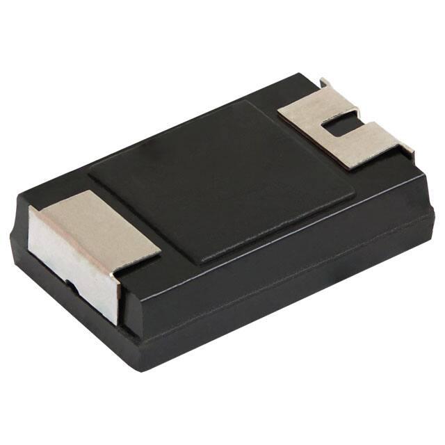

Upgrade for High Reliability With T56 T55 www.vishay.com Vishay Polytech vPolyTanTM Polymer Surface-Mount Chip Capacitors, Molded Case, High Performance Type FEATURES • Ultra low ESR • 100 % surge current tested • Accelerated voltage conditioning • High ripple current capability • Stable capacitance over operating temperature, voltage, and frequency range • No wear out effect • Molded case available in 9 case codes • Terminations: cases C, J, P: 100 % tin case A, T, B, Z, V, D: Ni / Pd / Au • Compatible with “high volume” automatic pick and place equipment LINKS TO ADDITIONAL RESOURCES • Moisture sensitivity level 3 3D 3D 3D Models Models • Material categorization: for definitions of compliance please see www.vishay.com/doc?99912 Calculators PERFORMANCE / ELECTRICAL CHARACTERISTICS APPLICATIONS Operating Temperature: -55 °C to +105 °C / +125 °C Capacitance Range: 3.3 μF to 1000 μF Capacitance Tolerance: ± 20 % Voltage Rating: 2.5 VDC to 63 VDC • Bulk energy storage in wireless cards • Decoupling, smoothing, filtering • Infrastructure equipment • Storage and networking • Computer motherboards • Smartphones and tablets ORDERING INFORMATION T55 A 156 M 6R3 C 0500 TYPE CASE CODE CAPACITANCE CAPACITANCE TOLERANCE DC VOLTAGE RATING TERMINATION / PACKAGING ESR See Ratings and Case Codes table This is expressed in picofarads. The first two digits are the significant figures. The third is the number of zeros to follow. M = ± 20 % 2R5 = 2.5 V 004 = 4 V 6R3 = 6.3 V 007 = 7 V 010 = 10 V 12R = 12.5 V 016 = 16 V 020 = 20 V 025 = 25 V 035 = 35 V 050 = 50 V 063 = 63 V C = lead (Pb)-free solderable coating, 7" reel Maximum 100 kHz ESR in mΩ Revision: 16-Aug-2023 Document Number: 40174 1 For technical questions, contact: polytech@vishay.com THIS DOCUMENT IS SUBJECT TO CHANGE WITHOUT NOTICE. THE PRODUCTS DESCRIBED HEREIN AND THIS DOCUMENT ARE SUBJECT TO SPECIFIC DISCLAIMERS, SET FORTH AT www.vishay.com/doc?91000 Upgrade for High Reliability With T56 T55 www.vishay.com Vishay Polytech DIMENSIONS in inches [millimeters] P case J case Anode indication belt mark L Anode indication belt mark L W W W W H H a l a l l l A, B case C, T case Anode indication belt mark Anode indication belt mark L L a W l a W l l H l H D, V, Z case H l l a W a L CASE CODE EIA SIZE L W H l a J 1608-09 0.063 ± 0.004 [1.6 ± 0.1] 0.031 ± 0.004 [0.8 ± 0.1] 0.031 ± 0.004 [0.8 ± 0.1] 0.012 ± 0.006 [0.3 ± 0.15] 0.024 ± 0.004 [0.6 ± 0.1] P 2012-12 0.080 ± 0.008 [2.0 ± 0.2] 0.049 ± 0.008 [1.25 ± 0.2] 0.047 max. [1.2 max.] 0.020 ± 0.008 [0.5 ± 0.2] 0.035 ± 0.004 [0.9 ± 0.1] A 3216-18 0.126 ± 0.008 [3.2 ± 0.2] 0.063 ± 0.008 [1.6 ± 0.2] 0.063 ± 0.008 [1.6 ± 0.2] 0.028 ± 0.012 [0.7 ± 0.3] 0.047 ± 0.008 [1.2 ± 0.2] T 3528-12 0.138 ± 0.008 [3.5 ± 0.2] 0.110 ± 0.008 [2.8 ± 0.2] 0.047 max. [1.2 max.] 0.030 ± 0.012 [0.8 ± 0.3] 0.087 ± 0.008 [2.2 ± 0.2] B 3528-21 0.138 ± 0.008 [3.5 ± 0.2] 0.110 ± 0.008 [2.8 ± 0.2] 0.075 ± 0.004 [1.9 ± 0.1] 0.030 ± 0.012 [0.8 ± 0.3] 0.087 ± 0.008 [2.2 ± 0.2] C 6032-28 0.228 ± 0.008 [5.8 ± 0.2] 0.126 ± 0.008 [3.2 ± 0.2] 0.100 ± 0.008 [2.5 ± 0.2] 0.051 ± 0.012 [1.3 ± 0.3] 0.087 ± 0.008 [2.2 ± 0.2] Z 7343-19 0.287 ± 0.008 [7.3 ± 0.2] 0.169 ± 0.012 [4.3 ± 0.3] 0.071 ± 0.004 [1.8 ± 0.1] 0.051 ± 0.012 [1.3 ± 0.3] 0.094 ± 0.008 [2.4 ± 0.2] V 7343-20 0.287 ± 0.008 [7.3 ± 0.2] 0.169 ± 0.012 [4.3 ± 0.3] 0.075 ± 0.004 [1.9 ± 0.1] 0.051 ± 0.012 [1.3 ± 0.3] 0.094 ± 0.008 [2.4 ± 0.2] D 7343-31 0.287 ± 0.008 [7.3 ± 0.2] 0.169 ± 0.012 [4.3 ± 0.3] 0.110 ± 0.012 [2.8 ± 0.3] 0.051 ± 0.012 [1.3 ± 0.3] 0.094 ± 0.008 [2.4 ± 0.2] Revision: 16-Aug-2023 Document Number: 40174 2 For technical questions, contact: polytech@vishay.com THIS DOCUMENT IS SUBJECT TO CHANGE WITHOUT NOTICE. THE PRODUCTS DESCRIBED HEREIN AND THIS DOCUMENT ARE SUBJECT TO SPECIFIC DISCLAIMERS, SET FORTH AT www.vishay.com/doc?91000 Upgrade for High Reliability With T56 T55 www.vishay.com Vishay Polytech RATINGS AND CASE CODES μF 1.0 2.2 3.3 4.7 6.8 2.5 V 4.0 V 6.3 V 10 J/P/A 15 22 33 47 68 P/A A/B A/B A/T/B A/T/B 100 150 220 330 470 680 1000 7.0 V 10 V J/P J/P/A P/A J/P P/A A P/A P/A A A A/T/B A A/T/B A A/T/B A/B T/B A/T/B/ A/T/B A/T/B Z/V/D B B/Z/V B/Z/V/D B/V B/Z/V/D B/Z/V/D B/Z/V/D Z/V/D V/D B/Z/V/D Z/D V/D D D D D 16 V 20 V 25 V B B 35 V 50 V B B B B B B B/D D B/V V V Z/V B/V V Z/V/D D D V Z/V/D D D D Z/V/D Z/V/D D D Z/V/D Z/V/D D D T 63 V B C/D B B B/V/D Z/V/D V A A/T/B A/T/B B V A 12.5 V D D MARKING T, B, Z, V, D, C case A case Simplified code of nominal capacitance (A7: 10 μF) Anode indication belt mark A7JA Simplified code of rated voltage (J: 6.3 (7) V) Date code + Type of series (N: T55) Revision: 16-Aug-2023 NA JS7 + Date code Simplified code of rated voltage (J: 6.3 V) VOLTAGE CODE V 2.5 4 6.3 (7) 10 12.5 16 20 25 35 50 63 Anode indication belt mark Simplified code of nominal capacitance (S7: 47 μF) CAPACITANCE CODE CODE e G J A B C D E V H J CAP, μF 1.0 1.5 2.2 3.3 4.7 6.8 10 15 22 33 47 68 100 150 220 330 470 680 1000 CODE A6 E6 J6 N6 S6 W6 A7 E7 J7 N7 S7 W7 A8 E8 J8 N8 S8 W8 A9 Document Number: 40174 3 For technical questions, contact: polytech@vishay.com THIS DOCUMENT IS SUBJECT TO CHANGE WITHOUT NOTICE. THE PRODUCTS DESCRIBED HEREIN AND THIS DOCUMENT ARE SUBJECT TO SPECIFIC DISCLAIMERS, SET FORTH AT www.vishay.com/doc?91000 Upgrade for High Reliability With T56 T55 www.vishay.com Vishay Polytech MARKING J, P case Anode indication belt mark Simplified code of nominal capacitance (S: 4.7 μF) SJ + Simplified code of rated voltage (J: 6.3 V) RATED VOLTAGE CAPACITANCE MARKING 4 10 AG 4 15 EG 6.3 3.3 NJ 6.3 4.7 SJ 6.3 6.8 WJ 6.3 10 AJ 10 3.3 NA 10 4.7 SA 10 10 AA DATE CODE MONTH YEAR 1 2 3 4 5 6 7 8 9 10 11 12 2017 A B C D E F G H J K L M 2018 N P Q R S T U V W X Y Z 2019 a b c d e f g h j k l m 2020 n p q r s t u v w x y z 2021 A B C D E F G H J K L M 2022 N P Q R S T U V W X Y Z 2023 a b c d e f g h j k l m 2024 n p q r s t u v w x y z Note • Marking code repeats every four years in alphabetical order (letter of I, i, O, and o are excluded) Revision: 16-Aug-2023 Document Number: 40174 4 For technical questions, contact: polytech@vishay.com THIS DOCUMENT IS SUBJECT TO CHANGE WITHOUT NOTICE. THE PRODUCTS DESCRIBED HEREIN AND THIS DOCUMENT ARE SUBJECT TO SPECIFIC DISCLAIMERS, SET FORTH AT www.vishay.com/doc?91000 Upgrade for High Reliability With T56 T55 www.vishay.com Vishay Polytech STANDARD RATINGS CAPACITANCE CASE (μF) CODE 22 22 33 33 47 47 68 68 68 100 100 100 100 100 150 150 220 220 220 220 220 220 220 220 220 330 330 330 330 330 330 330 330 330 330 330 330 330 470 470 470 470 470 470 470 470 470 470 470 470 680 680 680 1000 1000 1000 1000 A A A A A A A A B A A T B B B B B B B B B B V V V B B B B Z Z V V V V D D D B Z V V D D D D D D D D D D D D D D D PART NUMBER T55A226M2R5C0200 T55A226M2R5C0180 T55A336M2R5C0200 T55A336M2R5C0180 T55A476M2R5C0200 T55A476M2R5C0180 T55A686M2R5C0250 T55A686M2R5C0200 T55B686M2R5C0070 T55A107M2R5C0200 T55A107M2R5C0100 T55T107M2R5C0070 T55B107M2R5C0070 T55B107M2R5C0055 T55B157M2R5C0070 T55B157M2R5C0055 T55B227M2R5C0070 T55B227M2R5C0055 T55B227M2R5C0045 T55B227M2R5C0035 T55B227M2R5C0030 T55B227M2R5C0025 T55V227M2R5C0025 T55V227M2R5C0018 T55V227M2R5C0015 T55B337M2R5C0070 T55B337M2R5C0045 T55B337M2R5C0035 T55B337M2R5C0025 T55Z337M2R5C0025 T55Z337M2R5C0018 T55V337M2R5C0040 T55V337M2R5C0025 T55V337M2R5C0018 T55V337M2R5C0015 T55D337M2R5C0009 T55D337M2R5C0008 T55D337M2R5C0007 T55B477M2R5C0025 T55Z477M2R5C0025 T55V477M2R5C0025 T55V477M2R5C0012 T55D477M2R5C0050 T55D477M2R5C0040 T55D477M2R5C0025 T55D477M2R5C0015 T55D477M2R5C0012 T55D477M2R5C0009 T55D477M2R5C0008 T55D477M2R5C0007 T55D687M2R5C0009 T55D687M2R5C0008 T55D687M2R5C0007 T55D108M2R5C0009 T55D108M2R5C0008 T55D108M2R5C0007 T55D108M2R5C0006 MAX. DCL AT 25 °C (μA) MAX. DF AT 25 °C 120 Hz (%) MAX. MAX. ESR MAX. RIPPLE HIGH AT 45 °C OPERATING AT + 25 °C TEMPERATURE 100 kHz IRMS TEMPERATURE 100 kHz LOAD, TIME (°C) (mΩ) (h) (A) 2.5 VDC AT +105 °C, 1.7 VDC AT +125 °C 5.5 10 200 5.5 10 180 8.2 10 200 8.2 10 180 11.7 10 200 11.7 10 180 17.0 10 250 17.0 10 200 17.0 8 70 25.0 10 200 25.0 10 100 25.0 10 70 25.0 8 70 25.0 8 55 37.5 8 70 37.5 8 55 55.0 8 70 55.0 8 55 55.0 8 45 55.0 8 35 55.0 8 30 55.0 8 25 55.0 10 25 55.0 10 18 55.0 10 15 82.5 8 70 82.5 8 45 82.5 8 35 82.5 8 25 82.5 10 25 82.5 10 18 82.5 10 40 82.5 10 25 82.5 10 18 82.5 10 15 82.5 10 9 82.5 10 8 82.5 10 7 117.5 8 25 117.5 10 25 117.5 10 25 117.5 10 12 117.5 10 50 117.5 10 40 117.5 10 25 117.5 10 15 117.5 10 12 117.5 10 9 117.5 10 8 117.5 10 7 170.0 10 9 170.0 10 8 170.0 10 7 250.0 10 9 250.0 10 8 250.0 10 7 250.0 10 6 0.75 0.79 0.75 0.79 0.75 0.79 0.67 0.75 1.36 0.75 1.07 1.22 1.36 1.53 1.36 1.53 1.36 1.53 1.69 1.93 2.08 2.28 2.73 3.22 3.53 1.36 1.70 1.93 2.28 2.73 3.22 2.16 2.73 3.22 3.53 5.00 5.30 5.66 2.28 2.73 2.73 3.94 2.12 2.37 3.00 3.87 4.33 5.00 5.30 5.66 5.00 5.30 5.66 5.00 5.30 5.67 6.12 1000 1000 1000 1000 1000 1000 1000 1000 2000 1000 1000 1000 2000 2000 2000 2000 2000 2000 2000 2000 2000 2000 2000 2000 2000 2000 2000 2000 2000 2000 2000 2000 2000 2000 2000 2000 2000 2000 2000 2000 2000 2000 2000 2000 2000 2000 2000 2000 2000 2000 2000 2000 2000 2000 2000 2000 1000 105 105 105 105 105 105 105 105 125 105 105 105 125 125 105 105 105 105 105 105 105 105 125 125 125 105 105 105 105 105 105 125 125 125 125 125 125 125 105 105 105 105 125 125 125 125 125 125 125 125 125 125 125 105 105 105 105 Notes • Termination code “C”: cases C, J, P: 100 % tin, case A, T, B, Z, V, D: Ni / Pd / Au (1) High temperature load time is 2000h at +105 °C Revision: 16-Aug-2023 Document Number: 40174 5 For technical questions, contact: polytech@vishay.com THIS DOCUMENT IS SUBJECT TO CHANGE WITHOUT NOTICE. THE PRODUCTS DESCRIBED HEREIN AND THIS DOCUMENT ARE SUBJECT TO SPECIFIC DISCLAIMERS, SET FORTH AT www.vishay.com/doc?91000 Upgrade for High Reliability With T56 T55 www.vishay.com Vishay Polytech STANDARD RATINGS CAPACITANCE CASE (μF) CODE 10 10 10 10 10 10 15 15 15 15 15 22 22 22 22 22 33 33 33 33 47 47 47 47 47 47 47 47 68 68 68 68 68 68 68 68 68 100 100 100 100 100 100 100 100 100 150 150 150 150 150 150 150 150 150 J P P P A A P P A A A A A A B B A A A B A A A T T T B B A A A T T T T B B A A T T B B B B B B B B B B Z V V V PART NUMBER T55J106M004C0500 T55P106M004C0500 T55P106M004C0300 T55P106M004C0200 T55A106M004C0500 T55A106M004C0200 T55P156M004C0500 T55P156M004C0200 T55A156M004C0500 T55A156M004C0300 T55A156M004C0200 T55A226M004C0500 T55A226M004C0300 T55A226M004C0200 T55B226M004C0200 T55B226M004C0150 T55A336M004C0500 T55A336M004C0300 T55A336M004C0200 T55B336M004C0200 T55A476M004C0500 T55A476M004C0200 T55A476M004C0180 T55T476M004C0200 T55T476M004C0080 T55T476M004C0070 T55B476M004C0150 T55B476M004C0070 T55A686M004C0500 T55A686M004C0250 T55A686M004C0200 T55T686M004C0200 T55T686M004C0180 T55T686M004C0080 T55T686M004C0070 T55B686M004C0150 T55B686M004C0070 T55A107M004C0200 T55A107M004C0100 T55T107M004C0150 T55T107M004C0070 T55B107M004C0070 T55B107M004C0055 T55B107M004C0045 T55B107M004C0040 T55B107M004C0035 T55B157M004C0070 T55B157M004C0055 T55B157M004C0045 T55B157M004C0040 T55B157M004C0035 T55Z157M004C0025 T55V157M004C0045 T55V157M004C0025 T55V157M004C0015 MAX. DCL AT 25 °C (μA) MAX. DF AT 25 °C 120 Hz (%) MAX. MAX. ESR MAX. RIPPLE HIGH AT 45 °C OPERATING AT + 25 °C TEMPERATURE 100 kHz IRMS TEMPERATURE 100 kHz LOAD, TIME (°C) (mΩ) (h) (A) 4 VDC AT +105 °C, 2.7 VDC AT +125 °C 10.0 10 500 5.0 10 500 5.0 10 300 5.0 10 200 4.0 10 500 4.0 10 200 10.0 10 500 10.0 10 200 6.0 10 500 6.0 10 300 6.0 10 200 8.8 10 500 8.8 10 300 8.8 10 200 8.8 8 200 8.8 8 150 13.2 10 500 13.2 10 300 13.2 10 200 13.2 8 200 18.8 10 500 18.8 10 200 18.8 10 180 18.8 10 200 18.8 10 80 18.8 10 70 18.8 8 150 18.8 8 70 27.2 10 500 27.2 10 250 27.2 10 200 27.2 10 200 27.2 10 180 27.2 10 80 27.2 10 70 27.2 8 150 27.2 8 70 40.0 10 200 40.0 10 100 40.0 10 150 40.0 10 70 40.0 8 70 40.0 8 55 40.0 8 45 40.0 8 40 40.0 8 35 60.0 8 70 60.0 8 55 60.0 8 45 60.0 8 40 60.0 8 35 60.0 10 25 60.0 10 45 60.0 10 25 60.0 10 15 0.32 0.36 0.46 0.56 0.48 0.76 0.36 0.56 0.48 0.61 0.76 0.48 0.61 0.76 0.81 0.93 0.48 0.61 0.76 0.81 0.48 0.76 0.79 0.72 1.15 1.22 0.93 1.36 0.48 0.67 0.76 0.72 0.76 1.15 1.22 0.93 1.36 0.75 1.07 0.84 1.22 1.36 1.53 1.70 1.80 1.92 1.36 1.53 1.69 1.80 1.93 2.73 2.03 2.73 3.53 1000 1000 1000 1000 1000 1000 1000 1000 1000 1000 1000 1000 1000 1000 2000 2000 1000 1000 1000 2000 1000 1000 1000 1000 1000 1000 2000 2000 1000 1000 1000 1000 1000 1000 1000 2000 2000 1000 1000 1000 1000 2000 2000 2000 2000 2000 2000 2000 2000 2000 2000 2000 2000 2000 2000 105 105 105 105 105 105 105 105 105 105 105 105 105 105 125 125 105 105 105 125 105 105 105 105 105 105 125 125 105 105 105 105 105 105 105 125 125 105 105 105 105 125 125 125 125 125 105 105 105 105 105 105 125 125 125 Notes • Termination code “C”: cases C, J, P: 100 % tin, case A, T, B, Z, V, D: Ni / Pd / Au (1) High temperature load time is 2000h at +105 °C Revision: 16-Aug-2023 Document Number: 40174 6 For technical questions, contact: polytech@vishay.com THIS DOCUMENT IS SUBJECT TO CHANGE WITHOUT NOTICE. THE PRODUCTS DESCRIBED HEREIN AND THIS DOCUMENT ARE SUBJECT TO SPECIFIC DISCLAIMERS, SET FORTH AT www.vishay.com/doc?91000 Upgrade for High Reliability With T56 T55 www.vishay.com Vishay Polytech STANDARD RATINGS CAPACITANCE CASE (μF) CODE 220 220 220 220 220 220 220 220 220 220 220 220 220 220 220 220 220 330 330 330 330 330 330 330 330 330 330 330 330 330 330 330 470 470 470 470 470 470 470 470 470 470 470 470 680 680 680 680 680 680 680 B B B B B Z Z V V V V V V V D D D Z Z V V V V V V D D D D D D D Z Z D D D D D D D D D D D D D D D D D PART NUMBER T55B227M004C0070 T55B227M004C0060 T55B227M004C0055 T55B227M004C0045 T55B227M004C0035 T55Z227M004C0025 T55Z227M004C0018 T55V227M004C0055 T55V227M004C0045 T55V227M004C0040 T55V227M004C0035 T55V227M004C0025 T55V227M004C0018 T55V227M004C0015 T55D227M004C0055 T55D227M004C0040 T55D227M004C0025 T55Z337M004C0025 T55Z337M004C0018 T55V337M004C0050 T55V337M004C0045 T55V337M004C0040 T55V337M004C0025 T55V337M004C0018 T55V337M004C0015 T55D337M004C0050 T55D337M004C0040 T55D337M004C0025 T55D337M004C0015 T55D337M004C0009 T55D337M004C0008 T55D337M004C0007 T55Z477M004C0025 T55Z477M004C0018 T55D477M004C0055 T55D477M004C0050 T55D477M004C0040 T55D477M004C0025 T55D477M004C0018 T55D477M004C0015 T55D477M004C0012 T55D477M004C0009 T55D477M004C0008 T55D477M004C0007 T55D687M004C0025 T55D687M004C0018 T55D687M004C0015 T55D687M004C0009 T55D687M004C0008 T55D687M004C0007 T55D687M004C0006 MAX. DCL AT 25 °C (μA) MAX. DF AT 25 °C 120 Hz (%) MAX. MAX. ESR MAX. RIPPLE HIGH AT 45 °C OPERATING AT + 25 °C TEMPERATURE 100 kHz IRMS TEMPERATURE 100 kHz LOAD, TIME (°C) (mΩ) (h) (A) 4 VDC AT +105 °C, 2.7 VDC AT +125 °C 88.0 8 70 88.0 8 60 88.0 8 55 88.0 8 45 88.0 8 35 88.0 10 25 88.0 10 18 88.0 10 55 88.0 10 45 88.0 10 40 88.0 10 35 88.0 10 25 88.0 10 18 88.0 10 15 88.0 10 55 88.0 10 40 88.0 10 25 132.0 10 25 132.0 10 18 132.0 10 50 132.0 10 45 132.0 10 40 132.0 10 25 132.0 10 18 132.0 10 15 132.0 10 50 132.0 10 40 132.0 10 25 132.0 10 15 132.0 10 9 132.0 10 8 132.0 10 7 188.0 10 25 188.0 10 18 188.0 10 55 188.0 10 50 188.0 10 40 188.0 10 25 188.0 10 18 188.0 10 15 188.0 10 12 188.0 10 9 188.0 10 8 188.0 10 7 272.0 10 25 272.0 10 18 272.0 10 15 272.0 10 9 272.0 10 8 272.0 10 7 272.0 10 6 1.36 1.47 1.53 1.70 1.93 2.73 3.22 1.84 2.03 2.16 2.31 2.73 3.22 3.53 2.02 2.37 3.00 2.73 3.22 1.93 2.03 2.16 2.73 3.22 3.53 2.12 2.37 3.00 3.87 5.00 5.30 5.66 2.74 3.22 2.02 2.12 2.37 3.00 3.53 3.87 4.33 5.00 5.30 5.66 3.00 3.53 3.87 5.00 5.30 5.66 6.12 2000 2000 2000 2000 2000 2000 2000 2000 2000 2000 2000 2000 2000 2000 2000 2000 2000 2000 2000 2000 2000 2000 2000 2000 2000 2000 2000 2000 2000 2000 2000 2000 2000 2000 2000 2000 2000 2000 2000 2000 2000 2000 2000 2000 2000 2000 2000 2000 2000 2000 1000 105 105 105 105 105 105 105 125 125 125 125 125 125 125 125 125 125 105 105 105 105 105 105 105 105 125 125 125 125 125 125 125 105 105 125 125 125 125 125 125 125 125 125 125 105 105 105 105 105 105 105 Notes • Termination code “C”: cases C, J, P: 100 % tin, case A, T, B, Z, V, D: Ni / Pd / Au (1) High temperature load time is 2000h at +105 °C Revision: 16-Aug-2023 Document Number: 40174 7 For technical questions, contact: polytech@vishay.com THIS DOCUMENT IS SUBJECT TO CHANGE WITHOUT NOTICE. THE PRODUCTS DESCRIBED HEREIN AND THIS DOCUMENT ARE SUBJECT TO SPECIFIC DISCLAIMERS, SET FORTH AT www.vishay.com/doc?91000 Upgrade for High Reliability With T56 T55 www.vishay.com Vishay Polytech STANDARD RATINGS CAPACITANCE CASE (μF) CODE 3.3 3.3 4.7 4.7 4.7 6.8 6.8 10 10 10 10 10 15 15 15 22 22 22 22 22 22 33 33 33 33 33 33 33 33 33 33 33 47 47 47 47 47 47 47 47 47 47 47 47 47 47 47 68 68 68 68 68 100 100 100 100 100 J P J P A P A P P A A A A A A A A A T T B A A A T T T B B B B B A A A A A A T T T T T B B B B T T T B B A A A A A PART NUMBER T55J335M6R3C0500 T55P335M6R3C0500 T55J475M6R3C0500 T55P475M6R3C0500 T55A475M6R3C0500 T55P685M6R3C0500 T55A685M6R3C0500 T55P106M6R3C0500 T55P106M6R3C0200 T55A106M6R3C0500 T55A106M6R3C0300 T55A106M6R3C0200 T55A156M6R3C0500 T55A156M6R3C0300 T55A156M6R3C0200 T55A226M6R3C0500 T55A226M6R3C0300 T55A226M6R3C0200 T55T226M6R3C0150 T55T226M6R3C0070 T55B226M6R3C0150 T55A336M6R3C0500 T55A336M6R3C0200 T55A336M6R3C0180 T55T336M6R3C0200 T55T336M6R3C0150 T55T336M6R3C0070 T55B336M6R3C0200 T55B336M6R3C0150 T55B336M6R3C0080 T55B336M6R3C0070 T55B336M6R3C0040 T55A476M6R3C0500 T55A476M6R3C0200 T55A476M6R3C0180 T55A476M6R3C0150 T55A476M6R3C0100 T55A476M6R3C0070 T55T476M6R3C0200 T55T476M6R3C0120 T55T476M6R3C0080 T55T476M6R3C0070 T55T476M6R3C0050 T55B476M6R3C0150 T55B476M6R3C0070 T55B476M6R3C0060 T55B476M6R3C0040 T55T686M6R3C0200 T55T686M6R3C0150 T55T686M6R3C0070 T55B686M6R3C0150 T55B686M6R3C0070 T55A107M6R3C0200 T55A107M6R3C0150 T55A107M6R3C0100 T55A107M6R3C0070 T55A107M6R3C0045 MAX. DCL AT 25 °C (μA) MAX. DF AT 25 °C 120 Hz (%) MAX. MAX. ESR MAX. RIPPLE HIGH AT 45 °C OPERATING AT + 25 °C TEMPERATURE 100 kHz IRMS TEMPERATURE 100 kHz LOAD, TIME (°C) (mΩ) (h) (A) 6.3 VDC AT +105 °C, 4.2 VDC AT +125 °C 10.0 10 500 5.0 10 500 10.0 10 500 5.0 10 500 3.0 10 500 5.0 10 500 4.2 10 500 10.0 10 500 10.0 10 200 6.3 10 500 6.3 10 300 6.3 10 200 9.4 10 500 9.4 10 300 9.4 10 200 13.8 10 500 13.8 10 300 13.8 10 200 13.8 10 150 13.8 10 70 13.8 8 150 20.7 10 500 20.7 10 200 20.7 10 180 20.7 10 200 20.7 10 150 20.7 10 70 20.7 8 200 20.7 8 150 20.7 8 80 20.7 8 70 20.7 8 40 29.6 10 500 29.6 10 200 29.6 10 180 29.6 10 150 29.6 10 100 29.6 10 70 29.6 10 200 29.6 10 120 29.6 10 80 29.6 10 70 29.6 10 50 29.6 8 150 29.6 8 70 29.6 8 60 29.6 8 40 42.8 10 200 42.8 10 150 42.8 10 70 42.8 8 150 42.8 8 70 63.0 10 200 63.0 10 150 63.0 10 100 63.0 10 70 63.0 10 45 0.32 0.36 0.32 0.36 0.48 0.36 0.48 0.36 0.56 0.48 0.61 0.76 0.48 0.61 0.76 0.48 0.61 0.76 0.84 1.22 0.93 0.48 0.76 0.79 0.72 0.84 1.22 0.81 0.93 1.27 1.36 1.80 0.48 0.76 0.79 0.88 1.07 1.28 0.72 0.93 1.15 1.22 1.44 0.93 1.36 1.47 1.80 0.72 0.83 1.22 0.93 1.36 0.76 0.88 1.07 1.28 1.59 1000 1000 1000 1000 1000 1000 1000 1000 1000 1000 1000 1000 1000 1000 1000 1000 1000 2000 1000 1000 2000 1000 1000 1000 1000 1000 1000 2000 2000 2000 2000 2000 1000 1000 1000 1000 1000 1000 1000 1000 1000 1000 1000 2000 2000 2000 2000 1000 1000 1000 2000 2000 1000 1000 1000 1000 1000 105 105 105 105 105 105 105 105 105 105 105 105 105 105 105 105 105 105 105 105 125 105 105 105 105 105 105 125 125 125 125 125 105 105 105 105 105 105 105 105 105 105 105 125 125 125 125 105 105 105 105 105 105 105 105 105 105 Notes • Termination code “C”: cases C, J, P: 100 % tin, case A, T, B, Z, V, D: Ni / Pd / Au (1) High temperature load time is 2000h at +105 °C Revision: 16-Aug-2023 Document Number: 40174 8 For technical questions, contact: polytech@vishay.com THIS DOCUMENT IS SUBJECT TO CHANGE WITHOUT NOTICE. THE PRODUCTS DESCRIBED HEREIN AND THIS DOCUMENT ARE SUBJECT TO SPECIFIC DISCLAIMERS, SET FORTH AT www.vishay.com/doc?91000 Upgrade for High Reliability With T56 T55 www.vishay.com Vishay Polytech STANDARD RATINGS CAPACITANCE CASE (μF) CODE 100 100 100 100 100 100 100 100 100 100 100 150 150 150 150 150 150 150 150 150 150 150 150 150 150 150 150 150 220 220 220 220 220 220 220 220 220 220 220 220 220 220 220 220 220 220 220 220 220 220 330 330 330 330 330 330 T T B B B B B B Z V D B B B B B B B Z Z Z V V V V V V D B B B B B Z Z V V V V V V V D D D D D D D D V V V V V V PART NUMBER T55T107M6R3C0200 T55T107M6R3C0070 T55B107M6R3C0100 T55B107M6R3C0070 T55B107M6R3C0055 T55B107M6R3C0045 T55B107M6R3C0040 T55B107M6R3C0035 T55Z107M6R3C0045 T55V107M6R3C0045 T55D107M6R3C0015 T55B157M6R3C0100 T55B157M6R3C0070 T55B157M6R3C0055 T55B157M6R3C0045 T55B157M6R3C0040 T55B157M6R3C0035 T55B157M6R3C0025 T55Z157M6R3C0035 T55Z157M6R3C0025 T55Z157M6R3C0018 T55V157M6R3C0055 T55V157M6R3C0045 T55V157M6R3C0040 T55V157M6R3C0035 T55V157M6R3C0025 T55V157M6R3C0018 T55D157M6R3C0025 T55B227M6R3C0200 T55B227M6R3C0070 T55B227M6R3C0045 T55B227M6R3C0035 T55B227M6R3C0025 T55Z227M6R3C0025 T55Z227M6R3C0018 T55V227M6R3C0050 T55V227M6R3C0045 T55V227M6R3C0040 T55V227M6R3C0035 T55V227M6R3C0025 T55V227M6R3C0018 T55V227M6R3C0015 T55D227M6R3C0055 T55D227M6R3C0050 T55D227M6R3C0040 T55D227M6R3C0035 T55D227M6R3C0025 T55D227M6R3C0009 T55D227M6R3C0008 T55D227M6R3C0007 T55V337M6R3C0050 T55V337M6R3C0045 T55V337M6R3C0040 T55V337M6R3C0025 T55V337M6R3C0018 T55V337M6R3C0015 MAX. DCL AT 25 °C (μA) MAX. DF AT 25 °C 120 Hz (%) MAX. MAX. ESR MAX. RIPPLE HIGH AT 45 °C OPERATING AT + 25 °C TEMPERATURE 100 kHz IRMS TEMPERATURE 100 kHz LOAD, TIME (°C) (mΩ) (h) (A) 6.3 VDC AT +105 °C, 4.2 VDC AT +125 °C 63.0 10 200 63.0 10 70 63.0 8 100 63.0 8 70 63.0 8 55 63.0 8 45 63.0 8 40 63.0 8 35 63.0 10 45 63.0 10 45 63.0 10 15 94.5 8 100 94.5 8 70 94.5 8 55 94.5 8 45 94.5 8 40 94.5 8 35 94.5 8 25 94.5 10 35 94.5 10 25 94.5 10 18 94.5 10 55 94.5 10 45 94.5 10 40 94.5 10 35 94.5 10 25 94.5 10 18 94.5 10 25 138.6 8 200 138.6 8 70 138.6 8 45 138.6 8 35 138.6 8 25 138.6 10 25 138.6 10 18 138.6 10 50 138.6 10 45 138.6 10 40 138.6 10 35 138.6 10 25 138.6 10 18 138.6 10 15 138.6 10 55 138.6 10 50 138.6 10 40 138.6 10 35 138.6 10 25 138.6 10 9 138.6 10 8 138.6 10 7 207.9 10 50 207.9 10 45 207.9 10 40 207.9 10 25 207.9 10 18 207.9 10 15 0.72 1.22 1.14 1.36 1.53 1.70 1.80 1.93 2.03 2.03 3.87 1.14 1.36 1.53 1.70 1.80 1.93 2.28 2.31 2.73 3.22 1.84 2.03 2.16 2.31 2.73 3.22 3.00 0.80 1.36 1.69 1.93 2.28 2.73 3.22 1.93 2.03 2.16 2.31 2.73 3.22 3.53 2.02 2.12 2.37 2.53 3.00 5.00 5.30 5.66 1.93 2.03 2.16 2.73 3.22 3.53 1000 2000 2000 2000 2000 2000 2000 2000 2000 2000 2000 2000 2000 2000 2000 2000 2000 2000 2000 2000 2000 2000 2000 2000 2000 2000 2000 2000 2000 2000 2000 2000 2000 2000 2000 2000 2000 2000 2000 2000 2000 2000 2000 2000 2000 2000 2000 2000 2000 2000 2000 2000 2000 2000 2000 2000 105 105 105 105 105 105 105 105 105 125 125 105 105 105 105 105 105 105 105 105 105 125 125 125 125 125 125 125 105 105 105 105 105 105 105 125 125 125 125 125 125 125 125 125 125 125 125 125 125 125 105 105 105 105 105 105 Notes • Termination code “C”: cases C, J, P: 100 % tin, case A, T, B, Z, V, D: Ni / Pd / Au (1) High temperature load time is 2000h at +105 °C Revision: 16-Aug-2023 Document Number: 40174 9 For technical questions, contact: polytech@vishay.com THIS DOCUMENT IS SUBJECT TO CHANGE WITHOUT NOTICE. THE PRODUCTS DESCRIBED HEREIN AND THIS DOCUMENT ARE SUBJECT TO SPECIFIC DISCLAIMERS, SET FORTH AT www.vishay.com/doc?91000 Upgrade for High Reliability With T56 T55 www.vishay.com Vishay Polytech STANDARD RATINGS CAPACITANCE CASE (μF) CODE PART NUMBER 330 330 330 330 330 330 330 330 330 330 330 470 470 470 470 470 470 470 470 470 680 D D D D D D D D D D D V V D D D D D D D D T55D337M6R3C0055 T55D337M6R3C0050 T55D337M6R3C0045 T55D337M6R3C0040 T55D337M6R3C0025 T55D337M6R3C0018 T55D337M6R3C0015 T55D337M6R3C0012 T55D337M6R3C0009 T55D337M6R3C0008 T55D337M6R3C0007 T55V477M6R3C0055 T55V477M6R3C0050 T55D477M6R3C0030 T55D477M6R3C0025 T55D477M6R3C0018 T55D477M6R3C0015 T55D477M6R3C0009 T55D477M6R3C0008 T55D477M6R3C0007 T55D687M6R3C0025 100 470 A D T55A107M007C0070 T55D477M007C0025 3.3 3.3 4.7 4.7 4.7 4.7 4.7 6.8 6.8 6.8 10 10 10 10 15 15 22 22 22 22 22 22 22 22 22 22 33 33 33 33 J P P P A A A A A A P A A A A A A A A T T T B B B B A A A A T55J335M010C0500 T55P335M010C0500 T55P475M010C0500 T55P475M010C0200 T55A475M010C0500 T55A475M010C0300 T55A475M010C0200 T55A685M010C0500 T55A685M010C0300 T55A685M010C0200 T55P106M010C0200 T55A106M010C0500 T55A106M010C0300 T55A106M010C0200 T55A156M010C0500 T55A156M010C0200 T55A226M010C0500 T55A226M010C0200 T55A226M010C0080 T55T226M010C0200 T55T226M010C0150 T55T226M010C0070 T55B226M010C0300 T55B226M010C0200 T55B226M010C0150 T55B226M010C0070 T55A336M010C0500 T55A336M010C0200 T55A336M010C0150 T55A336M010C0070 MAX. DCL AT 25 °C (μA) MAX. DF AT 25 °C 120 Hz (%) MAX. MAX. ESR MAX. RIPPLE HIGH AT 45 °C OPERATING AT + 25 °C TEMPERATURE 100 kHz IRMS TEMPERATURE 100 kHz LOAD, TIME (°C) (mΩ) (h) (A) 6.3 VDC AT +105 °C, 4.2 VDC AT +125 °C 207.9 10 55 207.9 10 50 207.9 10 45 207.9 10 40 207.9 10 25 207.9 10 18 207.9 10 15 207.9 10 12 207.9 10 9 207.9 10 8 207.9 10 7 296.1 10 55 296.1 10 50 296.1 10 30 296.1 10 25 296.1 10 18 296.1 10 15 296.1 10 9 296.1 10 8 296.1 10 7 428.4 10 25 7 VDC AT +105 °C, 4.7 VDC AT +125 °C 70.0 10 70 329.0 10 25 10 VDC AT +105 °C, 6.7 VDC AT +125 °C 10.0 10 500 5.0 10 500 10.0 10 500 10.0 10 200 4.7 10 500 4.7 10 300 4.7 10 200 6.8 10 500 6.8 10 300 6.8 10 200 30.0 10 200 10.0 10 500 10.0 10 300 10.0 10 200 15.0 10 500 15.0 10 200 22.0 10 500 22.0 10 200 22.0 10 80 22.0 10 200 22.0 10 150 22.0 10 70 22.0 8 300 22.0 8 200 22.0 8 150 22.0 8 70 33.0 10 500 33.0 10 200 33.0 10 150 33.0 10 70 2.02 2.12 2.23 2.37 3.00 3.53 3.87 4.33 5.00 5.30 5.66 1.84 1.93 2.73 3.00 3.53 3.87 5.00 5.30 5.66 3.00 2000 2000 2000 2000 2000 2000 2000 2000 2000 2000 2000 2000 2000 2000 2000 2000 2000 2000 2000 2000 2000 125 125 125 125 125 125 125 125 125 125 125 105 105 105 105 105 105 105 105 105 105 1.28 3.00 1000 2000 105 105 0.32 0.36 0.36 0.56 0.48 0.61 0.76 0.48 0.61 0.76 0.56 0.48 0.61 0.76 0.48 0.76 0.48 0.76 1.19 0.72 0.84 1.22 0.66 0.81 0.93 1.36 0.48 0.76 0.88 1.28 1000 1000 1000 1000 1000 1000 1000 1000 1000 1000 2000 1000 1000 1000 1000 1000 1000 1000 1000 1000 1000 1000 1000 1000 1000 1000 1000 1000 1000 1000 105 105 105 105 105 105 105 105 105 105 105 105 105 105 105 105 105 105 105 105 105 105 125 125 125 125 105 105 105 105 Notes • Termination code “C”: cases C, J, P: 100 % tin, case A, T, B, Z, V, D: Ni / Pd / Au (1) High temperature load time is 2000h at +105 °C Revision: 16-Aug-2023 Document Number: 40174 10 For technical questions, contact: polytech@vishay.com THIS DOCUMENT IS SUBJECT TO CHANGE WITHOUT NOTICE. THE PRODUCTS DESCRIBED HEREIN AND THIS DOCUMENT ARE SUBJECT TO SPECIFIC DISCLAIMERS, SET FORTH AT www.vishay.com/doc?91000 Upgrade for High Reliability With T56 T55 www.vishay.com Vishay Polytech STANDARD RATINGS CAPACITANCE CASE (μF) CODE 33 33 33 33 33 33 33 33 33 47 47 68 68 100 100 100 100 100 100 100 100 100 150 150 150 150 150 150 150 150 150 220 220 220 220 220 220 220 220 220 220 220 220 220 220 220 330 330 330 330 330 330 330 T T T T T B B B B B B V V Z Z V D D D D D D Z Z V V V V V D D Z Z V V V V V D D D D D D D D D D D D D D D PART NUMBER MAX. DCL AT 25 °C (μA) MAX. DF AT 25 °C 120 Hz (%) MAX. MAX. ESR MAX. RIPPLE HIGH AT 45 °C OPERATING AT + 25 °C TEMPERATURE 100 kHz IRMS TEMPERATURE 100 kHz LOAD, TIME (°C) (mΩ) (h) (A) 10 VDC AT +105 °C, 6.7 VDC AT +125 °C 33.0 10 200 33.0 10 150 33.0 10 80 33.0 10 70 33.0 8 40 33.0 8 200 33.0 8 150 33.0 8 80 33.0 8 70 47.0 8 150 47.0 8 70 68.0 10 100 68.0 10 60 100.0 10 45 100.0 10 25 100.0 10 45 100.0 10 80 100.0 10 55 100.0 10 45 100.0 10 40 100.0 10 25 100.0 10 18 150.0 10 40 150.0 10 25 150.0 10 55 150.0 10 45 150.0 10 40 150.0 10 25 150.0 10 15 150.0 10 40 150.0 10 25 220.0 10 40 220.0 10 25 220.0 10 50 220.0 10 45 220.0 10 40 220.0 10 25 220.0 10 18 220.0 10 55 220.0 10 50 220.0 10 40 220.0 10 25 220.0 10 18 220.0 10 9 220.0 10 8 220.0 10 7 330.0 10 40 330.0 10 35 330.0 10 25 330.0 10 18 330.0 10 9 330.0 10 8 330.0 10 7 12.5 VDC AT +105 °C, 8.4 VDC AT +125 °C T55T156M12RC0080 18.7 8 80 T55T336M010C0200 T55T336M010C0150 T55T336M010C0080 T55T336M010C0070 T55T336M010C0040 T55B336M010C0200 T55B336M010C0150 T55B336M010C0080 T55B336M010C0070 T55B476M010C0150 T55B476M010C0070 T55V686M010C0100 T55V686M010C0060 T55Z107M010C0045 T55Z107M010C0025 T55V107M010C0045 T55D107M010C0080 T55D107M010C0055 T55D107M010C0045 T55D107M010C0040 T55D107M010C0025 T55D107M010C0018 T55Z157M010C0040 T55Z157M010C0025 T55V157M010C0055 T55V157M010C0045 T55V157M010C0040 T55V157M010C0025 T55V157M010C0015 T55D157M010C0040 T55D157M010C0025 T55Z227M010C0040 T55Z227M010C0025 T55V227M010C0050 T55V227M010C0045 T55V227M010C0040 T55V227M010C0025 T55V227M010C0018 T55D227M010C0055 T55D227M010C0050 T55D227M010C0040 T55D227M010C0025 T55D227M010C0018 T55D227M010C0009 T55D227M010C0008 T55D227M010C0007 T55D337M010C0040 T55D337M010C0035 T55D337M010C0025 T55D337M010C0018 T55D337M010C0009 T55D337M010C0008 T55D337M010C0007 15 T Notes • Termination code “C”: cases C, J, P: 100 % tin, case A, T, B, Z, V, D: Ni / Pd / Au (1) High temperature load time is 2000h at +105 °C Revision: 16-Aug-2023 0.72 0.84 1.14 1.22 1.62 0.81 0.93 1.27 1.36 0.93 1.36 1.36 1.76 2.03 2.73 2.03 1.67 2.02 2.23 2.37 3.00 3.53 2.16 2.73 1.84 2.03 2.16 2.73 3.53 2.37 3.00 2.16 2.73 1.93 2.03 2.16 2.73 3.22 2.02 2.12 2.37 3.00 3.53 5.00 5.30 5.66 2.37 2.53 3.00 3.53 5.00 5.30 5.66 1000 1000 1000 1000 2000 1000 1000 1000 1000 1000 1000 2000 2000 2000 2000 2000 2000 2000 2000 2000 2000 2000 2000 2000 2000 2000 2000 2000 2000 2000 2000 2000 2000 2000 2000 2000 2000 2000 2000 2000 2000 2000 2000 2000 2000 2000 2000 2000 2000 2000 2000 2000 2000 105 105 105 105 105 125 125 125 125 105 105 125 125 105 105 125 125 125 125 125 125 125 105 105 125 125 125 125 125 125 125 105 105 105 105 105 105 105 125 125 125 125 125 125 125 125 105 105 105 105 125 125 125 1.14 1000 105 Document Number: 40174 11 For technical questions, contact: polytech@vishay.com THIS DOCUMENT IS SUBJECT TO CHANGE WITHOUT NOTICE. THE PRODUCTS DESCRIBED HEREIN AND THIS DOCUMENT ARE SUBJECT TO SPECIFIC DISCLAIMERS, SET FORTH AT www.vishay.com/doc?91000 Upgrade for High Reliability With T56 T55 www.vishay.com Vishay Polytech STANDARD RATINGS CAPACITANCE CASE (μF) CODE PART NUMBER 6.8 10 10 15 15 22 22 33 33 33 47 47 47 47 47 68 68 100 100 100 150 150 150 B B B B B B B B V D Z V V D D V V Z V D D D D T55B685M016C0200 T55B106M016C0200 T55B106M016C0100 T55B156M016C0150 T55B156M016C0090 T55B226M016C0150 T55B226M016C0070 T55B336M016C0070 T55V336M016C0070 T55D336M016C0070 T55Z476M016C0045 T55V476M016C0070 T55V476M016C0045 T55D476M016C0070 T55D476M016C0065 T55V686M016C0070 T55V686M016C0050 T55Z107M016C0050 T55V107M016C0050 T55D107M016C0050 T55D157M016C0050 T55D157M016C0040 T55D157M016C0015 15 15 15 22 33 47 47 100 B B V V V Z V D T55B156M020C0090 T55B156M020C0070 T55V156M020C0125 T55V226M020C0040 T55V336M020C0040 T55Z476M020C0070 T55V476M020C0045 T55D107M020C0055 6.8 10 10 15 15 22 33 33 33 33 47 68 100 100 B B B B V V Z V V D D D D D T55B685M025C0100 T55B106M025C0150 T55B106M025C0100 T55B156M025C0100 T55V156M025C0125 T55V226M025C0040 T55Z336M025C0050 T55V336M025C0050 T55V336M025C0040 T55D336M025C0060 T55D476M025C0065 T55D686M025C0070 T55D107M025C0060 T55D107M025C0040 2.2 4.7 6.8 10 10 15 22 B B B B D V Z T55B225M035C0200 T55B475M035C0200 T55B685M035C0200 T55B106M035C0200 T55D106M035C0120 T55V156M035C0125 T55Z226M035C0070 MAX. DCL AT 25 °C (μA) MAX. DF AT 25 °C 120 Hz (%) MAX. MAX. ESR MAX. RIPPLE HIGH AT 45 °C OPERATING AT + 25 °C TEMPERATURE 100 kHz IRMS TEMPERATURE 100 kHz LOAD, TIME (°C) (mΩ) (h) (A) 16 VDC AT +105 °C, 10.7 VDC AT +125 °C 10.8 8 200 16.0 8 200 16.0 8 100 24.0 8 150 24.0 8 90 35.2 8 150 35.2 8 70 52.8 8 70 52.8 10 70 52.8 10 70 75.2 10 45 75.2 10 70 75.2 10 45 75.2 10 70 75.2 10 65 108.8 10 70 108.8 10 50 160.0 10 50 160.0 10 50 160.0 10 50 240.0 10 50 240.0 10 40 240.0 10 15 20 VDC AT +105 °C, 13.4 VDC AT +125 °C 30.0 8 90 30.0 8 70 30.0 10 125 44.0 10 40 66.0 10 40 94.0 10 70 94.0 10 45 200.0 10 55 25 VDC AT +105 °C, 16.8 VDC AT +125 °C 17.0 8 100 25.0 8 150 25.0 8 100 37.5 8 100 37.5 10 125 55.0 10 40 82.5 10 50 82.5 10 50 82.5 10 40 82.5 10 60 117.5 10 65 170.0 10 70 250.0 10 60 250.0 10 40 35 VDC AT +105 °C, 23.5 VDC AT +125 °C 7.7 8 200 16.4 8 200 23.8 8 200 35.0 8 200 35.0 10 120 52.5 10 125 77.0 10 70 0.80 0.80 1.14 0.93 1.20 0.93 1.36 1.36 1.63 1.79 2.03 1.63 2.03 1.79 1.86 1.63 1.934 1.93 1.93 2.12 2.12 2.37 3.87 2000 2000 2000 2000 2000 2000 2000 2000 2000 2000 2000 2000 2000 2000 2000 2000 2000 2000 2000 2000 2000 2000 2000 125 125 125 125 125 125 125 105 125 125 105 125 125 125 125 125 125 105 125 125 105 105 125 1.20 1.36 1.22 2.16 2.16 1.63 2.03 2.02 2000 2000 2000 2000 2000 2000 2000 2000 125 125 125 125 125 105 125 125 1.14 0.93 1.14 1.14 1.22 2.16 1.93 1.93 2.16 1.93 1.86 1.793 1.93 2.37 2000 2000 2000 1000 2000 2000 2000 2000 2000 2000 2000 2000 2000 2000 125 125 125 125 (1) 125 125 105 125 125 125 125 125 125 125 0.80 0.80 0.81 0.80 1.36 1.22 1.63 2000 2000 2000 2000 2000 2000 2000 105 105 105 105 125 125 105 Notes • Termination code “C”: cases C, J, P: 100 % tin, case A, T, B, Z, V, D: Ni / Pd / Au (1) High temperature load time is 2000h at +105 °C Revision: 16-Aug-2023 Document Number: 40174 12 For technical questions, contact: polytech@vishay.com THIS DOCUMENT IS SUBJECT TO CHANGE WITHOUT NOTICE. THE PRODUCTS DESCRIBED HEREIN AND THIS DOCUMENT ARE SUBJECT TO SPECIFIC DISCLAIMERS, SET FORTH AT www.vishay.com/doc?91000 Upgrade for High Reliability With T56 T55 www.vishay.com Vishay Polytech STANDARD RATINGS CAPACITANCE CASE (μF) CODE 22 22 33 33 47 47 V D D D D D T55V226M035C0070 T55D226M035C0120 T55D336M035C0100 T55D336M035C0065 T55D476M035C0070 T55D476M035C0055 2.2 10 10 15 B D D D T55B225M050C0200 T55D106M050C0120 T55D106M050C0090 T55D156M050C0090 1.0 4.7 4.7 10 10 B C D D D T55B105M063C0200 T55C475M063C0200 T55D475M063C0100 T55D106M063C0150 T55D106M063C0060 MAX. MAX. ESR MAX. RIPPLE HIGH AT 45 °C OPERATING AT + 25 °C TEMPERATURE 100 kHz IRMS TEMPERATURE 100 kHz LOAD, TIME (°C) (mΩ) (h) (A) MAX. DF AT 25 °C 120 Hz (%) MAX. DCL AT 25 °C (μA) PART NUMBER 35 VDC AT +105 °C, 23.5 VDC AT +125 °C 77.0 10 70 77.0 10 120 115.5 10 100 115.5 10 65 164.5 10 70 164.5 10 55 50 VDC AT +105 °C, 33.5 VDC AT +125 °C 11.0 8 200 50.0 10 120 50.0 10 90 75.0 10 90 63 VDC AT +105 °C, 42.2 VDC AT +125 °C 6.3 8 200 29.6 10 200 29.6 10 100 63.0 10 150 63.0 10 60 1.63 1.36 1.50 1.86 1.79 2.02 2000 2000 2000 2000 2000 2000 125 125 125 125 105 105 0.80 1.36 1.58 1.58 2000 2000 2000 2000 105 125 125 105 0.80 0.90 1.50 1.22 1.93 2000 1000 2000 2000 2000 105 105 125 105 105 Notes • Termination code “C”: cases C, J, P: 100 % tin, case A, T, B, Z, V, D: Ni / Pd / Au (1) High temperature load time is 2000h at +105 °C RECOMMENDED TEMPERATURE DERATING 100 10000 95 Rated voltage Recommended maximum application voltage VR ≤ 10 V 85 1000 80 1st line 2nd line 2nd line Rated Voltage (%) 90 Recommended maximum application voltage VR > 10 V 75 70 100 67 % 65 60 % 60 55 54 % 10 50 -55 25 45 85 105 125 Temperature (°C) RECOMMENDED VOLTAGE DERATING GUIDELINES CAPACITOR VOLTAGE RATING AT -55 °C TO +105 °C 2.5 4 6.3 7 10 12.5 16 20 25 35 50 63 Revision: 16-Aug-2023 CAPACITOR CATEGORY VOLTAGE AT +105 °C TO +125 °C 1.7 2.7 4.2 4.7 6.7 8.4 10.7 13.4 16.8 23.5 33.5 42.2 RECOMMENDED VOLTAGE DERATING AT -55 °C TO +105 °C 2.3 3.6 5.7 6.3 9 10 12.8 16 20 28 40 50 RECOMMENDED VOLTAGE DERATING AT +105 °C TO +125 °C 1.5 2.4 3.8 4.2 6.0 6.8 8.6 10.8 13.5 18.9 27.0 34 Document Number: 40174 13 For technical questions, contact: polytech@vishay.com THIS DOCUMENT IS SUBJECT TO CHANGE WITHOUT NOTICE. THE PRODUCTS DESCRIBED HEREIN AND THIS DOCUMENT ARE SUBJECT TO SPECIFIC DISCLAIMERS, SET FORTH AT www.vishay.com/doc?91000 Upgrade for High Reliability With T56 T55 www.vishay.com Vishay Polytech POWER DISSIPATION MAXIMUM PERMISSIBLE POWER DISSIPATION (W) AT ≤ +45 °C IN FREE AIR 0.050 0.064 0.115 0.105 0.130 0.165 0.187 0.187 0.225 CASE CODE J P A T B C Z V D STANDARD PACKAGING QUANTITY CASE CODE J P A T B C Z V D UNITS PER 7" REEL 4000 3000 2000 3000 2000 500 800 800 500 PERFORMANCE CHARACTERISTICS ITEM CONDITION Temperature Measure the specified characteristics characteristics in each stage POST TEST PERFORMANCE Specified initial value Capacitance change Dissipation factor shown in Standard 8 to 10 Ratings table or less Refer to Standard Leakage current Ratings table 105 °C, 1000 successive test cycles in series with a 1 kΩ resistor at the rate of 30 s ON, Capacitance change 30 s OFF; test voltage per table below: Surge voltage Rated 2.5 4.0 6.3 7.0 10 12.5 16 20 25 35 50 63 Dissipation factor voltage Surge 3.2 5.2 8.2 9.0 13 16.2 20 23 29 40 57 72 Leakage current voltage Capacitance change Reflow board surface peak temperature: Solder heat less than 260 °C Dissipation factor resistance Time: 5 s max. Leakage current Moisture resistance no load Leave at 60 °C and 90 % RH for 500 h 105 °C. The rated voltage is applied through a protective resistor of 3 Ω for 1000 h or 2000 h (1) 125 °C. 2/3 rated voltage is applied through a protective resistor of 3 Ω for 1000 h or 2000 h (1) Leave at -55 °C, normal temperature, 105 °C, and normal temperature for 30 min., 15 min. Thermal shock 30 min., and 15 min. Repeat this operation 5 times running. 105 °C. The rated voltage is applied through Failure rate a protective resistor of 1 Ω/V. High temperature load -55 °C +105 °C / +125 °C -30 % to 0 % 0 % to +50 % 14 - - Not more than 1 CV or 30 μA which is greater Within ± 20 % of initial value Within initial limit Shall not exceed 300 % of initial limit Within ± 20 % of initial value Initial specified value or less Shall not exceed 300 % of initial specified value Relative to the value before test VR ≤ 4 V +50 % to -20 % Capacitance change Relative to the value before test VR ≥ 6.3 V +40 % to -20 % Dissipation factor Initial specified value or less Leakage current Shall not exceed 300 % of initial specified value Capacitance change Within ± 20 % of initial value Dissipation factor Initial specified value or less Leakage current Capacitance change Dissipation factor Leakage current Shall not exceed 300 % of initial specified value Within ± 20 % of initial value or less Initial specified value or less Shall not exceed 300 % of initial specified value 1 % / 1000 h Notes • Test conditions per JIS C5101-1 (1) Test time and test temperature, please refer to table “Standard Ratings” Revision: 16-Aug-2023 Document Number: 40174 14 For technical questions, contact: polytech@vishay.com THIS DOCUMENT IS SUBJECT TO CHANGE WITHOUT NOTICE. THE PRODUCTS DESCRIBED HEREIN AND THIS DOCUMENT ARE SUBJECT TO SPECIFIC DISCLAIMERS, SET FORTH AT www.vishay.com/doc?91000 Polymer Guide www.vishay.com Vishay Guide for Tantalum Solid Electrolyte Chip Capacitors With Polymer Cathode INTRODUCTION Tantalum electrolytic capacitors are the preferred choice in applications where volumetric efficiency, stable electrical parameters, high reliability, and long service life are primary considerations. The stability and resistance to elevated temperatures of the tantalum/tantalum oxide/manganese dioxide system make solid tantalum capacitors an appropriate choice for today's surface mount assembly technology. Vishay Sprague has been a pioneer and leader in this field, producing a large variety of tantalum capacitor types for consumer, industrial, automotive, military, and aerospace electronic applications. Tantalum is not found in its pure state. Rather, it is commonly found in a number of oxide minerals, often in combination with Columbium ore. This combination is known as “tantalite” when its contents are more than one-half tantalum. Important sources of tantalite include Australia, Brazil, Canada, China, and several African countries. Synthetic tantalite concentrates produced from tin slags in Thailand, Malaysia, and Brazil are also a significant raw material for tantalum production. Electronic applications, and particularly capacitors, consume the largest share of world tantalum production. Other important applications for tantalum include cutting tools (tantalum carbide), high temperature super alloys, chemical processing equipment, medical implants, and military ordnance. Vishay Sprague is a major user of tantalum materials in the form of powder and wire for capacitor elements and rod and sheet for high temperature vacuum processing. THE BASICS OF TANTALUM CAPACITORS Most metals form crystalline oxides which are non-protecting, such as rust on iron or black oxide on copper. A few metals form dense, stable, tightly adhering, electrically insulating oxides. These are the so-called “valve”metals and include titanium, zirconium, niobium, tantalum, hafnium, and aluminum. Only a few of these permit the accurate control of oxide thickness by electrochemical means. Of these, the most valuable for the electronics industry are aluminum and tantalum. Capacitors are basic to all kinds of electrical equipment, from radios and television sets to missile controls and automobile ignitions. Their function is to store an electrical charge for later use. Capacitors consist of two conducting surfaces, usually metal plates, whose function is to conduct electricity. They are separated by an insulating material or dielectric. The dielectric used in all tantalum electrolytic capacitors is tantalum pentoxide. Tantalum pentoxide compound possesses high-dielectric strength and a high-dielectric constant. As capacitors are being manufactured, a film of tantalum pentoxide is applied to their electrodes by means of an electrolytic process. The film is applied in various thicknesses and at various voltages and although transparent to begin with, it takes on different colors as light refracts through it. This coloring occurs on the tantalum electrodes of all types of tantalum capacitors. Revision: 08-Sep-2022 Rating for rating, tantalum capacitors tend to have as much as three times better capacitance/volume efficiency than aluminum electrolytic capacitors. An approximation of the capacitance/volume efficiency of other types of capacitors may be inferred from the following table, which shows the dielectric constant ranges of the various materials used in each type. Note that tantalum pentoxide has a dielectric constant of 26, some three times greater than that of aluminum oxide. This, in addition to the fact that extremely thin films can be deposited during the electrolytic process mentioned earlier, makes the tantalum capacitor extremely efficient with respect to the number of microfarads available per unit volume. The capacitance of any capacitor is determined by the surface area of the two conducting plates, the distance between the plates, and the dielectric constant of the insulating material between the plates. COMPARISON OF CAPACITOR DIELECTRIC CONSTANTS DIELECTRIC Air or vacuum Paper Plastic Mineral oil Silicone oil Quartz Glass Porcelain Mica Aluminum oxide Tantalum pentoxide Ceramic e DIELECTRIC CONSTANT 1.0 2.0 to 6.0 2.1 to 6.0 2.2 to 2.3 2.7 to 2.8 3.8 to 4.4 4.8 to 8.0 5.1 to 5.9 5.4 to 8.7 8.4 26 12 to 400K In the tantalum electrolytic capacitor, the distance between the plates is very small since it is only the thickness of the tantalum pentoxide film. As the dielectric constant of the tantalum pentoxide is high, the capacitance of a tantalum capacitor is high if the area of the plates is large: C = eA ------t where C = capacitance e = dielectric constant A = surface area of the dielectric t = thickness of the dielectric Tantalum capacitors contain either liquid or solid electrolytes. In solid electrolyte capacitors, a dry material (manganese dioxide) forms the cathode plate. A tantalum lead is embedded in or welded to the pellet, which is in turn connected to a termination or lead wire. The drawings show the construction details of the surface mount types of tantalum capacitors shown in this catalog. Document Number: 40076 1 For technical questions, contact: polytech@vishay.com THIS DOCUMENT IS SUBJECT TO CHANGE WITHOUT NOTICE. THE PRODUCTS DESCRIBED HEREIN AND THIS DOCUMENT ARE SUBJECT TO SPECIFIC DISCLAIMERS, SET FORTH AT www.vishay.com/doc?91000 Polymer Guide www.vishay.com Vishay SOLID ELECTROLYTE POLYMER TANTALUM CAPACITORS Solid electrolyte polymer capacitors utilize sintered tantalum pellets as anodes. Tantalum pentoxide dielectric layer is formed on the entire surface of anode, which is further impregnated with highly conductive polymer as cathode system. The conductive polymer layer is then coated with graphite, followed by a layer of metallic silver, which provides a conductive surface between the capacitor element and the outer termination (lead frame or other). Molded chip polymer tantalum capacitor encases the element in plastic resins, such as epoxy materials. The molding compound has been selected to meet the requirements of UL 94 V-0 and outgassing requirements of ASTM E-595. After assembly, the capacitors are tested and inspected to assure long life and reliability. It offers excellent reliability and high stability for variety of applications in electronic devices. Usage of conductive polymer cathode system provides very low equivalent series resistance (ESR), which makes the capacitors particularly suitable for high frequency applications. TANTALUM CAPACITOR WITH POLYMER CATHODE TYPE T50 / T51 / T55 / T56 Epoxy encapsulation Silver adhesive Anode polarity bar Solderable cathode termination Polymer / carbon / silver coating Solderable anode termination Sintered tantalum pellet Lead frame welded to Ta wire TANTALUM CAPACITOR WITH POLYMER CATHODE TYPE T58 Rating / marking Encapsulation Side cathode termination (-) Anode polarity bar Silver adhesive epoxy Bottom cathode termination (-) Copper pad Side anode termination (+) Glass reinforced epoxy resin substrate Polymer / carbon / silver coating Conductive strip Sintered tantalum pellet Anode wire Revision: 08-Sep-2022 Bottom anode termination (+) Document Number: 40076 2 For technical questions, contact: polytech@vishay.com THIS DOCUMENT IS SUBJECT TO CHANGE WITHOUT NOTICE. THE PRODUCTS DESCRIBED HEREIN AND THIS DOCUMENT ARE SUBJECT TO SPECIFIC DISCLAIMERS, SET FORTH AT www.vishay.com/doc?91000 Polymer Guide www.vishay.com Vishay TANTALUM CAPACITOR WITH POLYMER CATHODE TYPE T52 T52 E5 case Encapsulation Side cathode termination (-) Polarity bar marking Silver adhesive epoxy Bottom cathode termination (-) Silver plated copper substrate Side anode termination (+) Sintered tantalum pellet Conductive strip Polymer / carbon / silver coating Bottom anode termination (+) T52 M1 case Encapsulation Polarity bar marking Side cathode termination (-) Silver adhesive epoxy Bottom cathode termination (-) Silver plated copper substrate Side anode termination (+) Sintered tantalum pellet Polymer / carbon / silver coating Bottom anode termination (+) TANTALUM CAPACITOR WITH POLYMER CATHODE TYPE T54 / T59 / 20021 Top / bottom cathode termination (-) Encapsulation Anode polarity marking Side cathode termination (-) Silver plated copper substrate Top / bottom anode termination (+) Silver adhesive epoxy Conductive strip Sintered tantalum pellet Side anode termination (+) Top / bottom cathode termination (-) Polymer / carbon / silver coating Top / bottom anode termination (+) Revision: 08-Sep-2022 Document Number: 40076 3 For technical questions, contact: polytech@vishay.com THIS DOCUMENT IS SUBJECT TO CHANGE WITHOUT NOTICE. THE PRODUCTS DESCRIBED HEREIN AND THIS DOCUMENT ARE SUBJECT TO SPECIFIC DISCLAIMERS, SET FORTH AT www.vishay.com/doc?91000 Polymer Guide www.vishay.com Vishay HERMETICALLY SEALED TANTALUM CAPACITOR WITH POLYMER CATHODE TYPE T27 Kapton sleeve Metal case Anode polarity marking Metal cover Cathode termination (-) Insulator Sintered tantalum pellet Polymer / carbon coating Silver coating Silver epoxy adhesive Anode wire Anode termination (+) Bushing [optional] Glass insulator POLYMER CAPACITORS - METAL CASE, HERMETICALLY SEALED SERIES T27 PRODUCT IMAGE TYPE FEATURES VPolyTanTM hermetically sealed polymer surface-mount chip capacitors, low ESR Hermetically sealed in metal case, low ESR / low DCL, hi-rel. processing TEMPERATURE RANGE -55 °C to +125 °C CAPACITANCE RANGE 15 μF to 470 μF VOLTAGE RANGE 16 V to 75 V CAPACITANCE TOLERANCE ± 20 % LEAKAGE CURRENT 0.05 CV DISSIPATION FACTOR ESR CASE SIZES TERMINATION FINISH Revision: 08-Sep-2022 12 % 25 mΩ to 100 mΩ D 100 % tin; tin / lead Document Number: 40076 4 For technical questions, contact: polytech@vishay.com THIS DOCUMENT IS SUBJECT TO CHANGE WITHOUT NOTICE. THE PRODUCTS DESCRIBED HEREIN AND THIS DOCUMENT ARE SUBJECT TO SPECIFIC DISCLAIMERS, SET FORTH AT www.vishay.com/doc?91000 Polymer Guide www.vishay.com Vishay POLYMER CAPACITORS - MOLDED CASE SERIES T50, T51, T55, T56 PRODUCT IMAGE VPolyTanTM, molded case, high performance polymer High performance -55 °C to +105 °C / +125 °C 3.3 μF to 1000 μF 2.5 V to 63 V ± 20 % 0.1 CV 8 % to 10 % 6 mΩ to 500 mΩ J, P, A, T, B, Z, V, D, C Cases J, P, C: 100 % tin Case A, T, B, Z, V, D: Ni / Pd / Au TYPE FEATURES TEMPERATURE RANGE CAPACITANCE RANGE VOLTAGE RANGE CAPACITANCE TOLERANCE LEAKAGE CURRENT DISSIPATION FACTOR ESR CASE SIZES TERMINATION FINISH POLYMER CAPACITORS - LEADFRAMELESS MOLDED CASE SERIES T52 T58 T59 T54 20021 vPolyTanTM polymer surface mount chip capacitors, low profile, leadframeless molded type vPolyTanTM polymer surface mount chip capacitors, compact, leadframeless molded type vPolyTanTM polymer surface mount chip capacitors, low ESR, leadframeless molded type Low profile Small case size Multianode TEMPERATURE RANGE -55 °C to +105 °C -55 °C to +105 °C -55 °C to +105 °C -55 °C to +125 °C -55 °C to +125 °C CAPACITANCE RANGE 47 μF to 1500 μF 1 μF to 330 μF 15 μF to 470 μF 15 μF to 470 μF (discrete capacitors) 30 μF to 2800 μF (stacked capacitors) 15 μF to 470 μF 10 V to 35 V 6.3 V to 35 V 16 V to 75 V 16 V to 75 V 16 V to 63 V ± 20 % ± 20 % ± 10 %, ± 20 % ± 20 % ± 20 % PRODUCT IMAGE TYPE FEATURES VOLTAGE RANGE CAPACITANCE TOLERANCE LEAKAGE CURRENT DISSIPATION FACTOR ESR CASE SIZES TERMINATION Revision: 08-Sep-2022 vPolyTanTM polymer surface mount chip capacitors, low ESR, leadframeless molded type, hi-rel commercial off-the-shelf (COTS) Hi-rel COTS, multianode vPolyTanTM polymer surface mount chip capacitors, low ESR, leadframeless molded type, DLA approved Multianode 0.1 CV 10 % 8 % to 14 % 25 mΩ to 55 mΩ 50 mΩ to 500 mΩ E5, M1, M9, B2 MM, W0, W9, A0, BB 100 % tin 12 % 12 % 25 mΩ to 150 mΩ 5 mΩ to 150 mΩ EE EE, E2, E3, E4, E6 100 % tin; tin / lead 10 % 25 mΩ to 150 mΩ EE Tin / lead Document Number: 40076 5 For technical questions, contact: polytech@vishay.com THIS DOCUMENT IS SUBJECT TO CHANGE WITHOUT NOTICE. THE PRODUCTS DESCRIBED HEREIN AND THIS DOCUMENT ARE SUBJECT TO SPECIFIC DISCLAIMERS, SET FORTH AT www.vishay.com/doc?91000 Polymer Guide www.vishay.com Vishay MOLDED CAPACITORS, T50 / T51 / T55 / T56 TYPES PLASTIC TAPE AND REEL PACKAGING DIMENSIONS in millimeters E A B C Label D W TAPE WIDTH A+0/-3 B+1/0 C ± 0.2 D ± 0.5 E ± 0.5 W ± 0.3 8 12 Ø 180 Ø 60 Ø 13 Ø 21 2.0 9.0 13.0 Note • A reel diameter of 330 mm is also applicable PLASTIC TAPE SIZE DIMENSIONS in millimeters Pocket Perforation E Ø 1.5 + 0.10 W B F A P1 t Direction of tape flow 4.0 ± 0.1 2.0 ± 0.1 Inserting direction Perforation Marking side (upper) Mounting terminal side (lower) Symbol: R CASE CODE J P A T B C Z V D A ± 0.2 1.0 1.4 1.9 3.1 3.1 3.7 4.8 4.8 4.8 B ± 0.2 1.8 2.2 3.5 3.8 3.8 6.3 7.7 7.7 7.7 W ± 0.3 8.0 8.0 8.0 8.0 8.0 12.0 12.0 12.0 12.0 F ± 0.1 3.5 3.5 3.5 3.5 3.5 5.5 5.5 5.5 5.5 E ± 0.1 1.75 1.75 1.75 1.75 1.75 1.75 1.75 1.75 1.75 P1 ± 0.1 4.0 4.0 4.0 4.0 4.0 8.0 8.0 8.0 8.0 tmax. 1.3 1.6 2.5 1.7 2.5 3.1 2.6 2.6 3.4 Note • A reel diameter of 330 mm is also applicable Revision: 08-Sep-2022 Document Number: 40076 6 For technical questions, contact: polytech@vishay.com THIS DOCUMENT IS SUBJECT TO CHANGE WITHOUT NOTICE. THE PRODUCTS DESCRIBED HEREIN AND THIS DOCUMENT ARE SUBJECT TO SPECIFIC DISCLAIMERS, SET FORTH AT www.vishay.com/doc?91000 Polymer Guide www.vishay.com Vishay LEADFRAMELESS MOLDED CAPACITORS, ALL TYPES PLASTIC TAPE AND REEL PACKAGING in inches [millimeters] 0.157 ± 0.004 [4.0 ± 0.10] Tape thickness Deformation between embossments 0.014 [0.35] max. 0.059 + 0.004 - 0.0 [1.5 + 0.10 - 0.0] Top cover tape A0 K0 B1 (max.) (6) 10 pitches cumulative tolerance on tape ± 0.008 [0.200] Embossment 0.079 ± 0.002 0.069 ± 0.004 [2.0 ± 0.05] [1.75 ± 0.10] 0.030 [0.75] min. (3) B0 0.030 [0.75] min. (4) Top cover tape For tape feeder 0.004 [0.10] max. reference only including draft. Concentric around B0 (5) F W 20° Maximum component rotation (Side or front sectional view) Center lines of cavity P1 D1 (min.) for components (5) . 0.079 x 0.047 [2.0 x 1.2] and larger USER DIRECTION OF FEED Maximum cavity size (1) Cathode (-) Anode (+) DIRECTION OF FEED 20° maximum component rotation Typical component cavity center line B0 A0 (Top view) Typical component center line 3.937 [100.0] 0.039 [1.0] max. Tape 0.039 [1.0] max. 0.9843 [250.0] Camber (Top view) Allowable camber to be 0.039/3.937 [1/100] Non-cumulative over 9.843 [250.0] Tape and Reel Specifications: all case sizes are available on plastic embossed tape per EIA-481. Standard reel diameter is 7" [178 mm]. Notes • Metric dimensions will govern. Dimensions in inches are rounded and for reference only (1) A , B , K , are determined by the maximum dimensions to the ends of the terminals extending from the component body and / or the body 0 0 0 dimensions of the component. The clearance between the ends of the terminals or body of the component to the sides and depth of the cavity (A0, B0, K0) must be within 0.002" (0.05 mm) minimum and 0.020" (0.50 mm) maximum. The clearance allowed must also prevent rotation of the component within the cavity of not more than 20° (2) Tape with components shall pass around radius “R” without damage. The minimum trailer length may require additional length to provide “R” minimum for 12 mm embossed tape for reels with hub diameters approaching N minimum (3) This dimension is the flat area from the edge of the sprocket hole to either outward deformation of the carrier tape between the embossed cavities or to the edge of the cavity whichever is less (4) This dimension is the flat area from the edge of the carrier tape opposite the sprocket holes to either the outward deformation of the carrier tape between the embossed cavity or to the edge of the cavity whichever is less (5) The embossed hole location shall be measured from the sprocket hole controlling the location of the embossment. Dimensions of embossment location shall be applied independent of each other (6) B dimension is a reference dimension tape feeder clearance only 1 Revision: 08-Sep-2022 Document Number: 40076 7 For technical questions, contact: polytech@vishay.com THIS DOCUMENT IS SUBJECT TO CHANGE WITHOUT NOTICE. THE PRODUCTS DESCRIBED HEREIN AND THIS DOCUMENT ARE SUBJECT TO SPECIFIC DISCLAIMERS, SET FORTH AT www.vishay.com/doc?91000 Polymer Guide www.vishay.com Vishay CARRIER TAPE DIMENSIONS in inches [millimeters] CASE CODE TAPE SIZE B1 (MAX.) (1) D1 (MIN.) F K0 (MAX.) P1 P2 0.315 ± 0.004 0.079 ± 0.002 [8.0 ± 0.10] [2.00 ± 0.05] W E5 12 mm 0.329 [8.35] 0.059 [1.5] 0.217 ± 0.002 [5.50 ± 0.05] 0.071 [1.8] MM (2) 8 mm 0.075 [1.91] 0.02 [0.5] 0.138 [3.5] 0.043 [1.10] M1, M9 12 mm 0.32 [8.2] 0.059 [1.5] W9 8 mm 0.126 [3.20] 0.030 [0.75] 0.138 [3.5] 0.045 [1.15] 0.157 [4.0] 0.079 ± 0.002 [2.00 ± 0.05] 0.315 [8.0] W0 8 mm 0.126 [3.20] 0.030 [0.75] 0.138 [3.5] 0.045 [1.15] 0.157 [4.0] 0.079 ± 0.002 [2.00 ± 0.05] 0.315 [8.0] A0 8 mm - 0.02 [0.5] 0.138 [3.5] 0.049 [1.25] 0.157 [4.0] 0.079 ± 0.002 [2.00 ± 0.05] 0.315 [8.0] BB 8 mm 0.157 [4.0] 0.039 [1.0] 0.138 [3.5] 0.087 [2.22] 0.157 [4.0] 0.079 ± 0.002 [2.00 ± 0.05] 0.315 [8.0] EE 12 mm 0.32 [8.2] 0.059 [1.5] B2 8 mm 0.157 [4.0] 0.039 [1.0] D (3) 16 mm 0.321 [8.16] 0.059 [1.5] 0.157 [4.0] 0.315 ± 0.04 [8.0 ± 1.0] 0.217 ± 0.002 0.094 [2.39] [5.5 ± 0.05] 0.217 ± 0.002 0.175 [4.44] [5.5 ± 0.05] 0.138 [3.5] 0.315 ± 0.04 [8.0 ±1.0] 0.057 [1.45] 0.157 [4.0] 0.476 ± 0.008 [12.1 ± 0.20] 0.079 ± 0.002 [2.00 ± 0.05] 0.315 [8.0] 0.079 ± 0.002 0.472 + 0.012 / - 0.004 [2.00 ± 0.05] [12.0 + 0.3 / - 0.10] 0.079 ± 0.002 0.472 + 0.012 / - 0.004 [2.00 ± 0.05] [12.0 + 0.3 / - 0.10] 0.079 ± 0.002 [2.00 ± 0.05] 0.295 ± 0.004 0.472 ± 0.004 0.079 ± 0.004 0.308 [7.83] [12.00 ± 0.1] [2.00 ± 0.1] [7.50 ± 0.1] 0.315 [8.0] 0.630 ± 0.012 [16.00 ± 0.3] Notes (1) For reference only (2) Standard packaging of MM case is with paper tape. Plastic tape is available per request (3) Tape thickness 0.018 [0.45] max. PAPER TAPE AND REEL PACKAGING DIMENSIONS in inches [millimeters] T Ø D0 P2 P0 [10 pitches cumulative tolerance on tape ± 0.2 mm] E1 A0 Bottom cover tape F W B0 E2 Top cover tape P1 Cavity center lines Anode Cavity size (1) Bottom cover tape G USER FEED DIRECTION CASE TAPE SIZE SIZE A0 B0 D0 P0 P1 P2 E F W T MM 8 mm 0.041 ± 0.002 0.071 ± 0.002 0.06 ± 0.004 0.157 ± 0.004 0.157 ± 0.004 0.079 ± 0.002 0.069 ± 0.004 0.0138 ± 0.002 0.315 ± 0.008 0.037 ± 0.002 [1.05 ± 0.05] [1.8 ± 0.05] [1.5 ± 0.1] [4.0 ± 0.1] [4.0 ± 0.1] [2.0 ± 0.05] [1.75 ± 0.1] [3.5 ± 0.05] [8.0 ± 0.2] [0.95 ± 0.05] M0 8 mm 0.049 ± 0.002 0.081 ± 0.002 0.06 ± 0.004 0.157 ± 0.004 0.157 ± 0.004 0.079 ± 0.002 0.069 ± 0.004 0.0138 ± 0.002 0.315 ± 0.008 0.041 ± 0.002 [1.25 ± 0.05] [2.05 ± 0.05] [1.5 ± 0.1] [4.0 ± 0.1] [4.0 ± 0.1] [2.0 ± 0.05] [1.75 ± 0.1] [3.5 ± 0.05] [8.0 ± 0.2] [1.05 ± 0.05] Note (1) A , B are determined by the maximum dimensions to the ends of the terminals extending from the component body and / or the body 0 0 dimensions of the component. The clearance between the ends of the terminals or body of the component to the sides and depth of the cavity (A0, B0) must be within 0.002" (0.05 mm) minimum and 0.020" (0.50 mm) maximum. The clearance allowed must also prevent rotation of the component within the cavity of not more than 20° Revision: 08-Sep-2022 Document Number: 40076 8 For technical questions, contact: polytech@vishay.com THIS DOCUMENT IS SUBJECT TO CHANGE WITHOUT NOTICE. THE PRODUCTS DESCRIBED HEREIN AND THIS DOCUMENT ARE SUBJECT TO SPECIFIC DISCLAIMERS, SET FORTH AT www.vishay.com/doc?91000 Polymer Guide www.vishay.com Vishay PACKING AND STORAGE Polymer capacitors meet moisture sensitivity level rating (MSL) of 3 or 4 as specified in IPC/JEDEC® J-STD-020 and are dry packaged in moisture barrier bags (MBB) per J-STD-033. MSL for each particular family is defined in the datasheet - either in “Features” section or “Standard Ratings” table. Level 3 specifies a floor life (out of bag) of 168 hours and level 4 specifies a floor life of 72 hours at 30 °C maximum and 60 % relative humidity (RH). Unused capacitors should be re-sealed in the MBB with fresh desiccant. A moisture strip (humidity indicator card) is included in the bag to assure dryness. To remove excess moisture, capacitors can be dried at 40 °C (standard “dry box” conditions). For detailed recommendations please refer to J-STD-033. RECOMMENDED REFLOW PROFILES Vishay recommends no more than 3 cycles of reflow in accordance with J-STD-020. TP tp Max. ramp up rate = 3 °C/s Max. ramp down rate = 6 °C/s TL Temperature TSmax. tL Preheat area TSmin. tS 25 Time 25 °C to peak Time PROFILE FEATURE PREHEAT AND SOAK Temperature min. (TSmin.) Temperature max. (TSmax.) Time (tS) from (TSmin. to TSmax.) RAMP UP Ramp-up rate (TL to Tp) Liquidus temperature (TL) Time (tL) maintained above TL Peak package body temperature (Tp) max. Time (tp) within 5 °C of the peak max. temperature RAMP DOWN Ramp-down rate (Tp to TL) Time from 25 °C to peak temperature SnPb EUTECTIC ASSEMBLY LEAD (Pb)-FREE ASSEMBLY 100 °C 150 °C 60 s to 120 s 150 °C 200 °C 60 s to 120 s 3 °C/s maximum 183 °C 217 °C 60 s to 150 s Depends on type and case - see table below 20 s 5 s (1) 6 °C/s maximum 6 min maximum 8 min maximum Note (1) For T27, lead (Pb)-free capacitors t = 30 s p PEAK PACKAGE BODY TEMPERATURE (Tp) MAXIMUM TYPE CASE CODE T27 T55 T52 T58 T50 T51 T56 T59 T54 20021 D J, P, A, T, B, C, Z, V, D E5, M1, M9, B2 MM, W9, W0, A0, BB D D, V B, D, V EE 3E, 6E, EE, E2, E3, E4, E6 EE PEAK PACKAGE BODY TEMPERATURE (TP) MAX. SnPb EUTECTIC ASSEMBLY LEAD (Pb)-FREE ASSEMBLY 220 °C 245 °C 260 °C 260 °C 260 °C n/a 260 °C 260 °C 250 °C 220 °C 250 °C 220 °C 250 °C 220 °C n/a Notes • T50, T51, T52, T55, T56, and T58 capacitors are process sensitive. PSL classification to JEDEC J-STD-075: R4G • T54 and T59 capacitors with 100 % tin termination are process sensitive. PSL classification to JEDEC J-STD-075: R6G Revision: 08-Sep-2022 Document Number: 40076 9 For technical questions, contact: polytech@vishay.com THIS DOCUMENT IS SUBJECT TO CHANGE WITHOUT NOTICE. THE PRODUCTS DESCRIBED HEREIN AND THIS DOCUMENT ARE SUBJECT TO SPECIFIC DISCLAIMERS, SET FORTH AT www.vishay.com/doc?91000 Polymer Guide www.vishay.com Vishay MOLDED CAPACITORS, T50 / T51 / T55 / T56 TYPES PAD DIMENSIONS in millimeters L Capacitor Pattern Y CASE / DIMENSIONS J P A T/B C Z/V/D CAPACITOR SIZE L W 1.6 0.8 2.0 1.25 3.2 1.6 3.5 2.8 5.8 3.2 7.3 4.3 X W G Z G (max.) 0.7 0.5 1.1 1.4 2.9 4.1 PAD DIMENSIONS Z (min.) X (min.) 2.5 1.0 2.6 1.2 3.8 1.5 4.1 2.7 6.9 2.7 8.2 2.9 Y (Ref.) 0.9 1.05 1.35 1.35 2.0 2.05 LEADFRAMELESS MOLDED CAPACITORS T52 / T58 PAD DIMENSIONS in inches [millimeters] D B C Pads A Capacitor body FAMILY T52 T58 CASE CODE E5 M1, M9 B2 MM W0, W9 A0 BB A (NOM.) 0.094 [2.40] 0.178 [4.52] 0.081 [2.06] 0.024 [0.61] 0.035 [0.89] 0.047 [1.19] 0.094 [2.39] B (MIN.) 0.077 [1.95] 0.098 [2.48] 0.057 [1.44] 0.027 [0.70] 0.029 [0.74] 0.042 [1.06] 0.044 [1.11] C (NOM.) 0.180 [4.57] 0.138 [3.50] 0.070 [1.77] 0.025 [0.64] 0.041 [1.05] 0.065 [1.65] 0.072 [1.82] D (MIN.) 0.333 [8.46] 0.333 [8.46] 0.183 [4.64] 0.080 [2.03] 0.099 [2.52] 0.148 [3.76] 0.159 [4.03] LEADFRAMELESS MOLDED CAPACITORS T59 / T54 / 20021 PAD DIMENSIONS in inches [millimeters] B D C Pads A Capacitor body FAMILY T59 / T54 T54 20021 Revision: 08-Sep-2022 CASE CODE EE E2 / E3 E4 / E6 3E 6E EE A (NOM.) 0.209 [5.30] 0.128 [3.24] 0.301 [7.64] 0.482 [12.24] 0.482 [12.24] 0.209 [5.30] B (MIN.) 0.098 [2.50] 0.120 [3.04] 0.120 [3.04] 0.120 [3.04] 0.120 [3.04] 0.098 [2.50] C (NOM.) 0.169 [4.30] 0.154 [3.92] 0.154 [3.92] 0.154 [3.92] 0.154 [3.92] 0.169 [4.30] D (MIN.) 0.366 [9.30] 0.394 [10.0] 0.394 [10.0] 0.394 [10.0] 0.394 [10.0] 0.366 [9.30] Document Number: 40076 10 For technical questions, contact: polytech@vishay.com THIS DOCUMENT IS SUBJECT TO CHANGE WITHOUT NOTICE. THE PRODUCTS DESCRIBED HEREIN AND THIS DOCUMENT ARE SUBJECT TO SPECIFIC DISCLAIMERS, SET FORTH AT www.vishay.com/doc?91000 Polymer Guide www.vishay.com Vishay HERMETICALLY SEALED CAPACITOR T27 TYPE PAD DIMENSIONS in inches [millimeters] D C B A CASE CODE A (MIN.) B (NOM.) C (NOM.) D (NOM.) D 0.295 [7.50] 0.138 [3.50] 0.100 [2.50] 0.374 [9.50] GUIDE TO APPLICATION 1. AC Ripple Current: the maximum allowable ripple current shall be determined from the formula: I R MS = 3. P -----------R ESR where, P= power dissipation in W at +45 °C as given in the tables in the product datasheets. 2. MAXIMUM RIPPLE CURRENT TEMPERATURE DERATING FACTOR RESR = the capacitor equivalent series resistance at the specified frequency. ≤ 45 °C 1.0 55 °C 0.8 AC Ripple Voltage: the maximum allowable ripple voltage shall be determined from the formula: 85 °C 0.6 P V R MS = Z -----------R ESR or, from the formula: Mounting Precautions: 5.1 Soldering: capacitors can be attached by conventional soldering techniques; vapor phase, convection reflow, infrared reflow, wave soldering, and hot plate methods. The soldering profile charts show recommended time / temperature conditions for soldering. Preheating is recommended. The recommended maximum ramp rate is 3 °C per second. Attachment with a soldering iron is not recommended due to the difficulty of controlling temperature and time at temperature. The soldering iron must never come in contact with the capacitor. For details see www.vishay.com/doc?40214. The capacitor impedance at the specified frequency. Voltage Ripple voltage Rated voltage Operating voltage Working voltage 0.25 5. RESR = The capacitor equivalent series resistance at the specified frequency. The tantalum capacitors must be used in such a condition that the sum of the working voltage and ripple voltage peak values does not exceed the rated voltage as shown in figure below. 0.4 125 °C Reverse Voltage: the capacitors are not intended for use with reverse voltage applied. However, they are capable of withstanding momentary reverse voltage peaks, which must not exceed the following values: At 25 °C: 10 % of the rated voltage or 1 V, whichever is smaller. At 85 °C: 5 % of the rated voltage or 0.5 V, whichever is smaller. At 105 °C: 3 % of the rated voltage or 0.3 V, whichever is smaller. where, P= power dissipation in W at +45 °C as given in the tables in the product datasheets. Z= 105 °C 4. V RMS = I RM S x Z 2.1 Temperature Derating: power dissipation is affected by the heat sinking capability of the mounting surface. If these capacitors are to be operated at temperatures above +45 °C, the permissible ripple current (or voltage) shall be calculated using the derating coefficient as shown in the table below: Time (s) Revision: 08-Sep-2022 Document Number: 40076 11 For technical questions, contact: polytech@vishay.com THIS DOCUMENT IS SUBJECT TO CHANGE WITHOUT NOTICE. THE PRODUCTS DESCRIBED HEREIN AND THIS DOCUMENT ARE SUBJECT TO SPECIFIC DISCLAIMERS, SET FORTH AT www.vishay.com/doc?91000 Polymer Guide www.vishay.com 5.2 Vishay Limit Pressure on Capacitor Installation with Mounter: pressure must not exceed 4.9 N with a tool end diameter of 1.5 mm when applied to the capacitors using an absorber, centering tweezers, or similar (maximum permitted pressurization time: 5 s). An excessively low absorber setting position would result in not only the application of undue force to the capacitors but capacitor and other component scattering, circuit board wiring breakage, and / or cracking as well, particularly when the capacitors are mounted together with other chips having a height of 1 mm or less. 5.3 Flux Selection 5.3.1 Select a flux that contains a minimum of chlorine and amine. 5.3.2 After flux use, the chlorine and amine in the flux remain must be removed. 5.4 Cleaning After Mounting: the following solvents are usable when cleaning the capacitors after mounting. Never use a highly active solvent. • Halogen organic solvent (HCFC225, etc.) • Alcoholic solvent (IPA, ethanol, etc.) • Petroleum solvent, alkali saponifying agent, water, etc. Circuit board cleaning must be conducted at a temperature of not higher than 50 °C and for an immersion time of not longer than 30 minutes. When an ultrasonic cleaning method is used, cleaning must be conducted at a frequency of 48 kHz or lower, at an vibrator output of 0.02 W/cm3, at a temperature of not higher than 40 °C, and for a time of 5 minutes or shorter. Notes • Care must be exercised in cleaning process so that the mounted capacitor will not come into contact with any cleaned object or the like or will not get rubbed by a stiff brush or similar. If such precautions are not taken particularly when the ultrasonic cleaning method is employed, terminal breakage may occur • When performing ultrasonic cleaning under conditions other than stated above, conduct adequate advance checkout Revision: 08-Sep-2022 Document Number: 40076 12 For technical questions, contact: polytech@vishay.com THIS DOCUMENT IS SUBJECT TO CHANGE WITHOUT NOTICE. THE PRODUCTS DESCRIBED HEREIN AND THIS DOCUMENT ARE SUBJECT TO SPECIFIC DISCLAIMERS, SET FORTH AT www.vishay.com/doc?91000 Legal Disclaimer Notice www.vishay.com Vishay Disclaimer ALL PRODUCT, PRODUCT SPECIFICATIONS AND DATA ARE SUBJECT TO CHANGE WITHOUT NOTICE TO IMPROVE RELIABILITY, FUNCTION OR DESIGN OR OTHERWISE. Vishay Intertechnology, Inc., its affiliates, agents, and employees, and all persons acting on its or their behalf (collectively, “Vishay”), disclaim any and all liability for any errors, inaccuracies or incompleteness contained in any datasheet or in any other disclosure relating to any product. Vishay makes no warranty, representation or guarantee regarding the suitability of the products for any particular purpose or the continuing production of any product. To the maximum extent permitted by applicable law, Vishay disclaims (i) any and all liability arising out of the application or use of any product, (ii) any and all liability, including without limitation special, consequential or incidental damages, and (iii) any and all implied warranties, including warranties of fitness for particular purpose, non-infringement and merchantability. Statements regarding the suitability of products for certain types of applications are based on Vishay's knowledge of typical requirements that are often placed on Vishay products in generic applications. Such statements are not binding statements about the suitability of products for a particular application. It is the customer's responsibility to validate that a particular product with the properties described in the product specification is suitable for use in a particular application. Parameters provided in datasheets and / or specifications may vary in different applications and performance may vary over time. All operating parameters, including typical parameters, must be validated for each customer application by the customer's technical experts. Product specifications do not expand or otherwise modify Vishay's terms and conditions of purchase, including but not limited to the warranty expressed therein. Hyperlinks included in this datasheet may direct users to third-party websites. These links are provided as a convenience and for informational purposes only. Inclusion of these hyperlinks does not constitute an endorsement or an approval by Vishay of any of the products, services or opinions of the corporation, organization or individual associated with the third-party website. Vishay disclaims any and all liability and bears no responsibility for the accuracy, legality or content of the third-party website or for that of subsequent links. Except as expressly indicated in writing, Vishay products are not designed for use in medical, life-saving, or life-sustaining applications or for any other application in which the failure of the Vishay product could result in personal injury or death. Customers using or selling Vishay products not expressly indicated for use in such applications do so at their own risk. Please contact authorized Vishay personnel to obtain written terms and conditions regarding products designed for such applications. No license, express or implied, by estoppel or otherwise, to any intellectual property rights is granted by this document or by any conduct of Vishay. Product names and markings noted herein may be trademarks of their respective owners. © 2023 VISHAY INTERTECHNOLOGY, INC. ALL RIGHTS RESERVED Revision: 01-Jan-2023 1 Document Number: 91000
T55V227M010C0050
物料型号: - Vishay Polytech 提供的T55系列聚合物表面贴装芯片电容器。
器件简介: - T55系列电容器是高性能的表面贴装电容器,具有超低等效串联电阻(ESR),100%经过浪涌电流测试,加速电压调节,符合RoHS标准,无卤素,绿色环保。
引脚分配: - 电容器的端子分配根据封装类型有所不同,例如:对于C, J, P封装,端子为100%锡;而对于A, T, B, Z, V, D封装,端子为Ni/Pd/Au。
参数特性: - 工作温度范围为-55°C至+105°C或+125°C。 - 电容范围从3.3μF至1000μF。 - 电容公差为±20%。 - 电压额定值从2.5VDC至63VDC。
功能详解: - T55系列电容器适用于去耦、平滑、滤波等应用,如无线卡的大量能量存储、基础设施设备、计算机主板、智能手机和平板电脑等。
应用信息: - 电容器适用于多种应用场景,包括但不限于去耦、平滑、滤波、无线卡能量存储、基础设施设备、计算机主板、智能手机和平板电脑。
封装信息: - 提供9种不同的封装尺寸,以适应不同的应用需求。
