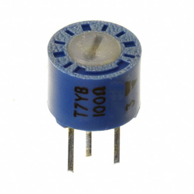

    可调电阻/电位器 100Ω ±20% 500mW 插件 ±100ppm/℃
T7YB101MB40 数据手册
T7 www.vishay.com Vishay Sfernice 7 mm Diameter Miniature Single-Turn Cermet Trimmer FEATURES • Industrial grade • 0.5 W at 70 °C • Tests according to CECC 41100 or IEC 60393-1 • Low temperature coefficient (100 ppm/K typical) LINKS TO ADDITIONAL RESOURCES 3D 3D • Wide resistance range (10 Ω to 2.2 MΩ) • Easy to read scale • 7 mm (0.275") diameter 3D Models A dust sealed plastic case protecting a quality cermet track guarantees high performance and proven reliability. Adjustments are made easier by the clear scale readings. T7 is ideally suited to all industrial applications. • Material categorization: for definitions of compliance please see www.vishay.com/doc?99912 DIMENSIONS in millimeters (± 0.5 mm) T7 YA T7 YB 0.6 0.3 2.54 ± 0.5 2.54 c c 0.55 90° b 2.54 ± 0.5 0.55 b a a 2.54 0.3 2.54 ± 0.5 Ø4 Ø 4.1 ± 0.5 6 5.85 ± 0.5 4.5 min. 4.5 min. 7 ± 0.5 Ø7 Document Number: 51015 1 For technical questions, contact: sferpottrimmers@vishay.com THIS DOCUMENT IS SUBJECT TO CHANGE WITHOUT NOTICE. THE PRODUCTS DESCRIBED HEREIN AND THIS DOCUMENT ARE SUBJECT TO SPECIFIC DISCLAIMERS, SET FORTH AT www.vishay.com/doc?91000 Revision: 18-Jul-2022 T7 www.vishay.com Vishay Sfernice ELECTRICAL SPECIFICATIONS Resistive element Cermet Electrical travel 270° ± 15° 10 Ω to 2.2 MΩ Resistance range Standard series E3 Tolerance standard 1 - 2.2 - 4.7 and on request 1 - 2 - 5 standard ± 20 % on request ± 10 % 0.5 W at 70 °C 10000 0.50 linear 1st line 2nd line Power rating 2nd line Power (W) 1000 0.25 100 10 0 0 20 40 60 70 80 100 125 140 Ambient Temperature (°C) a Circuit diagram c (1) (3) cw b (2) Temperature coefficient Limiting element voltage (linear law) Contact resistance variation End resistance (typical) See Standard Resistance Element Data 250 V 3 % or 3 Ω 1Ω Dielectric strength (RMS) 1000 V Insulation resistance 106 MΩ MECHANICAL SPECIFICATIONS Mechanical travel Operating torque (max. Ncm) End stop torque (max. Ncm) Unit weight (max. g) Terminals 300° ± 5° 1.5 3 0.5 SnAg alloy (code e2) ENVIRONMENTAL SPECIFICATIONS Temperature range Climatic category Sealing -55 °C to +125 °C 55 / 100 / 56 IP64 For board cleaning, Vishay recommends testing before usage. Water immersion is forbidden. Ultrasonic may cause component damage or failure. Document Number: 51015 2 For technical questions, contact: sferpottrimmers@vishay.com THIS DOCUMENT IS SUBJECT TO CHANGE WITHOUT NOTICE. THE PRODUCTS DESCRIBED HEREIN AND THIS DOCUMENT ARE SUBJECT TO SPECIFIC DISCLAIMERS, SET FORTH AT www.vishay.com/doc?91000 Revision: 18-Jul-2022 T7 www.vishay.com Vishay Sfernice PERFORMANCES TESTS CONDITIONS 1000 h at rated power 90'/30' - ambient temperature 70 °C Load life TYPICAL VALUES AND DRIFTS ΔRT/RT (%) ΔR1-2/R1-2 (%) ±3% Contact resistance variation: ±4% < 3 % Rn Phase A dry heat 100 °C Phase B damp heat Phase C cold -55 °C Phase D damp heat 5 cycles ±2% ±3% 56 days ±2% Dielectric strength: 1000 VRMS Insulation resistance: > 104 MΩ ±3% Rapid temperature change 5 cycles -55 °C at +125 °C ±1% ΔV1-2/ΔV1-3 ≤±2% Shock 3 successive shocks in 3 directions 10 Hz to 55 Hz 0.75 mm or 10 g during 6 h ± 0.5 % ±1% ± 0.5 % ΔV1-2/ΔV1-3 ≤±1% Climatic sequence Long term damp heat 50 g - 11 ms Vibration Rotational life 200 cycles ±3% Contact resistance variation: < 3 % Rn Note • Nothing stated herein shall be construed as a guarantee of quality or durability STANDARD RESISTANCE ELEMENT DATA STANDARD RESISTANCE VALUES Ω 10 22 47 100 220 470 1K 2.2K 4.7K 10K 22K 47K 100K 220K 470K 1M 2.2M MAX. POWER AT 70 °C W 0.5 0.5 0.5 0.5 0.5 0.5 0.5 0.5 0.5 0.5 0.5 0.5 0.5 0.28 0.13 0.06 0.028 LINEAR LAW MAX. WORKING VOLTAGE V 2.2 3.3 4.8 7.0 10.5 15.3 22.4 33.2 48.5 70.7 105 153 224 250 250 250 250 MAX. WIPER CURRENT mA 224 150 103 70 47 32 22 15 10 7.0 4.8 3.2 2.2 1.1 1.53 0.25 0.11 TYPICAL TCR -55 °C to +125 °C ppm/°C ± 100 MARKING • • • • • • Vishay trademark Model YA or YB style Ohmic value (in Ω, kΩ, MΩ) Manufacturing date Marking of terminal: 3 Document Number: 51015 3 For technical questions, contact: sferpottrimmers@vishay.com THIS DOCUMENT IS SUBJECT TO CHANGE WITHOUT NOTICE. THE PRODUCTS DESCRIBED HEREIN AND THIS DOCUMENT ARE SUBJECT TO SPECIFIC DISCLAIMERS, SET FORTH AT www.vishay.com/doc?91000 Revision: 18-Jul-2022 T7 www.vishay.com Vishay Sfernice PACKAGING • In box of 200 pieces, code B40 • On request: In tube of 50 pieces, code T20 (TU50) ORDERING INFORMATION (part number) T 7 Y A 4 7 4 M B 4 0 MODEL STYLE OHMIC VALUE TOLERANCE PACKAGING CODE SPECIAL NUMBER T7 YA YB From 10 Ω to 2.2 MΩ 103 = 10K M = 20 % On request: K = 10 % B40 = box 200 pieces On request: T20 = tube 50 pieces (If applicable) Given by Vishay for custom design DESCRIPTION (for information only) T7 YA 470K 20 % MODEL STYLE VALUE TOLERANCE SPECIAL BO e2 PACKAGING LEAD FINISH RELATED DOCUMENTS APPLICATION NOTES Potentiometers and Trimmers www.vishay.com/doc?51001 Guidelines for Vishay Sfernice Resistive and Inductive Components www.vishay.com/doc?52029 Document Number: 51015 4 For technical questions, contact: sferpottrimmers@vishay.com THIS DOCUMENT IS SUBJECT TO CHANGE WITHOUT NOTICE. THE PRODUCTS DESCRIBED HEREIN AND THIS DOCUMENT ARE SUBJECT TO SPECIFIC DISCLAIMERS, SET FORTH AT www.vishay.com/doc?91000 Revision: 18-Jul-2022 Legal Disclaimer Notice www.vishay.com Vishay Disclaimer ALL PRODUCT, PRODUCT SPECIFICATIONS AND DATA ARE SUBJECT TO CHANGE WITHOUT NOTICE TO IMPROVE RELIABILITY, FUNCTION OR DESIGN OR OTHERWISE. Vishay Intertechnology, Inc., its affiliates, agents, and employees, and all persons acting on its or their behalf (collectively, “Vishay”), disclaim any and all liability for any errors, inaccuracies or incompleteness contained in any datasheet or in any other disclosure relating to any product. Vishay makes no warranty, representation or guarantee regarding the suitability of the products for any particular purpose or the continuing production of any product. To the maximum extent permitted by applicable law, Vishay disclaims (i) any and all liability arising out of the application or use of any product, (ii) any and all liability, including without limitation special, consequential or incidental damages, and (iii) any and all implied warranties, including warranties of fitness for particular purpose, non-infringement and merchantability. Statements regarding the suitability of products for certain types of applications are based on Vishay's knowledge of typical requirements that are often placed on Vishay products in generic applications. Such statements are not binding statements about the suitability of products for a particular application. It is the customer's responsibility to validate that a particular product with the properties described in the product specification is suitable for use in a particular application. Parameters provided in datasheets and / or specifications may vary in different applications and performance may vary over time. All operating parameters, including typical parameters, must be validated for each customer application by the customer's technical experts. Product specifications do not expand or otherwise modify Vishay's terms and conditions of purchase, including but not limited to the warranty expressed therein. Hyperlinks included in this datasheet may direct users to third-party websites. These links are provided as a convenience and for informational purposes only. Inclusion of these hyperlinks does not constitute an endorsement or an approval by Vishay of any of the products, services or opinions of the corporation, organization or individual associated with the third-party website. Vishay disclaims any and all liability and bears no responsibility for the accuracy, legality or content of the third-party website or for that of subsequent links. Except as expressly indicated in writing, Vishay products are not designed for use in medical, life-saving, or life-sustaining applications or for any other application in which the failure of the Vishay product could result in personal injury or death. Customers using or selling Vishay products not expressly indicated for use in such applications do so at their own risk. Please contact authorized Vishay personnel to obtain written terms and conditions regarding products designed for such applications. No license, express or implied, by estoppel or otherwise, to any intellectual property rights is granted by this document or by any conduct of Vishay. Product names and markings noted herein may be trademarks of their respective owners. © 2022 VISHAY INTERTECHNOLOGY, INC. ALL RIGHTS RESERVED Revision: 01-Jan-2022 1 Document Number: 91000
