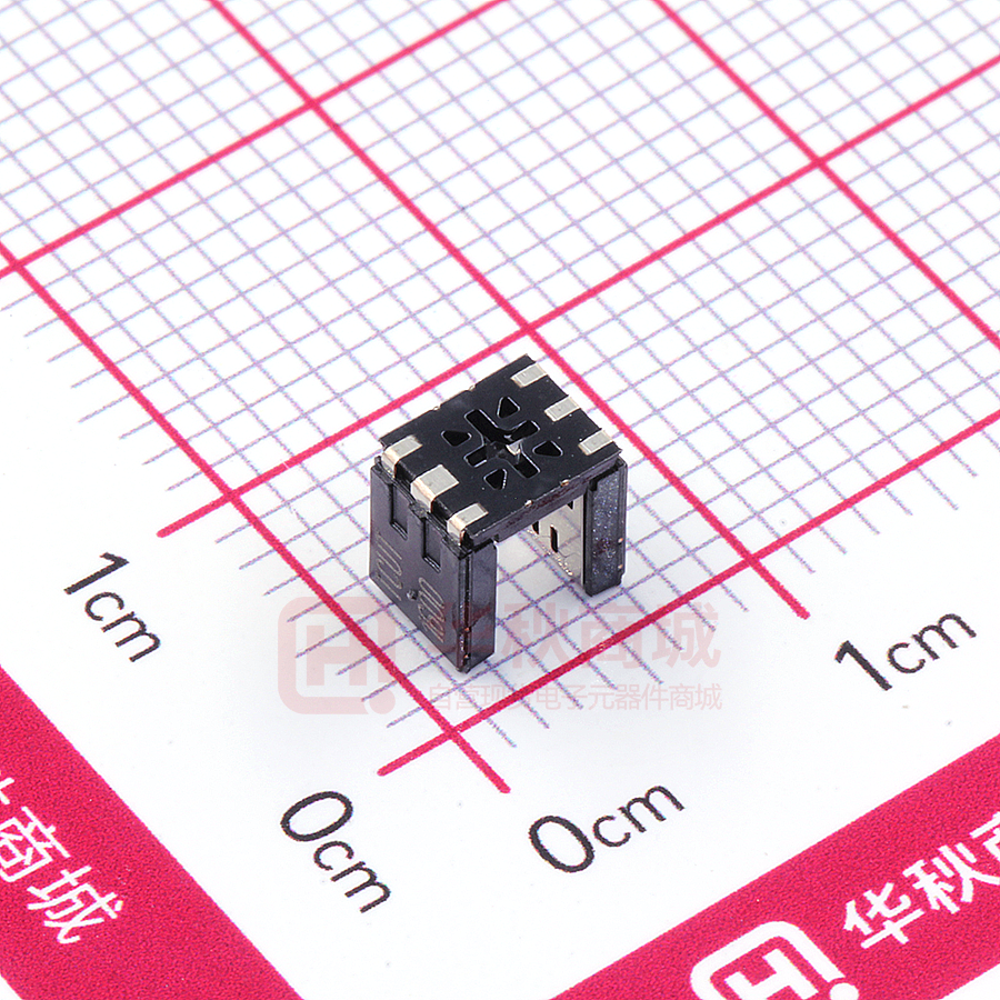

TCUT1600X01 www.vishay.com Vishay Semiconductors Tall Dome Dual Channel Transmissive Optical Sensor with Phototransistor Outputs FEATURES • Package type: surface mount • Detector type: phototransistor • Dimensions (L x W x H in mm): 5.5 x 4 x 5.7 • AEC-Q101 qualified • Gap (in mm): 3 • Aperture (in mm): 0.3 • Channel distance (center to center): 0.8 mm • Typical output current under test: IC = 1.6 mA • Emitter wavelength: 950 nm • Lead (Pb)-free soldering released DESCRIPTION • Moisture sensitivity level (MSL): 1 The TCUT1600X01 is a compact transmissive sensor that includes an infrared emitter and two phototransistor detectors, located face-to-face in a surface mount package. The tall dome design supports additional mechanical room for vertical signal encoding. • Material categorization: for definitions of compliance please see www.vishay.com/doc?99912 APPLICATIONS • Automotive optical sensors • Accurate position sensor for encoder • Sensor for motion, speed, and direction • Sensor for “turn and push” encoding PRODUCT SUMMARY PART NUMBER TCUT1600X01 GAP WIDTH (mm) APERTURE WIDTH (mm) 3 0.3 TYPICAL OUTPUT DAYLIGHT BLOCKING CURRENT UNDER TEST (1) FILTER INTEGRATED (mA) 1.6 No Note (1) Conditions like in table basic characteristics/coupler ORDERING INFORMATION ORDERING CODE PACKAGING VOLUME (1) REMARKS TCUT1600X01 Tape and reel MOQ: 1300 pcs, 1300 pcs/reel Drypack, MSL 1 Note (1) MOQ: minimum order quantity Document Number: 84174 1 For technical questions, contact: sensorstechsupport@vishay.com THIS DOCUMENT IS SUBJECT TO CHANGE WITHOUT NOTICE. THE PRODUCTS DESCRIBED HEREIN AND THIS DOCUMENT ARE SUBJECT TO SPECIFIC DISCLAIMERS, SET FORTH AT www.vishay.com/doc?91000 Rev. 1.0, 06-Nov-15 TCUT1600X01 www.vishay.com Vishay Semiconductors ABSOLUTE MAXIMUM RATINGS (Tamb = 25 °C, unless otherwise specified) PARAMETER TEST CONDITION SYMBOL VALUE UNIT Tamb ≤ 95 °C Ptot 37.5 mW Tj 110 °C Tamb -40 to +105 °C Tstg -40 to +125 °C Tsd 260 °C COUPLER Total power dissipation Junction temperature Ambient temperature range Storage temperature range Soldering temperature In accordance with fig. 16 INPUT (EMITTER) Reverse voltage VR 5 V Tamb ≤ 95 °C IF 25 mA tp ≤ 10 μs IFSM 200 mA Tamb ≤ 95 °C PV 37.5 mW Collector emitter voltage VCEO 20 V Emitter collector voltage VECO 7 V IC 20 mA ICEO 3.3 μA Forward current Forward surge current Power dissipation OUTPUT (DETECTOR) Collector current Tamb = 85 °C, VCE = 5 V Collector dark current ABSOLUTE MAXIMUM RATINGS 30 35 IF - Forward Current (mA) PV - Power Dissipation (mW) 40 30 25 RthJA = 460 K/W 20 15 10 25 20 15 RthJA = 460 K/W 10 5 5 0 0 0 22460 20 40 60 80 100 0 120 Tamb - Ambient Temperature (°C) Fig. 1 - Power Dissipation Limit vs. Ambient Temperature 22461 20 40 60 80 100 120 Tamb - Ambient Temperature (°C) Fig. 2 - Forward Current Limit vs. Ambient Temperature Document Number: 84174 2 For technical questions, contact: sensorstechsupport@vishay.com THIS DOCUMENT IS SUBJECT TO CHANGE WITHOUT NOTICE. THE PRODUCTS DESCRIBED HEREIN AND THIS DOCUMENT ARE SUBJECT TO SPECIFIC DISCLAIMERS, SET FORTH AT www.vishay.com/doc?91000 Rev. 1.0, 06-Nov-15 TCUT1600X01 www.vishay.com Vishay Semiconductors ELECTRICAL CHARACTERISTICS (Tamb = 25 °C, unless otherwise specified) PARAMETER TEST CONDITION SYMBOL MIN. TYP. MAX. UNIT VCE = 5 V, IF = 15 mA IC 0.7 1.6 - mA IF = 15 mA, IC = 0.2 mA VCEsat - - 0.4 V Forward voltage IF = 15 mA VF 1 1.2 1.4 V Reverse current VR = 5 V IR - - 10 μA VR = 0 V, f = 1 MHz Cj - 25 - pF IC = 1 mA VCEO 20 - - V COUPLER Collector current per channel Collector emitter saturation voltage INPUT (EMITTER) Junction capacitance OUTPUT (DETECTOR) Collector emitter voltage IC Emitter collector voltage IE = 100 μA VECO 7 - - V VCE = 25 V, IF = 0 A, E = 0 lx ICEO - 1 100 nA Rise time IC = 0.7 mA, VCE = 5 V, RL = 100 Ω (see fig. 3) tr - 9 150 μs Fall time IC = 0.7 mA, VCE = 5 V, RL = 100 Ω (see fig. 3) tf - 16 150 μs Collector dark current SWITCHING CHARACTERISTICS IF IF 0 +5V IF IC 0 adjusted by IF T t 100 % 90 % R G = 50 Ω tp tp IC = 20 t p = 1 ms 50 Ω Channel I Oscilloscope Channel II R L ≥ 1 MΩ C L ≤ 20 pF 100 Ω 20688 10 % 0 tr td ts t on tp td tr t on (= td + tr) Pulse duration Delay time Rise time Turn-on time t tf t off ts tf t off (= ts + tf) Storage time Fall time Turn-off time 96 11698 Fig. 4 - Switching Times Fig. 3 - Test Circuit for tr and tf BASIC CHARACTERISTICS (Tamb = 25 °C, unless otherwise specified) 1.4 VF - Forward Voltage (V) IF - Forward Current (mA) 100 10 1 0.8 20589 0.9 1.0 1.1 1.2 1.3 1.4 1.5 1.6 VF - Forward Voltage (V) Fig. 5 - Forward Current vs. Forward Voltage 1.3 1.2 1.1 1.0 - 50 - 25 22680 0 25 50 75 100 125 150 Tamb - Ambient Temperature (°C) Fig. 6 - Forward Voltage vs. Ambient Temperature Document Number: 84174 3 For technical questions, contact: sensorstechsupport@vishay.com THIS DOCUMENT IS SUBJECT TO CHANGE WITHOUT NOTICE. THE PRODUCTS DESCRIBED HEREIN AND THIS DOCUMENT ARE SUBJECT TO SPECIFIC DISCLAIMERS, SET FORTH AT www.vishay.com/doc?91000 Rev. 1.0, 06-Nov-15 TCUT1600X01 www.vishay.com Vishay Semiconductors 2.5 10 IC - Collector Current (mA) IC - Collector Current (mA) VCE = 5 V 1 0.1 2.0 IF = 15 mA 1.5 1.0 IF = 5 mA 0.5 VCE = 5 V 0.0 0.01 1 10 IF - Forward Current (mA) 22681 25 50 75 100 125 150 Fig. 10 - Collector Current vs. Ambient Temperature 100 000 ICEO - Collector Dark Current (nA) 10 IF = 25 mA IF = 15 mA IF = 5 mA 1 IF = 3 mA 0.1 10 000 0.1 1 10 1000 10 1 - 50 - 25 25 50 75 100 125 150 Fig. 11 - Collector Dark Current vs. Ambient Temperature 0.30 1 IC rel - Relative Collector Current IC = 200 μA 0.25 IF = 5 mA 0.20 0.15 IF = 15 mA 0.10 0.05 0.00 - 50 - 25 22683 0 Tamb - Ambient Temperature (°C) 22685 Fig. 8 - Collector Current vs. Collector Emitter Voltage VCE = 5 V 100 100 VCE - Collector Emitter Voltage (V) 22682 VCE = 70 V VCE = 25 V 0.01 VCEsat - Coll. Emitter Saturation Voltage (V) 0 Tamb - Ambient Temperature (°C) 22684 Fig. 7 - Collector Current vs. Forward Current IC - Collector Current (mA) - 50 - 25 100 0 25 50 75 100 125 S 0.8 0.6 0.4 0.2 0 - 1.5 150 Tamb - Ambient Tempearture (°C) Fig. 9 - Collector Emitter Saturation Voltage vs. Ambient Temperature 20595 -1 - 0.5 0 0.5 1 1.5 S - Horizontal Displacement (mm) Fig. 12 - Relative Collector Current vs. Horizontal Displacement Document Number: 84174 4 For technical questions, contact: sensorstechsupport@vishay.com THIS DOCUMENT IS SUBJECT TO CHANGE WITHOUT NOTICE. THE PRODUCTS DESCRIBED HEREIN AND THIS DOCUMENT ARE SUBJECT TO SPECIFIC DISCLAIMERS, SET FORTH AT www.vishay.com/doc?91000 Rev. 1.0, 06-Nov-15 TCUT1600X01 www.vishay.com Vishay Semiconductors I F = 15 mA + VC = 5 V S 1 ± 0.2 ICrel - Rel. Collector Current 1 Optical axis 0.5 74HCT14 UQ VE 10 kΩ 0 - 1.5 -1 - 0.5 0 0.5 1 1.5 13887 GND S - Vertical Displacement (mm) 20610 Fig. 13 - Relative Collector Current vs. Vertical Displacement Fig. 15 - Application example REFLOW SOLDER PROFILE 100 300 80 RL = 100 Ω 70 60 50 40 tf 30 tr 20 200 max. 30 s 150 max. 100 s max. 120 s 100 max. ramp down 6 °C/s 50 10 max. 260 °C 245 °C 255 °C 240 °C 217 °C 250 Temperature (°C) tr/tf - Rise/Fall Time (µs) 90 max. ramp up 3 °C/s 0 0 20599 250 0 500 750 1000 1250 1500 1750 2000 IC - Collector Current (µA) Fig. 14 - Rise/Fall Time vs. Collector Current 0 19841 50 100 150 200 250 300 Time (s) Fig. 16 - Lead (Pb)-free Reflow Solder Profile acc. J-STD-020 FLOOR LIFE Level 1, acc. JEDEC®, J-STD-020. No time limit. Document Number: 84174 5 For technical questions, contact: sensorstechsupport@vishay.com THIS DOCUMENT IS SUBJECT TO CHANGE WITHOUT NOTICE. THE PRODUCTS DESCRIBED HEREIN AND THIS DOCUMENT ARE SUBJECT TO SPECIFIC DISCLAIMERS, SET FORTH AT www.vishay.com/doc?91000 Rev. 1.0, 06-Nov-15 TCUT1600X01 www.vishay.com Vishay Semiconductors PACKAGE DIMENSIONS in millimeters 3.16 Material cut-outs Not indicated tolerances ± 0.15 0.5 0.8 1.4 0 1.4 Technical drawings according to DIN specification. Emitter side wider contact for pin-identification 0.2 max. 0.2 max. 0.8 ± 0.05 0.2 B 5.5 Optical axis 0.3 ± 0.05 1 0.9 4.5 .3 0.9 5.7 Ø 0.35 R0 1 1.2 1 3 5 Injection gate location 4 B Pin connection top view Coll. A NC E Cath. E Detector side Proposed solderpad design 1.9 0.7 1 R0 Ejector marks .9 Marking area 1.4 0.7 Emitter side 0 1 1.2 1.4 3 Drawing-No.: 6.541-5098.01-4 Issue: 1; 04.11.15 Document Number: 84174 6 For technical questions, contact: sensorstechsupport@vishay.com THIS DOCUMENT IS SUBJECT TO CHANGE WITHOUT NOTICE. THE PRODUCTS DESCRIBED HEREIN AND THIS DOCUMENT ARE SUBJECT TO SPECIFIC DISCLAIMERS, SET FORTH AT www.vishay.com/doc?91000 Rev. 1.0, 06-Nov-15 TCUT1600X01 www.vishay.com Vishay Semiconductors PACKAGE DIMENSIONS in millimeters Reel-design is representative for different types Unreel direction A E (em mpt pty y le tra ade iler r 4 20 00 m 0m m m mi mi n. n.) Ø 330 Ø 62 Label posted here 2 Ø 13 18.4 12.4 E to E E A Ø 1.55 0.4 Ø 1.5 4 8 2 Cathode Anode 6 E 5.5 Drawing-No.: 9.800-5124.01-4 Issue: 1; 04.11.15 1.75 12 Document Number: 84174 7 For technical questions, contact: sensorstechsupport@vishay.com THIS DOCUMENT IS SUBJECT TO CHANGE WITHOUT NOTICE. THE PRODUCTS DESCRIBED HEREIN AND THIS DOCUMENT ARE SUBJECT TO SPECIFIC DISCLAIMERS, SET FORTH AT www.vishay.com/doc?91000 Rev. 1.0, 06-Nov-15 Legal Disclaimer Notice www.vishay.com Vishay Disclaimer ALL PRODUCT, PRODUCT SPECIFICATIONS AND DATA ARE SUBJECT TO CHANGE WITHOUT NOTICE TO IMPROVE RELIABILITY, FUNCTION OR DESIGN OR OTHERWISE. Vishay Intertechnology, Inc., its affiliates, agents, and employees, and all persons acting on its or their behalf (collectively, “Vishay”), disclaim any and all liability for any errors, inaccuracies or incompleteness contained in any datasheet or in any other disclosure relating to any product. Vishay makes no warranty, representation or guarantee regarding the suitability of the products for any particular purpose or the continuing production of any product. To the maximum extent permitted by applicable law, Vishay disclaims (i) any and all liability arising out of the application or use of any product, (ii) any and all liability, including without limitation special, consequential or incidental damages, and (iii) any and all implied warranties, including warranties of fitness for particular purpose, non-infringement and merchantability. Statements regarding the suitability of products for certain types of applications are based on Vishay's knowledge of typical requirements that are often placed on Vishay products in generic applications. Such statements are not binding statements about the suitability of products for a particular application. It is the customer's responsibility to validate that a particular product with the properties described in the product specification is suitable for use in a particular application. Parameters provided in datasheets and / or specifications may vary in different applications and performance may vary over time. All operating parameters, including typical parameters, must be validated for each customer application by the customer's technical experts. Product specifications do not expand or otherwise modify Vishay's terms and conditions of purchase, including but not limited to the warranty expressed therein. Hyperlinks included in this datasheet may direct users to third-party websites. These links are provided as a convenience and for informational purposes only. Inclusion of these hyperlinks does not constitute an endorsement or an approval by Vishay of any of the products, services or opinions of the corporation, organization or individual associated with the third-party website. Vishay disclaims any and all liability and bears no responsibility for the accuracy, legality or content of the third-party website or for that of subsequent links. Except as expressly indicated in writing, Vishay products are not designed for use in medical, life-saving, or life-sustaining applications or for any other application in which the failure of the Vishay product could result in personal injury or death. Customers using or selling Vishay products not expressly indicated for use in such applications do so at their own risk. Please contact authorized Vishay personnel to obtain written terms and conditions regarding products designed for such applications. No license, express or implied, by estoppel or otherwise, to any intellectual property rights is granted by this document or by any conduct of Vishay. Product names and markings noted herein may be trademarks of their respective owners. © 2022 VISHAY INTERTECHNOLOGY, INC. ALL RIGHTS RESERVED Revision: 01-Jan-2022 1 Document Number: 91000
