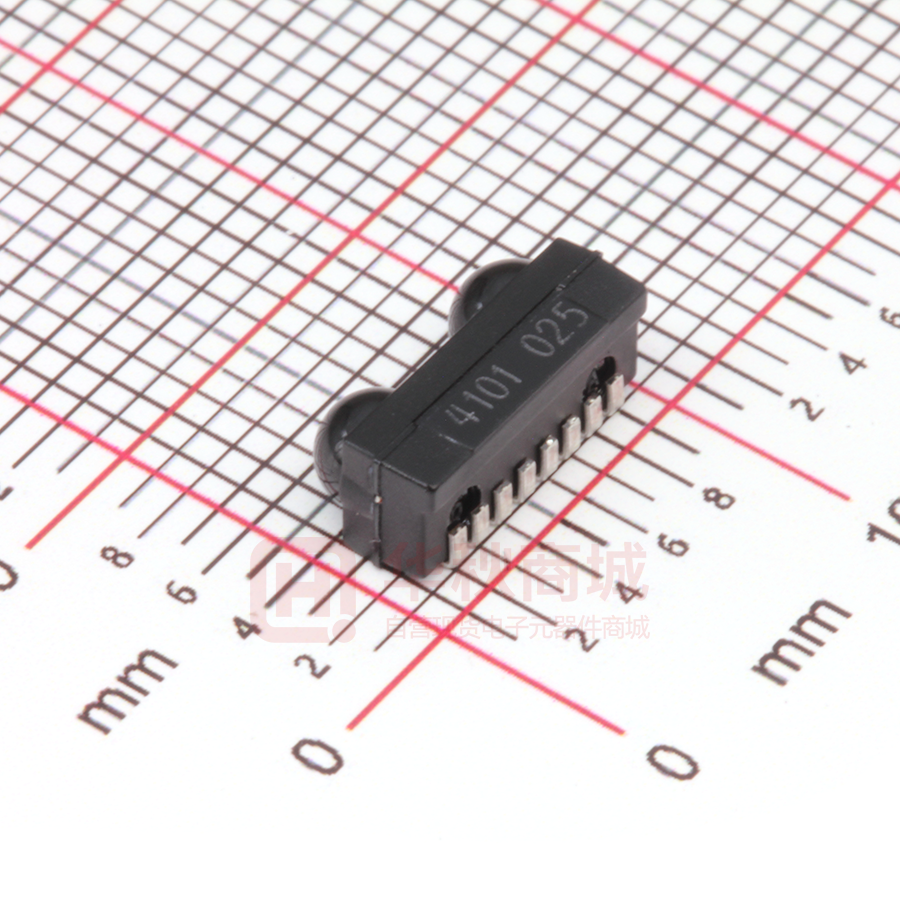

TFDU4101 www.vishay.com Vishay Semiconductors Infrared Transceiver Module (SIR, 115.2 kbit/s) for IrDA® Applications DESCRIPTION TFDU4101 is an infrared transceiver that supports data rates up to 115 kbit/s per the IrDA standard. The link distance is up to 1 meter. The transceiver includes a PIN photodiode, an infrared emitter, and a low-power control IC. These components have not been qualified according to automotive specifications. FEATURES • Compliant to the IrDA physical layer specification • Standard IrDA link distance of 1 m • Low power consumption, typically less than 70 μA • Less than 1 μA in shutdown mode • Material categorization: for definitions of compliance please see www.vishay.com/doc?99912 20110-1 APPLICATIONS • Short-distance wireless communication and data transfer • Use in environments where RF is problematic LINKS TO ADDITIONAL RESOURCES Product Page Related Documents DESIGN SUPPORT TOOLS • • • • • 3D model Window size calculator Symbols and terminology IRDC protocol Reference layouts and circuit diagrams FUNCTIONAL BLOCK DIAGRAM VCC1 Tri-state driver PD Amplifier RXD Comparator VCC2 (IRED anode) SD Mode control TXD IRED driver IRED IREDC ASIC 19283-2 GND Rev. 2.2, 25-Jul-2022 Document Number: 81288 1 For technical questions within your region: irdasupportAM@vishay.com, irdasupportAP@vishay.com, irdasupportEU@vishay.com THIS DOCUMENT IS SUBJECT TO CHANGE WITHOUT NOTICE. THE PRODUCTS DESCRIBED HEREIN AND THIS DOCUMENT ARE SUBJECT TO SPECIFIC DISCLAIMERS, SET FORTH AT www.vishay.com/doc?91000 TFDU4101 www.vishay.com Vishay Semiconductors PRODUCT SUMMARY PART NUMBER DATA RATE (kbit/s) DIMENSIONS HxLxW (mm x mm x mm) LINK DISTANCE (m) OPERATING VOLTAGE (V) IDLE SUPPLY CURRENT (mA) 115.2 4 x 9.7 x 4.7 0 to ≥ 1 2.4 to 5.5 0.07 TFDU4101 PARTS TABLE PART DESCRIPTION QTY/REEL TFDU4101-TR3 Oriented in carrier tape for side view surface mounting 1000 pcs TFDU4101-TT3 Oriented in carrier tape for top view surface mounting 1000 pcs PIN DESCRIPTION PIN NUMBER SYMBOL DESCRIPTION 1 VCC2 IRED anode IRED anode to be externally connected to VCC2. An external resistor is only necessary for controlling the IRED current when a current reduction below 300 mA is intended to operate in IrDA low power mode. This pin is allowed to be supplied from an uncontrolled power supply separated from the controlled VCC1 - supply. 2 IRED cathode IRED cathode, internally connected to driver transistor 3 4 I/O ACTIVE TXD This Schmitt-Trigger input is used to transmit serial data when SD is low. An on-chip protection circuit disables the LED driver if the TXD pin is asserted for longer than 50 μs (max. 300 μs). I High RXD Received data output, push-pull CMOS driver output capable of driving standard CMOS or TTL loads. During transmission the RXD output is active (echo-on). No external pull-up or pull-down resistor is required. Floating with a weak pull-up of 500 kΩ (typ.) in shutdown mode. O Low I High 5 SD Shutdown 6 VCC1 Supply voltage 7 NC No internal connection 8 GND Ground I Rev. 2.2, 25-Jul-2022 Document Number: 81288 2 For technical questions within your region: irdasupportAM@vishay.com, irdasupportAP@vishay.com, irdasupportEU@vishay.com THIS DOCUMENT IS SUBJECT TO CHANGE WITHOUT NOTICE. THE PRODUCTS DESCRIBED HEREIN AND THIS DOCUMENT ARE SUBJECT TO SPECIFIC DISCLAIMERS, SET FORTH AT www.vishay.com/doc?91000 TFDU4101 www.vishay.com Vishay Semiconductors PINOUT TFDU4101 Weight 200 mg ”U” Option Baby Face (universal) IRED 1 2 Detector 3 4 5 6 7 8 17087 ABSOLUTE MAXIMUM RATINGS PARAMETER TEST CONDITIONS SYMBOL MIN. TYP. MAX. UNIT -0.3 V < VCC2 < 6 V VCC1 -0.5 - 6 V Supply voltage range, transmitter -0.5 V < VCC1 < 6 V VCC2 -0.5 - 6 V Voltage at RXD -0.5 V < VCC1 < 6 V VRXD -0.5 - VCC1 + 0.5 V Vin > VCC1 is allowed Vin -0.5 - 6 V Supply voltage range, transceiver Voltage at all inputs and outputs Input currents For all pins, except IRED anode pin Output sinking current - - 10 mA - - 25 mA Power dissipation PD - - 250 mW Junction temperature TJ - - 125 °C Tamb -30 - +85 °C Tstg -30 - +85 °C - - 260 °C IIRED (DC) - - 80 mA Ambient temperature range (operating) Storage temperature range Soldering temperature See “Recommended Solder Profile” Average output current, pin 1 Repetitive pulse output current, pin 1 to pin 2 < 90 μs, ton < 20 % IIRED (RP) - - 400 mA Thermal resistance junction-to-ambient JESD51 RthJA - 300 - K/W Note • Reference point pin, GND unless otherwise noted. Typical values are for DESIGN AID ONLY, not guaranteed nor subject to production testing EYE SAFETY INFORMATION STANDARD CLASSIFICATION IEC/EN 60825-1 (2007-03), DIN EN 60825-1 (2008-05) “SAFETY OF LASER PRODUCTS Part 1: equipment classification and requirements”, simplified method Class 1 IEC 62471 (2006), CIE S009 (2002) “Photobiological Safety of Lamps and Lamp Systems” Exempt DIRECTIVE 2006/25/EC OF THE EUROPEAN PARLIAMENT AND OF THE COUNCIL of 5th April 2006 on the minimum health and safety requirements regarding the exposure of workers to risks arising from physical agents (artificial optical radiation) (19th individual directive within the meaning of article 16(1) of directive 89/391/EEC) Exempt Note • Vishay transceivers operating inside the absolute maximum ratings are classified as eye safe according the above table Rev. 2.2, 25-Jul-2022 Document Number: 81288 3 For technical questions within your region: irdasupportAM@vishay.com, irdasupportAP@vishay.com, irdasupportEU@vishay.com THIS DOCUMENT IS SUBJECT TO CHANGE WITHOUT NOTICE. THE PRODUCTS DESCRIBED HEREIN AND THIS DOCUMENT ARE SUBJECT TO SPECIFIC DISCLAIMERS, SET FORTH AT www.vishay.com/doc?91000 TFDU4101 www.vishay.com Vishay Semiconductors ELECTRICAL CHARACTERISTICS (Tamb = 25 °C, VCC1 = VCC2 = 2.4 V to 5.5 V unless otherwise noted) PARAMETER TEST CONDITIONS/PINS SYMBOL MIN. TYP. MAX. UNIT TRANSCEIVER Supply voltage VCC1 2.4 - 5.5 V Dynamic supply current SD = low, Ee = 1 klx (1), Tamb = -25 °C to +85 °C VCC1 = VCC2 = 2.4 V to 5.5 V ICC1 40 90 130 μA Dynamic supply current SD = low, Ee = 1 klx (1), Tamb = 25 °C VCC1 = VCC2 = 2.4 V to 5.5 V ICC1 40 75 - μA Average dynamic supply current, transmitting IIRED = 300 mA, 25 % duty cycle ICC - 0.65 2.5 mA SD = high, T = 25 °C, Ee = 0 klx no signal, no resistive load ISD - 0.01 0.1 μA SD = high, T = 70 °C no signal, no resistive load ISD - - 1 μA SD = high, T = 85 °C no signal, no resistive load ISD - - 1 μA TA -30 - +85 °C Shutdown supply current Operating temperature range Output voltage low, RXD Output voltage high, RXD Cload = 15 pF VOL -0.5 - 0.15 x VCC1 V IOH = -500 μA, CLoad = 15 pF VOH 0.8 x VCC1 - VCC1 + 0.5 V IOH = -250 μA, CLoad = 15 pF VOH 0.9 x VCC1 - VCC1 + 0.5 V RRXD 400 500 600 kΩ V RXD to VCC1 impedance Input voltage low (TXD, SD) SD = high VIL -0.5 - 0.5 VIH VCC1 - 0.5 - 6 V Vin = 0.9 x VCC1 IICH -2 - +2 μA SD, TXD = “0” or “1” IIrTX -1 0 +150 1 μA μA - - 5 pF Input voltage high (TXD, SD) Input leakage current (TXD, SD) Controlled pull down current 0 < Vin < 0.15 VCC1 Vin > 0.7 VCC1 Input capacitance (TXD, SD) CI Notes • Typical values are for DESIGN AID ONLY, not guaranteed nor subject to production testing (1) Standard illuminant A (2) The typical threshold level is 0.5 x V CC1. It is recommended to use the specified min./max. values to avoid increased operating current Rev. 2.2, 25-Jul-2022 Document Number: 81288 4 For technical questions within your region: irdasupportAM@vishay.com, irdasupportAP@vishay.com, irdasupportEU@vishay.com THIS DOCUMENT IS SUBJECT TO CHANGE WITHOUT NOTICE. THE PRODUCTS DESCRIBED HEREIN AND THIS DOCUMENT ARE SUBJECT TO SPECIFIC DISCLAIMERS, SET FORTH AT www.vishay.com/doc?91000 TFDU4101 www.vishay.com Vishay Semiconductors OPTOELECTRONIC CHARACTERISTICS (Tamb = 25 °C, VCC1 = VCC2 = 2.4 V to 5.5 V unless otherwise noted) PARAMETER TEST CONDITIONS SYMBOL MIN. TYP. MAX. UNIT Minimum irradiance Ee in angular range (2) SIR mode 9.6 kbit/s to 115.2 kbit/s λ = 850 nm to 900 nm; α = 0°, 15° Ee, min. 4 (0.4) 20 (2) 35 (1) (3.5) mW/m2 (μW/cm2) Maximum irradiance Ee in angular range (3) λ = 850 nm to 900 nm Ee, max. 5 (500) - - kW/m2 (mW/cm2) Rise time of output signal 10 % to 90 %, CL = 15 pF tr (RXD) 20 - 100 ns Fall time of output signal 90 % to 10 %, CL = 15 pF tf (RXD) 20 - 100 ns RXD pulse width Input pulse length > 1.2 μs tPW 1.65 2.2 3 μs Input irradiance = 100 mW/m2, ≤ 115.2 kbit/s - - 250 ns After shutdown active or power-on - 100 500 μs - 100 150 μs RECEIVER Leading edge jitter Standby/shutdown delay, receiver startup time Latency tL TRANSMITTER (new surface emitter values introduced via PCN OPT-1210-2022) IRED operating current limitation Forward voltage of built-in IRED Output leakage IRED current Output radiant intensity No external resistor for current limitation (4) ID 200 300 430 mA If = 300 mA Vf 1.4 1.8 1.9 V TXD = 0 V, 0 < VCC1 < 5.5 V IIRED -1 0.01 1 μA α = 0°, 15°, TXD = high, SD = low Ie 50 150 400 mW/sr VCC1 = 5 V, α = 0°, 15°, TXD = low or SD = high (receiver is inactive as long as SD = high) Ie - - 0.04 mW/sr α - ± 30 - ° λp 870 - 910 nm Δλ - 45 - nm 50 Output radiant intensity, angle of half intensity Peak - emission wavelength (5) Spectral bandwidth Optical rise time, fall time Optical output pulse duration tropt, tfopt 10 Input pulse width 1.6 < tTXD < 23 μs topt tTXD - 0.15 Input pulse width tTXD ≥ 23 μs topt 23 Optical overshoot 50 100 ns tTXD + 0.15 μs 100 μs 25 % Notes • Typical values are for DESIGN AID ONLY, not guaranteed nor subject to production testing (1) IrDA specification is 40 mW/m2. Specification takes a window loss of 10 % into account (2) IrDA sensitivity definition: minimum irradiance E in angular range, power per unit area. The receiver must meet the BER specification while e the source is operating at the minimum intensity in angular range into the minimum half-angular range at the maximum link length (3) Maximum irradiance E in angular range, power per unit area. The optical delivered to the detector by a source operating at the maximum e intensity in angular range at minimum link length must not cause receiver overdrive distortion and possible ralated link errors. If placed at the active output interface reference plane of the transmitter, the receiver must meet its bit error ratio (BER) specification (4) Using an external current limiting resistor is allowed and recommended to reduce IRED intensity and operating current when current reduction is intended to operate at the IrDA low power conditions. E.g. for VCC2 = 3.3 V a current limiting resistor of RS = 56 Ω will allow a power minimized operation at IrDA low power conditions (5) Due to this wavelength restriction compared to the IrDA spec of 850 nm to 900 nm the transmitter is able to operate as source for the standard remote control applications with codes as e.g. Phillips RC5/RC6® or RECS 80 For more definitions see the document “Symbols and Terminology” on the Vishay website. Rev. 2.2, 25-Jul-2022 Document Number: 81288 5 For technical questions within your region: irdasupportAM@vishay.com, irdasupportAP@vishay.com, irdasupportEU@vishay.com THIS DOCUMENT IS SUBJECT TO CHANGE WITHOUT NOTICE. THE PRODUCTS DESCRIBED HEREIN AND THIS DOCUMENT ARE SUBJECT TO SPECIFIC DISCLAIMERS, SET FORTH AT www.vishay.com/doc?91000 TFDU4101 www.vishay.com Vishay Semiconductors RECOMMENDED CIRCUIT DIAGRAM Operated with a clean low impedance power supply the TFDU4101 needs no additional external components. However, depending on the entire system design and board layout, additional components may be required (see figure 1). That is especially the case when separate power supplies are used for bench tests. When using compact wiring and regulated supplies as e. g. in phone applications in most cases no external components are necessary. VIRED R1(1) VCC R2 GND C1 VCC2, IRED A VCC1 C2 Ground SD SD TXD TXD RXD RXD 20037 IRED C Fig. 1 - Recommended Test Circuit Note (1) R1 is optional when reduced intensity is used The capacitor C1 is buffering the supply voltage and eliminates the inductance of the power supply line. This one should be a Tantalum or other fast capacitor to guarantee the fast rise time of the IRED current. The resistor R1 is the current limiting resistor, which may be used to reduce the operating current to levels below the specified controlled values for saving battery power. Vishay's transceivers integrate a sensitive receiver and a built-in power driver. The combination of both needs a careful circuit board layout. The use of thin, long, resistive and inductive wiring should be avoided. The shutdown input must be grounded for normal operation, also when the shutdown function is not used. The inputs (TXD, SD) and the output RXD should be directly connected (DC-coupled) to the I/O circuit. The capacitor C2 combined with the resistor R2 is the low pass filter for smoothing the supply voltage. R2, C1 and C2 are optional and dependent on the quality of the supply voltages VCC1 and injected noise. An unstable power supply with dropping voltage during transmission may reduce the sensitivity (and transmission range) of the transceiver. The placement of these parts is critical. It is strongly recommended to position C2 as close as possible to the transceiver power supply pins. When extended wiring is used (bench tests!) the inductance of the power supply can cause dynamically a voltage drop at VCC2. Often some power supplies are not able to follow the fast current rise time. In that case another 4.7 μF (type, see table under C1) at VCC2 will be helpful. Under extreme EMI conditions as placing an RF-transmitter antenna on top of the transceiver, we recommend to protect all inputs by a low-pass filter, as a minimum a 12 pF capacitor, especially at the RXD port. The transceiver itself withstands EMI at GSM frequencies above 500 V/m. When interference is observed, the wiring to the inputs picks it up. It is verified by DPI measurements that as long as the interfering RF - voltage is below the logic threshold levels of the inputs and equivalent levels at the outputs no interferences are expected. One should keep in mind that basic RF-design rules for circuit design should be taken into account. Especially longer signal lines should not be used without termination. See e.g. “The Art of Electronics” Paul Horowitz, Winfield Hill, 1989, Cambridge University Press, ISBN: 0521370957. TABLE 1 - RECOMMENDED TESTS AND APPLICATION CIRCUIT COMPONENTS COMPONENT RECOMMENDED VALUE VISHAY PART NUMBER C1 4.7 μF, 16 V 293D 475X9 016B 0.1 μF, ceramic VJ 1206 Y 104 J XXMT C2 R1 R2 Depends on current to be adjusted, e. g. with VCC2 = 3.3 V 56 Ω is an option for minimum low power operation 47 Ω, 0.125 W Figure 2 shows an example of a typical application with a separate supply voltage VS and using the transceiver with the IRED anode connected to the unregulated battery Vbatt. This method reduces the peak load of the regulated power supply and saves therefore costs. Alternatively all supplies can also be tied to only one voltage source. R1 and C1 are not used in this case and are depending on the circuit design in most cases not necessary. CRCW-1206-47R0-F-RT1 In Fig. 2 an option is shown to operate the transmitter at two different power levels to switch for long range to low power mode for e.g. saving power for IrDA application but use the full range specification for remote control. The additional components are marked in the figure. For operating at RS232 ports we recommend to use an encoder / decoder-module. Rev. 2.2, 25-Jul-2022 Document Number: 81288 6 For technical questions within your region: irdasupportAM@vishay.com, irdasupportAP@vishay.com, irdasupportEU@vishay.com THIS DOCUMENT IS SUBJECT TO CHANGE WITHOUT NOTICE. THE PRODUCTS DESCRIBED HEREIN AND THIS DOCUMENT ARE SUBJECT TO SPECIFIC DISCLAIMERS, SET FORTH AT www.vishay.com/doc?91000 TFDU4101 www.vishay.com Vishay Semiconductors I/O AND SOFTWARE Vbatt  3 V Hi/Low Vs = 2.8 V C1 R1 Vdd IRTX IRRX IR MODE R2 IRED anode (1) IRED cathode (2) TXD (3) RXD (4) SD (5) VCC1 (6) In the description, already different I/Os are mentioned. Different combinations are tested and the function verified with the special drivers available from the I/O suppliers. In special cases refer to the I/O manual, the Vishay application notes, or contact directly Vishay Sales, Marketing or Application. C2 GND (8) 20038 Fig. 2 - Typical Application Circuit Grey: Optional for High/Low Switching TABLE 2 - TRUTH TABLE INPUTS OUTPUTS REMARK SD TXD OPTICAL INPUT IRRADIANCE mW/m2 High > 1 ms x x High < 50 μs x Low active Ie Transmitting High > 50 μs x High inactive 0 Protection is active Low min. irradiance Ee < max. irradiance Ee Low (active) 0 Response to an IrDA compliant optical input signal Low > max. irradiance Ee Undefined 0 Overload conditions can cause unexpected outputs RXD TRANSMITTER OPERATION Weakly pulled (500 kΩ) to VCC1 0 Shutdown Low Rev. 2.2, 25-Jul-2022 Document Number: 81288 7 For technical questions within your region: irdasupportAM@vishay.com, irdasupportAP@vishay.com, irdasupportEU@vishay.com THIS DOCUMENT IS SUBJECT TO CHANGE WITHOUT NOTICE. THE PRODUCTS DESCRIBED HEREIN AND THIS DOCUMENT ARE SUBJECT TO SPECIFIC DISCLAIMERS, SET FORTH AT www.vishay.com/doc?91000 TFDU4101 www.vishay.com Vishay Semiconductors ASSEMBLY INSTRUCTIONS Reflow Soldering • Reflow soldering must be done within 72 h while stored under a max. temperature of 30 °C, 60 % RH after opening the dry pack envelope • Set the furnace temperatures for pre-heating and heating in accordance with the reflow temperature profile as shown in the diagram. Exercise extreme care to keep the maximum temperature below 260 °C. The temperature shown in the profile means the temperature at the device surface. Since there is a temperature difference between the component and the circuit board, it should be verified that the temperature of the device is accurately being measured • Handling after reflow should be done only after the work surface has been cooled off Manual Soldering • Use a soldering iron of 25 W or less. Adjust the temperature of the soldering iron below 300 °C • Finish soldering within 3 s • Handle products only after the temperature has cooled off VISHAY LEAD (Pb)-FREE REFLOW SOLDER PROFILE Axis Title 10000 300 255 °C 240 °C 250 245 °C 217 °C 200 1000 max. 20 s 150 max. 120 s max. 100 s 100 100 Max. ramp up 3 °C/s 50 Max. ramp down 6 °C/s Max. 2 cycles allowed 0 0 19800 1st line 2nd line 2nd line Temperature (°C) max. 260 °C 50 100 150 200 250 10 300 Time (s) Rev. 2.2, 25-Jul-2022 Document Number: 81288 8 For technical questions within your region: irdasupportAM@vishay.com, irdasupportAP@vishay.com, irdasupportEU@vishay.com THIS DOCUMENT IS SUBJECT TO CHANGE WITHOUT NOTICE. THE PRODUCTS DESCRIBED HEREIN AND THIS DOCUMENT ARE SUBJECT TO SPECIFIC DISCLAIMERS, SET FORTH AT www.vishay.com/doc?91000 TFDU4101 www.vishay.com Vishay Semiconductors PACKAGE DIMENSIONS in millimeters 7x1=7 0.6 2.5 1 8 18470 1 Fig. 3 - Package Drawing TFDU4101. Tolerance ± 0.2 mm if not otherwise mentioned 20035 Fig. 4 - Recommended Footprint for Side View Applications and Solderpaste Mask Rev. 2.2, 25-Jul-2022 Document Number: 81288 9 For technical questions within your region: irdasupportAM@vishay.com, irdasupportAP@vishay.com, irdasupportEU@vishay.com THIS DOCUMENT IS SUBJECT TO CHANGE WITHOUT NOTICE. THE PRODUCTS DESCRIBED HEREIN AND THIS DOCUMENT ARE SUBJECT TO SPECIFIC DISCLAIMERS, SET FORTH AT www.vishay.com/doc?91000 TFDU4101 www.vishay.com Vishay Semiconductors 20036 Fig. 5 - Recommended Footprint for Top View Applications and Solderpaste Mask TAPE DIMENSIONS FOR TT3 in millimeters Drawing-No.: 9.700-5251.01-4 Issue: 3; 02.09.05 19824 Fig. 6 - Tape Drawing, TFDU4101 for Top View Mounting, Tolerance ± 0.1 mm Rev. 2.2, 25-Jul-2022 Document Number: 81288 10 For technical questions within your region: irdasupportAM@vishay.com, irdasupportAP@vishay.com, irdasupportEU@vishay.com THIS DOCUMENT IS SUBJECT TO CHANGE WITHOUT NOTICE. THE PRODUCTS DESCRIBED HEREIN AND THIS DOCUMENT ARE SUBJECT TO SPECIFIC DISCLAIMERS, SET FORTH AT www.vishay.com/doc?91000 TFDU4101 www.vishay.com Vishay Semiconductors TAPE DIMENSIONS FOR TR3 in millimeters 19875 Fig. 7 - Tape Drawing, TFDU4101 for Side View Mounting, Tolerance ± 0.1 mm Rev. 2.2, 25-Jul-2022 Document Number: 81288 11 For technical questions within your region: irdasupportAM@vishay.com, irdasupportAP@vishay.com, irdasupportEU@vishay.com THIS DOCUMENT IS SUBJECT TO CHANGE WITHOUT NOTICE. THE PRODUCTS DESCRIBED HEREIN AND THIS DOCUMENT ARE SUBJECT TO SPECIFIC DISCLAIMERS, SET FORTH AT www.vishay.com/doc?91000 TFDU4101 www.vishay.com Vishay Semiconductors REEL DIMENSIONS in millimeters Drawing-No.: 9.800-5090.01-4 Issue: 1; 29.11.05 14017 TAPE WIDTH (mm) A MAX. (mm) N (mm) W1 MIN. (mm) W2 MAX. (mm) W3 MIN. (mm) W3 MAX. (mm) 24 330 60 24.4 30.4 23.9 27.4 LEADER AND TRAILER DIMENSIONS in millimeters Trailer no devices Leader devices no devices End Start min. 200 min. 400 96 11818 COVER TAPE PEEL STRENGTH LABEL According to DIN EN 60286-3 0.1 N to 1.3 N 300 ± 10 mm/min. 165° to 180° peel angle Standard bar code labels for finished goods The standard bar code labels are product labels and used for identification of goods. The finished goods are packed in final packing area. The standard packing units are labeled with standard bar code labels before transported as finished goods to warehouses. The labels are on each packing unit and contain Vishay Semiconductor GmbH specific data. Rev. 2.2, 25-Jul-2022 Document Number: 81288 12 For technical questions within your region: irdasupportAM@vishay.com, irdasupportAP@vishay.com, irdasupportEU@vishay.com THIS DOCUMENT IS SUBJECT TO CHANGE WITHOUT NOTICE. THE PRODUCTS DESCRIBED HEREIN AND THIS DOCUMENT ARE SUBJECT TO SPECIFIC DISCLAIMERS, SET FORTH AT www.vishay.com/doc?91000 TFDU4101 www.vishay.com Vishay Semiconductors DRY PACKING The reel is packed in an anti-humidity bag to protect the devices from absorbing moisture during transportation and storage. Aluminum bag Label After more than 72 h under these conditions moisture content will be too high for reflow soldering. In case of moisture absorption, the devices will recover to the former condition by drying under the following condition: 192 h at 40 °C + 5 °C / - 0 °C and < 5 % RH (dry air / nitrogen) or 96 h at 60 °C + 5 °C and < 5 % RH for all device containers or 24 h at 125 °C + 5 °C not suitable for reel or tubes. An EIA JEDEC® standard J-STD-020 level 4 label is included on all dry bags. Reel CAUTION 15973 This bag contains MOISTURE-SENSITIVE DEVICES FINAL PACKING LEVEL 4 1. Shelf life in sealed bag: 12 months at < 40 °C and < 90 % relative humidity (RH) The sealed reel is packed into a cardboard box. 2. After this bag is opened, devices that will be subjected to soldering reflow or equivalent processing (peak package body temp. 260 °C) must be 2a. Mounted within 72 hours at factory condition of < 30 °C/60 % RH or 2b. Stored at < 5 % RH RECOMMENDED METHOD OF STORAGE 3. Devices require baking befor mounting if: Humidity Indicator Card is > 10 % when read at 23 °C ± 5 °C or 2a. or 2b. are not met. Dry box storage is recommended as soon as the aluminum bag has been opened to prevent moisture absorption. The following conditions should be observed, if dry boxes are not available: • Storage temperature 10 °C to 30 °C • Storage humidity ≤ 60 % RH max. 4. If baking is required, devices may be baked for: 192 hours at 40 °C + 5 °C/- 0 °C and < 5 % RH (dry air/nitrogen) or 96 hours at 60 °C ± 5 °C and < 5 % RH for all device containers or 24 hours at 125 °C ± 5 °C not suitable for reels or tubes Bag Seal Date: (If blank, see barcode label) Note: Level and body temperature defined by EIA JEDEC Standard J-STD-020 22522 EIA JEDEC standard J-STD-020 level 4 label is included on all dry bags OUTER PACKAGING The sealed reel is packed into a pizza box. CARTON BOX DIMENSIONS in millimeters Length Thickness 22127 ORDER CODE Width BOXING THICKNESS WIDTH LENGTH TT3 / TR3 Pizza box (taping in reels) 50 340 340 TT1 / TR1 Pizza box (taping in reels) 32 190 190 Rev. 2.2, 25-Jul-2022 Document Number: 81288 13 For technical questions within your region: irdasupportAM@vishay.com, irdasupportAP@vishay.com, irdasupportEU@vishay.com THIS DOCUMENT IS SUBJECT TO CHANGE WITHOUT NOTICE. THE PRODUCTS DESCRIBED HEREIN AND THIS DOCUMENT ARE SUBJECT TO SPECIFIC DISCLAIMERS, SET FORTH AT www.vishay.com/doc?91000 TFDU4101 www.vishay.com Vishay Semiconductors VISHAY SEMICONDUCTOR GmbH STANDARD BAR CODE PRODUCT LABEL (finished goods) PLAIN WRITING ABBREVIATION LENGTH Item-description - 18 Item-number INO 8 Selection-code SEL 3 BATCH 10 Data-code COD 3 (YWW) Plant-code PTC 2 Quantity QTY 8 Accepted by ACC - Packed by PCK - LOT-/serial-number Mixed code indicator MIXED CODE - xxxxxxx+ Company logo Origin Long bar code top Type Length Item-number N 8 Plant-code N 2 Sequence-number X 3 Quantity N 8 Total length - 21 Short bar code bottom Type Length Selection-code X 3 Data-code N 3 Batch-number X 10 Filter - 1 Total length - 17 The Vishay Semiconductors standard bar code labels are printed at final packing areas. The labels are on each packing unit and contain Vishay Semiconductors specific data. Lead (Pb)-free category e3  Sn Lot 1: lot number or identification Lot 2: 1920031A91 19 – plant code 20 – year 03 – workweek 1 – weekday: 1 Mon, 2 Tue, … A – shift 91 – printer number QA acceptance seal Device type Quantity Plant location Plant location code 23195 Batch number YYYYWW + country + plant code RoHS compliance logo Lead (Pb)-free logo Fig. 8 - 2D Bar Code Label (according the bar code standard for 2D label PDF 417) for a Lead (Pb)-Free Device Made in Philippines, Detailed Description ESD PRECAUTION Proper storage and handling procedures should be followed to prevent ESD damage to the devices especially when they are removed from the antistatic shielding bag. Electrostatic sensitive devices warning labels are on the packaging. Rev. 2.2, 25-Jul-2022 Document Number: 81288 14 For technical questions within your region: irdasupportAM@vishay.com, irdasupportAP@vishay.com, irdasupportEU@vishay.com THIS DOCUMENT IS SUBJECT TO CHANGE WITHOUT NOTICE. THE PRODUCTS DESCRIBED HEREIN AND THIS DOCUMENT ARE SUBJECT TO SPECIFIC DISCLAIMERS, SET FORTH AT www.vishay.com/doc?91000 Legal Disclaimer Notice www.vishay.com Vishay Disclaimer ALL PRODUCT, PRODUCT SPECIFICATIONS AND DATA ARE SUBJECT TO CHANGE WITHOUT NOTICE TO IMPROVE RELIABILITY, FUNCTION OR DESIGN OR OTHERWISE. Vishay Intertechnology, Inc., its affiliates, agents, and employees, and all persons acting on its or their behalf (collectively, “Vishay”), disclaim any and all liability for any errors, inaccuracies or incompleteness contained in any datasheet or in any other disclosure relating to any product. Vishay makes no warranty, representation or guarantee regarding the suitability of the products for any particular purpose or the continuing production of any product. To the maximum extent permitted by applicable law, Vishay disclaims (i) any and all liability arising out of the application or use of any product, (ii) any and all liability, including without limitation special, consequential or incidental damages, and (iii) any and all implied warranties, including warranties of fitness for particular purpose, non-infringement and merchantability. Statements regarding the suitability of products for certain types of applications are based on Vishay's knowledge of typical requirements that are often placed on Vishay products in generic applications. Such statements are not binding statements about the suitability of products for a particular application. It is the customer's responsibility to validate that a particular product with the properties described in the product specification is suitable for use in a particular application. Parameters provided in datasheets and / or specifications may vary in different applications and performance may vary over time. All operating parameters, including typical parameters, must be validated for each customer application by the customer's technical experts. Product specifications do not expand or otherwise modify Vishay's terms and conditions of purchase, including but not limited to the warranty expressed therein. Hyperlinks included in this datasheet may direct users to third-party websites. These links are provided as a convenience and for informational purposes only. Inclusion of these hyperlinks does not constitute an endorsement or an approval by Vishay of any of the products, services or opinions of the corporation, organization or individual associated with the third-party website. Vishay disclaims any and all liability and bears no responsibility for the accuracy, legality or content of the third-party website or for that of subsequent links. Except as expressly indicated in writing, Vishay products are not designed for use in medical, life-saving, or life-sustaining applications or for any other application in which the failure of the Vishay product could result in personal injury or death. Customers using or selling Vishay products not expressly indicated for use in such applications do so at their own risk. Please contact authorized Vishay personnel to obtain written terms and conditions regarding products designed for such applications. No license, express or implied, by estoppel or otherwise, to any intellectual property rights is granted by this document or by any conduct of Vishay. Product names and markings noted herein may be trademarks of their respective owners. © 2022 VISHAY INTERTECHNOLOGY, INC. ALL RIGHTS RESERVED Revision: 01-Jan-2022 1 Document Number: 91000
