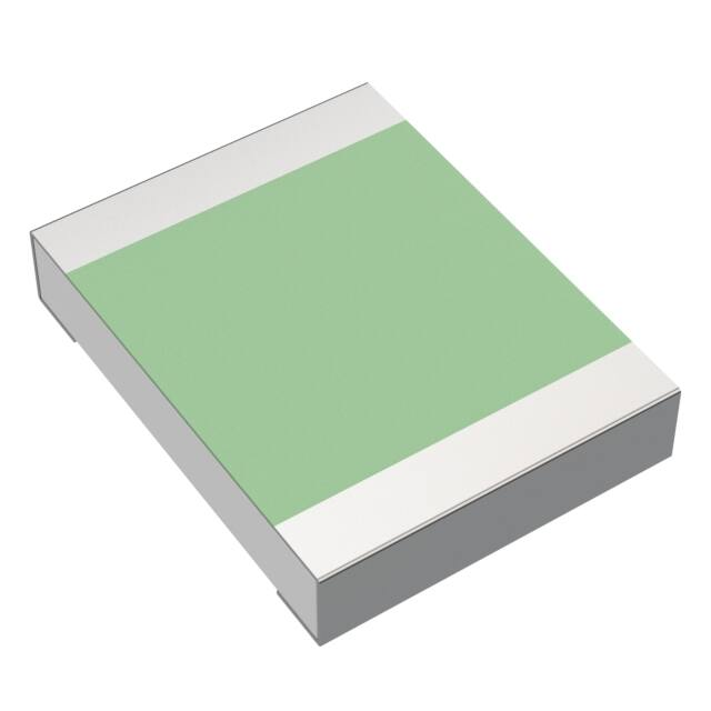

TNPW e3 www.vishay.com Vishay High Stability Thin Film Flat Chip Resistors FEATURES • Superior moisture resistivity (85 °C; 85 % RH) • Excellent overall stability at different environmental conditions ≤ 0.05 % (1000 h rated power at 70 °C) • AEC-Q200 qualified • Single lot date code (optional) • Advanced sulfur resistance verified according to ASTM B 809 • Material categorization: for definitions of compliance please see www.vishay.com/doc?99912 TNPW e3 precision thin film flat chip resistors are the perfect choice for most fields of modern electronics where highest reliability and stability is of major concern. Typical applications include automotive, industrial, test and measuring equipment, and medical equipment. APPLICATIONS • Automotive • Industrial equipment • Test and measuring equipment • Medical equipment TECHNICAL SPECIFICATIONS DESCRIPTION Imperial size Metric size code Resistance range Resistance tolerance Temperature coefficient Rated dissipation, P70 (1) Operating voltage, Umax. ACRMS or DC TNPW0201 e3 TNPW0402 e3 TNPW0603 e3 TNPW0805 e3 TNPW1206 e3 0201 0402 0603 0805 1206 1210 RR0603M RR1005M RR1608M RR2012M RR3216M RR3225M 22 Ω to 40 kΩ 10 Ω to 100 kΩ 1 Ω to 332 kΩ 1 Ω to 1 MΩ 1 Ω to 2 MΩ 10 Ω to 3.01 MΩ ± 0.5 %; ± 0.1 % ± 1 %; ± 0.5 %; ± 0.1 % ± 25 ppm/K ± 50 ppm/K; ± 25 ppm/K; ± 15 ppm/K; ± 10 ppm/K 0.075 W 0.100 W 0.125 W 0.200 W 0.400 W 0.500 W 25 V 50 V 75 V 150 V 200 V 200 V Permissible film temperature, ϑF max. (1) 155 °C Operating temperature range Internal thermal resistance TNPW1210 e3 -55 °C to 155 °C (1) - 90 K/W 63 K/W 38 K/W 32 K/W - 50 V 75 V 100 V 200 V 300 V 300 V Permissible voltage against ambient (insulation): 1 min; Uins Failure rate: FITobserved ≤ 0.1 x 10-9/h Note (1) Please refer to APPLICATION INFORMATION APPLICATION INFORMATION When the resistor dissipates power, a temperature rise above the ambient temperature occurs, dependent on the thermal resistance of the assembled resistor together with the printed circuit board. The rated dissipation applies only if the permitted film temperature is not exceeded. Please consider the application note “Thermal Management in Surface-Mounted (www.vishay.com/doc?28844) for information on the general nature of thermal resistance. Resistor Applications” These resistors do not feature a limited lifetime when operated within the permissible limits. However, resistance value drift increasing over operating time may result in exceeding a limit acceptable to the specific application, thereby establishing a functional lifetime. Revision: 23-Sep-2021 Document Number: 28758 1 For technical questions, contact: thinfilmchip@vishay.com THIS DOCUMENT IS SUBJECT TO CHANGE WITHOUT NOTICE. THE PRODUCTS DESCRIBED HEREIN AND THIS DOCUMENT ARE SUBJECT TO SPECIFIC DISCLAIMERS, SET FORTH AT www.vishay.com/doc?91000 TNPW e3 www.vishay.com Vishay MAXIMUM RESISTANCE CHANGE AT RATED DISSIPATION OPERATION MODE STANDARD POWER TNPW0201 e3 0.050 W 0.075 W TNPW0402 e3 0.063 W 0.100 W TNPW0603 e3 0.100 W 0.125 W TNPW0805 e3 0.125 W 0.200 W TNPW1206 e3 0.250 W 0.400 W TNPW1210 e3 0.330 W 0.500 W -55 °C to 125 °C -55 °C to 155 °C 125 °C 155 °C TNPW0201 e3 22 Ω to 40 kΩ 22 Ω to 40 kΩ TNPW0402 e3 10 Ω to 100 kΩ 10 Ω to 100 kΩ TNPW0603 e3 1 Ω to 332 kΩ 1 Ω to 332 kΩ TNPW0805 e3 1 Ω to 1 MΩ 1 Ω to 1 MΩ TNPW1206 e3 1 Ω to 2 MΩ 1 Ω to 2 MΩ TNPW1210 e3 10 Ω to 3.01 MΩ 10 Ω to 3.01 MΩ 1000 h ≤ 0.05 % ≤ 0.10 % 8000 h ≤ 0.10 % ≤ 0.20 % 225 000 h ≤ 0.30 % ≤ 0.60 % Rated dissipation, P70 Operating temperature range Permissible film temperature, ϑF max. Max. resistance change at P70 for resistance range, |ΔR/R| after: Note • The presented operation modes do not refer to different types of resistors, but actually show examples of different loads, that lead to different film temperatures and different achievable load-life stability (drift) of the resistance value. A suitable low thermal resistance of the circuit board assembly must be safeguarded in order to maintain the film temperature of the resistors within the specified limits. Please consider the application note “Thermal Management in Surface-Mounted Resistor Applications” (www.vishay.com/doc?28844) for information on the general nature of thermal resistance Revision: 23-Sep-2021 Document Number: 28758 2 For technical questions, contact: thinfilmchip@vishay.com THIS DOCUMENT IS SUBJECT TO CHANGE WITHOUT NOTICE. THE PRODUCTS DESCRIBED HEREIN AND THIS DOCUMENT ARE SUBJECT TO SPECIFIC DISCLAIMERS, SET FORTH AT www.vishay.com/doc?91000 TNPW e3 www.vishay.com Vishay TEMPERATURE COEFFICIENT AND RESISTANCE RANGE TYPE / SIZE TNPW0201 e3 TCR ± 25 ppm/K TOLERANCE ± 0.5 % 22 Ω to 40 kΩ ± 0.1 % 22 Ω to 25 kΩ ±1% ± 50 ppm/K ± 0.5 % ± 0.1 % TNPW0402 e3 ±1% ± 25 ppm/K RESISTANCE ± 0.5 % 10 Ω to 100 kΩ 47 Ω to 100 kΩ 10 Ω to 100 kΩ ± 0.1 % ± 15 ppm/K ± 10 ppm/K ± 0.1 % ±1% ± 50 ppm/K ± 0.5 % ± 0.1 % TNPW0603 e3 ±1% ± 25 ppm/K ± 15 ppm/K ± 10 ppm/K ± 0.5 % 1 Ω to 332 kΩ ± 0.1 % 47 Ω to 332 kΩ ± 0.5 % ±1% ± 25 ppm/K 3.5 Ω to 332 kΩ 3.5 Ω to 332 kΩ ± 0.1 % TNPW0805 e3 1 Ω to 332 kΩ ± 0.1 % ±1% ± 50 ppm/K 47 Ω to 100 kΩ ± 0.5 % 1 Ω to 1 MΩ 3.5 Ω to 1 MΩ 1 Ω to 1 MΩ ± 0.1 % ± 15 ppm/K ± 10 ppm/K ± 0.1 % ±1% ± 50 ppm/K ± 0.5 % ± 0.1 % TNPW1206 e3 ±1% ± 25 ppm/K ± 15 ppm/K ± 10 ppm/K ± 0.5 % 1 Ω to 2 MΩ ± 0.1 % 47 Ω to 2 MΩ ± 0.5 % ±1% ± 25 ppm/K 3.5 Ω to 2 MΩ 3.5 Ω to 2 MΩ ± 0.1 % TNPW1210 e3 1 Ω to 2 MΩ ± 0.1 % ±1% ± 50 ppm/K 3.5 Ω to 1 MΩ ± 0.5 % 10 Ω to 3.01 MΩ 47 Ω to 2.13 MΩ 10 Ω to 3.01 MΩ ± 0.1 % ± 15 ppm/K ± 10 ppm/K Revision: 23-Sep-2021 ± 0.1 % 47 Ω to 2.13 MΩ E-SERIES E24; E192 E24; E96 E24; E192 E24; E96 E24; E192 E24; E96 E24; E192 E24; E96 E24; E192 E24; E96 E24; E192 E24; E96 E24; E192 E24; E96 E24; E192 E24; E96 E24; E192 E24; E96 E24; E192 E24; E96 E24; E192 Document Number: 28758 3 For technical questions, contact: thinfilmchip@vishay.com THIS DOCUMENT IS SUBJECT TO CHANGE WITHOUT NOTICE. THE PRODUCTS DESCRIBED HEREIN AND THIS DOCUMENT ARE SUBJECT TO SPECIFIC DISCLAIMERS, SET FORTH AT www.vishay.com/doc?91000 TNPW e3 www.vishay.com Vishay PACKAGING TYPE / SIZE CODE QUANTITY ET2 = EI 5000 ET7 = ED 10 000 EP1 = EP 1000 PACKAGING STYLE WIDTH PITCH PACKAGING DIMENSIONS 2 mm Ø 180 mm / 7" 4 mm Ø 180 mm / 7" 4 mm Ø 330 mm / 13" TNPW0201 e3 TNPW0402 e3 TNPW0603 e3 TNPW0805 e3 TNPW1206 e3 TNPW1210 e3 (1) ET2 = EI 5000 ET7 = ED 10 000 E52 = EN 1000 Paper tape according IEC 60286-3, Type 1a 8 mm (1) ET1 = EA 5000 ET6 = EC (2) 20 000 Notes (1) 1000 pieces packaging is available only for precision resistors with tolerance ± 0.1 % and temperature coefficient ≤ ± 25 ppm/K (2) 20 000 pieces packaging is available only for resistors with TCR ± 25 ppm/K and ± 50 ppm/K PART NUMBER AND PRODUCT DESCRIPTION Part Number: TNPW12061K32DEEA T N P W 1 2 0 6 1 K 3 2 D E E A TYPE / SIZE RESISTANCE TOLERANCE TCR PACKAGING SPECIAL TNPW0201 TNPW0402 TNPW0603 TNPW0805 TNPW1206 TNPW1210 R = decimal K = thousand M = million (4 digits) B = ± 0.1 % D = ± 0.5 % F = ± 1.0 % H = ± 50 ppm/K E = ± 25 ppm/K X = ± 15 ppm/K Y = ± 10 ppm/K ED EP EI EN EA EC (E.. = lead-free) Up to 2 digits Blank = standard 0H = single lot date code Product Description: TNPW1206 1K32 0.5 % T-9 ET1 e3 TNPW1206 1K32 0.5 % T-9 ET1 e3 TYPE / SIZE RESISTANCE TOLERANCE TCR PACKAGING LEAD (Pb)-FREE TNPW0201 TNPW0402 TNPW0603 TNPW0805 TNPW1206 TNPW1210 54R1 = 54.1 Ω 1K32 = 1320 Ω ± 0.1 % ± 0.5 % ± 1.0 % T-2 = ± 50 ppm/K T-9 = ± 25 ppm/K T-10 = ± 15 ppm/K T-13 = ± 10 ppm/K ET7 EP1 ET2 E52 ET1 ET6 (E.. = lead-free) e3 = pure matte tin termination finish BV 20545 = single lot date code Note • The product can be ordered using either the PART NUMBER or the PRODUCT DESCRIPTION Revision: 23-Sep-2021 Document Number: 28758 4 For technical questions, contact: thinfilmchip@vishay.com THIS DOCUMENT IS SUBJECT TO CHANGE WITHOUT NOTICE. THE PRODUCTS DESCRIBED HEREIN AND THIS DOCUMENT ARE SUBJECT TO SPECIFIC DISCLAIMERS, SET FORTH AT www.vishay.com/doc?91000 TNPW e3 www.vishay.com Vishay DESCRIPTION MATERIALS Production is strictly controlled and follows an extensive set of instructions established for reproducibility. A homogeneous film of special metal alloy is deposited on a high grade ceramic substrate (AI2O3) and conditioned to achieve the desired temperature coefficient. Specially designed inner contacts are deposited on both sides. A special laser is used to achieve the target value by smoothly fine trimming the resistive layer without damaging the ceramics. A further conditioning is applied in order to stabilize the trimming result. The resistor elements are covered by a protective coating designed for electrical, mechanical and climatic protection. The terminations receive a final pure matte tin on nickel plating. The result of the determined production is verified by an extensive testing procedure and optical inspection performed on 100 % of the individual chip resistors. This includes full screening for the elimination of products with a potential risk of early life failures (feasible for R ≥ 10 Ω). Only accepted products are laid directly into the tape in accordance with IEC 60286-3, Type 1a (1). Vishay acknowledges the following systems for the regulation of hazardous substances: • IEC 62474, Material Declaration for Products of and for the Electrotechnical Industry, with the list of declarable substances given therein (2) • The Global Automotive Declarable Substance List (GADSL) (3) • The REACH regulation (1907/2006/EC) and the related list of substances with very high concern (SVHC) (4) for its supply chain The products do not contain any of the banned substances as per IEC 62474, GADSL, or the SVHC list, see www.vishay.com/how/leadfree. ASSEMBLY The resistors are suitable for processing on automatic SMD assembly systems. They are suitable for automatic soldering using wave, reflow or vapour phase as shown in IEC 61760-1 (1). The encapsulation is resistant to all cleaning solvents commonly used in the electronics industry, including alcohols, esters and aqueous solutions. The suitability of conformal coatings, potting compounds and their processes, if applied, shall be qualified by appropriate means to ensure the long-term stability of the whole system. The resistors are RoHS-compliant, the pure matte tin plating provides compatibility with lead (Pb)-free and lead-containing soldering processes. Solderability is specified for 2 years after production or requalification. The permitted storage time is 20 years. The immunity of the plating against tin whisker growth has been proven under extensive testing. Hence the products fully comply with the following directives: • 2000/53/EC End-of-Life Vehicle Directive (ELV) and Annex II (ELV II) • 2011/65/EU Restriction of the Use of Hazardous Substances Directive (RoHS) with amendment 2015/863/EU • 2012/19/EU Waste Electrical and Electronic Equipment Directive (WEEE) Vishay pursues the elimination of conflict minerals from its supply chain, see the Conflict Minerals Policy at www.vishay.com/doc?49037. RELATED PRODUCTS The TNPW with SnPb termination plating is designed for those applications, where lead bearing terminations are mandatory. For ordering TNPW with SnPb terminations please refer to latest edition of datasheet TNPW (www.vishay.com/doc?31006). TNPU e3 ultra precision thin film flat chip resistors combine the proven reliability of TNPW e3 products with a most advanced level of precision and stability (www.vishay.com/doc?28779). TNPS .... ESCC high-reliability thin film chip resistors are the premium choice for design and manufacture of equipment, where matured technology and proven reliability are of utmost importance. They are regularly used in communication and research satellites and fit equally well into aircraft and military electronic systems. Approval of the TNPS .... ESCC products is granted by the European Space Components Coordination and registered in the ESCC Qualified Parts List, REP005 (www.vishay.com/doc?28789). TNPV e3 High Voltage Thin Film Flat Chip Resistors are designed for most fields of modern electronics where precision, reliability and stability at high operating voltage are primary concerns (www.vishay.com/doc?28881). Notes (1) The quoted IEC standards are also released as EN standards with the same number and identical contents (2) The IEC 62474 list of declarable substances is maintained in a dedicated database, which is available at http://std.iec.ch/iec62474 (3) The Global Automotive Declarable Substance List (GADSL) is maintained by the American Chemistry Council and available at www.gadsl.org (4) The SVHC list is maintained by the European Chemical Agency (ECHA) and available at http://echa.europa.eu/candidate-list-table Revision: 23-Sep-2021 Document Number: 28758 5 For technical questions, contact: thinfilmchip@vishay.com THIS DOCUMENT IS SUBJECT TO CHANGE WITHOUT NOTICE. THE PRODUCTS DESCRIBED HEREIN AND THIS DOCUMENT ARE SUBJECT TO SPECIFIC DISCLAIMERS, SET FORTH AT www.vishay.com/doc?91000 TNPW e3 www.vishay.com Vishay 120 TNPW1206 e3 TNPW0805 e3 TNPW0603 e3 110 100 TNPW0402 e3 90 80 2 1 0.5 TNPW0402 e3 TNPW0603 e3 0.3 TNPW0805 e3 0.1 TNPW1206 e3 0.05 0.03 70 60 3 Current Noise in µV/V Non-Linearity A3 in dB FUNCTIONAL PERFORMANCE 10 100 1K 10K 0.01 100 100K 1K 10K 100K 4 Current Noise TNPW0201 e3 25 50 100 2 0 -2 Phase Angle in ϑ° [Z]-RO in % RO Non-Linearity 5 TNPW0201 e3 4 3 2 25 1 50 0 -4 -1 549 -3 -8 -4 10 100 [Z]-RO in % RO 4 -5 1000 3000 Frequency f in MHz 1 10 100 1000 3000 Frequency f in MHz HF Performance (1) TNPW0402 e3 2 25 50 100 0 -2 200 -4 Phase Angle in ϑ° 1 HF Performance (1) 5 TNPW0402 e3 4 25 3 2 1 0 -1 -6 -8 -10 100 549 -2 -6 -10 1M Resistance Value in  Resistance Value in  549  1 10 HF Performance (1) 100 1000 3000 Frequency f in MHz -2 50 -3 100 200  549  -4 -5 1 10 100 1000 3000 Frequency f in MHz HF Performance (1) Note (1) Typical figures. HF-characteristic also depends on termination and circuit design Revision: 23-Sep-2021 Document Number: 28758 6 For technical questions, contact: thinfilmchip@vishay.com THIS DOCUMENT IS SUBJECT TO CHANGE WITHOUT NOTICE. THE PRODUCTS DESCRIBED HEREIN AND THIS DOCUMENT ARE SUBJECT TO SPECIFIC DISCLAIMERS, SET FORTH AT www.vishay.com/doc?91000 TNPW e3 www.vishay.com Vishay 20 TNPW0603 e3 10 25 50 100 200 0 -20 Phase Angle in ϑ° [Z]-RO in % RO FUNCTIONAL PERFORMANCE 549 25 TNPW0603 e3 10 20 15 10 5 0 -40 -5 1000  -60 10 100 [Z]-RO in % RO HF Performance (1) 20 -20 1000 3000 Frequency f in MHz 1 10 100 TNPW0805 e3 10 100 0 1000  -20 20 10 100 -20 1000  -40 -60 -60 10 000  1 10 HF Performance (1) 1000 3000 Frequency f in MHz TNPW0805 e3 0 -40 -80 1000  4750  10 000  HF Performance (1) Phase Angle in ϑ° 1 -15 4750  10 000  -80 200 / 549  -10 25 50 100 100 1000 3000 Frequency f in MHz -80 10 000  1 10 100 1000 3000 Frequency f in MHz HF Performance (1) Note (1) Typical figures. HF-characteristic also depends on termination and circuit design Revision: 23-Sep-2021 Document Number: 28758 7 For technical questions, contact: thinfilmchip@vishay.com THIS DOCUMENT IS SUBJECT TO CHANGE WITHOUT NOTICE. THE PRODUCTS DESCRIBED HEREIN AND THIS DOCUMENT ARE SUBJECT TO SPECIFIC DISCLAIMERS, SET FORTH AT www.vishay.com/doc?91000 TNPW e3 www.vishay.com Vishay Power Dissipation P FUNCTIONAL PERFORMANCE 0.6 W 0.5 TNPW0201 e3 TNPW0402 e3 TNPW0603 e3 TNPW0805 e3 0.4 TNPW1206 e3 TNPW1210 e3 0.3 0.2 0.1 0 -55 0 50 70 100 125 °C 155 Ambient Temparature ϑ amb Power Dissipation P Derating - Standard Operation 0.6 W 0.5 TNPW0201 e3 TNPW0402 e3 TNPW0603 e3 TNPW0805 e3 0.4 TNPW1206 e3 TNPW1210 e3 0.3 0.2 0.1 0 -55 0 50 70 100 125 °C 155 Ambient Temparature ϑ amb Derating - Power Operation Note • The solid line is based on IEC/EN reference test conditions which is considered as standard mode. However, above that the maximum permissible film temperature is 155 °C (dashed line) Revision: 23-Sep-2021 Document Number: 28758 8 For technical questions, contact: thinfilmchip@vishay.com THIS DOCUMENT IS SUBJECT TO CHANGE WITHOUT NOTICE. THE PRODUCTS DESCRIBED HEREIN AND THIS DOCUMENT ARE SUBJECT TO SPECIFIC DISCLAIMERS, SET FORTH AT www.vishay.com/doc?91000 TNPW e3 www.vishay.com Vishay 3K TNPW0805 e3 1K TNPW0603 e3 3K Test Voltage in V Test Voltage in V FUNCTIONAL PERFORMANCE TNPW0603 e3 100 100 10 TNPW0805 e3 1K 10R 100R 1K 10 10R 10K 100K Resistance Value in Ω 100R 1K 10K 100K Resistance Value in Ω Single-Pulse High Voltage Overload Test 10/700 μs EN140000 4.27 100 W 100 W TNPW1206 e3 Permissible pulse power Pi, max. Permissible pulse power Pi, max. Single-Pulse High Voltage Overload Test 1.2/50 μs EN140000 4.27 TNPW0805 e3 TNPW0603 e3 10 W 1W Conditions: P 0, n ≤ 1000 and Ui ≤ Ui, max. 0.1 W 10 µs 100 µs 1 ms 10 ms 100 ms 1s 10 s Pulse Duration t i Maximum Pulse Load Pi, max. for Single Pulses TNPW1206 e3 TNPW0805 e3 10 W TNPW0603 e3 1W Conditions: Pmax. ≤ Pmax. (including derating) and Ui ≤ Ui, max. 0.1 W 10 µs 100 µs 1 ms 10 ms 100 ms 1s 10 s Pulse Duration t i Maximum Pulse Load Pi, max. for Continuous Pulses Permissible pulse voltage Ui, max. 10 000 V 1000 V TNPW1206 e3 TNPW0805 e3 TNPW0603 e3 100 V Conditions: Pi ≤ Pi, max. 10 V 10 µs 100 µs 1 ms 10 ms 100 ms 1s 10 s Pulse Duration t i Maximum Pulse Voltage Ui, max. Revision: 23-Sep-2021 Document Number: 28758 9 For technical questions, contact: thinfilmchip@vishay.com THIS DOCUMENT IS SUBJECT TO CHANGE WITHOUT NOTICE. THE PRODUCTS DESCRIBED HEREIN AND THIS DOCUMENT ARE SUBJECT TO SPECIFIC DISCLAIMERS, SET FORTH AT www.vishay.com/doc?91000 TNPW e3 www.vishay.com Vishay TEST AND REQUIREMENTS All tests are carried out in accordance with the following specifications: EN 60115-1, generic specification EN 60115-8, sectional specification EN 140401-801, detail specification IEC 60068-2-xx, test methods The parameters stated in the Test Procedures and Requirements table are based on the required tests and permitted limits of EN 140401-801. The detail specification EN 140401-801 does not cover case size 0201. The table presents only the most important tests, for the full test schedule refer to the documents listed above. However, some additional tests and a number of improvements against those minimum requirements have been included. The testing also covers most of the requirements specified by EIA / ECA-703 and JIS-C-5201-1. The tests are carried out under standard atmospheric conditions in accordance with IEC 60068-1, 4.3, whereupon the following values are applied: Temperature: 15 °C to 35 °C Relative humidity: 25 % to 75 % Air pressure: 86 kPa to 106 kPa (860 mbar to 1060 mbar) A climatic category LCT / UCT / 56 is applied, defined by the lower category temperature (LCT), the upper category temperature (UCT), and the duration of exposure in the damp heat, steady state test (56 days). The components are mounted for testing on printed circuit boards in accordance with EN 60115-8, 2.4.2, unless otherwise specified. TEST PROCEDURES AND REQUIREMENTS EN 60115-1 CLAUSE IEC 60068-2 (1) TEST METHOD TEST PROCEDURE REQUIREMENTS PERMISSIBLE CHANGE (ΔR) Stability for product types: TNPW0201 e3 22 Ω to 40 kΩ TNPW0402 e3 10 Ω to 100 kΩ TNPW0603 e3 1 Ω to 332 kΩ TNPW0805 e3 1 Ω to 1 MΩ TNPW1206 e3 1 Ω to 2 MΩ TNPW1210 e3 10 Ω to 3.01 MΩ 4.5 - Resistance - ± 1 %; ± 0.5 %; ± 0.1 % 4.8 - Temperature coefficient At (20 / -55 / 20) °C and (20 / 125 / 20) °C ± 50 ppm/K; ± 25 ppm/K; ± 15 ppm/K; ± 10 ppm/K Endurance at 70 °C: standard operation mode 4.25.1 Endurance at 70 °C: power operation mode U = P 70 x R or U = Umax.; whichever is the less severe; 1.5 h on; 0.5 h off; 70 °C; 1000 h ± (0.05 % R + 0.01 Ω) 70 °C; 8000 h ± (0.1 % R + 0.02 Ω) U = P 70 x R or U = Umax.; whichever is the less severe; 1.5 h on; 0.5 h off; 70 °C; 1000 h ± (0.1 % R + 0.01 Ω) 70 °C; 8000 h ± (0.2 % R + 0.02 Ω) Endurance at upper category temperature 125 °C; 1000 h ± (0.05 % R + 0.01 Ω) 155 °C; 1000 h ± (0.1 % R + 0.02 Ω) 78 (Cab) Damp heat, steady state (40 ± 2) °C; 56 days; (93 ± 3) % RH ± (0.1 % R + 0.01 Ω) 4.37 67 (Cy) Damp heat, steady state accelerated: Standard operation mode (85 ± 2) °C (85 ± 5) % RH U = 0.1 x P 70 x R ; U ≤ 0.3 x Umax.; 1000 h ± (0.25 % R + 0.05 Ω) - 1 (Ab) Cold -55 °C; 2 h ± (0.05 % R + 0.01 Ω) 4.25.3 4.24 - Revision: 23-Sep-2021 Document Number: 28758 10 For technical questions, contact: thinfilmchip@vishay.com THIS DOCUMENT IS SUBJECT TO CHANGE WITHOUT NOTICE. THE PRODUCTS DESCRIBED HEREIN AND THIS DOCUMENT ARE SUBJECT TO SPECIFIC DISCLAIMERS, SET FORTH AT www.vishay.com/doc?91000 TNPW e3 www.vishay.com Vishay TEST PROCEDURES AND REQUIREMENTS EN 60115-1 CLAUSE IEC 60068-2 (1) TEST METHOD TEST PROCEDURE REQUIREMENTS PERMISSIBLE CHANGE (ΔR) Stability for product types: 4.19 14 (Na) 4.13 22 Ω to 40 kΩ TNPW0402 e3 10 Ω to 100 kΩ TNPW0603 e3 1 Ω to 332 kΩ TNPW0805 e3 1 Ω to 1 MΩ TNPW1206 e3 1 Ω to 2 MΩ TNPW1210 e3 10 Ω to 3.01 MΩ Rapid change of temperature 30 min at LCT and 30 min at UCT; LCT = -55 °C; UCT = 125 °C; 1000 cycles ± (0.1 % R + 0.01 Ω) Short time overload: standard operation mode U = 2.5 x P 70 x R or U = 2 x Umax.; whichever is the less severe; 5s ± (0.05 % R + 0.01 Ω) Short time overload: power operation mode U = 2.5 x P 70 x R or U = 2 x Umax.; whichever is the less severe; 5s ± (0.1 % R + 0.01 Ω) Single pulse high voltage overload: standard operation mode Severity no. 4: U = 10 x P 70 x R or U = 2 x Umax.; whichever is the less severe; 10 pulses 10 μs/700 μs ± (0.5 % R + 0.02 Ω) no visible damage Single pulse high voltage overload: power operation mode Severity no. 4: U = 10 x P 70 x R or U = 2 x Umax.; whichever is the less severe; 10 pulses 10 μs/700 μs ± (1 % R + 0.02 Ω) no visible damage Periodic electric overload: standard operation mode U = 15 x P 70 x R or U = 2 x Umax.; 0.1 s on; 2.5 s off; whichever is the less severe; 1000 cycles ± (0.5 % R + 0.05 Ω) no visible damage Periodic electric overload: power operation mode U = 15 x P 70 x R or U = 2 x Umax.; 0.1 s on; 2.5 s off; whichever is the less severe; 1000 cycles ± (1 % R + 0.05 Ω) no visible damage (2) Electro static discharge (human body model) IEC 61340-3-1 (1); 3 pos. + 3 neg. (equivalent to MIL-STD-883, method 3015) TNPW0201 e3: 200 V TNPW0402 e3: 400 V TNPW0603 e3: 1000 V TNPW0805 e3: 1500 V TNPW 1206 e3: 2000 V ± (0.5 % R + 0.05 Ω) Vibration Endurance by sweeping; 10 Hz to 2000 Hz; no resonance; amplitude ≤ 1.5 mm or ≤ 200 m/s2; 7.5 h ± (0.05 % R + 0.01 Ω) no visible damage - 4.27 - 4.39 (2) - 4.38 4.22 TNPW0201 e3 - 6 (Fc) Revision: 23-Sep-2021 Document Number: 28758 11 For technical questions, contact: thinfilmchip@vishay.com THIS DOCUMENT IS SUBJECT TO CHANGE WITHOUT NOTICE. THE PRODUCTS DESCRIBED HEREIN AND THIS DOCUMENT ARE SUBJECT TO SPECIFIC DISCLAIMERS, SET FORTH AT www.vishay.com/doc?91000 TNPW e3 www.vishay.com Vishay TEST PROCEDURES AND REQUIREMENTS EN 60115-1 CLAUSE IEC 60068-2 (1) TEST METHOD TEST PROCEDURE REQUIREMENTS PERMISSIBLE CHANGE (ΔR) Stability for product types: TNPW0201 e3 22 Ω to 40 kΩ TNPW0402 e3 10 Ω to 100 kΩ TNPW0603 e3 1 Ω to 332 kΩ TNPW0805 e3 1 Ω to 1 MΩ TNPW1206 e3 1 Ω to 2 MΩ TNPW1210 e3 10 Ω to 3.01 MΩ Solder bath method; SnPb40; non-activated flux (215 ± 3) °C; (3 ± 0.3) s Good tinning (≥ 95 % covered); no visible damage 4.17 58 (Td) Solderability 4.18 58 (Td) Resistance to soldering heat Solder bath method; (260 ± 5) °C; (10 ± 1) s (3) ± (0.02 % R + 0.01 Ω) 4.29 45 (XA) Component solvent resistance Isopropyl alcohol + 50 °C; method 2 No visible damage Solder bath method; SnAg3Cu0.5 or SnAg3.5; non-activated flux (235 ± 3) °C; (2 ± 0.2) s TNPW0201 e3: 2 N 4.32 21 (Ue3) Shear (adhesion) TNPW0402 e3 and TNPW0603 e3: 9 N No visible damage TNPW0805 e3, TNPW1206 e3, and TNPW1210 e3: 45 N 4.33 21 (Ue1) Substrate bending Depth 2 mm, 3 times ± (0.05 % R + 0.01 Ω) no visible damage, no open circuit in bent position 4.7 - Voltage proof URMS = Uins; 60 ± 5 s No flashover or breakdown 4.35 - Flammability (1), IEC 60695-11-5 needle flame test; 10 s No burning after 30 s Notes (1) The quoted IEC standards are also released as EN standards with the same number and identical contents (2) Periodic electric overload test for power operation mode not applicable for case size 0201 (3) For TNPW0201 e3 only similar to DIN EN 60115-8 test procedure. Due to the components small size they were fixed by glue previous to testing instead of applying tweezers Revision: 23-Sep-2021 Document Number: 28758 12 For technical questions, contact: thinfilmchip@vishay.com THIS DOCUMENT IS SUBJECT TO CHANGE WITHOUT NOTICE. THE PRODUCTS DESCRIBED HEREIN AND THIS DOCUMENT ARE SUBJECT TO SPECIFIC DISCLAIMERS, SET FORTH AT www.vishay.com/doc?91000 TNPW e3 www.vishay.com Vishay DIMENSIONS L Tt W H Tb DIMENSIONS AND MASS L (mm) W (mm) H (mm) Tt / Tb (mm) MASS (mg) TNPW0201 e3 0.6 ± 0.05 0.3 ± 0.05 0.23 ± 0.03 0.12 ± 0.05 0.14 TNPW0402 e3 1.0 ± 0.05 0.5 ± 0.05 0.35 ± 0.05 0.2 ± 0.10 0.65 TNPW0603 e3 1.55 ± 0.05 0.85 ± 0.10 0.45 ± 0.10 0.3 ± 0.20 2 TNPW0805 e3 2.0 ± 0.1 1.25 ± 0.15 0.45 ± 0.10 0.4 ± 0.20 5.5 TNPW1206 e3 3.2 + 0.1 / - 0.2 1.6 ± 0.15 0.55 ± 0.10 0.5 ± 0.25 10 TNPW1210 e3 3.2 + 0.1 / - 0.2 2.45 ± 0.15 0.60 ± 0.15 0.5 ± 0.25 16 TYPE / SIZE SOLDER PAD DIMENSIONS b l a RECOMMENDED SOLDER PAD DIMENSIONS REFLOW SOLDERING TYPE / SIZE WAVE SOLDERING a (mm) b (mm) l (mm) a (mm) b (mm) l (mm) TNPW0201 e3 0.28 0.43 0.23 - - - TNPW0402 e3 0.4 0.6 0.5 - - - TNPW0603 e3 0.5 0.9 1.0 0.9 0.9 1.0 TNPW0805 e3 0.7 1.3 1.2 0.9 1.3 1.3 TNPW1206 e3 0.9 1.7 2.0 1.1 1.7 2.3 TNPW1210 e3 0.9 2.5 2.0 1.1 2.5 2.3 Notes • The given solder pad dimensions reflect the considerations for board design and assembly as outlined e.g. in standards IEC 61188-5-x (1), or in publication IPC-7351 (1) The quoted IEC standards are also released as EN standards with the same number and identical contents Revision: 23-Sep-2021 Document Number: 28758 13 For technical questions, contact: thinfilmchip@vishay.com THIS DOCUMENT IS SUBJECT TO CHANGE WITHOUT NOTICE. THE PRODUCTS DESCRIBED HEREIN AND THIS DOCUMENT ARE SUBJECT TO SPECIFIC DISCLAIMERS, SET FORTH AT www.vishay.com/doc?91000 Legal Disclaimer Notice www.vishay.com Vishay Disclaimer ALL PRODUCT, PRODUCT SPECIFICATIONS AND DATA ARE SUBJECT TO CHANGE WITHOUT NOTICE TO IMPROVE RELIABILITY, FUNCTION OR DESIGN OR OTHERWISE. Vishay Intertechnology, Inc., its affiliates, agents, and employees, and all persons acting on its or their behalf (collectively, “Vishay”), disclaim any and all liability for any errors, inaccuracies or incompleteness contained in any datasheet or in any other disclosure relating to any product. Vishay makes no warranty, representation or guarantee regarding the suitability of the products for any particular purpose or the continuing production of any product. To the maximum extent permitted by applicable law, Vishay disclaims (i) any and all liability arising out of the application or use of any product, (ii) any and all liability, including without limitation special, consequential or incidental damages, and (iii) any and all implied warranties, including warranties of fitness for particular purpose, non-infringement and merchantability. Statements regarding the suitability of products for certain types of applications are based on Vishay's knowledge of typical requirements that are often placed on Vishay products in generic applications. Such statements are not binding statements about the suitability of products for a particular application. It is the customer's responsibility to validate that a particular product with the properties described in the product specification is suitable for use in a particular application. Parameters provided in datasheets and / or specifications may vary in different applications and performance may vary over time. All operating parameters, including typical parameters, must be validated for each customer application by the customer's technical experts. Product specifications do not expand or otherwise modify Vishay's terms and conditions of purchase, including but not limited to the warranty expressed therein. Hyperlinks included in this datasheet may direct users to third-party websites. These links are provided as a convenience and for informational purposes only. Inclusion of these hyperlinks does not constitute an endorsement or an approval by Vishay of any of the products, services or opinions of the corporation, organization or individual associated with the third-party website. Vishay disclaims any and all liability and bears no responsibility for the accuracy, legality or content of the third-party website or for that of subsequent links. Except as expressly indicated in writing, Vishay products are not designed for use in medical, life-saving, or life-sustaining applications or for any other application in which the failure of the Vishay product could result in personal injury or death. Customers using or selling Vishay products not expressly indicated for use in such applications do so at their own risk. Please contact authorized Vishay personnel to obtain written terms and conditions regarding products designed for such applications. No license, express or implied, by estoppel or otherwise, to any intellectual property rights is granted by this document or by any conduct of Vishay. Product names and markings noted herein may be trademarks of their respective owners. © 2021 VISHAY INTERTECHNOLOGY, INC. ALL RIGHTS RESERVED Revision: 09-Jul-2021 1 Document Number: 91000

物料型号: - TNPW0201 e3 - TNPW0402 e3 - TNPW0603 e3 - TNPW0805 e3 - TNPW1206 e3 - TNPW1210 e3
器件简介: Vishay的TNPW e3系列是高稳定性薄膜平芯片电阻器,适用于对可靠性和稳定性要求极高的现代电子领域的大多数应用。这些电阻器具有出色的抗湿性、整体稳定性、AEC-Q200认证、RoHS合规性、无卤素特性,并通过了ASTM B 809的高级硫抗性验证。
引脚分配: 文档中没有提供具体的引脚分配信息,通常这种信息会在更详细的技术图纸或数据手册中给出。
参数特性: - 尺寸范围从0201到1210。 - 电阻范围从10Ω到3.01MΩ。 - 电阻公差从±0.5%到±0.1%。 - 温度系数从±10 ppm/K到±50 ppm/K。 - 额定耗散功率从0.075W到0.5W。 - 最大工作电压从25V到200V。 - 工作温度范围从-55°C到155°C。
功能详解: 这些电阻器在电阻耗散功率时,会根据组装电阻器和印刷电路板的热阻产生高于环境温度的温度升高。在不超过允许的膜温度的情况下,才适用额定耗散功率。文档还提到了热管理、电阻值漂移和功能寿命等信息。
应用信息: - 汽车 - 工业设备 - 测试和测量设备 - 医疗设备
封装信息: 提供了不同尺寸的封装信息,包括宽度、间距和包装尺寸。封装风格包括纸带包装,符合IEC60286-3, Type 1a标准。
