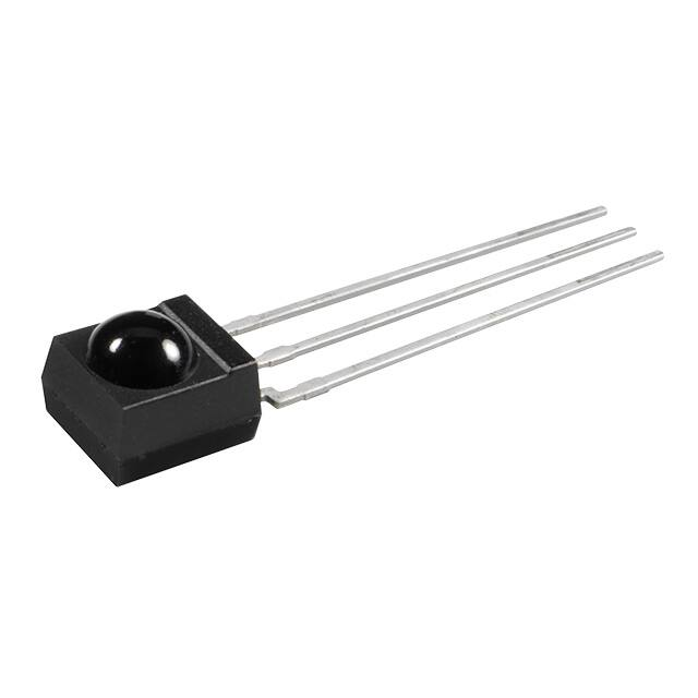

TSOP182.., TSOP184.., TSOP186.. www.vishay.com Vishay Semiconductors IR Receiver Modules for Remote Control Systems FEATURES • Improved dark sensitivity • Improved immunity against optical noise • Improved immunity against Wi-Fi noise • Low supply current • Photo detector and preamplifier in one package • Internal filter for PCM frequency 1 • Supply voltage: 2.5 V to 5.5 V 2 3 • Insensitive to supply voltage ripple and noise 19026 • Material categorization: for definitions of compliance please see www.vishay.com/doc?99912 LINKS TO ADDITIONAL RESOURCES 3D 3D Product Page 3D Models Calculators Marking MECHANICAL DATA Packages Pinning for TSOP18...: 1 = OUT, 2 = GND, 3 = VS Bends and Cuts ORDERING CODE DESCRIPTION TSOP18... - 1500 pieces in bags The TSOP18... series devices are the latest generation miniaturized IR receiver modules for infrared remote control systems. This series provides improvements in sensitivity to remote control signals in dark ambient as well as in sensitivity in the presence of optical disturbances e.g. from CFLs. The robustness against spurious pulses originating from Wi-Fi signals has been enhanced. BLOCK DIAGRAM 16833-13 3 30 kΩ The devices contain a PIN diode and a preamplifier assembled on a lead frame. The epoxy package contains an IR filter. The demodulated output signal can be directly connected to a microprocessor for decoding. 1 Input The TSOP182.., TSOP184.., and TSOP186.. series devices are designed to receive long burst codes (10 or more carrier cycles per burst). The third digit designates the AGC level (AGC2, AGC4, or AGC6) and the last two digits designate the band-pass frequency (see table below). The higher the AGC, the better noise is suppressed, but the lower the code compatibility. AGC2 provides basic noise suppression, AGC4 provides enhanced noise suppression and AGC6 provides maximized noise suppression. Generally, we advise to select the highest AGC that satisfactorily receives the desired remote code. Band pass AGC Demodulator 2 PIN Control circuit APPLICATION CIRCUIT 17170-11 Transmitter with TSALxxxx These components have not been qualified to automotive specifications. R1 IR receiver VS Circuit Holders + VS C1 μC OUT GND VO GND R1 and C1 recommended to reduce supply ripple for VS < 2.8 V Rev. 1.7, 09-Aug-2021 1 Document Number: 82739 THIS DOCUMENT IS SUBJECT TO CHANGE WITHOUT NOTICE. THE PRODUCTS DESCRIBED HEREIN AND THIS DOCUMENT ARE SUBJECT TO SPECIFIC DISCLAIMERS, SET FORTH AT www.vishay.com/doc?91000 TSOP182.., TSOP184.., TSOP186.. www.vishay.com Vishay Semiconductors PARTS TABLE BASIC NOISE SUPPRESSION (AGC2) ENHANCED NOISE SUPPRESSION (AGC4) MAXIMIZED NOISE SUPPRESSION (AGC6) 30 kHz TSOP18230 TSOP18430 TSOP18630 33 kHz TSOP18233 TSOP18433 TSOP18633 36 kHz TSOP18236 TSOP18436 (2)(5)(7) TSOP18636 (6) AGC Carrier frequency 38 kHz TSOP18238 TSOP18438 (3)(4)(10)(11) TSOP18638 40 kHz TSOP18240 (12) TSOP18440 TSOP18640 56 kHz TSOP18256 (1) TSOP18456 (9) TSOP18656 (8) Package Minicast Pinning 1 = OUT, 2 = GND, 3 = VS Dimensions (mm) 5.0 W x 6.95 H x 4.8 D Mounting Leaded Application Remote control (1) Best choice for Cisco (2) MCIR (3) Mitsubishi (4) NEC (5) Panasonic (6) RC-5 (7) (8) RCA (9) r-step (10) Sejin 4PPM (11) Sharp (12) Sony RC-6 Note • 30 kHz and 33 kHz only available on written request ABSOLUTE MAXIMUM RATINGS PARAMETER TEST CONDITION SYMBOL VALUE UNIT Supply voltage VS -0.3 to +6 V Supply current IS 3 mA Output voltage VO -0.3 to (VS + 0.3) V Output current IO 5 mA Junction temperature Storage temperature range Operating temperature range Power consumption Soldering temperature Tj 100 °C Tstg -25 to +85 °C Tamb -25 to +85 °C Tamb ≤ 85 °C Ptot 10 mW t ≤ 10 s, 1 mm from case Tsd 260 °C Note • Stresses beyond those listed under “Absolute Maximum Ratings” may cause permanent damage to the device. This is a stress rating only and functional operation of the device at these or any other conditions beyond those indicated in the operational sections of this specification is not implied. Exposure to absolute maximum rating conditions for extended periods may affect the device reliability ELECTRICAL AND OPTICAL CHARACTERISTICS (Tamb = 25 °C, unless otherwise specified) PARAMETER TEST CONDITION SYMBOL MIN. TYP. MAX. UNIT Ev = 0, VS = 3.3 V ISD 0.55 0.7 0.9 mA Ev = 40 klx, sunlight ISH - 0.8 - mA VS 2.5 - 5.5 V Transmission distance Ev = 0, test signal see Fig. 1, IR diode TSAL6200, IF = 50 mA d - 24 - m Output voltage low IOSL = 0.5 mA, Ee = 0.7 mW/m2, test signal see Fig. 1 VOSL - - 100 mV Minimum irradiance Pulse width tolerance: tpi - 3.5/f0 < tpo < tpi + 3.5/f0, test signal see Fig. 1 Ee min. - 0.12 0.25 mW/m2 Maximum irradiance tpi - 3.5/f0 < tpo < tpi + 3.5/f0, test signal see Fig. 1 Ee max. 30 - - W/m2 Angle of half transmission distance ϕ1/2 - ± 45 - ° Supply current Supply voltage Directivity Rev. 1.7, 09-Aug-2021 2 Document Number: 82739 THIS DOCUMENT IS SUBJECT TO CHANGE WITHOUT NOTICE. THE PRODUCTS DESCRIBED HEREIN AND THIS DOCUMENT ARE SUBJECT TO SPECIFIC DISCLAIMERS, SET FORTH AT www.vishay.com/doc?91000 TSOP182.., TSOP184.., TSOP186.. www.vishay.com Vishay Semiconductors TYPICAL CHARACTERISTICS (Tamb = 25 °C, unless otherwise specified) Axis Title Optical Test Signal (IR diode TSAL6200, IF = 0.1 A, 30 pulses, f = f0, t = 10 ms) (1) VO VOH VOL (1) T AGC4: tpi ≥ 10/f0, AGC2, AGC6: tpi ≥ 19/f0 Output Signal (2) AGC4: 8/f0 < td < 14/f0 AGC2, AGC 6: 14/f0 < td < 20/f0 (3) tpi - 3.5/f0 < tpo < tpi + 3.5/f0 td (2) 16110-15 ton 0.7 0.6 1000 0.5 toff 1st line 2nd line t tpi 10000 0.8 2nd line ton, toff - Output Pulse Width (ms) Ee 0.4 0.3 100 0.2 0.1 λ = 950 nm, optical test signal, Fig. 3 0 tpo (3) 0.1 t 1 10 100 1000 10 10 000 Ee - Irradiance (mW/m2) Fig. 4 - Pulse-Width vs. Irradiance in Dark Ambient Fig. 1 - Output Delay and Pulse-Width Axis Title Axis Title 10000 0.90 10000 1.2 1000 0.75 1st line 2nd line 0.80 Input burst length 100 0.70 0.65 λ = 950 nm, optical test signal, Fig. 1 10 100 000 0.60 0.1 1000 1000 0.8 0.6 100 0.4 f = f0 ± 5 % 0.2 10 0 0.7 0.9 1.1 1.3 Ee - Irradiance (mW/m2) f/f0 - Relative Frequency Fig. 2 - Pulse-Width vs. Irradiance in Dark Ambient Fig. 5 - Frequency Dependence of Responsivity Axis Title Optical Test Signal 600 µs 4 t 600 µs t = 60 ms VO 1.0 94 8134 Output Signal, (see Fig. 4) VOH VOL t on t off 3 Wavelength of ambient illumination: λ = 950 nm 1000 2 100 1 0 0.01 t 10 0.1 1 10 100 Ee - Ambient DC Irradiance (W/m2) Fig. 6 - Sensitivity in Bright Ambient Fig. 3 - Test Signal Rev. 1.7, 09-Aug-2021 10000 Correlation with ambient light sources: 10 W/m2 = 1.4 klx (std. ilum. A, T = 2855 K) 10 W/m2 = 8.2 klx (daylight, T = 5900 K) 1st line 2nd line Ee 10 2nd line Ee min. - Threshold Irradiance (mW/m2) 2nd line tpo - Output Pulse Width (ms) 0.85 1st line 2nd line 2nd line Ee min./Ee - Relative Responsivity Output pulse width 3 Document Number: 82739 THIS DOCUMENT IS SUBJECT TO CHANGE WITHOUT NOTICE. THE PRODUCTS DESCRIBED HEREIN AND THIS DOCUMENT ARE SUBJECT TO SPECIFIC DISCLAIMERS, SET FORTH AT www.vishay.com/doc?91000 TSOP182.., TSOP184.., TSOP186.. www.vishay.com Vishay Semiconductors Axis Title Axis Title 10000 0.7 f = f0 f = 30 kHz f = 10 kHz f = 100 Hz 0.5 0.4 1000 0.3 100 0.2 0.1 10 1000 0 1 10 100 0.15 1000 0.1 100 0.05 10 0 -30 -10 10 70 90 Tamb - Ambient Temperature (°C) Fig. 7 - Sensitivity vs. Supply Voltage Disturbances Fig. 9 - Sensitivity vs. Ambient Temperature Axis Title Axis Title 1.0 2nd line S(λ)rel. - Relative Spectral Sensitivity f = 38 kHz, Ee = 2 mW/m2 0.8 0.7 1000 TSOP182.. 1st line 2nd line 0.6 0.5 TSOP186.. 0.4 100 0.3 TSOP184.. 0.2 0.1 10 0 0 20 40 60 80 100 120 10000 0.9 0.8 0.7 1000 0.6 1st line 2nd line 10000 0.9 2nd line Maximum Envelope Duty Cycle 50 ∆VS RMS - AC Voltage on DC Supply Voltage (mV) 1.0 0.5 0.4 100 0.3 0.2 0.1 0 750 140 850 950 1050 10 1150 Burst Length (Number of Cycles/Burst) λ - Wavelength (nm) Fig. 8 - Max. Envelope Duty Cycle vs. Burst Length Fig. 10 - Relative Spectral Sensitivity vs. Wavelength Axis0° Title 10° 20° Axis0° Title 10° 30° 40° 50° 0.8 2nd line Vertical 0.9 20° 30° 40° 1.0 2nd line 2nd line 1.0 2nd line Horizontal 30 0.9 50° 0.8 60° 60° 70° 0.7 70° 0.7 80° 0.6 0.4 0.2 0 0.2 0.4 2nd line 2nd line 0.6 10000 1st line 2nd line 2nd line Ee min. - Threshold Irradiance (mW/m2) 0.2 1st line 2nd line 2nd line Ee min. - Threshold Irradiance (mW/m2) 0.8 80° 0.6 0.6 drel. - Relative Transmission Distance 0.4 0.2 0 0.2 0.4 0.6 drel. - Relative Transmission Distance Fig. 11 - Horizontal and Vertical Directivity Rev. 1.7, 09-Aug-2021 4 Document Number: 82739 THIS DOCUMENT IS SUBJECT TO CHANGE WITHOUT NOTICE. THE PRODUCTS DESCRIBED HEREIN AND THIS DOCUMENT ARE SUBJECT TO SPECIFIC DISCLAIMERS, SET FORTH AT www.vishay.com/doc?91000 TSOP182.., TSOP184.., TSOP186.. www.vishay.com Vishay Semiconductors Axis Title 10000 0.15 1000 1st line 2nd line 2nd line Ee min. - Threshold Irradiance (mW/m2) 0.2 0.1 100 0.05 10 0 1.5 2.5 3.5 4.5 5.5 VS - Supply Voltage (V) Fig. 12 - Sensitivity vs. Supply Voltage Rev. 1.7, 09-Aug-2021 5 Document Number: 82739 THIS DOCUMENT IS SUBJECT TO CHANGE WITHOUT NOTICE. THE PRODUCTS DESCRIBED HEREIN AND THIS DOCUMENT ARE SUBJECT TO SPECIFIC DISCLAIMERS, SET FORTH AT www.vishay.com/doc?91000 TSOP182.., TSOP184.., TSOP186.. www.vishay.com Vishay Semiconductors SUITABLE DATA FORMAT Axis Title This series is designed to suppress spurious output pulses due to noise or disturbance signals. The devices can distinguish data signals from noise due to differences in frequency, burst length, and envelope duty cycle. The data signal should be close to the device’s band-pass center frequency (e.g. 38 kHz) and fulfill the conditions in the table below. 10000 7 When a data signal is applied to the product in the presence of a disturbance, the sensitivity of the receiver is automatically reduced by the AGC to insure that no spurious pulses are present at the receiver’s output. 5 1000 1st line 2nd line 2nd line IR Signal Amplitude 6 4 3 100 2 1 Some examples which are suppressed are: 10 0 • DC light (e.g. from tungsten bulbs sunlight) 0 • Continuous signals at any frequency 5 15 20 Time (ms) 16920 • Strongly or weakly modulated patterns from fluorescent lamps with electronic ballasts (see Fig. 13 or Fig. 14) 10 Fig. 13 - IR Disturbance from Fluorescent Lamp With Low Modulation • 2.4 GHz and 5 GHz Wi-Fi Axis Title 10000 40 1000 0 1st line 2nd line 2nd line IR Signal Amplitude 20 -20 100 -40 10 -60 0 5 10 15 20 Time (ms) 16921 Fig. 14 - IR Disturbance from Fluorescent Lamp With High Modulation TSOP182.. TSOP184.. TSOP186.. Minimum burst length 19 cycles/burst 10 cycles/burst 19 cycles/burst After each burst of length a minimum gap time is required of 19 to 85 cycles ≥ 19 cycles 10 to 40 cycles ≥ 12 cycles 19 to 50 cycles ≥ 19 cycles 85 cycles > 6 x burst length 40 cycles > 10 x burst length 50 cycles > 10 x burst length For bursts greater than a minimum gap time in the data stream is needed of Maximum number of continuous short bursts/second 800 1300 800 RC-5 code Yes Preferred Preferred RC-6 code Yes Preferred Yes NEC code Yes Preferred Yes r-step code Yes Preferred Yes Sony code Preferred No No Yes Yes Preferred Fig. 13 Fig. 13 and Fig. 14 Fig. 13 and Fig. 14 RCA 56 kHz code Suppression of interference from fluorescent lamps Note • For data formats with short bursts please see the datasheet for TSOP181.., TSOP183.., TSOP185.. Rev. 1.7, 09-Aug-2021 6 Document Number: 82739 THIS DOCUMENT IS SUBJECT TO CHANGE WITHOUT NOTICE. THE PRODUCTS DESCRIBED HEREIN AND THIS DOCUMENT ARE SUBJECT TO SPECIFIC DISCLAIMERS, SET FORTH AT www.vishay.com/doc?91000 TSOP182.., TSOP184.., TSOP186.. www.vishay.com Vishay Semiconductors PACKAGE DIMENSIONS in millimeters 5 4.8 (4) 2.8 (5.55) 6.95 ± 0.3 8.25 ± 0.3 R2 0.9 1.1 30.5 ± 0.5 (1.54) 0.85 max. 0.7 max. 2.54 nom. 2.54 nom. 0.5 max. 1.2 ± 0.2 Marking area technical drawings according to DIN specifications Not indicated to lerances ± 0.2 Drawing-No.: 6.550-5263.01-4 Issue: 12; 16.04.10 19009 Rev. 1.7, 09-Aug-2021 R2 7 Document Number: 82739 THIS DOCUMENT IS SUBJECT TO CHANGE WITHOUT NOTICE. THE PRODUCTS DESCRIBED HEREIN AND THIS DOCUMENT ARE SUBJECT TO SPECIFIC DISCLAIMERS, SET FORTH AT www.vishay.com/doc?91000 Legal Disclaimer Notice www.vishay.com Vishay Disclaimer ALL PRODUCT, PRODUCT SPECIFICATIONS AND DATA ARE SUBJECT TO CHANGE WITHOUT NOTICE TO IMPROVE RELIABILITY, FUNCTION OR DESIGN OR OTHERWISE. Vishay Intertechnology, Inc., its affiliates, agents, and employees, and all persons acting on its or their behalf (collectively, “Vishay”), disclaim any and all liability for any errors, inaccuracies or incompleteness contained in any datasheet or in any other disclosure relating to any product. Vishay makes no warranty, representation or guarantee regarding the suitability of the products for any particular purpose or the continuing production of any product. To the maximum extent permitted by applicable law, Vishay disclaims (i) any and all liability arising out of the application or use of any product, (ii) any and all liability, including without limitation special, consequential or incidental damages, and (iii) any and all implied warranties, including warranties of fitness for particular purpose, non-infringement and merchantability. Statements regarding the suitability of products for certain types of applications are based on Vishay's knowledge of typical requirements that are often placed on Vishay products in generic applications. Such statements are not binding statements about the suitability of products for a particular application. It is the customer's responsibility to validate that a particular product with the properties described in the product specification is suitable for use in a particular application. Parameters provided in datasheets and / or specifications may vary in different applications and performance may vary over time. All operating parameters, including typical parameters, must be validated for each customer application by the customer's technical experts. Product specifications do not expand or otherwise modify Vishay's terms and conditions of purchase, including but not limited to the warranty expressed therein. Hyperlinks included in this datasheet may direct users to third-party websites. These links are provided as a convenience and for informational purposes only. Inclusion of these hyperlinks does not constitute an endorsement or an approval by Vishay of any of the products, services or opinions of the corporation, organization or individual associated with the third-party website. Vishay disclaims any and all liability and bears no responsibility for the accuracy, legality or content of the third-party website or for that of subsequent links. Except as expressly indicated in writing, Vishay products are not designed for use in medical, life-saving, or life-sustaining applications or for any other application in which the failure of the Vishay product could result in personal injury or death. Customers using or selling Vishay products not expressly indicated for use in such applications do so at their own risk. Please contact authorized Vishay personnel to obtain written terms and conditions regarding products designed for such applications. No license, express or implied, by estoppel or otherwise, to any intellectual property rights is granted by this document or by any conduct of Vishay. Product names and markings noted herein may be trademarks of their respective owners. © 2021 VISHAY INTERTECHNOLOGY, INC. ALL RIGHTS RESERVED Revision: 09-Jul-2021 1 Document Number: 91000
TSOP18236
- 物料型号:TSOP182.., TSOP184.., TSOP186.. - 器件简介:这些是为红外遥控系统设计的最新一代微型红外接收模块,具有改进的暗环境灵敏度和对光学干扰的鲁棒性。 - 引脚分配:1=OUT, 2=GND, 3=Vs - 参数特性: - 工作电压:2.5 V至5.5 V - 低供电电流 - 内部PCM频率滤波器 - 对电源电压波动和噪声不敏感 - 功能详解:包含PIN二极管和前置放大器,封装内含红外滤波器,解调后的输出信号可直接连接到微处理器进行解码。 - 应用信息:设计用于接收长脉冲码(每个脉冲至少10个载波周期),适用于远程控制。 - 封装信息:Minicast封装,尺寸为5.0mm宽x6.95mm高x4.8mm深,引线式安装。
