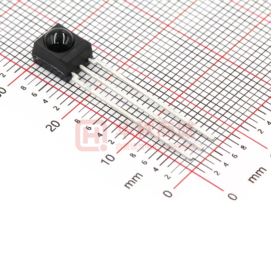

TSOP321.., TSOP323.., TSOP325.., TSOP341.., TSOP343.., www.vishay.com Vishay Semiconductors IR Receiver Modules for Remote Control Systems FEATURES • Very low supply current • Photo detector and preamplifier in one package • Internal filter for PCM frequency • Improved shielding against EMI • Supply voltage: 2.5 V to 5.5 V • Improved immunity against ambient light • Insensitive to supply voltage ripple and noise 1 2 3 • Material categorization: for definitions of compliance please see www.vishay.com/doc?99912 16672 LINKS TO ADDITIONAL RESOURCES 3D 3D Product Page 3D Models Calculators Marking MECHANICAL DATA Packages Pinning for TSOP341.., TSOP343.., TSOP345..: 1 = OUT, 2 = GND, 3 = VS Holders Bends and Cuts Pinning for TSOP321.., TSOP323.., TSOP325..: 1 = OUT, 2 = VS, 3 = GND DESCRIPTION ORDERING CODE These products are miniaturized receivers for infrared remote control systems. A PIN diode and a preamplifier are assembled on a lead frame, the epoxy package contains an IR filter. The demodulated output signal can be directly connected to a microprocessor for decoding. TSOP3.... - 2160 pieces in tubes BLOCK DIAGRAM The TSOP323.., TSOP343..series devices are optimized to suppress almost all spurious pulses from energy saving lamps like CFLs. AGC3 may also suppress some data signals if continuously transmitted. VS 30 kΩ OUT The TSOP321.., TSOP341.. series are provided primarily for compatibility with old AGC1 designs. New designs should prefer the TSOP323.., TSOP343.. series containing the newer AGC3. The TSOP325.., TSOP345.. series contain a very robust AGC5. This series should only be used for critically noisy environments. Input Band pass AGC Demodulator GND PIN These components have not been qualified according to automotive specifications. Control circuit 16833-22 APPLICATION CIRCUIT 17170-11 R1 IR receiver VS Circuit Transmitter with TSALxxxx + VS C1 μC OUT GND VO GND R1 and C1 recommended to reduce supply ripple for VS < 2.8 V Rev. 2.2, 14-Dec-2021 1 Document Number: 82490 THIS DOCUMENT IS SUBJECT TO CHANGE WITHOUT NOTICE. THE PRODUCTS DESCRIBED HEREIN AND THIS DOCUMENT ARE SUBJECT TO SPECIFIC DISCLAIMERS, SET FORTH AT www.vishay.com/doc?91000 TSOP321.., TSOP323.., TSOP325.., TSOP341.., TSOP343.., www.vishay.com Vishay Semiconductors PARTS TABLE LEGACY, FOR SHORT BURST REMOTE CONTROLS (AGC1) AGC Carrier frequency NOISY ENVIRONMENTS AND SHORT BURSTS (AGC3) VERY NOISY ENVIRONMENTS AND SHORT BURSTS (AGC5) 30 kHz TSOP34130 TSOP32130 TSOP34330 TSOP32330 TSOP34530 TSOP32530 33 kHz TSOP34133 TSOP32133 TSOP34333 TSOP32333 TSOP34533 TSOP32533 36 kHz TSOP34136 TSOP32136 TSOP34336 (1)(6) TSOP32336 (1) TSOP34536 TSOP32536 38 kHz TSOP34138 TSOP32138 TSOP34338 TSOP32338 (2)(3)(4)(5) (2)(3)(4)(5) TSOP34538 TSOP32538 40 kHz TSOP34140 TSOP32140 TSOP34340 TSOP32340 TSOP34540 TSOP32540 56 kHz TSOP34156 TSOP32156 TSOP34356 TSOP32356 TSOP34556 TSOP32556 Package Pinning Mold 1 = OUT, 1 = OUT, 2 = VS, 2 = GND, 3 = VS 3 = GND 1 = OUT, 2 = GND, 3 = VS Dimensions (mm) 1 = OUT, 1 = OUT, 2 = VS, 2 = GND, 3 = VS 3 = GND 6.0 W x 6.95 H x 5.6 D Mounting Leaded Application Remote control (1) Best choice for Special options 1 = OUT, 2 = VS, 3 = GND MCIR (2) Mitsubishi (3) RECS-80 Code (4) r-map (5) XMP-1, XMP-2 (6) RCMM • Narrow optical filter: www.vishay.com/doc?81590 • Wide optical filter: www.vishay.com/doc?82726 • Low voltage option: www.vishay.com/doc?82382 ABSOLUTE MAXIMUM RATINGS PARAMETER SYMBOL VALUE Supply voltage TEST CONDITION VS -0.3 to +6 V Supply current IS 3 mA Output voltage VO -0.3 to (VS + 0.3) V Output current IO 5 mA Junction temperature Storage temperature range Operating temperature range Power consumption Soldering temperature UNIT Tj 100 °C Tstg -25 to +85 °C Tamb -25 to +85 °C Tamb ≤ 85 °C Ptot 10 mW t ≤ 10 s, 1 mm from case Tsd 260 °C Note • Stresses beyond those listed under “Absolute Maximum Ratings” may cause permanent damage to the device. This is a stress rating only and functional operation of the device at these or any other conditions beyond those indicated in the operational sections of this specification is not implied. Exposure to absolute maximum rating conditions for extended periods may affect the device reliability ELECTRICAL AND OPTICAL CHARACTERISTICS (Tamb = 25 °C, unless otherwise specified) PARAMETER Supply current TEST CONDITION SYMBOL MIN. TYP. MAX. Ev = 0, VS = 3.3 V ISD 0.27 0.35 0.45 mA Ev = 40 klx, sunlight ISH - 0.45 - mA VS 2.5 - 5.5 V d - 30 - m VOSL - - 100 mV Supply voltage Transmission distance Output voltage low Ev = 0, test signal see Fig. 1, IR diode TSAL6200, IF = 50 mA mW/m2, IOSL = 0.5 mA, Ee = 0.7 test signal see Fig. 1 UNIT Minimum irradiance Pulse width tolerance: tpi - 5/fo < tpo < tpi + 6/fo, test signal see Fig. 1 Ee min. - 0.08 0.15 mW/m2 Maximum irradiance tpi - 5/fo < tpo < tpi + 6/fo, test signal see Fig. 1 Ee max. 30 - - W/m2 Directivity Angle of half transmission distance ϕ1/2 - ± 45 - ° Rev. 2.2, 14-Dec-2021 2 Document Number: 82490 THIS DOCUMENT IS SUBJECT TO CHANGE WITHOUT NOTICE. THE PRODUCTS DESCRIBED HEREIN AND THIS DOCUMENT ARE SUBJECT TO SPECIFIC DISCLAIMERS, SET FORTH AT www.vishay.com/doc?91000 TSOP321.., TSOP323.., TSOP325.., TSOP341.., TSOP343.., www.vishay.com Vishay Semiconductors TYPICAL CHARACTERISTICS (Tamb = 25 °C, unless otherwise specified) 0.8 t tpi *) T *) tpi ≥ 6/f0 is recommended for optimal function Output Signal VO 14337 1) 3/f0 < td < 9/f0 2) tpi - 4/f0 < tpo < tpi + 6/f0 VOH VOL td 1) tpo ton ton, toff - Output Pulse Width (ms) Optical Test Signal (IR diode TSAL6200, IF = 0.4 A, N = 6 pulses, f = f0, t = 10 ms) Ee 0.7 0.6 0.5 toff 0.4 0.3 0.2 0 0.1 t 2) λ = 950 nm, optical test signal, fig. 3 0.1 20744 Ee min./Ee - Relative Responsivity tpo - Output Pulse Width (ms) 0.35 0.30 Output pulse width 0.20 0.15 Input burst length 0.10 λ = 950 nm, optical test signal, Fig. 1 10 000 1.0 0.8 0.6 0.4 f = f0 ± 5 % Δf(3 dB) = f0/10 0.2 0.0 1 10 100 1000 10 000 0.7 Ee - Irradiance (mW/m²) 20760 Ee min. - Threshold Irradiance (mW/m²) t 600 µs t = 60 ms 94 8134 Output Signal, (see Fig. 4) VOH VOL t on t off 1.3 4.0 Correlation with ambient light sources: 3.5 10 W/m² = 1.4 klx (std. illum. A, T = 2855 K) 10 W/m² = 8.2 klx (daylight, T = 5900 K) 3.0 2.5 1.5 1.0 0.5 0 0.01 t Fig. 3 - Output Function Wavelength of ambient illumination: λ = 950 nm 2.0 20745 Rev. 2.2, 14-Dec-2021 1.1 Fig. 5 - Frequency Dependence of Responsivity Optical Test Signal 600 µs 0.9 f/f0 - Relative Frequency 16925 Fig. 2 - Pulse Length and Sensitivity in Dark Ambient VO 1000 1.2 0 0.1 Ee 100 Fig. 4 - Output Pulse Diagram 0.40 0.05 10 Ee - Irradiance (mW/m²) Fig. 1 - Output Active Low 0.25 1 0.1 1 10 100 Ee - Ambient DC Irradiance (W/m²) Fig. 6 - Sensitivity in Bright Ambient 3 Document Number: 82490 THIS DOCUMENT IS SUBJECT TO CHANGE WITHOUT NOTICE. THE PRODUCTS DESCRIBED HEREIN AND THIS DOCUMENT ARE SUBJECT TO SPECIFIC DISCLAIMERS, SET FORTH AT www.vishay.com/doc?91000 TSOP321.., TSOP323.., TSOP325.., TSOP341.., TSOP343.., www.vishay.com Vishay Semiconductors Axis Title 1.0 2.5 2.0 f = f0 f = 30 kHz f = 10 kHz f = 100 Hz 1.5 1.0 0.5 0 1 10 100 1000 10000 0.9 0.8 0.7 1000 0.6 1st line 2nd line 2nd line S(λ)rel. - Relative Spectral Sensitivity Ee min. - Threshold Irradiance (mW/m2) 3.0 0.5 0.4 100 0.3 0.2 0.1 750 850 Fig. 7 - Sensitivity vs. Supply Voltage Disturbances 950 1050 λ - Wavelength (nm) 23180 Fig. 10 - Relative Spectral Sensitivity vs. Wavelength 0° 1.0 10° 20° 30° f = 38 kHz, Ee = 2 mW/m² 0.9 Max. Envelope Duty Cycle 10 1150 0 ΔVS RMS - AC Voltage on DC Supply Voltage (mV) 0.8 0.7 40° 0.6 1.0 TSOP341.. TSOP321.. 0.5 0.9 50° 0.8 60° 0.4 0.3 TSOP343.., TSOP323.. 0.2 70° 0.7 80° 0.1 TSOP345.., TSOP325.. 0 0 22180-8 20 40 60 80 100 120 0.6 Burst Length (Number of Cycles/Burst) 0.2 0 Fig. 11 - Horizontal Directivity 0.20 0.20 0.18 0.18 Ee min. - Sensitivity (mW/m2) Ee min. - Threshold Irradiance (mW/m2) Fig. 8 - Maximum Envelope Duty Cycle vs. Burst Length 0.4 drel - Relative Transmission Distance 96 12223p2 0.16 0.14 0.12 0.10 0.08 0.06 0.04 0.02 0.16 0.14 0.12 0.10 0.08 0.06 0.04 0.02 0.00 0 -30 -10 10 30 50 70 1 90 Fig. 9 - Sensitivity vs. Ambient Temperature Rev. 2.2, 14-Dec-2021 2 3 4 5 VS - Supply Voltage (V) Tamb - Ambient Temperature (°C) Fig. 12 - Sensitivity vs. Supply Voltage 4 Document Number: 82490 THIS DOCUMENT IS SUBJECT TO CHANGE WITHOUT NOTICE. THE PRODUCTS DESCRIBED HEREIN AND THIS DOCUMENT ARE SUBJECT TO SPECIFIC DISCLAIMERS, SET FORTH AT www.vishay.com/doc?91000 TSOP321.., TSOP323.., TSOP325.., TSOP341.., TSOP343.., www.vishay.com Vishay Semiconductors SUITABLE DATA FORMAT Axis Title This series is designed to suppress spurious output pulses due to noise or disturbance signals. The devices can distinguish data signals from noise due to differences in frequency, burst length, and envelope duty cycle. The data signal should be close to the device’s band-pass center frequency (e.g. 38 kHz) and fulfill the conditions in the table below. 10000 7 When a data signal is applied to the product in the presence of a disturbance, the sensitivity of the receiver is automatically reduced by the AGC to insure that no spurious pulses are present at the receiver’s output. Some examples which are suppressed are: 5 1000 1st line 2nd line 2nd line IR Signal Amplitude 6 4 3 100 2 1 • DC light (e.g. from tungsten bulbs sunlight) 10 0 0 • Continuous signals at any frequency 5 15 20 Time (ms) 16920 • Strongly or weakly modulated patterns from fluorescent lamps with electronic ballasts (see Fig. 13 or Fig. 14). 10 Fig. 13 - IR Disturbance from Fluorescent Lamp With Low Modulation Axis Title 10000 40 1000 0 1st line 2nd line 2nd line IR Signal Amplitude 20 -20 100 -40 10 -60 0 5 10 15 20 Time (ms) 16921 Fig. 14 - IR Disturbance from Fluorescent Lamp With High Modulation TSOP341.., TSOP321.. TSOP343.., TSOP323.. TSOP345.., TSOP325.. Minimum burst length 6 cycles/burst 6 cycles/burst 6 cycles/burst After each burst of length A gap time is required of 6 to 70 cycles ≥ 10 cycles 6 to 35 cycles ≥ 10 cycles 6 to 24 cycles ≥ 10 cycles For bursts greater than a minimum gap time in the data stream is needed of 70 cycles 35 cycles 24 cycles > 1.2 x burst length > 6 x burst length > 25 ms Maximum number of continuous short bursts/second 2000 2000 2000 MCIR code Yes Preferred Yes XMP-1, XMP-2 code Yes Preferred Yes Mild disturbance patterns are suppressed (example: signal pattern of Fig. 13) Complex disturbance patterns are suppressed (example: signal pattern of Fig. 14) Critical disturbance patterns are suppressed, e.g. highly dimmed LCDs Suppression of interference from fluorescent lamps Notes • For data formats with long bursts (more than 10 carrier cycles) please see the datasheet for TSOP348.., TSOP344.., TSOP322.., TSOP324.. Rev. 2.2, 14-Dec-2021 5 Document Number: 82490 THIS DOCUMENT IS SUBJECT TO CHANGE WITHOUT NOTICE. THE PRODUCTS DESCRIBED HEREIN AND THIS DOCUMENT ARE SUBJECT TO SPECIFIC DISCLAIMERS, SET FORTH AT www.vishay.com/doc?91000 TSOP321.., TSOP323.., TSOP325.., TSOP341.., TSOP343.., www.vishay.com Vishay Semiconductors PACKAGE DIMENSIONS in millimeters 3.9 1 1 30.5 ± 0.5 (5.55) 8.25 6.95 5.3 6 0.85 max. 0.89 0.5 max. 2.54 nom. 1.3 0.7 max. 4.1 2.54 nom. 5.6 marking area Not indicated tolerances ± 0.2 technical drawings according to DIN specifications R 2.5 Drawing-No.: 6.550-5169.01-4 Issue: 9; 03.11.10 13655 Rev. 2.2, 14-Dec-2021 6 Document Number: 82490 THIS DOCUMENT IS SUBJECT TO CHANGE WITHOUT NOTICE. THE PRODUCTS DESCRIBED HEREIN AND THIS DOCUMENT ARE SUBJECT TO SPECIFIC DISCLAIMERS, SET FORTH AT www.vishay.com/doc?91000 Legal Disclaimer Notice www.vishay.com Vishay Disclaimer ALL PRODUCT, PRODUCT SPECIFICATIONS AND DATA ARE SUBJECT TO CHANGE WITHOUT NOTICE TO IMPROVE RELIABILITY, FUNCTION OR DESIGN OR OTHERWISE. Vishay Intertechnology, Inc., its affiliates, agents, and employees, and all persons acting on its or their behalf (collectively, “Vishay”), disclaim any and all liability for any errors, inaccuracies or incompleteness contained in any datasheet or in any other disclosure relating to any product. Vishay makes no warranty, representation or guarantee regarding the suitability of the products for any particular purpose or the continuing production of any product. To the maximum extent permitted by applicable law, Vishay disclaims (i) any and all liability arising out of the application or use of any product, (ii) any and all liability, including without limitation special, consequential or incidental damages, and (iii) any and all implied warranties, including warranties of fitness for particular purpose, non-infringement and merchantability. Statements regarding the suitability of products for certain types of applications are based on Vishay's knowledge of typical requirements that are often placed on Vishay products in generic applications. Such statements are not binding statements about the suitability of products for a particular application. It is the customer's responsibility to validate that a particular product with the properties described in the product specification is suitable for use in a particular application. Parameters provided in datasheets and / or specifications may vary in different applications and performance may vary over time. All operating parameters, including typical parameters, must be validated for each customer application by the customer's technical experts. Product specifications do not expand or otherwise modify Vishay's terms and conditions of purchase, including but not limited to the warranty expressed therein. Hyperlinks included in this datasheet may direct users to third-party websites. These links are provided as a convenience and for informational purposes only. Inclusion of these hyperlinks does not constitute an endorsement or an approval by Vishay of any of the products, services or opinions of the corporation, organization or individual associated with the third-party website. Vishay disclaims any and all liability and bears no responsibility for the accuracy, legality or content of the third-party website or for that of subsequent links. Except as expressly indicated in writing, Vishay products are not designed for use in medical, life-saving, or life-sustaining applications or for any other application in which the failure of the Vishay product could result in personal injury or death. Customers using or selling Vishay products not expressly indicated for use in such applications do so at their own risk. Please contact authorized Vishay personnel to obtain written terms and conditions regarding products designed for such applications. No license, express or implied, by estoppel or otherwise, to any intellectual property rights is granted by this document or by any conduct of Vishay. Product names and markings noted herein may be trademarks of their respective owners. © 2022 VISHAY INTERTECHNOLOGY, INC. ALL RIGHTS RESERVED Revision: 01-Jan-2022 1 Document Number: 91000
TSOP34138
物料型号:TSOP321系列、TSOP323系列、TSOP325系列、TSOP341系列、TSOP343系列。
器件简介:这些产品是用于红外遥控系统的微型接收器,集成了PIN二极管和前置放大器,并在一个环氧树脂封装内含有红外滤波器。解调后的输出信号可以直接连接到微处理器进行解码。
引脚分配: - TSOP341系列、TSOP343系列、TSOP345系列:1=OUT, 2=GND, 3=Vs - TSOP321系列、TSOP323系列、TSOP325系列:1=OUT, 2=Vs, 3=GND
参数特性: - 供应电流:3mA - 输出电压:-0.3至(Vs+0.3)伏 - 输出电流:5mA - 结温:100℃ - 存储温度范围:-25至+85℃ - 工作温度范围:-25至+85℃ - 功耗:在85°C时为10mW - 焊接温度:260℃
功能详解:文档提供了接收模块的工作原理、电气特性、光学特性、典型特性和应用电路图。
应用信息:适用于遥控系统,特别是与特定编码格式(如MCIR、XMP-1、XMP-2)兼容的遥控。
封装信息:提供了封装的尺寸和安装信息。
