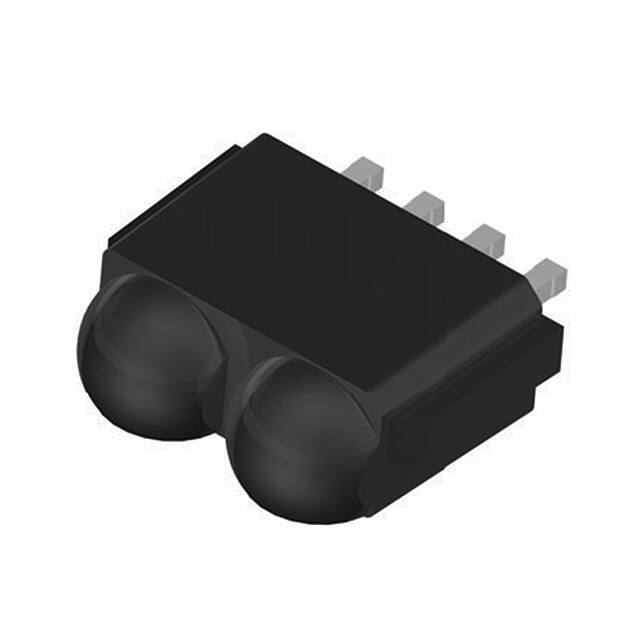

TSOP393..TR1, TSOP395..TR1 www.vishay.com Vishay Semiconductors IR Receiver Modules for Remote Control Systems FEATURES • Very low supply current • Photo detector and preamplifier in one package 4 • Internal filter for PCM frequency 3 • Supply voltage: 2.5 V to 5.5 V 2 1 • Improved immunity against ambient light • Two lenses for high sensitivity • Insensitive to supply voltage ripple and noise • Ultra low 2.6 mm profile • Winged for mounting within PCB cutout 22964 • Compatible with reflow soldering • Material categorization: for definitions of compliance please see www.vishay.com/doc?99912 LINKS TO ADDITIONAL RESOURCES MECHANICAL DATA 3D 3D Product Page 3D Models Pinning: Calculators Marking 1, 4 = GND, 2 = VS, 3 = OUT DESCRIPTION ORDERING CODE The TSOP39...TR1 series are miniaturized receiver modules for infrared remote control systems. Two PIN diodes and a preamplifier are assembled on a leadframe, the epoxy package contains an IR filter. The demodulated output signal can be directly connected to digital circuitry for decoding. Taping: TSOP39...TR1 - top view taped, 2000 pcs/reel BLOCK DIAGRAM 2 The TSOP393..TR1 series devices are optimized to suppress almost all spurious pulses from energy saving lamps like CFLs. These AGC3 devices may also suppress some data signals if continuously transmitted. 30 k Ω VS 3 Input The TSOP395..TR1 series contains a very robust AGC5. This series should only be used for critically noisy environments. Band pass AGC OUT Demodulator 1, 4 PIN These components have not been qualified according to automotive specifications. GND Control circuit 20445-1 APPLICATION CIRCUIT 17170-11 R1 IR receiver VS Circuit Transmitter with TSALxxxx + VS C1 μC OUT GND VO GND R1 and C1 recommended to reduce supply ripple for VS < 2.8 V Rev. 1.6, 14-Apr-2021 1 Document Number: 82774 THIS DOCUMENT IS SUBJECT TO CHANGE WITHOUT NOTICE. THE PRODUCTS DESCRIBED HEREIN AND THIS DOCUMENT ARE SUBJECT TO SPECIFIC DISCLAIMERS, SET FORTH AT www.vishay.com/doc?91000 TSOP393..TR1, TSOP395..TR1 www.vishay.com Vishay Semiconductors PARTS TABLE NOISY ENVIRONMENTS AND SHORT BURSTS (AGC3) VERY NOISY ENVIRONMENTS AND SHORT BURSTS (AGC5) 30 kHz TSOP39330TR1 TSOP39530TR1 33 kHz TSOP39333TR1 TSOP39533TR1 36 kHz TSOP39336TR1 (1) TSOP39536TR1 38 kHz TSOP39338TR1 (2)(3)(4)(5) TSOP39538TR1 40 kHz TSOP39340TR1 TSOP39540TR1 56 kHz TSOP39356TR1 AGC Carrier frequency TSOP39556TR1 Package TVCastSMD Pinning 1, 4 = GND, 2 = VS, 3 = OUT Dimensions (mm) 6.8 W x 2.6 H x 5.3 D Mounting SMD Application Remote control (1) Best choice for MCIR (2) Mitsubishi (3) RECS-80 Code (4) r-map (5) XMP-1, XMP-2 ABSOLUTE MAXIMUM RATINGS PARAMETER Supply voltage Supply current Output voltage Output current Junction temperature Storage temperature range Operating temperature range Power consumption TEST CONDITION SYMBOL VALUE UNIT Tamb ≤ 85 °C VS IS VO IO Tj Tstg Tamb Ptot -0.3 to +6 3 -0.3 to (VS + 0.3) 5 100 -25 to +85 -25 to +85 10 V mA V mA °C °C °C mW Note • Stresses beyond those listed under “Absolute Maximum Ratings” may cause permanent damage to the device. This is a stress rating only and functional operation of the device at these or any other conditions beyond those indicated in the operational sections of this specification is not implied. Exposure to absolute maximum rating conditions for extended periods may affect the device reliability ELECTRICAL AND OPTICAL CHARACTERISTICS (Tamb = 25 °C, unless otherwise specified) PARAMETER TEST CONDITION Supply voltage Supply current Transmission distance Output voltage low Minimum irradiance Maximum irradiance Directivity Rev. 1.6, 14-Apr-2021 Ev = 0, VS = 3.3 V Ev = 40 klx, sunlight Ev = 0, test signal see Fig. 1, IR diode TSAL6200, IF = 50 mA IOSL = 0.5 mA, Ee = 0.7 mW/m2, test signal see Fig. 1 Pulse width tolerance: tpi - 5/fo < tpo < tpi + 6/fo, test signal see Fig. 1 tpi - 5/fo < tpo < tpi + 6/fo, test signal see Fig. 1 Angle of half transmission distance 2 SYMBOL MIN. TYP. MAX. UNIT VS ISD ISH 2.5 0.27 - 0.35 0.45 5.5 0.45 - V mA mA d - 30 - m VOSL - - 100 mV Ee min. - 0.08 0.12 mW/m2 Ee max. ϕ1/2 30 - ± 50 - W/m2 ° Document Number: 82774 THIS DOCUMENT IS SUBJECT TO CHANGE WITHOUT NOTICE. THE PRODUCTS DESCRIBED HEREIN AND THIS DOCUMENT ARE SUBJECT TO SPECIFIC DISCLAIMERS, SET FORTH AT www.vishay.com/doc?91000 TSOP393..TR1, TSOP395..TR1 www.vishay.com Vishay Semiconductors TYPICAL CHARACTERISTICS (Tamb = 25 °C, unless otherwise specified) Optical Test Signal (IR diode TSAL6200, IF = 0.4 A, N = 6 pulses, f = f0, t = 10 ms) 0.8 t tpi *) T *) tpi ≥ 6/f0 is recommended for optimal function Output Signal VO 1) 2) VOH VOL td 14337 3/f0 < td < 9/f0 tpi - 4/f0 < tpo < tpi + 6/f0 1) tpo ton ton, toff - Output Pulse Width (ms) Ee 0.7 0.6 0.5 toff 0.4 0.3 0.2 0 0.1 20744 t 2) Ee min./Ee - Relative Responsivity tpo - Output Pulse Width (ms) 100 1000 10 000 1.2 0.35 0.30 Output pulse width 0.20 0.15 Input burst length 0.10 0.05 λ = 950 nm, optical test signal, Fig. 1 1.0 0.8 0.6 0.4 f = f0 ± 5 % Δf(3 dB) = f0/10 0.2 0.0 0 0.1 1 10 100 1000 10 000 0.7 Ee - Irradiance (mW/m²) 20760 0.9 1.1 1.3 f/f0 - Relative Frequency 16925 Fig. 2 - Pulse Length and Sensitivity in Dark Ambient Fig. 5 - Frequency Dependence of Responsivity Ee min. - Threshold Irradiance (mW/m²) Optical Test Signal 600 µs t 600 µs t = 60 ms VO 10 Fig. 4 - Output Pulse Diagram 0.40 Ee 1 Ee - Irradiance (mW/m²) Fig. 1 - Output Active Low 0.25 λ = 950 nm, optical test signal, fig. 3 0.1 94 8134 Output Signal, (see Fig. 4) VOH 4.0 Correlation with ambient light sources: 3.5 10 W/m² = 1.4 klx (std. illum. A, T = 2855 K) 10 W/m² = 8.2 klx (daylight, T = 5900 K) 3.0 2.5 2.0 1.5 1.0 0.5 0 0.01 VOL t on t off t 20745 Fig. 3 - Output Function Rev. 1.6, 14-Apr-2021 Wavelength of ambient illumination: λ = 950 nm 0.1 1 10 100 Ee - Ambient DC Irradiance (W/m²) Fig. 6 - Sensitivity in Bright Ambient 3 Document Number: 82774 THIS DOCUMENT IS SUBJECT TO CHANGE WITHOUT NOTICE. THE PRODUCTS DESCRIBED HEREIN AND THIS DOCUMENT ARE SUBJECT TO SPECIFIC DISCLAIMERS, SET FORTH AT www.vishay.com/doc?91000 TSOP393..TR1, TSOP395..TR1 www.vishay.com Vishay Semiconductors 1.0 2.5 f = f0 f = 30 kHz f = 10 kHz f = 100 Hz 2.0 1.5 1.0 0.5 0 1 10 100 1000 10000 0.9 0.8 0.7 1000 0.6 1st line 2nd line 2nd line S(λ)rel. - Relative Spectral Sensitivity Ee min. - Threshold Irradiance (mW/m2) Axis Title 3.0 0.5 0.4 100 0.3 0.2 0.1 0 750 ΔVS RMS - AC Voltage on DC Supply Voltage (mV) 850 1050 10 1150 λ - Wavelength (nm) 21425 Fig. 7 - Sensitivity vs. Supply Voltage Disturbances 950 Fig. 10 - Relative Spectral Sensitivity vs. Wavelength 0° 10° 20° 1.0 30° Max. Envelope Duty Cycle 0.9 f = 38 kHz, Ee = 2 mW/m² 0.8 0.7 40° 0.6 1.0 0.5 0.9 50° 0.8 60° 0.4 0.3 TSOP393.. 0.2 70° 0.7 80° 0.1 TSOP395.. 0 0 20 40 60 80 100 0.6 120 0.4 0.2 0 drel - Relative Transmission Distance Burst Length (number of cycles/burst) Fig. 8 - Max. Envelope Duty Cycle vs. Burst Length Fig. 11 - Horizontal Directivity Ee min. - Threshold Irradiance (mW/m2) 0° 10° 20° 0.20 30° 0.18 0.16 0.14 40° 1.0 0.12 0.10 0.9 50° 0.08 0.8 60° 0.06 70° 0.7 0.04 80° 0.02 0 -30 -10 10 30 50 70 0.6 90 0.4 0.2 0 Tamb - Ambient Temperature (°C) drel - Relative Transmission Distance Fig. 9 - Sensitivity vs. Ambient Temperature Fig. 12 - Vertical Directivity Rev. 1.6, 14-Apr-2021 4 Document Number: 82774 THIS DOCUMENT IS SUBJECT TO CHANGE WITHOUT NOTICE. THE PRODUCTS DESCRIBED HEREIN AND THIS DOCUMENT ARE SUBJECT TO SPECIFIC DISCLAIMERS, SET FORTH AT www.vishay.com/doc?91000 TSOP393..TR1, TSOP395..TR1 www.vishay.com Vishay Semiconductors Ee min. - Sensitivity (mW/m2) 0.20 0.18 0.16 0.14 0.12 0.10 0.08 0.06 0.04 0.02 0.00 1 2 3 4 5 VS - Supply Voltage (V) Fig. 13 - Sensitivity vs. Supply Voltage Rev. 1.6, 14-Apr-2021 5 Document Number: 82774 THIS DOCUMENT IS SUBJECT TO CHANGE WITHOUT NOTICE. THE PRODUCTS DESCRIBED HEREIN AND THIS DOCUMENT ARE SUBJECT TO SPECIFIC DISCLAIMERS, SET FORTH AT www.vishay.com/doc?91000 TSOP393..TR1, TSOP395..TR1 www.vishay.com Vishay Semiconductors SUITABLE DATA FORMAT Axis Title This series is designed to suppress spurious output pulses due to noise or disturbance signals. The devices can distinguish data signals from noise due to differences in frequency, burst length, and envelope duty cycle. The data signal should be close to the device’s band-pass center frequency (e.g. 38 kHz) and fulfill the conditions in the table below 10000 7 6 When a data signal is applied to the product in the presence of a disturbance, the sensitivity of the receiver is automatically reduced by the AGC to insure that no spurious pulses are present at the receiver’s output. 1000 1st line 2nd line 2nd line IR Signal Amplitude 5 4 3 100 2 1 Some examples which are suppressed are: 10 0 • DC light (e.g. from tungsten bulbs sunlight) 0 • Continuous signals at any frequency 5 10 15 20 Time (ms) 16920 • Strongly or weakly modulated pattern from fluorescent lamps with electronic ballasts (see Fig. 14 or Fig. 15) Fig. 14 - IR Disturbance from Fluorescent Lamp With Low Modulation Axis Title 10000 40 1000 0 1st line 2nd line 2nd line IR Signal Amplitude 20 -20 100 -40 10 -60 0 5 10 15 20 Time (ms) 16921 Fig. 15 - IR Disturbance from Fluorescent Lamp With High Modulation TSOP393..TR1 TSOP395..TR1 Minimum burst length 6 cycles/burst 6 cycles/burst After each burst of length a minimum gap time is required of 6 to 35 cycles ≥ 10 cycles 6 to 24 cycles ≥ 10 cycles 35 cycles 24 cycles > 4 x burst length > 25 ms 2000 2000 MCIR code Preferred Yes XMP-1, XMP-2 code Preferred Yes Mild and complex disturbance patterns are suppressed (example: signal patterns of Fig. 14 and Fig. 15) Critical disturbance patterns are suppressed, e.g. highly dimmed LCDs For bursts greater than a minimum gap time in the data stream is needed of Maximum number of continuous short bursts/second Suppression of interference from fluorescent lamps Note • For data formats with long bursts please see the datasheet for TSOP392..TR1, TSOP394..TR1 Rev. 1.6, 14-Apr-2021 6 Document Number: 82774 THIS DOCUMENT IS SUBJECT TO CHANGE WITHOUT NOTICE. THE PRODUCTS DESCRIBED HEREIN AND THIS DOCUMENT ARE SUBJECT TO SPECIFIC DISCLAIMERS, SET FORTH AT www.vishay.com/doc?91000 TSOP393..TR1, TSOP395..TR1 www.vishay.com Vishay Semiconductors PACKAGE DIMENSIONS in millimeters Less Mo ive sensit angle 6.8 re s e ang nsitiv e le 2.6 5.9 R1.5 (1.6) R1.5 R1.5 (0.6) 4 7 ± 0.3 5.3 0.7 Marking area GND VS OUT GND Area not plane 0.9 1.15 0.6 max. 1.27 nom. 0.4 ± 0.1 1.27 nom. Proposed hole layout from component side (for reference only) 3 x 1.27 = 3.81 Technical drawings according to DIN specification. (7.1) (5.3) (2.6) (6.1) (4.9) (2.54) (1.27) 0.5 Not indicated tolerances ± 0.2 Drawing-No.: MM-200-220.01-4 Issue 1: 11.04.17 (0.8) (0.25) (0.7) (4 x) (1.27) (3.05) Rev. 1.6, 14-Apr-2021 °) (45 (0.635) (0.7) (4 x) 7 Document Number: 82774 THIS DOCUMENT IS SUBJECT TO CHANGE WITHOUT NOTICE. THE PRODUCTS DESCRIBED HEREIN AND THIS DOCUMENT ARE SUBJECT TO SPECIFIC DISCLAIMERS, SET FORTH AT www.vishay.com/doc?91000 TSOP393..TR1, TSOP395..TR1 www.vishay.com Vishay Semiconductors VISHAY LEAD (Pb)-FREE REFLOW SOLDER PROFILE Axis Title 300 10000 max. 260 °C 255 °C 240 °C 2nd line Temperature (°C) 250 245 °C 217 °C 1000 200 max. 20 s 150 max. 120 s max. 100 s 100 100 Max. ramp up 3 °C/s 50 Max. ramp down 6 °C/s Max. 2 cycles allowed 10 0 0 50 100 150 200 250 300 Time (s) 19800 TAPING VERSION TSOP..TR1 DIMENSIONS in millimeters (7.35) (1.7) (5.58) (2.85) A-A (2:1) (16) (7.5) (1.75) B-B (2:1) (7.05) B B (0.3) A (2) (Ø 1.5) Direction of feed (4) (12) A (Ø 1.5) Technical drawings according to DIN specification. Drawing-No.: MM-200-229.01-4_Z Issue A: 24.04.17 Rev. 1.6, 14-Apr-2021 8 Document Number: 82774 THIS DOCUMENT IS SUBJECT TO CHANGE WITHOUT NOTICE. THE PRODUCTS DESCRIBED HEREIN AND THIS DOCUMENT ARE SUBJECT TO SPECIFIC DISCLAIMERS, SET FORTH AT www.vishay.com/doc?91000 TSOP393..TR1, TSOP395..TR1 www.vishay.com Vishay Semiconductors REEL DIMENSIONS in millimeters Packing quantity - 2000 pieces per reel 16734 LEADER AND TRAILER DIMENSIONS in millimeters Trailer no devices Leader devices no devices End Start min. 200 min. 400 96 11818 Rev. 1.6, 14-Apr-2021 9 Document Number: 82774 THIS DOCUMENT IS SUBJECT TO CHANGE WITHOUT NOTICE. THE PRODUCTS DESCRIBED HEREIN AND THIS DOCUMENT ARE SUBJECT TO SPECIFIC DISCLAIMERS, SET FORTH AT www.vishay.com/doc?91000 TSOP393..TR1, TSOP395..TR1 www.vishay.com Vishay Semiconductors OUTER PACKAGING The sealed reel is packed into a pizza box. CARTON BOX DIMENSIONS in millimeters Length Thickness 22127 Width Pizza box (Belobog, Panhead, Heimdall, TVCast SMD, and Minimold DF1P) (taping in reels) THICKNESS WIDTH LENGTH 50 340 340 COVER TAPE PEEL STRENGTH LABEL According to DIN EN 60286-3 Standard bar code labels for finished goods 0.1 N to 1.3 N The standard bar code labels are product labels and used for identification of goods. The finished goods are packed in final packing area. The standard packing units are labeled with standard bar code labels before transported as finished goods to warehouses. The labels are on each packing unit and contain Vishay Semiconductor GmbH specific data. 300 ± 10 mm/min. 165° to 180° peel angle VISHAY SEMICONDUCTOR GmbH STANDARD BAR CODE PRODUCT LABEL (finished goods) PLAIN WRITING ABBREVIATION LENGTH Item-description - 18 INO 8 Item-number Selection-code SEL 3 BATCH 10 Data-code COD 3 (YWW) Plant-code PTC 2 Quantity QTY 8 Accepted by ACC - Packed by PCK - MIXED CODE - xxxxxxx+ Company logo TYPE LENGTH LOT-/serial-number Mixed code indicator Origin LONG BAR CODE TOP Item-number N 8 Plant-code N 2 Sequence-number X 3 Quantity N 8 Total length - 21 SHORT BAR CODE BOTTOM TYPE LENGTH Selection-code X 3 Data-code N 3 Batch-number X 10 Filter - 1 Total length - 17 Rev. 1.6, 14-Apr-2021 10 Document Number: 82774 THIS DOCUMENT IS SUBJECT TO CHANGE WITHOUT NOTICE. THE PRODUCTS DESCRIBED HEREIN AND THIS DOCUMENT ARE SUBJECT TO SPECIFIC DISCLAIMERS, SET FORTH AT www.vishay.com/doc?91000 TSOP393..TR1, TSOP395..TR1 www.vishay.com Vishay Semiconductors DRY PACKING ESD PRECAUTION The reel is packed in an anti-humidity bag to protect the devices from absorbing moisture during transportation and storage. Proper storage and handling procedures should be followed to prevent ESD damage to the devices especially when they are removed from the antistatic shielding bag. Electrostatic sensitive devices warning labels are on the packaging. Aluminum bag VISHAY SEMICONDUCTORS STANDARD BAR CODE LABELS Label The Vishay Semiconductors standard bar code labels are printed at final packing areas. The labels are on each packing unit and contain Vishay Semiconductors specific data. Reel 15973 FINAL PACKING The sealed reel is packed into a cardboard box. RECOMMENDED METHOD OF STORAGE 22178 Dry box storage is recommended as soon as the aluminum bag has been opened to prevent moisture absorption. The following conditions should be observed, if dry boxes are not available: • Storage temperature 10 °C to 30 °C • Storage humidity ≤ 60 % RH max. After more than 72 h under these conditions moisture content will be too high for reflow soldering. In case of moisture absorption, the devices will recover to the former condition by drying under the following condition: 192 h at 40 °C + 5 °C / - 0 °C and < 5 % RH (dry air / nitrogen) or 96 h at 60 °C + 5 °C and < 5 % RH for all device containers or 24 h at 125 °C + 5 °C not suitable for reel or tubes. An EIA JEDEC® standard J-STD-020 level 4 label is included on all dry bags. CAUTION This bag contains MOISTURE-SENSITIVE DEVICES LEVEL 4 1. Shelf life in sealed bag: 12 months at < 40 °C and < 90 % relative humidity (RH) 2. After this bag is opened, devices that will be subjected to soldering reflow or equivalent processing (peak package body temp. 260 °C) must be 2a. Mounted within 72 hours at factory condition of < 30 °C/60 % RH or 2b. Stored at < 5 % RH 3. Devices require baking befor mounting if: Humidity Indicator Card is > 10 % when read at 23 °C ± 5 °C or 2a. or 2b. are not met. 4. If baking is required, devices may be baked for: 192 hours at 40 °C + 5 °C/- 0 °C and < 5 % RH (dry air/nitrogen) or 96 hours at 60 °C ± 5 °C and < 5 % RH for all device containers or 24 hours at 125 °C ± 5 °C not suitable for reels or tubes Bag Seal Date: (If blank, see barcode label) Note: Level and body temperature defined by EIA JEDEC Standard J-STD-020 22522 EIA JEDEC standard J-STD-020 level 4 label is included on all dry bags Rev. 1.6, 14-Apr-2021 11 Document Number: 82774 THIS DOCUMENT IS SUBJECT TO CHANGE WITHOUT NOTICE. THE PRODUCTS DESCRIBED HEREIN AND THIS DOCUMENT ARE SUBJECT TO SPECIFIC DISCLAIMERS, SET FORTH AT www.vishay.com/doc?91000 Legal Disclaimer Notice www.vishay.com Vishay Disclaimer ALL PRODUCT, PRODUCT SPECIFICATIONS AND DATA ARE SUBJECT TO CHANGE WITHOUT NOTICE TO IMPROVE RELIABILITY, FUNCTION OR DESIGN OR OTHERWISE. Vishay Intertechnology, Inc., its affiliates, agents, and employees, and all persons acting on its or their behalf (collectively, “Vishay”), disclaim any and all liability for any errors, inaccuracies or incompleteness contained in any datasheet or in any other disclosure relating to any product. Vishay makes no warranty, representation or guarantee regarding the suitability of the products for any particular purpose or the continuing production of any product. To the maximum extent permitted by applicable law, Vishay disclaims (i) any and all liability arising out of the application or use of any product, (ii) any and all liability, including without limitation special, consequential or incidental damages, and (iii) any and all implied warranties, including warranties of fitness for particular purpose, non-infringement and merchantability. Statements regarding the suitability of products for certain types of applications are based on Vishay's knowledge of typical requirements that are often placed on Vishay products in generic applications. Such statements are not binding statements about the suitability of products for a particular application. It is the customer's responsibility to validate that a particular product with the properties described in the product specification is suitable for use in a particular application. Parameters provided in datasheets and / or specifications may vary in different applications and performance may vary over time. All operating parameters, including typical parameters, must be validated for each customer application by the customer's technical experts. Product specifications do not expand or otherwise modify Vishay's terms and conditions of purchase, including but not limited to the warranty expressed therein. Hyperlinks included in this datasheet may direct users to third-party websites. These links are provided as a convenience and for informational purposes only. Inclusion of these hyperlinks does not constitute an endorsement or an approval by Vishay of any of the products, services or opinions of the corporation, organization or individual associated with the third-party website. Vishay disclaims any and all liability and bears no responsibility for the accuracy, legality or content of the third-party website or for that of subsequent links. Except as expressly indicated in writing, Vishay products are not designed for use in medical, life-saving, or life-sustaining applications or for any other application in which the failure of the Vishay product could result in personal injury or death. Customers using or selling Vishay products not expressly indicated for use in such applications do so at their own risk. Please contact authorized Vishay personnel to obtain written terms and conditions regarding products designed for such applications. No license, express or implied, by estoppel or otherwise, to any intellectual property rights is granted by this document or by any conduct of Vishay. Product names and markings noted herein may be trademarks of their respective owners. © 2021 VISHAY INTERTECHNOLOGY, INC. ALL RIGHTS RESERVED Revision: 09-Jul-2021 1 Document Number: 91000
