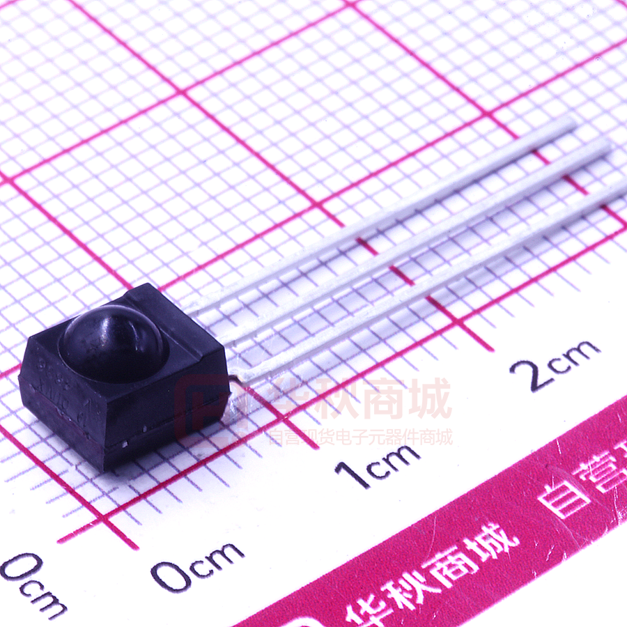

TSOP322.., TSOP324.., TSOP344.., TSOP348.. www.vishay.com Vishay Semiconductors IR Receiver Modules for Remote Control Systems FEATURES • Very low supply current • Photo detector and preamplifier in one package • Internal filter for PCM frequency • Supply voltage: 2.5 V to 5.5 V • Improved immunity against ambient light • Insensitive to supply voltage ripple and noise • Material categorization: for definitions of compliance please see www.vishay.com/doc?99912 1 2 3 16672 LINKS TO ADDITIONAL RESOURCES MECHANICAL DATA 3D 3D Product Page 3D Models Calculators Marking Pinning for TSOP348.., TSOP344..: Packages 1 = OUT, 2 = GND, 3 = VS Pinning for TSOP322.., TSOP324..: Holders Bends and Cuts 1 = OUT, 2 = VS, 3 = GND DESCRIPTION ORDERING CODE The TSOP322.., TSOP348.., TSOP324.. and TSOP344.. series are miniaturized IR receiver modules for infrared remote control systems. A PIN diode and a preamplifier are assembled on lead frame, the epoxy package contains an IR filter. TSOP32.., TSOP34.. - 2160 pieces in tubes BLOCK DIAGRAM VS The demodulated output signal can be directly connected to a microprocessor for decoding. 30 kΩ The TSOP324.., TSOP344.. series devices are optimized to suppress almost all spurious pulses from energy saving lamps like CFLs. The AGC4 used in the TSOP324.., TSOP344.. may suppress some data signals. The TSOP322.., TSOP348.. series are provided primarily for compatibility with old AGC2 designs. New designs should prefer the TSOP324.., TSOP344.. series containing the newer AGC4. OUT Input Band pass AGC Demodulator GND PIN Control circuit 16833-22 These components have not been qualified according to automotive specifications. APPLICATION CIRCUIT 17170-11 R1 IR receiver VS Circuit Transmitter with TSALxxxx + VS C1 μC OUT GND VO GND R1 and C1 recommended to reduce supply ripple for VS < 2.8 V Rev. 1.9, 14-Dec-2021 1 Document Number: 82489 THIS DOCUMENT IS SUBJECT TO CHANGE WITHOUT NOTICE. THE PRODUCTS DESCRIBED HEREIN AND THIS DOCUMENT ARE SUBJECT TO SPECIFIC DISCLAIMERS, SET FORTH AT www.vishay.com/doc?91000 TSOP322.., TSOP324.., TSOP344.., TSOP348.. www.vishay.com Vishay Semiconductors PARTS TABLE LEGACY, FOR LONG BURST REMOTE CONTROLS (AGC2) AGC Carrier frequency RECOMMENDED FOR LONG BURST CODES (AGC4) 30 kHz TSOP34830 TSOP32230 TSOP34430 33 kHz TSOP34833 TSOP32233 TSOP34433 TSOP32430 TSOP32433 36 kHz TSOP34836 TSOP32236 TSOP34436 (1)(2)(3) TSOP32436 (1)(2)(3) TSOP32438 (4)(5) 38 kHz TSOP34838 TSOP32238 TSOP34438 (4)(5) 40 kHz TSOP34840 TSOP32240 TSOP34440 TSOP32440 56 kHz TSOP34856 TSOP32256 TSOP34456 (6)(7) TSOP32456 (6)(7) Package Mold Pinning 1 = OUT, 2 = GND, 3 = VS 1 = OUT, 2 = VS, 3 = GND 1 = OUT, 2 = GND, 3 = VS 1 = OUT, 2 = VS, 3 = GND Dimensions (mm) 6.0 W x 6.95 H x 5.6 D Mounting Leaded Application Remote control (1) Best choice for RC-5 (2) RC-6 (3) Panasonic (4) NEC (5) Sharp (6) r-step (7) Thomson RCA ABSOLUTE MAXIMUM RATINGS PARAMETER SYMBOL VALUE Supply voltage TEST CONDITION VS -0.3 to +6 V Supply current IS 3 mA Output voltage VO -0.3 to (VS + 0.3) V Output current IO 5 mA Junction temperature Storage temperature range Operating temperature range Power consumption Soldering temperature UNIT Tj 100 °C Tstg -25 to +85 °C Tamb -25 to +85 °C Tamb ≤ 85 °C Ptot 10 mW t ≤ 10 s, 1 mm from case Tsd 260 °C Note • Stresses beyond those listed under “Absolute Maximum Ratings” may cause permanent damage to the device. This is a stress rating only and functional operation of the device at these or any other conditions beyond those indicated in the operational sections of this specification is not implied. Exposure to absolute maximum rating conditions for extended periods may affect the device reliability ELECTRICAL AND OPTICAL CHARACTERISTICS (Tamb = 25 °C, unless otherwise specified) PARAMETER TEST CONDITION SYMBOL MIN. TYP. MAX. UNIT Ev = 0, VS = 3.3 V ISD 0.27 0.35 0.45 mA Ev = 40 klx, sunlight ISH - 0.45 - mA VS 2.5 - 5.5 V Ev = 0, test signal see Fig. 1, IR diode TSAL6200, IF = 50 mA d - 30 - m Output voltage low IOSL = 0.5 mA, Ee = 0.7 mW/m2, test signal see Fig. 1 VOSL - - 100 mV Minimum irradiance Pulse width tolerance: tpi - 5/f0 < tpo < tpi + 6/f0, test signal see Fig. 1 Ee min. - 0.08 0.15 mW/m2 Maximum irradiance tpi - 5/f0 < tpo < tpi + 6/f0, test signal see Fig. 1 Ee max. 30 - - W/m2 Angle of half transmission distance ϕ1/2 - ± 45 - ° Supply current Supply voltage Transmission distance Directivity Rev. 1.9, 14-Dec-2021 2 Document Number: 82489 THIS DOCUMENT IS SUBJECT TO CHANGE WITHOUT NOTICE. THE PRODUCTS DESCRIBED HEREIN AND THIS DOCUMENT ARE SUBJECT TO SPECIFIC DISCLAIMERS, SET FORTH AT www.vishay.com/doc?91000 TSOP322.., TSOP324.., TSOP344.., TSOP348.. www.vishay.com Vishay Semiconductors TYPICAL CHARACTERISTICS (Tamb = 25 °C, unless otherwise specified) Optical Test Signal Ee 0.8 t tpi * T 10/f0 is recommended for optimal function * tpi Output Signal VO 1) VOH 2) VOL td 16110 7/f0 < td < 15/f0 tpi - 5/f0 < tpo < tpi + 6/f0 1) tpo ton ton, toff - Output Pulse Width (ms) (IR diode TSAL6200, IF = 0.4 A, 30 pulses, f = f0, t = 10 ms) 0.7 0.6 0.5 toff 0.4 0.3 0.2 λ = 950 nm, optical test signal, fig. 3 0.1 0 0.1 2) 20744 t 1000 10 000 1.2 Output pulse width 0.9 Ee min./Ee - Relative Responsivity tpo - Output Pulse Width (ms) 100 Fig. 4 - Output Pulse Diagram 1.0 0.8 Input burst length 0.7 0.6 0.5 0.4 0.3 λ = 950 nm, Optical test signal, fig. 1 0.2 0.1 1.0 0.8 0.6 0.4 f = f0 ± 5 % Δf(3 dB) = f0/10 0.2 0.0 0 0.1 1 10 100 1000 10 000 0.7 Ee - Irradiance (mW/m²) 20743 Ee min. - Threshold Irradiance (mW/m²) t 600 µs t = 60 ms 94 8134 Output Signal, (see Fig. 4) VOH VOL t on t off 1.3 4.0 Correlation with ambient light sources: 3.5 10 W/m² = 1.4 klx (std. illum. A, T = 2855 K) 10 W/m² = 8.2 klx (daylight, T = 5900 K) 3.0 2.5 1.5 1.0 0.5 0 0.01 t Fig. 3 - Output Function Wavelength of ambient illumination: λ = 950 nm 2.0 20745 Rev. 1.9, 14-Dec-2021 1.1 Fig. 5 - Frequency Dependence of Responsivity Optical Test Signal 600 µs 0.9 f/f0 - Relative Frequency 16925 Fig. 2 - Pulse Length and Sensitivity in Dark Ambient VO 10 Ee - Irradiance (mW/m²) Fig. 1 - Output Active Low Ee 1 0.1 1 10 100 Ee - Ambient DC Irradiance (W/m²) Fig. 6 - Sensitivity in Bright Ambient 3 Document Number: 82489 THIS DOCUMENT IS SUBJECT TO CHANGE WITHOUT NOTICE. THE PRODUCTS DESCRIBED HEREIN AND THIS DOCUMENT ARE SUBJECT TO SPECIFIC DISCLAIMERS, SET FORTH AT www.vishay.com/doc?91000 TSOP322.., TSOP324.., TSOP344.., TSOP348.. www.vishay.com Vishay Semiconductors Axis Title 1.0 2.5 2.0 f = f0 f = 30 kHz f = 10 kHz f = 100 Hz 1.5 1.0 0.5 0 1 10 100 1000 10000 0.9 0.8 0.7 1000 0.6 1st line 2nd line 2nd line S(λ)rel. - Relative Spectral Sensitivity Ee min. - Threshold Irradiance (mW/m2) 3.0 0.5 0.4 100 0.3 0.2 0.1 10 1150 0 750 ΔVS RMS - AC Voltage on DC Supply Voltage (mV) 850 1050 λ - Wavelength (nm) 23180 Fig. 7 - Sensitivity vs. Supply Voltage Disturbances 950 Fig. 10 - Relative Spectral Sensitivity vs. Wavelength 0° 1.0 10° 20° 30° Max. Envelope Duty Cycle 0.9 0.8 0.7 40° 0.6 1.0 TSOP322.. TSOP348.. 0.5 TSOP324.. TSOP344.. 0.4 0.3 0.9 50° 0.8 60° 70° 0.2 0.7 0.1 80° f = 38 kHz, Ee = 2 mW/m² 0 0 20748-2 20 40 60 80 100 120 0.6 Burst Length (number of cycles/burst) 0.2 0 Fig. 11 - Horizontal Directivity 0.20 0.20 0.18 0.18 Ee min. - Sensitivity (mW/m2) Ee min. - Threshold Irradiance (mW/m2) Fig. 8 - Max. Envelope Duty Cycle vs. Burst Length 0.4 drel - Relative Transmission Distance 96 12223p2 0.16 0.14 0.12 0.10 0.08 0.06 0.04 0.02 0.16 0.14 0.12 0.10 0.08 0.06 0.04 0.02 0.00 0 -30 -10 10 30 50 70 1 90 Fig. 9 - Sensitivity vs. Ambient Temperature Rev. 1.9, 14-Dec-2021 2 3 4 5 VS - Supply Voltage (V) Tamb - Ambient Temperature (°C) Fig. 12 - Sensitivity vs. Supply Voltage 4 Document Number: 82489 THIS DOCUMENT IS SUBJECT TO CHANGE WITHOUT NOTICE. THE PRODUCTS DESCRIBED HEREIN AND THIS DOCUMENT ARE SUBJECT TO SPECIFIC DISCLAIMERS, SET FORTH AT www.vishay.com/doc?91000 TSOP322.., TSOP324.., TSOP344.., TSOP348.. www.vishay.com Vishay Semiconductors SUITABLE DATA FORMAT Axis Title This series is designed to suppress spurious output pulses due to noise or disturbance signals. The devices can distinguish data signals from noise due to differences in frequency, burst length, and envelope duty cycle. The data signal should be close to the device’s band-pass center frequency (e.g. 38 kHz) and fulfill the conditions in the table below. 10000 7 When a data signal is applied to the product in the presence of a disturbance, the sensitivity of the receiver is automatically reduced by the AGC to insure that no spurious pulses are present at the receiver’s output. Some examples which are suppressed are: 5 1000 1st line 2nd line 2nd line IR Signal Amplitude 6 4 3 100 2 1 • DC light (e.g. from tungsten bulbs sunlight) 10 0 0 • Continuous signals at any frequency 5 15 20 Time (ms) 16920 • Strongly or weakly modulated patterns from fluorescent lamps with electronic ballasts (see Fig. 13 or Fig. 14). 10 Fig. 13 - IR Disturbance from Fluorescent Lamp With Low Modulation Axis Title 10000 40 1000 0 1st line 2nd line 2nd line IR Signal Amplitude 20 -20 100 -40 10 -60 0 5 10 15 20 Time (ms) 16921 Fig. 14 - IR Disturbance from Fluorescent Lamp With High Modulation TSOP322.., TSOP348.. TSOP324.., TSOP344.. Minimum burst length 10 cycles/burst 10 cycles/burst After each burst of length a minimum gap time is required of 10 to 70 cycles ≥ 10 cycles 10 to 35 cycles ≥ 10 cycles For bursts greater than a minimum gap time in the data stream is needed of 70 cycles > 4 x burst length 35 cycles > 10 x burst length Maximum number of continuous short bursts/second 1800 1500 NEC code Yes Preferred RC5/RC6 code Yes Preferred Thomson 56 kHz code Yes Preferred Sharp code Yes Preferred Mild disturbance patterns are suppressed (example: signal pattern of Fig. 13) Complex and critical disturbance patterns are suppressed (example: signal pattern of Fig. 14 or highly dimmed LCDs) Suppression of interference from fluorescent lamps Notes • For data formats with short bursts please see the datasheet for TSOP323.., TSOP325.., TSOP343.., TSOP345.. • For Sony 12, 15, and 20 bit IR codes please see the datasheet of TSOP34S40F, TSOP32S40F Rev. 1.9, 14-Dec-2021 5 Document Number: 82489 THIS DOCUMENT IS SUBJECT TO CHANGE WITHOUT NOTICE. THE PRODUCTS DESCRIBED HEREIN AND THIS DOCUMENT ARE SUBJECT TO SPECIFIC DISCLAIMERS, SET FORTH AT www.vishay.com/doc?91000 TSOP322.., TSOP324.., TSOP344.., TSOP348.. www.vishay.com Vishay Semiconductors PACKAGE DIMENSIONS in millimeters 3.9 1 1 30.5 ± 0.5 (5.55) 8.25 6.95 5.3 6 0.85 max. 0.89 0.5 max. 2.54 nom. 1.3 0.7 max. 4.1 2.54 nom. 5.6 marking area Not indicated tolerances ± 0.2 technical drawings according to DIN specifications R 2.5 Drawing-No.: 6.550-5169.01-4 Issue: 9; 03.11.10 13655 Rev. 1.9, 14-Dec-2021 6 Document Number: 82489 THIS DOCUMENT IS SUBJECT TO CHANGE WITHOUT NOTICE. THE PRODUCTS DESCRIBED HEREIN AND THIS DOCUMENT ARE SUBJECT TO SPECIFIC DISCLAIMERS, SET FORTH AT www.vishay.com/doc?91000 Legal Disclaimer Notice www.vishay.com Vishay Disclaimer ALL PRODUCT, PRODUCT SPECIFICATIONS AND DATA ARE SUBJECT TO CHANGE WITHOUT NOTICE TO IMPROVE RELIABILITY, FUNCTION OR DESIGN OR OTHERWISE. Vishay Intertechnology, Inc., its affiliates, agents, and employees, and all persons acting on its or their behalf (collectively, “Vishay”), disclaim any and all liability for any errors, inaccuracies or incompleteness contained in any datasheet or in any other disclosure relating to any product. Vishay makes no warranty, representation or guarantee regarding the suitability of the products for any particular purpose or the continuing production of any product. To the maximum extent permitted by applicable law, Vishay disclaims (i) any and all liability arising out of the application or use of any product, (ii) any and all liability, including without limitation special, consequential or incidental damages, and (iii) any and all implied warranties, including warranties of fitness for particular purpose, non-infringement and merchantability. Statements regarding the suitability of products for certain types of applications are based on Vishay's knowledge of typical requirements that are often placed on Vishay products in generic applications. Such statements are not binding statements about the suitability of products for a particular application. It is the customer's responsibility to validate that a particular product with the properties described in the product specification is suitable for use in a particular application. Parameters provided in datasheets and / or specifications may vary in different applications and performance may vary over time. All operating parameters, including typical parameters, must be validated for each customer application by the customer's technical experts. Product specifications do not expand or otherwise modify Vishay's terms and conditions of purchase, including but not limited to the warranty expressed therein. Hyperlinks included in this datasheet may direct users to third-party websites. These links are provided as a convenience and for informational purposes only. Inclusion of these hyperlinks does not constitute an endorsement or an approval by Vishay of any of the products, services or opinions of the corporation, organization or individual associated with the third-party website. Vishay disclaims any and all liability and bears no responsibility for the accuracy, legality or content of the third-party website or for that of subsequent links. Except as expressly indicated in writing, Vishay products are not designed for use in medical, life-saving, or life-sustaining applications or for any other application in which the failure of the Vishay product could result in personal injury or death. Customers using or selling Vishay products not expressly indicated for use in such applications do so at their own risk. Please contact authorized Vishay personnel to obtain written terms and conditions regarding products designed for such applications. No license, express or implied, by estoppel or otherwise, to any intellectual property rights is granted by this document or by any conduct of Vishay. Product names and markings noted herein may be trademarks of their respective owners. © 2022 VISHAY INTERTECHNOLOGY, INC. ALL RIGHTS RESERVED Revision: 01-Jan-2022 1 Document Number: 91000
TSOP4838
物料型号: - TSOP322系列 - TSOP324系列 - TSOP344系列 - TSOP348系列
器件简介: 这些系列是用于红外遥控系统的微型红外接收模块。它们在引脚框架上组装了PIN二极管和前置放大器,并在环氧树脂封装内含有红外滤波器。
引脚分配: - TSOP348系列和TSOP344系列:1=OUT, 2=GND, 3=VS - TSOP322系列和TSOP324系列:1=OUT, 2=VS, 3=GND
参数特性: - 非常低的供电电流 - 光探测器和前置放大器集成在一个封装中 - 内部滤波PCM频率 - 供电电压:2.5V至5.5V - 提高对环境光的免疫力 - 对供电电压波动和噪声不敏感
功能详解: - 去调频输出信号可以直接连接到微处理器进行解码。 - TSOP324和TSOP344系列设备优化以抑制几乎所有来自节能灯(如CFL)的干扰脉冲。
应用信息: - 用于遥控系统。
封装信息: - 封装类型:Mold - 尺寸:6.0Wx6.95Hx5.6D mm - 安装方式:有引线
