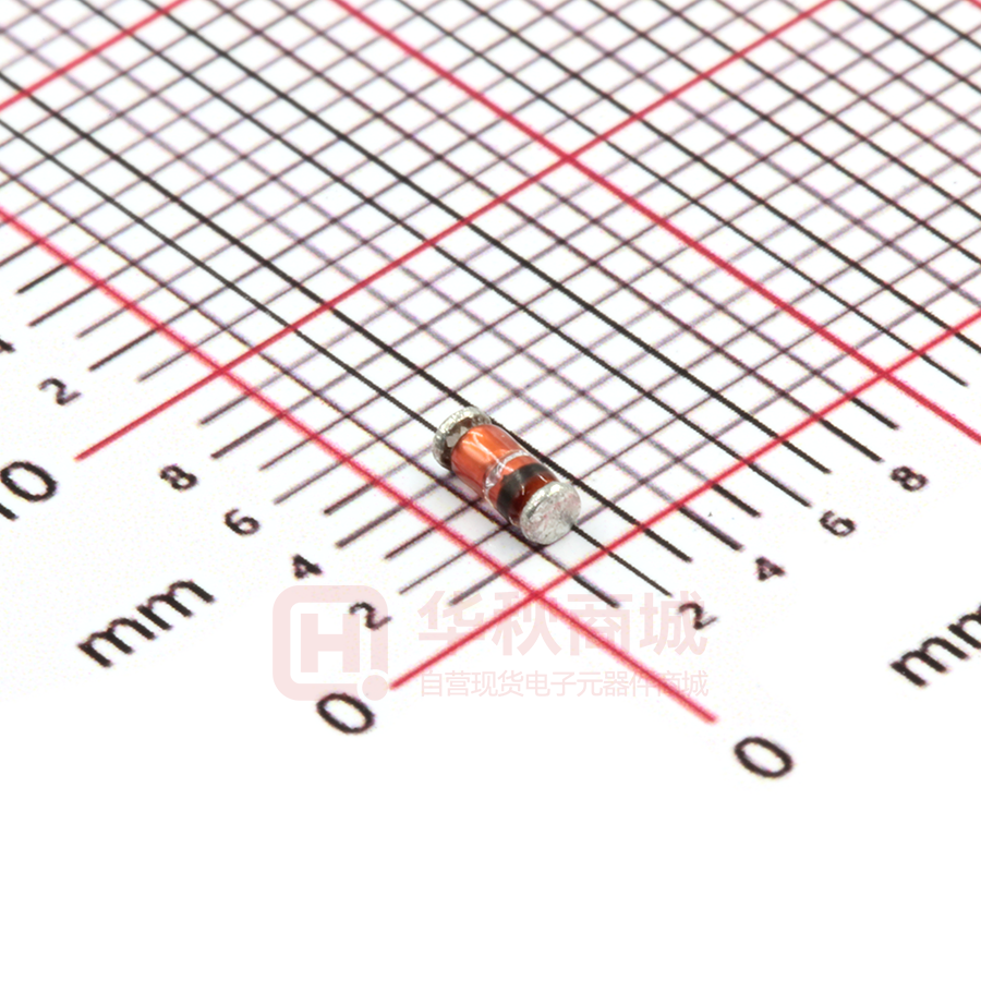

TZM5221 to TZM5267 www.vishay.com Vishay Semiconductors Small Signal Zener Diodes FEATURES • Very sharp reverse characteristic • Very high stability • Electrical data identical with the devices 1N5221B to 1N5267B • Low reverse current level • Standard Zener voltage tolerance ± 5 % • Material categorization: for definitions of compliance please see www.vishay.com/doc?99912 LINKS TO ADDITIONAL RESOURCES APPLICATIONS 3D 3D • Voltage stabilization 3D Models PRIMARY CHARACTERISTICS PARAMETER VALUE UNIT VZ range nom. 2.4 to 75 V Test current IZT 1.7 to 20 mA VZ specification Thermal equilibrium Circuit configuration Single ORDERING INFORMATION DEVICE NAME ORDERING CODE TAPED UNITS PER REEL MINIMUM ORDER QUANTITY TZM5221B to TZM5267B TZM5221B to TZM5267B-series-GS18 10 000 (8 mm tape on 13" reel) 10 000/box TZM5221B to TZM5267B TZM5221B to TZM5267B-series-GS08 2500 (8 mm tape on 7" reel) 12 500/box PACKAGE PACKAGE NAME MiniMELF (SOD-80) WEIGHT MOLDING COMPOUND FLAMMABILITY RATING MOISTURE SENSITIVITY LEVEL SOLDERING CONDITIONS 31 mg UL 94 V-0 MSL level 1 (according J-STD-020) Peak temperature max. 260 °C ABSOLUTE MAXIMUM RATINGS (Tamb = 25 °C, unless otherwise specified) PARAMETER TEST CONDITION SYMBOL Power dissipation RthJA = < 300 K/W Zener current Junction to ambient air On PC board 50 mm x 50 mm x 1.6 mm Junction temperature Storage temperature range Forward voltage (max.) IF = 200 mA VALUE UNIT Ptot 500 mW IZ Ptot/VZ mA RthJA 500 K/W Tj 175 °C Tstg -65 to +175 °C VF 1.1 V Rev. 2.1, 25-Nov-2021 Document Number: 85609 1 For technical questions within your region: DiodesAmericas@vishay.com, DiodesAsia@vishay.com, DiodesEurope@vishay.com THIS DOCUMENT IS SUBJECT TO CHANGE WITHOUT NOTICE. THE PRODUCTS DESCRIBED HEREIN AND THIS DOCUMENT ARE SUBJECT TO SPECIFIC DISCLAIMERS, SET FORTH AT www.vishay.com/doc?91000 TZM5221 to TZM5267 www.vishay.com Vishay Semiconductors ELECTRICAL CHARACTERISTICS (Tamb = 25 °C, unless otherwise specified) ZENER VOLTAGE RANGE (1) PART NUMBER VZ at IZT1 TEST CURRENT IZT1 V TZM5221 TZM5222 TZM5223 TZM5224 TZM5225 TZM5226 TZM5227 TZM5228 TZM5229 TZM5230 TZM5231 TZM5232 TZM5233 TZM5234 TZM5235 TZM5236 TZM5237 TZM5238 TZM5239 TZM5240 TZM5241 TZM5242 TZM5243 TZM5244 TZM5245 TZM5246 TZM5247 TZM5248 TZM5249 TZM5250 TZM5251 TZM5252 TZM5253 TZM5254 TZM5255 TZM5256 TZM5257 TZM5258 TZM5259 TZM5260 TZM5261 TZM5262 TZM5263 TZM5264 TZM5265 TZM5266 TZM5267 NOM. 2.4 2.5 2.7 2.8 3 3.3 3.6 3.9 4.3 4.7 5.1 5.6 6 6.2 6.8 7.5 8.2 8.7 9.1 10 11 12 13 14 15 16 17 18 19 20 22 24 25 27 28 30 33 36 39 43 47 51 56 60 62 68 75 IZT2 mA 20 20 20 20 20 20 20 20 20 20 20 20 20 20 20 20 20 20 20 20 20 20 9.5 9 8.5 7.8 7.4 7 6.6 6.2 5.6 5.2 5 4.6 4.5 4.2 3.8 3.4 3.2 3 2.7 2.5 2.2 2.1 2 1.8 1.7 REVERSE LEAKAGE CURRENT 0.25 0.25 0.25 0.25 0.25 0.25 0.25 0.25 0.25 0.25 0.25 0.25 0.25 0.25 0.25 0.25 0.25 0.25 0.25 0.25 0.25 0.25 0.25 0.25 0.25 0.25 0.25 0.25 0.25 0.25 0.25 0.25 0.25 0.25 0.25 0.25 0.25 0.25 0.25 0.25 0.25 0.25 0.25 0.25 0.25 0.25 0.25 ZZ at IZT1 IR at VR μA < 100 < 100 < 75 < 75 < 50 < 25 < 15 < 10

物料型号:TZM5221至TZM5267
器件简介:这些是Vishay Semiconductors生产的小型信号齐纳二极管,具有非常尖锐的反向特性、高稳定性、低反向电流水平,并且符合RoHS标准。
引脚分配:文档中没有提供具体的引脚分配图,但通常齐纳二极管有阳极和阴极两个引脚。
参数特性: - 标准齐纳电压容差为±5% - 测试电流范围从1.7mA至20mA - 齐纳电压规格在热平衡状态下进行测量
功能详解: - 这些二极管主要用于电压稳定。
应用信息:适用于电压稳定。
封装信息: - 封装类型为MiniMELF(SOD-80) - 重量为31毫克 - 阻燃等级为UL94V-0 - 湿度敏感等级为MSL 1级(根据J-STD-020标准) - 焊接条件:峰值温度最高260°C
订购信息: - 订购代码为TZM5221B至TZM5267B-series-GS18或TZM5221B至TZM5267B-series-GS08 - 8毫米胶带,13英寸卷,每卷10000个单位 - 最小订购量为每盒10000个单位
绝对最大额定值(环境温度=25°C,除非另有说明): - 总功耗为500毫瓦 - 结温最高175°C - 存储温度范围为-65°C至+175°C - 最大正向电压为1.1V
电气特性(环境温度=25°C,除非另有说明): - 提供了不同型号的齐纳电压范围、测试电流、反向漏电流、动态电阻和温度系数等详细电气参数。
