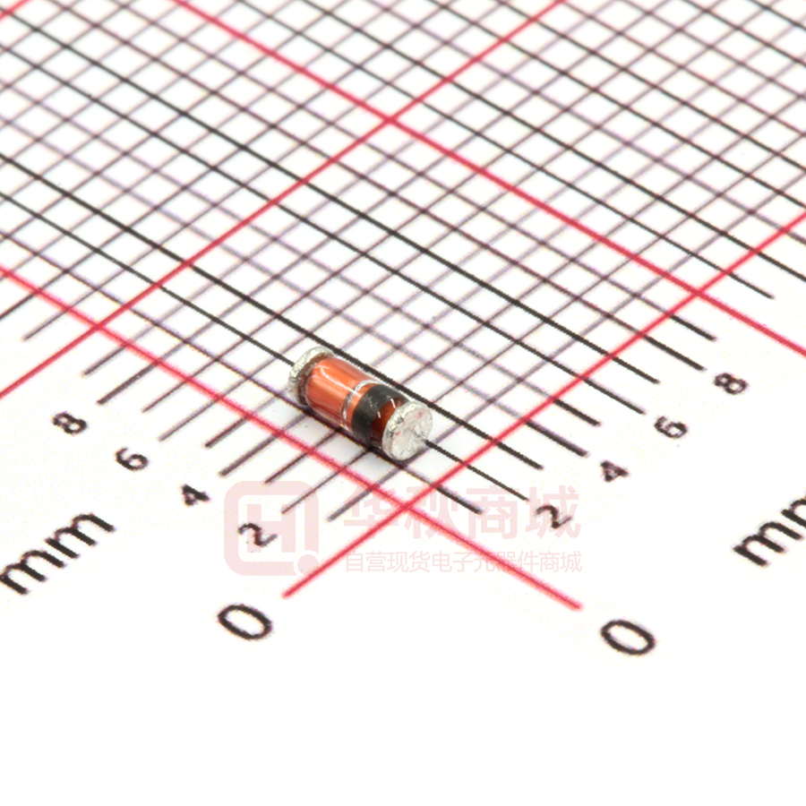

TZM-Series www.vishay.com Vishay Semiconductors Small Signal Zener Diodes FEATURES • Very sharp reverse characteristic • Low reverse current level • Very high stability • Low noise • TZMC - VZ-tolerance ± 5 % • TZMB - VZ-tolerance ± 2 % • Material categorization: for definitions of compliance please see www.vishay.com/doc?99912 LINKS TO ADDITIONAL RESOURCES APPLICATIONS 3D 3D • Voltage stabilization 3D Models PRIMARY CHARACTERISTICS PARAMETER VALUE UNIT VZ range nom. 2.4 to 75 V Test current IZT 2.5; 5 mA VZ specification Pulse current Circuit configuration Single ORDERING INFORMATION DEVICE NAME ORDERING CODE TAPED UNITS PER REEL MINIMUM ORDER QUANTITY TZM-series TZM-series-GS18 10 000 (8 mm tape on 13" reel) 10 000/box TZM-series TZM-series-GS08 2500 (8 mm tape on 7" reel) 12 500/box PACKAGE PACKAGE NAME MiniMELF (SOD-80) WEIGHT MOLDING COMPOUND FLAMMABILITY RATING MOISTURE SENSITIVITY LEVEL SOLDERING CONDITIONS 31 mg UL 94 V-0 MSL level 1 (according J-STD-020) Peak temperature max. 260 °C ABSOLUTE MAXIMUM RATINGS (Tamb = 25 °C, unless otherwise specified) PARAMETER Power dissipation TEST CONDITION SYMBOL VALUE UNIT RthJA ≤ 300 K/W Ptot 500 mW IZ Ptot/VZ mA RthJA 500 K/W Zener current Junction to ambient air On PC board 50 mm x 50 mm x 1.6 mm Junction temperature Storage temperature range Forward voltage (max.) IF = 200 mA Tj 175 °C Tstg -65 to +175 °C VF 1.5 V Rev. 1.7, 25-Nov-2021 Document Number: 84122 1 For technical questions within your region: DiodesAmericas@vishay.com, DiodesAsia@vishay.com, DiodesEurope@vishay.com THIS DOCUMENT IS SUBJECT TO CHANGE WITHOUT NOTICE. THE PRODUCTS DESCRIBED HEREIN AND THIS DOCUMENT ARE SUBJECT TO SPECIFIC DISCLAIMERS, SET FORTH AT www.vishay.com/doc?91000 TZM-Series www.vishay.com Vishay Semiconductors ELECTRICAL CHARACTERISTICS (Tamb = 25 °C, unless otherwise specified) ZENER VOLTAGE RANGE PART NUMBER VZ at IZT1 TEST CURRENT IZT1 V MIN. IZT2 mA REVERSE LEAKAGE CURRENT IR at VR μA V IR (1) at VR μA DYNAMIC RESISTANCE TEMPERATURE COEFFICIENT OF ZENER VOLTAGE ZZ at IZT1 ZZK at IZT2 TKVZ Ω V NOM. MAX. %/K TYP. TYP. MIN. MAX. TZMC2V4 2.28 2.4 2.56 5 1 < 50 1 < 100 1 < 85 < 600 -0.09 -0.06 TZMC2V7 2.5 2.7 2.9 5 1 < 10 1 < 50 1 < 85 < 600 -0.09 -0.06 TZMC3V0 2.8 3.0 3.2 5 1

物料型号: TZM系列
器件简介: - 非常尖锐的反向特性 - 低反向电流水平 - 高稳定性 - 低噪音 - 符合RoHS标准
引脚分配: 未在文档中明确说明,但通常稳压二极管为单向导通器件,具有两个引脚:阳极和阴极。
参数特性: - 稳压范围(Vz range nom.): 2.4V至75V - 测试电流(Izr): 2.5mA或5mA - 稳压电压规格(Vz specification): 脉冲电流下 - 电路配置: 单个
功能详解: - 主要用于电压稳定。
应用信息: - 用于电压稳定。
封装信息: - 封装类型: MiniMELF(SOD-80) - 重量: 31毫克 - 模塑化合物阻燃等级: UL 94V-0 - 湿度敏感等级: MSL 1级(根据J-STD-020) - 焊接条件: 最高温度260°C
订购信息: - 订购代码: TZM系列-GS18或TZM系列-GS08 - 卷带单位: GS18为10,000(8毫米胶带在13英寸卷上),GS08为2,500(8毫米胶带在7英寸卷上) - 最小订购量: 10000/箱或12500/箱
绝对最大额定值: - 功率耗散(Ptot): 500mW - 稳压电流(lz): Ptot/Nz mA - 结点至环境空气热阻(RthJA): 500 K/W - 结点温度(T): 175℃ - 存储温度范围(Tstg): -65至+175℃ - 最大正向电压(VF): 1.5V
电气特性: 提供了详细的稳压电压范围、测试电流、反向漏电流、动态电阻和稳压电压的温度系数等参数。
