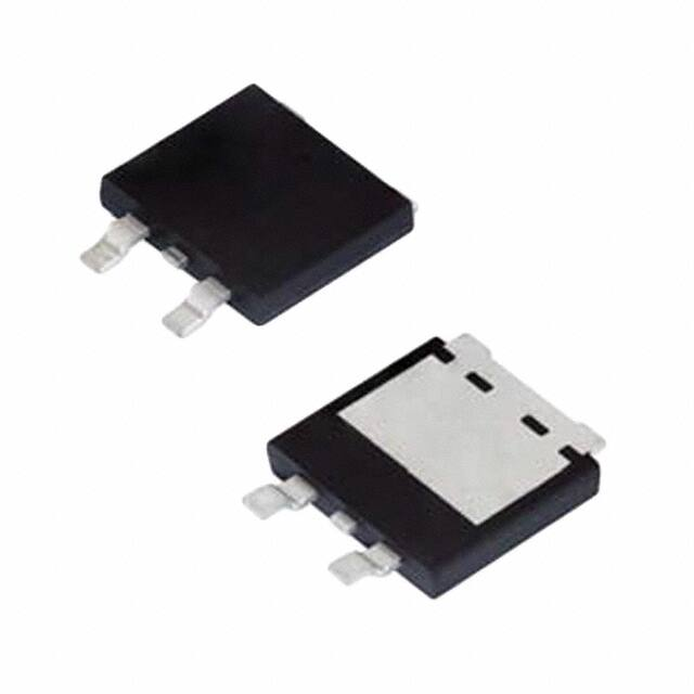

V20D45C www.vishay.com Vishay General Semiconductor Dual Low-Voltage TMBS® (Trench MOS Barrier Schottky) Rectifier Ultra Low VF = 0.34 V at IF = 5.0 A FEATURES eSMP® Series SMPD (TO-263AC) • Trench MOS Schottky technology Available • Very low profile - typical height of 1.7 mm • Ideal for automated placement K • Low forward voltage drop, low power losses • High efficiency operation 1 • Meets MSL level 1, per LF maximum peak of 260 °C 2 Top View Bottom View J-STD-020, • AEC-Q101 qualified available: - Automotive ordering code: base P/NHM3 • Material categorization: for definitions of compliance please see www.vishay.com/doc?99912 Anode 1 K Anode 2 Cathode DESIGN SUPPORT TOOLS AVAILABLE 3D 3D 3D Models PRIMARY CHARACTERISTICS TYPICAL APPLICATIONS For use in high frequency DC/DC converters, switching power supplies, freewheeling diodes, OR-ing diode, and reverse battery protection in commercial, industrial, and automotive application. MECHANICAL DATA IF(AV) 2 x 10 A VRRM 45 V IFSM 120 A VF at IF = 10 A (TA = 125 °C) 0.40 V TJ max. 150 °C Package SMPD (TO-263AC) Circuit configuration Common cathode Case: SMPD (TO-263AC) Molding compound meets UL 94 V-0 flammability rating Base P/N-M3 - halogen-free, RoHS-compliant Base P/NHM3 - halogen-free, RoHS-compliant, and AEC-Q101 qualified Terminals: matte tin plated leads, solderable per J-STD-002 and JESD 22-B102 M3 and HM3 suffix meet JESD 201 class 2 whisker test Polarity: as marked MAXIMUM RATINGS (TA = 25 °C unless otherwise noted) PARAMETER SYMBOL Device marking code UNIT V20D45C Maximum repetitive peak reverse voltage Maximum average forward rectified current (fig. 1) V20D45C VRRM per device per diode IF(AV) (1) 45 V 20 A 10 Peak forward surge current 8.3 ms single half sine-wave superimposed on rated load IFSM 120 Operating junction temperature range TJ (2) -40 to +150 Storage temperature range TSTG -55 to +150 A °C Notes (1) Mounted on infinite heatsink (2) The heat generated must be less than the thermal conductivity from junction-to-ambient: dP /dT < 1/R D J JA Revision: 14-Mar-2019 Document Number: 87548 1 For technical questions within your region: DiodesAmericas@vishay.com, DiodesAsia@vishay.com, DiodesEurope@vishay.com THIS DOCUMENT IS SUBJECT TO CHANGE WITHOUT NOTICE. THE PRODUCTS DESCRIBED HEREIN AND THIS DOCUMENT ARE SUBJECT TO SPECIFIC DISCLAIMERS, SET FORTH AT www.vishay.com/doc?91000 V20D45C www.vishay.com Vishay General Semiconductor ELECTRICAL CHARACTERISTICS (TA = 25 °C unless otherwise noted) PARAMETER TEST CONDITIONS IF = 5 A - 0.49 0.57 0.34 - 0.40 0.50 TA = 125 °C IF = 10 A TA = 25 °C VR = 45 V Typical junction capacitance MAX. 0.44 VF (1) IF = 5 A Reverse current at rated VR per diode TYP. TA = 25 °C IF = 10 A Instantaneous forward voltage per diode SYMBOL TA = 125 °C - 1 10 20 1900 - IR (2) 4.0 V, 1 MHz CJ UNIT V mA pF Notes (1) Pulse test: 300 μs pulse width, 1 % duty cycle (2) Pulse test: Pulse width  5 ms THERMAL CHARACTERISTICS (TA = 25 °C unless otherwise noted) PARAMETER Typical thermal resistance per device SYMBOL V20D45C RJC(1) 1.8 RJA (2)(3) 48 UNIT °C/W Notes (1) Mounted on infinite heatsink (2) The heat generated must be less than the thermal conductivity from junction-to-ambient: dP /dT < 1/R D J JA (3) Free air, without heatsink ORDERING INFORMATION (Example) PREFERRED P/N UNIT WEIGHT (g) PACKAGE CODE BASE QUANTITY DELIVERY MODE 0.55 I 2000/reel 13" diameter plastic tape and reel 0.55 I 2000/reel 13" diameter plastic tape and reel V20D45C-M3/I V20D45CHM3/I (1) Note (1) AEC-Q101 qualified 6.0 25 RthJC = 1.8 °C/W 20 Average Power Loss (W) Average Forward Rectified Current (A) RATINGS AND CHARACTERISTICS CURVES (TA = 25 °C unless otherwise noted) 15 10 RthJA = 48 °C/W 5 D = 0.5 5.0 D = 0.8 D = 0.3 4.0 D = 0.2 D = 1.0 3.0 D = 0.1 2.0 T 1.0 D = tp/T tp 0.0 0 0 25 50 75 100 125 150 Case Temperature (°C) Fig. 1 - Maximum Forward Current Derating Curve 0 2 4 6 8 10 12 Average Forward Current (A) Fig. 2 - Average Power Loss Characteristics Revision: 14-Mar-2019 Document Number: 87548 2 For technical questions within your region: DiodesAmericas@vishay.com, DiodesAsia@vishay.com, DiodesEurope@vishay.com THIS DOCUMENT IS SUBJECT TO CHANGE WITHOUT NOTICE. THE PRODUCTS DESCRIBED HEREIN AND THIS DOCUMENT ARE SUBJECT TO SPECIFIC DISCLAIMERS, SET FORTH AT www.vishay.com/doc?91000 V20D45C www.vishay.com Vishay General Semiconductor Transient Thermal Impedance (°C/W) Instantaneous Forward Current (A) 100 TJ = 150 °C 10 TJ = 125 °C TJ = 100 °C TJ = 25 °C 1 TJ = -40 °C 0.1 0 0.1 0.2 0.3 0.4 0.5 0.6 0.7 0.8 100 Junction to Ambient 10 1 0.1 0.01 0.1 Instantaneous Forward Voltage (V) 10 100 t - Pulse Duration (s) Fig. 3 - Typical Instantaneous Forward Characteristics Fig. 6 - Typical Transient Thermal Impedance 50 100 TJ = 150 °C 10 1 TJ = 100 °C Thermal Resistance (°C/W) Instantaneous Reverse Current (mA) 1 TJ = 125 °C 0.1 0.01 TJ = 25 °C 0.001 0.0001 0.00001 TJ = -40 °C 0.000001 Epoxy printed circuit board FR4 copper thickness = 70 μm 45 40 35 30 25 S (cm2) 20 10 20 30 40 50 60 70 80 90 100 Percent of Rated Peak Reverse Voltage (%) Fig. 4 - Typical Reverse Leakage Characteristics 1 2 3 4 5 6 7 Copper Pad Areas (cm2) 8 9 Fig. 7 - Thermal Resistance Junction-to-Ambient vs. Copper Pad Areas Junction Capacitance (pF) 10 000 TJ = 25 °C f = 1.0 MHz Vsig = 50 mVp-p 1000 100 0.1 1 10 100 Reverse Voltage (V) Fig. 5 - Typical Junction Capacitance Revision: 14-Mar-2019 Document Number: 87548 3 For technical questions within your region: DiodesAmericas@vishay.com, DiodesAsia@vishay.com, DiodesEurope@vishay.com THIS DOCUMENT IS SUBJECT TO CHANGE WITHOUT NOTICE. THE PRODUCTS DESCRIBED HEREIN AND THIS DOCUMENT ARE SUBJECT TO SPECIFIC DISCLAIMERS, SET FORTH AT www.vishay.com/doc?91000 V20D45C www.vishay.com Vishay General Semiconductor PACKAGE OUTLINE DIMENSIONS in inches (millimeters) SMPD (TO-263AC)       5()                      WR   WR                    120     Mounting Pad Layout   0,1           5()   120       5()   0,1     Revision: 14-Mar-2019 Document Number: 87548 4 For technical questions within your region: DiodesAmericas@vishay.com, DiodesAsia@vishay.com, DiodesEurope@vishay.com THIS DOCUMENT IS SUBJECT TO CHANGE WITHOUT NOTICE. THE PRODUCTS DESCRIBED HEREIN AND THIS DOCUMENT ARE SUBJECT TO SPECIFIC DISCLAIMERS, SET FORTH AT www.vishay.com/doc?91000 Legal Disclaimer Notice www.vishay.com Vishay Disclaimer ALL PRODUCT, PRODUCT SPECIFICATIONS AND DATA ARE SUBJECT TO CHANGE WITHOUT NOTICE TO IMPROVE RELIABILITY, FUNCTION OR DESIGN OR OTHERWISE. Vishay Intertechnology, Inc., its affiliates, agents, and employees, and all persons acting on its or their behalf (collectively, “Vishay”), disclaim any and all liability for any errors, inaccuracies or incompleteness contained in any datasheet or in any other disclosure relating to any product. Vishay makes no warranty, representation or guarantee regarding the suitability of the products for any particular purpose or the continuing production of any product. To the maximum extent permitted by applicable law, Vishay disclaims (i) any and all liability arising out of the application or use of any product, (ii) any and all liability, including without limitation special, consequential or incidental damages, and (iii) any and all implied warranties, including warranties of fitness for particular purpose, non-infringement and merchantability. Statements regarding the suitability of products for certain types of applications are based on Vishay's knowledge of typical requirements that are often placed on Vishay products in generic applications. Such statements are not binding statements about the suitability of products for a particular application. It is the customer's responsibility to validate that a particular product with the properties described in the product specification is suitable for use in a particular application. Parameters provided in datasheets and / or specifications may vary in different applications and performance may vary over time. All operating parameters, including typical parameters, must be validated for each customer application by the customer's technical experts. Product specifications do not expand or otherwise modify Vishay's terms and conditions of purchase, including but not limited to the warranty expressed therein. Hyperlinks included in this datasheet may direct users to third-party websites. These links are provided as a convenience and for informational purposes only. Inclusion of these hyperlinks does not constitute an endorsement or an approval by Vishay of any of the products, services or opinions of the corporation, organization or individual associated with the third-party website. Vishay disclaims any and all liability and bears no responsibility for the accuracy, legality or content of the third-party website or for that of subsequent links. Except as expressly indicated in writing, Vishay products are not designed for use in medical, life-saving, or life-sustaining applications or for any other application in which the failure of the Vishay product could result in personal injury or death. Customers using or selling Vishay products not expressly indicated for use in such applications do so at their own risk. Please contact authorized Vishay personnel to obtain written terms and conditions regarding products designed for such applications. No license, express or implied, by estoppel or otherwise, to any intellectual property rights is granted by this document or by any conduct of Vishay. Product names and markings noted herein may be trademarks of their respective owners. © 2021 VISHAY INTERTECHNOLOGY, INC. ALL RIGHTS RESERVED Revision: 09-Jul-2021 1 Document Number: 91000
