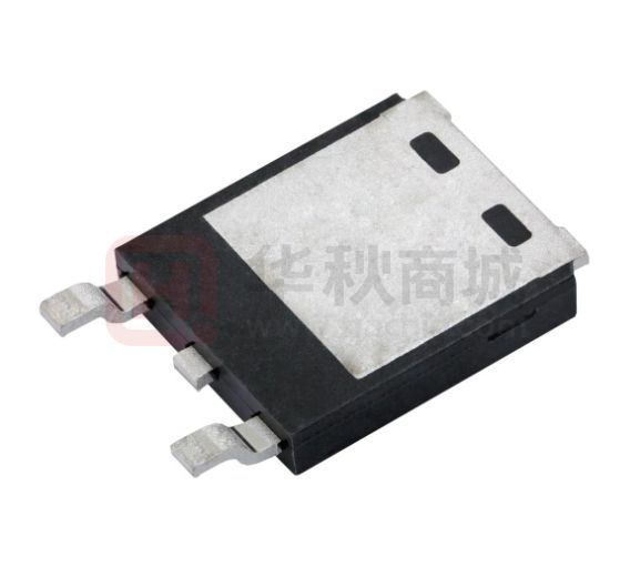

    肖特基二极管 TO252AE Vrrm=200V If=20A Ifsm=200A Cj=780pF
V20PW22-M3/I 数据手册
V20PW22 www.vishay.com Vishay General Semiconductor High Current Density Surface-Mount TMBS® (Trench MOS Barrier Schottky) Rectifier Ultra Low VF = 0.58 V at IF = 5 A FEATURES eSMP® Series • Very low profile - typical height of 1.3 mm Available • Trench MOS Schottky technology K • Low forward voltage drop, low power losses • High efficiency operation 1 • Meets MSL level 1, per J-STD-020, LF maximum peak of 260 °C 2 • AEC-Q101 qualified available - Automotive ordering code: base P/NHM3 SlimDPAK (TO-252AE) PIN 1 PIN 2 • Ideal for automated placement K • Material categorization: for definitions of compliance please see www.vishay.com/doc?99912 HEATSINK ADDITIONAL RESOURCES TYPICAL APPLICATIONS 3D 3D For use in low voltage high frequency DC/DC converters, freewheeling diodes, and polarity protection applications. 3D Models MECHANICAL DATA PRIMARY CHARACTERISTICS IF(AV) 20 A VRRM 200 V IFSM 200 A VF at IF = 20 A (TJ = 125 °C) 0.74 V TJ max. 175 °C Package SlimDPAK (TO-252AE) Circuit configuration Single Case: SlimDPAK (TO-252AE) Molding compound meets UL 94 V-0 flammability rating Base P/N-M3 - halogen-free, RoHS-compliant Base P/NHM3_X - halogen-free, RoHS-compliant, and AEC-Q101 qualified (“_X” denotes revision code e.g. A, B,.....) Terminals: matte tin plated leads, solderable per J-STD-002 and JESD 22-B102 M3 and HM3 suffix meets JESD 201 class 2 whisker test MAXIMUM RATINGS (TA = 25 °C unless otherwise noted) PARAMETER SYMBOL Device marking code Maximum repetitive peak reverse voltage V20PW22 UNIT V20PW22 VRRM 200 V IF(AV) (1) 20 A Peak forward surge current 8.3 ms single half sine-wave superimposed on rated load IFSM 200 A Operating junction temperature range TJ (2) -40 to +175 °C Storage temperature range TSTG -55 to +175 °C Maximum average forward rectified current (Fig. 1) Notes (1) With infinite heatsink (2) The heat generated must be less than the thermal conductivity from junction to ambient: dP /dT < 1/R D J θJA Revision: 19-Apr-2023 Document Number: 87004 1 For technical questions within your region: DiodesAmericas@vishay.com, DiodesAsia@vishay.com, DiodesEurope@vishay.com THIS DOCUMENT IS SUBJECT TO CHANGE WITHOUT NOTICE. THE PRODUCTS DESCRIBED HEREIN AND THIS DOCUMENT ARE SUBJECT TO SPECIFIC DISCLAIMERS, SET FORTH AT www.vishay.com/doc?91000 V20PW22 www.vishay.com Vishay General Semiconductor ELECTRICAL CHARACTERISTICS (TJ = 25 °C unless otherwise noted) PARAMETER TEST CONDITIONS SYMBOL IF = 5.0 A TJ = 25 °C IF = 10 A Maximum Instantaneous forward voltage IF = 20 A VF (1) IF = 5.0 A TJ = 125 °C IF = 10 A IF = 20 A VR = 160 V Reverse current Typical junction capacitance MAX. 0.73 - 0.8 - 0.88 0.96 0.58 - 0.65 - 0.74 0.82 TJ = 25 °C 0.0006 - TJ = 125 °C 1.5 - - 0.3 3 12 780 - TJ = 25 °C VR = 200 V TYP. IR (2) TJ = 125 °C 4.0 V, 1 MHz CJ UNIT V mA pF Notes (1) Pulse test: 300 μs pulse width, 1 % duty cycle (2) Pulse test: pulse width ≤ 5 ms THERMAL CHARACTERISTICS (TA = 25 °C unless otherwise noted) PARAMETER SYMBOL RθJA Typical thermal resistance V20PW22 (1)(2) UNIT 65 RθJM (3) °C/W 2 Notes (1) The heat generated must be less than thermal conductivity from junction-to-ambient: dP /dT < 1/R D J θJA (2) Free air, mounted on recommended copper pad area, 2 oz., FR4 PCB; thermal resistance R θJA - junction to ambient (3) Mounted on infinite heat sink; thermal resistance R θJM - junction-to-mount ORDERING INFORMATION (Example) PREFERRED P/N UNIT WEIGHT (g) PREFERRED PACKAGE CODE BASE QUANTITY DELIVERY MODE V20PW22-M3/I 0.20 I 4500 13" diameter plastic tape and reel V20PW22HM3_A/I (1) 0.20 I 4500 13" diameter plastic tape and reel Note AEC-Q101 qualified (1) Revision: 19-Apr-2023 Document Number: 87004 2 For technical questions within your region: DiodesAmericas@vishay.com, DiodesAsia@vishay.com, DiodesEurope@vishay.com THIS DOCUMENT IS SUBJECT TO CHANGE WITHOUT NOTICE. THE PRODUCTS DESCRIBED HEREIN AND THIS DOCUMENT ARE SUBJECT TO SPECIFIC DISCLAIMERS, SET FORTH AT www.vishay.com/doc?91000 V20PW22 www.vishay.com Vishay General Semiconductor RATINGS AND CHARACTERISTICS CURVES (TA = 25 °C unless otherwise noted) Axis Title Axis Title 1000 15 10 100 RthJA = 65 °C/W 5 0 25 50 75 100 125 150 1 1000 0.1 TJ = 150 °C TJ = 100 °C 0.01 TJ = 125 °C 0.001 100 0.0001 TJ = 25 °C 0.00001 TJ = -40 °C 10 20 175 40 60 Axis Title 10000 10 000 D = 0.8 1000 D = 0.2 D = 1.0 10.0 D = 0.1 8.0 100 6.0 T 4.0 2.0 D = tp/T 10 2 4 6 1000 100 100 tp 0 0 1000 1st line 2nd line 14.0 2nd line Junction Capacitance (pF) D = 0.5 1st line 2nd line 2nd line Average Power Loss (W) 10000 TJ = 25 °C f = 1.0 MHz Vsig = 50 mVp-p D = 0.3 12.0 10 8 10 12 14 16 18 20 22 24 0.1 1 10 Average Forward Current (A) 10000 Junction to Ambient 10 1000 TJ = 150 °C TJ = 125 °C TJ = 100 °C 100 TJ = 25 °C TJ = -40 °C 0.1 10 0.2 0.4 0.6 0.8 1.0 1.2 1.4 1.6 1.8 2.0 Instantaneous Forward Voltage (V) Fig. 3 - Typical Instantaneous Forward Characteristics 10 1000 1 100 1st line 2nd line TJ = 175 °C 2nd line Transient Thermal Impedance (°C/W) 2nd line Instantaneous Forward Current (A) Axis Title 100 10000 0 10 1000 Fig. 5 - Typical Junction Capacitance Axis Title 100 100 Reverse Voltage (V) Fig. 2 - Forward Power Loss Characteristics 1 100 Fig. 4 - Typical Reverse Leakage Characteristics Axis Title 20.0 16.0 80 Percent of Rated Peak Reverse Voltage (%) Mount Temperature (°C) Fig. 1 - Maximum Forward Current Derating Curve 18.0 TJ = 175 °C 0.000001 10 0 10000 10 1st line 2nd line TM measured at cathode terminal mount typical values line Current (mA) Instantaneous2nd Reverse RthJM = 2.0 °C/W 20 1st line 2nd line 2nd line Average Forward Rectified Current (A) 100 10000 25 0.1 0.01 10 0.1 1 10 100 t - Pulse Duration (s) Fig. 6 - Typical Transient Thermal Impedance Revision: 19-Apr-2023 Document Number: 87004 3 For technical questions within your region: DiodesAmericas@vishay.com, DiodesAsia@vishay.com, DiodesEurope@vishay.com THIS DOCUMENT IS SUBJECT TO CHANGE WITHOUT NOTICE. THE PRODUCTS DESCRIBED HEREIN AND THIS DOCUMENT ARE SUBJECT TO SPECIFIC DISCLAIMERS, SET FORTH AT www.vishay.com/doc?91000 V20PW22 www.vishay.com Vishay General Semiconductor Axis Title 80 10000 Epoxy printed circuit board FR4 copper thickness = 70 µm 60 1000 50 1st line 2nd line 2nd line Thermal Resistance (°C/W) 70 40 30 100 20 S (cm2) 10 0 10 0 1 2 3 4 5 6 7 8 9 10 Copper Pad Areas (cm2) Fig. 7 - Typical Resistance Junction to Ambient vs. Copper Pad Areas Revision: 19-Apr-2023 Document Number: 87004 4 For technical questions within your region: DiodesAmericas@vishay.com, DiodesAsia@vishay.com, DiodesEurope@vishay.com THIS DOCUMENT IS SUBJECT TO CHANGE WITHOUT NOTICE. THE PRODUCTS DESCRIBED HEREIN AND THIS DOCUMENT ARE SUBJECT TO SPECIFIC DISCLAIMERS, SET FORTH AT www.vishay.com/doc?91000 V20PW22 www.vishay.com Vishay General Semiconductor PACKAGE OUTLINE DIMENSIONS in inches (millimeters) 0.055 (1.40) 0.047 (1.20) SlimDPAK (TO-252AE) 0.249 (6.32) 0.239 (6.08) 0.016 (0.41) 0.010 (0.25) 0.028 (0.70) 0.012 (0.30) 0.265 (6.72) 0.255 (6.48) 0.370 (9.40) 0.339 (8.60) 0.008 0.000 0.055 0.039 0.090 NOM. (2.29) (0.20) (0.00) (1.40) (1.00) 0.180 NOM. (4.57) Mounting Pad Layout 0.240 MIN. (6.10) 0.224 (5.70) 0.209 (5.30) 0.205 NOM. (5.20) 0.235 MIN. (5.97) 0.386 REF. (9.80) 0.075 MIN. (1.90) 0.035 (0.90) 0.028 (0.70) 0.090 NOM. (2.29) 0.055 MIN. (1.40) Revision: 19-Apr-2023 Document Number: 87004 5 For technical questions within your region: DiodesAmericas@vishay.com, DiodesAsia@vishay.com, DiodesEurope@vishay.com THIS DOCUMENT IS SUBJECT TO CHANGE WITHOUT NOTICE. THE PRODUCTS DESCRIBED HEREIN AND THIS DOCUMENT ARE SUBJECT TO SPECIFIC DISCLAIMERS, SET FORTH AT www.vishay.com/doc?91000 Legal Disclaimer Notice www.vishay.com Vishay Disclaimer ALL PRODUCT, PRODUCT SPECIFICATIONS AND DATA ARE SUBJECT TO CHANGE WITHOUT NOTICE TO IMPROVE RELIABILITY, FUNCTION OR DESIGN OR OTHERWISE. Vishay Intertechnology, Inc., its affiliates, agents, and employees, and all persons acting on its or their behalf (collectively, “Vishay”), disclaim any and all liability for any errors, inaccuracies or incompleteness contained in any datasheet or in any other disclosure relating to any product. Vishay makes no warranty, representation or guarantee regarding the suitability of the products for any particular purpose or the continuing production of any product. To the maximum extent permitted by applicable law, Vishay disclaims (i) any and all liability arising out of the application or use of any product, (ii) any and all liability, including without limitation special, consequential or incidental damages, and (iii) any and all implied warranties, including warranties of fitness for particular purpose, non-infringement and merchantability. Statements regarding the suitability of products for certain types of applications are based on Vishay's knowledge of typical requirements that are often placed on Vishay products in generic applications. Such statements are not binding statements about the suitability of products for a particular application. It is the customer's responsibility to validate that a particular product with the properties described in the product specification is suitable for use in a particular application. Parameters provided in datasheets and / or specifications may vary in different applications and performance may vary over time. All operating parameters, including typical parameters, must be validated for each customer application by the customer's technical experts. Product specifications do not expand or otherwise modify Vishay's terms and conditions of purchase, including but not limited to the warranty expressed therein. Hyperlinks included in this datasheet may direct users to third-party websites. These links are provided as a convenience and for informational purposes only. Inclusion of these hyperlinks does not constitute an endorsement or an approval by Vishay of any of the products, services or opinions of the corporation, organization or individual associated with the third-party website. Vishay disclaims any and all liability and bears no responsibility for the accuracy, legality or content of the third-party website or for that of subsequent links. Except as expressly indicated in writing, Vishay products are not designed for use in medical, life-saving, or life-sustaining applications or for any other application in which the failure of the Vishay product could result in personal injury or death. Customers using or selling Vishay products not expressly indicated for use in such applications do so at their own risk. Please contact authorized Vishay personnel to obtain written terms and conditions regarding products designed for such applications. No license, express or implied, by estoppel or otherwise, to any intellectual property rights is granted by this document or by any conduct of Vishay. Product names and markings noted herein may be trademarks of their respective owners. © 2023 VISHAY INTERTECHNOLOGY, INC. ALL RIGHTS RESERVED Revision: 01-Jan-2023 1 Document Number: 91000
