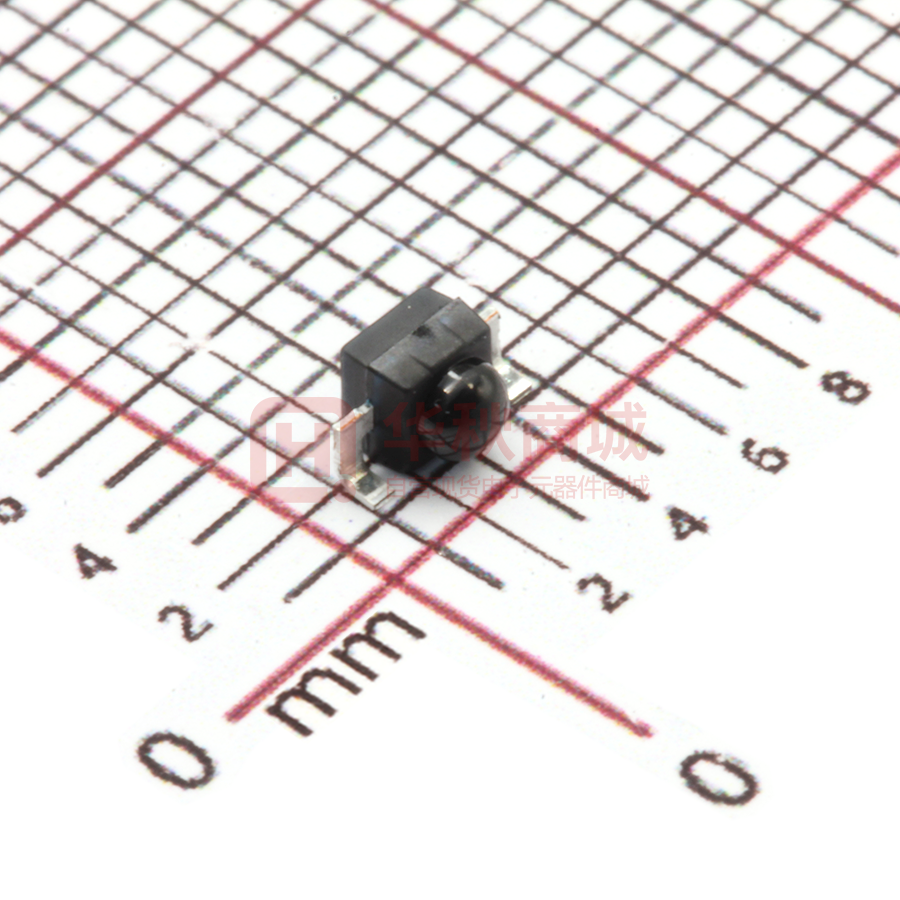

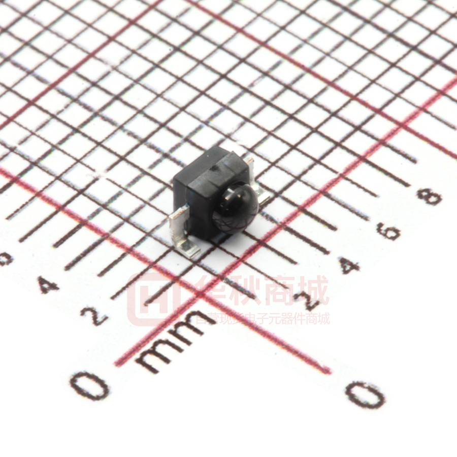

    VEMT2023SLX01是一款硅NPN外延平面光电晶体管,采用微型侧视表面贴装封装(SMD),带圆顶透镜和遮光滤光片。滤波带宽与 830 nm 至 950 nm 红外发射器匹配。
VEMT2023SLX01 数据手册
VEMT2023SLX01 www.vishay.com Vishay Semiconductors Silicon NPN Phototransistor FEATURES • Package type: surface mount • Package form: side view • Dimensions (L x W x H in mm): 2.3 x 2.55 x 2.3 • AEC-Q101 qualified • High radiant sensitivity • Daylight blocking filter matched with 830 nm to 950 nm IR emitters • Fast response times • Angle of half sensitivity:  = ± 35° • Package matched with IR emitter series VSMB2943SLX01 • Floor life: 4 weeks, MSL 2a, acc. J-STD-020 • Lead (Pb)-free reflow soldering DESCRIPTION VEMT2023SLX01 is a silicon NPN epitaxial planar phototransistor in a miniature side looking, surface mount package (SMD) with dome lens and daylight blocking filter. Filter bandwidth is matched with 830 nm to 950 nm IR emitters. • Material categorization: For definitions of compliance please see www.vishay.com/doc?99912 APPLICATIONS • Detector in automotive applications • Photo interrupters • Miniature switches • Counters • Encoders • Position sensors PRODUCT SUMMARY COMPONENT Ica (mA)  (deg) 0.5 (nm) 2.7 ± 35 790 to 970 VEMT2023SLX01 Note • Test condition see table “Basic Characteristics” ORDERING INFORMATION ORDERING CODE PACKAGING REMARKS PACKAGE FORM VEMT2023SLX01 Tape and reel MOQ: 3000 pcs, 3000 pcs/reel Side view Note • MOQ: minimum order quantity Rev. 1.0, 05-Apr-13 Document Number: 84166 1 For technical questions, contact: detectortechsupport@vishay.com THIS DOCUMENT IS SUBJECT TO CHANGE WITHOUT NOTICE. THE PRODUCTS DESCRIBED HEREIN AND THIS DOCUMENT ARE SUBJECT TO SPECIFIC DISCLAIMERS, SET FORTH AT www.vishay.com/doc?91000 VEMT2023SLX01 www.vishay.com Vishay Semiconductors ABSOLUTE MAXIMUM RATINGS (Tamb = 25 °C, unless otherwise specified) SYMBOL VALUE UNIT Collector emitter voltage PARAMETER TEST CONDITION VCEO 20 V Emitter collector voltage VECO 7 V IC 50 mA PV 100 mW Tj 100 °C Tamb - 40 to + 100 °C °C Collector current Tamb  75 °C Power power dissipation Junction temperature Operating temperature range Storage temperature range Soldering temperature Tstg - 40 to + 100 Acc. reflow profile fig. 8 Tsd 260 °C Acc. J-STD-051 RthJA 250 K/W Thermal resistance junction/ambient PV - Power Dissipation (mW) 120 100 80 60 RthJA = 250 K/W 40 20 0 0 21619 10 20 30 40 50 60 70 80 90 100 Tamb - Ambient Temperature (°C)                 Fig. 1 - Power Dissipation Limit vs. Ambient Temperature BASIC CHARACTERISTICS (Tamb = 25 °C, unless otherwise specified) PARAMETER Collector emitter breakdown voltage Collector dark current Collector emitter capacitance Collector light current TEST CONDITION SYMBOL MIN. IC = 0.1 mA VCEO 20 TYP. UNIT V VCE = 5 V, E = 0 ICEO 1 VCE = 0 V, f = 1 MHz, E = 0 CCEO 25 Ee = 1 mW/cm2,  = 950 nm, VCE = 5 V Ica 1.3 MAX. 2.7 100 nA pF 4.1 mA Angle of half sensitivity  ± 35 Wavelength of peak sensitivity p 860 nm Range of spectral bandwidth 0.5 790 to 970 nm Collector emitter saturation voltage Temperature coefficient of Ica Rev. 1.0, 05-Apr-13 IC = 0.05 mA VCEsat Ee = 1 mW/cm2,  = 950 nm, VCE = 5 V TkIca deg 0.4 1.1 V %/K Document Number: 84166 2 For technical questions, contact: detectortechsupport@vishay.com THIS DOCUMENT IS SUBJECT TO CHANGE WITHOUT NOTICE. THE PRODUCTS DESCRIBED HEREIN AND THIS DOCUMENT ARE SUBJECT TO SPECIFIC DISCLAIMERS, SET FORTH AT www.vishay.com/doc?91000 VEMT2023SLX01 www.vishay.com Vishay Semiconductors BASIC CHARACTERISTICS (Tamb = 25 °C, unless otherwise specified) 1 S(λ)rel - Relative Spectral Sensitivity IF = 0 1000 VCE = 70 V VCE = 25 V VCE = 5 V 100 10 0.9 0.8 0.7 0.6 0.5 0.4 0.3 0.2 0.1 1 0 10 20594 20 30 40 50 60 70 80 0 600 650 700 750 800 850 900 950 1000 1050 1100 90 100 Tamb - Ambient Temperature (°C) λ - Wavelength (nm) 21574 Fig. 2 - Collector Dark Current vs. Ambient Temperature Fig. 5 - Relative Spectral Sensitivity vs. Wavelength 0° Srel - Relative Radiant Sensitivity Ica - Collector Light Current (mA) 100 10 VCE = 5 V, λ = 950 nm 1 0.1 0.01 0.1 1 10 Fig. 3 - Collector Light Current vs. Irradiance 30° 1.0 0.9 50° 0.8 60° 70° 80° 0.4 0.2 0 Fig. 6 - Relative Radiant Sensitivity vs. Angular Displacement 100 80 RL = 100 Ω 70 60 50 40 tf 30 tr 20 10 0 0 20599 250 500 750 1000 1250 1500 1750 2000 IC - Collector Current (µA) Fig. 4 - Rise/Fall Time vs. Collector Current Rev. 1.0, 05-Apr-13 Ica rel - Relative Collector Current 2.0 90 tr/tf - Rise/Fall Time (µs) 20° 40° 0.7 0.6 Ee - Irradiance (mW/cm²) 10° ϕ - Angular Displacement ICE0 - Collector Dark Current (nA) 10 000 1.8 VCE = 5 V Ee = 1 mW/cm2 λ = 950 nm 1.6 1.4 1.2 1.0 0.8 0.6 0 94 8239 20 40 60 80 100 Tamb - Ambient Temperature (°C) Fig. 7 - Relative Collector Current vs. Ambient Temperature Document Number: 84166 3 For technical questions, contact: detectortechsupport@vishay.com THIS DOCUMENT IS SUBJECT TO CHANGE WITHOUT NOTICE. THE PRODUCTS DESCRIBED HEREIN AND THIS DOCUMENT ARE SUBJECT TO SPECIFIC DISCLAIMERS, SET FORTH AT www.vishay.com/doc?91000 VEMT2023SLX01 www.vishay.com Vishay Semiconductors REFLOW SOLDER PROFILE DRYPACK 300 Temperature (°C) max. 260 °C 245 °C 255 °C 240 °C 217 °C 250 FLOOR LIFE 200 Floor life (time between soldering and removing from MBB) must not exceed the time indicated on MBB label:  Floor life: 4 weeks  Conditions: Tamb < 30 °C, RH < 60 % Moisture sensitivity level 2a, acc. to J-STD-020. max. 30 s 150 max. 100 s max. 120 s 100 max. ramp up 3 °C/s max. ramp down 6 °C/s 50 0 0 19841 50 Devices are packed in moisture barrier bags (MBB) to prevent the products from moisture absorption during transportation and storage. Each bag contains a desiccant. 100 150 200 250 300 Time (s) Fig. 8 - Lead (Pb)-free Reflow Solder Profile acc. J-STD-020 DRYING In case of moisture absorption devices should be baked before soldering. Conditions see J-STD-020 or label. Devices taped on reel dry using recommended conditions 192 h at 40 °C (+ 5 °C), RH < 5 %. PACKAGE DIMENSIONS VEMT2023SLX01 in millimeters Rev. 1.0, 05-Apr-13 Document Number: 84166 4 For technical questions, contact: detectortechsupport@vishay.com THIS DOCUMENT IS SUBJECT TO CHANGE WITHOUT NOTICE. THE PRODUCTS DESCRIBED HEREIN AND THIS DOCUMENT ARE SUBJECT TO SPECIFIC DISCLAIMERS, SET FORTH AT www.vishay.com/doc?91000 VEMT2023SLX01 www.vishay.com Vishay Semiconductors TAPE AND REEL DIMENSIONS VEMT2023SLX01 in millimeters Reel Unreel direction Ø 13 ±0 .5 Ø 330 ± 1 0.5 5± Ø 62 ± 0.5 2. Tape position coming out from reel 3000 pcs / reel technical drawings according to DIN specifications Label posted here 12.4 ± 1.5 Leader and tailer tape: Empty (160 mm min.) Parts mounted Direction of pulling out 1.75 ± 0.1 Empty (400 mm min.) Terminal position in tape Lead II Cathode Rev. 1.0, 05-Apr-13 5.5 ± 0.05 Emitter Drawing refers to following types: Reel dimensions and tape X 2:1 Ø1.55 ± 0.05 I Anode +0.3 12 -0.1 Lead I Device VSMB2943SLX01 VSMF2893SLX01 Cathode VSMB2948SL VEMD2023SLX01 VEMD2523SLX01 VEMT2023SLX01 Collector VEMT2523SLX01 Anode VSMY2853SL 4 ±0.1 2 ± 0.05 8 ± 0.1 II 2.85± 0.1 see table Drawing-No.: 9.800-5123.01-4 Issue: 2; 19.02.13 Document Number: 84166 5 For technical questions, contact: detectortechsupport@vishay.com THIS DOCUMENT IS SUBJECT TO CHANGE WITHOUT NOTICE. THE PRODUCTS DESCRIBED HEREIN AND THIS DOCUMENT ARE SUBJECT TO SPECIFIC DISCLAIMERS, SET FORTH AT www.vishay.com/doc?91000 Legal Disclaimer Notice www.vishay.com Vishay Disclaimer ALL PRODUCT, PRODUCT SPECIFICATIONS AND DATA ARE SUBJECT TO CHANGE WITHOUT NOTICE TO IMPROVE RELIABILITY, FUNCTION OR DESIGN OR OTHERWISE. Vishay Intertechnology, Inc., its affiliates, agents, and employees, and all persons acting on its or their behalf (collectively, “Vishay”), disclaim any and all liability for any errors, inaccuracies or incompleteness contained in any datasheet or in any other disclosure relating to any product. Vishay makes no warranty, representation or guarantee regarding the suitability of the products for any particular purpose or the continuing production of any product. To the maximum extent permitted by applicable law, Vishay disclaims (i) any and all liability arising out of the application or use of any product, (ii) any and all liability, including without limitation special, consequential or incidental damages, and (iii) any and all implied warranties, including warranties of fitness for particular purpose, non-infringement and merchantability. Statements regarding the suitability of products for certain types of applications are based on Vishay’s knowledge of typical requirements that are often placed on Vishay products in generic applications. Such statements are not binding statements about the suitability of products for a particular application. It is the customer’s responsibility to validate that a particular product with the properties described in the product specification is suitable for use in a particular application. Parameters provided in datasheets and / or specifications may vary in different applications and performance may vary over time. All operating parameters, including typical parameters, must be validated for each customer application by the customer’s technical experts. Product specifications do not expand or otherwise modify Vishay’s terms and conditions of purchase, including but not limited to the warranty expressed therein. Except as expressly indicated in writing, Vishay products are not designed for use in medical, life-saving, or life-sustaining applications or for any other application in which the failure of the Vishay product could result in personal injury or death. Customers using or selling Vishay products not expressly indicated for use in such applications do so at their own risk. Please contact authorized Vishay personnel to obtain written terms and conditions regarding products designed for such applications. No license, express or implied, by estoppel or otherwise, to any intellectual property rights is granted by this document or by any conduct of Vishay. Product names and markings noted herein may be trademarks of their respective owners. © 2021 VISHAY INTERTECHNOLOGY, INC. ALL RIGHTS RESERVED Revision: 01-Jan-2021 1 Document Number: 91000
