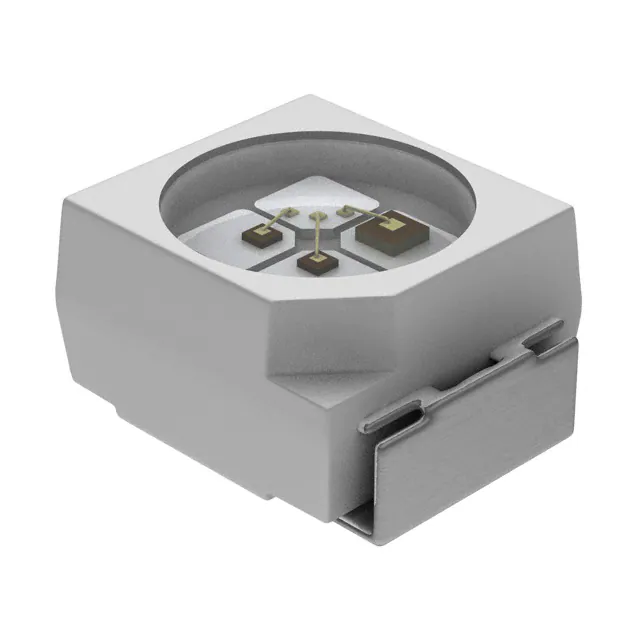

VLMR334BACB-GS08 数据手册
VLMS334.., VLMR334.., VLMK334.., VLMY334.. www.vishay.com Vishay Semiconductors Power SMD LED PLCC-2 FEATURES • Utilizing latest advanced AlInGaP technology • Available in 8 mm tape • Luminous intensity and color categorized per packing unit • Luminous intensity ratio per packing unit IVmax./IVmin. ≤ 1.6 19225 • Thermal resistance R = 300 K/W • ESD-withstand voltage: Up to 2 kV according to JESD22-A114-B DESCRIPTION The VLM.334.. series is an advanced modification of the Vishay VLM.31.. series. It is designed to incorporate larger chips, therefore, capable of withstanding a 70 mA drive current. • Preconditioning according to JEDEC® level 2a • Compatible with reflow, vapor phase and wave solder processes according to CECC 00802 and J-STD-020 The package of the VLM.334.. is the PLCC-2. It consists of a lead frame which is embedded in a white thermoplast. The reflector inside this package is filled up with clear epoxy. • AEC-Q101 qualified PRODUCT GROUP AND PACKAGE DATA APPLICATIONS • Product group: LED • Traffic signals and signs • Package: SMD PLCC-2 • Interior and exterior lighting • Product series: power • Dashboard illumination • Angle of half intensity: ± 60° • Indicator and backlighting purposes for audio, video, LCDs switches, symbols, illuminated advertising etc. • Material categorization: for definitions of compliance please see www.vishay.com/doc?99912 PARTS TABLE PART COLOR LUMINOUS INTENSITY (mcd) MIN. TYP. MAX. at IF (mA) WAVELENGTH (nm) MIN. TYP. MAX. at IF (mA) FORWARD VOLTAGE (V) MIN. TYP. MAX. at IF TECHNOLOGY (mA) VLMS334AABB-GS08 Super red 1120 1600 2800 50 626 630 639 50 1.9 2.2 2.8 50 AlInGaP on Si VLMS334AABB-GS18 (1) Super red 1120 1600 2800 50 626 630 639 50 1.9 2.2 2.8 50 AlInGaP on Si AlInGaP on Si VLMR334BACB-GS08 Red 1800 2200 4500 50 619 625 631 50 1.9 2.2 2.8 50 VLMR334BACB-GS18 (1) Red 1800 2200 4500 50 619 625 631 50 1.9 2.2 2.8 50 AlInGaP on Si VLMK334BACB-GS08 Amber 1800 2800 4500 50 611 616 622 50 1.9 2.25 2.8 50 AlInGaP on Si VLMK334BACB-GS18 (1) Amber 1800 2800 4500 50 611 616 622 50 1.9 2.25 2.8 50 AlInGaP on Si VLMY334BACB-GS08 Yellow 1800 2300 4500 50 583 589 594 50 1.9 2.3 2.8 50 AlInGaP on Si VLMY334BACB-GS18 (1) Yellow 1800 2300 4500 50 583 589 594 50 1.9 2.3 2.8 50 AlInGaP on Si Note (1) Not for new designs Rev. 1.3, 13-Oct-2021 Document Number: 84213 1 For technical questions, contact: LED@vishay.com THIS DOCUMENT IS SUBJECT TO CHANGE WITHOUT NOTICE. THE PRODUCTS DESCRIBED HEREIN AND THIS DOCUMENT ARE SUBJECT TO SPECIFIC DISCLAIMERS, SET FORTH AT www.vishay.com/doc?91000 VLMS334.., VLMR334.., VLMK334.., VLMY334.. www.vishay.com Vishay Semiconductors ABSOLUTE MAXIMUM RATINGS (Tamb = 25 °C, unless otherwise specified) VLMS334..., VLMR334..., VLMK334..., VLMY334... PARAMETER TEST CONDITION SYMBOL VALUE Reverse voltage (1) Short term application only VR 5 V DC forward current Tamb ≤ 65 °C (300 K/W) IF 70 mA tp ≤ 10 μs IFSM 0.1 A PV 200 mW Surge forward current Power dissipation Junction temperature Operating temperature range Storage temperature range Thermal resistance junction to ambient Mounted on PC board (pad size > 16 mm2) UNIT Tj 125 °C Tamb -40 to +100 °C Tstg -40 to +100 °C RthJA 300 K/W Note (1) Driving the LED in reverse direction is suitable for a short term application OPTICAL AND ELECTRICAL CHARACTERISTICS (Tamb = 25 °C, unless otherwise specified) VLMS334.., SUPER RED PARAMETER Luminous intensity TEST CONDITION PART SYMBOL MIN. TYP. MAX. IF = 50 mA VLMS334AABB IV 1120 1600 2800 mcd φV/IV - 3 - mlm/mcd Luminous flux/luminous intensity UNIT Dominant wavelength IF = 50 mA λd 626 630 639 nm Peak wavelength IF = 50 mA λp - 639 - nm nm Spectral bandwidth at 50 % Irel max. IF = 50 mA Δλ - 18 - Angle of half intensity IF = 50 mA ϕ - ± 60 - ° Forward voltage IF = 50 mA VF 1.9 2.2 2.8 V Reverse current VR = 5 V IR - 0.01 10 μA OPTICAL AND ELECTRICAL CHARACTERISTICS (Tamb = 25 °C, unless otherwise specified) VLMR334.., RED PARAMETER Luminous intensity TEST CONDITION PART SYMBOL MIN. TYP. MAX. IF = 50 mA VLMR334BACB IV 1800 2200 4500 mcd φV/IV - 3 - mlm/mcd Luminous flux/luminous intensity UNIT Dominant wavelength IF = 50 mA λd 619 625 631 nm Peak wavelength IF = 50 mA λp - 632 - nm Spectral bandwidth at 50 % Irel max. IF = 50 mA Δλ - 18 - nm Angle of half intensity IF = 50 mA ϕ - ± 60 - ° Forward voltage IF = 50 mA VF 1.9 2.2 2.8 V Reverse current VR = 5 V IR - 0.01 10 μA OPTICAL AND ELECTRICAL CHARACTERISTICS (Tamb = 25 °C, unless otherwise specified) VLMK334.., AMBER PARAMETER Luminous intensity TEST CONDITION PART SYMBOL MIN. TYP. MAX. UNIT IF = 50 mA VLMK334BACB IV 1800 2800 4500 mcd mlm/mcd φV/IV - 3 - Dominant wavelength IF = 50 mA λd 611 616 622 nm Peak wavelength IF = 50 mA λp - 622 - nm nm Luminous flux/luminous intensity Spectral bandwidth at 50 % Irel max. IF = 50 mA Δλ - 18 - Angle of half intensity IF = 50 mA ϕ - ± 60 - ° Forward voltage IF = 50 mA VF 1.9 2.25 2.8 V Reverse current VR = 5 V IR - 0.01 10 μA Rev. 1.3, 13-Oct-2021 Document Number: 84213 2 For technical questions, contact: LED@vishay.com THIS DOCUMENT IS SUBJECT TO CHANGE WITHOUT NOTICE. THE PRODUCTS DESCRIBED HEREIN AND THIS DOCUMENT ARE SUBJECT TO SPECIFIC DISCLAIMERS, SET FORTH AT www.vishay.com/doc?91000 VLMS334.., VLMR334.., VLMK334.., VLMY334.. www.vishay.com Vishay Semiconductors OPTICAL AND ELECTRICAL CHARACTERISTICS (Tamb = 25 °C, unless otherwise specified) VLMY334.., YELLOW PARAMETER Luminous intensity TEST CONDITION PART SYMBOL MIN. TYP. MAX. IF = 50 mA VLMY334BACB IV 1800 2300 4500 mcd φV/IV - 3 - mlm/mcd Luminous flux/luminous intensity UNIT Dominant wavelength IF = 50 mA λd 583 589 594 nm Peak wavelength IF = 50 mA λp - 591 - nm Spectral bandwidth at 50 % Irel max. IF = 50 mA Δλ - 17 - nm Angle of half intensity IF = 50 mA ϕ - ± 60 - ° Forward voltage IF = 50 mA VF 1.9 2.3 2.8 V Reverse current VR = 5 V IR - 0.01 10 μA COLOR CLASSIFICATION DOM. WAVELENGTH (nm) GROUP AMBER YELLOW MIN. MAX. MIN. 1 611 618 - MAX. - 2 614 622 583 586 3 - - 585 588 4 - - 587 590 5 - - 589 592 6 - - 591 594 Note • Wavelengths are tested at a current pulse duration of 25 ms LUMINOUS INTENSITY CLASSIFICATION GROUP LIGHT INTENSITY (mcd) STANDARD MIN. MAX. AA 1120 1400 AB 1400 1800 BA 1800 2240 BB 2240 2800 CA 2800 3550 CB 3550 4500 CROSSING TABLE VISHAY OSRAM VLMK334BACB LA T67F-U2AB-24-1 VLMY334BACB LY T67F-U1AA-36-1 Note • Luminous intensity is tested at a current pulse duration of 25 ms and an accuracy of ± 11 %. The above type numbers represent the order groups which include only a few brightness groups. Only one group will be shipped on each reel (there will be no mixing of two groups on each reel). In order to ensure availability, single brightness groups will not be orderable. In a similar manner for colors where wavelength groups are measured and binned, single wavelength groups will be shipped on any one reel. In order to ensure availability, single wavelength groups will not be orderable CROSSING TABLE VISHAY OSRAM VLMS334AABB LS T67F-T2V2-1-1 VLMR334BACB LR T67F-U1AA-1-1 Rev. 1.3, 13-Oct-2021 Document Number: 84213 3 For technical questions, contact: LED@vishay.com THIS DOCUMENT IS SUBJECT TO CHANGE WITHOUT NOTICE. THE PRODUCTS DESCRIBED HEREIN AND THIS DOCUMENT ARE SUBJECT TO SPECIFIC DISCLAIMERS, SET FORTH AT www.vishay.com/doc?91000 VLMS334.., VLMR334.., VLMK334.., VLMY334.. www.vishay.com Vishay Semiconductors TYPICAL CHARACTERISTICS (Tamb = 25 °C, unless otherwise specified) 80 1.2 amber 60 50 40 30 20 yellow 1.0 Irel - Relative Intensity IF - Max. Permissible Forward Current (mA) 70 0.8 0.6 0.4 0.2 10 0 540 560 580 600 620 640 660 680 0 0 20 40 60 80 100 120 λ - Wavelenght (nm) Tamb - Ambient Temperature (°C) Fig. 4 - Relative Intensity vs. Wavelength Fig. 1 - Maximum Permissible Forward Current vs. Ambient Temperature 0° 10° 20° 100 30° 0.9 50° 0.8 60° 70° 0.7 IF - Forward Current (mA) 40° 1.0 yellow ϕ - Angular Displacement IV rel - Relative Luminous Intensity red super red amber red super red 10 80° 1 0.6 0.4 0.2 0 1 95 10319 2 2.5 3 3.5 VF - Forward Voltage (V) Fig. 2 - Relative Luminous Intensity vs. Angular Displacement Fig. 5 - Forward Current vs. Forward Voltage 10 IV rel - Relative Luminous Intensity 0.12 IF - Forward Current (A) 1.5 0.10 0.08 tp/T = 0.005 0.05 0.5 0.06 0.04 0.02 0.00 yellow amber red super red 1 0.1 0.01 0.001 10 -5 10 -4 10 -3 10 -2 10 -1 10 0 17044 101 102 tp - Pulse Length (s) Fig. 3 - Forward Current vs. Pulse Length Rev. 1.3, 13-Oct-2021 1 10 100 IF - Forward Current (mA) Fig. 6 - Relative Luminous Intensity vs. Forward Current Document Number: 84213 4 For technical questions, contact: LED@vishay.com THIS DOCUMENT IS SUBJECT TO CHANGE WITHOUT NOTICE. THE PRODUCTS DESCRIBED HEREIN AND THIS DOCUMENT ARE SUBJECT TO SPECIFIC DISCLAIMERS, SET FORTH AT www.vishay.com/doc?91000 VLMS334.., VLMR334.., VLMK334.., VLMY334.. ΔVF - Change of Forward Voltage (mV) www.vishay.com Vishay Semiconductors 300 yellow amber red super red 200 100 0 -100 -200 -300 -40 -20 0 20 40 60 80 100 Tamb - Ambient Temperature (°C) Fig. 7 - Change of Forward Voltage vs. Ambient Temperature IV rel - Relative Luminous Intensity 2.5 2.0 yellow amber red 1.5 1.0 super red 0.5 0 -40 -20 0 20 40 60 80 100 Tamb - Ambient Temperature (°C) Δλd - Change Dominant Wavelength (nm) Fig. 8 - Relative Luminous Intensity vs. Ambient Temperature 10 8 yellow 6 4 2 0 amber red super red -2 -4 -6 -8 - 40 -20 0 20 40 60 80 100 Tamb - Ambient Temperature (°C) Fig. 9 - Change of Dominant Wavelength vs. Ambient Temperature Rev. 1.3, 13-Oct-2021 Document Number: 84213 5 For technical questions, contact: LED@vishay.com THIS DOCUMENT IS SUBJECT TO CHANGE WITHOUT NOTICE. THE PRODUCTS DESCRIBED HEREIN AND THIS DOCUMENT ARE SUBJECT TO SPECIFIC DISCLAIMERS, SET FORTH AT www.vishay.com/doc?91000 VLMS334.., VLMR334.., VLMK334.., VLMY334.. www.vishay.com Vishay Semiconductors PACKAGE DIMENSIONS in millimeters 0.9 1.75 ± 0.1 3.5 ± 0.2 0.8 technical drawings according to DIN specifications C A 2.2 2.8 ± 0.15 Pin identification Drawing-No.: 6.541-5067.01-4 Issue: 7; 12.03.14 Ø 2.4 3 + 0.15 Mounting Pad Layout Area covered with solderresist 4 2.6 (2.8) 1.2 1.6 (1.9) 4 Dimensions: reflow and vapor phase (wave soldering) Rev. 1.3, 13-Oct-2021 Document Number: 84213 6 For technical questions, contact: LED@vishay.com THIS DOCUMENT IS SUBJECT TO CHANGE WITHOUT NOTICE. THE PRODUCTS DESCRIBED HEREIN AND THIS DOCUMENT ARE SUBJECT TO SPECIFIC DISCLAIMERS, SET FORTH AT www.vishay.com/doc?91000 VLMS334.., VLMR334.., VLMK334.., VLMY334.. www.vishay.com Vishay Semiconductors METHOD OF TAPING / POLARITY AND TAPE AND REEL SMD LED (VLMx334..-SERIES) Vishay’s LEDs in SMD packages are available in an antistatic 8 mm blister tape (in accordance with DIN IEC 40 (CO) 564) for automatic component insertion. The blister tape is a plastic strip with impressed component cavities, covered by a top tape. REEL PACKAGE DIMENSION IN MILLIMETERS FOR SMD LEDS, TAPE OPTION GS18 (= 8000 PCS.) PREFERRED 10.4 8.4 120° 4.5 3.5 Adhesive tape 13.00 12.75 2.5 1.5 62.5 60.0 Identification Label: Vishay type group tape code production code quantity Blister tape Component cavity 94 8670 14.4 max. 321 329 18857 Fig. 12 - Reel Dimensions - GS18 SOLDERING PROFILE TAPING OF VLMx334.. 3.5 3.1 IR Reflow Soldering Profile for Lead (Pb)-free Soldering 2.2 2.0 Preconditioning acc. to JEDEC level 3 300 8.3 7.7 1.85 1.65 1.6 1.4 4.1 3.9 Temperature (°C) 3.6 3.4 4.0 3.6 max. 260 °C 245 °C 255 °C 240 °C 217 °C 250 5.75 5.25 200 max. 30 s 150 max. 100 s max. 120 s 100 0.25 4.1 3.9 max. ramp down 6 °C/s max. ramp up 3 °C/s 50 2.05 1.95 0 94 8668 0 50 100 150 Time (s) Fig. 10 - Tape Dimensions in mm for PLCC-2 200 Fig. 13 - Vishay Lead (Pb)-free Reflow Soldering Profile (according to J-STD-020) TTW Soldering (according to CECC00802) 300 250 13.00 12.75 63.5 60.5 Identification Label: Vishay type group tape code production code quantity 200 235 °C to 260 °C First wave 100 °C to 130 °C 100 100 2 K/s 50 180 178 Fig. 11 - Reel Dimensions - GS08 Rev. 1.3, 13-Oct-2021 ca. 5 K/s Forced cooling 10 0 14.4 max. 0 94 8665 948626-1 1000 ca. 2 K/s ca. 200 K/s 150 Full line: typical Dotted lines: process limits Second wave 1st line 2nd line 2.5 1.5 Lead temperature 2nd line Temperature (°C) 4.5 3.5 10000 5s 10.0 9.0 120° 300 max. 2 cycles allowed 19885-1 REEL PACKAGE DIMENSION IN MILLIMETERS FOR SMD LEDS, TAPE OPTION GS08 (= 1500 PCS.) 250 50 100 150 200 250 Time (s) Fig. 14 - Double Wave Soldering of Opto Devices (all Packages) Document Number: 84213 7 For technical questions, contact: LED@vishay.com THIS DOCUMENT IS SUBJECT TO CHANGE WITHOUT NOTICE. THE PRODUCTS DESCRIBED HEREIN AND THIS DOCUMENT ARE SUBJECT TO SPECIFIC DISCLAIMERS, SET FORTH AT www.vishay.com/doc?91000 VLMS334.., VLMR334.., VLMK334.., VLMY334.. www.vishay.com Vishay Semiconductors BAR CODE PRODUCT LABEL (example only) RECOMMENDED METHOD OF STORAGE Dry box storage is recommended as soon as the aluminum bag has been opened to prevent moisture absorption. The following conditions should be observed, if dry boxes are not available: A B C D • Storage temperature 10 °C to 30 °C L E I G F H M K A. 2D barcode • Storage humidity ≤ 60 % RH max. After more than 672 h under these conditions moisture content will be too high for reflow soldering. In case of moisture absorption, the devices will recover to the former condition by drying under the following condition: B. Vishay part number C. Quantity D. PTC = selection code (binning) E. Code of manufacturing plant F. Batch = date code: year/week/plant code 192 h at 40 °C + 5 °C / - 0 °C and < 5 % RH (dry air/nitrogen) or 96 h at 60 °C + 5 °C and < 5 % RH for all device containers or 24 h at 100 °C + 5 °C not suitable for reel or tubes. An EIA JEDEC standard JESD22-A112 level 2a label is included on all dry bags. G. Region code H. SL = sales location I. Terminations finishing K. Lead (Pb)-free symbol L E V E L CAUTION This bag contains MOISTURE –SENSITIVE DEVICES L. Halogen-free symbol M. RoHS symbol 2a 1. Shelf life in sealed bag 12 months at
