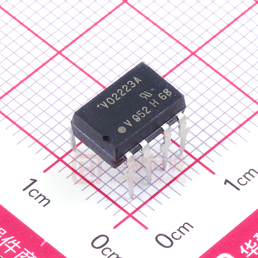

VO2223A www.vishay.com Vishay Semiconductors Optocoupler, Power Phototriac FEATURES • Maximum trigger current (IFT): 10 mA 8 1 • Isolation test voltage 5300 VRMS 2 • Peak off-state voltage 600 V i179012-3 3 6 4 5 • Load current 1 ARMS • dV/dt of 210 V/μs • DIP-8 package 21081-4 V D E • Pure tin leads • Material categorization: for definitions of compliance please see www.vishay.com/doc?99912 PIN FUNCTION APPLICATIONS 1 LED cathode 2 LED anode 3 LED cathode 4 LED cathode 5 Triac gate • Home appliances (air conditioners, microwave ovens, washing machines, personal hygiene systems, refrigerators, fan heaters, inductive heating cooker, water heaters, etc.) 6 Triac T1 • Industrial equipments 8 Triac T2 AGENCY APPROVALS DESCRIPTION • UL - E52744 system code H The VO2223A is an optically couple phototriac driving a power triac in a DIP-8 package. It provides a 5300 V of input to output isolation. • cUL - E52744 system code H • VDE - DIN EN60747-5-5 (VDE 0884-5) ORDERING INFORMATION V O 2 2 PART NUMBER AGENCY CERTIFIED/PACKAGE UL, cUL DIP-8 DIP-8, option 7 VDE, UL, cUL DIP-8 2 3 A - X 0 0 # PACKAGE OPTION DIP-8 7.62 mm Option 7 > 0.7 mm TRIGGER, CURRENT IFT (mA) 10 VO2223A VO2223A-X007T 10 VO2223A-X001 Document Number: 81924 1 For technical questions, contact: optocoupleranswers@vishay.com THIS DOCUMENT IS SUBJECT TO CHANGE WITHOUT NOTICE. THE PRODUCTS DESCRIBED HEREIN AND THIS DOCUMENT ARE SUBJECT TO SPECIFIC DISCLAIMERS, SET FORTH AT www.vishay.com/doc?91000 Rev. 1.5, 07-Dec-17 VO2223A www.vishay.com Vishay Semiconductors ABSOLUTE MAXIMUM RATINGS (Tamb = 25 °C, unless otherwise specified) PARAMETER TEST CONDITION SYMBOL VALUE UNIT LED continuous forward current IF 50 mA LED reverse voltage VR 5 V INPUT OUTPUT Repetitive peak off-state voltage Sine wave, 50 Hz to 60 Hz, gate open VDRM 600 V IT(RMS) 1 A ITSM 10 A Total power dissipation (2) Pdiss 1.2 W Ambient temperature range Tamb -40 to +85 °C Storage temperature range Tstg -40 to +125 °C t ≤ 10 s max. Tsld 260 °C For 1 s VISO 5300 VRMS On-state RMS current Peak non-repetitive surge current (50 Hz, peak) COUPLER Soldering temperature (1) Isolation test voltage Notes • Stresses in excess of the absolute maximum ratings can cause permanent damage to the device. Functional operation of the device is not implied at these or any other conditions in excess of those given in the operational sections of this document. Exposure to absolute maximum ratings for extended periods of the time can adversely affect reliability (1) Refer to wave profile for soldering conditions for through hole devices (2) Total power dissipation value is based on 2S2P PCB 21296 IT(RMS) - RMS On-State Current (A) Pdiss - Input Power Disspation (mW) ABSOLUTE MAXIMUM RATING CURVES 80 60 40 20 0 -40 -20 0 20 40 60 1.2 1.0 0.8 0.6 0.4 0.2 80 100 120 Tamb - Ambient Temperature (°C) Fig. 1 - Power Dissipation vs. Temperature 21354 0 -40 -20 0 20 40 60 80 100 Tamb - Ambient Temperature (°C) Fig. 2 - Allowable Load Current vs. Ambient Temperature Note • The allowable load current was calculated out under a given operating conditions and only for reference: LED power: QE = 0.015 W, θBA (4-layer) = 30 °C/W Document Number: 81924 2 For technical questions, contact: optocoupleranswers@vishay.com THIS DOCUMENT IS SUBJECT TO CHANGE WITHOUT NOTICE. THE PRODUCTS DESCRIBED HEREIN AND THIS DOCUMENT ARE SUBJECT TO SPECIFIC DISCLAIMERS, SET FORTH AT www.vishay.com/doc?91000 Rev. 1.5, 07-Dec-17 VO2223A www.vishay.com Vishay Semiconductors ELECTRICAL CHARACTERISTICS (Tamb = 25 °C, unless otherwise specified) PARAMETER TEST CONDITION SYMBOL MIN. TYP. MAX. UNIT INPUT LED trigger current VT = 6 V IFT 2.5 - 10 mA Input reverse current VR = 5 V IR - - 10 μA LED forward voltage IF = 10 mA VF 0.9 - 1.4 V Peak on-state voltage ITM = 1 A VTM - - 1.7 V Peak off-state current VDRM = 600 V, TA = 110 °C IDRM - - 100 μA OUTPUT RL = 100 Ω IH - - 25 mA VIN = 400 VRMS (Fig. 3) dV/dtcr - 210 - V/μs VIN = 240 VRMS, IT = 1 ARMS (Fig. 3) dV/dtcrq - 0.7 - V/μs Holding current Critical rate of rise of off-state voltage Critical rate of rise of commutating voltage Note • Minimum and maximum values are testing requirements. Typical values are characteristics of the device and are the result of engineering evaluations. Typical values are for information only and are not part of the testing requirements RIN RL RTEST + 120 Ω VCC - AC VIN VIN Mon CTEST RL 5 V, VCC 0V dV/dt dV/dt (c) 21575 Fig. 3 - dV/dt Test Circuit SAFETY AND INSULATION RATINGS PARAMETER TEST CONDITION SYMBOL MIN. TYP. MAX. Climatic classification IEC 68 part 1 - 40 / 85 / 21 - Pollution degree DIN VDE 0109 - 2 - Tracking resistance (comparative tracking index) Highest allowable overvoltage Maximum working insulation voltage UNIT Insulation group IIIa CTI 175 - Transient overvoltage VIOTM 8000 - - Vpeak Recurring peak voltage VIORM 890 - - Vpeak Insulation resistance at 25 °C VIO = 500 V RIS - - ≥ 1012 Ω Insulation resistance at TS VIO = 500 V RIS - - ≥ 109 Ω Insulation resistance at 100 °C VIO = 500 V RIS - - ≥ 1011 Ω Method b, Vpd = VIORM x 1.6 Vpd - - 1424 Vpeak Case temperature TSI - - 165 °C Input current ISI - - 150 mA PSO Partial discharge test voltage Safety limiting values maximum values allowed in the event of a failure Output power - - 2000 mW Minimum external air gap (clearance distance) Measured from input terminals to output terminals, shortest distance through air ≥7 - - mm Minimum external tracking (creepage distance) Measured from input terminals to output terminals, shortest distance path along body ≥7 - - mm Note • This phototriac coupler is suitable for “safe electrical insulation” only within the safety ratings. Compliance with safety ratings shall be ensured by means of protective circuits Document Number: 81924 3 For technical questions, contact: optocoupleranswers@vishay.com THIS DOCUMENT IS SUBJECT TO CHANGE WITHOUT NOTICE. THE PRODUCTS DESCRIBED HEREIN AND THIS DOCUMENT ARE SUBJECT TO SPECIFIC DISCLAIMERS, SET FORTH AT www.vishay.com/doc?91000 Rev. 1.5, 07-Dec-17 VO2223A www.vishay.com Vishay Semiconductors TYPICAL CHARACTERISTICS (Tamb = 25 °C, unless otherwise specified) Off-State Leakage Current (nA) IF - Forward Current (mA) 100 85 °C 25 °C 10 0 °C 55 °C -40 °C 100 000 10 000 85 °C 1000 55 °C 100 25 °C 10 0 °C 1 -40 °C 0.1 1 0 0.8 1.0 1.2 1.4 1.6 0 100 VF - Forward Voltage (V) IFT - Trigger Current (mA) VR - Reverse Voltage (V) 600 45 1.3 1.1 0.9 0.7 0.5 -15 35 10 60 85 -40 -15 10 35 60 85 Tamb - Temperature (°C) Tamb - Temperature (°C) Fig. 5 - Reverse Voltage vs. Temperature Fig. 8 - Normalized Trigger Input Current vs. Temperature 1.8 50 IFT - Trigger Input Current (mA) ITM - Peak On-State Current (A) 500 1.5 50 1.2 0.6 0 -0.6 -1.2 21909 400 Fig. 7 - Off-State Leakage Current vs. Voltage 55 -1.8 -1.8 300 Supply Voltage (V) Fig. 4 - Forward Current vs. Forward Voltage 40 -40 200 40 30 20 10 -1.2 -0.6 0 0.6 1.2 1.8 VTM - Peak On-State Voltage (V) Fig. 6 - On-State Current vs. On-State Voltage 1 21912 10 100 Turn-On Time (µs) Fig. 9 - Trigger Input Current vs. Turn-on Time Document Number: 81924 4 For technical questions, contact: optocoupleranswers@vishay.com THIS DOCUMENT IS SUBJECT TO CHANGE WITHOUT NOTICE. THE PRODUCTS DESCRIBED HEREIN AND THIS DOCUMENT ARE SUBJECT TO SPECIFIC DISCLAIMERS, SET FORTH AT www.vishay.com/doc?91000 Rev. 1.5, 07-Dec-17 VO2223A www.vishay.com Vishay Semiconductors Holding Current (mA) 2.5 2.0 1.5 1.0 0.5 0 -40 -15 10 35 60 85 Tamb - Temperature (°C) Fig. 10 - Normalized Holding Current vs. Temperature IFT - Trigger Input Current (mA) 5.5 5.0 4.5 4.0 3.5 3.0 20 40 60 80 100 Trigger Pulse Width (µs) 21914 Fig. 11 - Trigger Current vs. Trigger Pulse Width IFT - Trigger Input Current (mA) 5 4 3 2 1 0 100 200 300 400 500 600 VT - Terminal Voltage (V) 21915 Fig. 12 - Trigger Current vs. VLOAD Document Number: 81924 5 For technical questions, contact: optocoupleranswers@vishay.com THIS DOCUMENT IS SUBJECT TO CHANGE WITHOUT NOTICE. THE PRODUCTS DESCRIBED HEREIN AND THIS DOCUMENT ARE SUBJECT TO SPECIFIC DISCLAIMERS, SET FORTH AT www.vishay.com/doc?91000 Rev. 1.5, 07-Dec-17 VO2223A www.vishay.com Vishay Semiconductors PACKAGE DIMENSIONS in millimeters Pin one ID 4 3 5 6 2 1 6.48 6.81 8 ISO method A 9.63 9.91 Option 7 0.76 7.62 typ. 1.14 7.62 typ. 0.79 4° typ. 3.30 3.81 0.7 1.27 10° 0.51 0.89 0.46 0.56 2.79 3.30 3° to 9° 5.84 6.35 8 min. 8.4 min. 10.3 max. 0.2 0.3 2.54 typ. 4.6 4.1 0.76 2.54 R 0.25 1.78 8 min. 11.05 1.52 PACKAGE MARKING (Example of VO2223A-X001) VO2223A V YWW H 68 Document Number: 81924 6 For technical questions, contact: optocoupleranswers@vishay.com THIS DOCUMENT IS SUBJECT TO CHANGE WITHOUT NOTICE. THE PRODUCTS DESCRIBED HEREIN AND THIS DOCUMENT ARE SUBJECT TO SPECIFIC DISCLAIMERS, SET FORTH AT www.vishay.com/doc?91000 Rev. 1.5, 07-Dec-17 Legal Disclaimer Notice www.vishay.com Vishay Disclaimer ALL PRODUCT, PRODUCT SPECIFICATIONS AND DATA ARE SUBJECT TO CHANGE WITHOUT NOTICE TO IMPROVE RELIABILITY, FUNCTION OR DESIGN OR OTHERWISE. Vishay Intertechnology, Inc., its affiliates, agents, and employees, and all persons acting on its or their behalf (collectively, “Vishay”), disclaim any and all liability for any errors, inaccuracies or incompleteness contained in any datasheet or in any other disclosure relating to any product. Vishay makes no warranty, representation or guarantee regarding the suitability of the products for any particular purpose or the continuing production of any product. To the maximum extent permitted by applicable law, Vishay disclaims (i) any and all liability arising out of the application or use of any product, (ii) any and all liability, including without limitation special, consequential or incidental damages, and (iii) any and all implied warranties, including warranties of fitness for particular purpose, non-infringement and merchantability. Statements regarding the suitability of products for certain types of applications are based on Vishay’s knowledge of typical requirements that are often placed on Vishay products in generic applications. Such statements are not binding statements about the suitability of products for a particular application. It is the customer’s responsibility to validate that a particular product with the properties described in the product specification is suitable for use in a particular application. Parameters provided in datasheets and / or specifications may vary in different applications and performance may vary over time. All operating parameters, including typical parameters, must be validated for each customer application by the customer’s technical experts. Product specifications do not expand or otherwise modify Vishay’s terms and conditions of purchase, including but not limited to the warranty expressed therein. Except as expressly indicated in writing, Vishay products are not designed for use in medical, life-saving, or life-sustaining applications or for any other application in which the failure of the Vishay product could result in personal injury or death. Customers using or selling Vishay products not expressly indicated for use in such applications do so at their own risk. Please contact authorized Vishay personnel to obtain written terms and conditions regarding products designed for such applications. No license, express or implied, by estoppel or otherwise, to any intellectual property rights is granted by this document or by any conduct of Vishay. Product names and markings noted herein may be trademarks of their respective owners. © 2019 VISHAY INTERTECHNOLOGY, INC. ALL RIGHTS RESERVED Revision: 01-Jan-2019 1 Document Number: 91000
