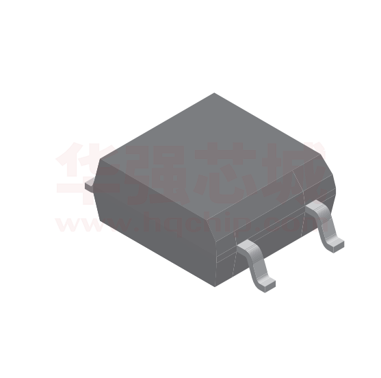

VOM3052, VOM3053 www.vishay.com Vishay Semiconductors Optocoupler, Phototriac Output, Non-Zero Crossing, 1.5 kV/μs dV/dt, 600 V FEATURES A C 4 1 3 2 • High static dV/dt > 1.5 kV/μs • Input sensitivity IFT = 5 mA and 10 mA MT2 • • • • MT1 i179066 On-state RMS current IT(RMS) = 70 mA 600 V peak off-state blocking voltage Isolation test voltage 3750 VRMS Material categorization: for definitions of compliance please see www.vishay.com/doc?99912 DESCRIPTION APPLICATIONS The VOM3052 and VOM3053 phototriac consist a GaAs IRLED optically coupled to a photosensitive non-zero crossing TRIAC packaged in a SOP-4 package. It has a LED trigger current of 5 mA for VOM3053 and 10 mA for VOM3052. The VOM3052 and VOM3053 phototriac isolate low-voltage logic from 120 VAC, 240 VAC, and 380 VAC lines to control resistive, inductive, or capacitive loads including motors, solenoids, high current thyristors or TRIAC and relays. • • • • • • Consumer appliances Triac drives Solid-state relays Industrial controls Office equipment Lighting controls AGENCY APPROVALS • • • • UL1577, file no. E52744, double protection cUL-file no. E52744, equivalent to CSA bulletin 5A VDE 0884-5, DIN EN 60747-5-5 CQC: GB8898, GB4943 ORDERING INFORMATION V O M 3 0 5 X SOP-# T PART NUMBER AGENCY CERTIFIED/PACKAGE UL, cUL, CQC 7.21 mm TRIGGER CURRENT IFT 5 mA 10 mA SOP-4 VOM3053T VOM3052T SOP-4 180° orientation VOM3053T3 - 5 mA 10 mA VOM3053-X001T VOM3052-X001T VDE, UL, cUL, CQC SOP-4 Notes • For additional information on the available options refer to option information. • The product is available only on tape and reel. ABSOLUTE MAXIMUM RATINGS (Tamb = 25 °C, unless otherwise specified) PARAMETER TEST CONDITION PART SYMBOL VALUE UNIT INPUT Reverse voltage VR 6 V Forward current IF 60 mA IFSM 0.5 A Pdiss 100 mW Peak surge current Power dissipation Rev. 1.5, 27-Jan-15 100 μs, 200 pps Document Number: 83492 1 For technical questions, contact: optocoupleranswers@vishay.com THIS DOCUMENT IS SUBJECT TO CHANGE WITHOUT NOTICE. THE PRODUCTS DESCRIBED HEREIN AND THIS DOCUMENT ARE SUBJECT TO SPECIFIC DISCLAIMERS, SET FORTH AT www.vishay.com/doc?91000 VOM3052, VOM3053 www.vishay.com Vishay Semiconductors ABSOLUTE MAXIMUM RATINGS (Tamb = 25 °C, unless otherwise specified) PARAMETER TEST CONDITION OUTPUT Peak off-state voltage RMS on-state current Peak non-repetitive surge current Power dissipation COUPLER Isolation test voltage Power dissipation Storage temperature range Ambient temperature range Soldering temperature PART SYMBOL VALUE UNIT VDRM IT(RMS) ITSM Pdiss 600 70 1 200 V mA A mW VISO Ptot Tstg Tamb Tsld 3750 300 -55 to +150 -40 to +100 260 VRMS mW °C °C °C PW = 100 ms, 120 pps t = 1 min Notes • Stresses in excess of the Absolute Maximum Ratings can cause permanent damage to the device. Functional operation of the device is not implied at these or any other conditions in excess of those given in the operational sections of this document. Exposure to Absolute Maximum Ratings for extended periods of the time can adversely affect reliability. IL - Load Current (mA) 100 80 60 40 20 0 - 40 - 20 0 20 40 60 80 100 120 Tamb - Temperature (°C) Fig. 1 - Recommended Operating Condition ELECTRICAL CHARACTERISTICS (Tamb = 25 °C, unless otherwise specified) PARAMETER INPUT Forward voltage Reverse current Input capacitance OUTPUT Off-state current On-state voltage Critical rate of rise off-state voltage Critical rate of rise of voltage at current commutation COUPLER LED trigger current, current required to latch output Capacitance (input - output) Peak off-state voltage Holding current TEST CONDITION PART SYMBOL IF = 10 mA VR = 6 V VF = 0 V, f = 1 MHz VF IR CI VD = VDRM IT = 100 mA VD = 0.67 VDRM, TJ = 25 °C IDRM VTM dV/dtcr MIN. f = 1 MHz, VIO = 0 V IC = 100 μA VOM3053 VOM3052 IFT IFT CIO VDRM Ihold MAX. UNIT 1.2 1.5 10 V μA pF 100 3 nA V V/μs 25 1500 dV/dtcrq VD = 3 V TYP. 0.13 V/μs 5 10 0.8 600 0.3 mA mA pF V mA Note • Minimum and maximum values were tested requirements. Typical values are characteristics of the device and are the result of engineering evaluations. Typical values are for information only and are not part of the testing requirements. Rev. 1.5, 27-Jan-15 Document Number: 83492 2 For technical questions, contact: optocoupleranswers@vishay.com THIS DOCUMENT IS SUBJECT TO CHANGE WITHOUT NOTICE. THE PRODUCTS DESCRIBED HEREIN AND THIS DOCUMENT ARE SUBJECT TO SPECIFIC DISCLAIMERS, SET FORTH AT www.vishay.com/doc?91000 VOM3052, VOM3053 www.vishay.com Vishay Semiconductors SAFETY AND INSULATION RATINGS PARAMETER SYMBOL MIN. TYP. Climatic classification (according to IEC 68 part 1) MAX. UNIT 40/100/21 Pollution degree (DIN VDE 0109) 2 Comparative tracking index CTI 175 Peak transient overvoltage VIOTM 6000 399 Vpeak Peak insulation voltage VIORM 707 Vpeak Ω Isolation resistance at Tamb = 100 °C, VDC = 500 V RIO 1011 Isolation resistance at Tamb = 25 °C, VDC = 500 V RIO 1012 Safety rating - power PSO 400 mW Safety rating - input current ISI 150 mA Safety rating - temperature TSI Ω 165 Creepage distance °C 5 Clearance distance Insulation thickness DTI mm 5 mm 0.4 mm TYPICAL CHARACTERISTICS (Tamb = 25 °C, unless otherwise specified) 100 ITM - On-State Current (mA) VF - Forward Voltage (V) 1.6 100 °C 1.4 85 °C 50 °C 1.2 25 °C 1.0 0 °C - 40 °C 0.8 1 10 80 60 40 20 21983 20 40 60 80 100 Tamb - Ambient Temperature (°C) Fig. 3 - Reverse Voltage vs. Ambient Temperature Rev. 1.5, 27-Jan-15 0 - 25 - 50 - 75 0.5 1 1.5 2 2.5 VTM - On-State Voltage (V) Fig. 4 - On-State Current vs. On-State Voltage IDRM - Off-State Leakage Current (nA) VR - Reverse Voltage (V) 100 0 25 21982 Fig. 2 - Forward Current vs. Forward Voltage - 20 50 - 100 - 2.5 - 2 - 1.5 - 1 - 0.5 0 100 IFT - Forward Current (mA) 0 - 40 75 100 000 10 000 1000 100 21993 10 1 0.1 - 40 - 20 0 20 40 60 80 100 Tamb - Ambient Temperature Fig. 5 - Off-State Leakage Current vs. Ambient Temperature Document Number: 83492 3 For technical questions, contact: optocoupleranswers@vishay.com THIS DOCUMENT IS SUBJECT TO CHANGE WITHOUT NOTICE. THE PRODUCTS DESCRIBED HEREIN AND THIS DOCUMENT ARE SUBJECT TO SPECIFIC DISCLAIMERS, SET FORTH AT www.vishay.com/doc?91000 VOM3052, VOM3053 IFT - Normalized Trigger Current (mA) www.vishay.com Vishay Semiconductors 100 1.5 VD = 3 V tGD - Delay Time (µs) 1.3 1.1 0.9 0.7 0.5 - 40 21985 - 20 0 20 40 60 80 1 10 100 20 30 40 50 IFT - Trigger Current (mA) 21988 Tamb - Ambient Temperature (°C) Fig. 6 - Normalized Trigger Current vs. Ambient Temperature Fig. 9 - Trigger Current vs. Delay Time 8 IFT - Trigger Current (mA) 100 Turn-On Time (µs) 10 10 VL = 7 V 7 6 5 4 3 VL = 7 V 2 1 10 20 30 50 40 IFT - Trigger Current (mA) 21987 Fig. 7 - Trigger Current vs. Turn-On Time 2.0 1.5 1.0 0.5 0 - 40 - 20 80 100 7 6 5 4 3 0 20 40 60 80 0 100 Tamb - Ambient Temperature (°C) Fig. 8 - Normalized Holding Current vs. Ambient Temperature Rev. 1.5, 27-Jan-15 60 8 2.5 21986 40 PW - Trigger Pulse Width (µs) Fig. 10 - Trigger Current vs. Trigger Pulse Width IFT - Trigger Current (mA) IH - Normalized Holding Current (µA) 20 21989 21990 100 200 300 400 500 600 VLoad - Load Voltage (V) Fig. 11 - Trigger Current vs. Load Voltage Document Number: 83492 4 For technical questions, contact: optocoupleranswers@vishay.com THIS DOCUMENT IS SUBJECT TO CHANGE WITHOUT NOTICE. THE PRODUCTS DESCRIBED HEREIN AND THIS DOCUMENT ARE SUBJECT TO SPECIFIC DISCLAIMERS, SET FORTH AT www.vishay.com/doc?91000 VOM3052, VOM3053 www.vishay.com Vishay Semiconductors PACKAGE DIMENSIONS in millimeters R 0.25 0.36 2.54 0.91 5.08 7.37 1.14 PACKAGE MARKING (example) M3052 Pin 1 I.D. ink mark V YWW U68 TAPE AND REEL PACKAGING Dimensions in millimeters ESD sticker Tape slot in core 330 (13") Regular, special or bar code label 17999 Fig. 12 - Tape and Reel Shipping Medium, 2000 units per reel Rev. 1.5, 27-Jan-15 Document Number: 83492 5 For technical questions, contact: optocoupleranswers@vishay.com THIS DOCUMENT IS SUBJECT TO CHANGE WITHOUT NOTICE. THE PRODUCTS DESCRIBED HEREIN AND THIS DOCUMENT ARE SUBJECT TO SPECIFIC DISCLAIMERS, SET FORTH AT www.vishay.com/doc?91000 VOM3052, VOM3053 www.vishay.com Vishay Semiconductors 1.50 ± 0.1 2.00 ± 0.05 1.50 ± 0.1 4.00 ± 0.1 2.00 ± 0.05 4.00 ± 0.1 1.75 ± 0.1 1.75 ± 0.1 5.50 ± 0.05 7.33 ± 0.1 2 1 3 4 5.50 ± 0.05 7.33 ± 0.1 + 0.3 4 3 1 2 + 0.3 12.00 - 0.1 8° 12.00 - 0.1 8° 1.50 ± 0.25 8.00 ± 0.1 2.66 ± 0.1 4.72 ± 0.1 1.50 ± 0.25 8.00 ± 0.1 2.66 ± 0.1 4.72 ± 0.1 22646 Fig. 13 - Tape Dimensions 22748 Fig. 14 - Tape Dimensions (order code T3) SOLDER PROFILE HANDLING AND STORAGE CONDITIONS ESD level: HBM class 2 300 Floor life: unlimited 255 °C 240 °C 217 °C 250 Temperature (°C) max. 260 °C 245 °C Conditions: Tamb < 30 °C, RH < 85 % Moisture sensitivity level 1, according to J-STD-020 200 max. 30 s 150 max. 100 s max. 120 s 100 max. ramp down 6 °C/s 50 max. ramp up 3 °C/s 0 0 19841 50 100 150 200 250 300 Time (s) Fig. 15 - Lead (Pb)-free Reflow Solder Profile according to J-STD-020 Rev. 1.5, 27-Jan-15 Document Number: 83492 6 For technical questions, contact: optocoupleranswers@vishay.com THIS DOCUMENT IS SUBJECT TO CHANGE WITHOUT NOTICE. THE PRODUCTS DESCRIBED HEREIN AND THIS DOCUMENT ARE SUBJECT TO SPECIFIC DISCLAIMERS, SET FORTH AT www.vishay.com/doc?91000 Legal Disclaimer Notice www.vishay.com Vishay Disclaimer  ALL PRODUCT, PRODUCT SPECIFICATIONS AND DATA ARE SUBJECT TO CHANGE WITHOUT NOTICE TO IMPROVE RELIABILITY, FUNCTION OR DESIGN OR OTHERWISE. Vishay Intertechnology, Inc., its affiliates, agents, and employees, and all persons acting on its or their behalf (collectively, “Vishay”), disclaim any and all liability for any errors, inaccuracies or incompleteness contained in any datasheet or in any other disclosure relating to any product. Vishay makes no warranty, representation or guarantee regarding the suitability of the products for any particular purpose or the continuing production of any product. To the maximum extent permitted by applicable law, Vishay disclaims (i) any and all liability arising out of the application or use of any product, (ii) any and all liability, including without limitation special, consequential or incidental damages, and (iii) any and all implied warranties, including warranties of fitness for particular purpose, non-infringement and merchantability. Statements regarding the suitability of products for certain types of applications are based on Vishay’s knowledge of typical requirements that are often placed on Vishay products in generic applications. Such statements are not binding statements about the suitability of products for a particular application. It is the customer’s responsibility to validate that a particular product with the properties described in the product specification is suitable for use in a particular application. Parameters provided in datasheets and / or specifications may vary in different applications and performance may vary over time. All operating parameters, including typical parameters, must be validated for each customer application by the customer’s technical experts. Product specifications do not expand or otherwise modify Vishay’s terms and conditions of purchase, including but not limited to the warranty expressed therein. Except as expressly indicated in writing, Vishay products are not designed for use in medical, life-saving, or life-sustaining applications or for any other application in which the failure of the Vishay product could result in personal injury or death. Customers using or selling Vishay products not expressly indicated for use in such applications do so at their own risk. Please contact authorized Vishay personnel to obtain written terms and conditions regarding products designed for such applications. No license, express or implied, by estoppel or otherwise, to any intellectual property rights is granted by this document or by any conduct of Vishay. Product names and markings noted herein may be trademarks of their respective owners. © 2017 VISHAY INTERTECHNOLOGY, INC. ALL RIGHTS RESERVED Revision: 08-Feb-17 1 Document Number: 91000 Mouser Electronics Authorized Distributor Click to View Pricing, Inventory, Delivery & Lifecycle Information: Vishay: VOM3052T VOM3053T VOM3052-X001T VOM3053-X001T
